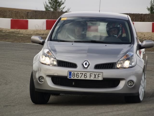

I am running stock contiSport contact's at the moment.I just ruined them all as there's meat inside, but the outside is shot. Maybe is just because the Continental tyres have soft sidewalls, but you guys can see what happens in this picture:
If you look at the tyre (not the bodyroll, stock non cup suspension can't cope with circuits) you can just see how the sidewall flexes. I was doing 2.2 bar (31 psi) of pressure front and 2 rear.
