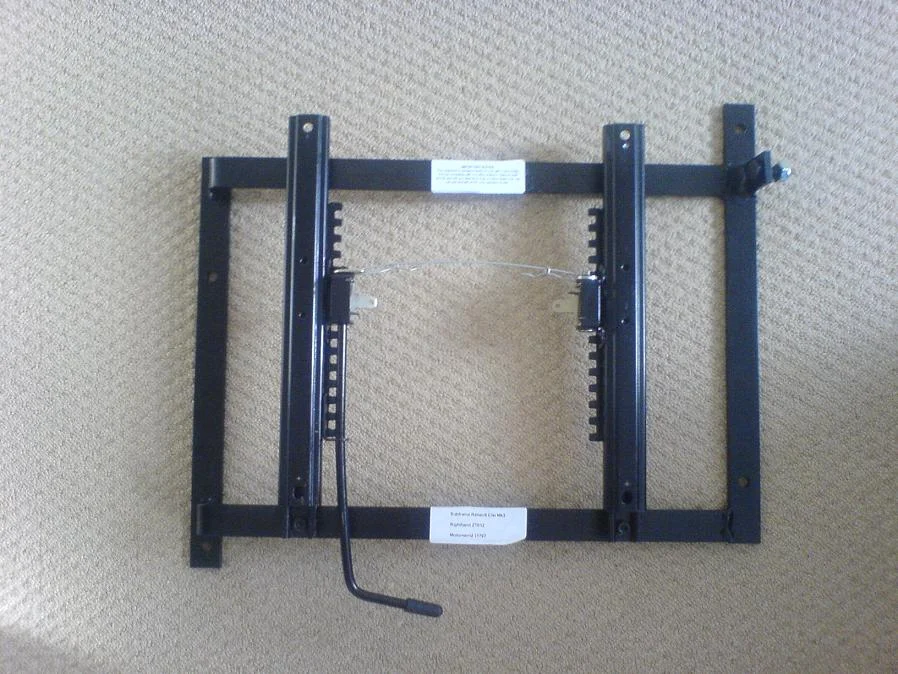

In order to fix the seat in your car you will need - a subframe - (Bolts to the car) a pair of sidemounts(these bolt to the side of the seat) and adaption bars so the sidemounts fit onto the subframe. Thats it! the seat will slide back and forward but will not tilt, You will be able to re-attach your seatbelt to the subframe.

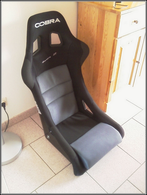

I have just bought a pair of Imola S, doubtless the end of serie, I do not know but I have it.

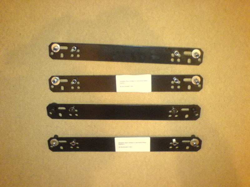

For the subframe, I do not understand has what serve the adaptation bars and or they come to take place.

This subframe is it indeed for Clio MKII?
I would be kind enough to have pics to see the depiction and the finish of the subframe in the car.

i can only assume that those bars are bolted to the floor pan through the cars old seat fixing holes, the seat mounts are then bolted to these and then the seat bolted to the mounts.
i cant be of much more use really im afraid, i just bolted my side mounts straight on to the car floor :P
