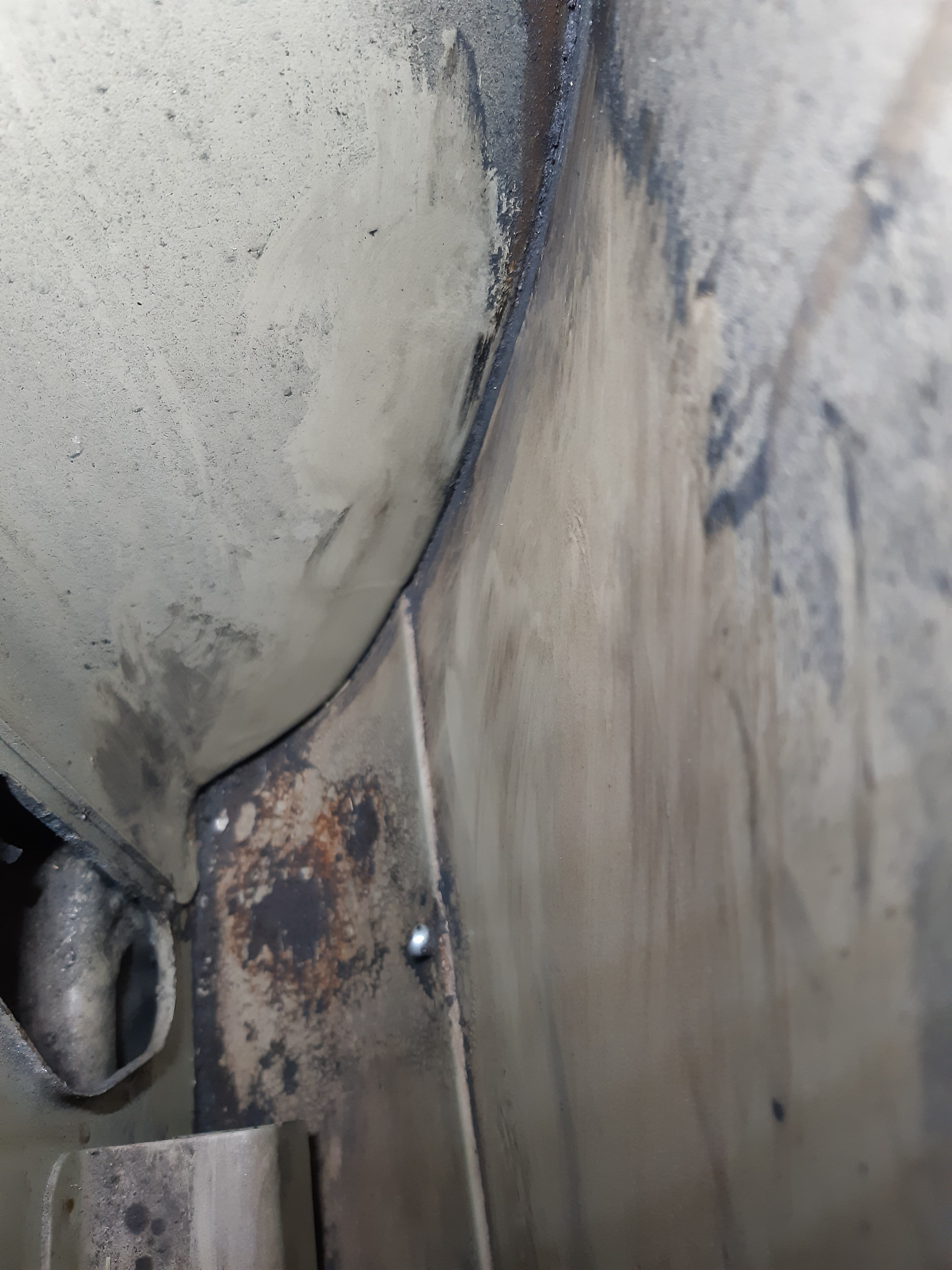

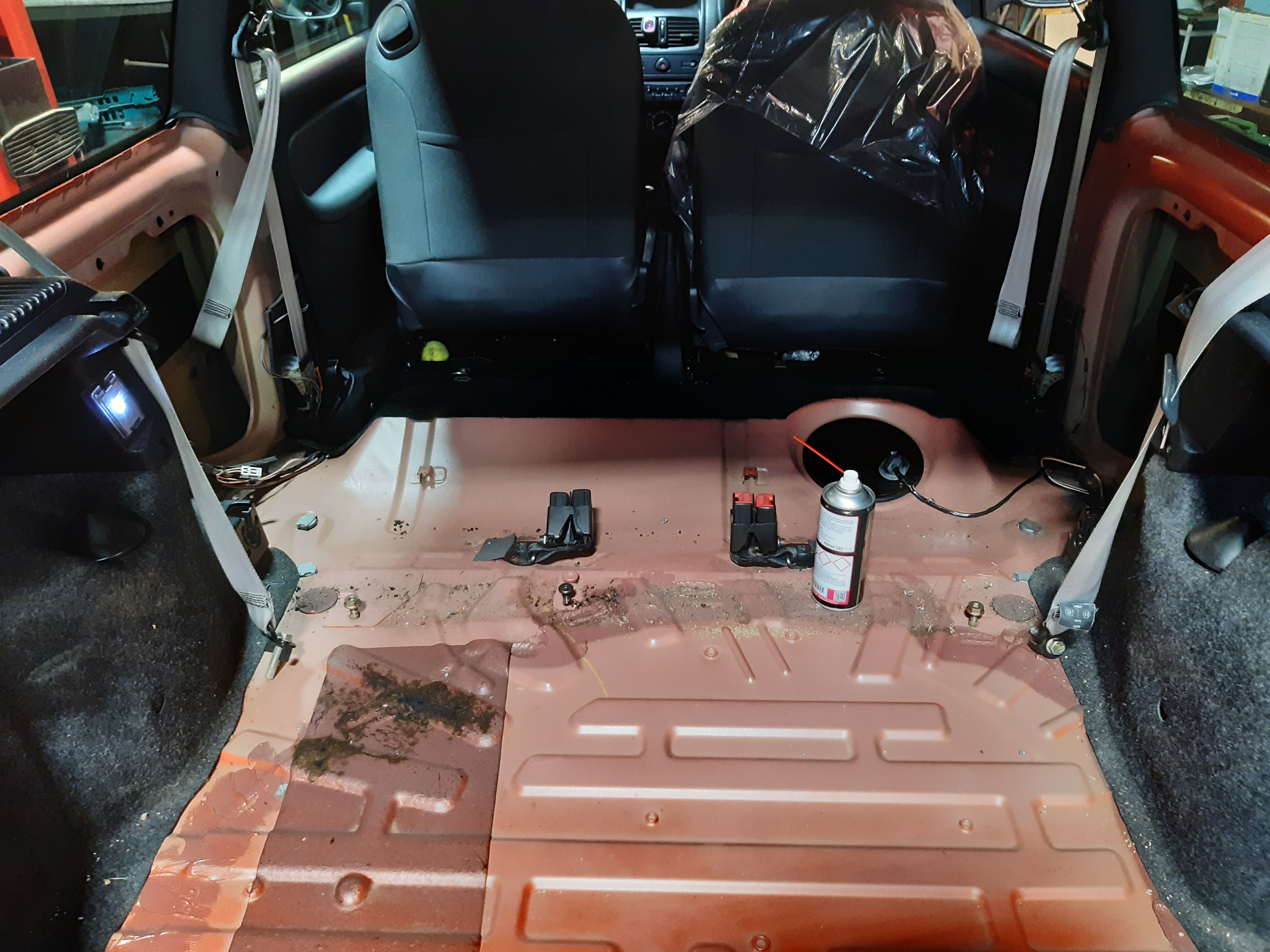

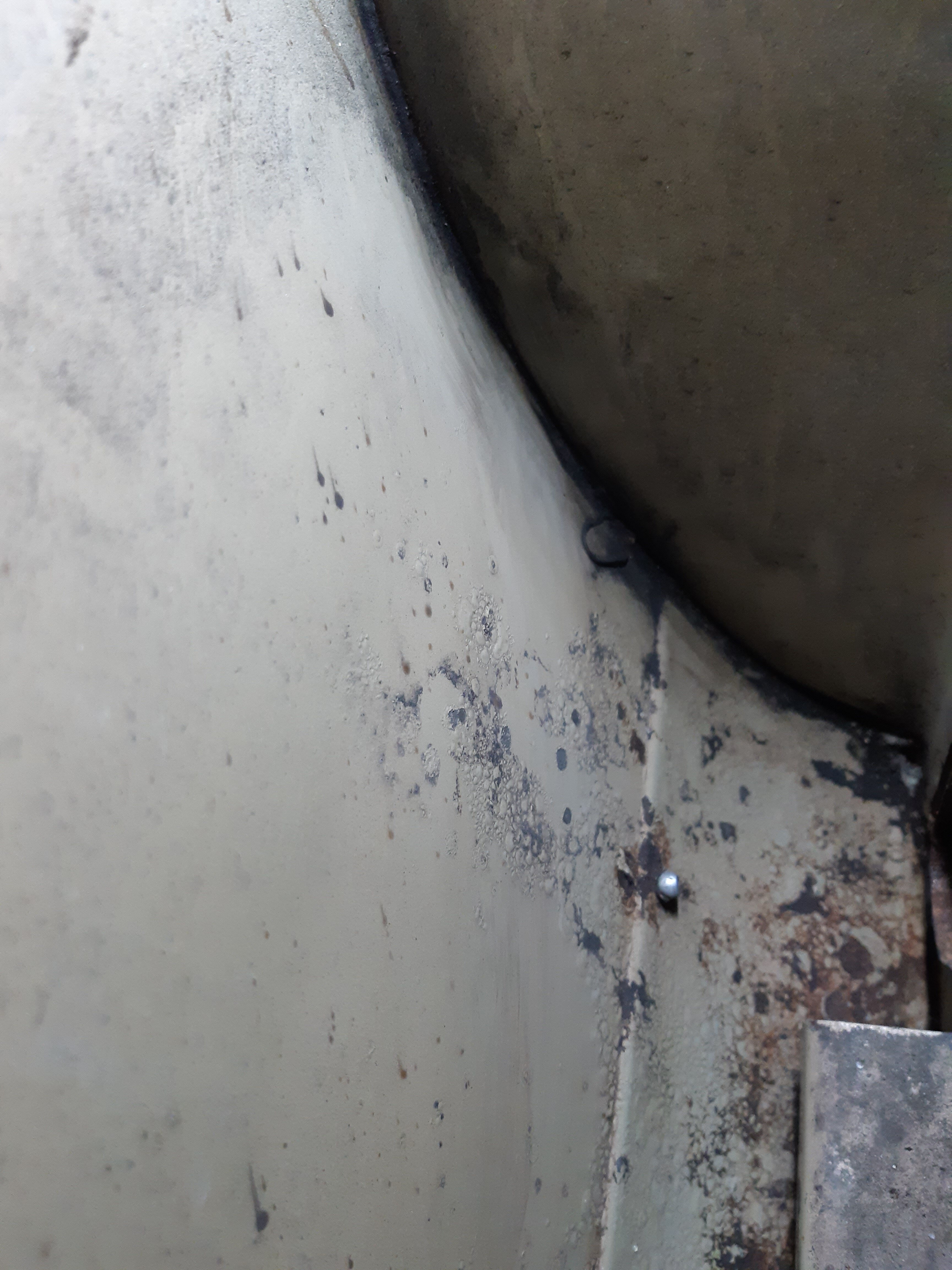

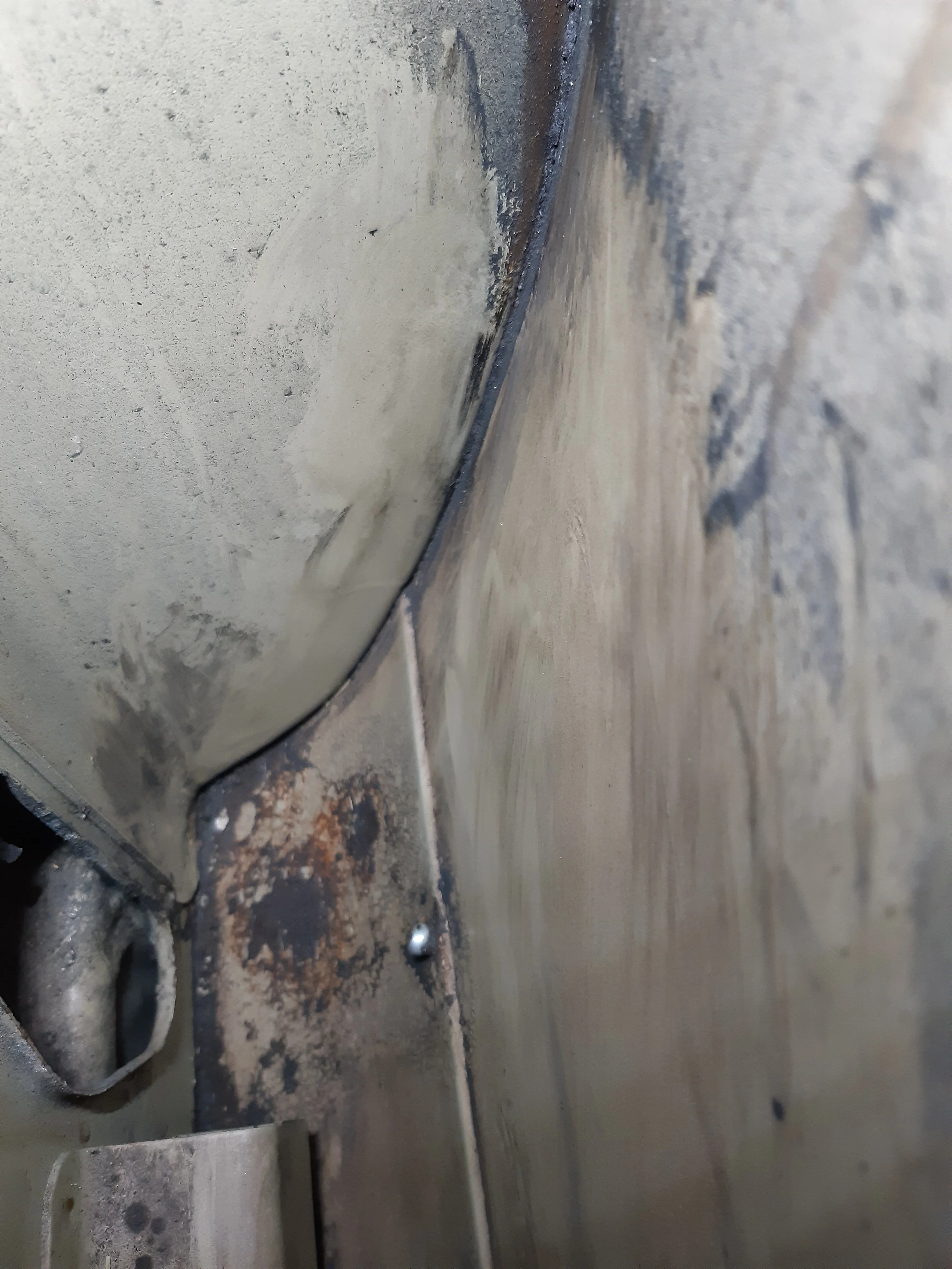

First job was , check the usual inner sills for corrosion. So stripped off the rear quarter panels to check these 🤞
Drivers inner sill
Passenger
I think there as good as I hoped they would be . Time for some rust converter and liberal amounts of waxoil , should help. Especially now that it will never be used in the winter again.

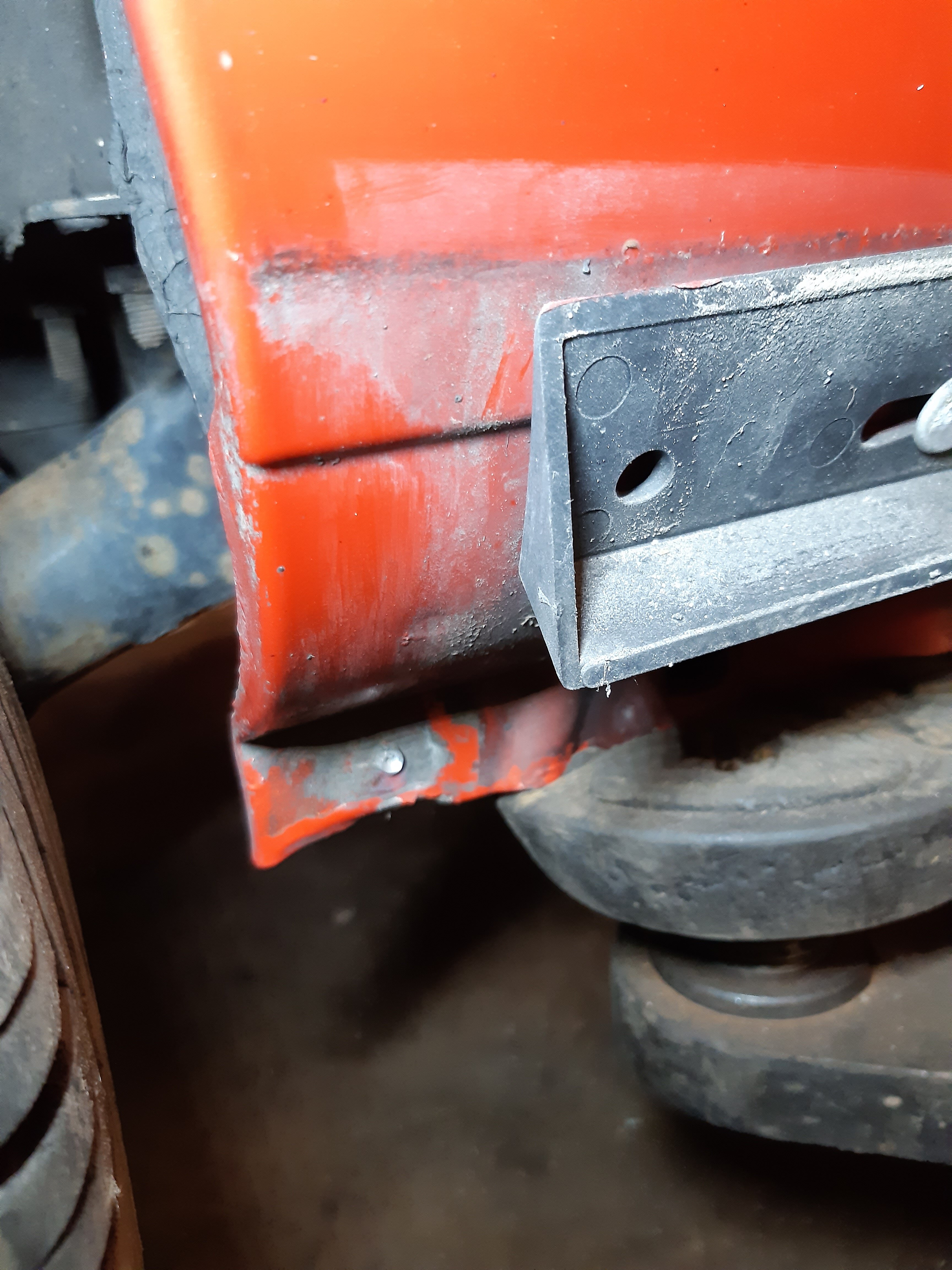

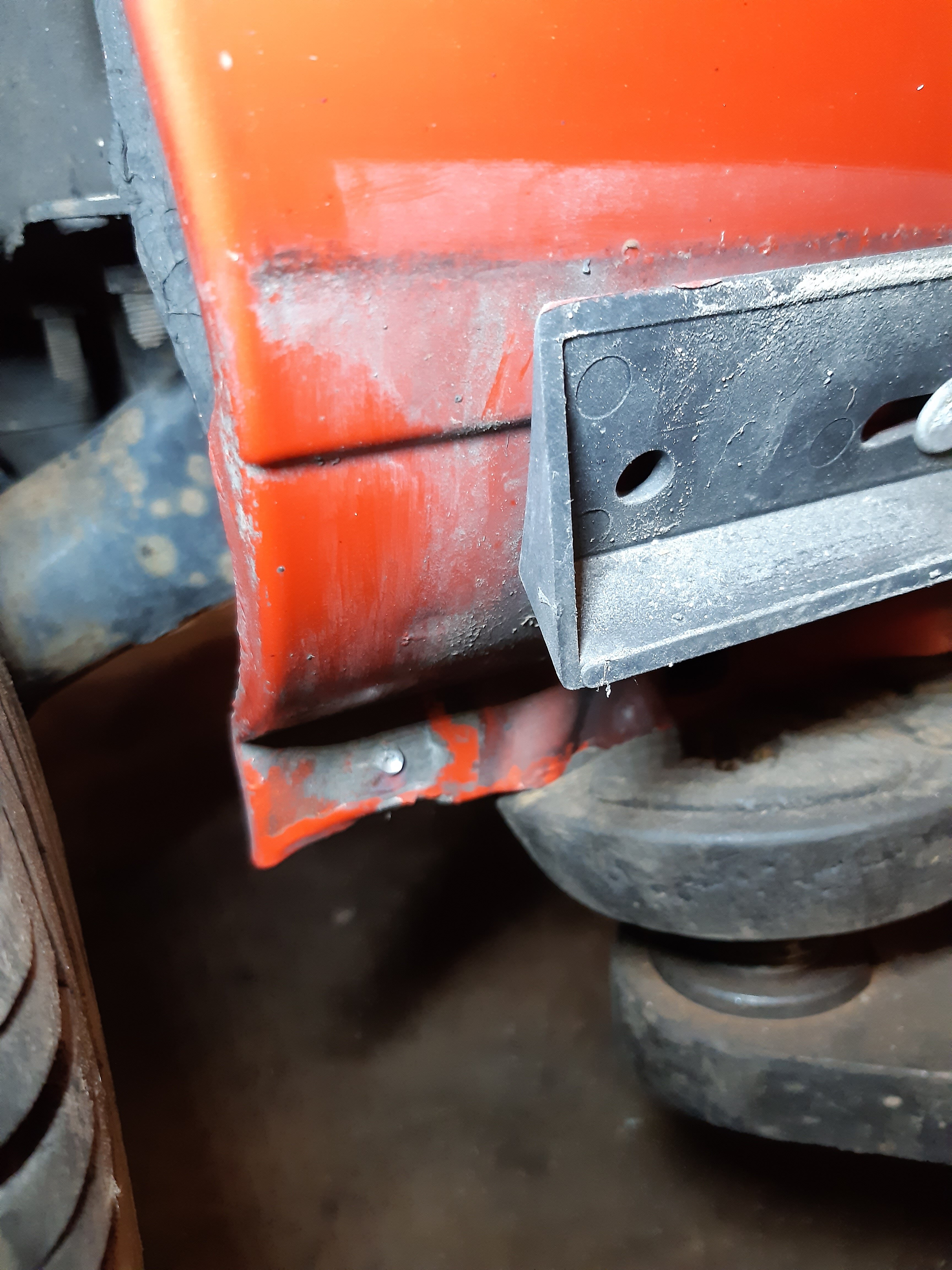

Also removed the drivers side skirt as someone has bent over the front jacking point slightly. Fortunately the rest of the jacking points are perfect. Looks as if it will square up ok and sill isn't damaged thankfully.
Only have a picture of the rear of the sill will get more of the jacking point. Just seems to be the double skinned part that's bent over.

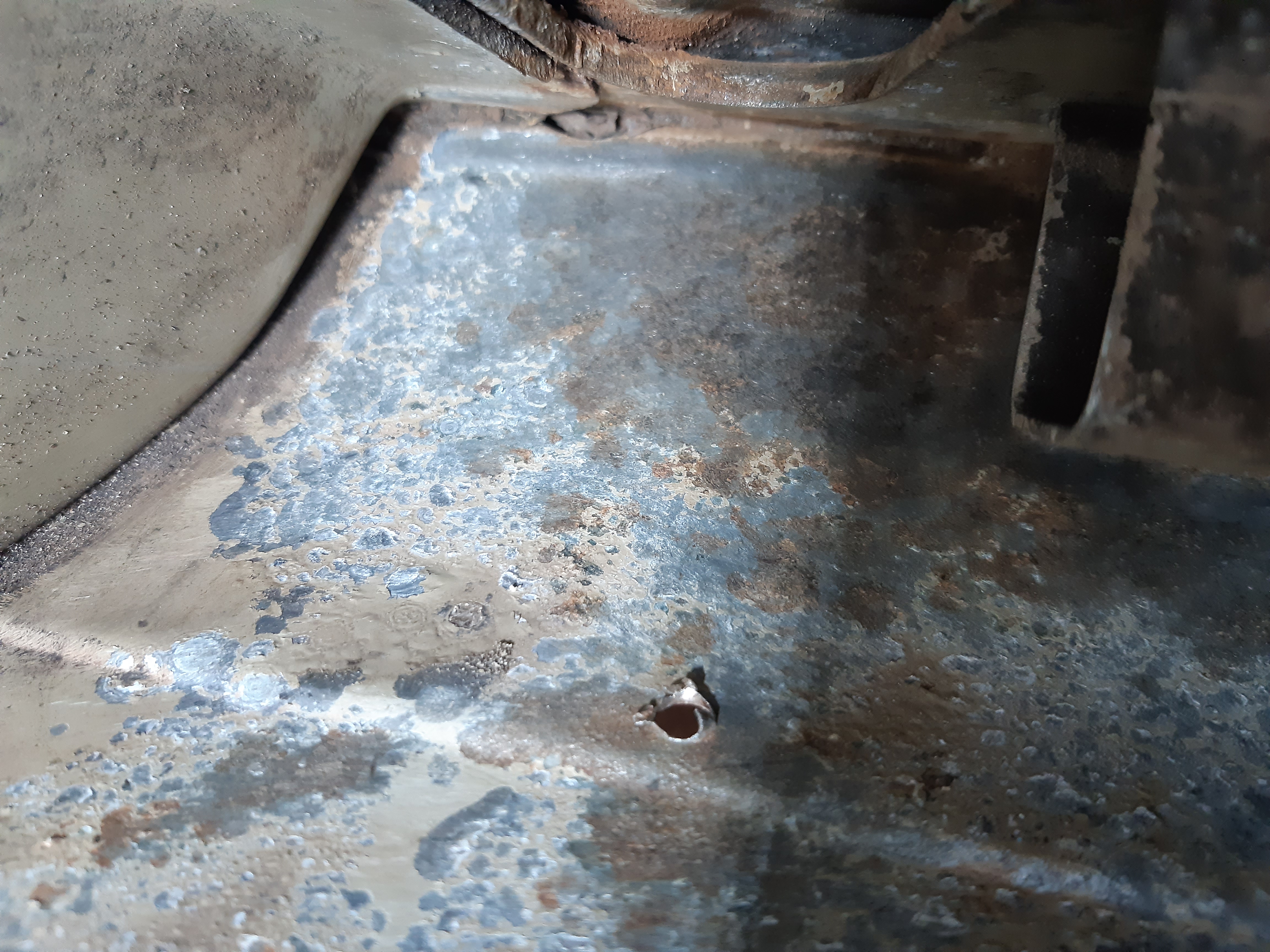

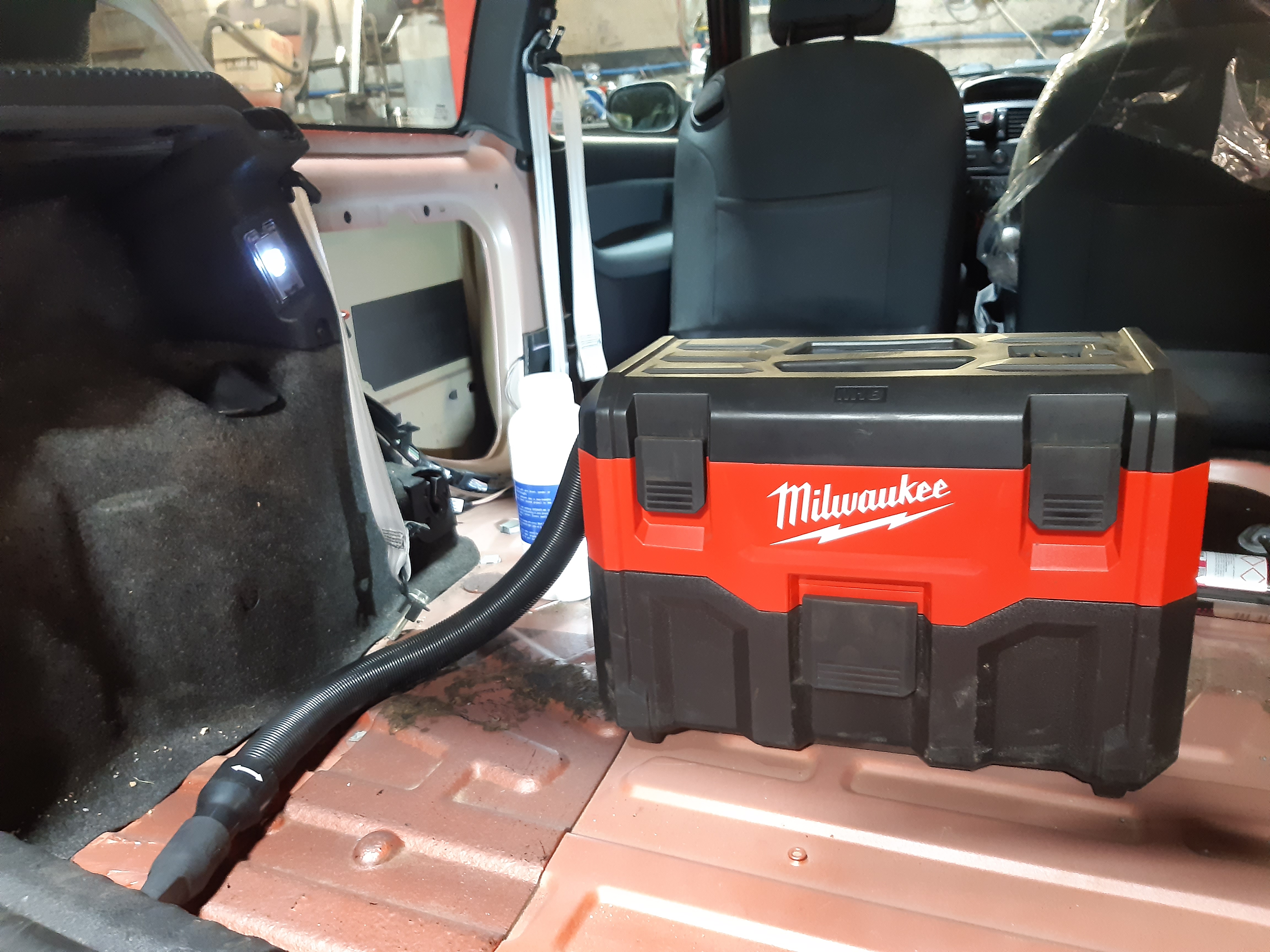

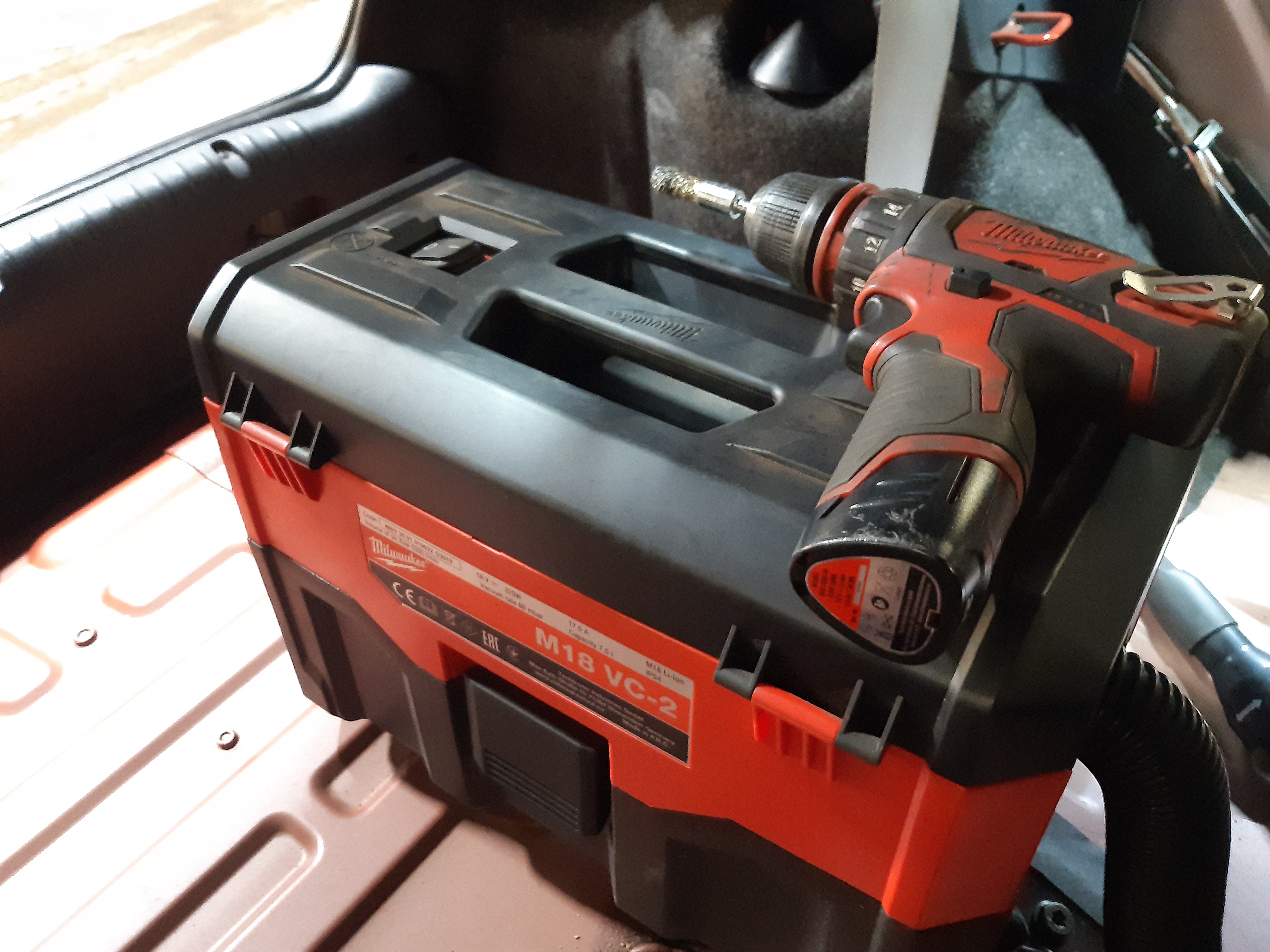

More progress today , used a Milwaukee m12 drill with a wire attachment. Found the drill was the perfect size for the job. Both sides cleaned up very well also used the Milwaukee m18 Hoover was ideal for cleaning up after 😎
Drivers side after cleaning
Passenger side after cleaning

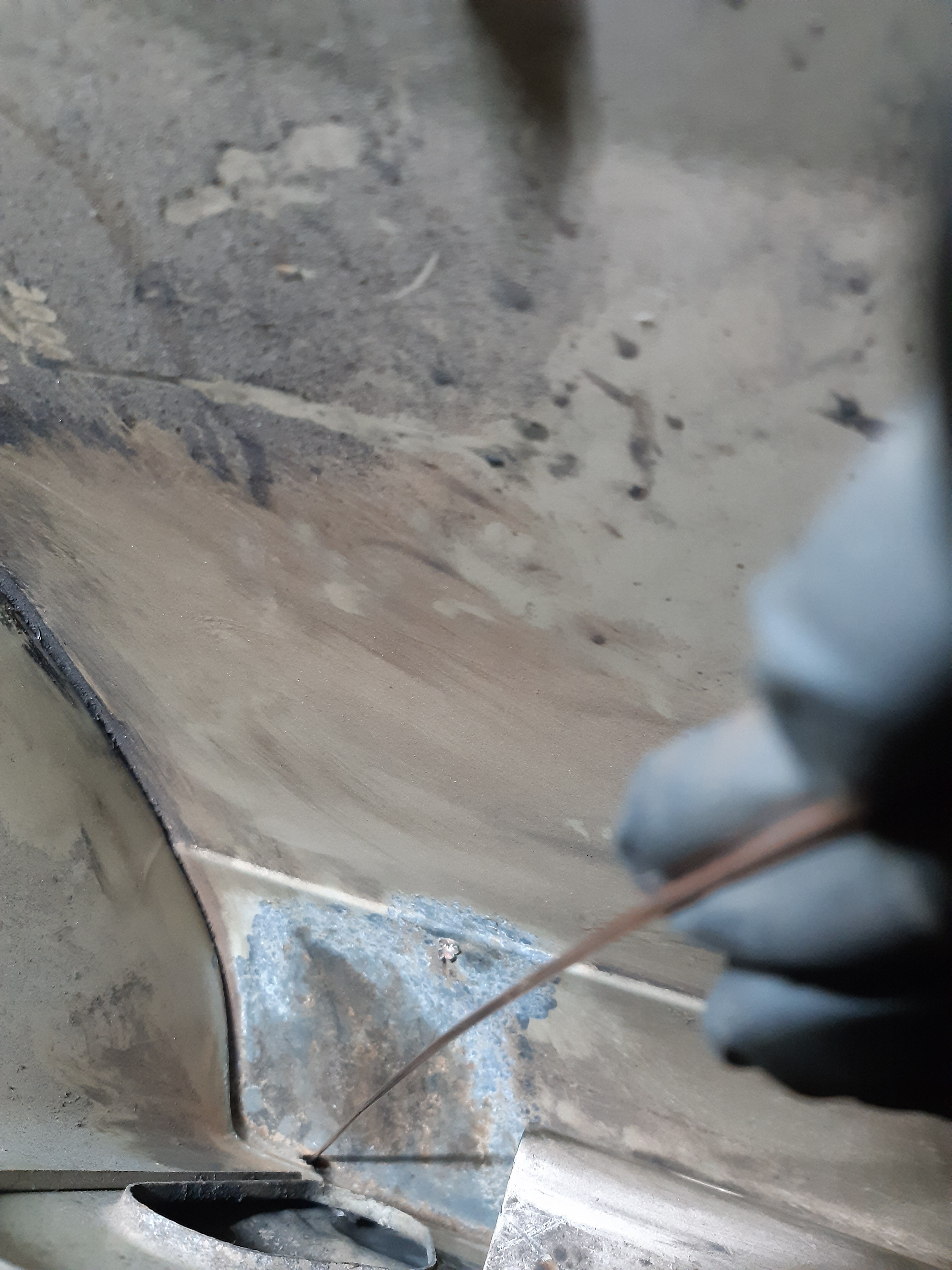

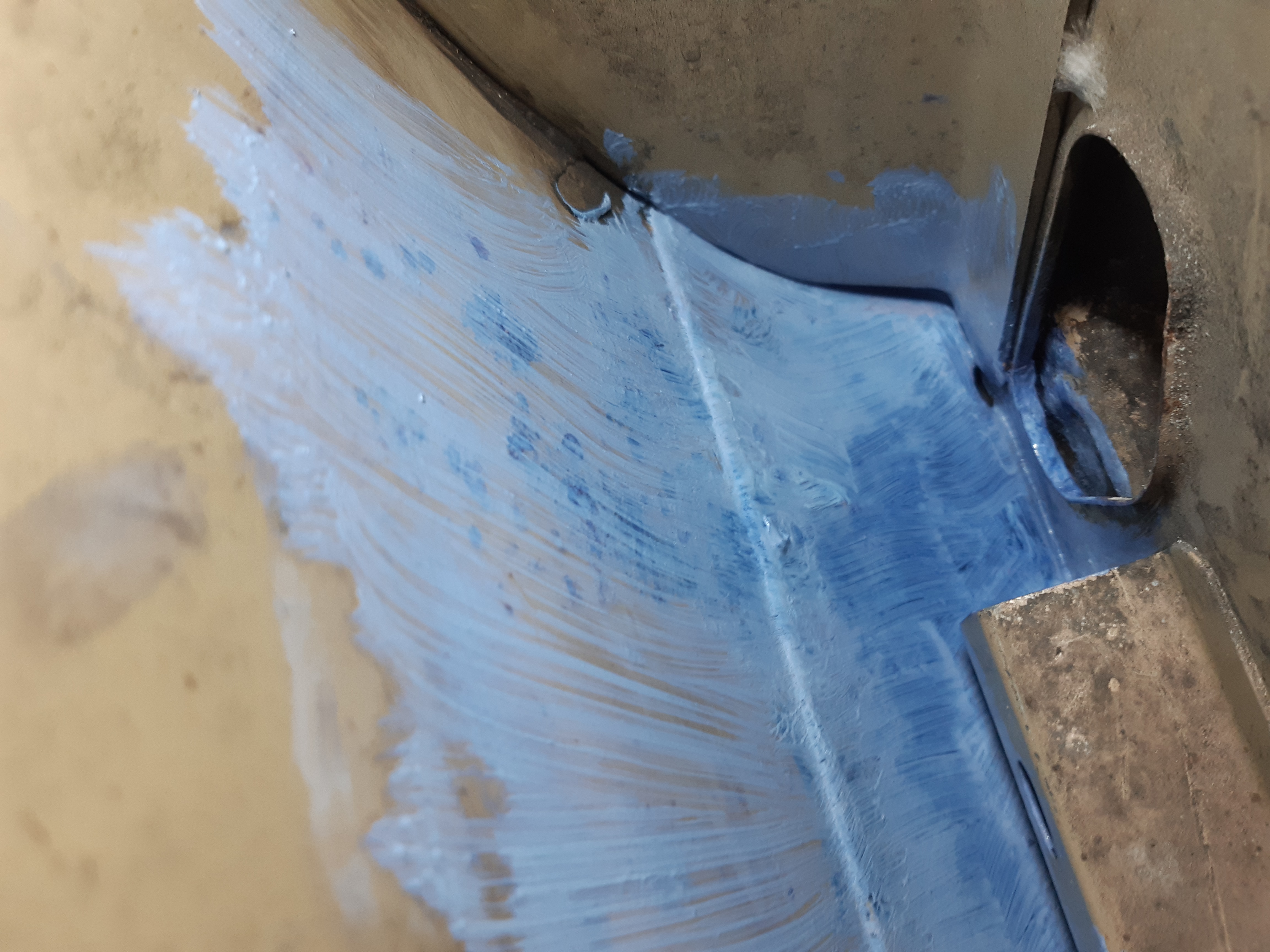

Decided I best clean out the drain holes as they were both blocked . A quick poke with welding wire and blow out with air nozzle 👌

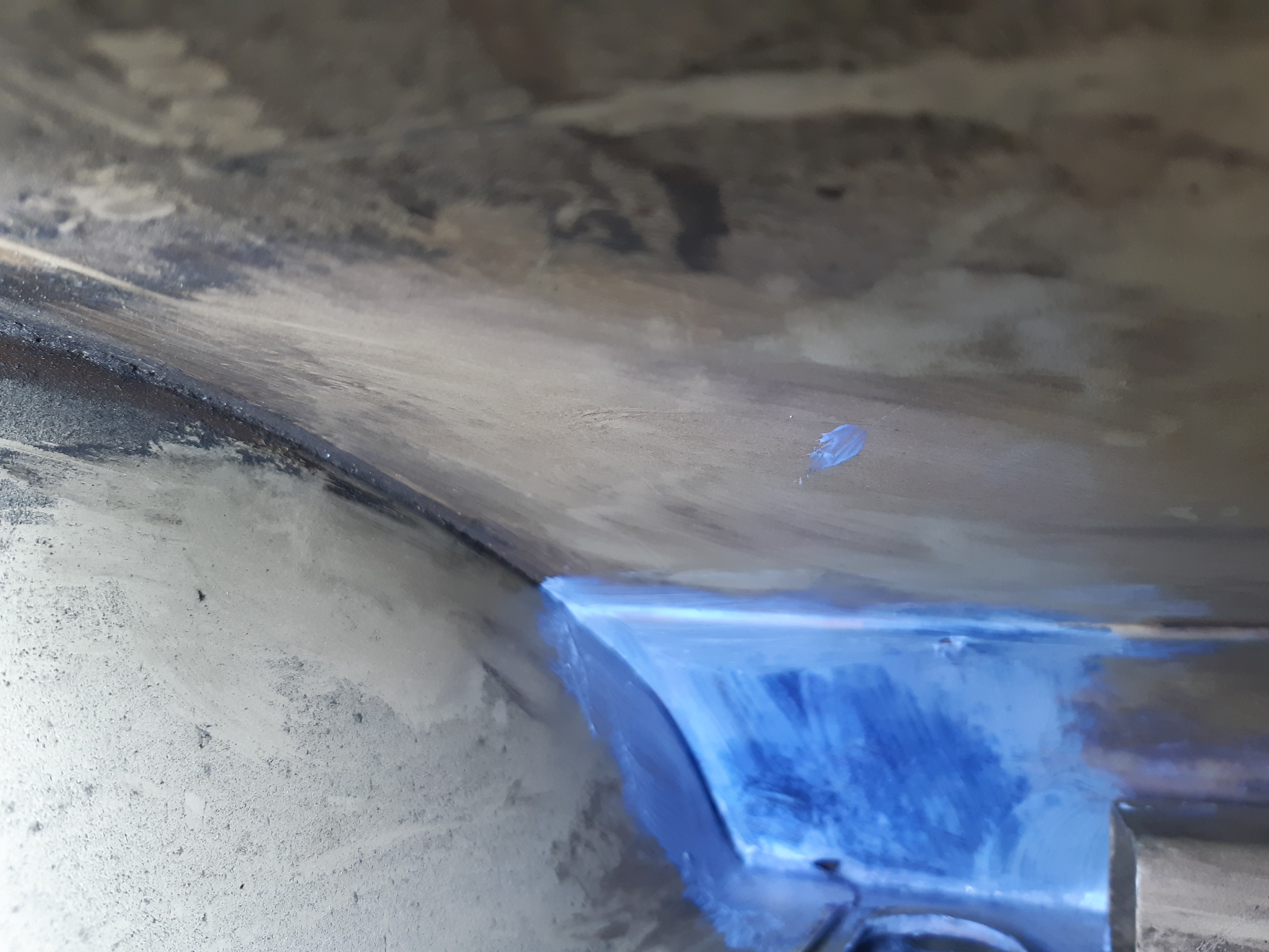

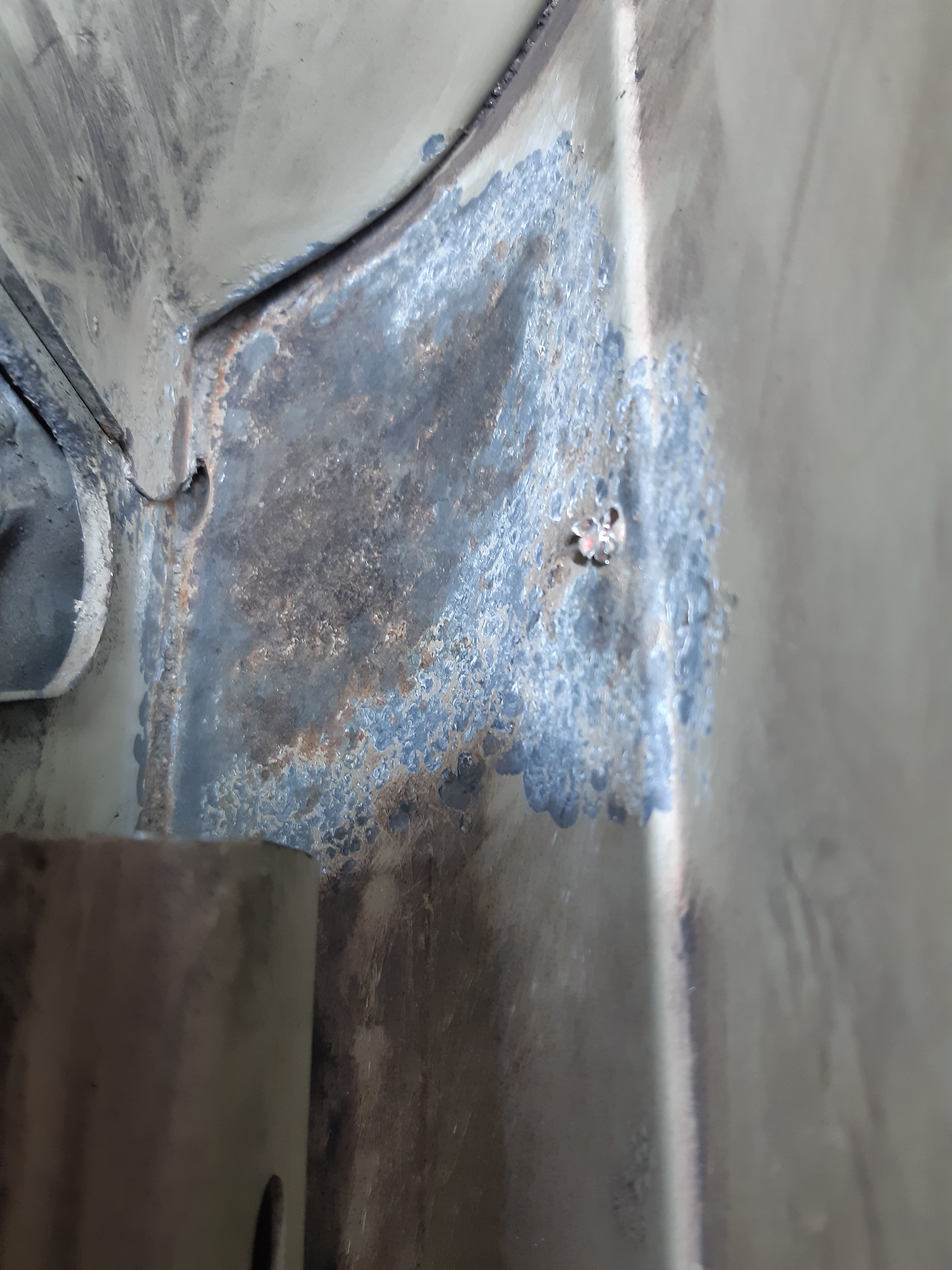

Finally finished off with 2 coats of Bilt Hydrate 80 rust converter , leaving it till tomorrow for waxoil / cavity wax .
Drilled off all the side skirt mounts to allow me to treat around the holes and allow me to spray in through them at the same time .
