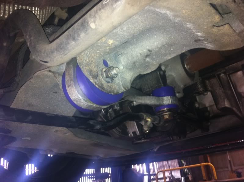

I then got on the net and ordered a set of uprated engine mounts, they looked like a good bit of kit and will stop all engine movement.
Old engine mount and cover
New uprated engine mount and black cover
Old dog leg mount
Old inserts pressed out,
New Powerflex inserts fitted
Mount refitted

hey mate, did you fit the new engine mounts yourself? If so, how easy / difficult was the job? I think mine need doing..
yeah i fitted the engine mounts, the top drivers side mount is easy, just support the engine from underneath, the dog leg mount comes of easy, have to give the old mounts alittle belt to get them out, but they will come out. The gearbox mount isnt really hard, take battery out, then you can see the original reno mount, undo those, then swap mounts over, i supported the gearbox but had to drop the support slighty when trying to get the new mount in, did that and it went ok.
They really firm up the engine and remove any movement, some funky vibrations through the steering wheel and gearstick,

Really great looking car! What engine mounts are the ones you put on? And are the vibrations gone once you covered a few miles with them?
Cheers buddy,
The mounts are ktec/vibra technics mounts, ive still got vibrations of them, but kinda knew i would due to the being uprated stiff mounts. I wouldnt say the vibrations are mega bad or anything, just give a nice solid feeling.
