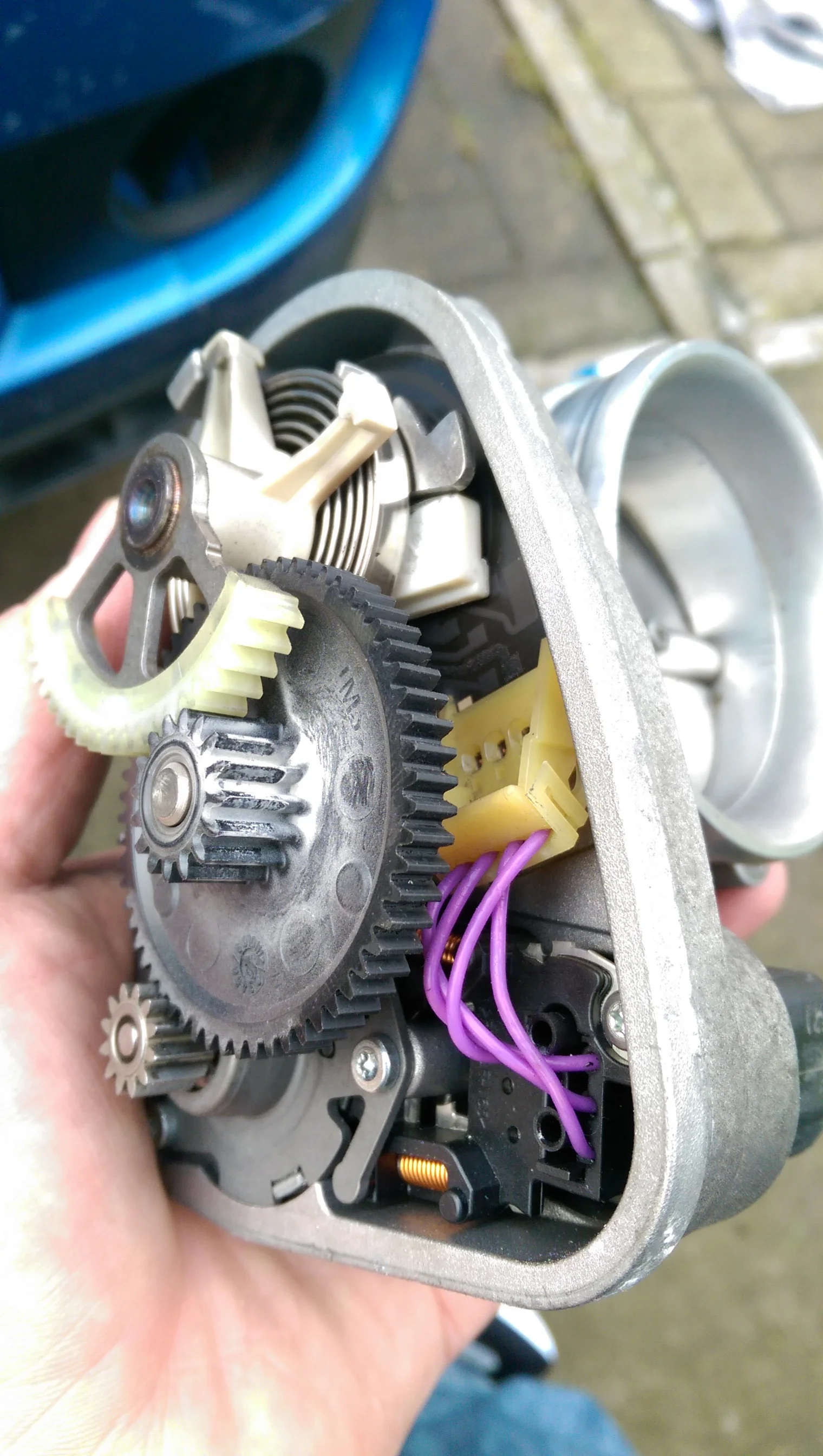

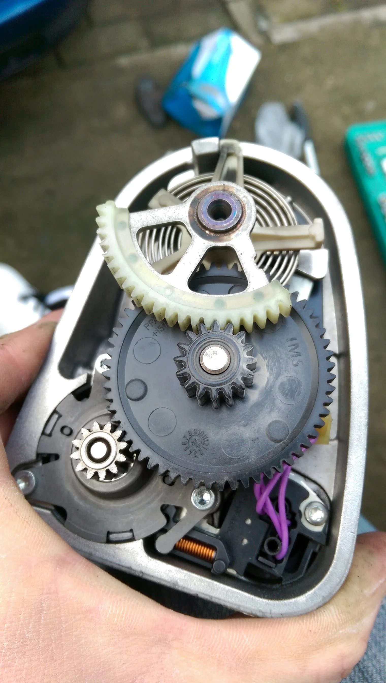

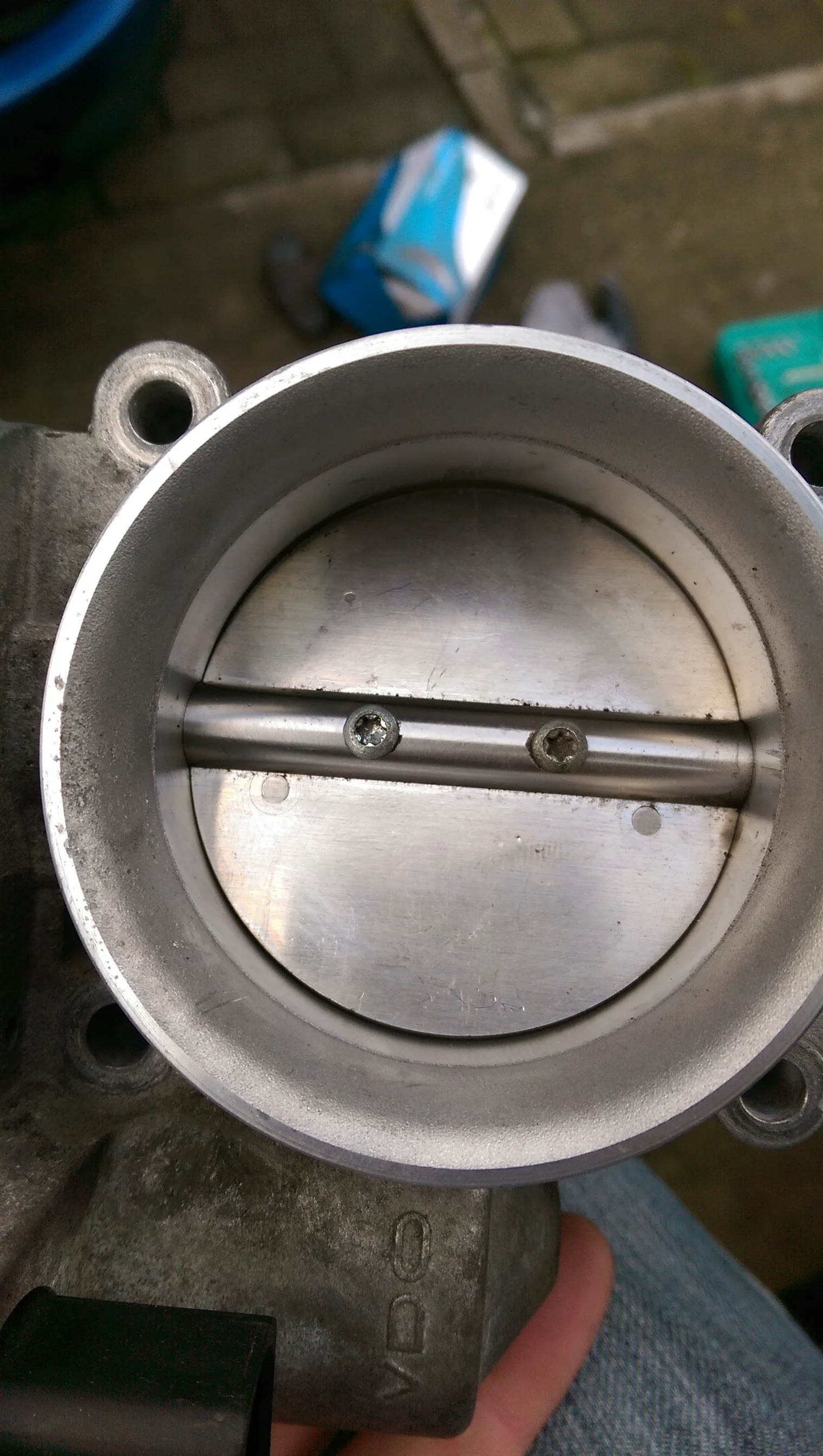

inside electronic throttle body of a Clio 172 cup 53
If any one interested or this may help some one with what a problem could be
Due to not being able to find any images of one of these opened up. Thought I would post these hoping they might help some one in one way or another.
