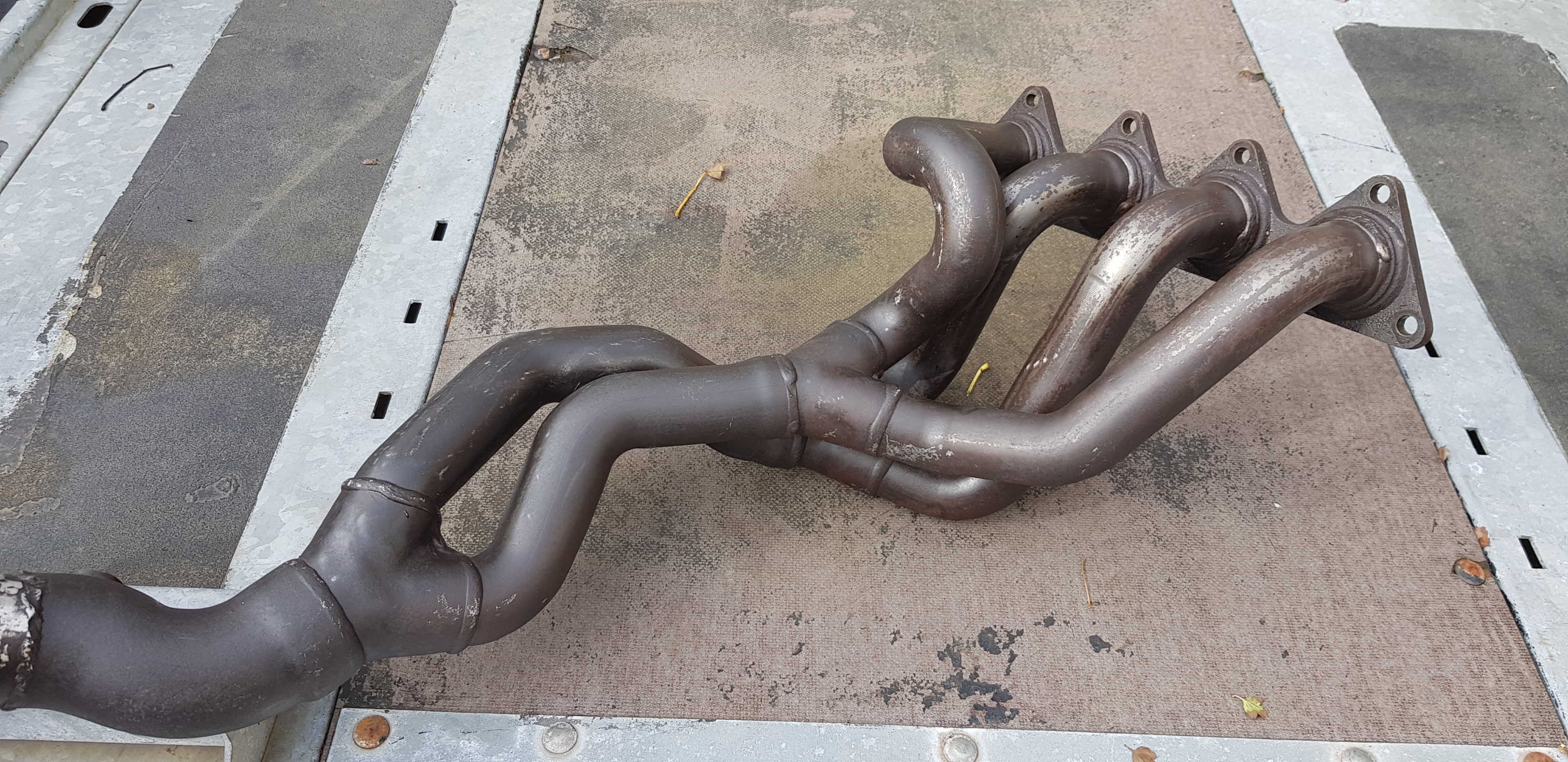

Is this an original 182 exhaust manifold?
As per title, I've seen pictures of this 4 to 2 to 1, and a different 4 to 1 manifold both advertised as '182 manifolds'
Can someone clarify please
It's stainless and obviously tubular rather than cast, so 3 more questions!
Is it worth replacing with anything less that a complete different design, such as PMS. Things like Gravity look pretty much the same thing.

The single pic you have posted above is a standard 4-2-1 exhaust mani from a 182, this will give you better mid-range in comparison to a 4-1 exhaust. 4-1 exhaust mani will give you slightly better top end, although I'm sure that can be debated.
Martin_172
As above generally a 4-1 for top end power and 4-2-1 for mid range. I swapped my 172 to a 182 manifold and also fitted a decat link pipe so not totally like for like comparison, but I gained mid range torque which felt much nicer on the road but also gained peak power and peak torque and it shifted them a few hundred rpm lower into the rev range
