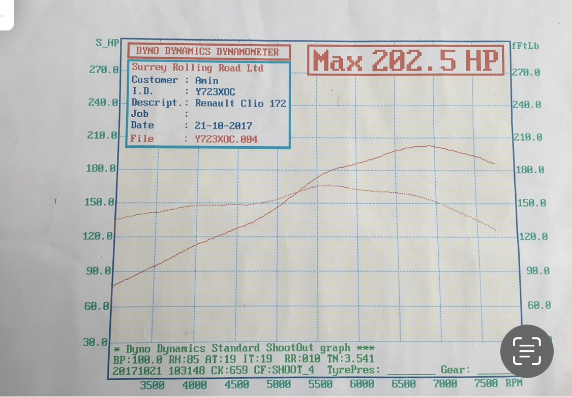

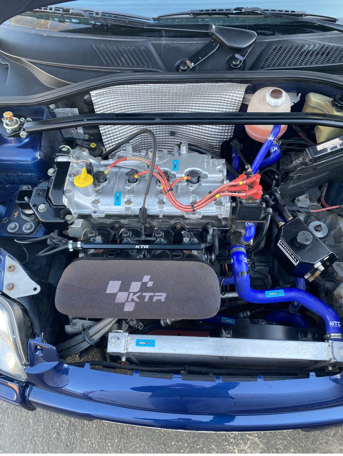

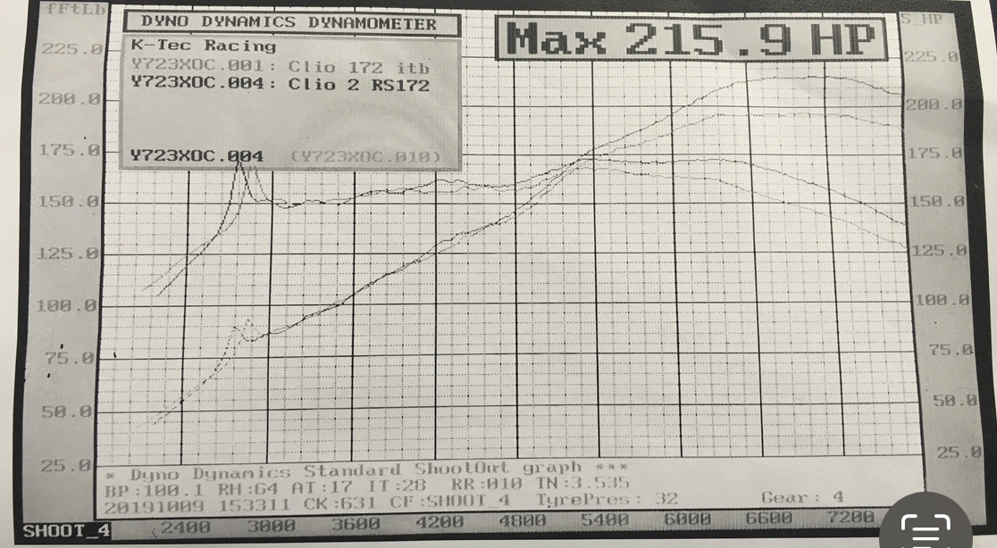

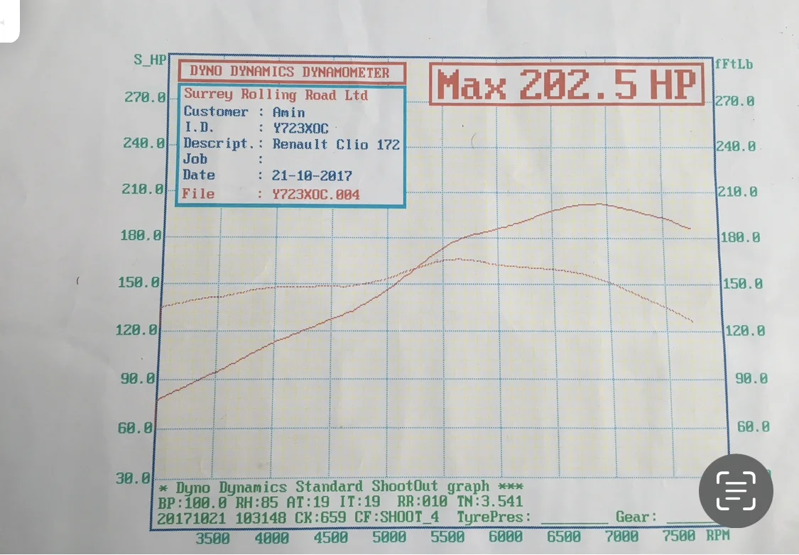

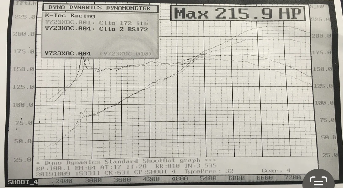

About 10 or so years ago I had ktec DTH ITB’s /gen 90 fitted with a bottom end refresh and went from 169 bhp to 202 bhp 172ftlb of toque. Engine was bulletproof!
Then a couple of years ago I had some Schrick cams fitted while having cam belt done and agained around 15 bhp. Has made the engine even more eager.
The ITB’s and engine has been absolutely faultless apart from an injector.
