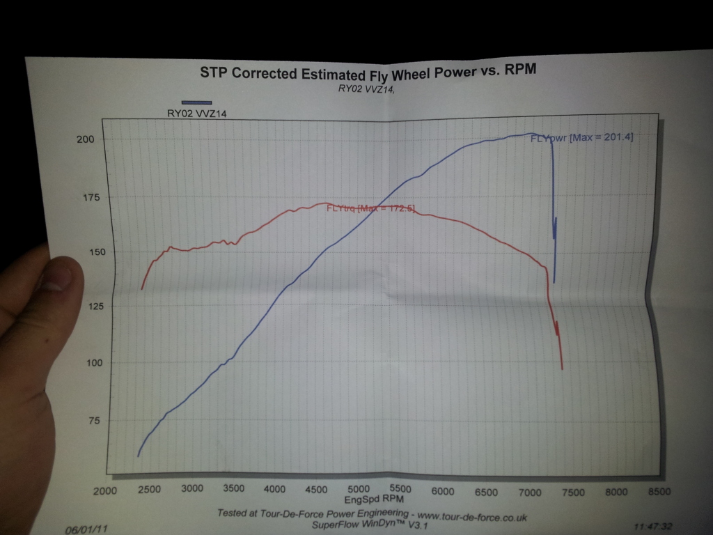

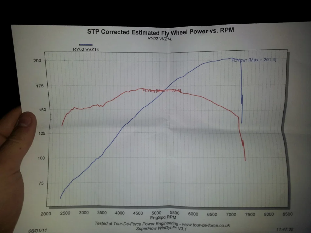

just gaging what ppl are getting torque wise on itb's and with what added extras?
mines running 172.8 ft/lb of torque
itb's
quaife diff
omex 600

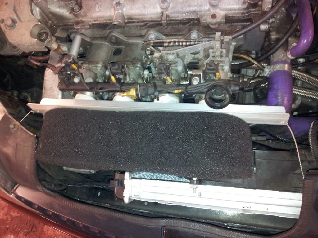

k-tec filter and a bodged bracket to hold it forward off the trumpets..
intrested to see other resuls! my figures are from matts rollers at TDF

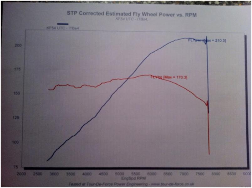

I can claim 185 on Matt's rollers.
That's with 422's, pistons (not sure of comp ratio though) 182 manifold, decat and headwork by Stevie Wonder.
It's running 428 cams and a 2.5" Piper exhaust with decat. It has an EC1 ECU fitted at TDF along with the ITBs.

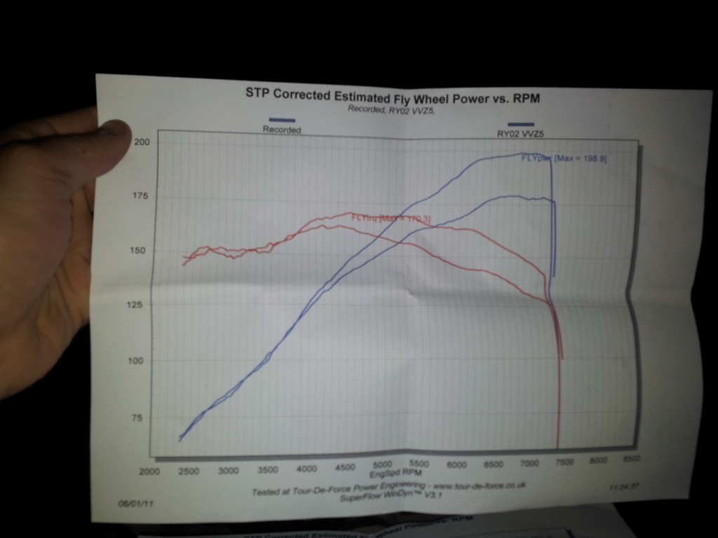

well just to give an idea of what went on
bottom one was after sam couldnt get why the power wouldnt go over 180 bhp! filter was sucking onto the trumpets
soooo this happend
i know it dont look nice having that bit of ally.. but i dont care! lol
