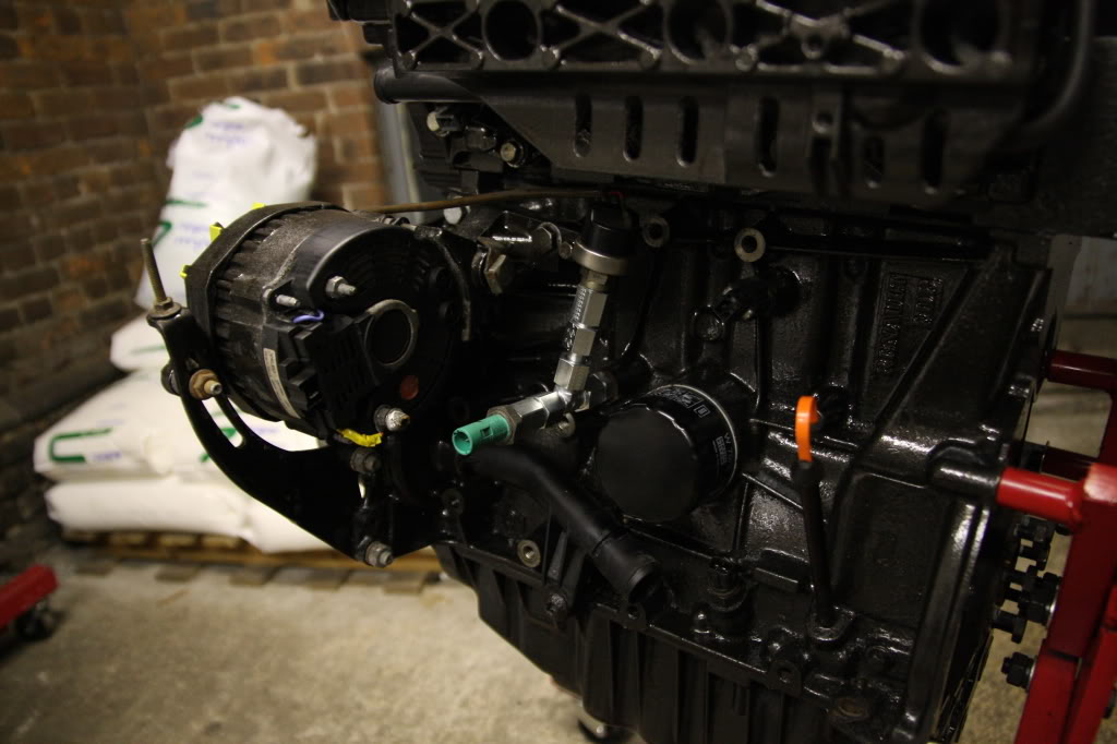

I run a T-Piece out of that hole on the front of the block, one output has the original oil pressure switch (as seen in your picture) and the other output I have fitted an oil pressure sender, which can drive a gauge inside the car to show you operating pressure :)
Thanks. Do you by any chance know the size of the threads in the block?

Pretty sure they were M14, I can check if you need confirmation though
Concerning the pressure sensor I dont know how to solve it. A hydralic pipe for the power steering goes right in front of the sensor on my car. So moving it out from the block is just not an option.
So at the moment it looks like it will have to wait. Have some plans of moving the battery. With that room free im thinking about a remote oilfilter adapter and putting the filter in the current location of the battery. Then it will be easy to fit extra sensors.
