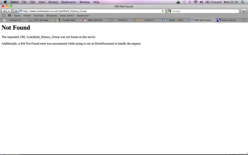

I've just done a simple site for history group and wanted to test it by publishing it to one of my domains. I've got hosting through JustHost and i've entered everything correct. When i visit the URL it comes up with error 404 like below.
I've not done any of this for a while so i've forgotten everything. Presuming its just a simple problem?
you're missing the extension in the URL, e.g. .html

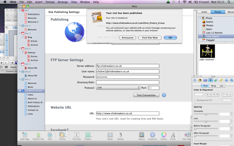

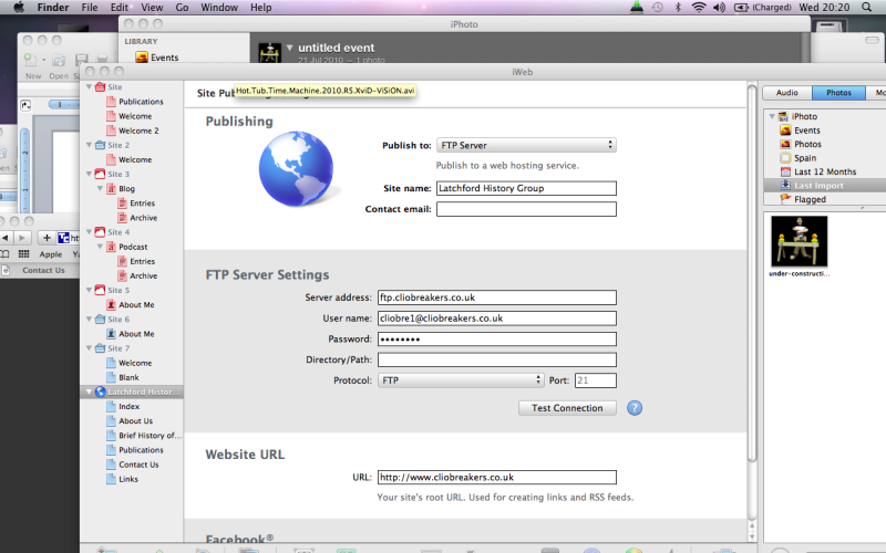

It is possible that you have stored it in the 'root' of your FTP one directory up from public_html / www folder, so it is not actually accessible.
The Directory / Path option when you're uploading the site may need to be filled in. Connect with a normal FTP client and find the correct path to your hostings public directory (usually public_html or www)
Edit: In most cases the Directory / Path is simply /public_html

If you log into your justhost account and go to file manager, you will see the public html directory (if www folder is there ignore it because cpanel set it as a link only) then put that in your path folder, and make sure the suffix is .html .htm or .php :)

You need to move the contents of the historylatchford1 folder to the folder above it within the directory tree
It probably goes something a bit like this:
- home directory (root)
- public_html directory​
- historylatchford1 directory
This is just an example, it will differ between hosts.
You need to move it to the parent folder of the historylatchford1 folder.

Ive put the historylatchford1 folder in public_html/latchfordhistorygroup.co.uk so i need to move it out into public_html?
No, it needs to go into the 'latchfordhistorygroup.co.uk' folder, so basically move all the contents of the historylatchford1 folder into the 'latchfordhistorygroup.co.uk' folder.
Have done mate, didnt relise it was full.
Still can't do it, ive put the folder in public_html aswell as public_html/latchfordhistorygroup.co.uk and no luck any of you able to sign into my account?
