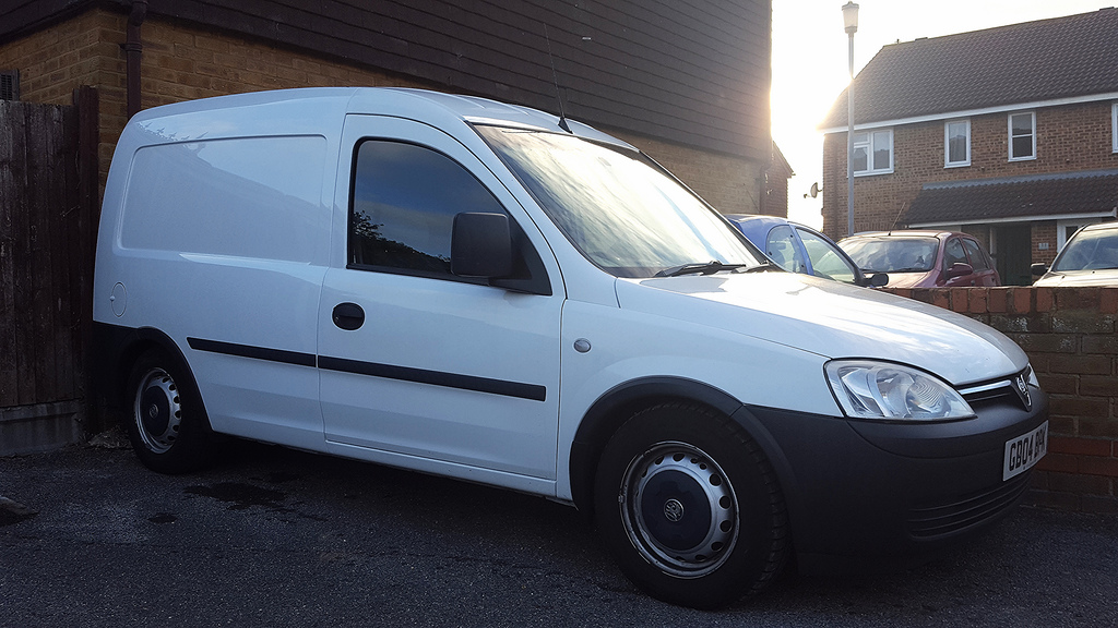

So after 7 years of owning my Combo 1.7 dti (with a whopping 75hp, it has an intercooler don't you know) i thought give it a bit of loving...😂
Id like a newer van, a VW Caddy maxi would be nice but i just don't have the funds or can i really justify it. I use the van as my daily and if it wasn't for the fact that ive been using it to go to customers houses to valet there cars then i would have sold it and bought a old Volvo estate the same as @leeds_182 has, tbh its Jim's fault that ive started messing with the Combo.
As i said i don't have alot of funds so i wanted to do bits that didn't cost alot of money, one of the first things was a good machine polish as the old paint was proper flat. Ive made a start by polishing the rear doors and the drivers side 1/4 panel.

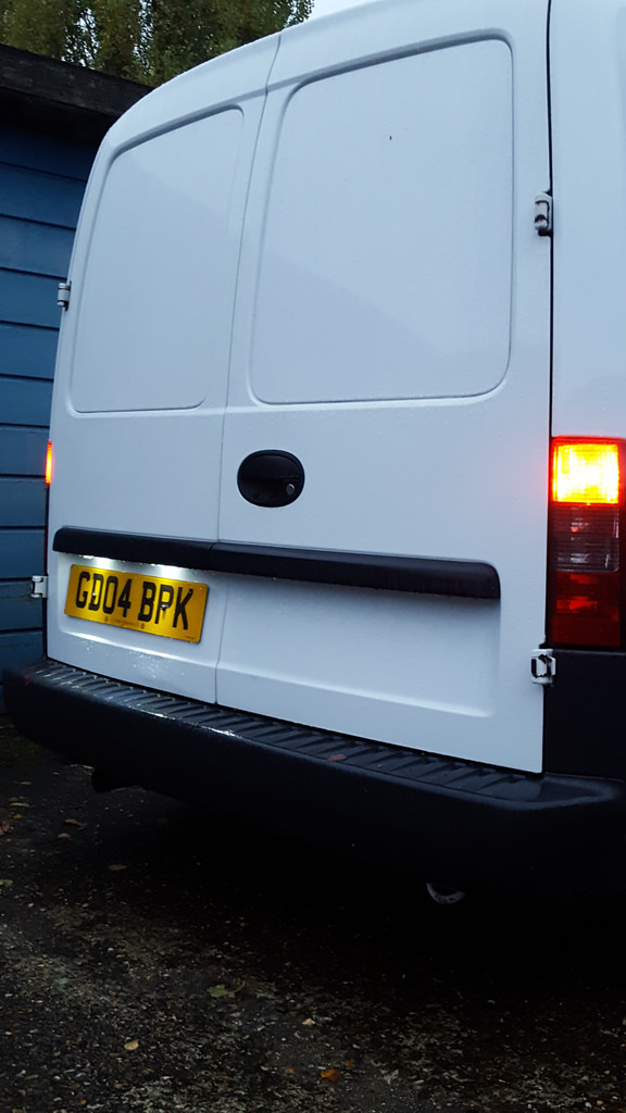

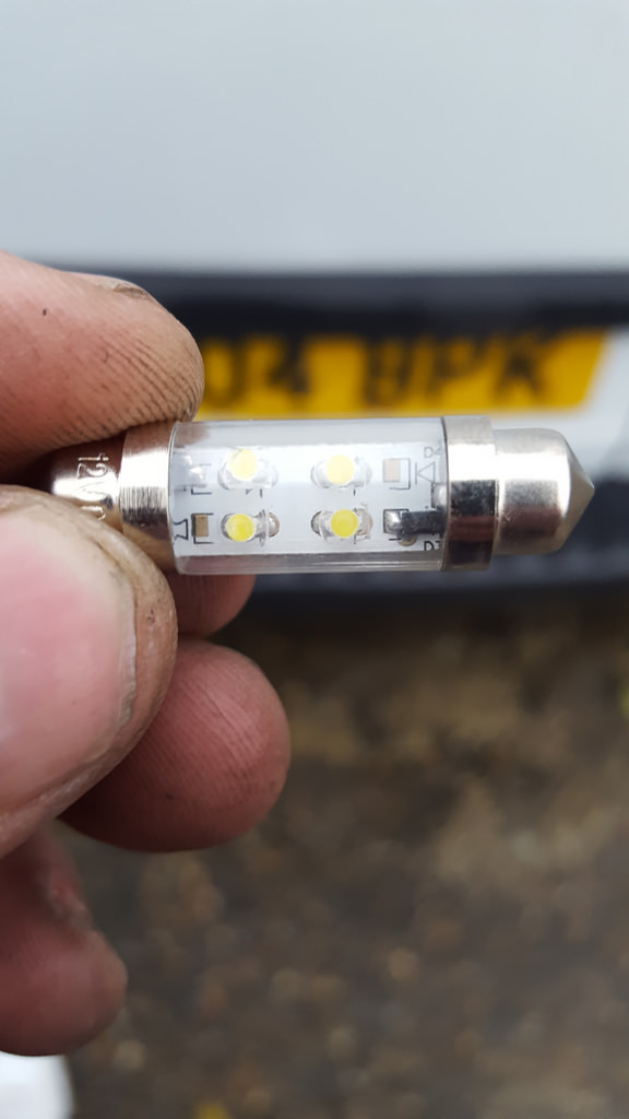

I removed the rear badges as well to try and give it a cleaner look (if that's possible with a stupid looking box van)

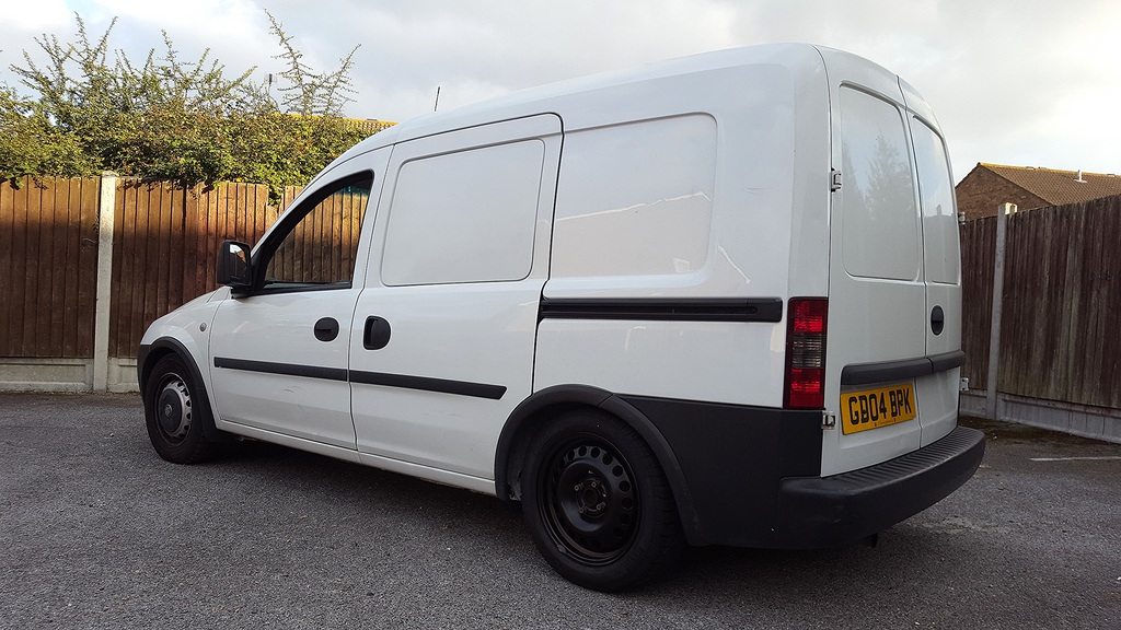

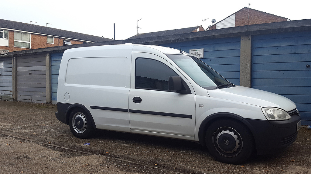

The old bus.
20160926_173219 by Scott Raven, on Flickr
Rear door's polished.
20160922_173204 by Scott Raven, on Flickr
Still loads more polishing to do and ill just do it a panel at a time. I did a silly thing and started looking at lowered vans on Google and came across this. :hearteyes:😂

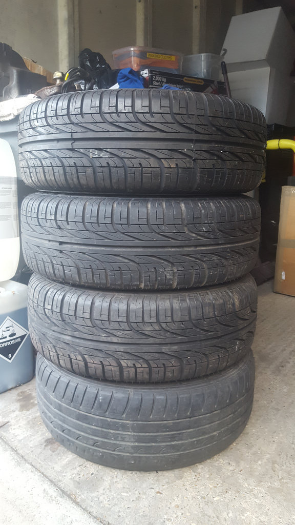

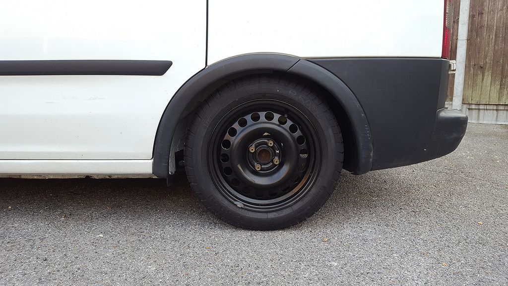

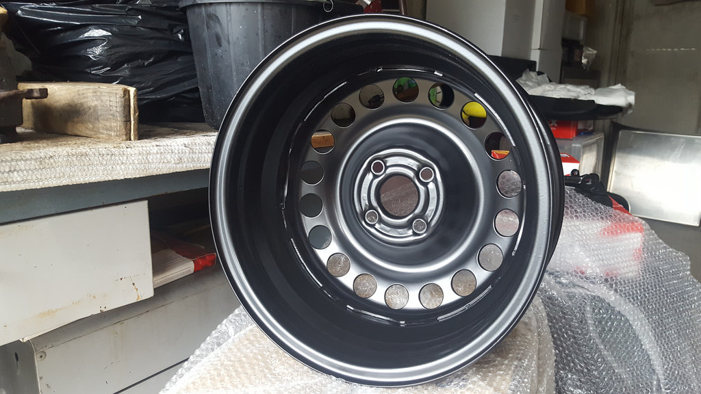

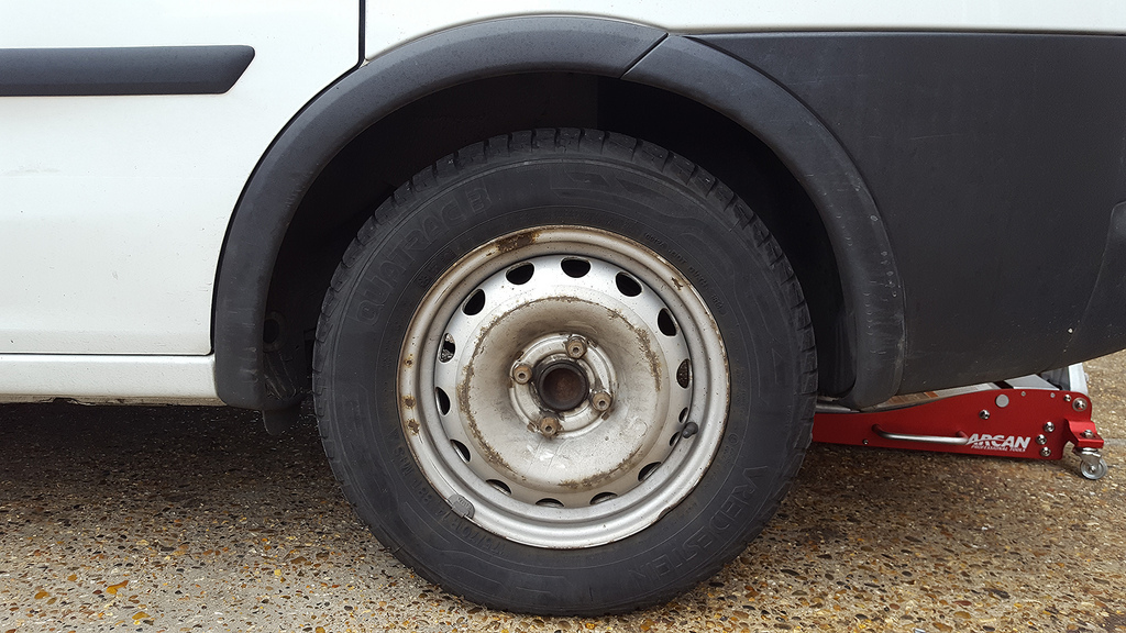

After seeing that picture i was now on the hut for a set of wheels, my van is running a 175/70/14 so i wanted to go to a 15" steel.

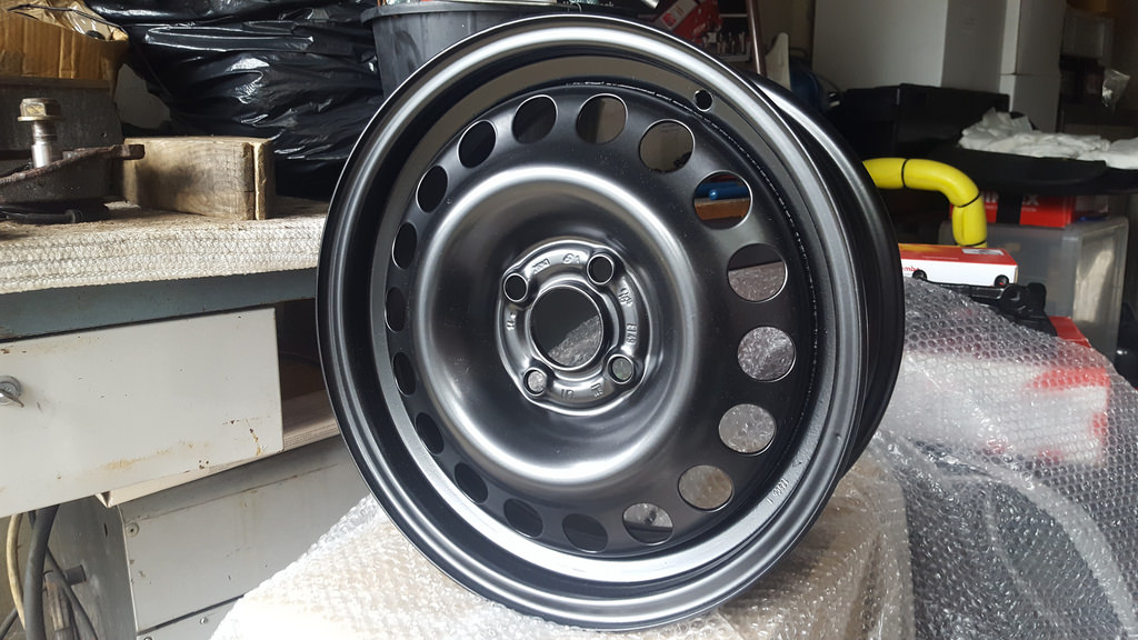

I found the Corsa SXI used a 185/55/15 and i started finding the odd new steel wheel on Ebay with new Pirelli P6000 tyre, maybe not the best tyres but its only for my van and they are new.
I have 4 now + a spare wheel.
20160930_165735 by Scott Raven, on Flickr
20160930_165724 by Scott Raven, on Flickr

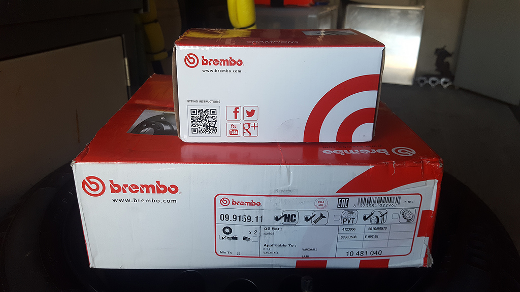

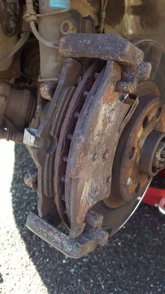

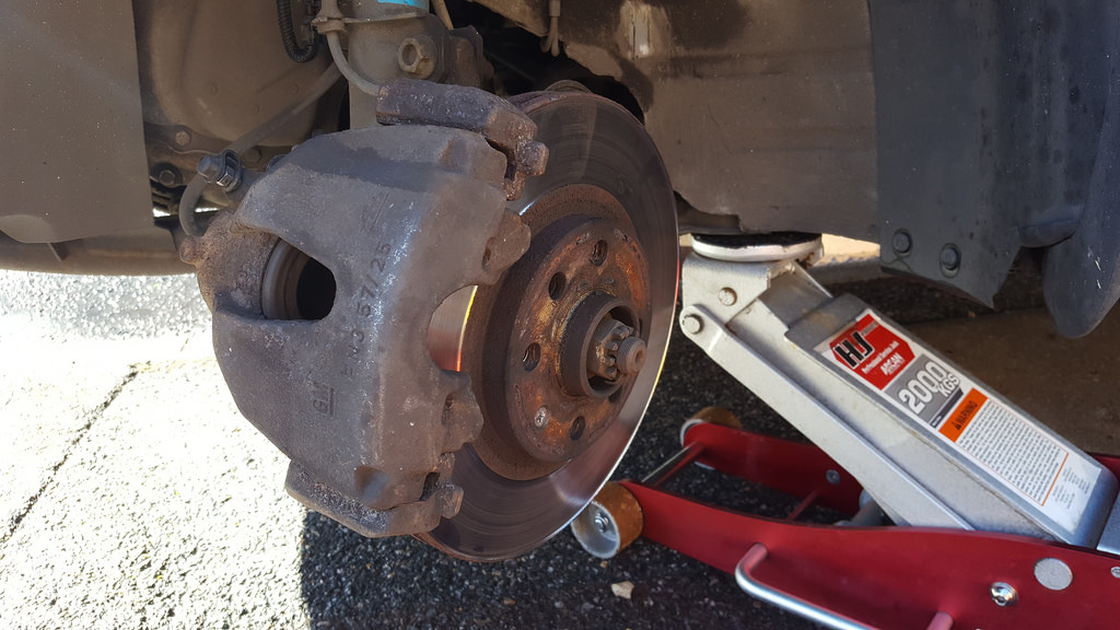

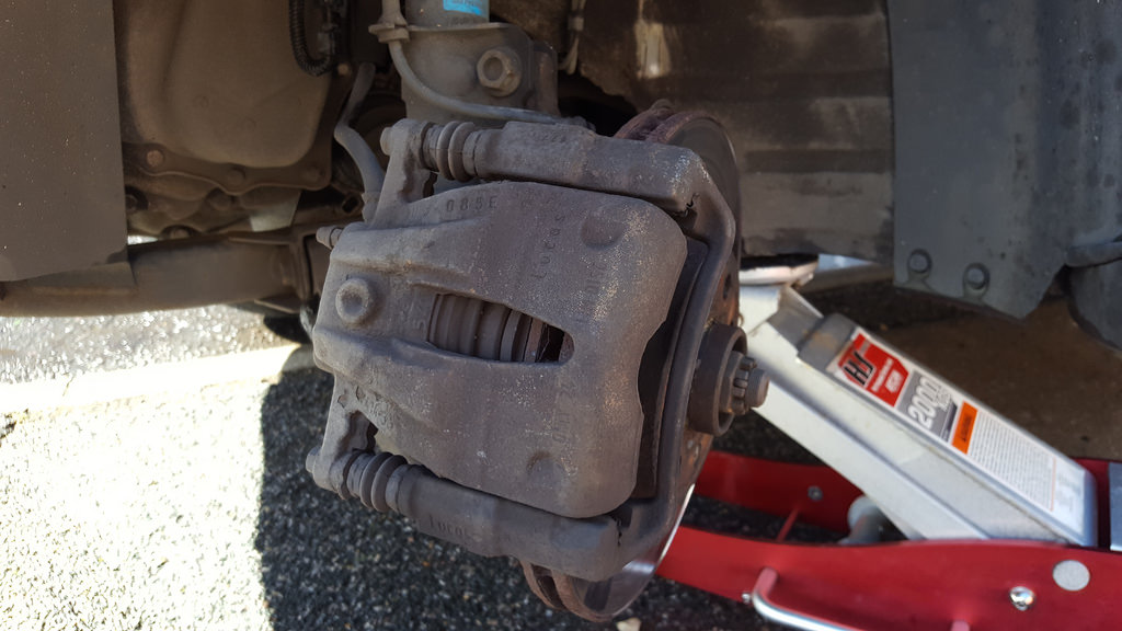

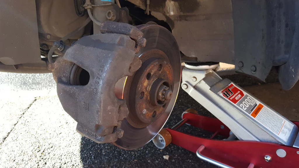

The van is up for a big service, service parts + ball joints + front brakes so i thought i would buy a pair of bigger calipers as i need to replace the discs and pads. The calipers came from a Meriva which ive cleaned up ready for a coat of paint. Im going from a 260mm disc to a 280mm disc, didnt need to as i only do 65mph in the thing, but in my mind i didnt want smaller brakes behind a larger wheel...😂

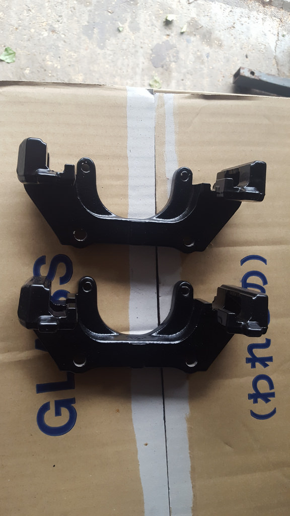

I sent the pad carriers to the powder coaters along with the spare wheel (i just can't help myself) :fearscream:
20161008_110514 by Scott Raven, on Flickr
20161008_110845 by Scott Raven, on Flickr
20161008_110910 by Scott Raven, on Flickr
Before i had the carriers powder coated i trial fitted them to the van, quite a bit of difference tbh.
Standard
20161001_143357 by Scott Raven, on Flickr
Meriva
20161001_144352 by Scott Raven, on Flickr
260 mm disc with the 280mm pads. :tonguewink:
20161001_144804 by Scott Raven, on Flickr
Bought all of the service parts from ECP along with the brakes, only the best for my van. :laughing:
20161003_132619 by Scott Raven, on Flickr

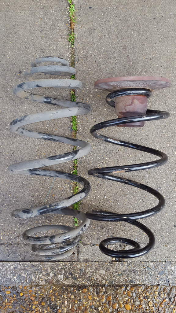

A bit more googling and i found that standard MK4 Astra springs can be used so i bought a pair for the grand sum of £20 delivered, yes they are alot shorter but they are also made of thinner wire (14mm vs 11mm) as it was such a small cost it was worth chucking them in.
20161029_142239 by Scott Raven, on Flickr
I was thinking they would be fine as i dont carry anything in the van, this is the height with the standard springs.
20161029_103708 by Scott Raven, on Flickr

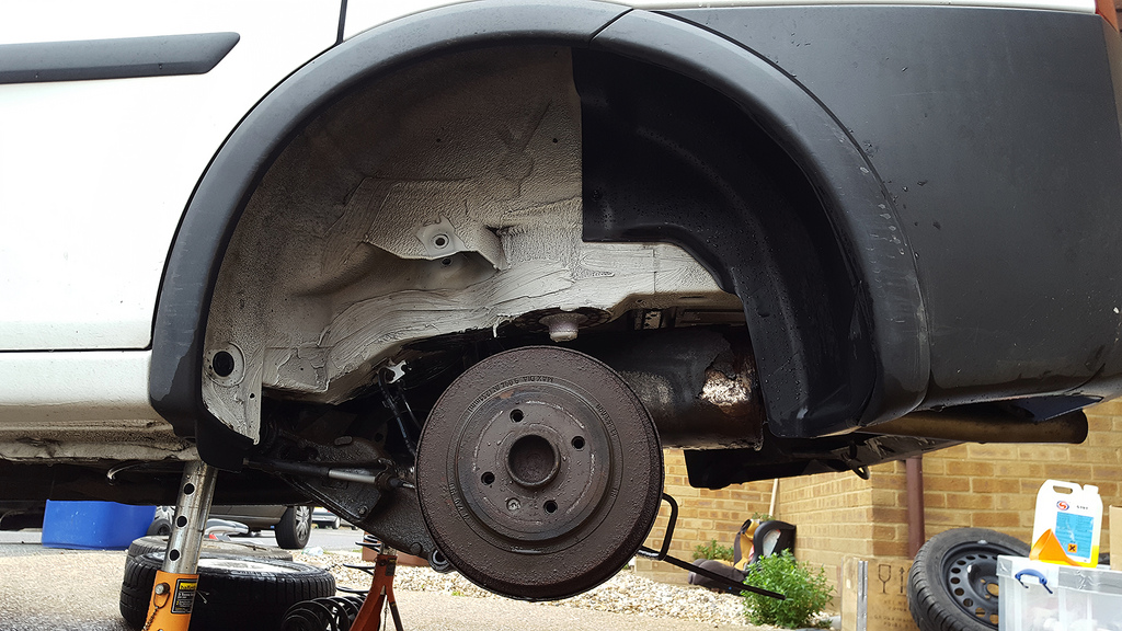

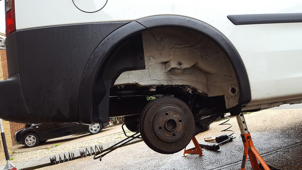

Before i fitted the springs i wanted to clean out the rear wheel arches, G101 a soft brush and the hose sorted this out.
20161029_114816 by Scott Raven, on Flickr
20161029_122750 by Scott Raven, on Flickr
20161029_133003 by Scott Raven, on Flickr

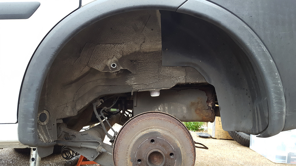

Always get carried away when cleaning so i ended up cleaning the underside, i wanted to treat the rusty areas anyway and give it a good coat of wax oil.
20161029_140258 by Scott Raven, on Flickr
20161029_140349 by Scott Raven, on Flickr
Im going to give my local pipe craft a call to see if they can remove the rear box and make me up a stright through pipe, im sure it won't make it loud.

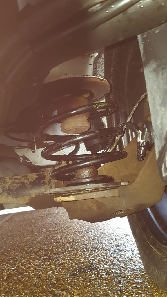

Once all of the cleaning was done i fitted the springs to see how compressed they where, not to bad but being thin they compress to much and hit the bump stop.
20161029_152620 by Scott Raven, on Flickr

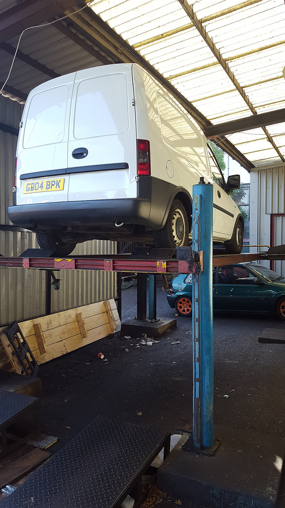

For now ive kept the van on its standard 14" wheels, yesterday i gave GAZ a call and have placed an order for a pair of front coilovers. :fearscream:
Looking forward to getting them now so the van wont look like a speed boat...😂
20161030_152617 by Scott Raven, on Flickr

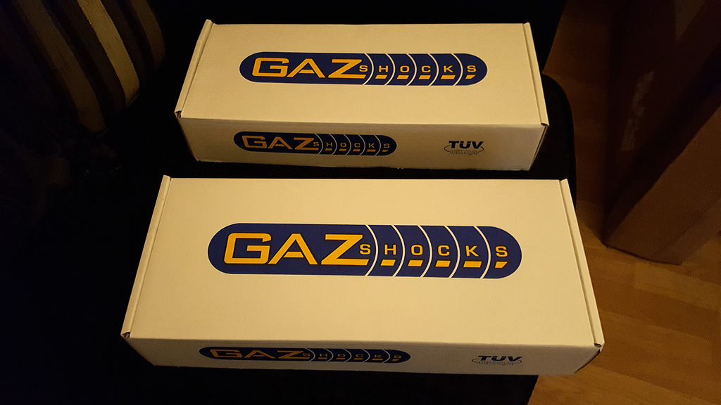

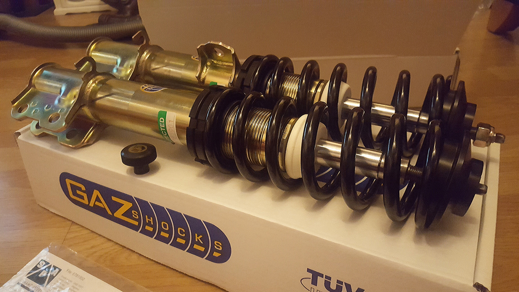

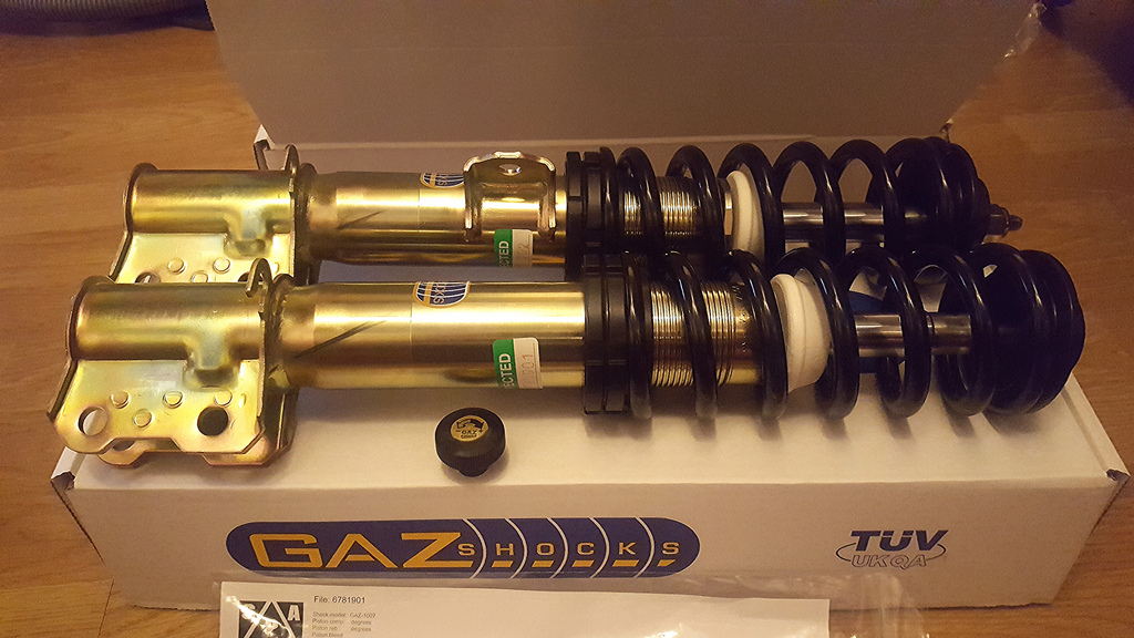

After placing the order for the GAZ i was told id have to wait 3 - 4 weeks as they are made to order. On Monday i had a call to say that they where ready for collection.
My wife went over to GAZ this afternoon and collected these. :cool:
20161123_175443 by Scott Raven, on Flickr
20161123_192815 by Scott Raven, on Flickr
20161123_192547 by Scott Raven, on Flickr
If im honest then im very happy, the quality is great and i was even happier when i saw that they where top damping adjustable (i wasn't told this when i ordered them)
SO now all i need is a couple of nice days to fit the front shocks and give the van a big service, once that's all done ill head over to GAZ and get them to make a new thicker and lower pair of rear springs with shocks to match.

The old 14" wheels are rusty and bleed rust over the tyre's when it rains.
So I bought 15" wheels with a lower profile tyre, this wouldn't look right on the van so it needed to be lowered...
Knock on affect, made perfect sense in my mind anyway. [emoji23]
