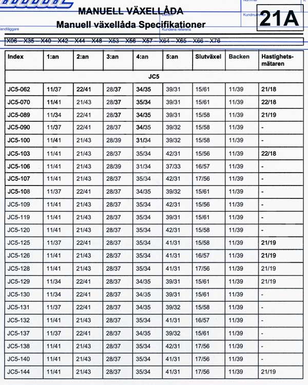

I think the box is the one with a taper bearing , like mine :(
Anyway heres the chart

If you want to lower the final drive do you have to go for the gripper lsd and then choose which c/w and pinion ratio you want? I take it the gripper c/w and pinion will only fit onto their plated diff?
I think there is another available but it's from an earlier box and not very strong after speaking to Agency, but I went the the Gripper Diff and their CWP route, it has totally changed the car
for what I'm doing with it, 4 seconds a lap at Anglesey along with tyres and suspension, and wet quicker and achieved PB's at every event, just need an engine with more HP and revs, the engine is still stock by the way but running an EC1 and cable throttle with single TB and stock inlet.

Think its the route I will be going too Russ. I would preferably have gone for a quaife purely for the fact you can fit and forget but i dont believe they offer a lower final drive.
Ph1 Tom
For my Ph1 I went Quaife with the 4.07 final drive rather than the 3.89. Gearing is pretty good, just needs ITBs now. Something like a 4.27 would be perfect imo.
If it's your daily then I'd say Quaife, but the Gripper is a different animal tbh, I've based mine on a 3-4 year service plan for the box and diff, I do about 2-3k miles a year and the rest is at Sprints and the odd test and track day. What surprised me was Aintree which is a power venue 2 x 90 bends and a long open bend all more or less flat, I thought I'd be slower there, I went a full 1-1/2 seconds faster but lost 8mph over the finish line, my slowest terminal speed even as a standard car. Just to add I oil change every 6 months on the box.
