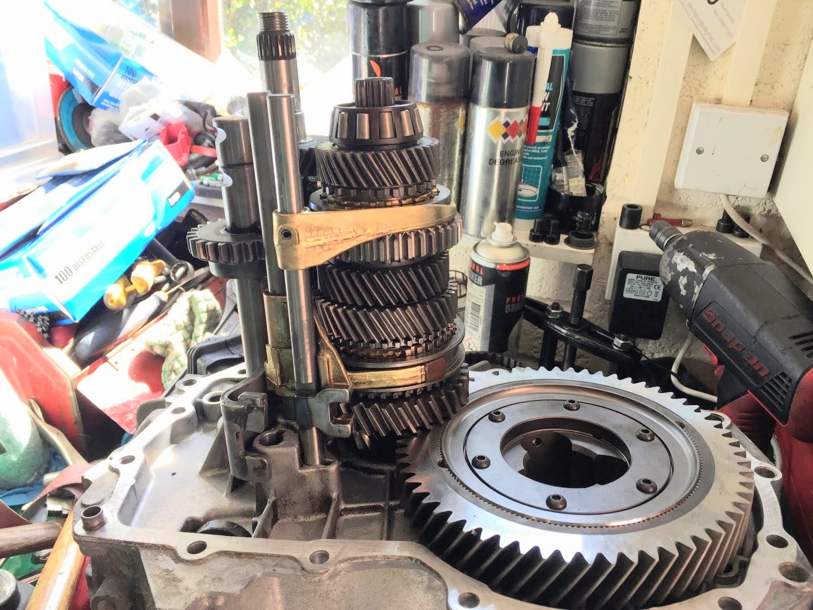

Here's mine which NorthloopCup did for me over a year ago.
2nd, 3rd, 4th and 5th gears and synchros were all new, plus the Quaife LSD.
