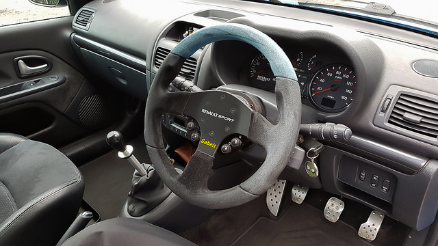

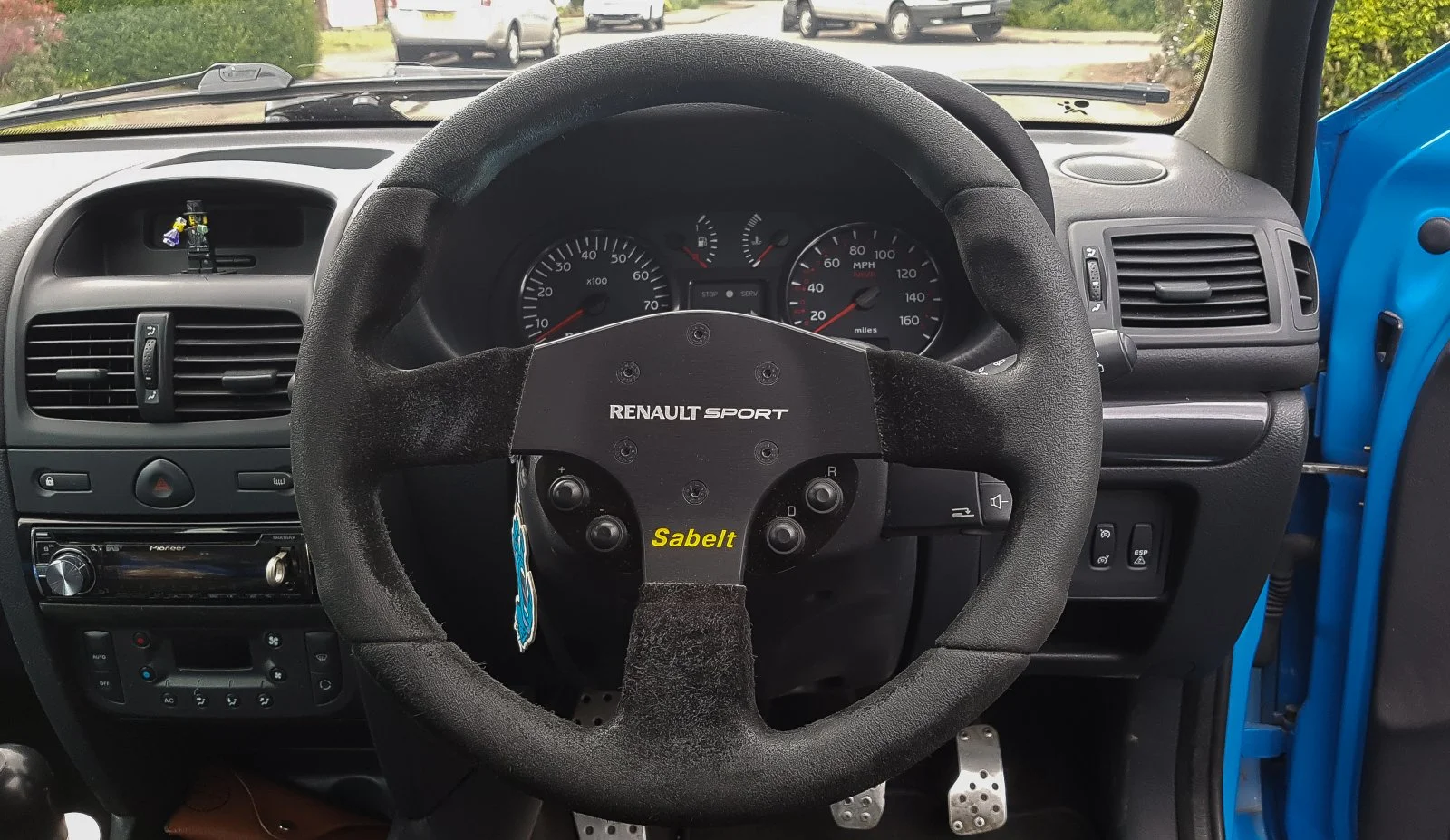

Gave the Sabelt a clean today. Well i tried the best i could. Unfortunately its lost quite a bit of colour but its a lot better now than it was before i started. It will do until i get it retrimmed. I do love the wheel and even more so now that they have been discontinued, so its worth keeping it now. Will look great once its retrimmed, but unsure when that'll be.
View attachment 185917 View attachment 185918 View attachment 185919 View attachment 185920 View attachment 185921 View attachment 185922 View attachment 185923 View attachment 185924
Huge difference! Actually looked like a full black suede steering wheel beforehand. Wonder if it'd help with a debobbler now after you've brushed it up.
Half expected photos of you in the bath with the steering wheel tbh :)
I saw the shower gel pop up on flickr and wondered what you were up to! Nice turn around there, as you say it should look great retrimmed.

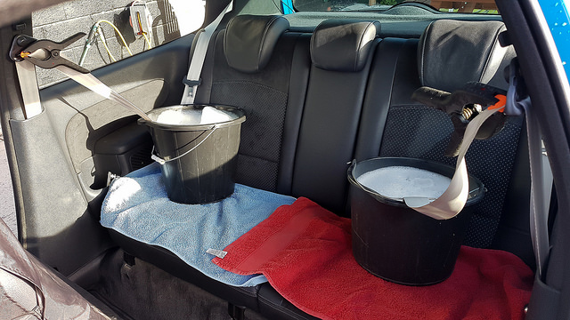

I'm doing the seatbelts today, while it's sitting in a bucket of vanish gold! Dabbed the nail brush in there and gave the blue on the steering wheel another going over so hopefully that make it'll look a tad better. Will get some pics today bit the wheel looks a lot better than those pics above.
Great work as always, as mentioned above it looked almost 100% black before.

It was mate. I actually looked at it today and it looks bluer than the pics tbh.

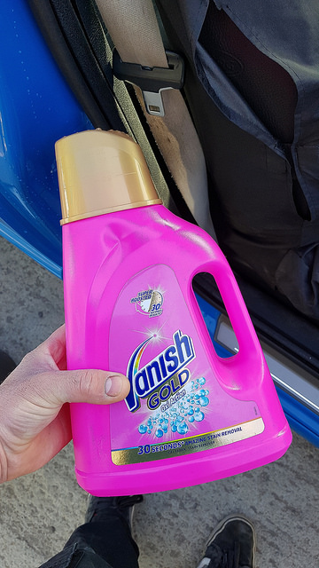

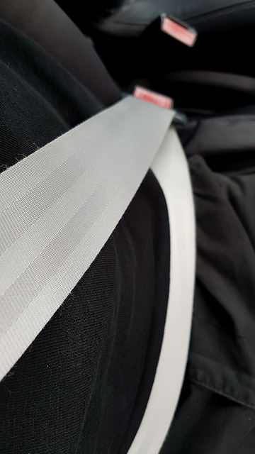

Did my seatbelts today. Leaving the belts in a bucket of hot water and Vanish Gold makes them come up like new again!
And a few more pics of the Sabelt in daylight this time. You can even see how blue it is now in the 4th pic above too.
Pretty happy with that for some shower gel, nail brush and a scrub!
Vanish gold is your friend!

Gonna grab some vanish tomorrow from poundland too!

Aldi oxy clean will also do the seatbelts. I prefer the granules over the liquid but it all works. Leave to soak and then use a washing up sponge with the brillo bit and scrub and it comes up sweet. Looks dark when it's wet as to be expected, but rest assured once it's dry it'll come up lovely.

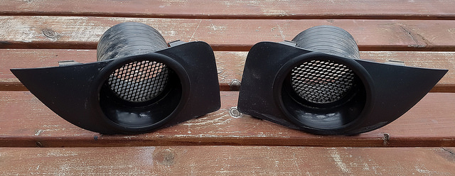

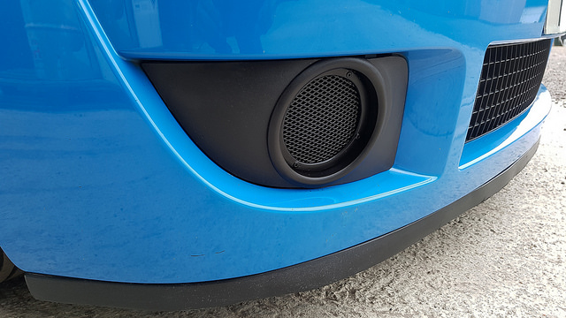

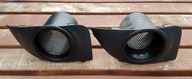

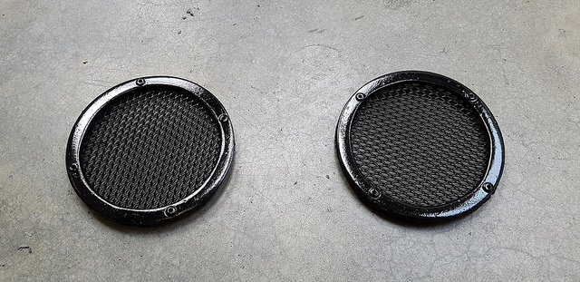

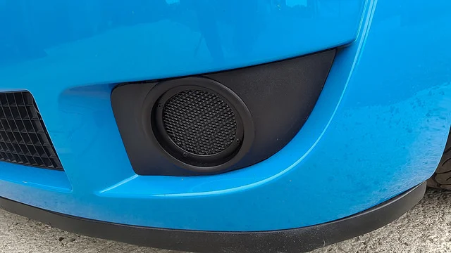

Its been on my mind to change my fog ducts for a while now. I love having the mesh there but 1: Because it was originally gold mesh that i sprayed black, it kept getting chipped revealing the gold underneath. 2: I didn't really like how deep the dish was on the mesh. In hindsight, i would have liked to have it more forward.

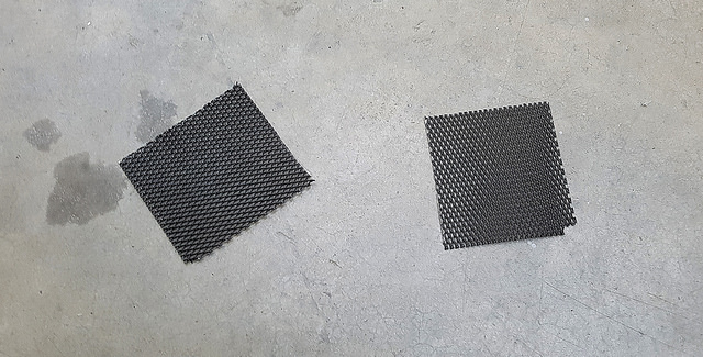

I left it like this until i was speaking to @Louis' as he wanted to do similar. He found some mesh but didn't need it all so we went halfs. He bought it, took what he needed and sent me the remainder for half the cost :smile: I also got some 2nd fog surrounds (As i ruined one with a mop i used a few months ago!) and some new 100mm bass ports off eBay and set about doing my ducts again.

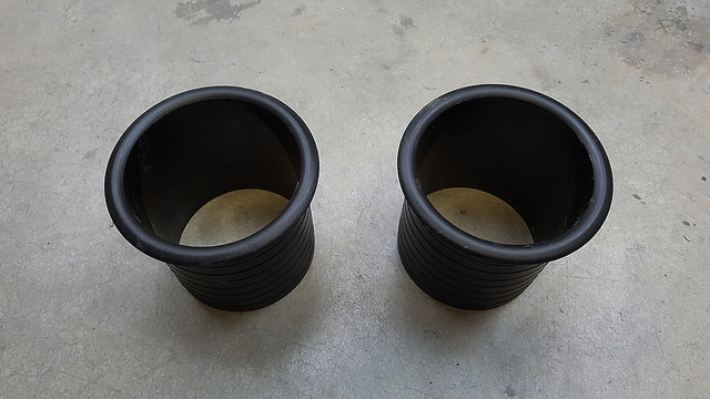

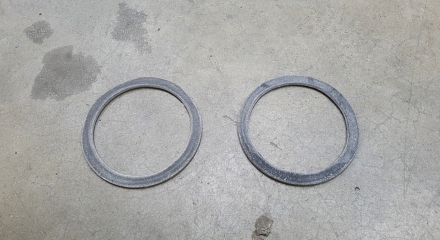

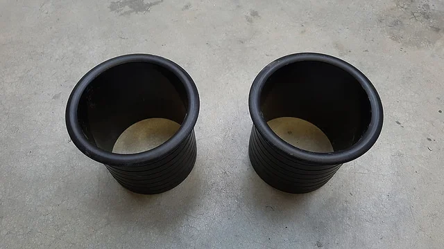

I cut some fiberglass rings up at work, like i did before.

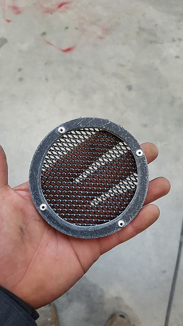

Cut the mesh to fit the rings
I then drilled and riveted the rings to the mesh and cut to shape. After that i gave them a couple of coats of satin black and lacquer.
I then rested the mesh rings in the ports on some sweet pots to get the right dish depth and then added some PU sealer and hot glue to bond them in the final position.
All done. I gave the mesh another coat of satin black as i didn't want the gloss look, but still wanted them protected. Gave the surrounds a rub of AF trim restorer
New Vs Old
Old ones
All fitted
I like them more than the old ones. If im honest i prefer the mesh gaps on the old ones but its so minor its not a issue, and the way these sit and the fact that these are fully black and not gold underneath makes me happy! I finished with a few pics :smile:
Those new ducts look superb Mark, you do make some nice touches to the car it has to be said :up::up:
I can see what you mean about the mesh gap but wouldn't bother me either tbh, I just really like the riveted then painted look on these new ones
That's guys! They look kind oem which is nice. The gloss form the lacquer made it stand out too much where as the satin look is much more sutble.

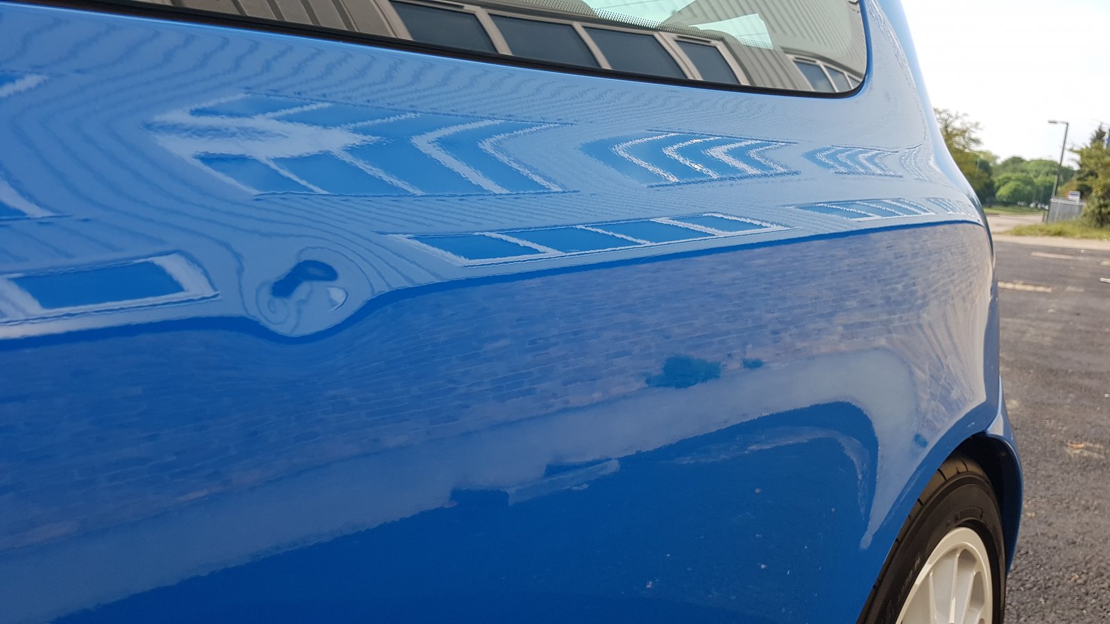

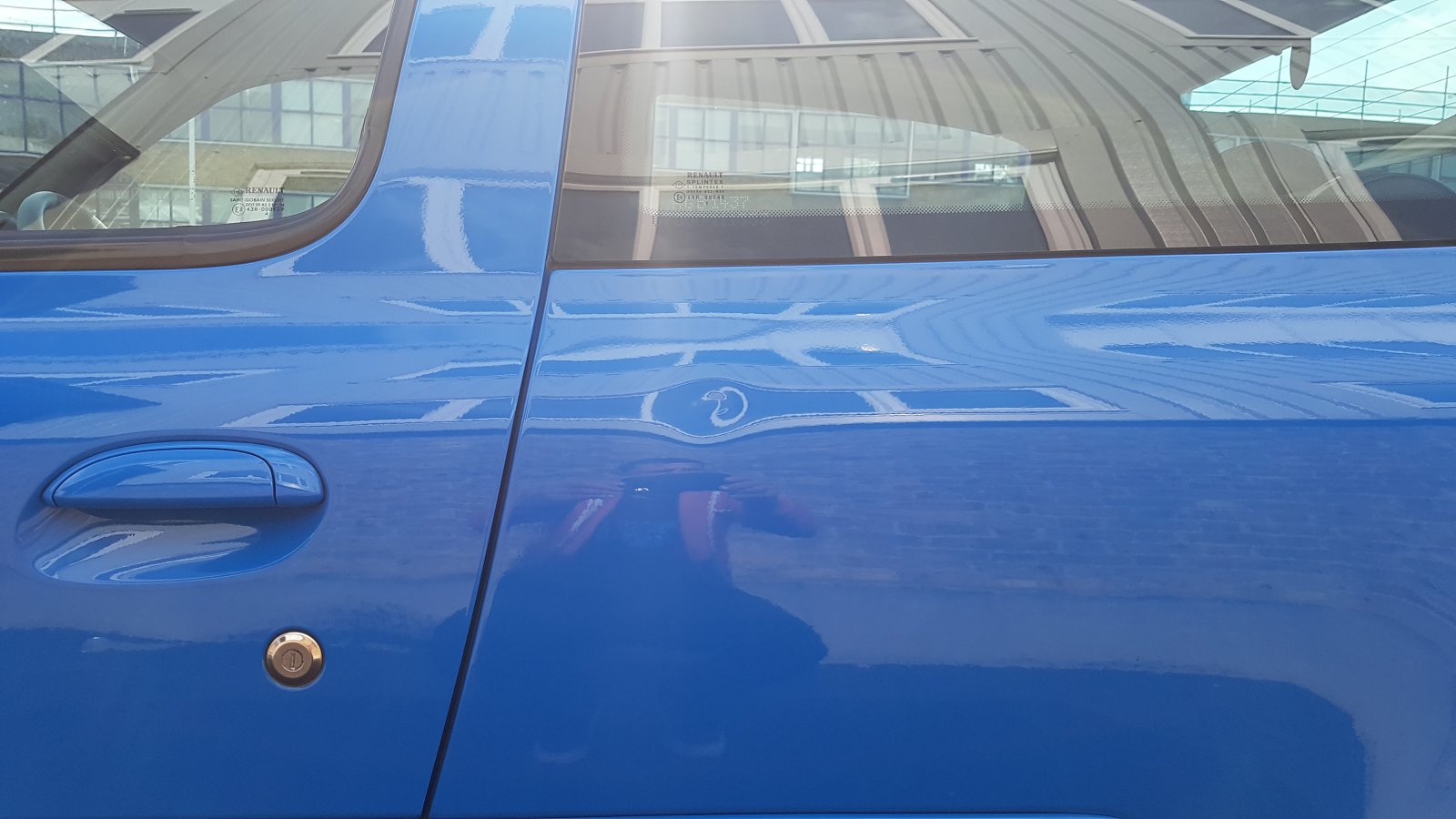

In other news, I've said all along that this car is not mint and I've never been bothered and the scars it has but I take that back. Parked in my local Tesco today and was in there no longer that 15 mins and some fucker gave my rear sister and nice ding. There is 2 marks so it's happened twice! I take pride in the RB and a lot of work has gone on to this, and some people just have no respect for other people's cars!
Oh well, guess I'll have to have a reunion with the dent man!

Damn they are bad ones. Good job they aren't in your sister or the dent man would have to give her some real hammer to sort them[emoji23].
So sorry to hear about the dent Mark.
The lack of care people take over cars annoys me massively. I've never once hit my car door on another vehicle and if I ever did I would leave my details.
Hopefully you get it sorted shortly.
Thats why i take up 2 spaces like a prick. Feel wounded for you pal.
