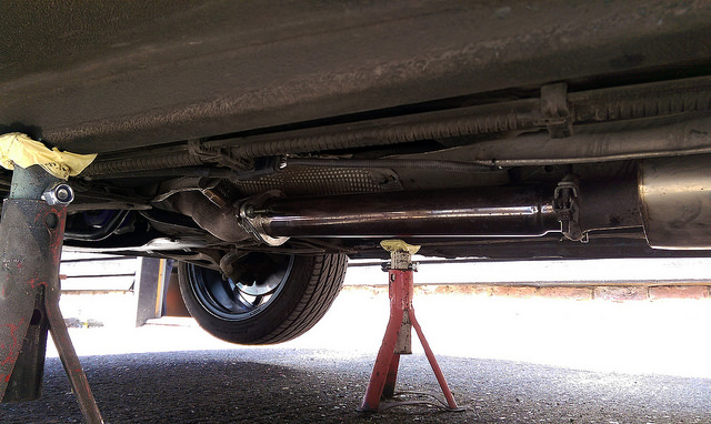

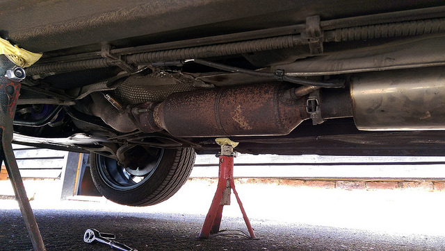

Decided to fit the decat. As you can see it has new lambda sensors. These were replaced with the last few months.
Even with it fitted, its a very quiet system. By far the quietest i've ever had.

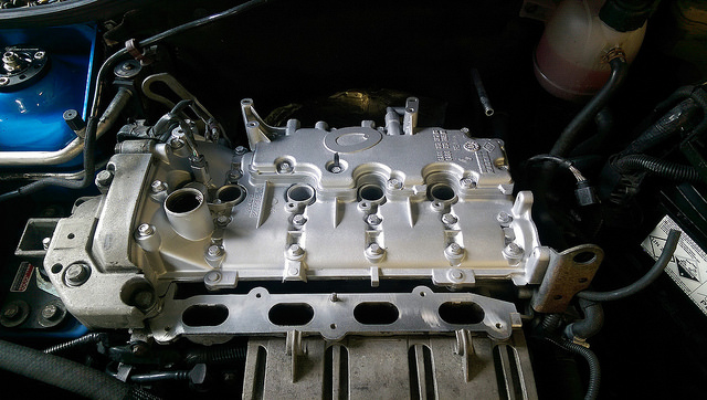

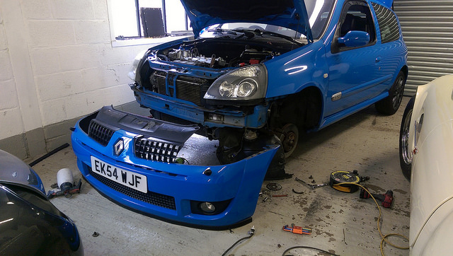

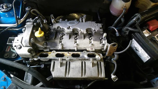

As i started to remove parts, i found a few more things to do. First off was to remove the old "Fatty" induction kit.

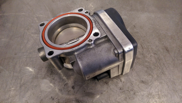

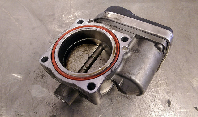

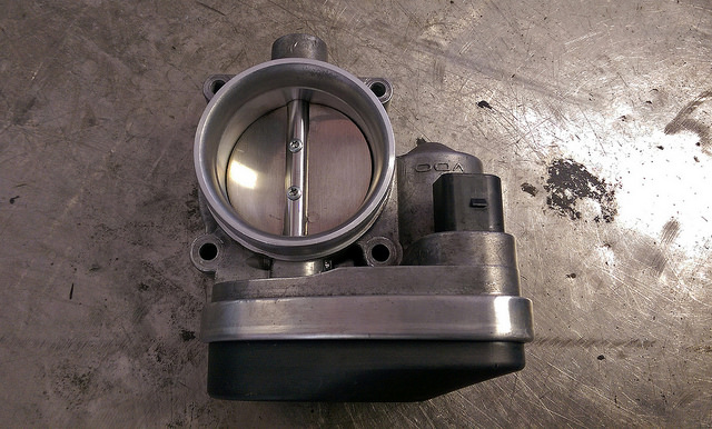

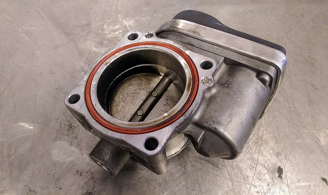

I removed the throttle body and gave it a clean.
Cleaned

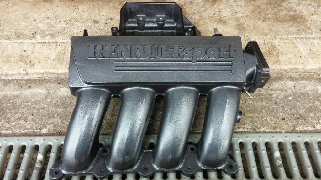

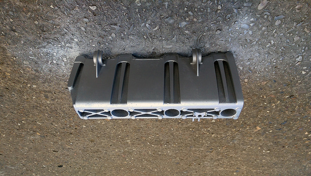

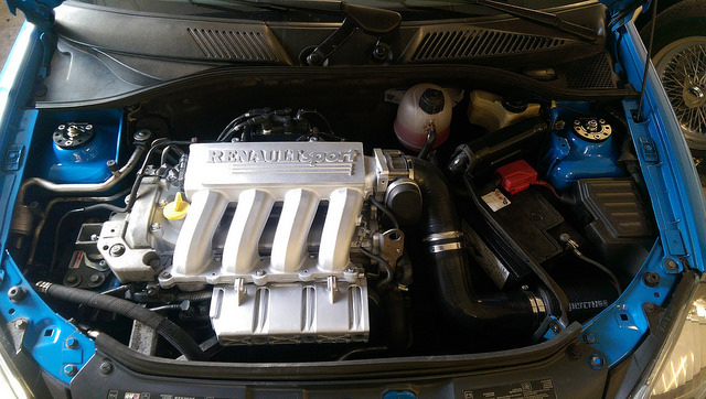

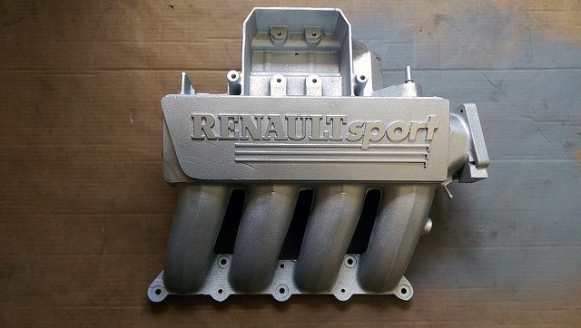

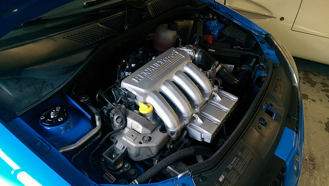

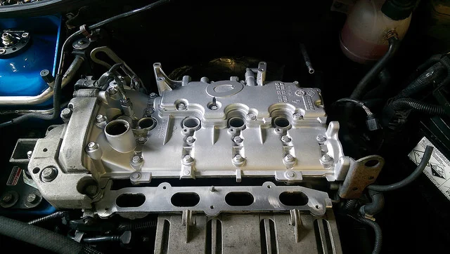

While that was off, i decided to remove the engine cover as i think they look better without them. Underneath was a little bit grubby so i decided to clean it up with a wire brush and scotch pads and give it a quick spray of silver.
The fuel rail guard and inlet was done also. I do plan on doing these a bit better at a later date and possibly do the inlet a grey colour but for now i just wanted to tidy it up a bit. Will do the belt cover too at a later date.

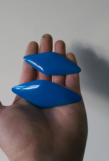

These also came from @Sesqui89 so i got them fitted. I meant to text you Jamie, but forgot but as you can see, they arrived :smile:

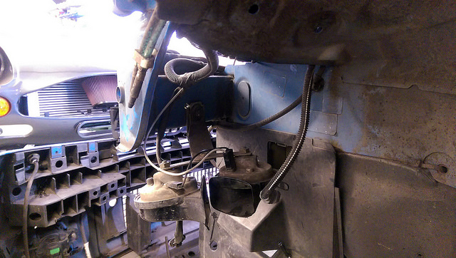

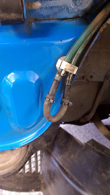

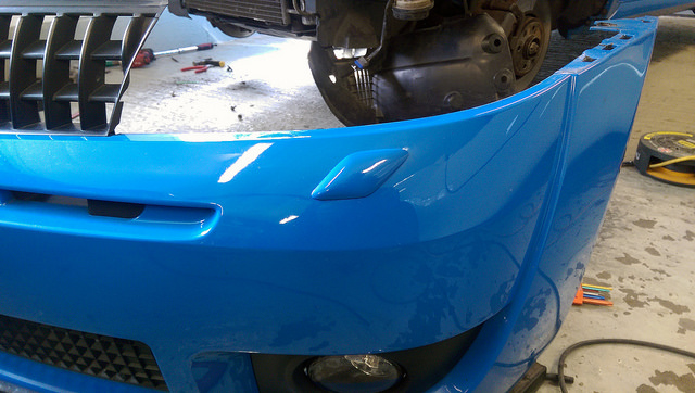

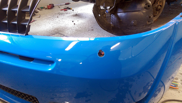

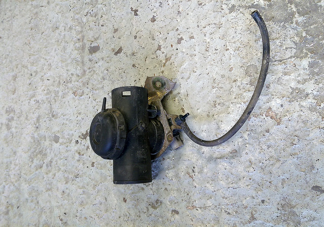

While the bumper was off i removed the acoustic valve.
I also shortened the air pipe and used a bolt to close it up.

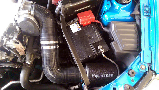

Induction kit fitted.

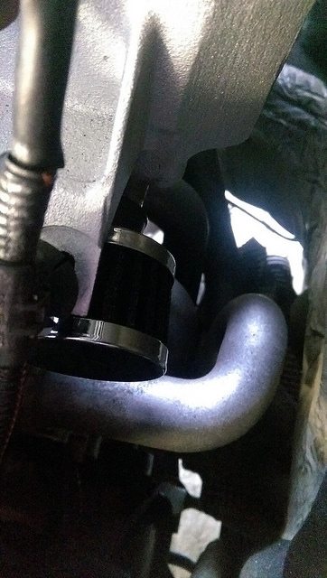

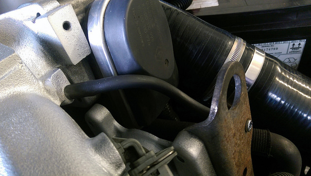

Breathe filter at the back of the inlet.

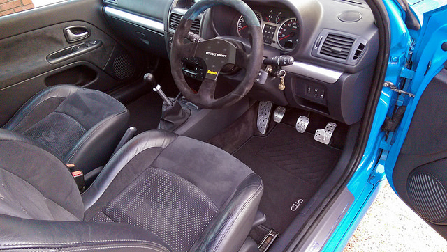

Got some new mats so i hoovered the car and fitted them. I normally get the Renault Sport ones but people on here have been buying the dynamique ones as they are the same material and quality, but instead of having silver piping and the Renault Sport logo, it has a plan Clio logo. Nice and simple and also a fair bit cheaper. £60 for the sport ones and £25 for these ones.

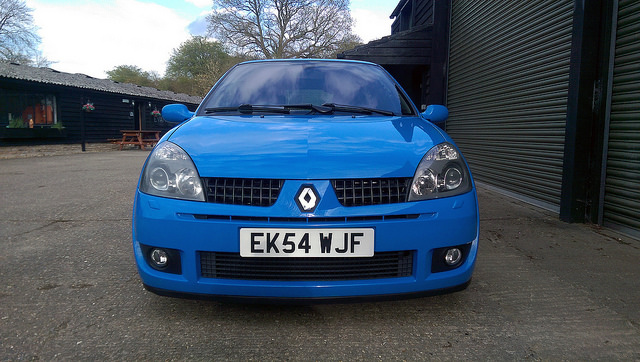

With that all done a gave it a quick wipe over and took some quick pics.

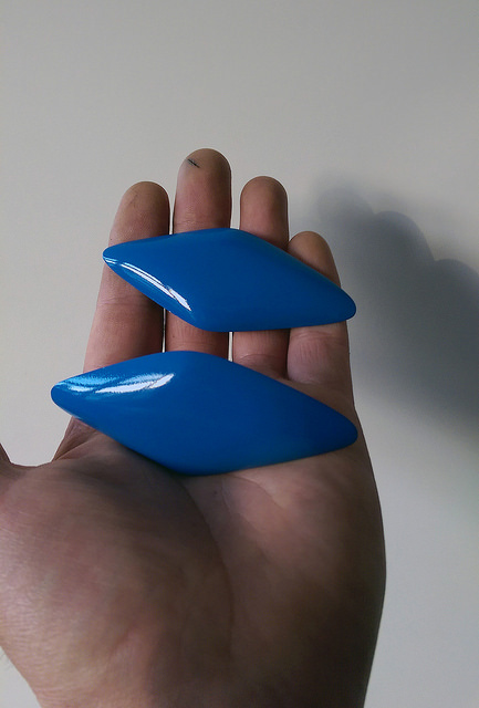

How much were those spray blank plates and were from?
Thank you Buddy. Not mint, but good for the age/mileage for sure.
As for the blanks, I bought them off here from the previous owner. You can buy them off eBay for just shy of £30, but they come unpainted.

I'm thinking grey of some sort for the upper inlet. Not sure yet though. Needs doing properly, but looks a lot better than before.
Typical. Tbh I was waiting on the silicone bends but the came in Friday so I manged to get it all done, otherwise I would of have to have waited till next weekend.
FYI I painted mine with halfords Peugeot metallic graphite grey. Turned out lovely.
Perfect shade.

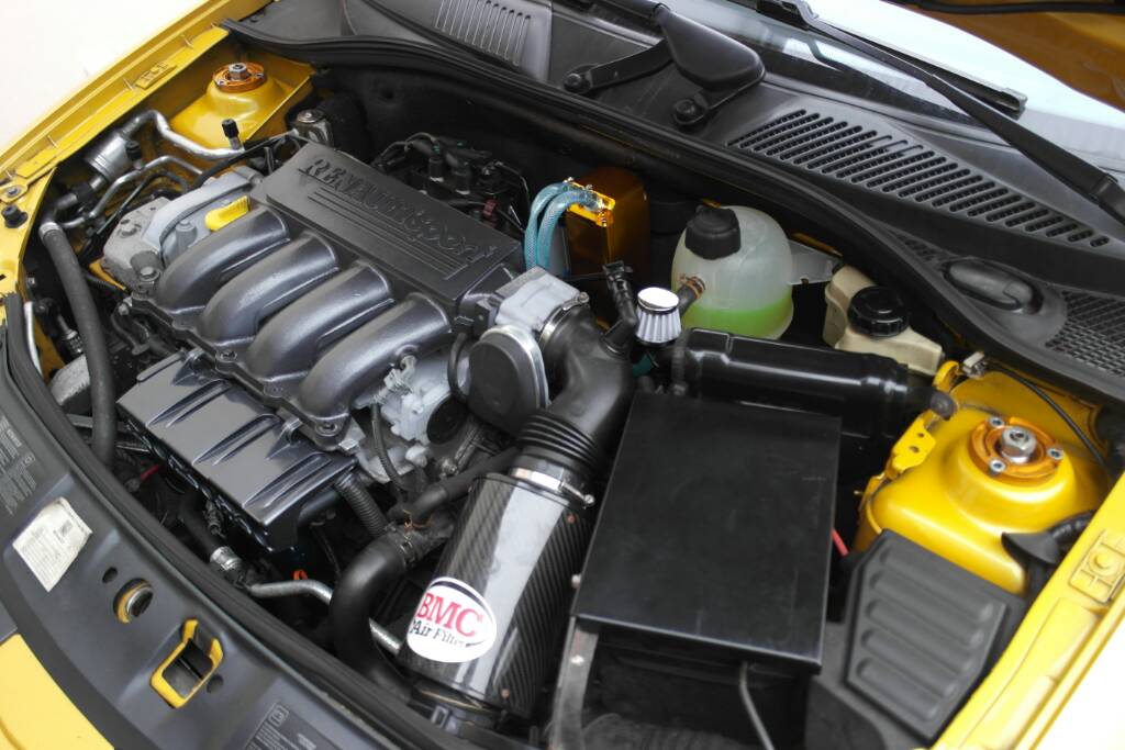

@Mr Blonde and jekyll. Here's the pics, not the best angle but I cba to dig through my laptop files [emoji23]
Yeah I like that. I like how you've got it silver underneath too. Think I'm sold tbh.
Really nice mark. Does look better with the washer blanks. I'm after getting done but in black I think
Get them colour coded. It won't look poverty spec then ;)
Yeah I like that @LiquidYellDan nice work,was it just normal paint not high temp paint?
Don't get high temp paint. They always come out dull and tbh the normal stuff can withstand the heat on these.
Where did you get the blanks from @Dr Jekyll?
I got them from the previous owner but he got these ones:
http://www.ebay.co.uk/itm/Renault-C...969665?hash=item3ac10d2e41:g:gqUAAOSwstxVJtxH
It's just normal paint. Be sure to prime it well! 3 primer coats, 2 or 3 colour and a few lacquer coats.
As it's just inlet manifold, only heat it gets is general heat in the engine bay. Did a track day and it got very hot in the bay and paint looked perfect still

All halfords rattle cans. Paint was Peugeot metallic graphite grey [emoji106]
It's a great colour against the silver.
Don't get the VHT version of this. I've used it, after a few months it's turned a greenish colour and looks gash :down: I should of followed Dans advice and done it his way.
VHT paint has always had a crap finish. It goes too matte looking and never looks like the colour you buy!

Thoroughly enjoyed your other thread so looking forward to this one as well. I am thinking of going down the same induction route. Could you let me know the exact measurements for the 90 degree elbows, joiner and the filter so I make sure I get the correct parts. Thanks

Mark how does the induction set up sound. I'm guessing you have had the fatty style one at some point?
