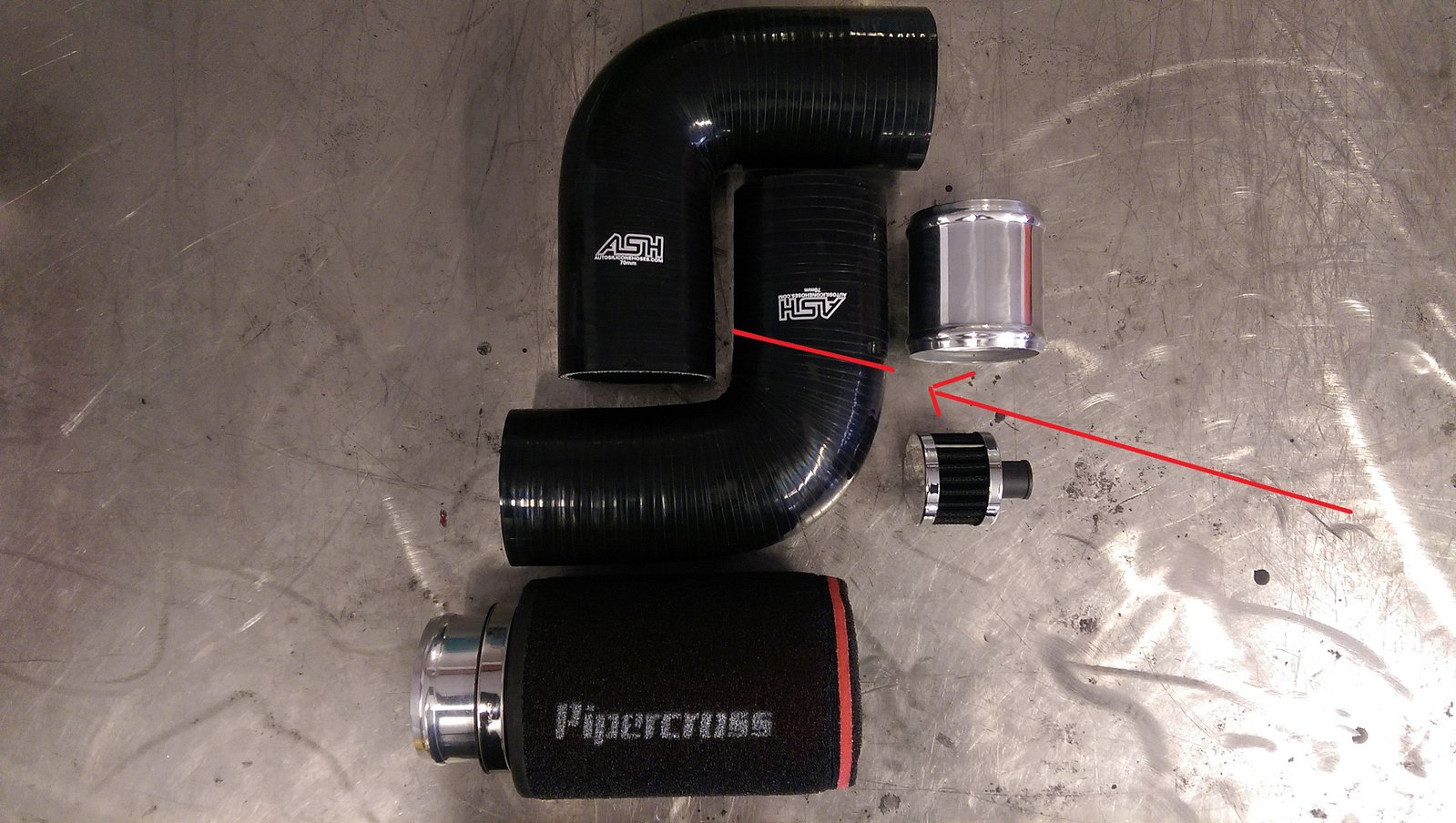

Thoroughly enjoyed your other thread so looking forward to this one as well. I am thinking of going down the same induction route. Could you let me know the exact measurements for the 90 degree elbows, joiner and the filter so I make sure I get the correct parts. Thanks
Thanks bud. Yes of course:
Ally joiner for the silicone pipes. (You will need to buy an extra one if you use the filter i currently have, as it comes with no neck)
http://www.ebay.co.uk/itm/381537206397?_trksid=p2057872.m2749.l2649&var=650640058375&ssPageName=STRK:MEBIDX:IT
Breather filter to go into the back of the inlet:
http://www.ebay.co.uk/itm/191579940089?_trksid=p2057872.m2749.l2649&ssPageName=STRK:MEBIDX:IT
2x 90 degree silicone bends:
http://www.ebay.co.uk/itm/131676086576?_trksid=p2057872.m2749.l2649&var=431063786095&ssPageName=STRK:MEBIDX:IT
And the filter of your choice. I went for a Pipercross C0171 filter this time, which doesn't come with a neck on the filter. The previous filter i had on my Ph1 was a ITG one which had a neck on it, so bare this in mind if you chose the above filter. What ever filter you decide on, make sure it has a 70mm outside diameter to go into the silicone bend, whether it comes with a neck or you use a joiner. You will also need to adjust/cut down one of the silicone bends at an angle for it to fit in-between the ECU cover and past the throttle body. Like here:

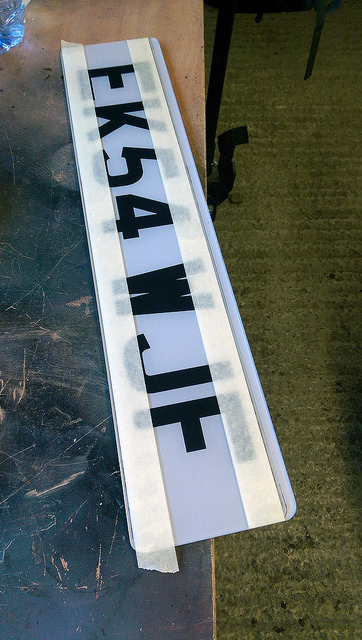

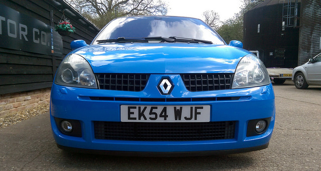

I decided that i didnt like the look of the full size plate, but the 3/4 one i have was a tad too small so i too the original plate and cut it down on the bansaw at work so i had my own 3/4 size, but this way ive still kept all the codes on the bottom of the plate to make it "legal" if i ever get pulled up.
I also removed the Team Heko's

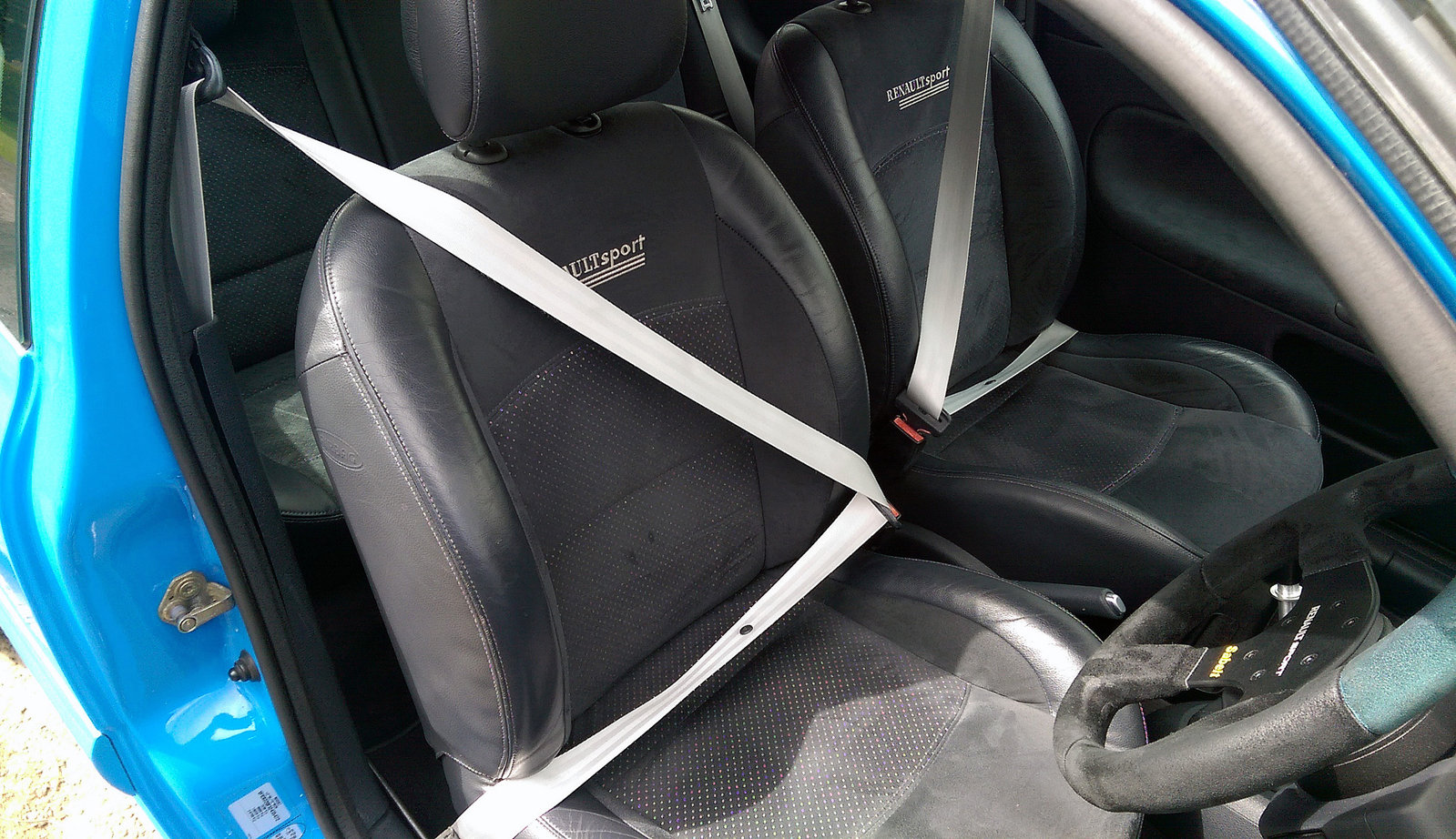

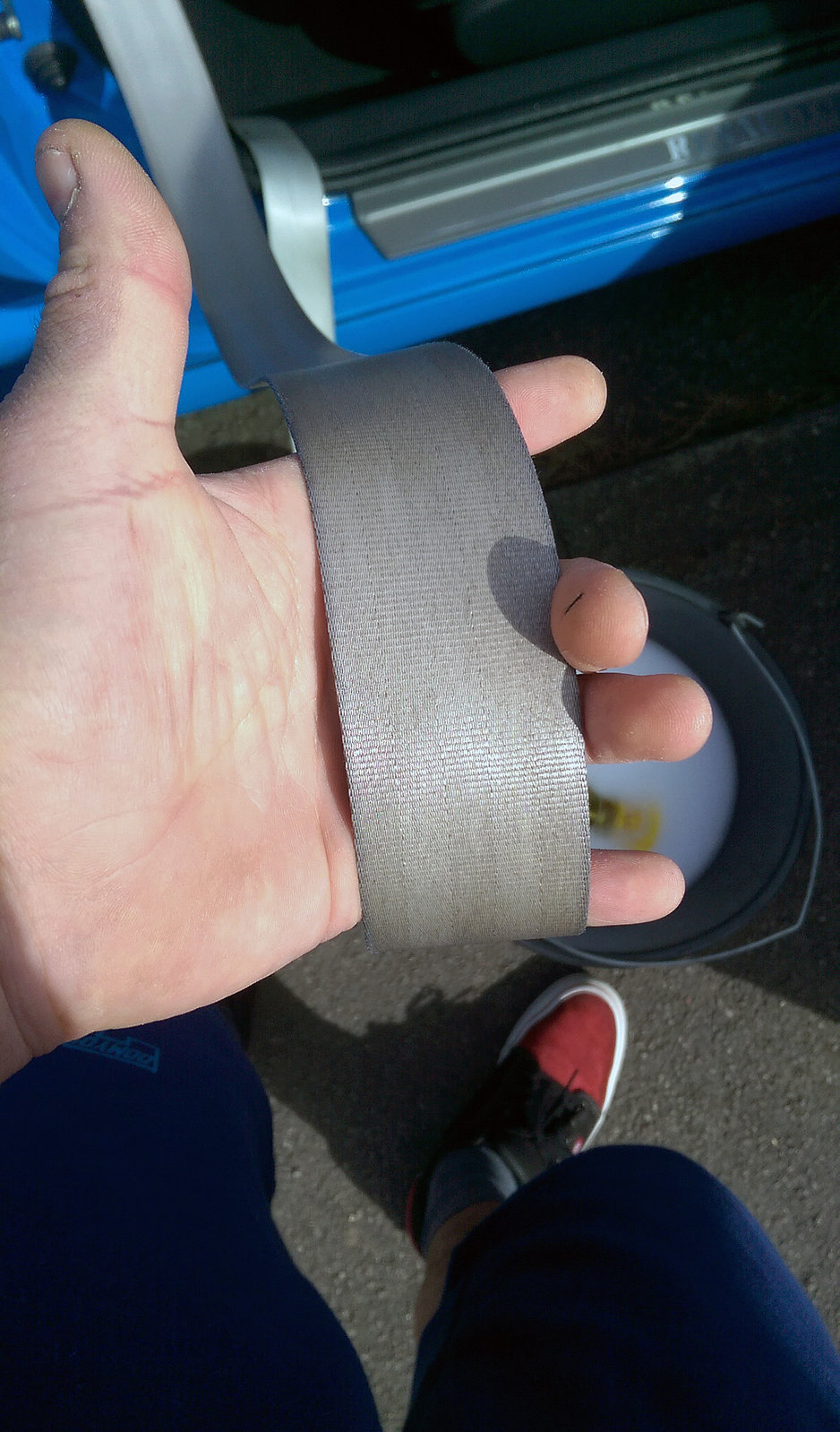

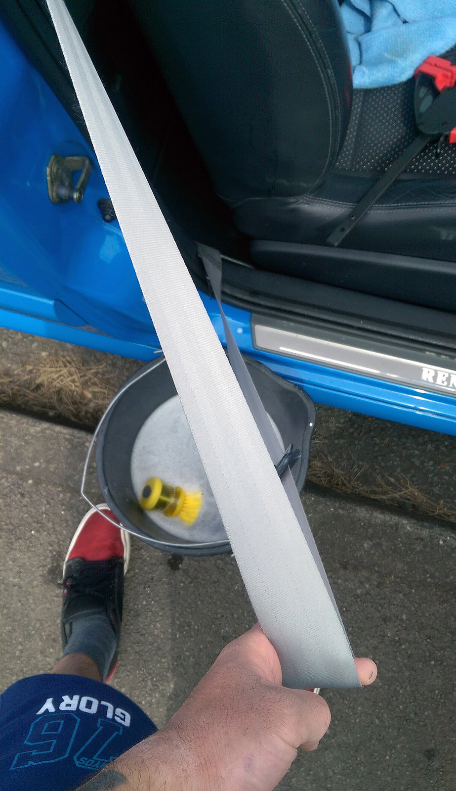

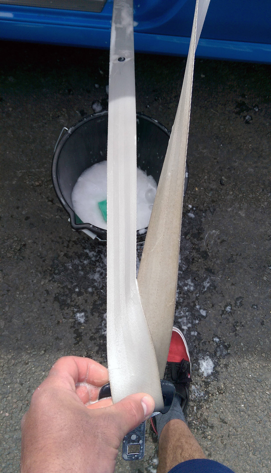

Then today i decided to clean the seatbelts as they was filthy. Hot water and Vanish Gold worked a treat :smile:

Thanks guys. The seat belts have come up brilliantly. The pictures don't really show the true lightness. We went out today and took the RB and when I put on the belts, I was really surprised on how good they actually are now that there fully dry. Such a simple job but rewarding.

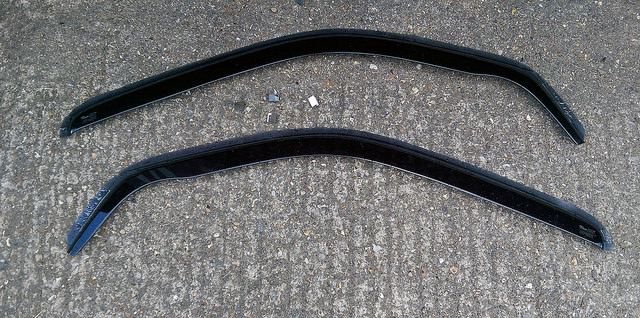

I knew you would approve on the deflector removal. I was going to to tag you, but i knew you'd be in here to comment!
I also greatly approve of the deflector removal. I think they're blinkin' awful, looks so so so much better without them!

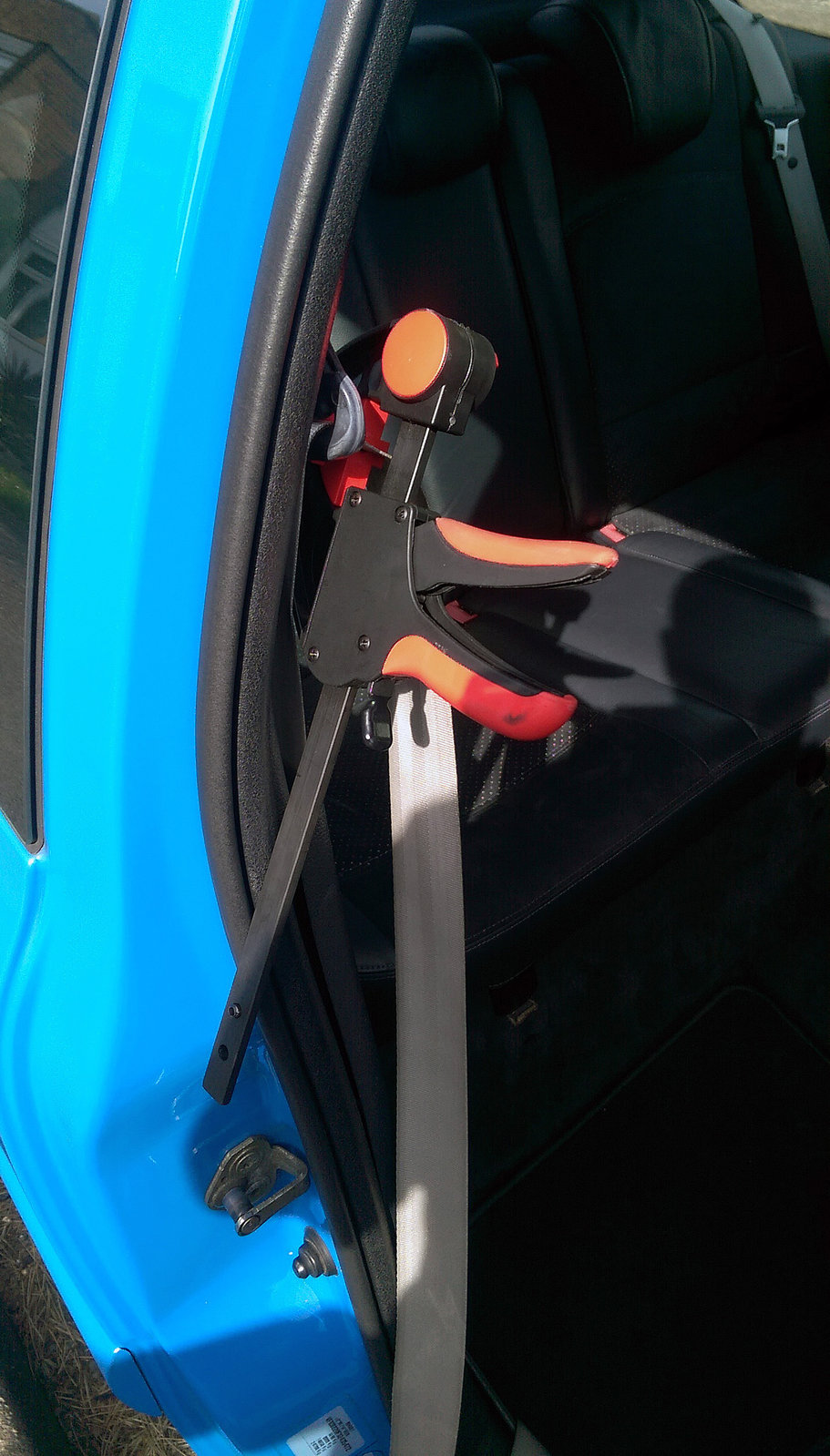

@RMDavis It's worked wonders mate. I just put a heaped spoonful in a bucket with hot water and took a washing up sponge to it. I pulled it out to its maximum and held it over with a quick clamp as my washing pegs didn't hold it. Let it soak the best I could for 5 mins then scrubbed away. It didn't look that good when I was doing it as the belts was wet, but once they was dry, they came out brilliantly. Both sides took less than an hour :)

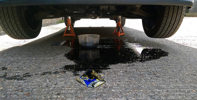

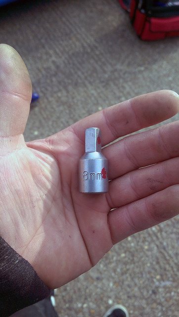

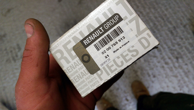

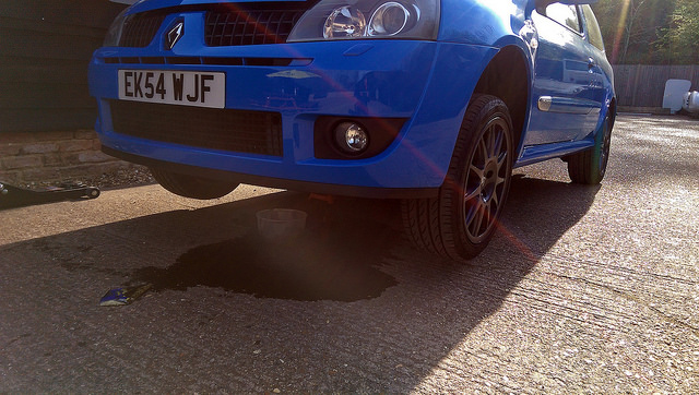

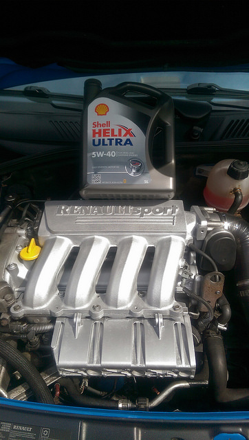

The RB spare and extras came with a new oil filter/washer and some oil so i ecided to give it an oil change as the weather was nice.
When i was draining the oil i naturally took a pic, little realising that my "catch tank" had no lid. Cue a bit of panic and oil soaked phone, tools and a large oily floor!

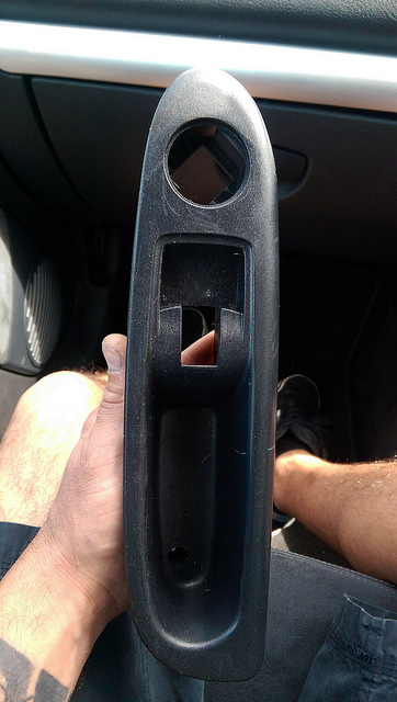

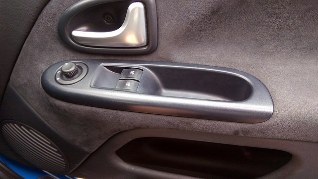

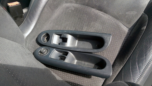

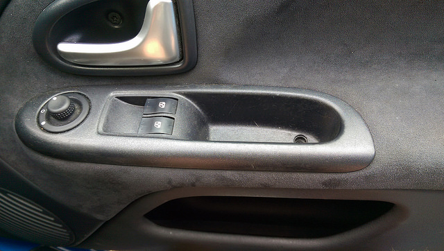

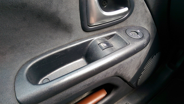

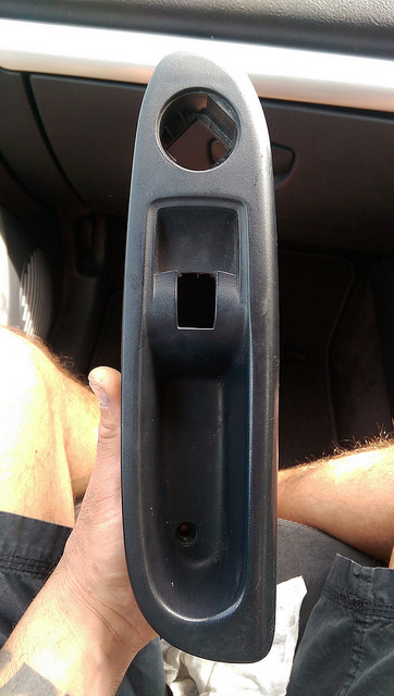

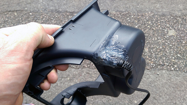

Non stick grab handles as mine has gone sticky

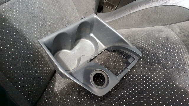

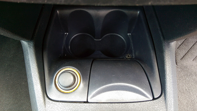

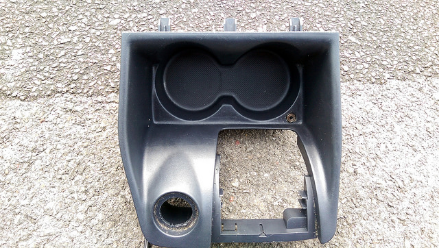

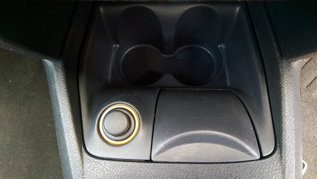

Standard cup holder as mine had a jack insert for the Connects2
Sapre side bullets as mine are a little bubbly

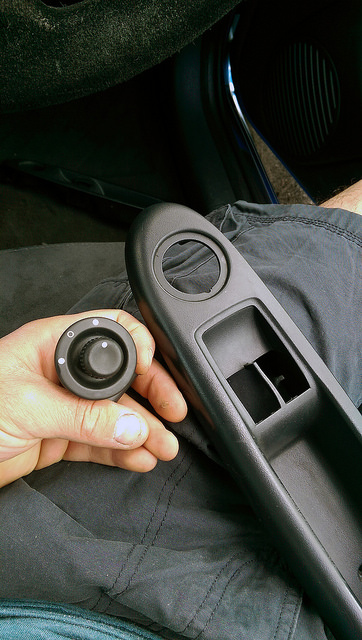

Swapped the handles over. Old:
I love these wipes. They are so universal!
Removed the switches and clean all the grub off

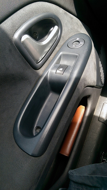

Non stick fitted
Passenger side. Old:
Non stick fitted:
Old cup holder

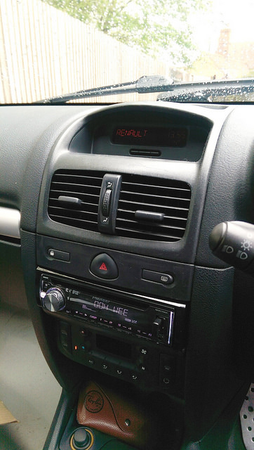

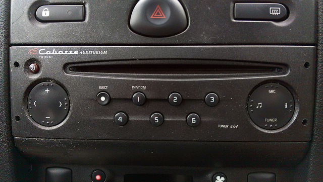

The reason i did the last bit was because i wanted to have usb compatibility, plus the standard headunit was all scabby. I didnt want to spend big bucks so i bough @LiquidYellDan old pioneer for a good price.
The old headunit
It didn't come with the leads so i ordered the harness to go into the back of the unit
http://www.ebay.co.uk/itm/351497234024?_trksid=p2057872.m2749.l2649&ssPageName=STRK:MEBIDX:IT
And then the adapter so i could have stalk control.
http://www.ebay.co.uk/itm/270878151210?_trksid=p2057872.m2749.l2649&ssPageName=STRK:MEBIDX:IT
All fitted

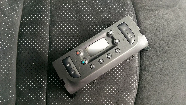

Its a bit tight behind the headunit, but with a bit of patience and strategic placing, it all fits a treat. Ive also ordered a spare climate control unit in decent condition:
I also have a new dash top, hazard panel and the strip that sits below the CC panel, all in good condition coming from another facebook group. Once they arrive i will swap them over, change the clock bulbs as the right side is dim, and ill add the renault sport sticker into the rev counter and the gear select sticker on the windscreen.
