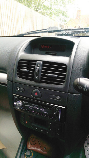

It's the first one that came on. Modern (ish) track with a old skool cool sound.
It doesn't sound to bad in the car, but I'd like to upgrade the speakers at some point.

Good good. The wires I had with mine seemed so OTT and unnecessary! I literally tried for an hour, tried zip ties to compact the bundles etc etc. Just would not go in! Only way I could get it in was dash top off, even then it barely went in! Lol

Just had all the stereo changed in mine and does make a big difference doesn't it, i see i'm not alone in having to have the steering wheel controls working haha........ that Pioneer is actually very similar to the one I have in my 'daily' car, is a decent bit of kit!

Yeah I like it Steve and it doesn't look too out of place.
Also, stalk control was a must! It was just confusing which one to get. I actually got the wrong one at first (003) but I spoke to the company I bought it from and they swapped it free of charge and the correct one (004/link above) was sent out and fitted promptly :smile:
Yeah that's the thing, has to blend in :up: I didn't want a bling bling all flashing one in mine either so actually had my old Alpine fitted that doesn't have USB or even AUX but i'm old skool with cd's 😂 so it's fine!

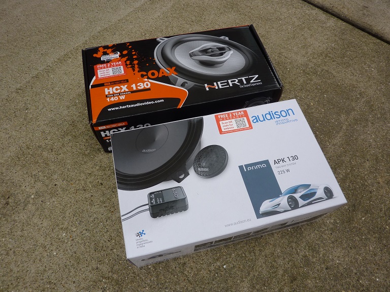

Saw you mentioned about speakers as well btw, this is what I've just had put in mine just in case it's of interest, sounds amazing and has a skinz kit (sound proofing) in both doors too... all in my project thread

Just FYI, you can fit 6.5 inch speakers in the front doors, with a slight trim to the doorcard. Just make sure you get a shallow-ish speaker as the baskets can hit the window/stop it coming fully down. I went full whack and ran new wire into the doors (through a multiplug) and to the tweeters (also replaced), with crossovers and tiny Vibe litebox 2 channel amp under the drivers seat. A few sheets of deadening in the doors and it all sounded great, bassy enough as well with the bigger speakers.

@Akay Thanks for the heads up. Not sure what i'll do yet, but that is good to know.

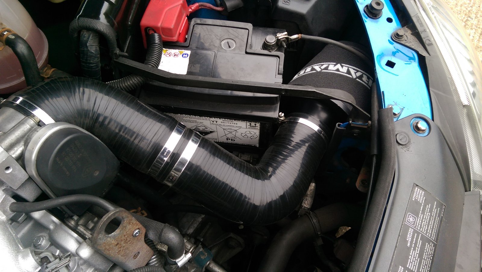

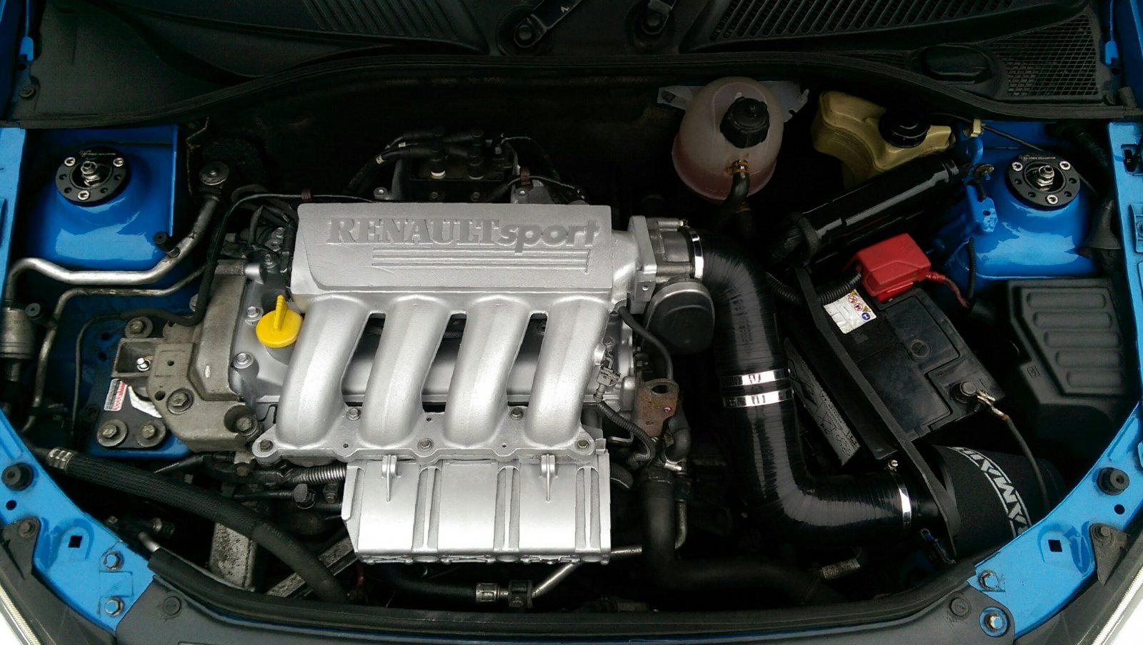

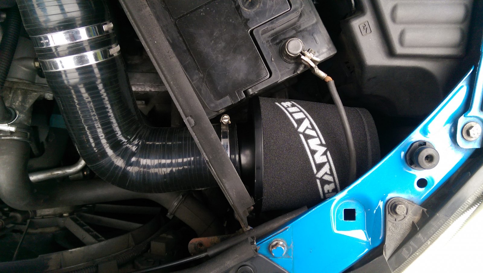

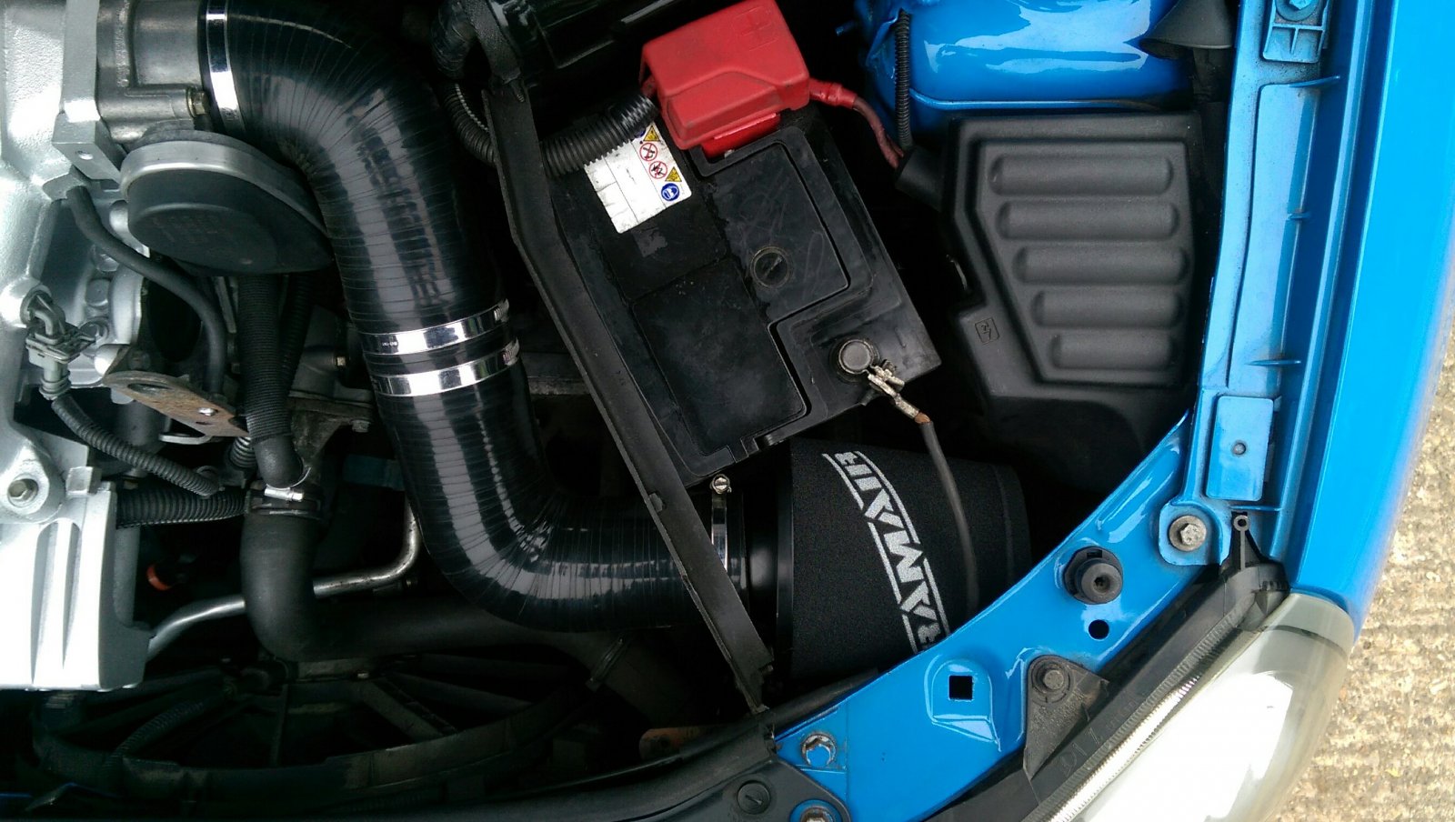

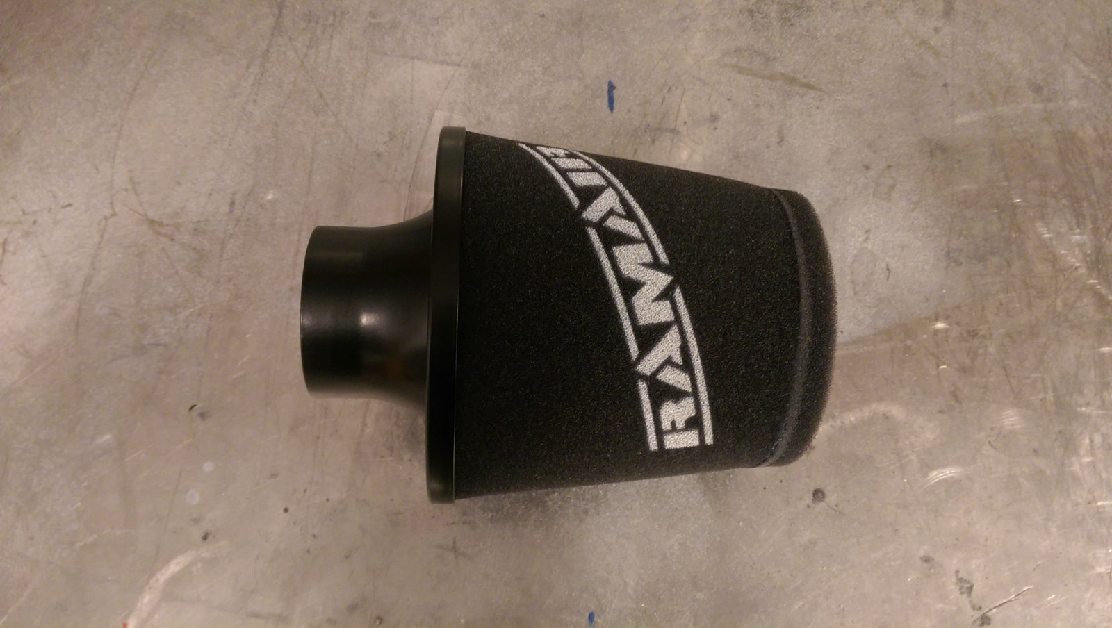

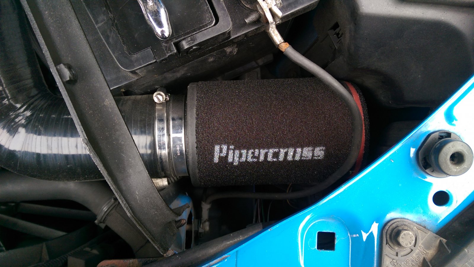

Not much has happened really. We go on holiday in 2 weeks so I'm keeping the costs down. I did however buy a new filter. Decided with a ramair one with neck, to feed into my silicone bend. It sounds so much better now, just like my old ITG setup. Happy days.

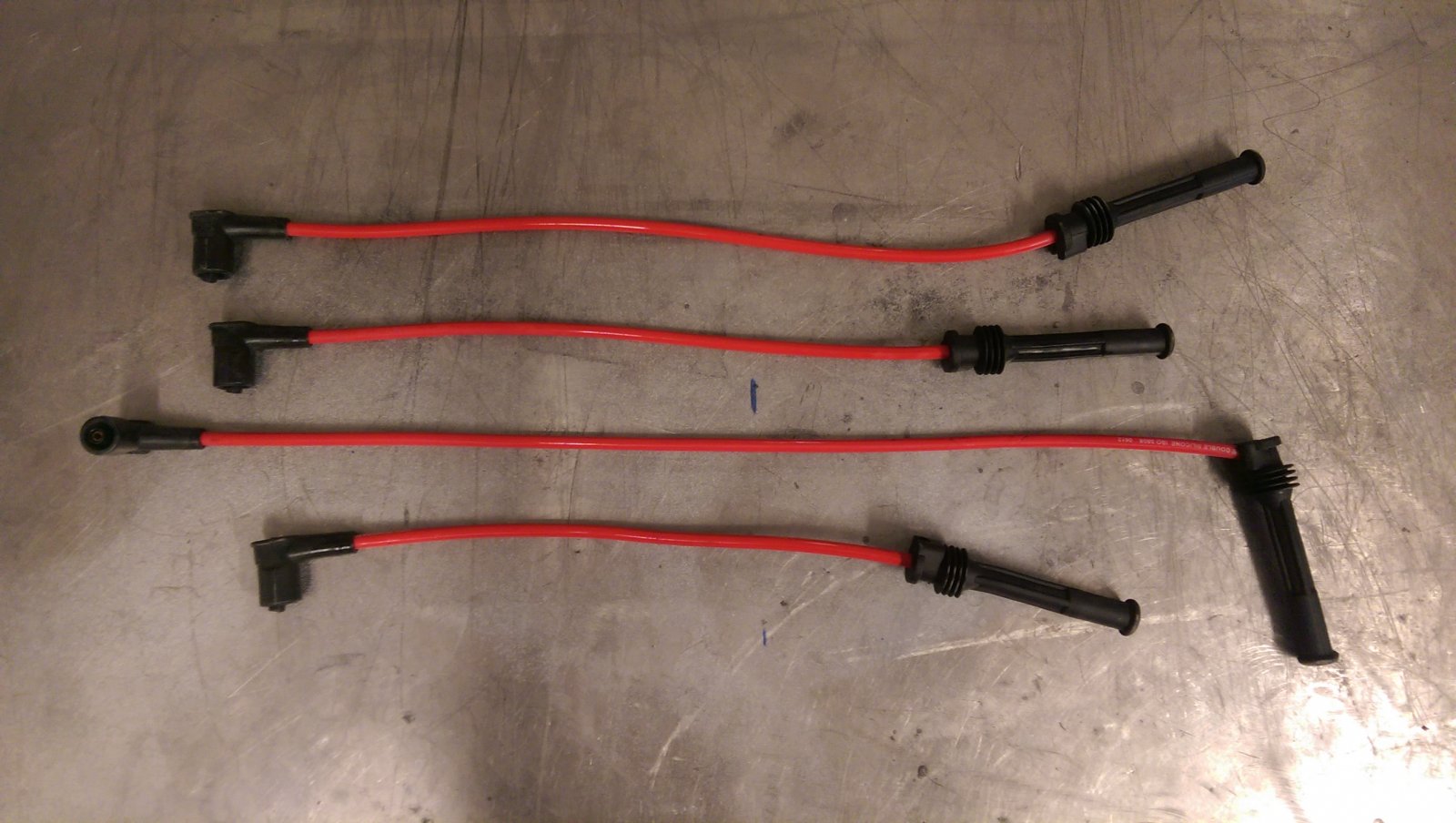

Once we're back off holiday, we have CSF to go too, which we are camping at, (well, hotel Friday night and camping Saturday night) then after that I plan to do the engine and caliper painting. I also got these of @Matt e so may fit these too while the inlet is off :smile:
I have a knocking around the gearbox, so I will do a nut/bolt check soon too.

Dan, it's not. I typed in 70mm rain air filter on eBay and this came up. It was the one I screenshot'd in the fatty thread.
