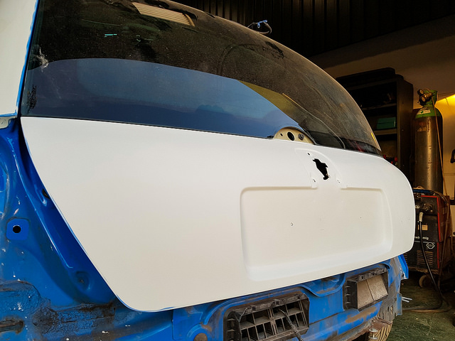

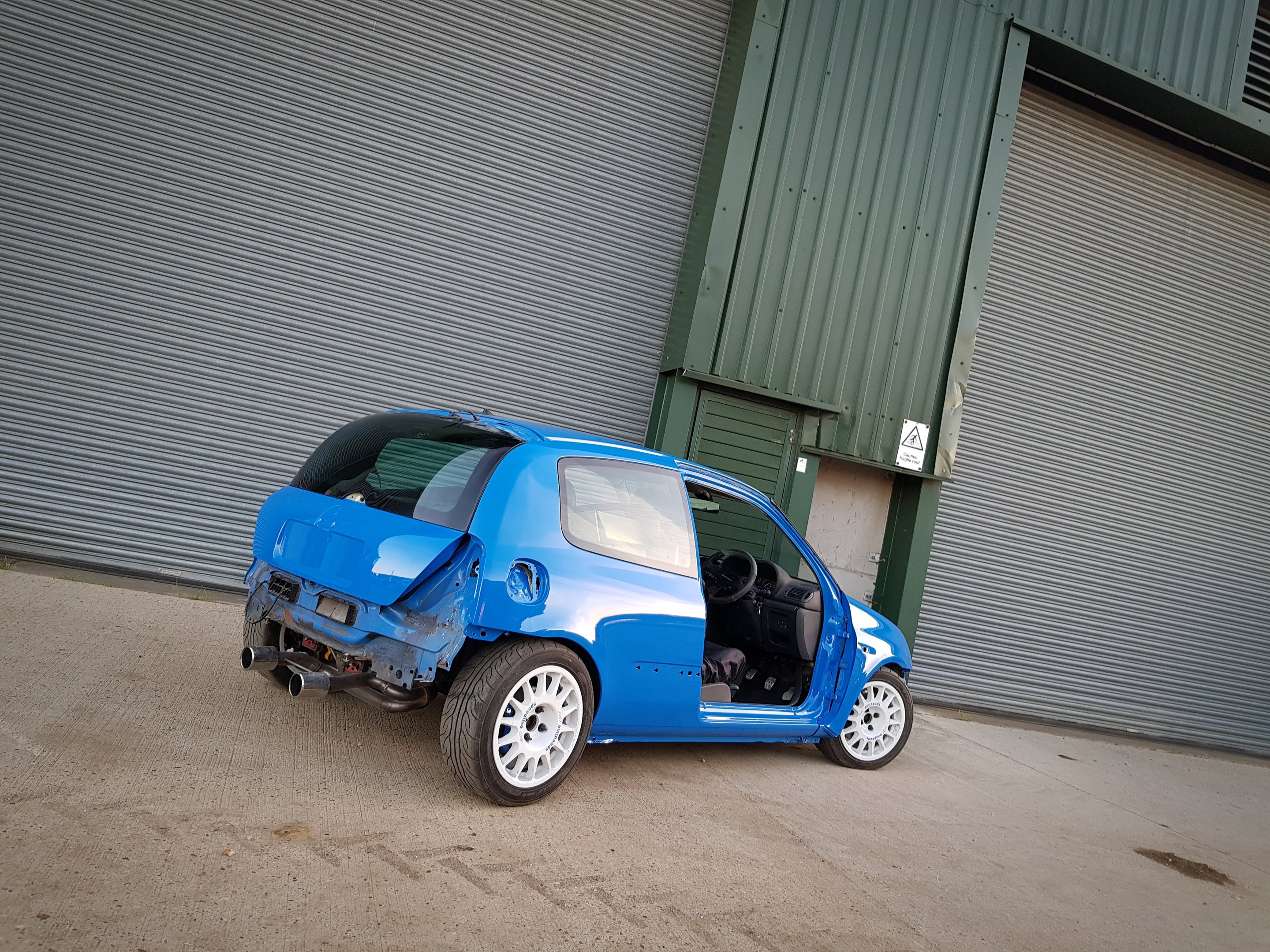

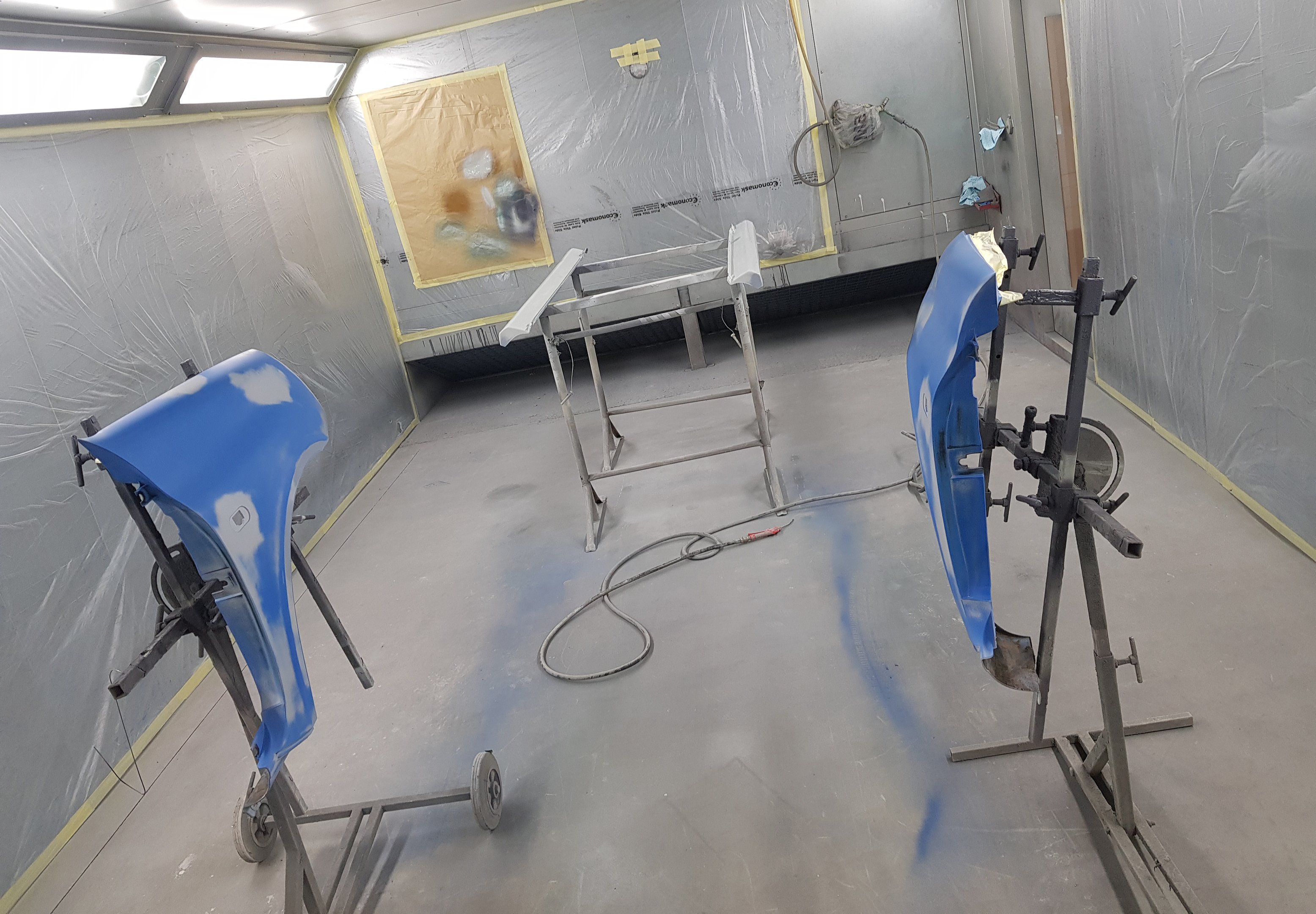

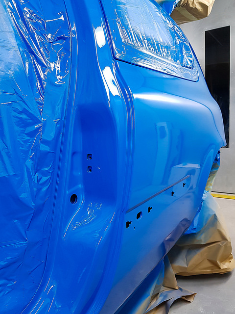

More bits done on the RB. Main bit is done, now its onto the smaller bits now.

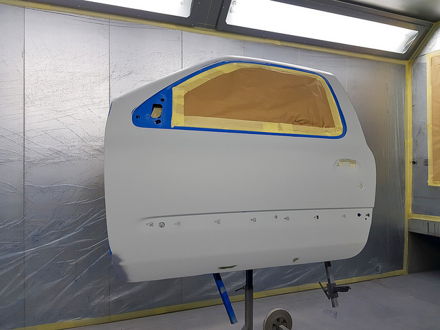

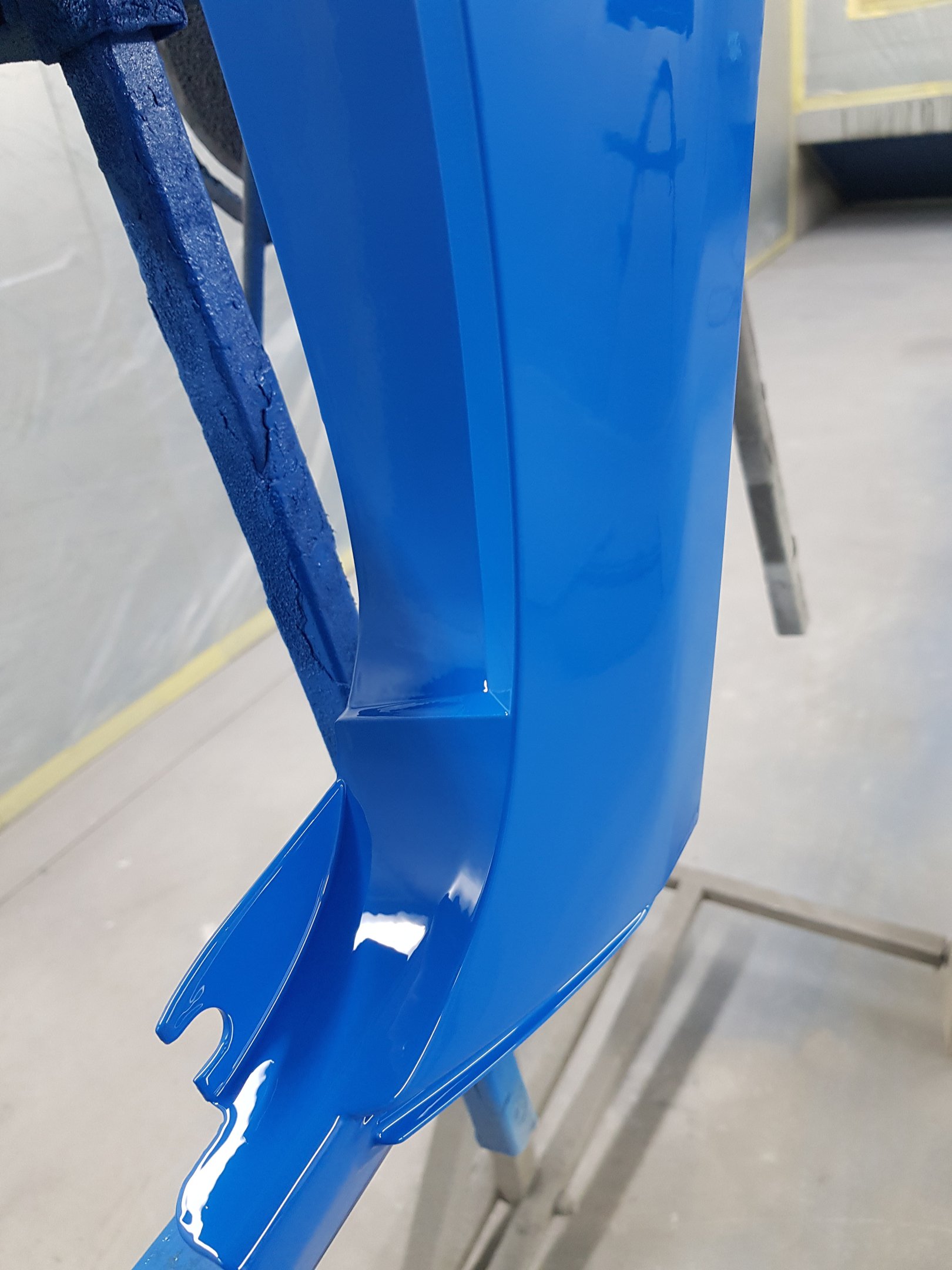

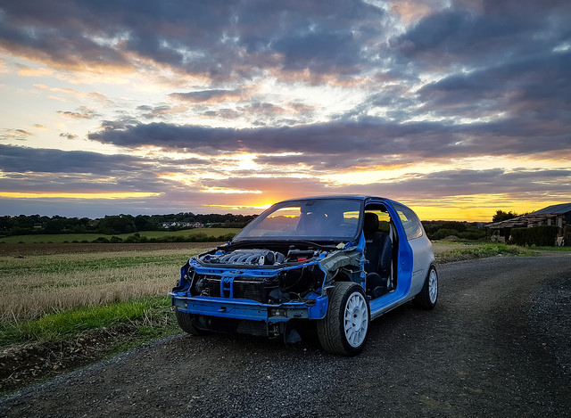

Door shuts prepped

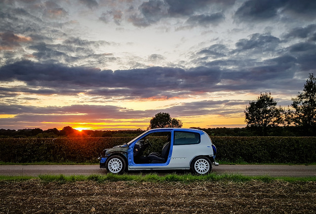

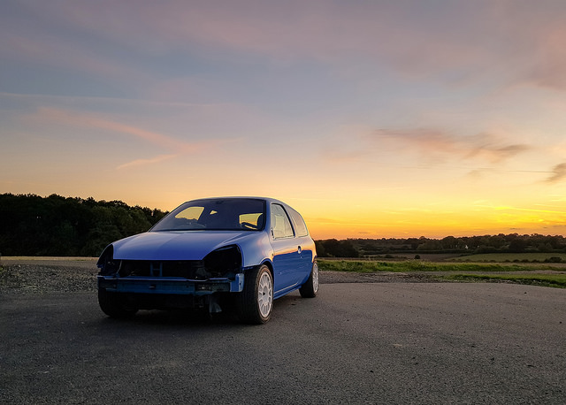

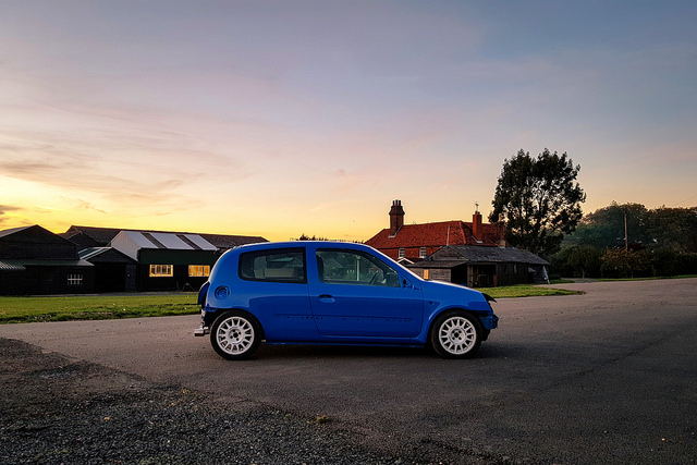

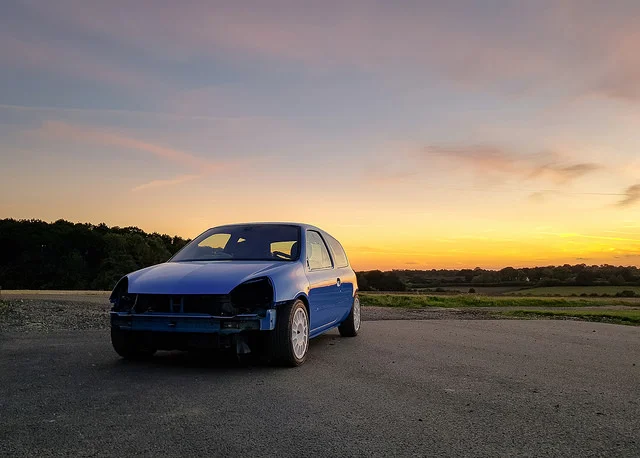

Took the doors off then took some sunset shots, mad max style!

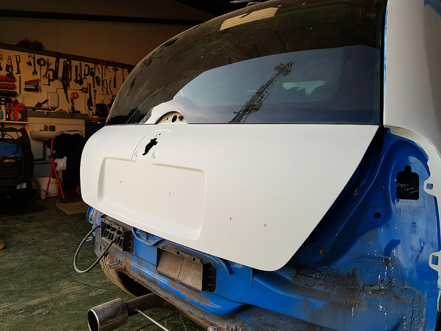

Prepped the bot and boot shuts

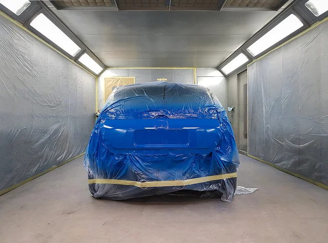

New paint

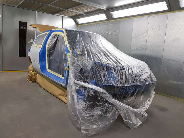

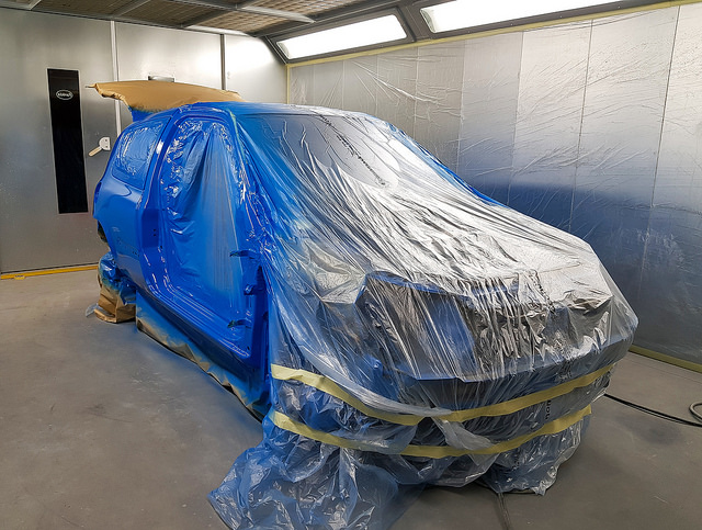

All masked up (will do the boot at a later date when doing other parts)

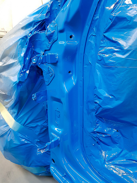

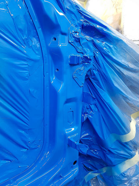

And got the RB blue again. Big thanks to Will again. for the paintwork.
It looks amazing. Happy Jekyll ?

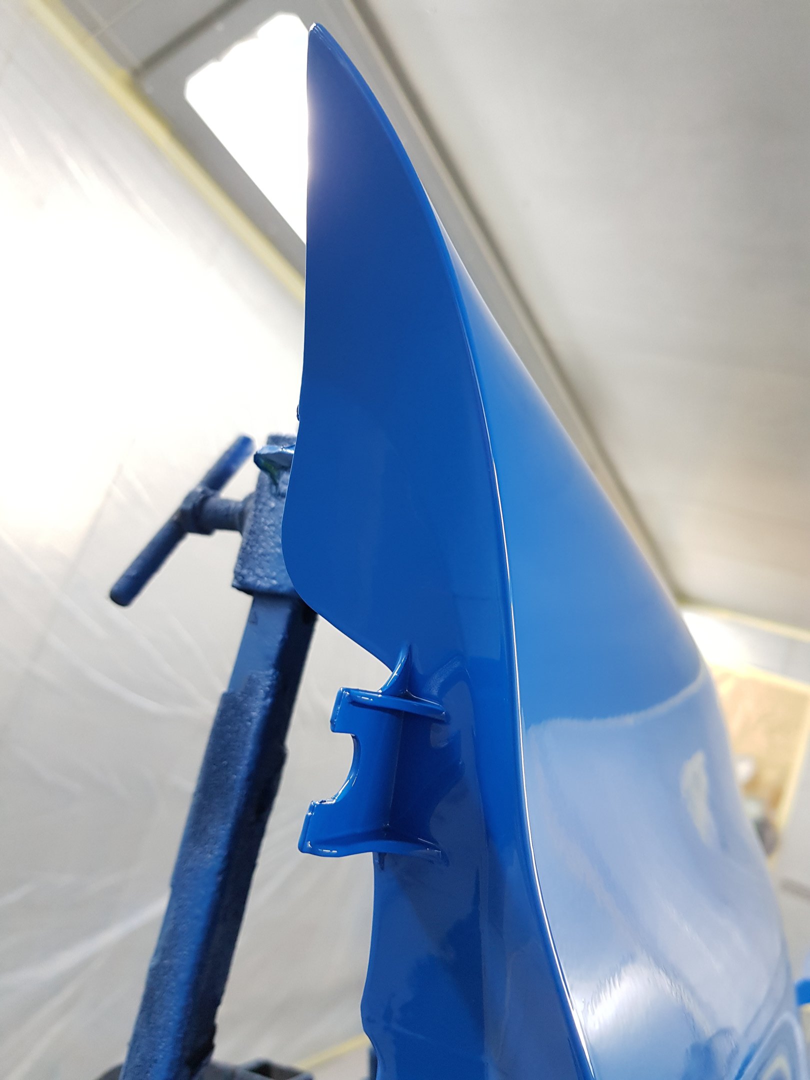

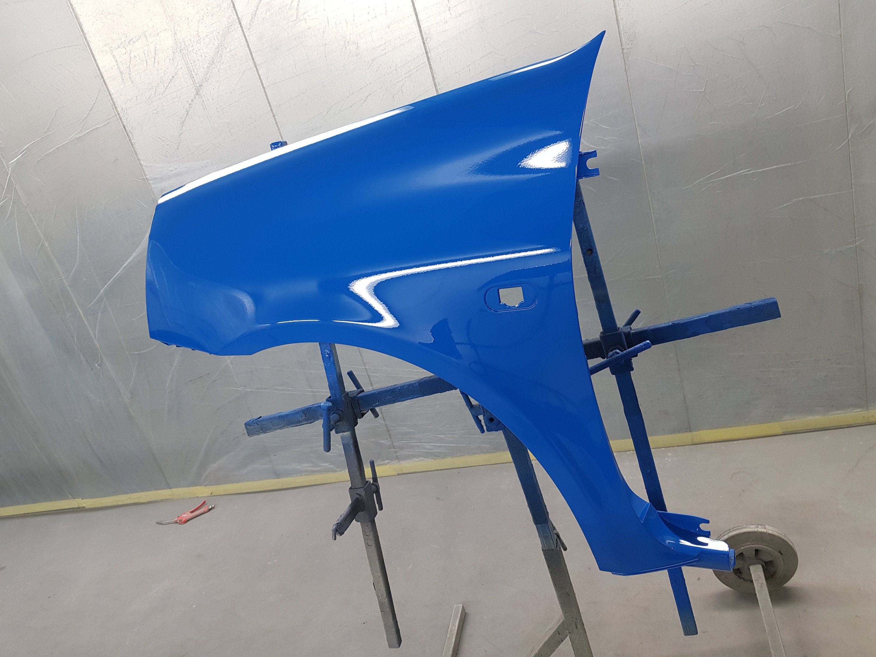

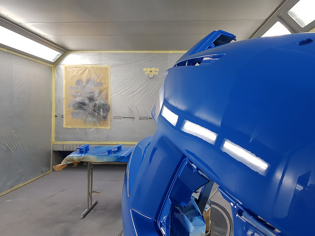

Got more bits painted on the RB tonight.
The finish is superb.
Hopefully get the doors and bonnet painted tomorrow. They have been final prepped tonight, masked up, degreased and are ready to go, so fingers crossed.

Jesus it looks so good when its naked in them sunset photos!
won't be long no though and it'll be back together!

I know mate. He said he'd get a good finish as you can't really polish in there and he has!
I've spoken to @LeeRS about the sticker. I'll hold fire until he can or can't do one and then I'll look further into it.

Brilliant. Getting a perfect finish in the areas where polishing is almost impossible once assembled is bang on - and way better than the factory to boot. Nice one.
Jekyll
100% agree. This is why he did it. I never even thought about it till after they was painted and he mentioned it. Glad he did it.

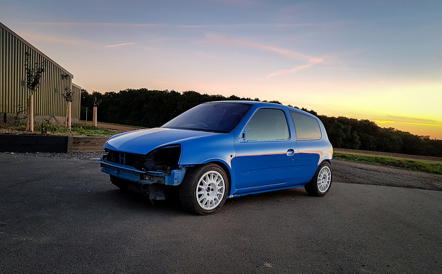

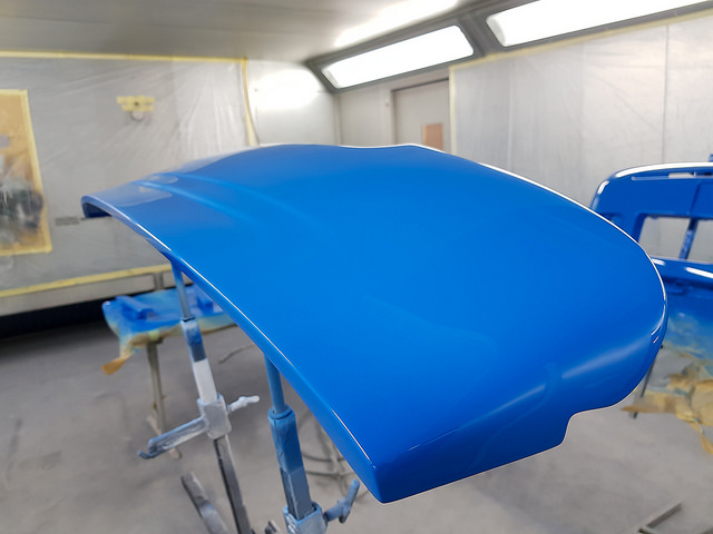

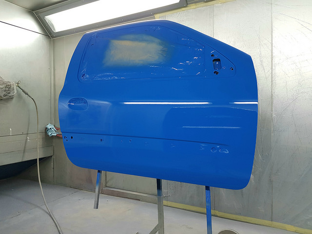

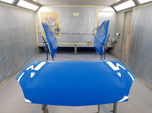

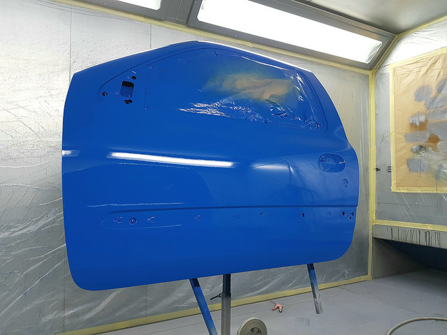

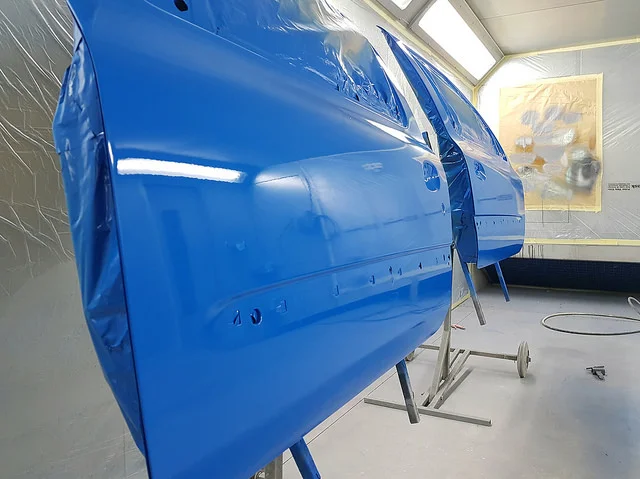

More bits have been painted. Bonnet and doors are now RB.

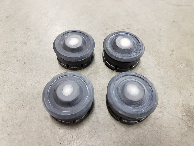

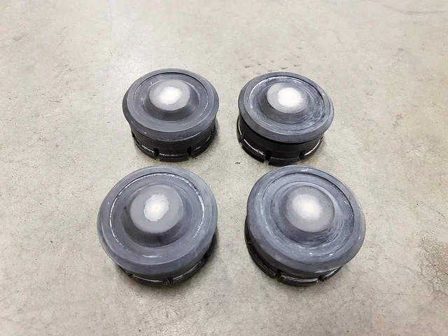

I fillered the center caps too as they have a little indent in them as standard and i wanted them flat in the middle. I just have to find a bright white to match my white 2118's but its hard to find the colour. Mine was slightly creamy and i want it bright white.

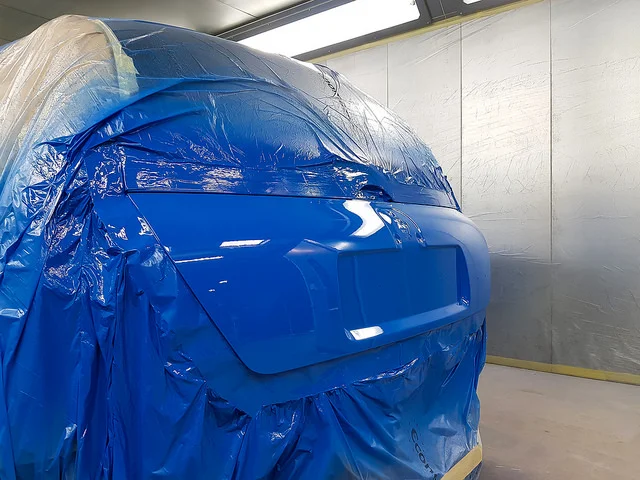

And this morning we got the boot painted.
The plan is to fit the doors after work and possibly the bonnet too. Fully fit the wings if we have time. And i think we may get a few more bits painted in between that but we will see what we are like for time and energy. Then Will is going to paint the rest while im away. Good stuff!

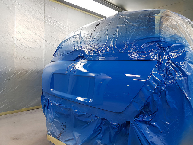

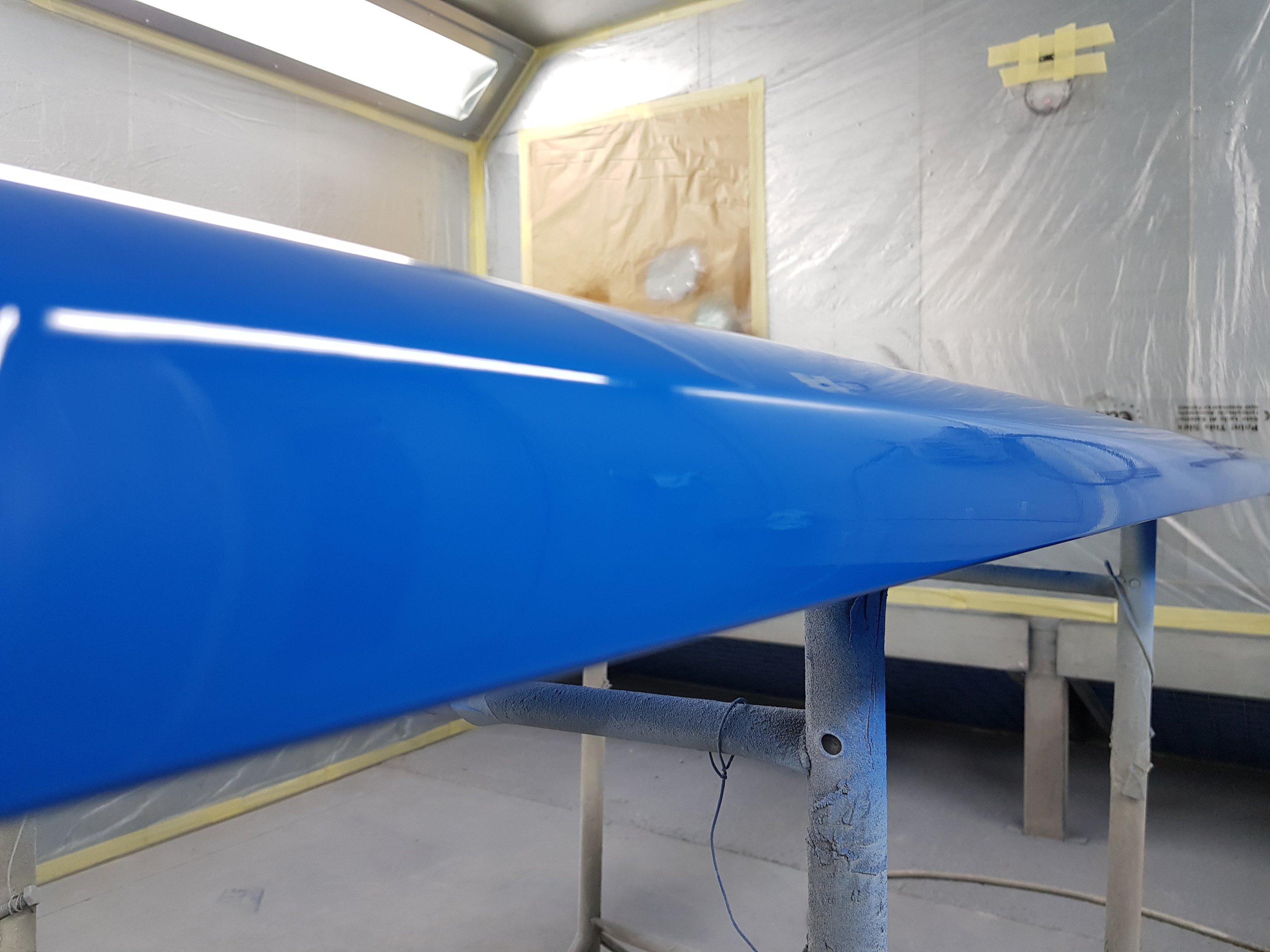

De-masked it and got out this morning. Had to take a couple of pics!
View attachment 1387520View attachment 1387521
It looks so smooth and perfect there. It'll look awesome when it's put back together mate. For the bullits how about some gris titane (697 titanium to us!) as it's a lovely metal shade and sparkly too??
Jekyll
Thanks Paul. It'll look much better once it's flat and polished. It feels good now seeing bits painted and going back on. Still a few hours to do though, but at least the worst bits are done now.

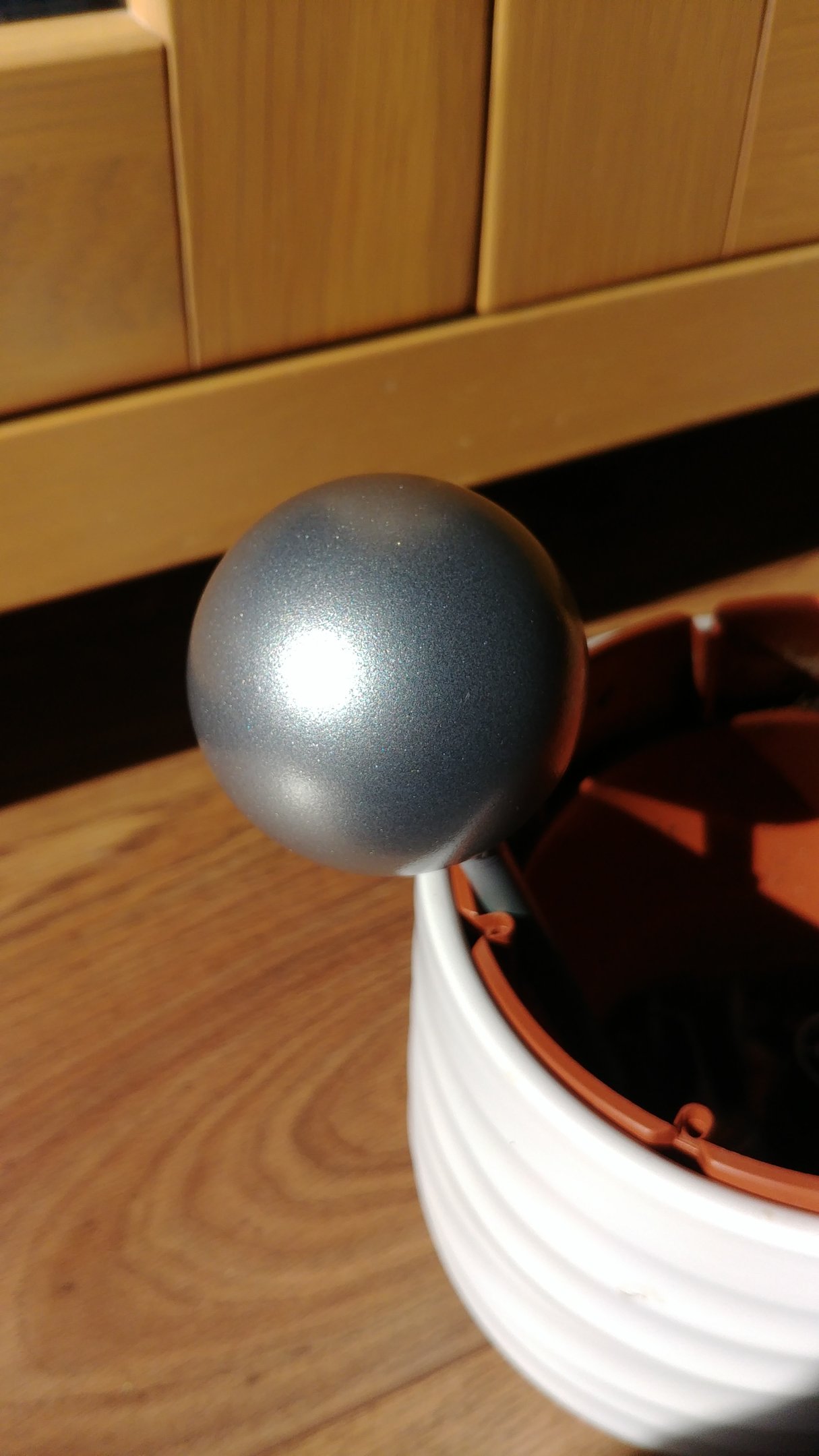

I like that grey too. Looks darker than titanium in the pic?

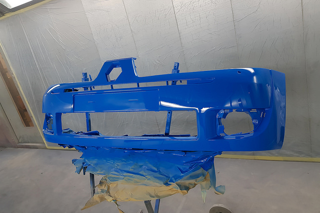

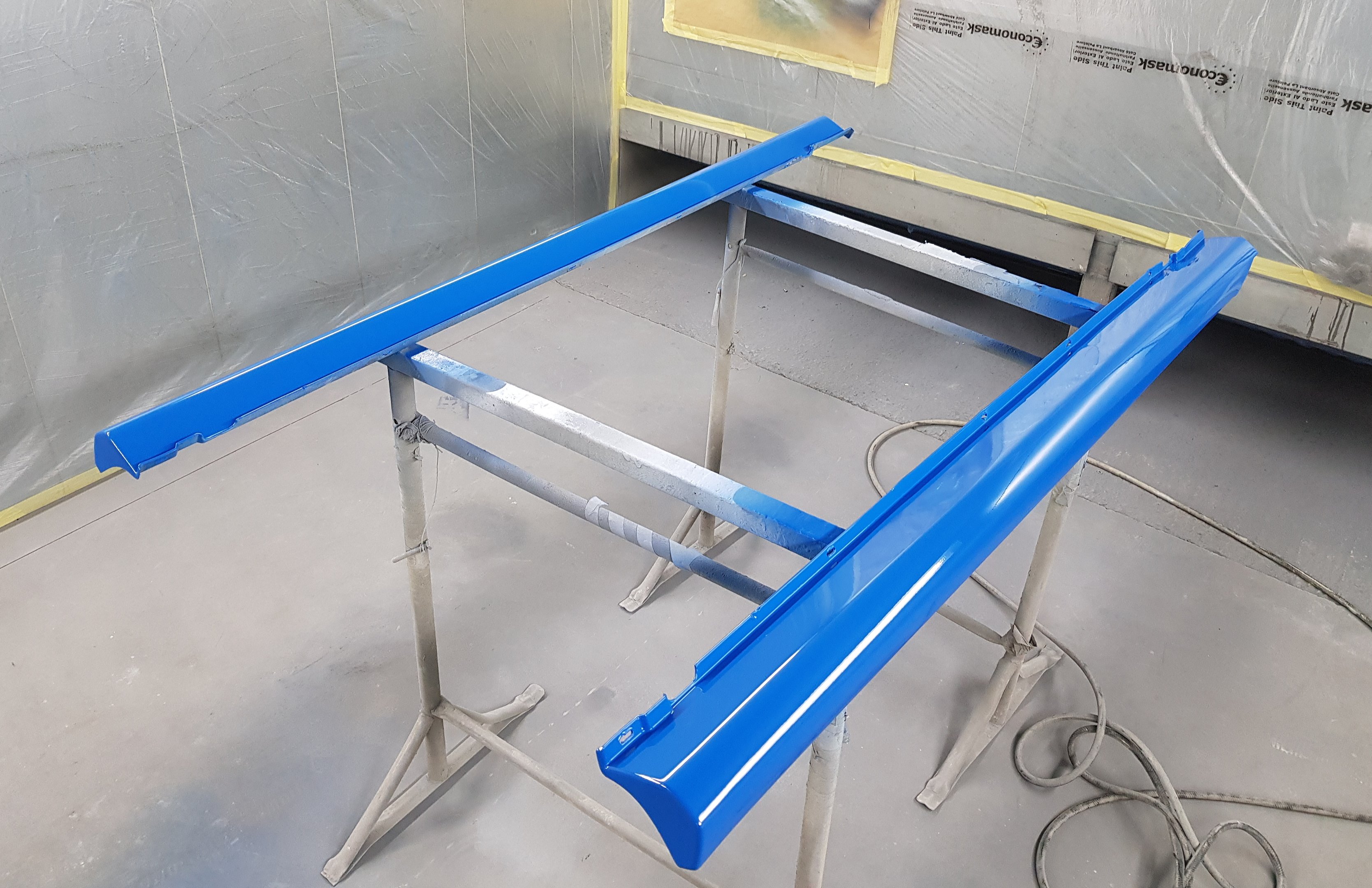

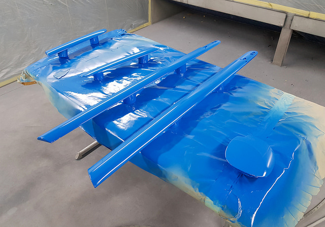

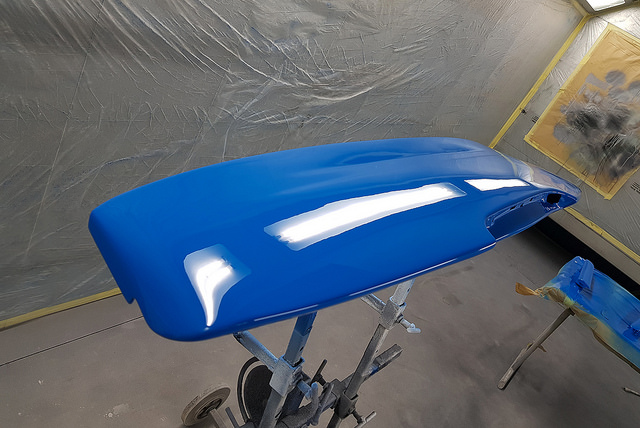

I got back to work thursday and we stayed on in the evening to paint a few more bits.

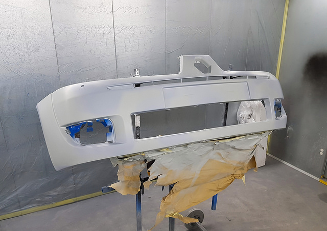

Front Bumper and spoiler ready for paint

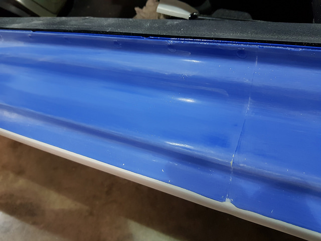

Side mouldings and fuel cap ready for paint.
We decided to use the original cap for now as it needed no primer. The new one comes unprimered and it was only the mechanism that was broken which needed replacing. Plus this has the stickers on the inside which are no longer available. Im still going to keep the new cap, just in case but there was noting wrong with this ones and it meant it could go RB with the other bits.

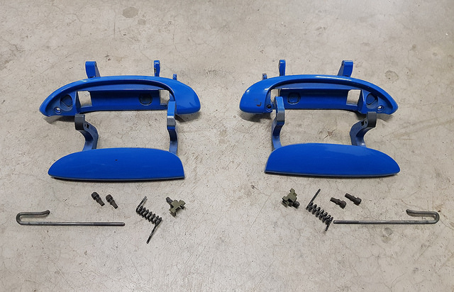

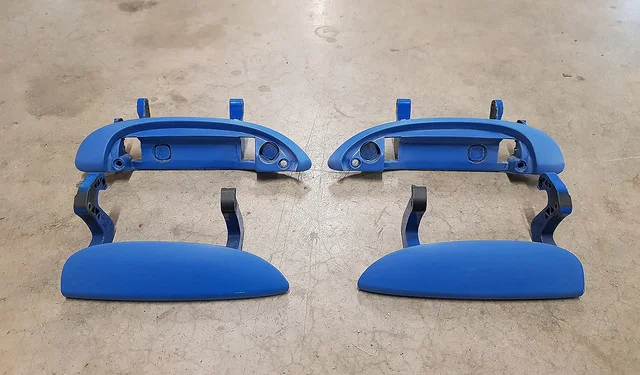

While Will was painting, i took apart my door handles and gave them a quick prep. They was actually decent condition and i thought about just polishing them up, but we have the paint so makes sense for them all to colour match.
Replacement door bullets came while i was away. Gve these a prep up too, ready for paint. Still undecided what colour yet.

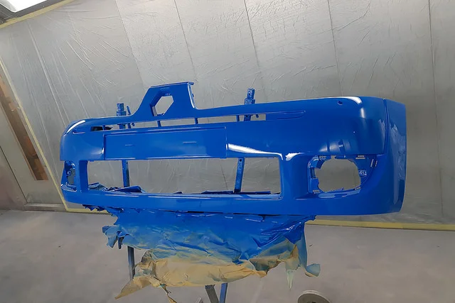

Painted bits done
I decided a while back to go wiperless, but i left the hole in the spoiler and im just going to add a grommet in there. I didn't want to take the risk of adding filler in the hole. You don't really see it as its curved round so less work that needed to be done.
Very happy with the results. The front bumper and spoiler especially look slick. The spoiler had been painted in the past but not that great and i had scuffed the front bumper, and it had stone chips and grazes, so now it looks ace. He also got it looking really smooth around the fog light areas and the strip/grill under the badge, on the hard to reach to polish areas.

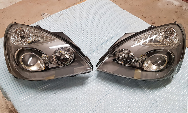

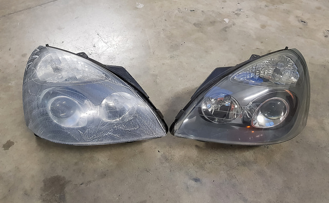

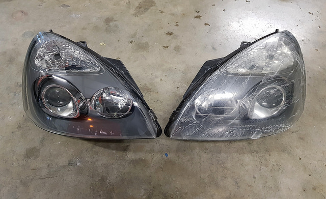

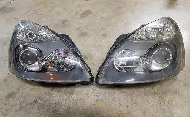

Then last night, i stayed behind and gave my headlights a polish with the mop. I did 2000, then 3000 on a trizac pad, then green, yellow and blue polish. They have come up great. I didn't think they was that bad at all but wanted them looking fresh next to the new paint work. You can see on the comparison, that it looks better. They are not "brand new" looking and still have imperfections, but they are 14 years old so that's to be expected but they look great now i think.
Original on the right, not that bad tbf.
Polished vs Unpolished
