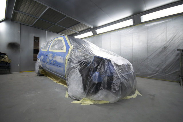

I need to get a crack on now as things are happening. Not only is this car being sprayed, but me and Emily have CSF at the end of the month, then next month the car shall be finished, I'm doing a 13mile obstacle course run and we have just bought a property which we should be moving into at the end of September and we are also away to Portugal at the end of September for our honeymoon/1st years anniversary.

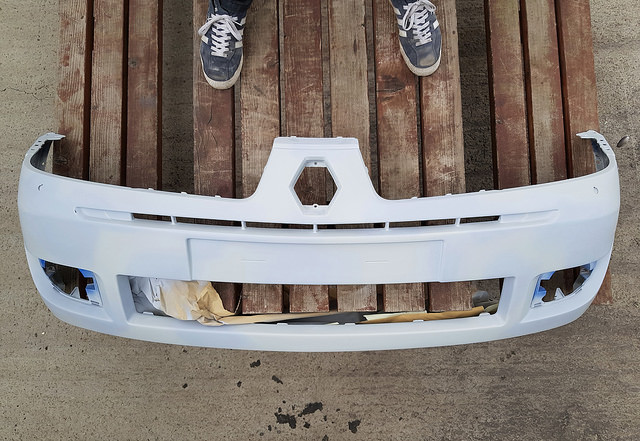

I used it on the front bumper. And the plan is to take more off. I certainly don't want sinkage!
Not trying to teach you to suck eggs mate, I worked in a bodyshop and as you know this stage of prep is key to a good job. Doesn't matter how well you put the paint on the prep is makes a great job or a dog.
Stripping the bonnet was a good move, saves rubbing down the stone chips and stops any sinkage issues and lots of layers of paint doesn't give a nice sharp finish.
We used to wet flat primer with 800 even for a straight colour this again stops any paint sinking into the sanding mark's

Not at all mate. I'm kinda new to it all and to be honest, I'm being guided through it.
Yes I know it's all in the prep work. Good paint will show up bad prep so best get it good beforehand.
Yeah we did decide on paint stripping the bonnet for that reason. It's a little harder elsewhere. The painters are confident that more can be doen kn the rear but not all to bare metal. The sills was the only other parts, due to chips as you know.

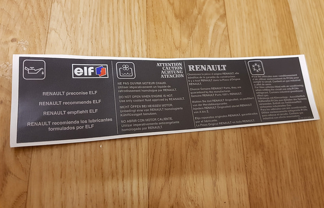

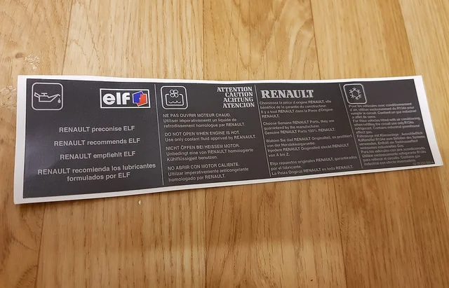

I actually want to ask you floor another one: the recommended fuel one that goes on the inside of the fuel flap.

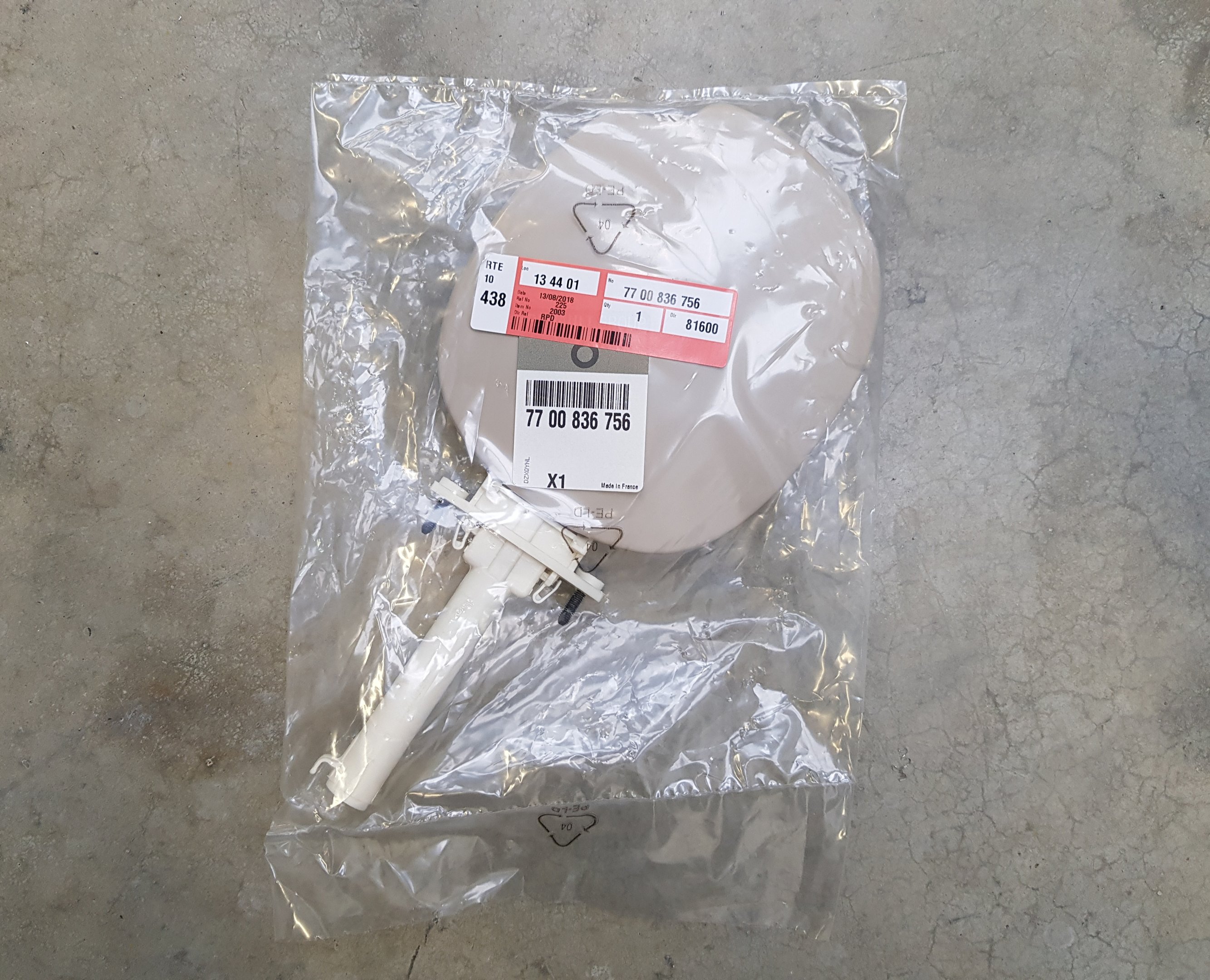

I was just going to use my original kick plates and double side tape them down again just like before. I dread to think how much they are new from Renault! Tbh mine are in good condition.
As for the stickers, I'm going to see if I can get them from Renault. I know you used to be able to a while back but they are discontinuing a lot of mk2 stuff now so will see if that are still available.

I didn't get much done on the RB last week as i was busy doing other things.

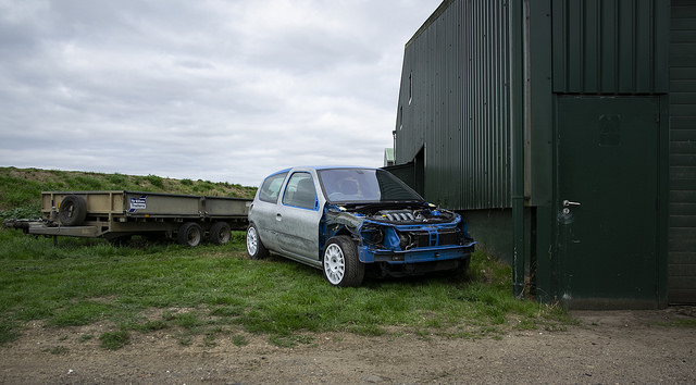

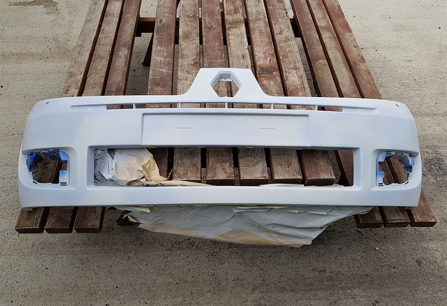

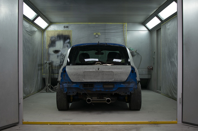

The bonnet has been rubbed down and is ready for paint. No pics of this. The bumper is now in the same stage.

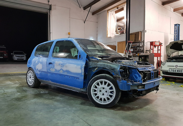

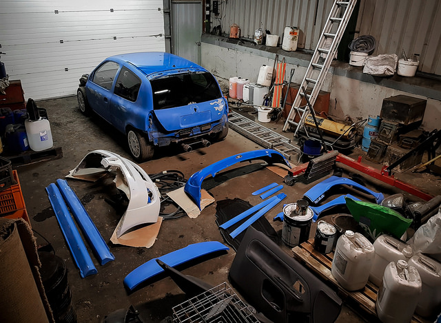

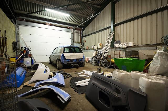

The RB's current residence and state.

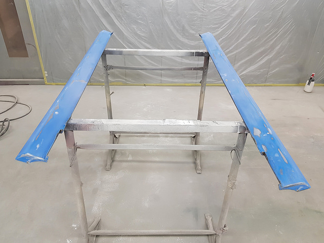

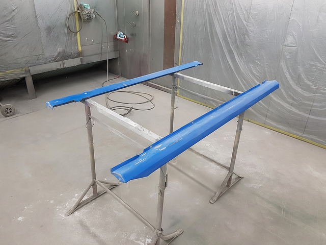

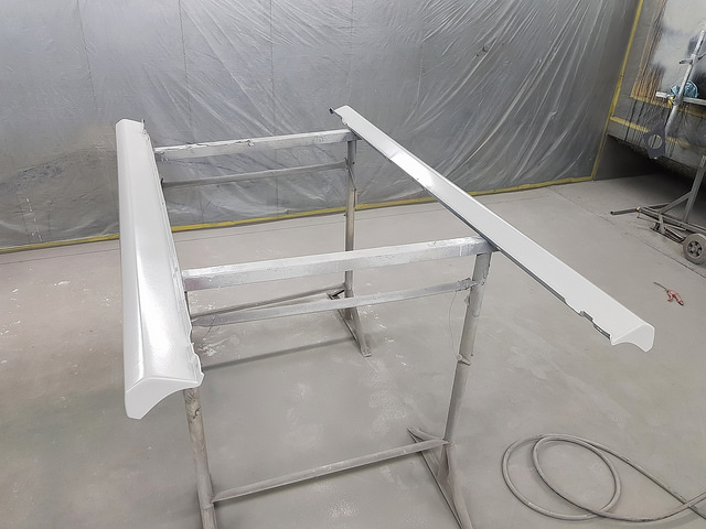

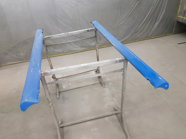

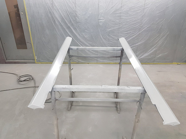

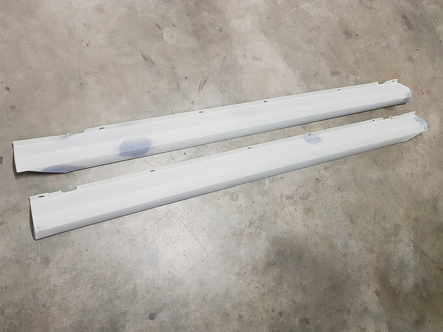

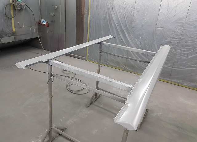

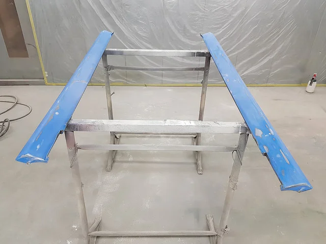

I did get the side skirts prepped and tonight i stayed on and got them primered.
I've ordered new push clips for the inner arches and new torx screws for the inner arches to connect to the bumpers.

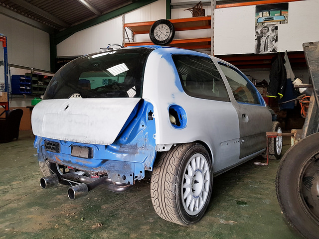

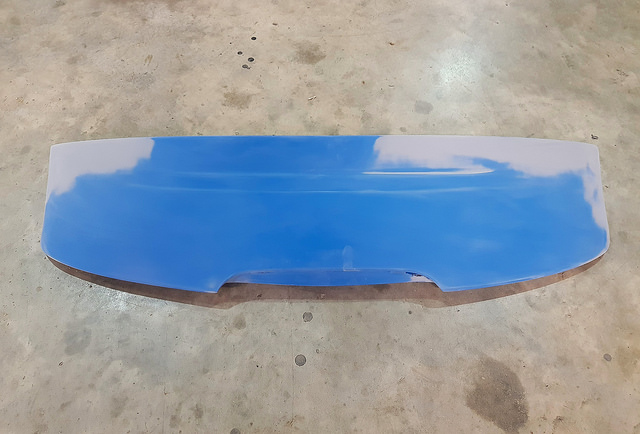

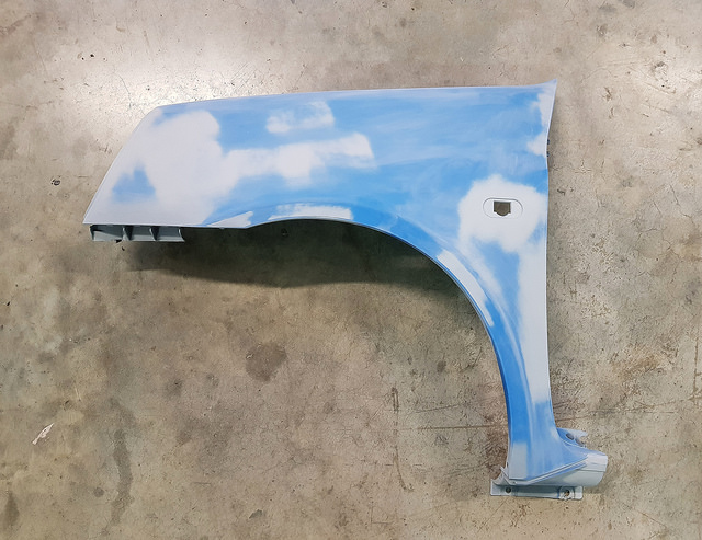

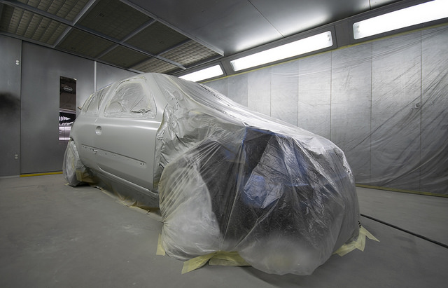

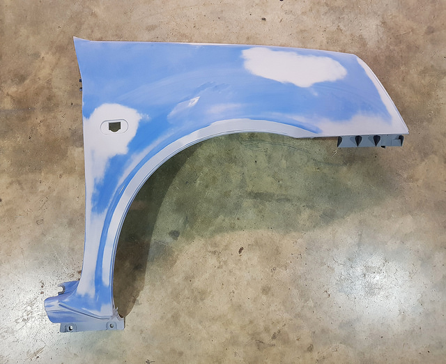

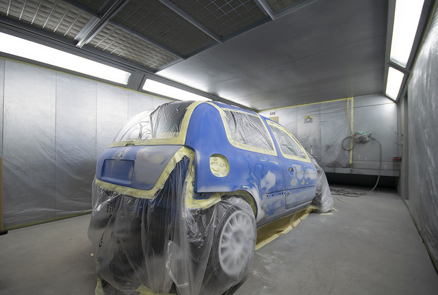

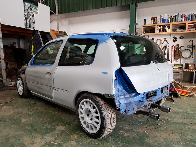

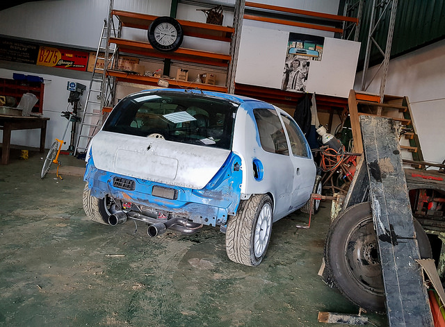

Got more done on the RB. The wings, door mouldings and spoiler was all in decent condition, so I DA'd them through the grades as there was no need for full primer. I used a small amount of primer on sections on where I broke through. All panels are good though so needed little work.
More filler work and the car was prepped for primer.

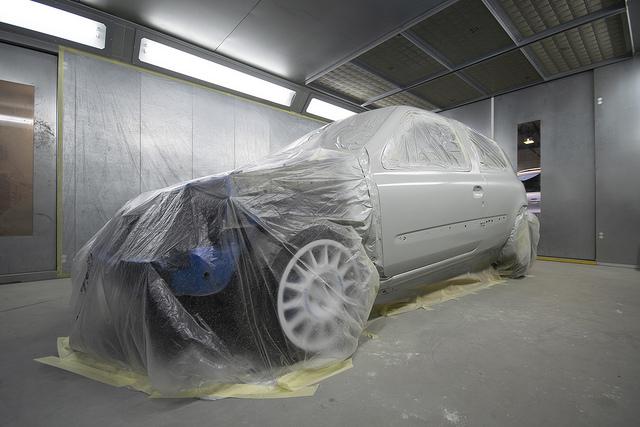

Stayed late one night and masked it all up.

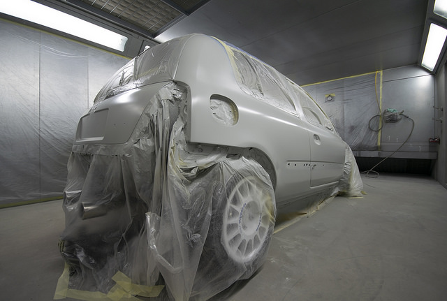

And got in early the next morning with Will and it was etched and primered.
It's all primered now so we gave it a quick satin black guide coat and then I put it away in the barn for it to sit for a week or so.
The RB in it's current habitat next to the alternative daily! Good way to keep fit I guess when you haven't got a car and the missus needs hers. It's a 15mile ride each way to work so certainly gets the miles in.

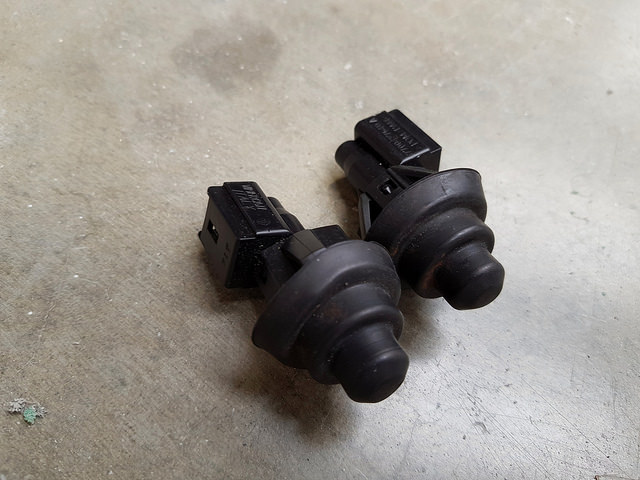

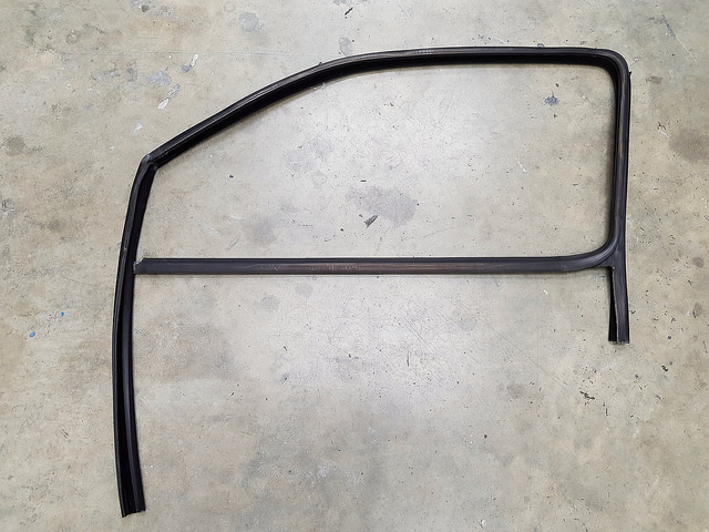

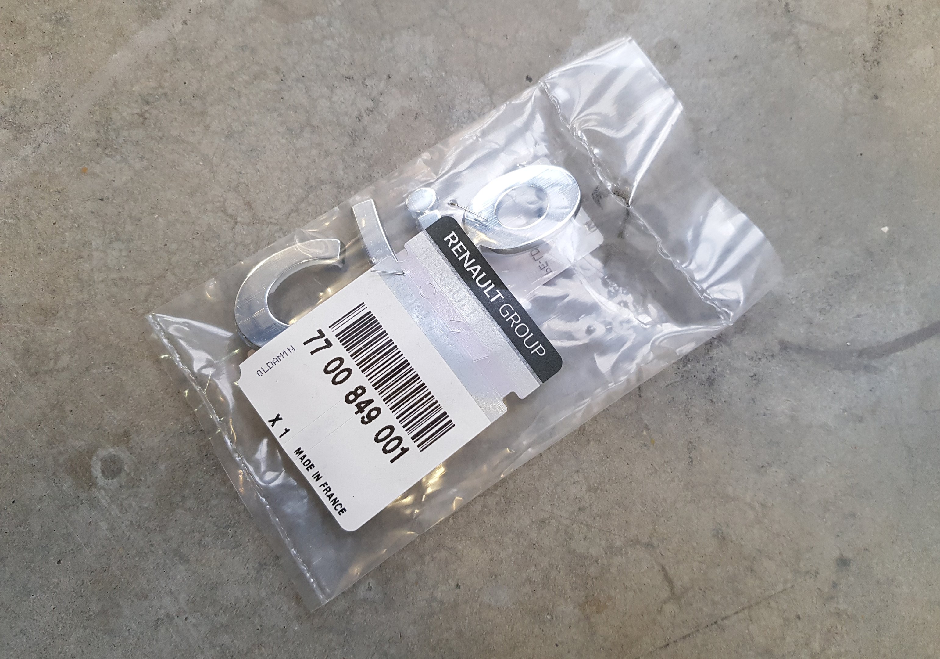

My replacement window seal and door light sensors came from @Mbeau. Thanks bud.

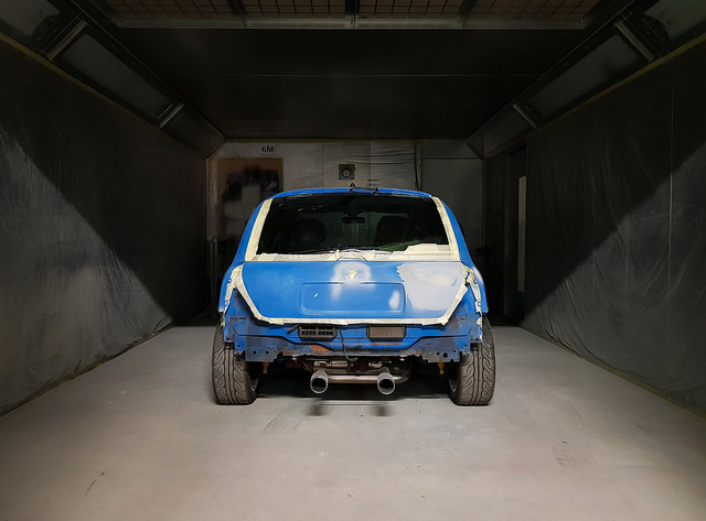

Got back and in between work and home life, i got a bit more done on the car.

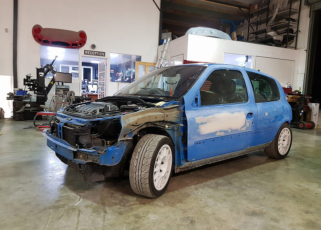

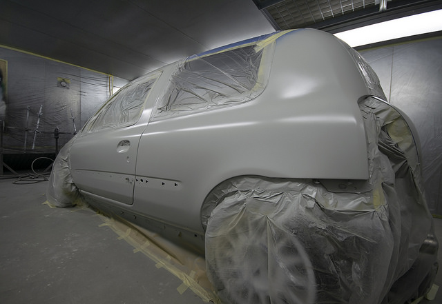

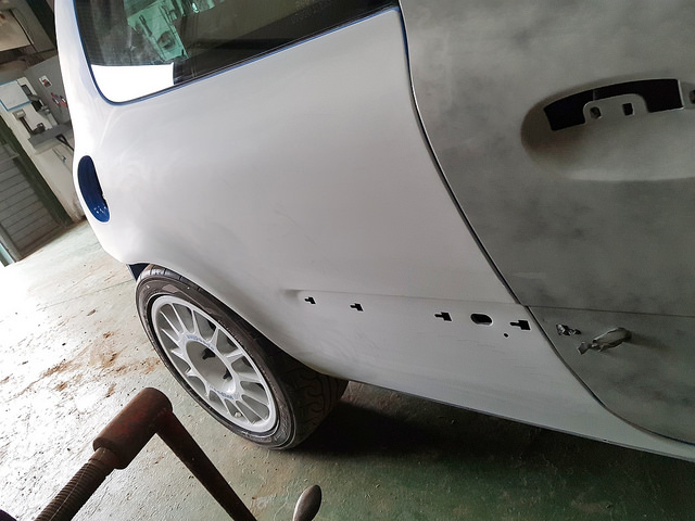

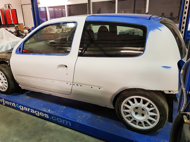

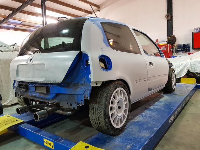

One night, me and Will got the rear quarters prepped.
Then another night we got the doors prepped.
All parked up in the farmers barn/workshop as my "normal" barn is being used for other storage at the moment.

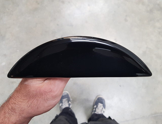

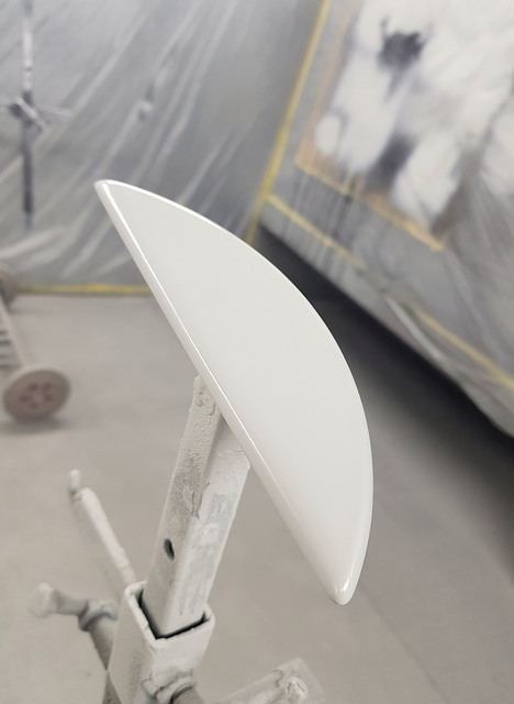

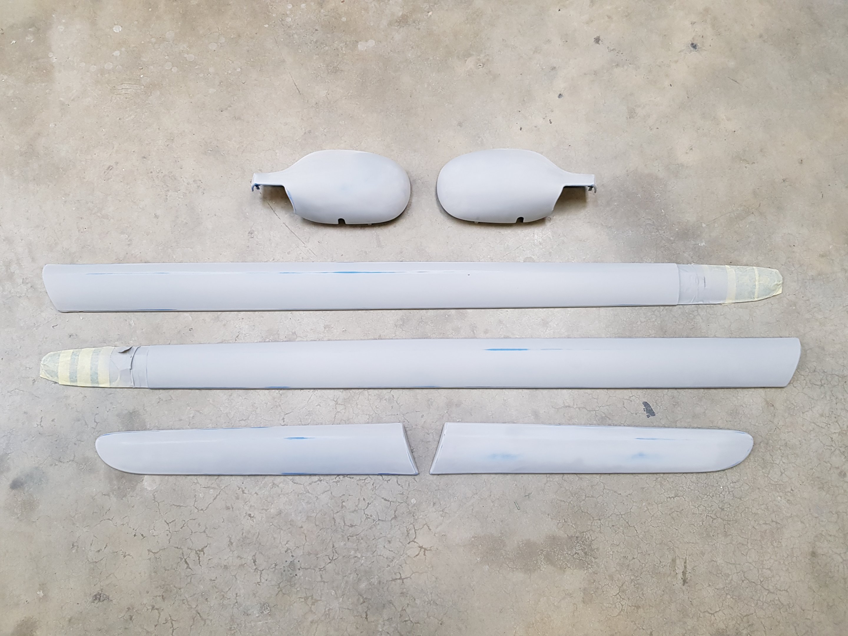

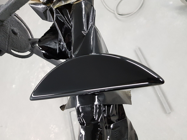

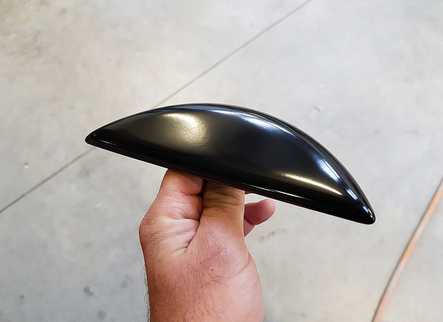

Prepped my wiper blank and primered it, then painted it in 2k satin black, left it for a few days, then flatted it and polished it. It looks gloss in the pics, but its more satin in person.

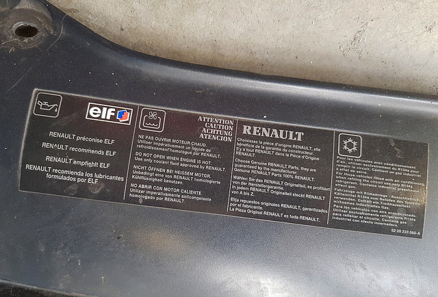

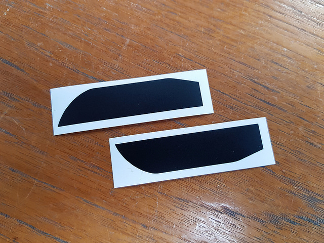

@Louis linked me to a guy selling the left handed grill stickers. Renault dont sell them anymore so i bought one. Looks decent.
My old one:
Just need to get this one now. Unsure if these are still available.
Also Renault no longer sell the front bumper stickers so i purchased a set from ebay in satin black.
