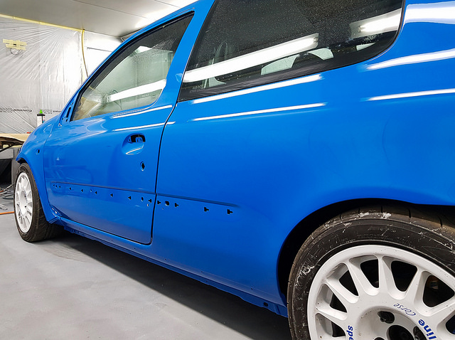

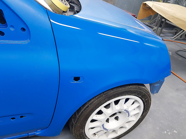

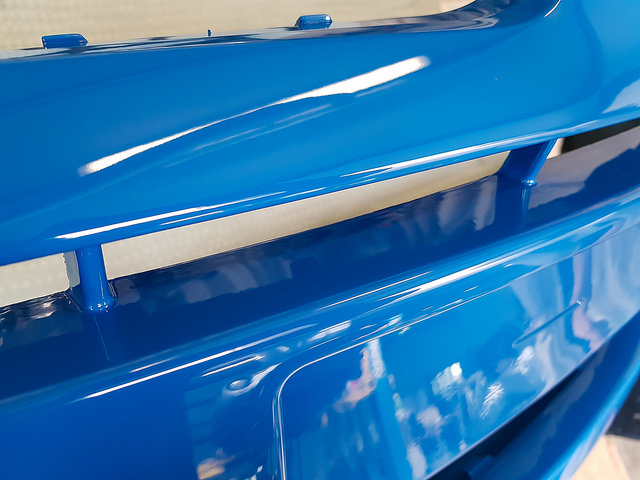

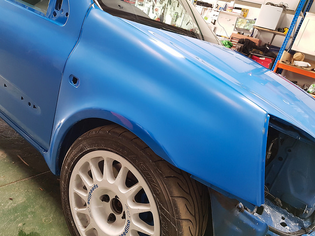

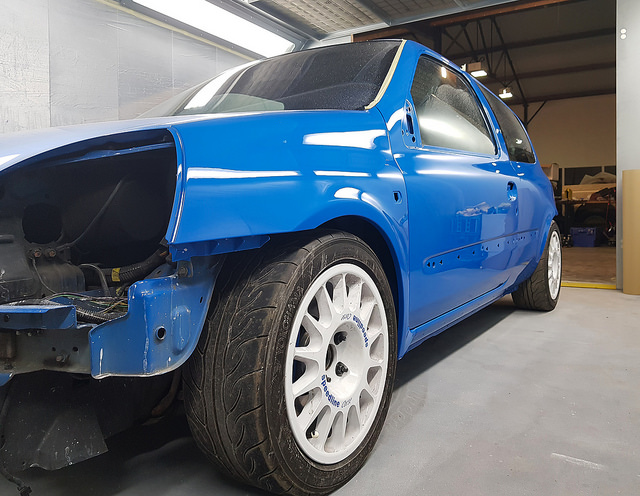

Got more done on the RB. Today me and Will got into work early and made a crack on the flatting. We flatted all the panels in 2000 and then went over with a trizac 3000 pad to even it all out. He was much quicker and better than me, but having 2 people on it mad lighter work. The bonnet, boot, doors and quarterss are now flatted, ready for polishing up. There was no point doing the lower part of the car as the finish is really good and you dont notice it.

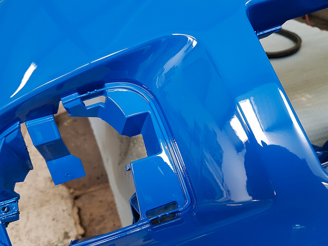

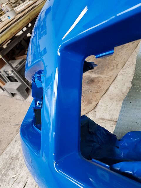

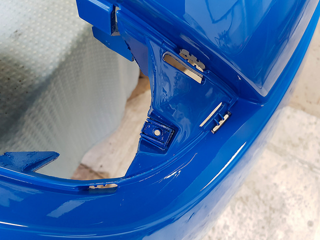

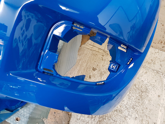

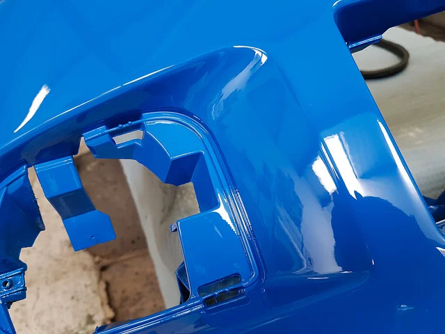

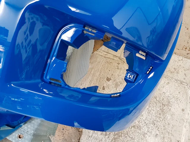

And a few pics to show how good the bumper is on the hard to polish areas.
And my stack of painted parts waiting to be fitted. (Rear bumper was done a few months back so that didn't need redoing, just a clean up as its collected dust.)

How good is on the hard to polish areas or how perfect it is?
I'm afraid I'm not sure I understand your post mate?
Radugns
  Clio 172 ph2
You said how good are the areas on the bumper that are hard to polish. They are not good, they are perfect.

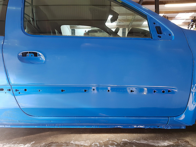

Yes he's done a fantastic job. I started to flat areas on the bumper, spoiler and moulding tonight but it really does need minimal work. I just flatted some dirt bits and that was pretty much it. I feel I'll be flatting it for no real reason. I don't want it looking like glass as it never left the factory like that. I want a factory finish.
We didn't even get rid of all the ripples down the doors as they are press marks. It's not a show car, it's a clean daily. The dents are gone though.

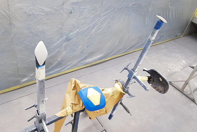

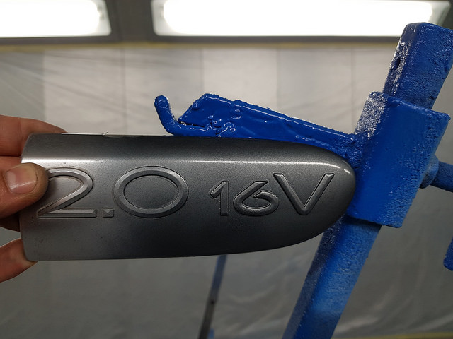

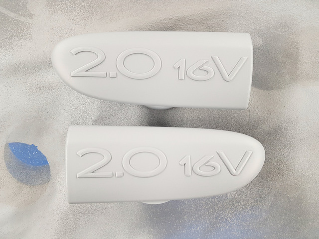

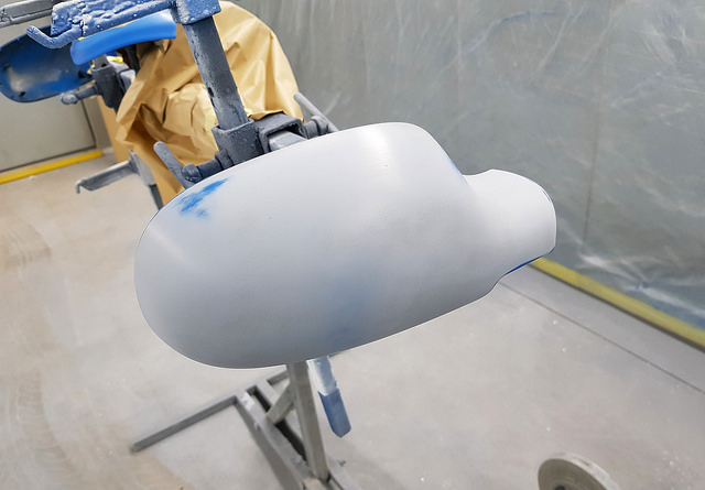

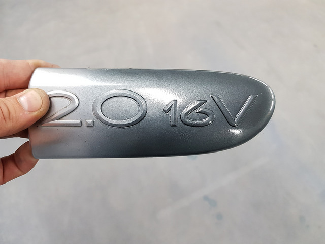

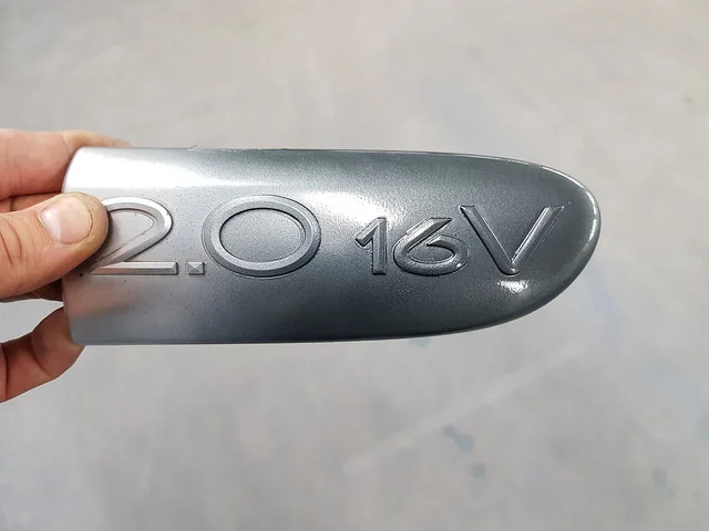

More work done on the RB. The side bullets are now primered and waiting a colour. I did choose Ford Polaris Grey (the same as my engine) but i had a slight doubt, so i tested it on a spare old bullit. In certain lights it looked ok, but it looked to dull in others so i decided not to use it.
Nice and light here, which is what i like
But too dark and dull here, next to RB paint too
The pics don't really show its true colour as it was quite light in the booth. Once outside, it looks a lot darker. I wanted a silver of some sort. I went into halfords to see what they had and i settled on Renault Iceberg silver. Did a test piece on a strip of aluminium (no pics) and it looks like what im after so i'll go with that. Plus it's a little homage to my old Iceberg PH1. I will use proper laquer on it when we paint my remaining RB bits.

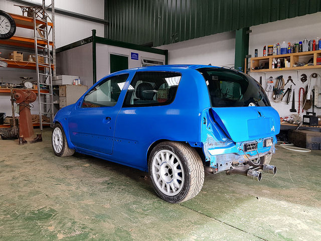

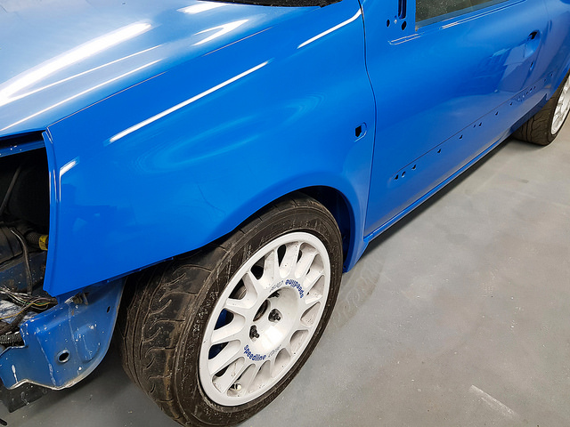

Did some polishing tonight. This is the cutting stage and even now it looks great. Really happy seeing it starting to take shape.
Passenger side done
Drivers wing done
Long process, especially after a days work, but nice to see the slick results. As i said, this is the 1st stage, it'll look even better once we put on the finishing polish on it ?

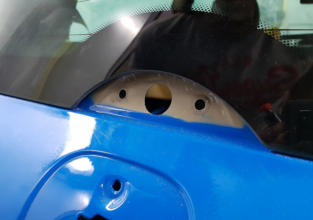

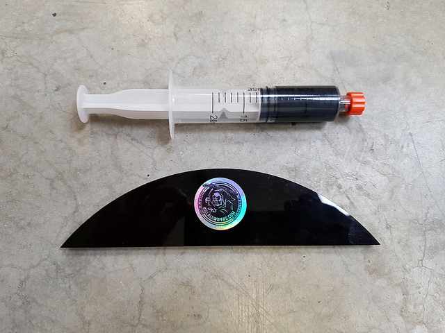

My kill all wipers kit came today and it looked decent. Better than expected actually so i decided to fit it.
You get sealer and a fitting guide that is unique to the mk2 clios, not a universal one. And the sticker/logo is right in the middle of the rear hole if you have a stripped car so you can see it. Looks like time has gone into the kit. Ignore the marks, that is degreaser that's wiped the excess sealer. We degreased it so its all washed into the groove and neatly finished. Will get a better pic later on.

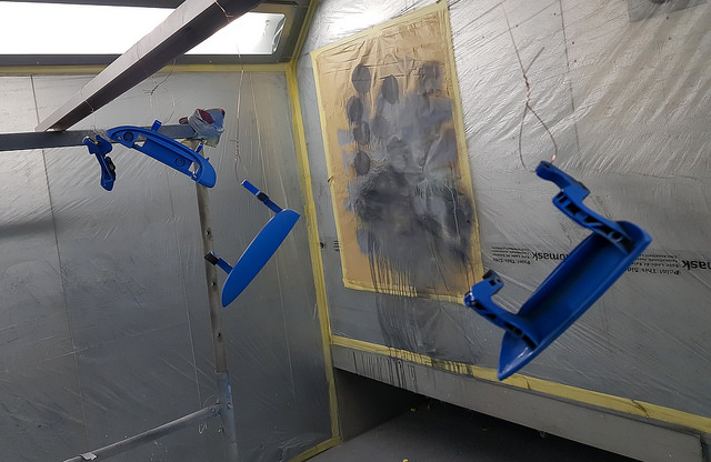

Got the last of the RB bits painted and got the bullets done too.
Im thinking of doing the dash strips and clock bezel in the same iceberg silver now after seeing the bullets. This will be date at a later date if i do decide to do so. Hopefully, more polishing tomorrow.
