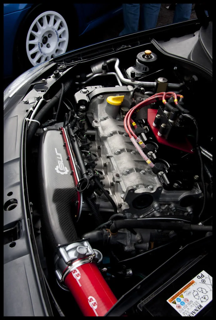

Right onto the car:
It began life as a ff 182, the road spec was effectively a mild braking setup, RS2 Manifold & AST coilovers valved to suit track orientated spring setup. A couple of Bimarco Seats and that was about it.
