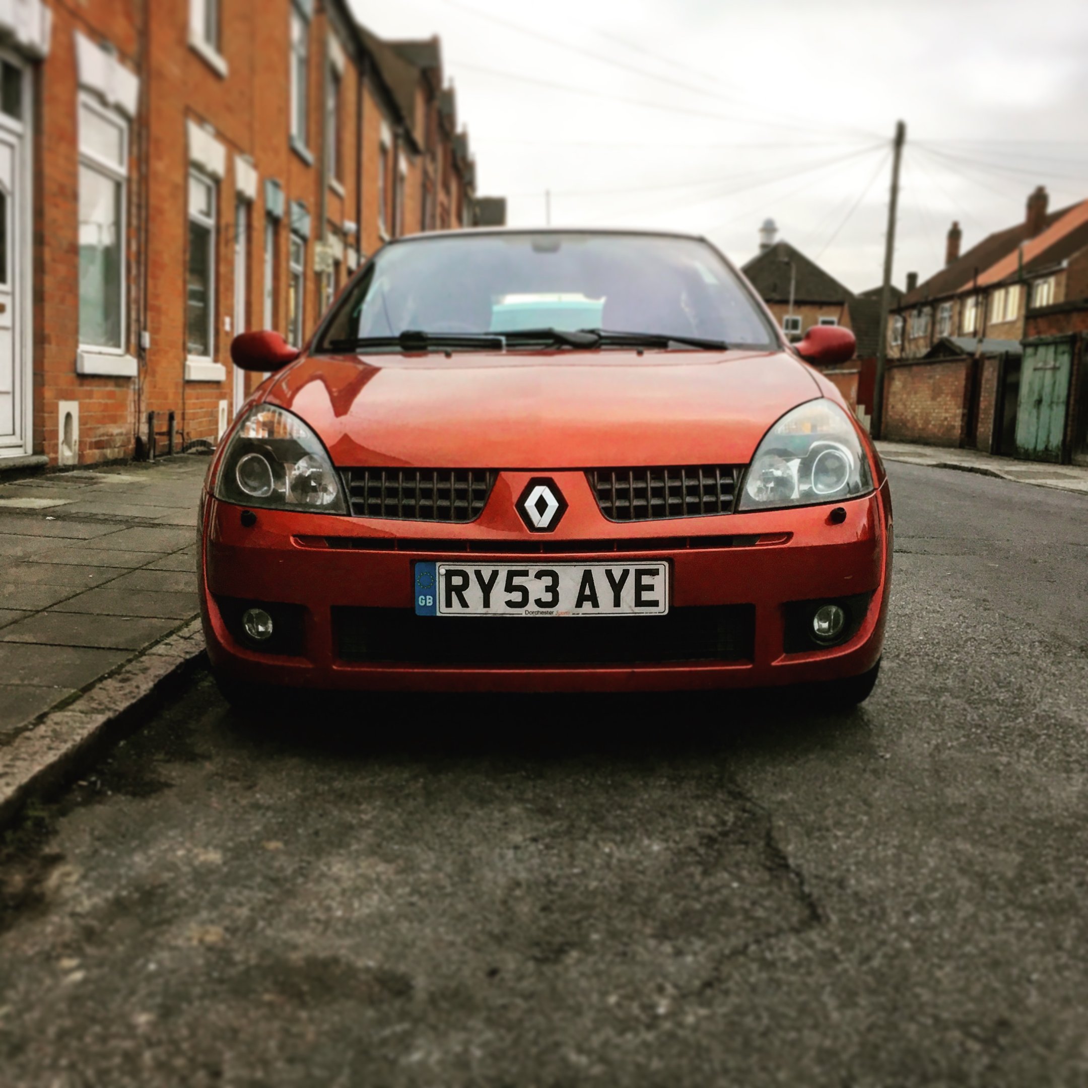

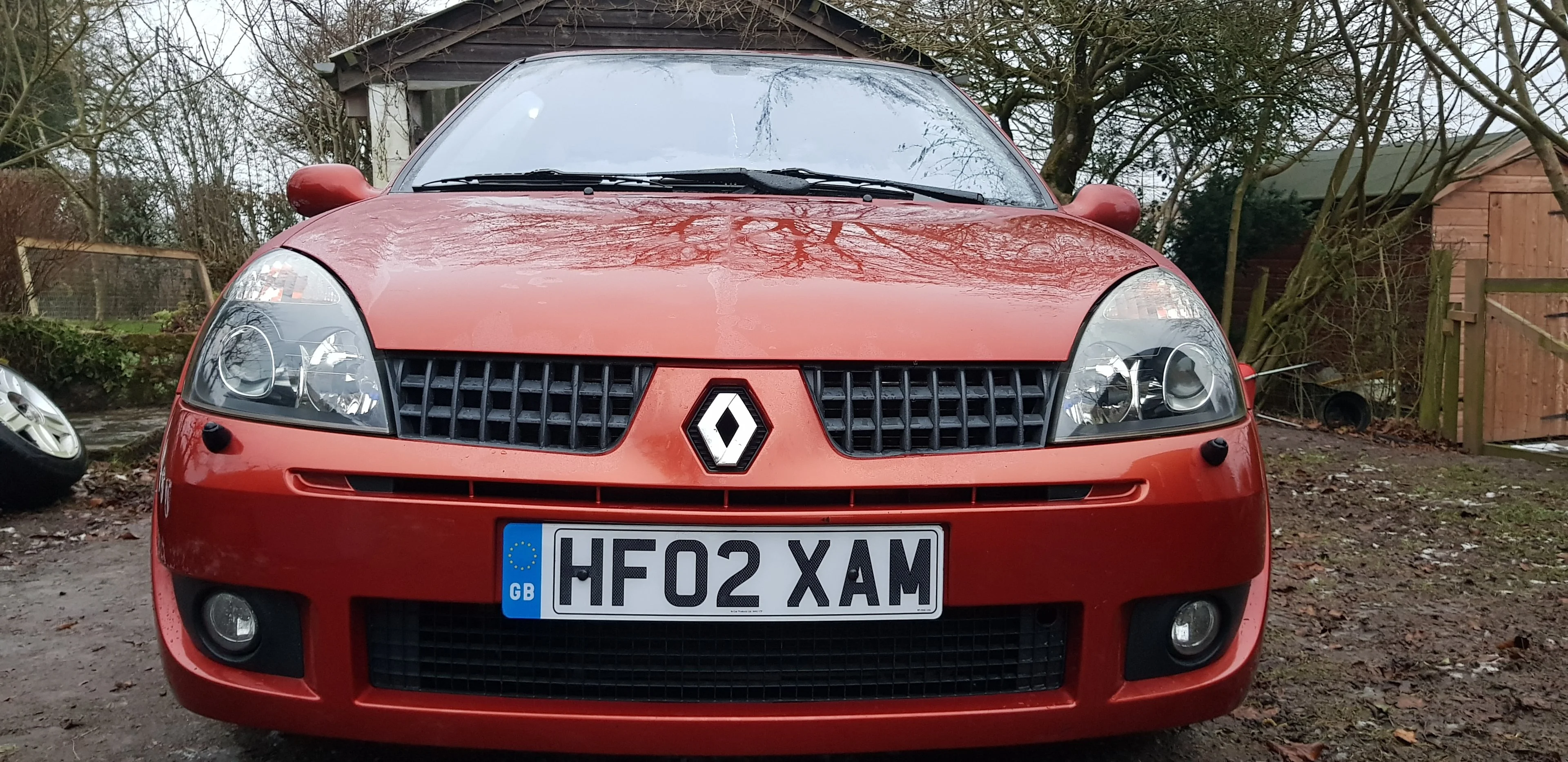

So the car - it’s a 99,000 mile Flame Red phase 2 172, first registered on the 11th November 2003, and appears to be completely stock save for an optional 6 disc CD changer and a set of 182 wheels. It came with 363 days’ MOT and a stack of paperwork as thick as a phone book, including a couple of bits of paper work that have brought a small amount of concern, notably a report that shows after No. 2 injector was changed, compression on 1, 2 and 4 was 190psi and 150psi on No. 3 cylinder. I guess this is something that needs to be investigated. Other that, it’s had quite a lot money thrown at it over the years including a new throttle body and crank position sensor.
There are things that need to be addressed fairly soon, and this thread will act as a reminder for me to keep track of the things I’ve done and what’s outstanding.

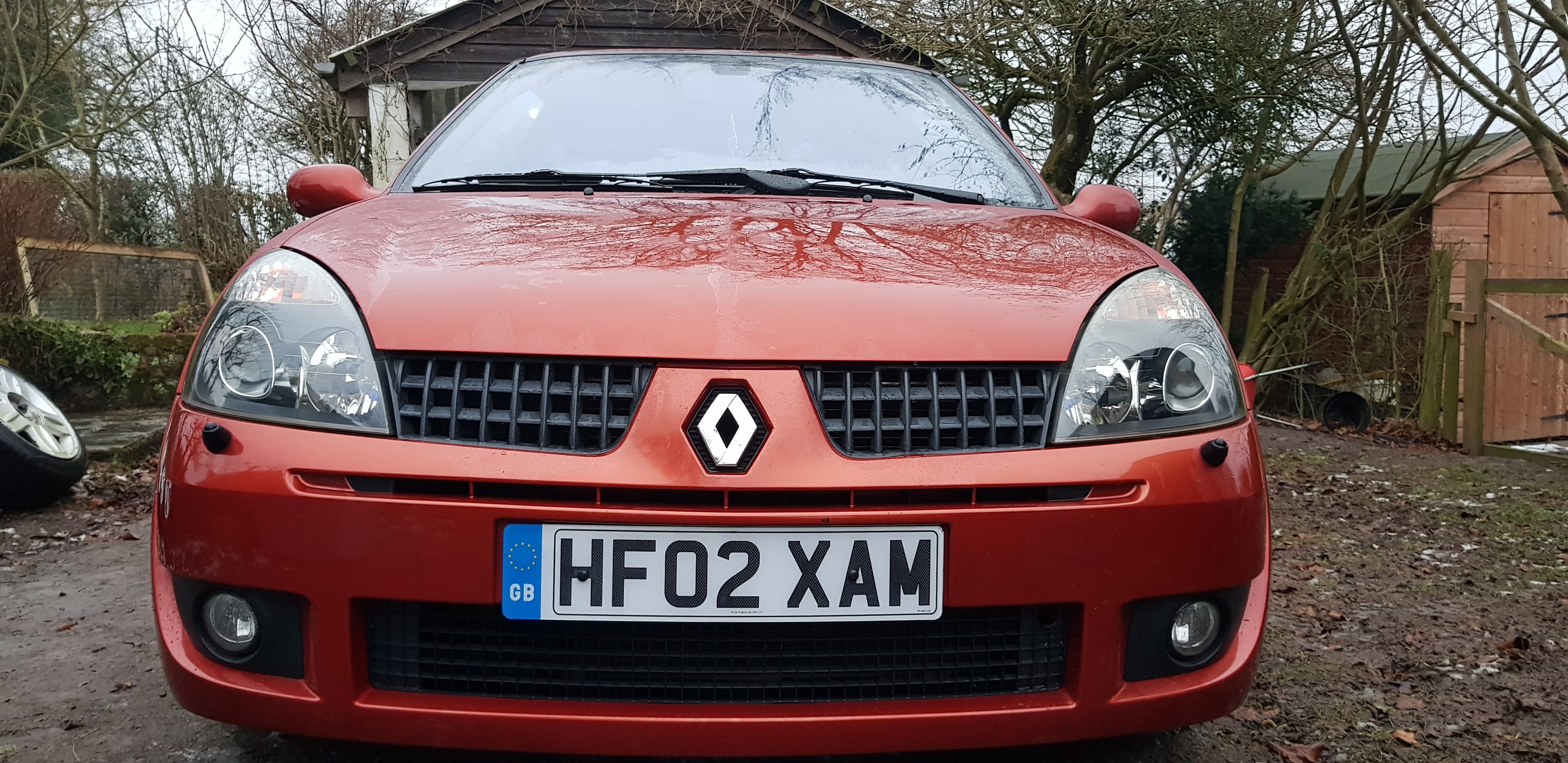

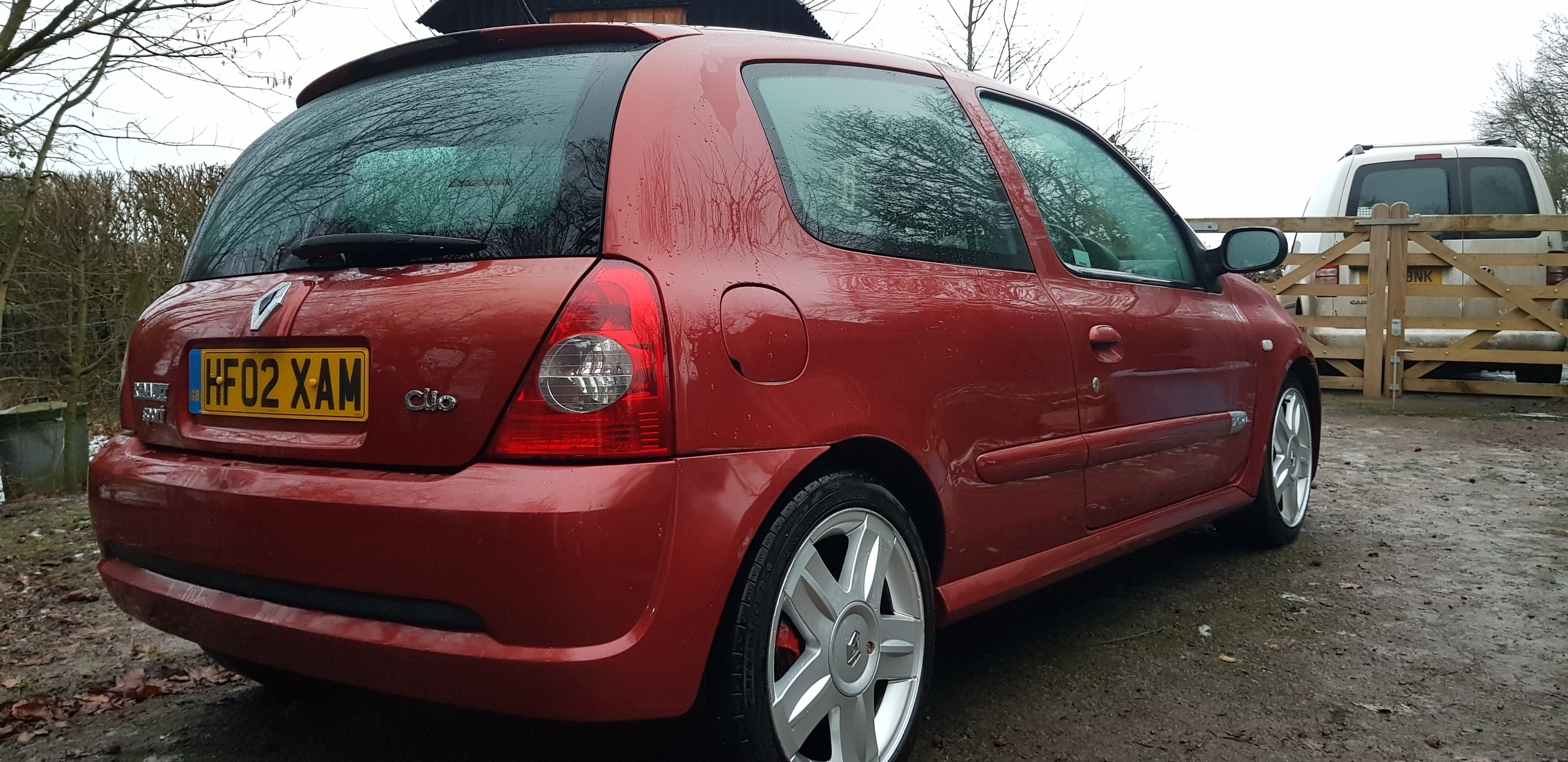

In the meantime, here’s a couple of photos
I commented on this on Facebook, looks very tidy! Doesn't look like there's anything wrong with the paintwork in those pics. I've replaced the shocks on my new Flamer with cup shocks and Grams springs with new rainsport 3s - quite a difference! I'm in need of a bonnet and a bit of pdr even then it'll be a bit of a scruff.
I should have done a project thread on mine really as it's been some ordeal.
Cheers Dom

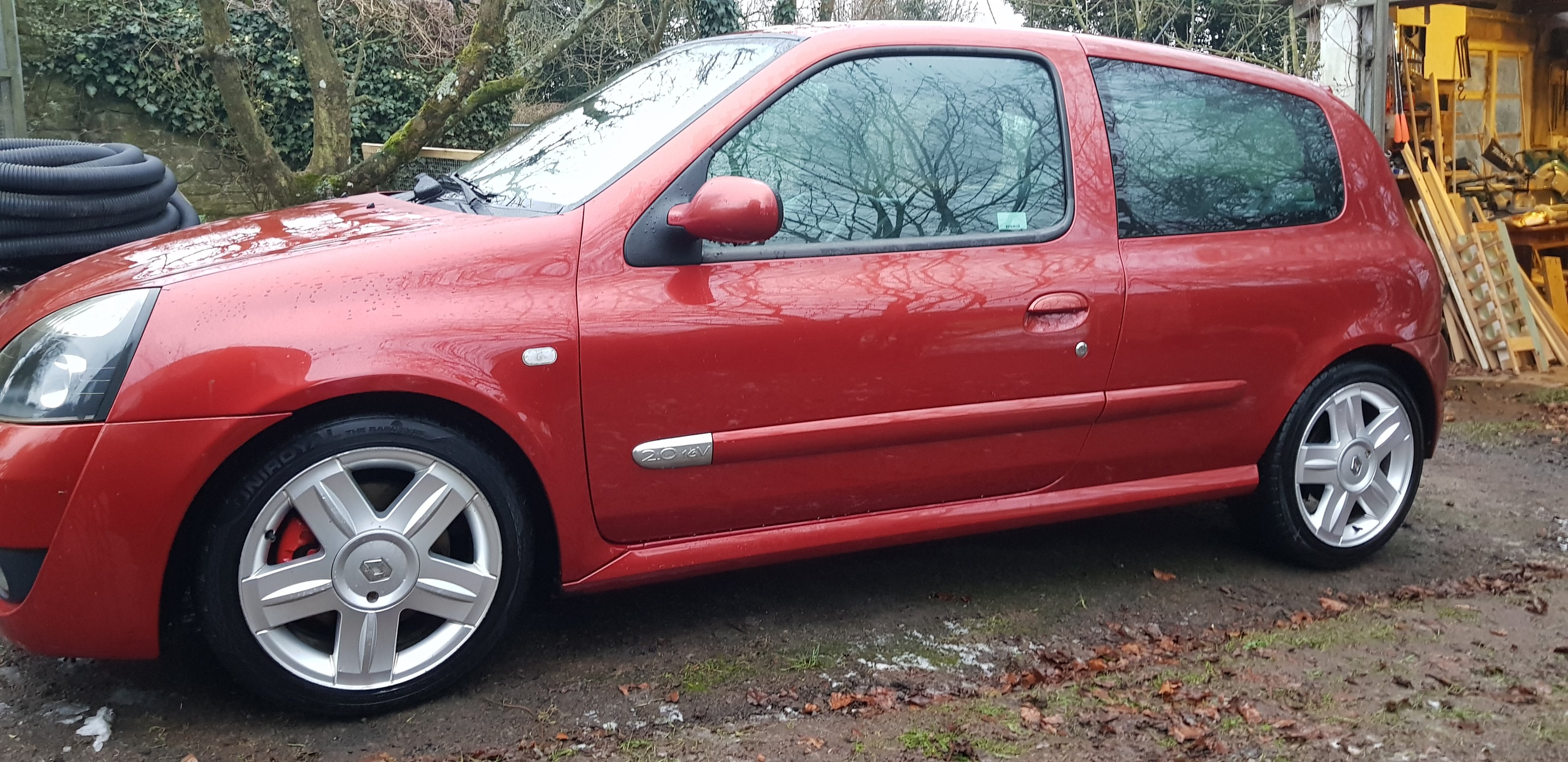

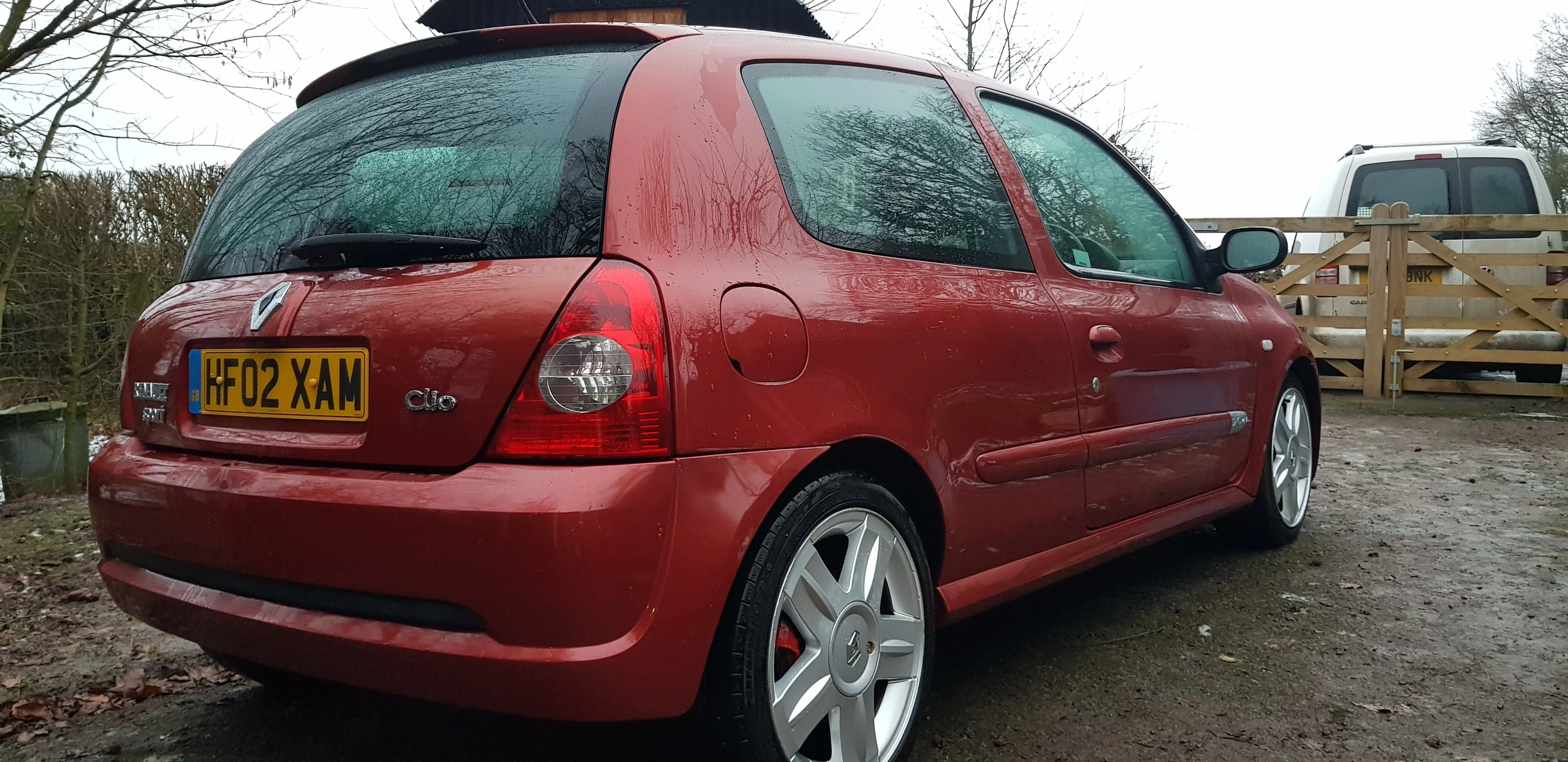

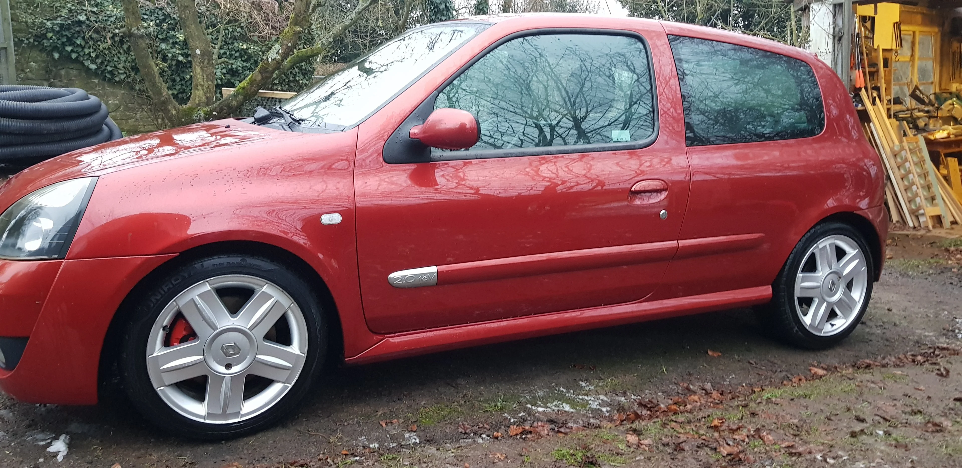

Front bumper needs a repaint, there are a couple of marks over the rear arch and by the drivers door handle, and a little dent in the bonnet.
I might get a set of phase 1 15s for track use because you can pick up a full set of Michelin PS3s for £130.

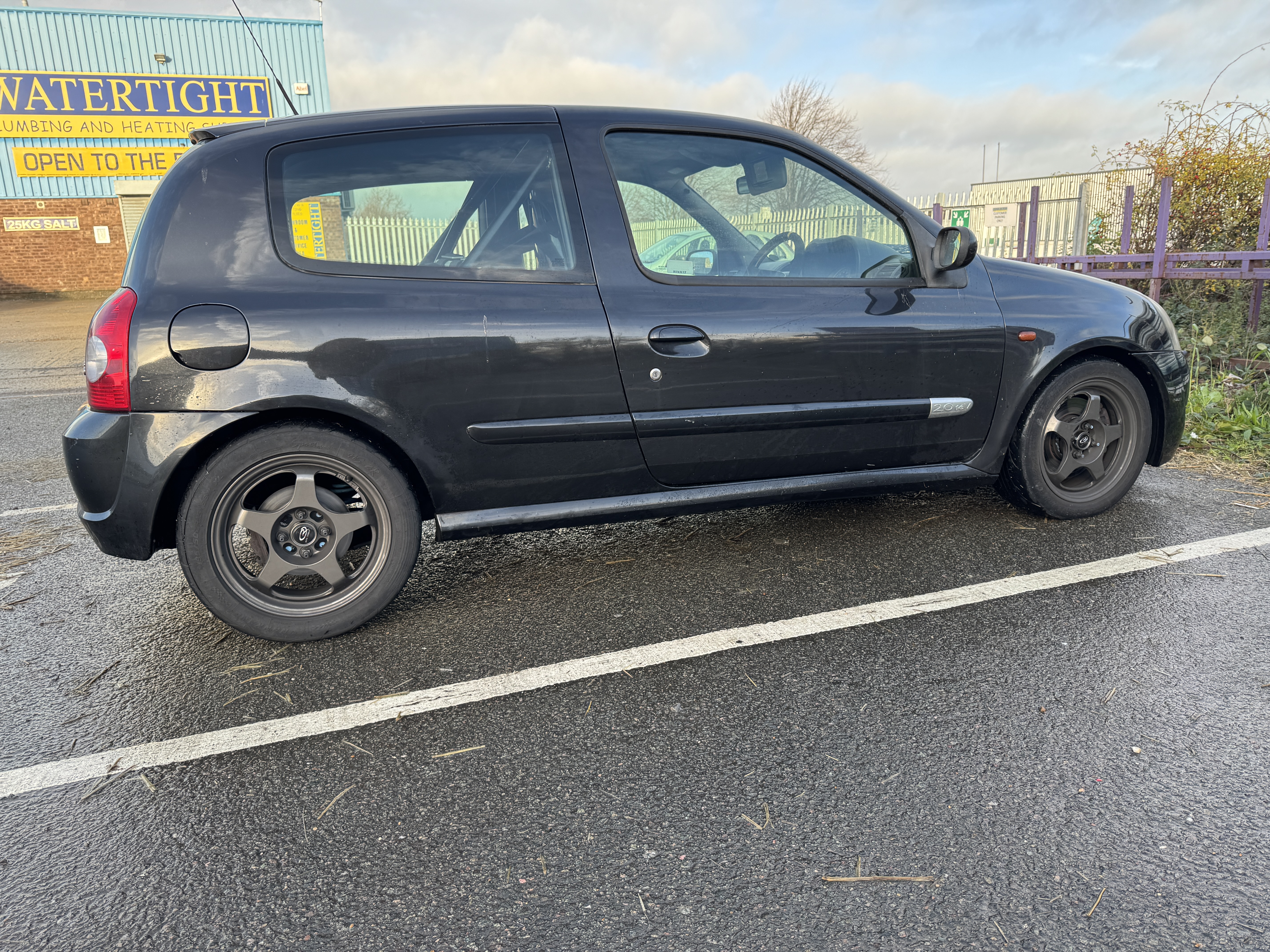

Which evidently wasn't enough to be getting on with, so in 2021 I went and found another 172. It was another cheap one at £14000 and to this day I still don't know why I didn't buy one that had already had loads done to it, rather than doing it all myself. I also don't know why I didn't go for a 182 and in a nicer colour than black.
Fast forward from 2021 to now, I've spent far too much money, have had to have two lots of welding, put a new tailgate and bonnet on so I could save myself the hassle of removing the tint film from the rear window or paint the knackered lacquer from it being left under a drip for a year. I've just had the half cage and a K brace powder coated as they were going rusty, the belts were all finally done earlier this year, I've spent a fortune on genuine screws and clips from Renault and Vehicle Clips (most of which I didn't need), fixed the servo motor for the air con flaps and done some more track days.

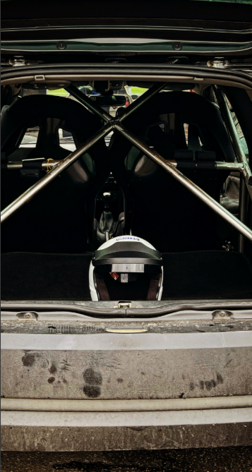

  • Alan Dent half cage
  • K brace
  • Half a false floor - I chucked the other half in a skip when I sold my house and moved out and decided I didn't have anywhere to keep it. Wish I hadn't now

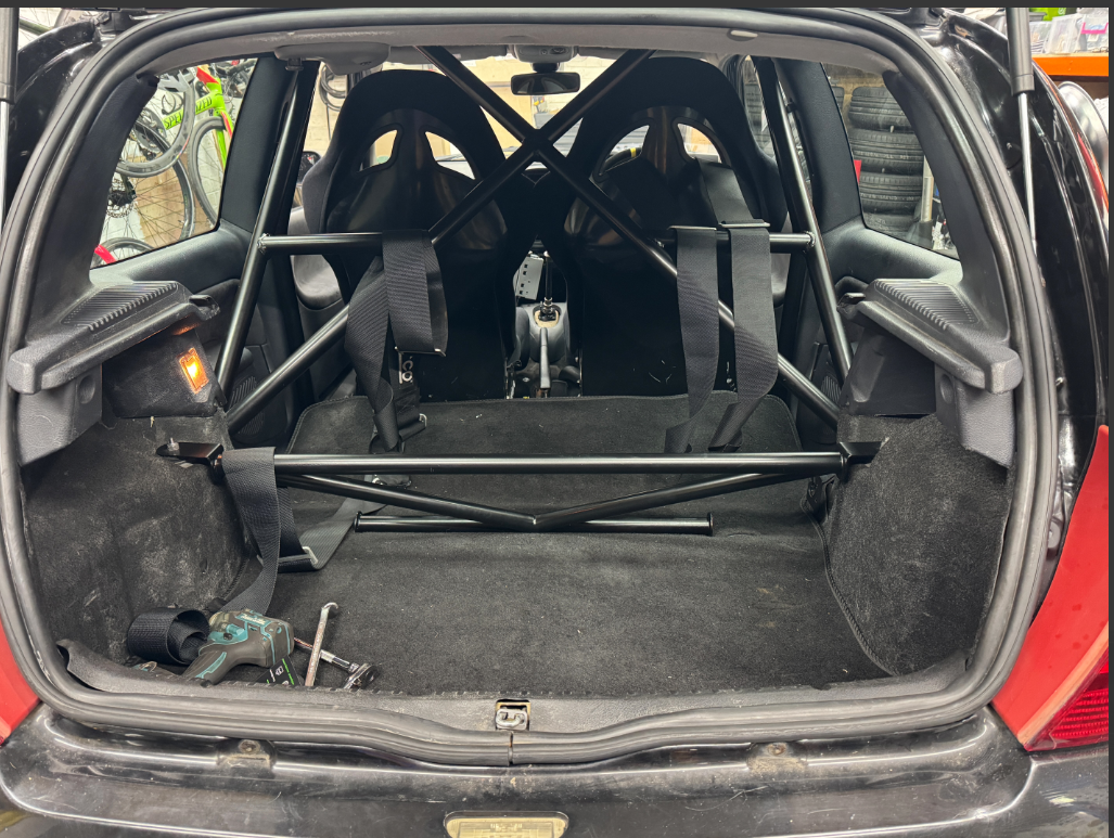

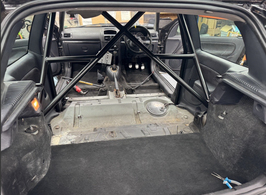

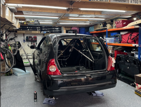

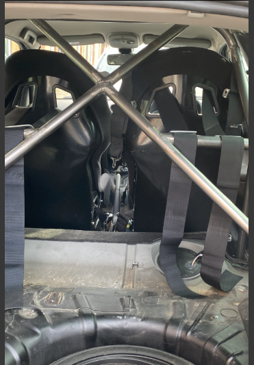

I got the car back down onto its wheels yesterday evening and started wrapping the harnesses around the bar and quickly discovered that am too old and knackered to get in the back, especially with the brace fitted.
Prior to taking everything apart, the seats tilted towards the middle, which I learned was partly due to the OMP subframes and partly to do with using the factory plastic spacers.
I've removed all 8 of them and after refitting the seats the tilt is less noticeable but they still meet in the middle. I suspect I have used the inboard mounting holes on the subframe. For anybody that's used the OMP subframes, does this seem reasonable? Should I be using the mid-mounted plastic locating spacers on the tunnel, but do away with the ones closest to the sills?
I'd like some Jon Foz subframes but funds don't permit at the moment and also I don't know if I want the seats to sit any lower.

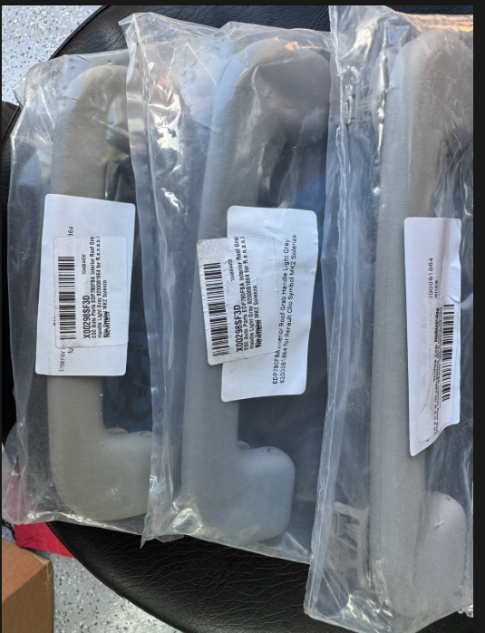

I've also tried getting hold of some reproduction plastic bits to hold the headliner in - grab handles, even though they're not needed, but the plastic blanking plugs don't fit properly in the mounting holes in the rear.
I ordered three handles from Amazon from a company that makes them for a Turkish version (a Solenza? I've not looked it up but I expect it will probably be a Clio II saloon with a Campus style front end. Oh bugger it, I'll look it up now...oh no, it's a Dacia branded version and it's worse than I thought)
They were all listed as "Light Grey" but when they turned up one of them is a different colour. Difficult to tell but the one in the middle is a different grey.
I also ordered a pair of sun visor clips which were also in a different colour grey and use a self-tapper to pull the plastic out, so they went back because they looked rubbish. I found a part number for some visor clips that are also used by Citroën, so I bought a pair of those for about £13. They will probably also be the wrong colour as well, but whatever.
It's a shame they're practically useless when they've been pulled out - I don't know how you'd remove a handle without totally destroying the plastic clip.
I also haven't quite fitted the headliner in the right place - it's millimetres out rather than there being a massive gap somewhere, but it does seem to affect how some of the trim sits. Never mind

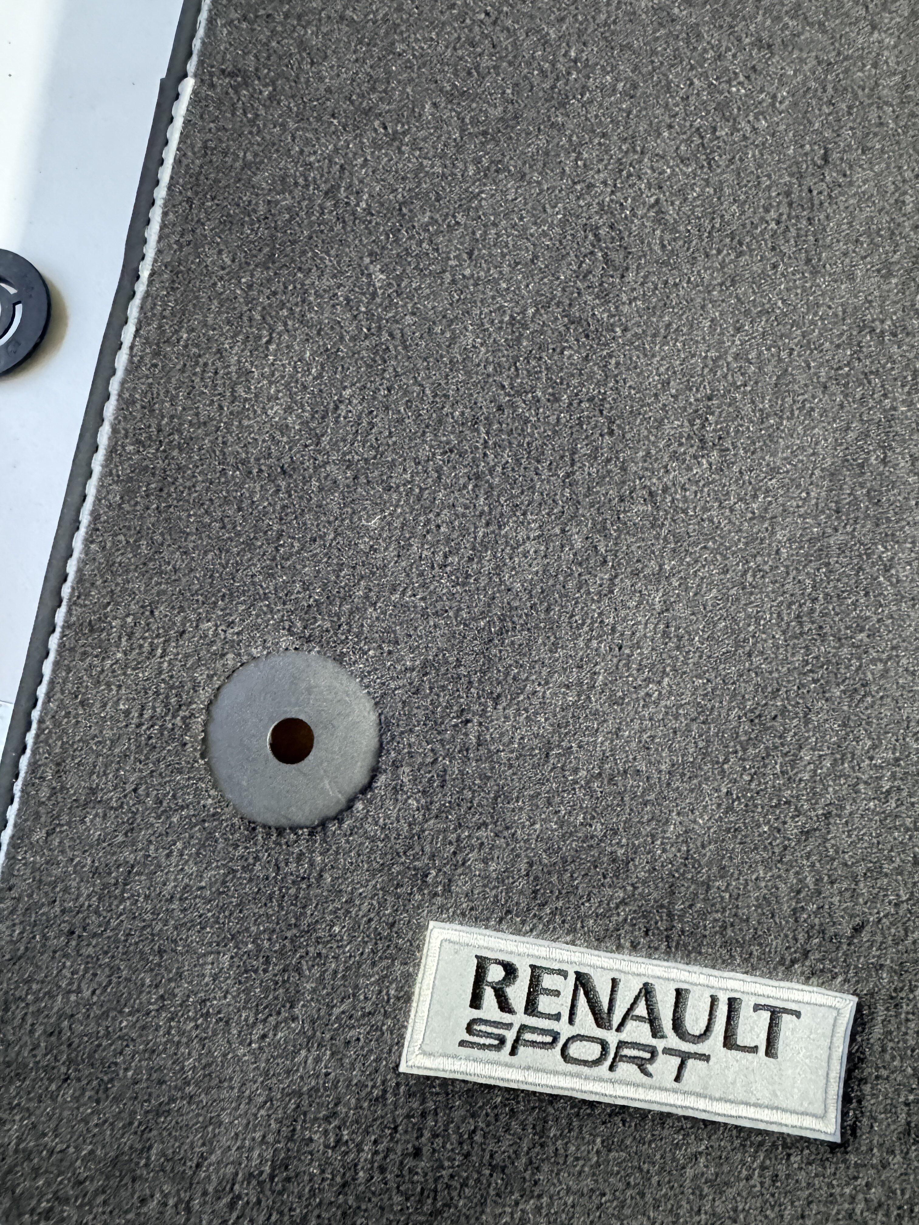

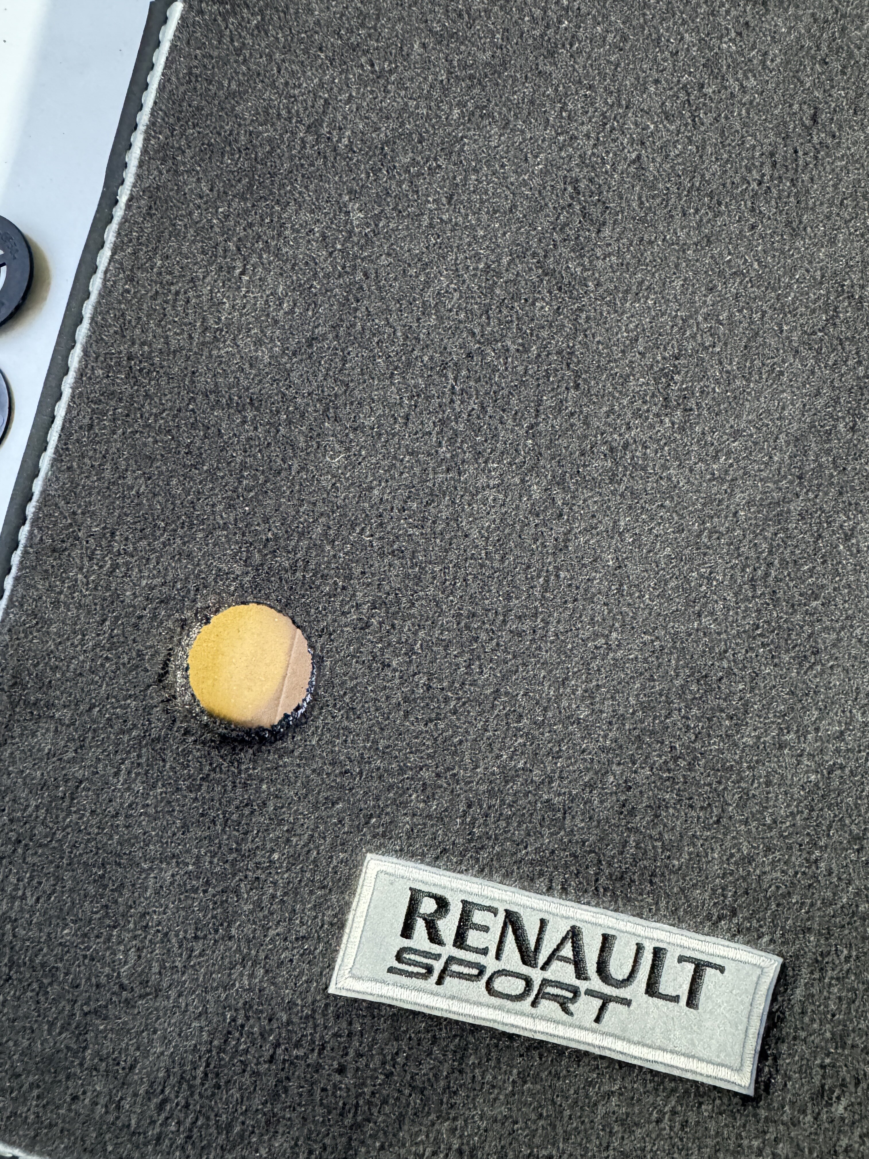

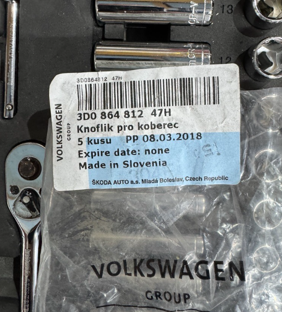

I wanted some of the chintzy Renaultsport mats - I must’ve bought these with some discount or other, as I wouldn’t have paid £70-odd for them.
I hate the bloody things sliding around under your feet, so I’ve taken to fitting VW/Audi securing pegs into them. The carpet peg is about 70p from Skoda and I’ve kept the mat grommets out of old carpet mats I’ve binned.

Top work. Do you have part numbers for the vag clips?
