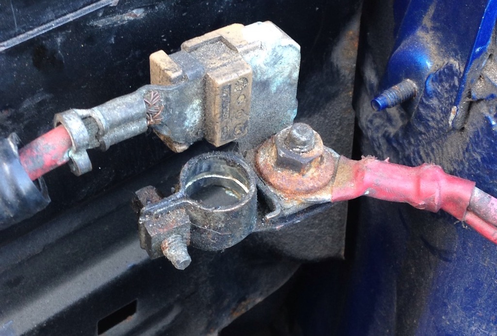

Why did you try and jump it in the first place? When you tried to start the car before you put the leads on the wrong way round, did the solenoid click then?
You may have gotten lucky and just blown the big fuse on the top of the positive terminal.
Yeah battery was dead. Hadn't moved for 2 weeks. When I tried to start it did the normal solenoid click and died - it's been quite regular as its not used often - so went to jump it and cocked it up. Now it won't do anything, with or without a donor car
Not familiar with that fuse - is it something to do with where the two positive cables connect to the terminal?
Not sure how to visibly check it, but you can just do a continuity check with a multimeter to see whether it's getting voltage on either side.
I doubt you'd get lights on the dash if this had blown though...
