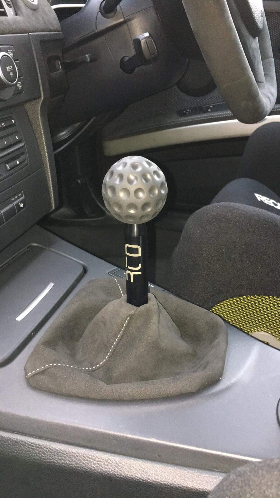

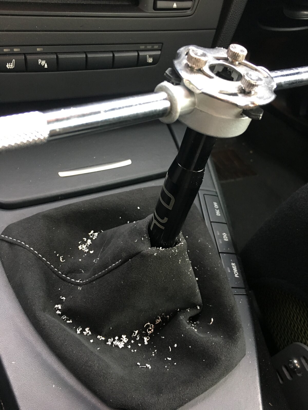

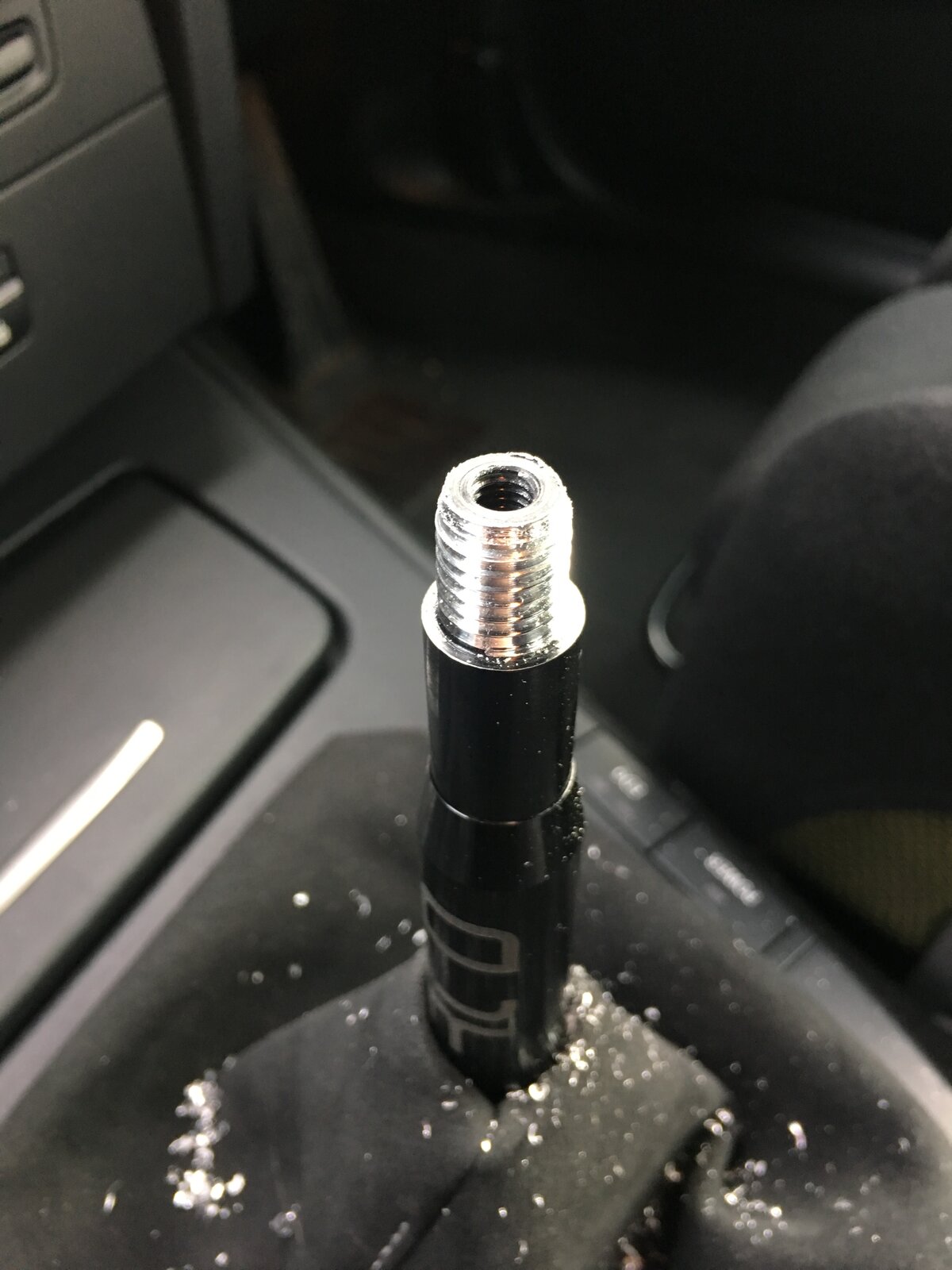

I must admit, constantly having to hit the gearknob back onto the short shifter wasn’t the most ideal.
Once I got home I set about sorting it out..
All done. No movement in it what so ever now - much nicer to use and no more problems when changing gears.

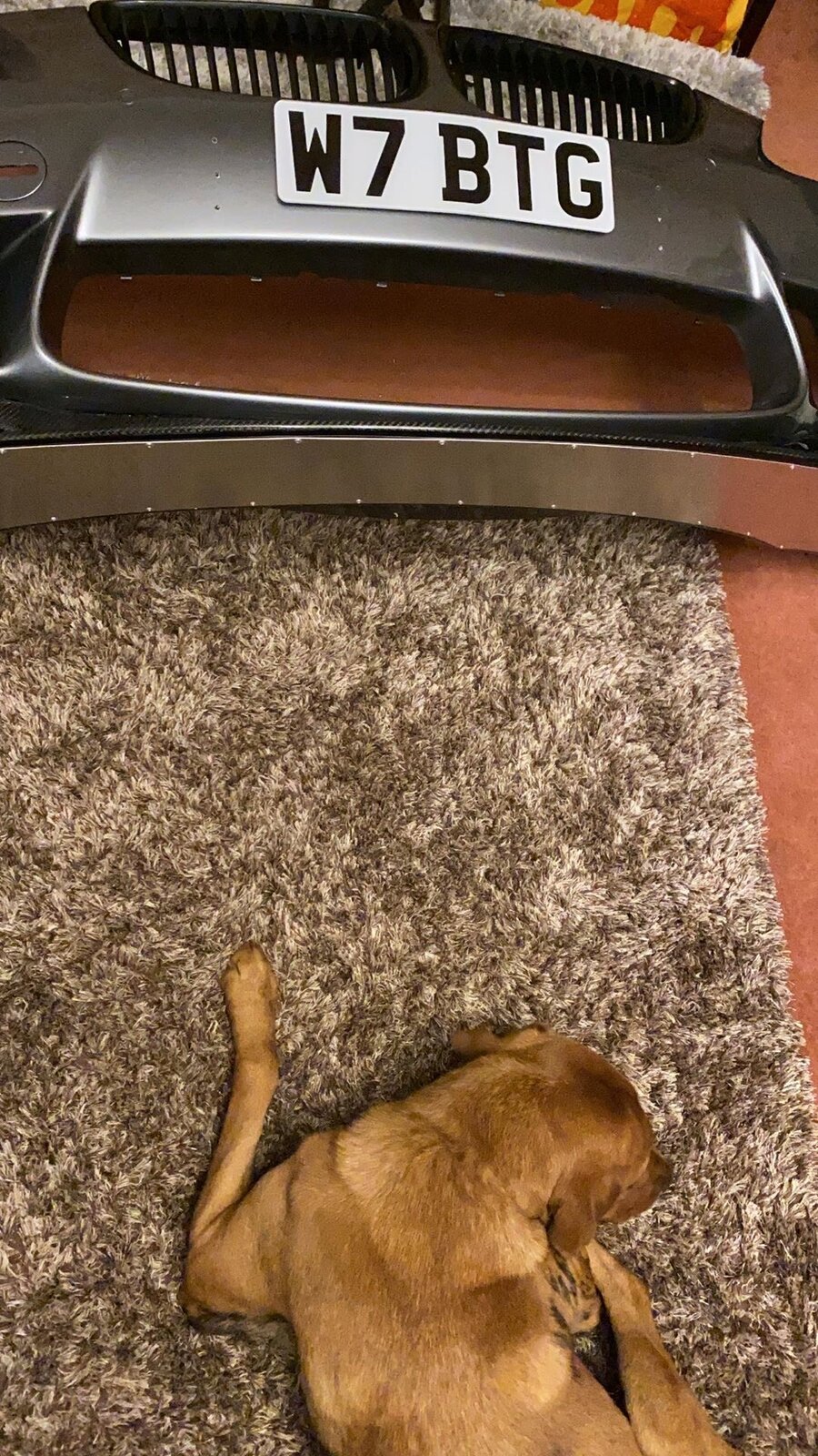

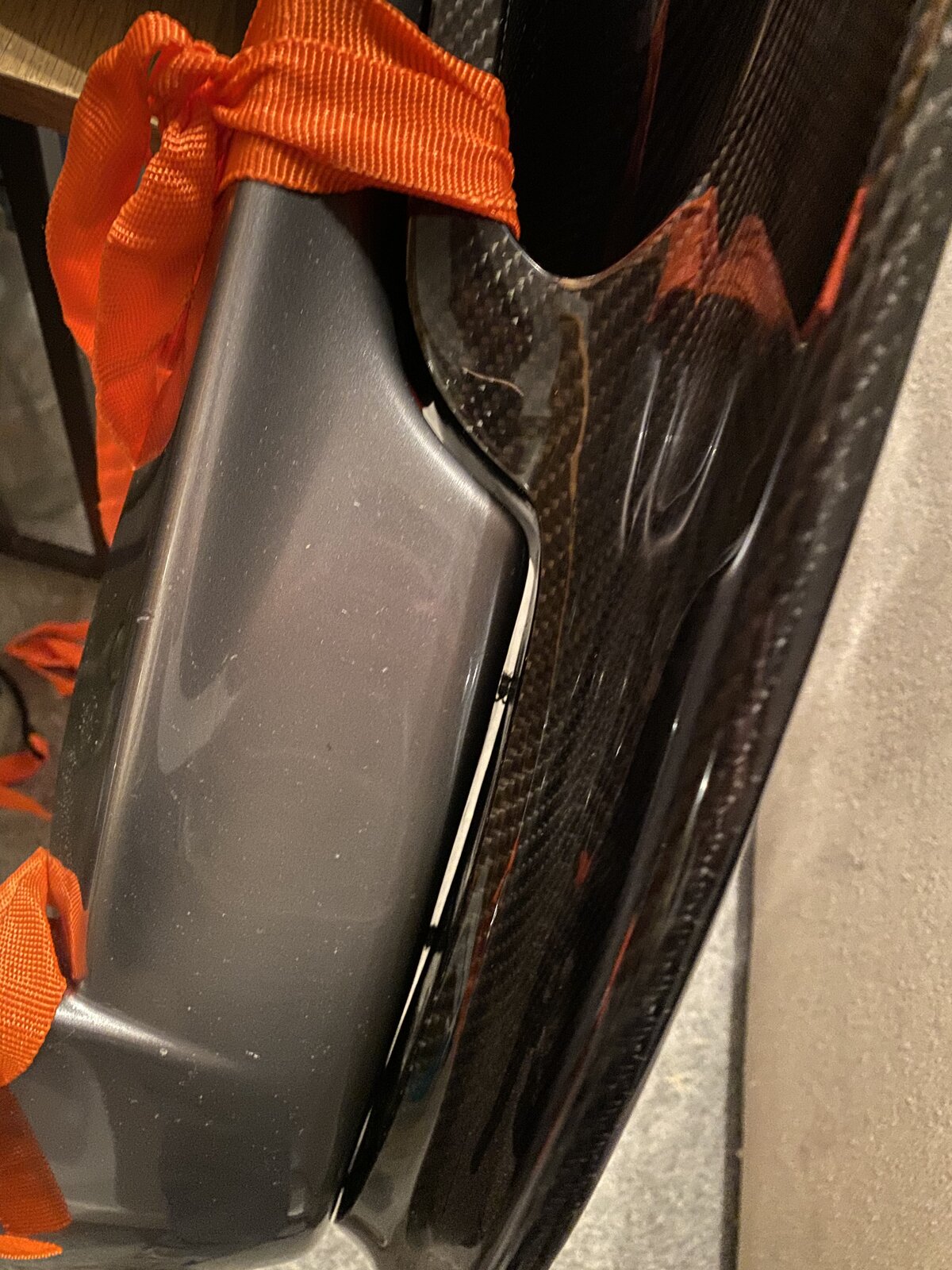

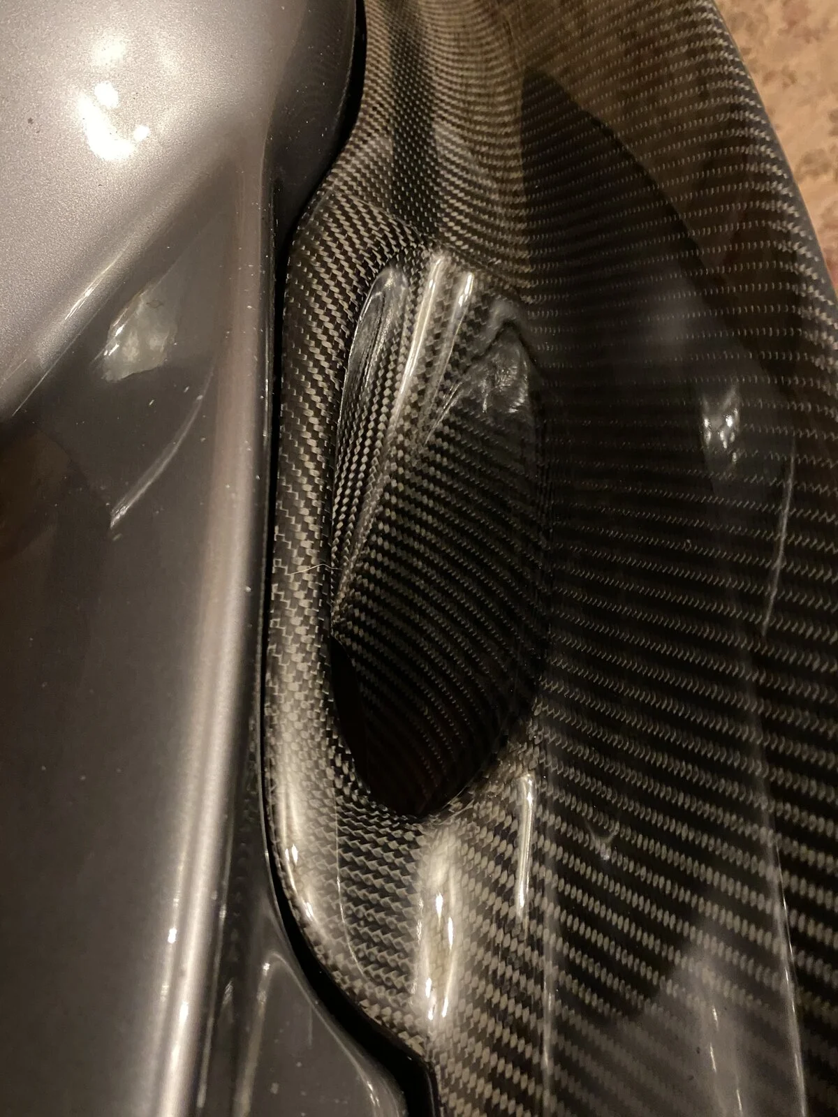

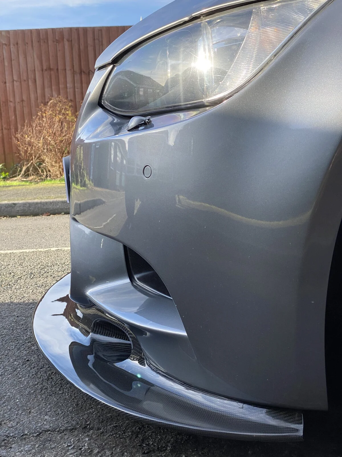

I bought a GT4 splitter; this is the fitment when offered up and bent into the lines of the bottom of the bumper..
Frankly shocking so that put an end to that idea, luckily a full refund from the splitter.

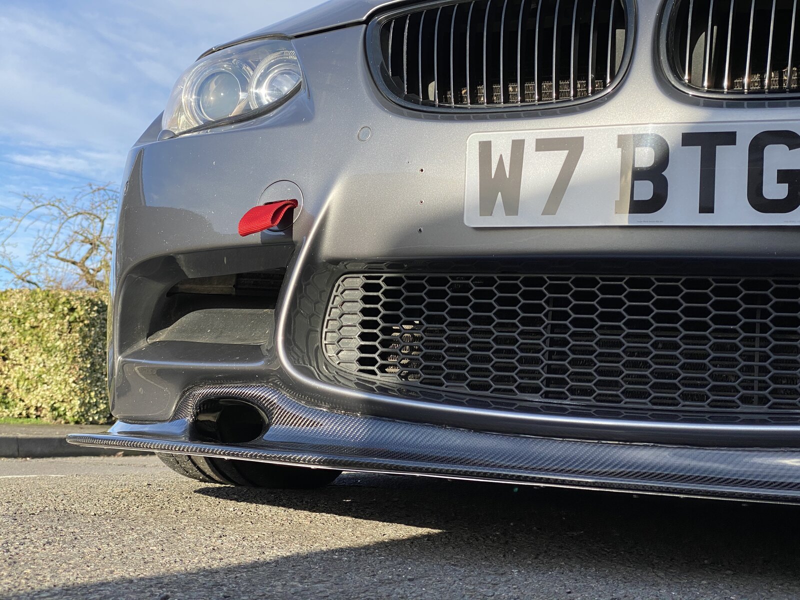

I’ve sourced a splitter from Germany using a cast from the genuine item, twice the price of the Chinese one but I’m hoping it fits a little better!

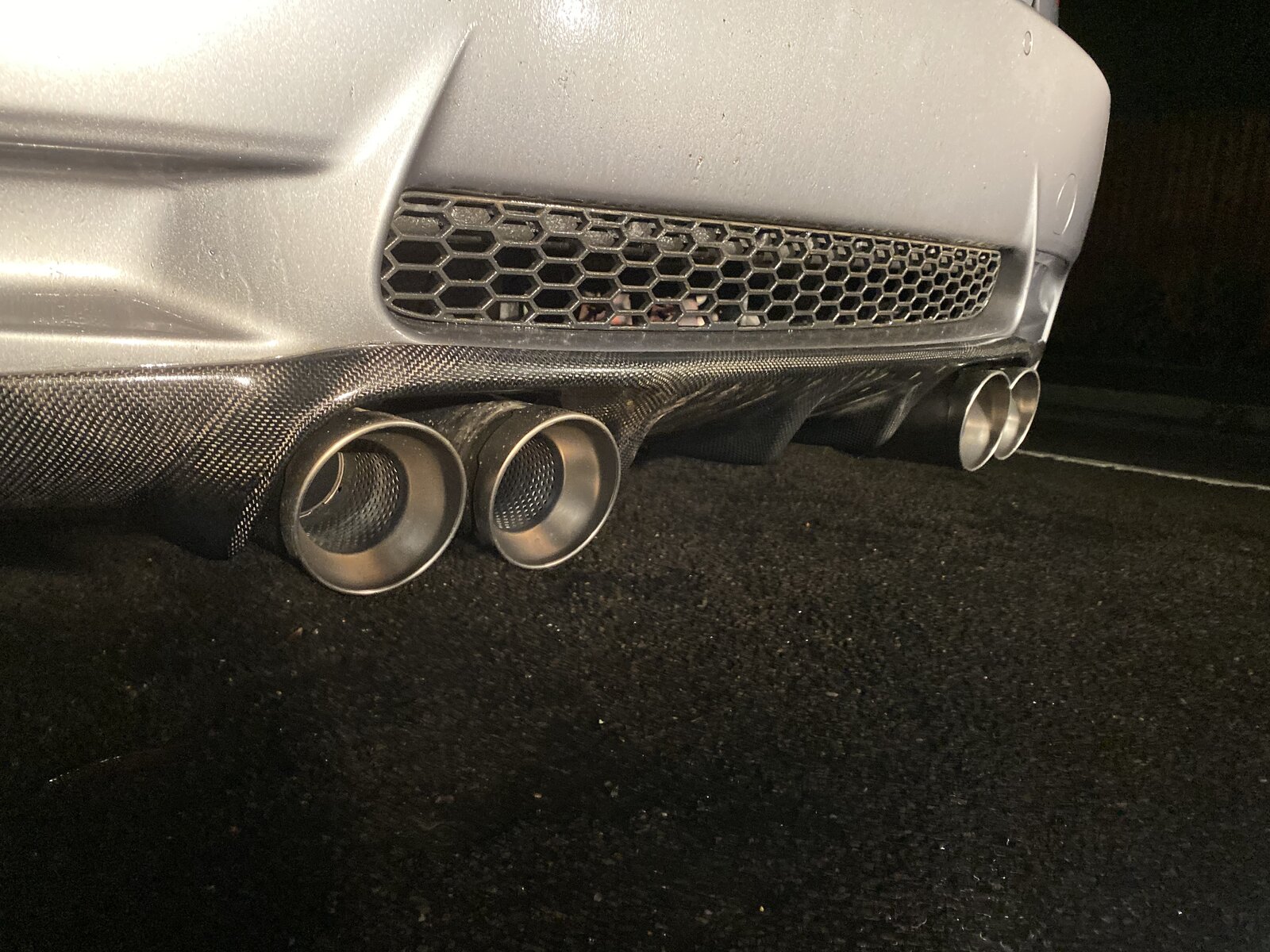

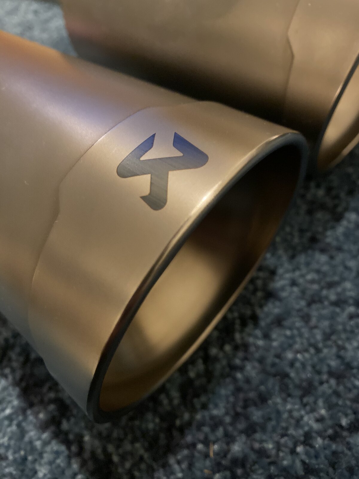

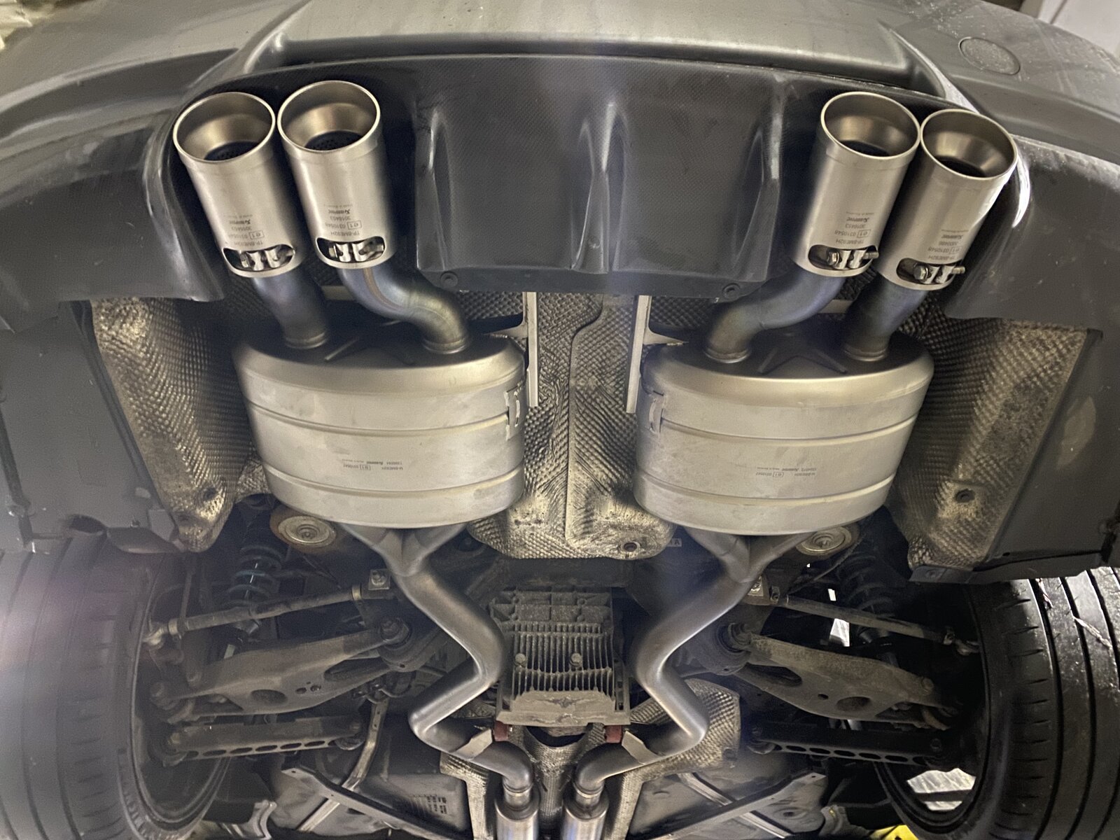

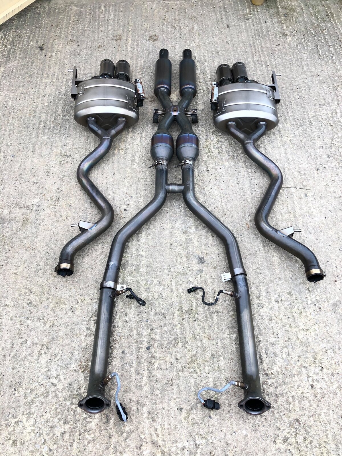

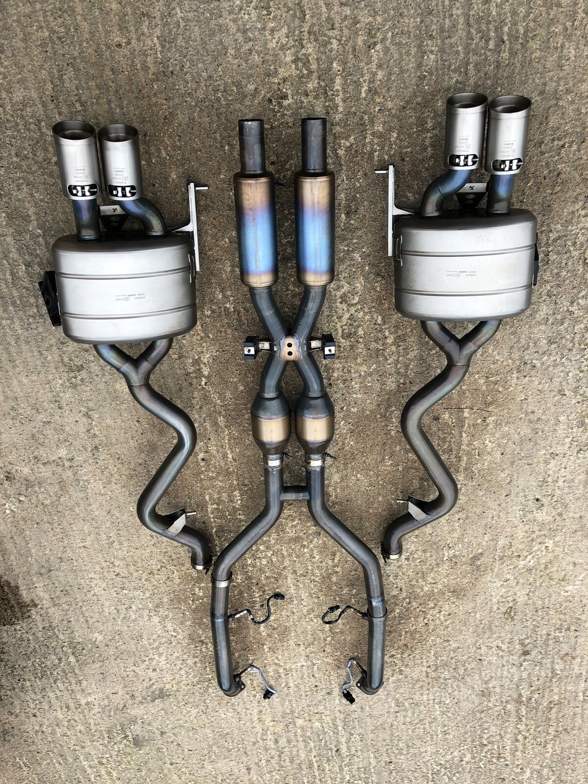

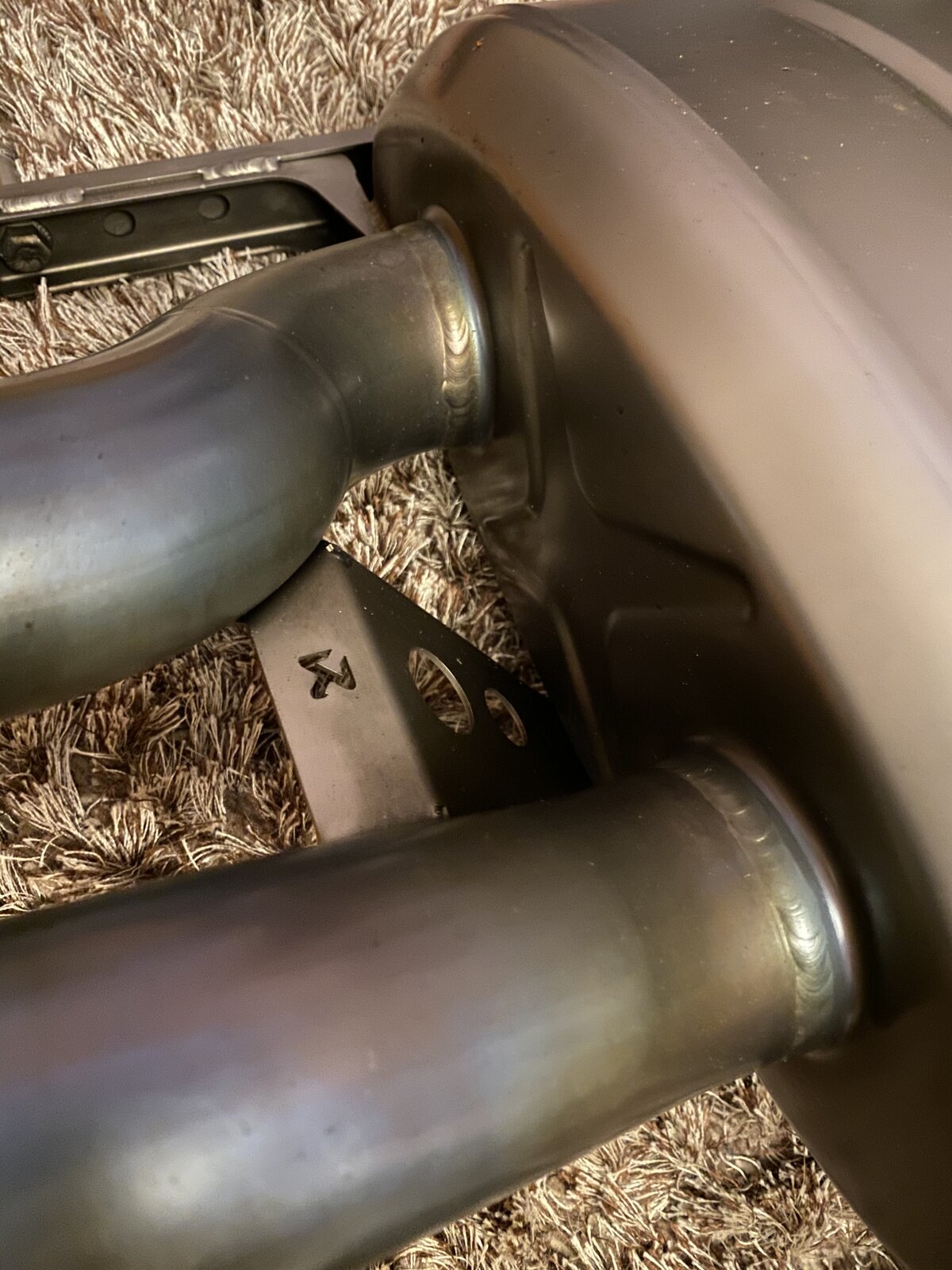

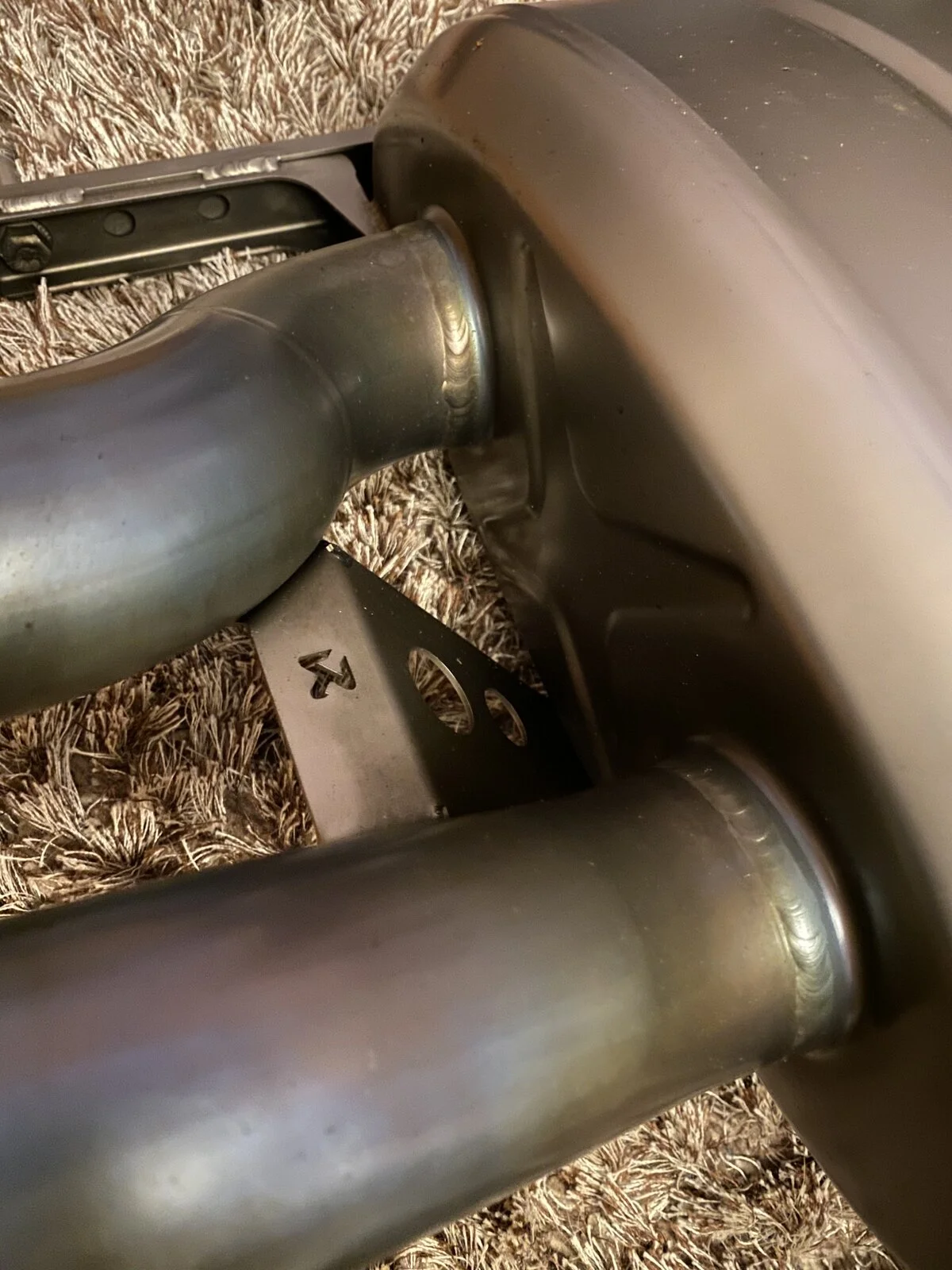

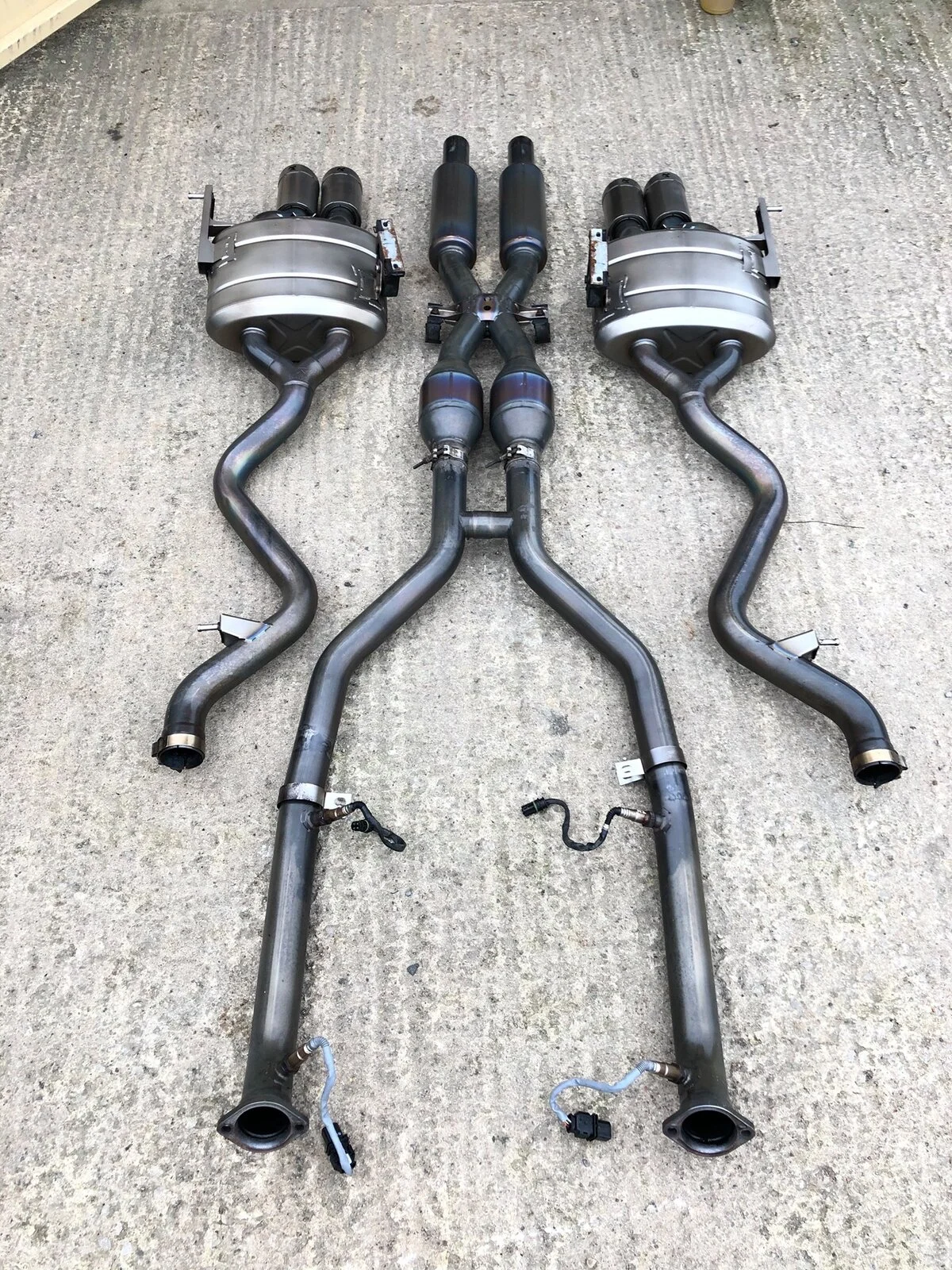

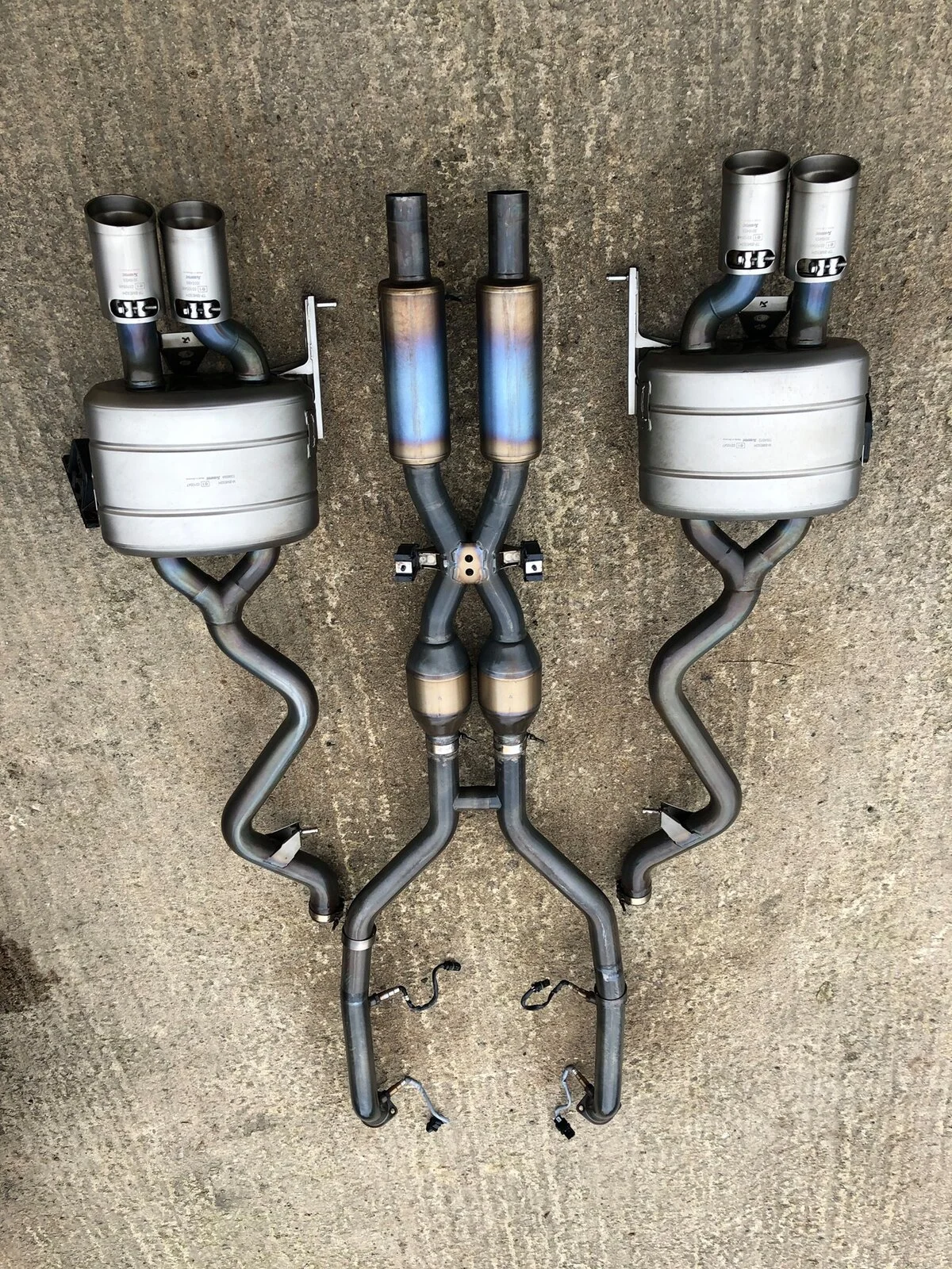

Treated myself to a little Christmas present from myself.
Full Titanium Akrapovic exhaust, should keep the noise down enough for UK trackdays and save a substantial amount of weight.
Another piece of art to make its way onto the car.

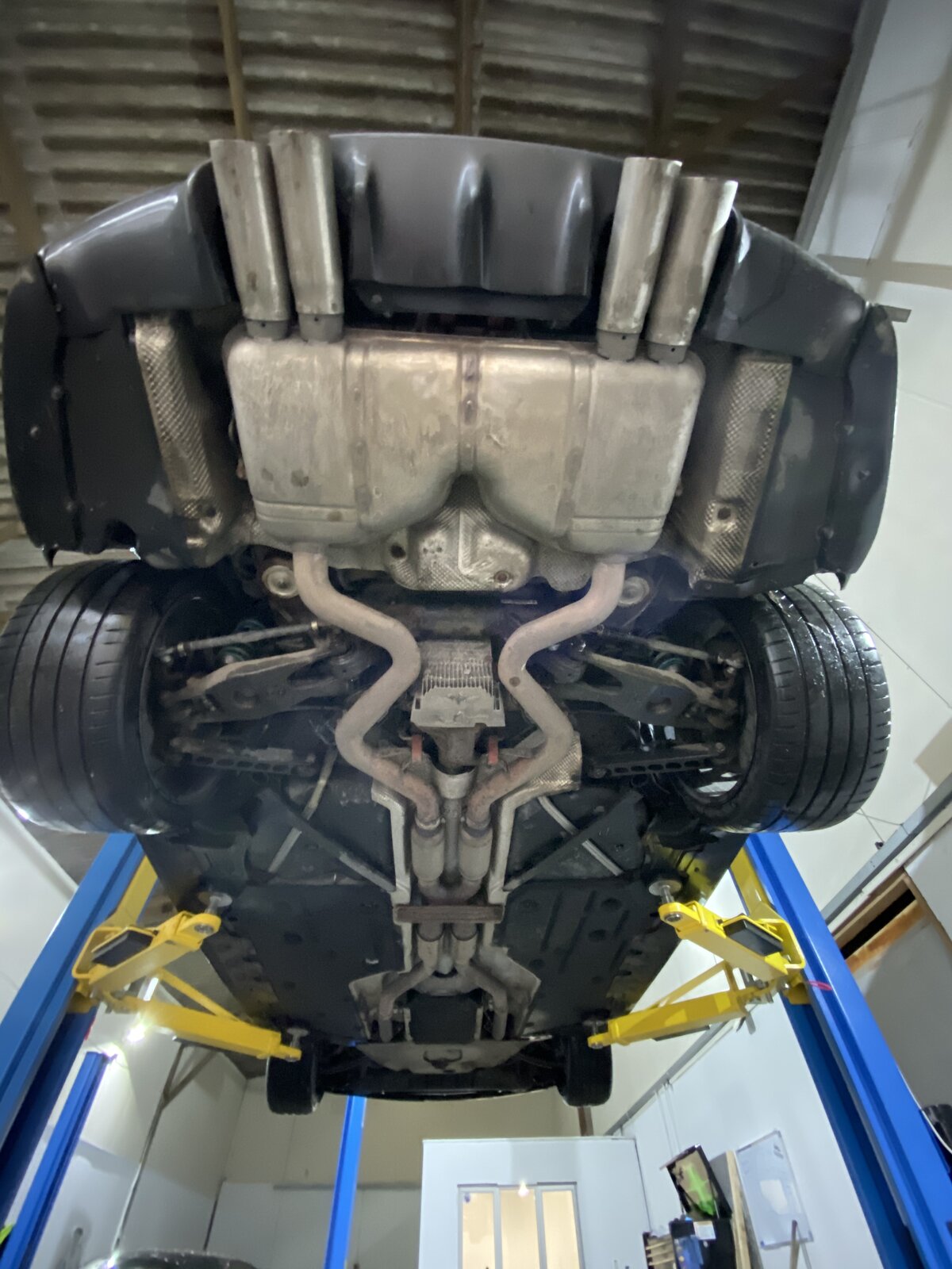

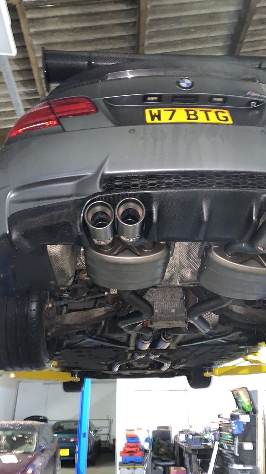

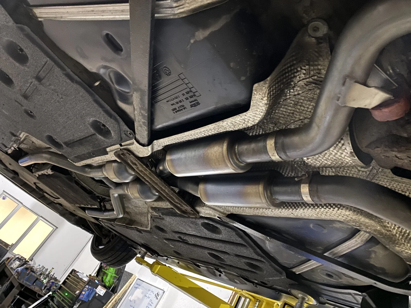

Before
During
After

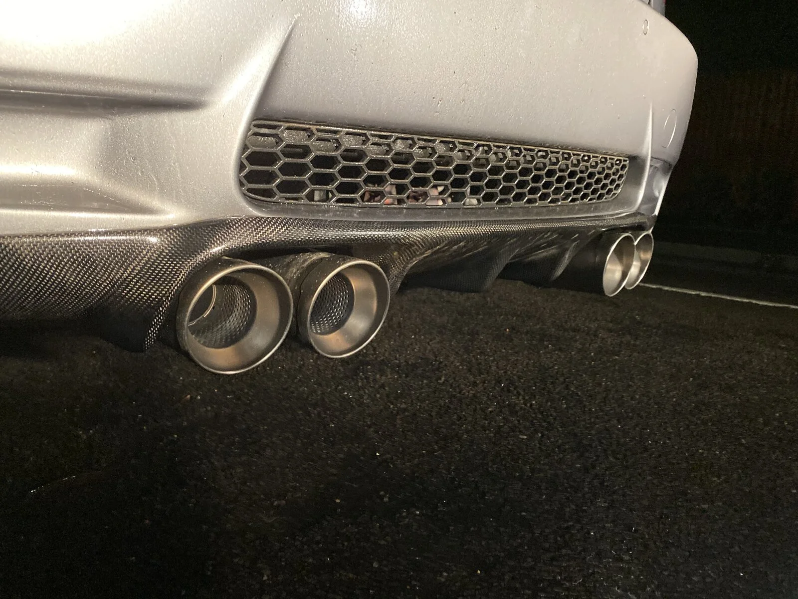

I’ve driven it about 20/30 miles now, it’s such a refined exhaust note. The car revs a lot easier now and feels noticeably quicker on the uptake.
The exhaust saves 24kg and gives around 15/17hp which is understandable. Unfortunately the weather isn’t great and I had to look at my rusty subframe which I wish I got powder coated when it was removed for the solid bushes but it is what it is..
I’m happy with the exhaust, it means it’ll pass noise tests for UK tracks now so I can look at some trackdays for testing before the Nurburgring trackday early April that I’ve just booked.
-Rob
Exhaust looks lovely..... But it sounds abit pants sorry 😕
Depends what you’re after I suppose.
If you wanted a loud exhaust I’d have gone for an IPE but saved no weight from the car at all.
Alternatively I could have kept my old exhaust which is a 4 pipe modified backbox with primary decats and noise tested at over 110db static. It had no class to it and sounded like bones in a metal tin.
This adds significant power gains, saves 24kg over the standard exhaust and fits perfectly. It’s also below UK trackday noise limits.
The video shows revving out inside the car to 6200rpm and the other is 2,500rpm blip on a Luke warm engine.
It absolutely howls over 4000rpm.
-Jamie-
Akra over any other exhaust if you have the cash, I'd have one in a heartbeat. Sounds lovely in person under load and saves a good chunk of weight!

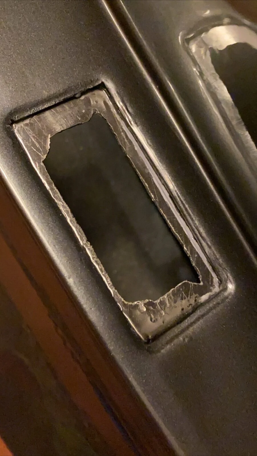

I’ve had this high kick carbon bootlid hanging around the house almost since I bought the M3.
I’ve bought a new wing for aero V2.. it creates some daft amount of downforce but it is boot mounted not chassis mounted. It’s not quite that hardcore a build.

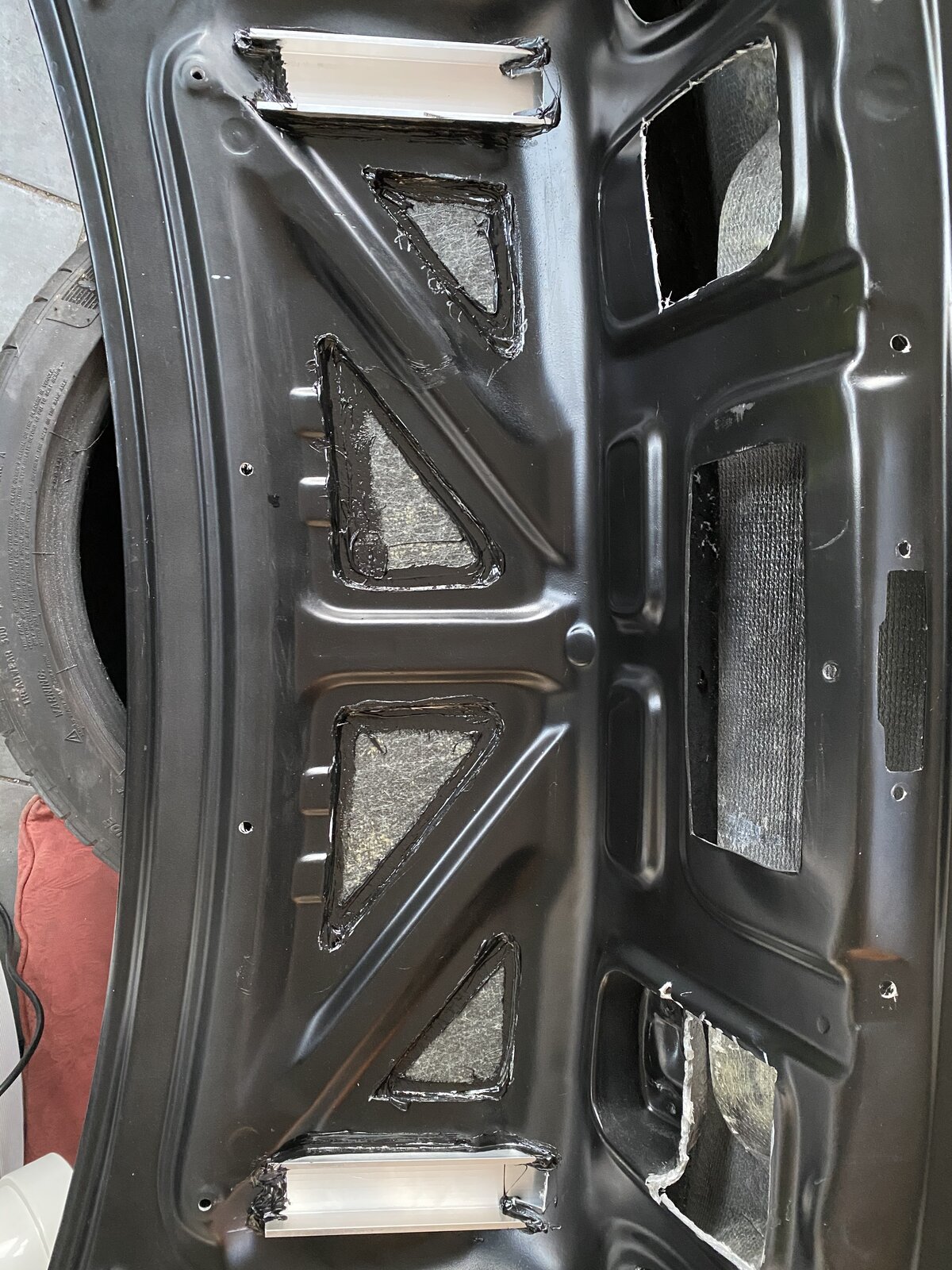

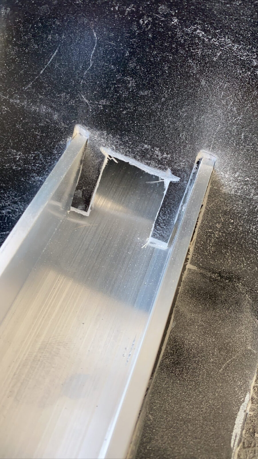

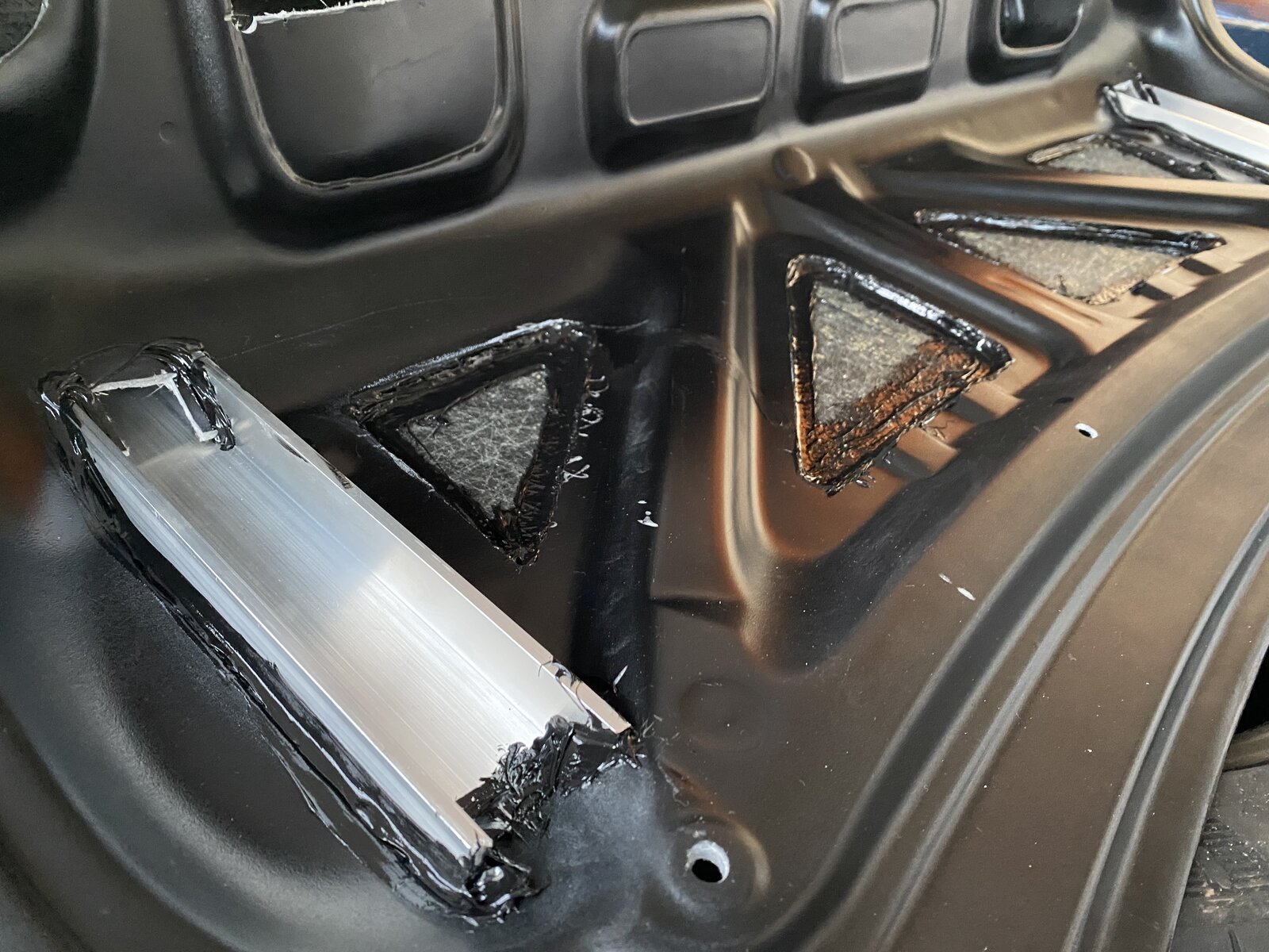

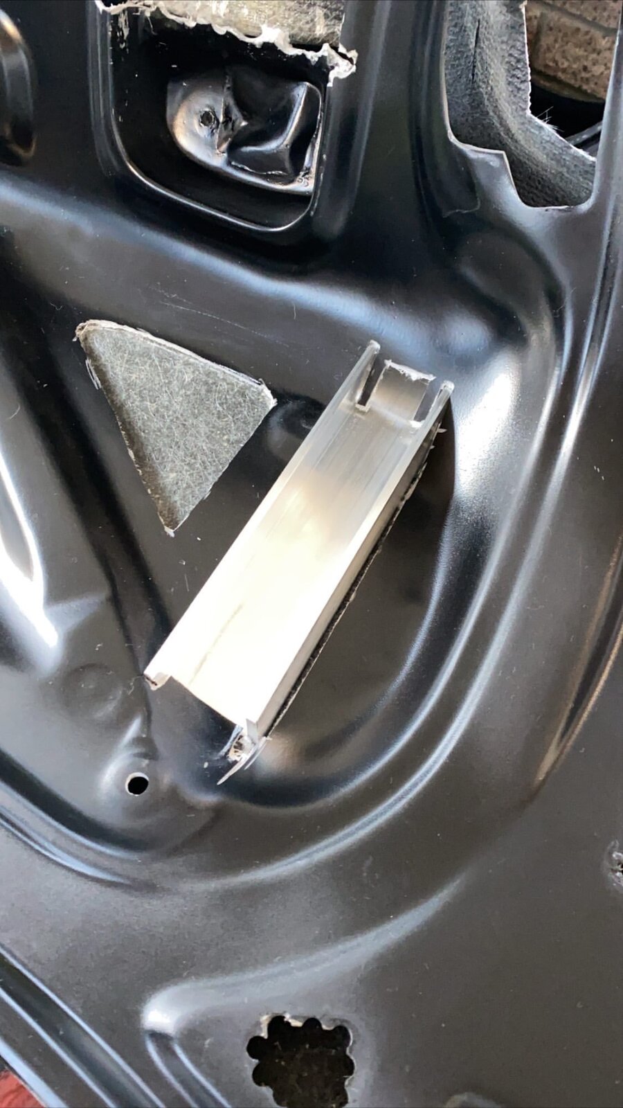

I’ve done some reading, research etc and decided I’d brace the bootlid to hopefully eliminate any flex in the bootlid and the wing. Last thing I want is my wing falling off at speed.. which is a concern at the back of my mind I must admit.
I cut some channels out of the fibreglass inner to slot these aluminium U shapes into place to give rigidity for the mounting of the wing.
The channels cut to perfection to allow the aluminium U shape to slot into place and to also hold onto the fiberglass inner if there’s any flex in the material.
I unloaded a tube of Tiger seal onto the u shapes and inner parts I’ve cut out to bond the two skins together to add more support throughout.
Its not the neatest job, but it’ll be hidden by the interior bootlid panel. Just waiting 2/3 days for it to 100% dry, then I’ll drill the holes through from the top of the skin (that I’ve already drilled through) and then it’s off to be painted body colour as the carbon looks terrible next to my new wing that has been properly made!
I have a feeling this is going to be my favourite modification.. it’ll split opinion but it’s definitely an upgrade from the GTS wing that I’ve currently got on there.

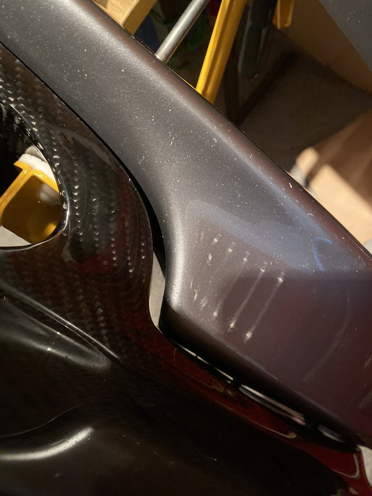

So, I got the bootlid painted.. 90% happy with the paintwork.
tried the first install and the number plate lights do this.. hilarious..
Just what I wanted to see after paying out £300 for the bootlid to be painted..

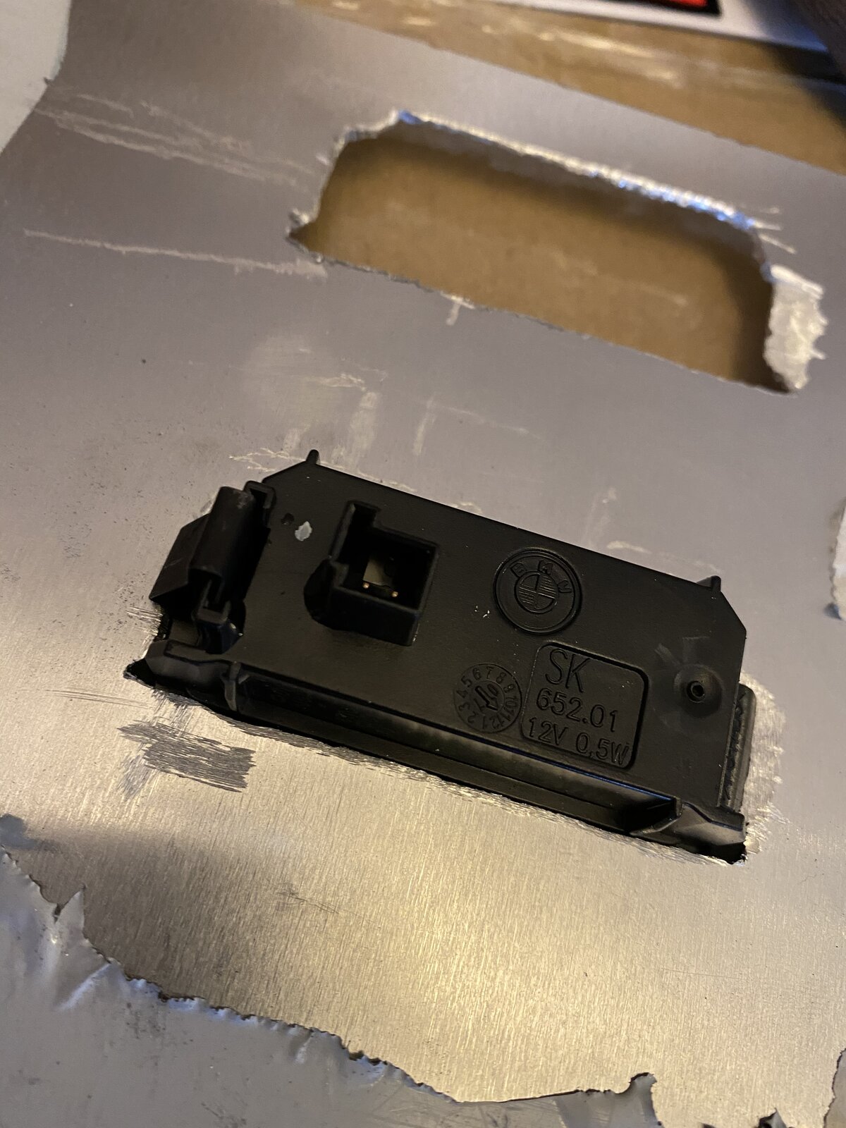

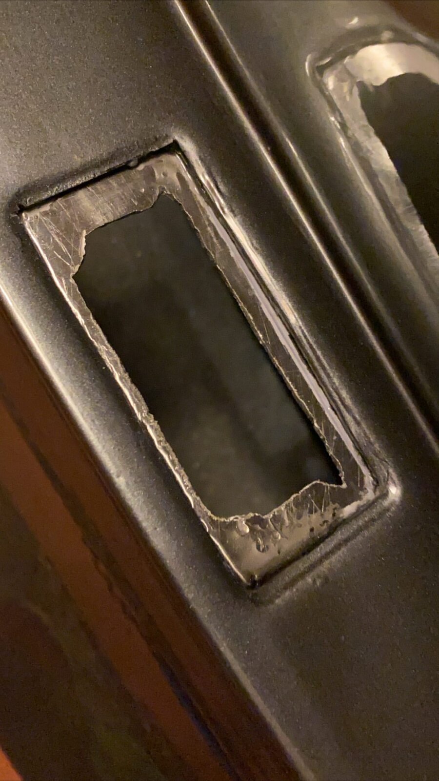

so I set about making some metal brackets that I’m going to bond on the inner of the carbon skin so they hold them without falling out/through.
Not the smoothest cuts as my dremel was overheating.
This bootlid has taken about 12 hours of preparation time, it’s been very time consuming!
Will be worth it once it’s fitted.. I hope..

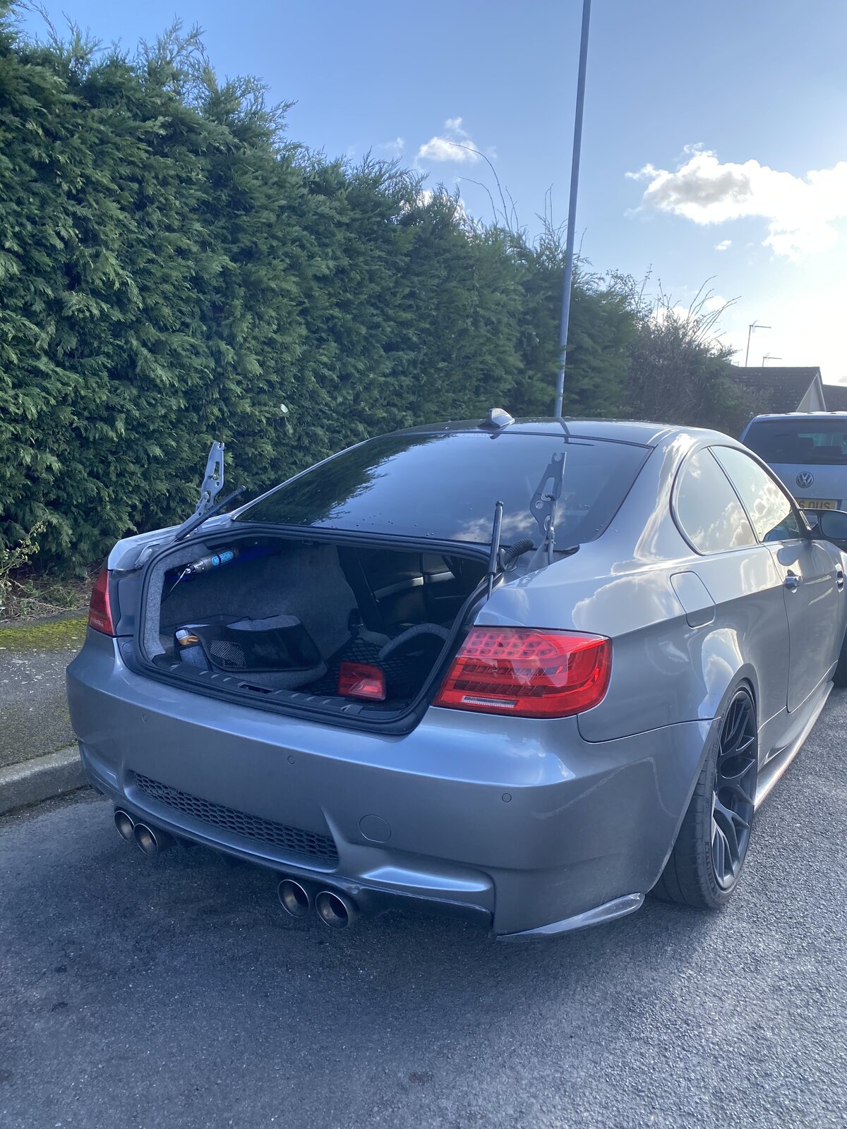

Today I set about installing the carbon bootlid.. actually changing over bootlids is relatively easy for anyone to do, not when there were problems I should have expected.
Original bootlid off!
Carbon bootlid trial fitting..
Finished article.
I think it looks epic, it’s all a little bittersweet though as I’ve got to re bond a number plate light surround again. I’ve got to raise the catch on the chassis by 5mm so the bootlid closes easier and actually hits the micro switch in the lock. It currently keeps thinking the boot is open and giving me dash warnings.
last but not least, I can’t drive with my window open as I get fumes. May have to order a slightly taller seal for the boot surround as I’ve tried everything else.
Spent about 4 hours today trying to align the bootlid so it shut and latched without too much effort and so the seal was air tight.. to no avail. May try again tomorrow before the wing goes on but I’m not sure..

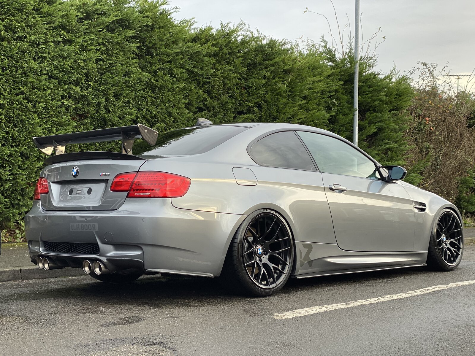

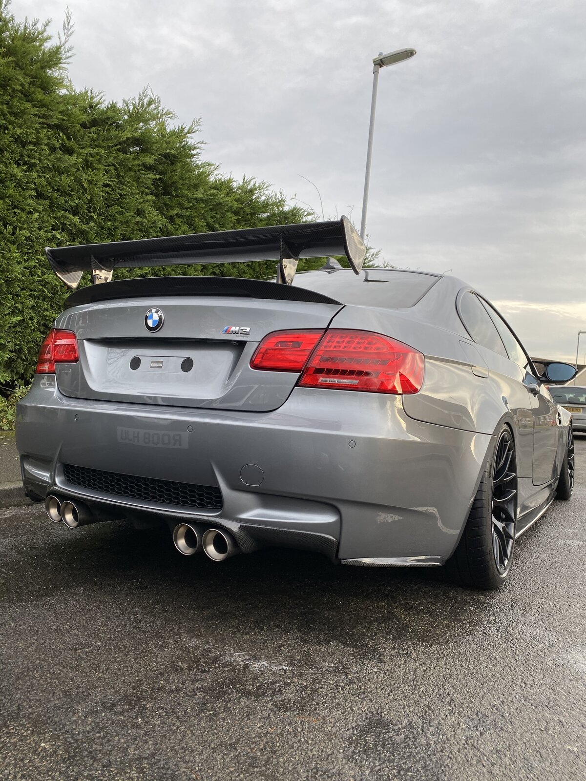

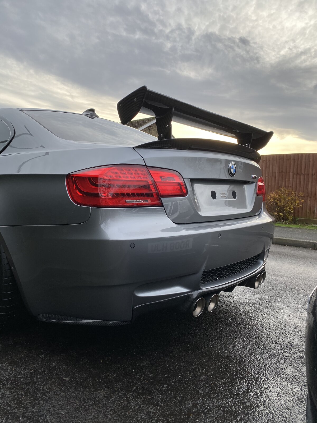

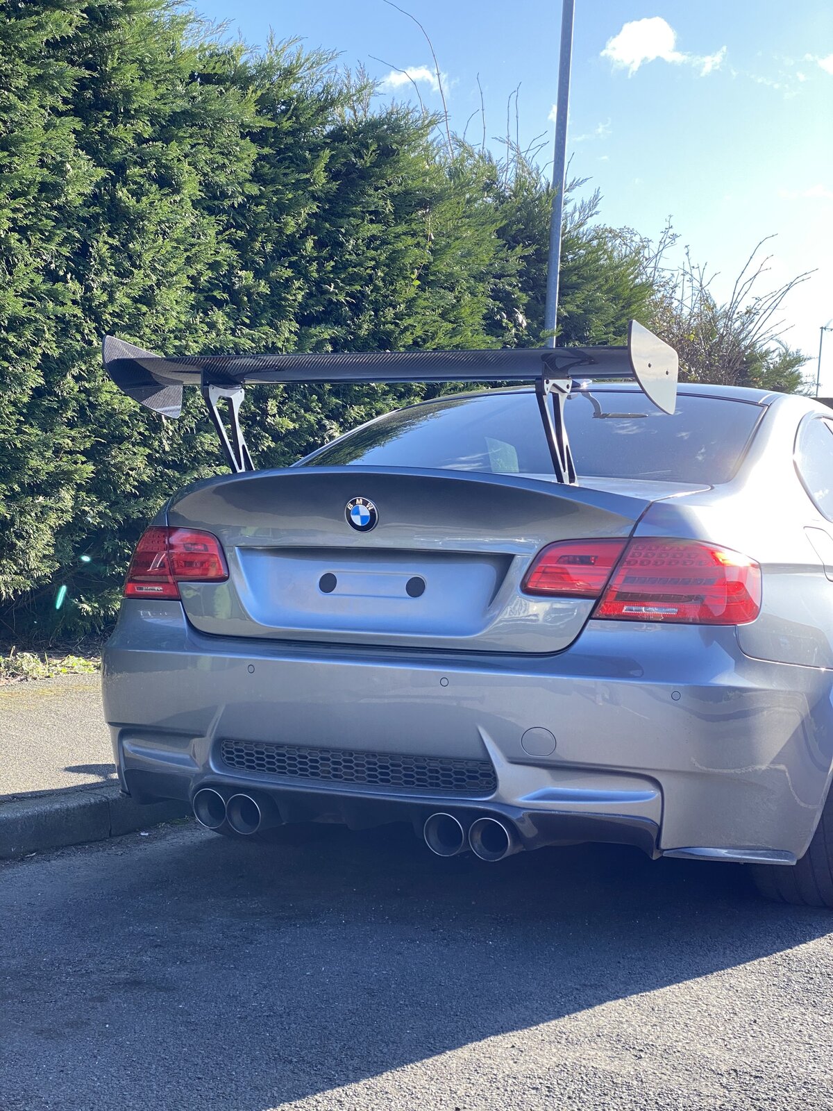

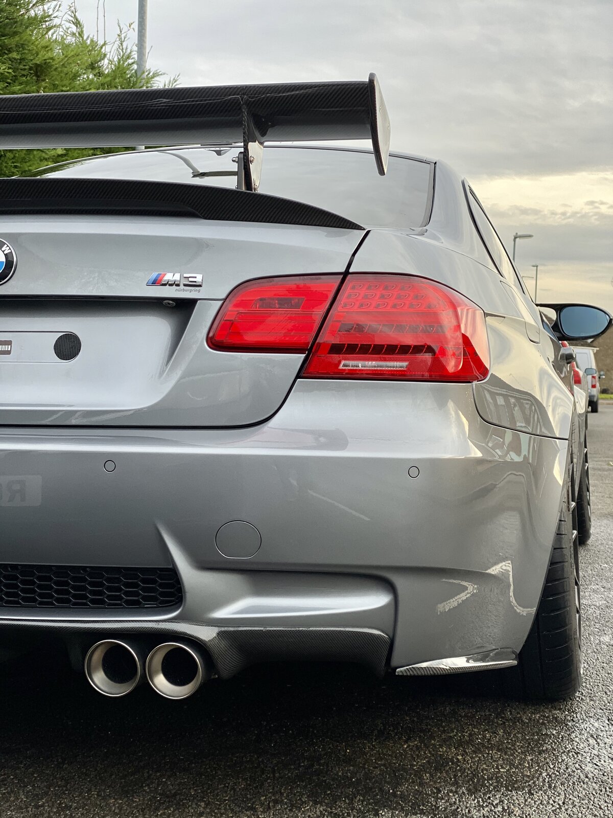

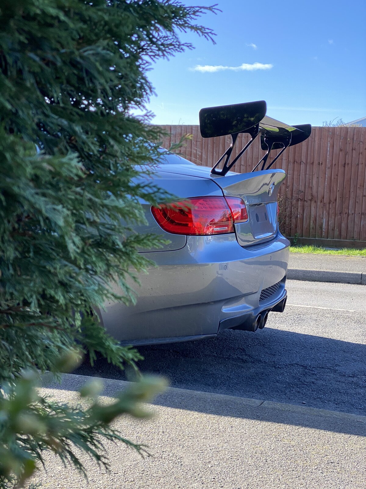

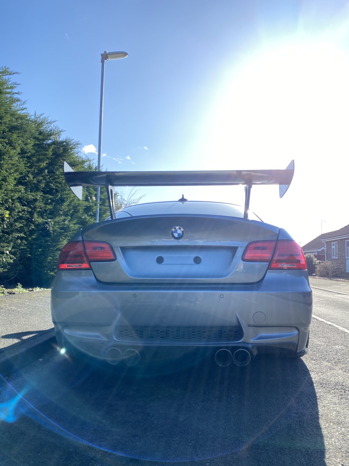

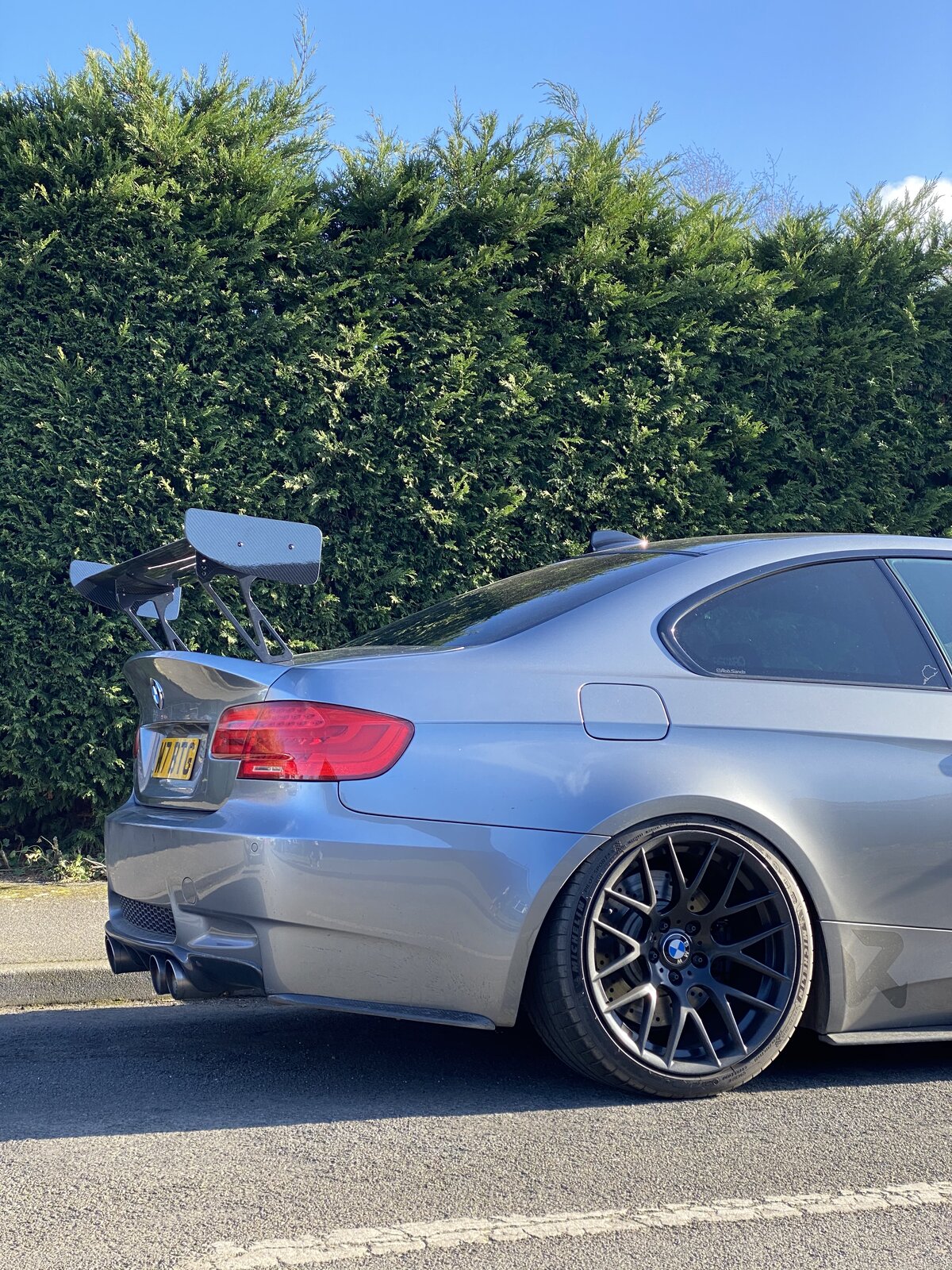

In comes the wang..
Better photos/photo shoot to come once I’ve cleaned it.
Still a few things left to do to perfect the fitment, the boot locks 90% of the time on first closing the bootlid, the micro switch in the boot lock knows it’s shut now.
Ive adjusted all the seals on the bootlid so there’s no longer massive gaps, no more fumes in the car and no drafts either.
The first British car to run this wing, so I’m very happy with it. It’s daft and it compliments the rest of the car.

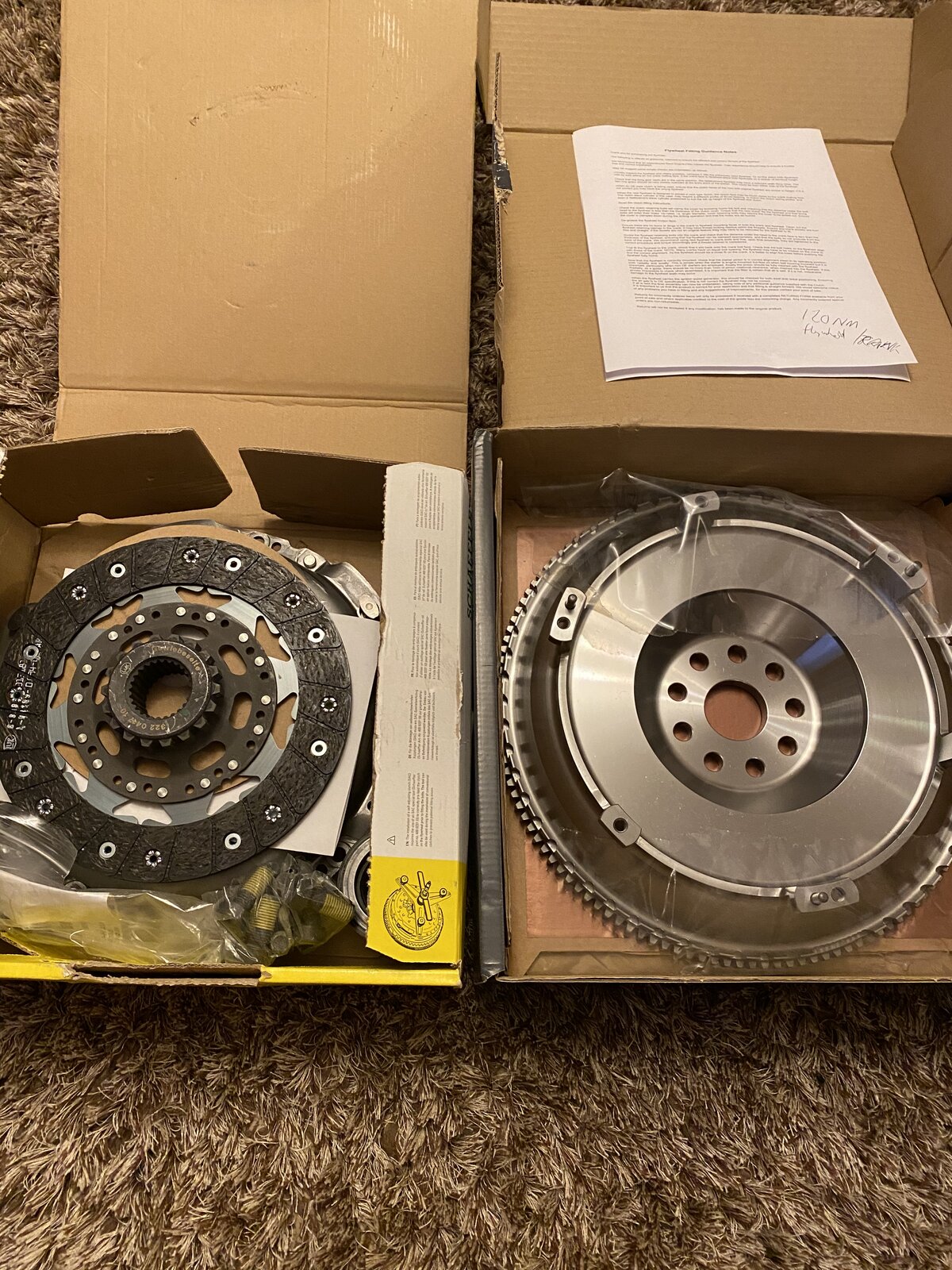

Off to the garage tomorrow to fit these.
LUK OEM Clutch kit, stainless clutch arm pivot pin, main bearings and everything else that could be replaced at the same time.
TTV lite flywheel taking the original from 12.8kg to just 6.1kg. Rotational mass! Can’t wait to feel it rev up after it’s all done.

I think the new bootlid, before you put the wing on it looked absolutely fantastic! I'm just not a fan of the wing :(
I thought the same too, just didn’t fit in with the rest of the car without a wing.
The new wing adds substantial downforce which is needed for track work so I’m happy with it. I look forward to testing it out once it’s back and a trackday booked!

How can anyone hate the wing? It looks better than the GTS wing and suits the car!
-Rob
Absolutely unreal. I love everything about it!
Thanks man, I agree. The GTS looked alright on the road, this wing looks over the top. But on track it won’t look out of place
