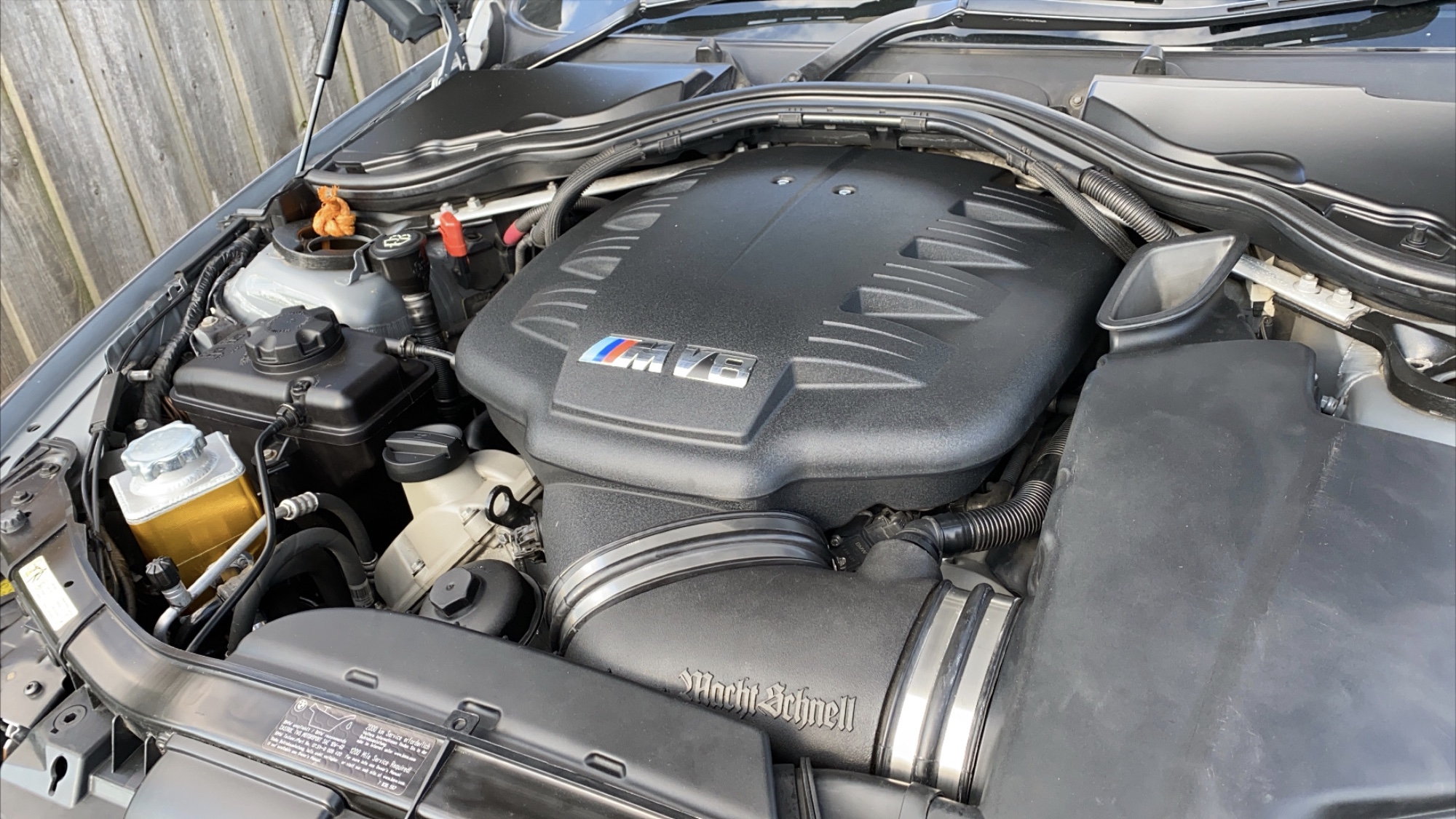

Just another M3, this time with a V8.

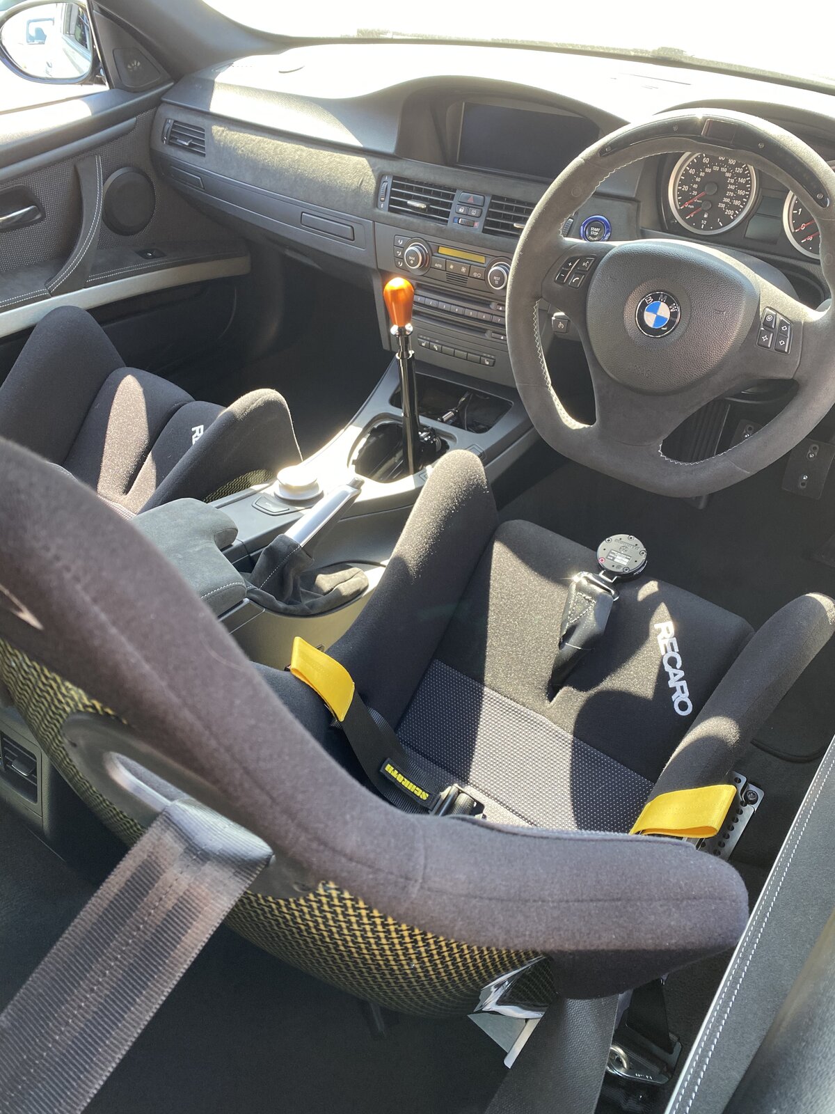

Have some big plans in the pipeline for the centre console, chucking loads of ideas around.
Carbon fibre
Alcantara
Kevlar
Perspex insert so I can still see the CAE
Double/triple Gauge pod where the ashtray was..
Undecided yet! But it’s getting there!

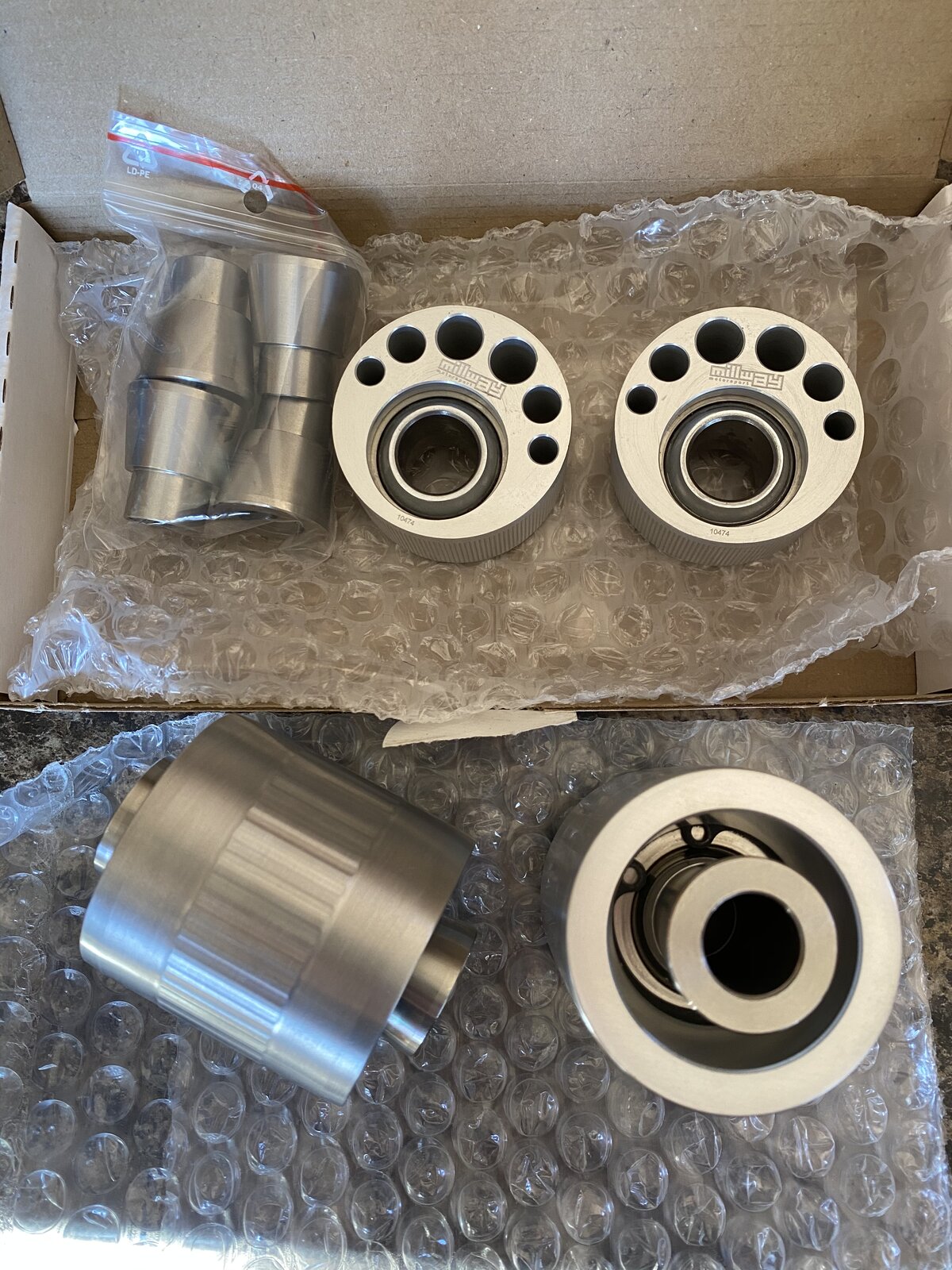

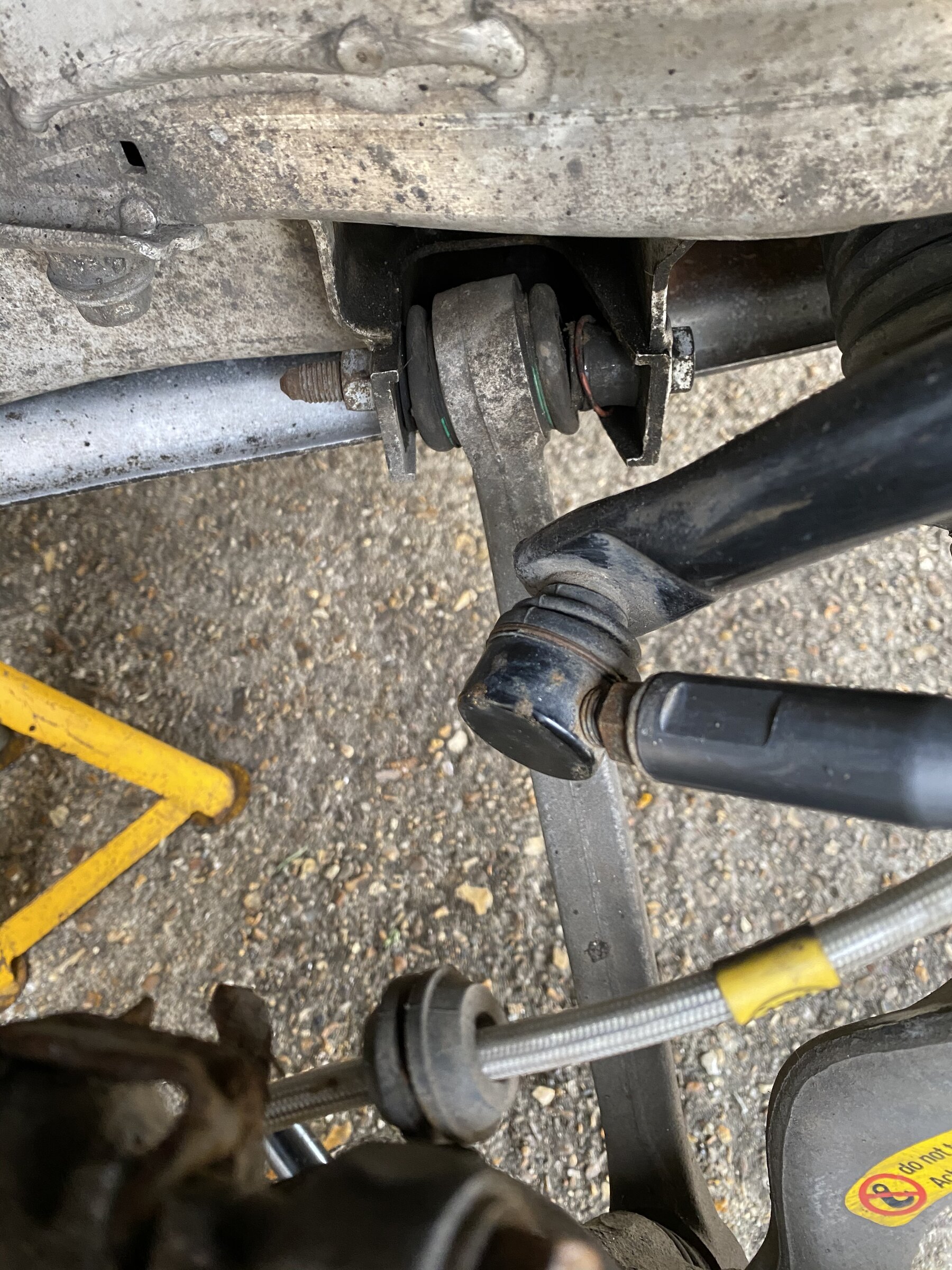

New rear camber bushes arrived, because my camber is 0.7 out of perfect when setup. Not to mention my inner bush looks absolutely destroyed after 12 years on the road. Should keep my camber more consistent especially under load - must have for running slicks.

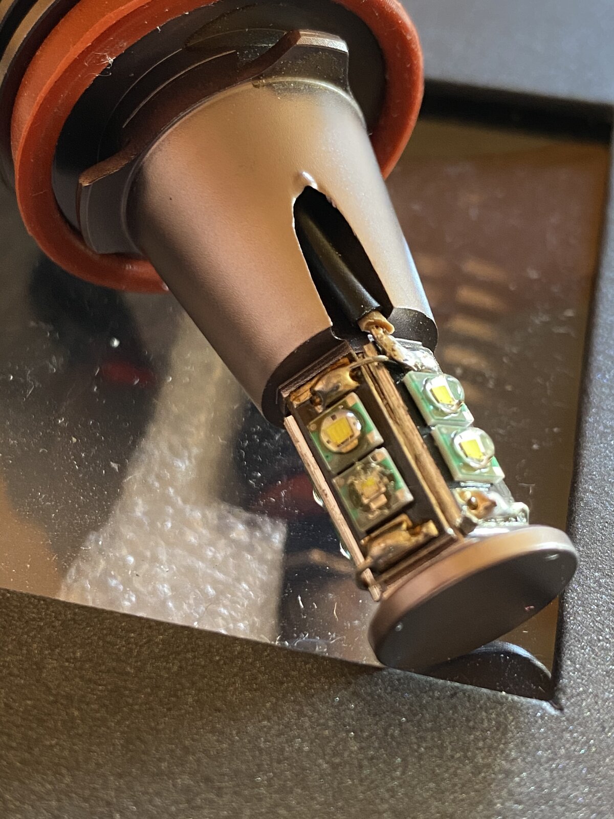

Anyone know how to fix this LED board on my LED sidelights? Would like to fix these as they’re £115 and im decent with a soldering iron. So if anyone has any suppliers that would be appreciated as I can’t find anything.

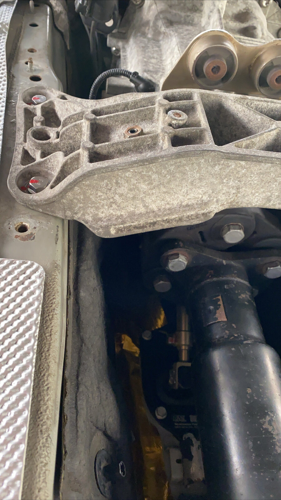

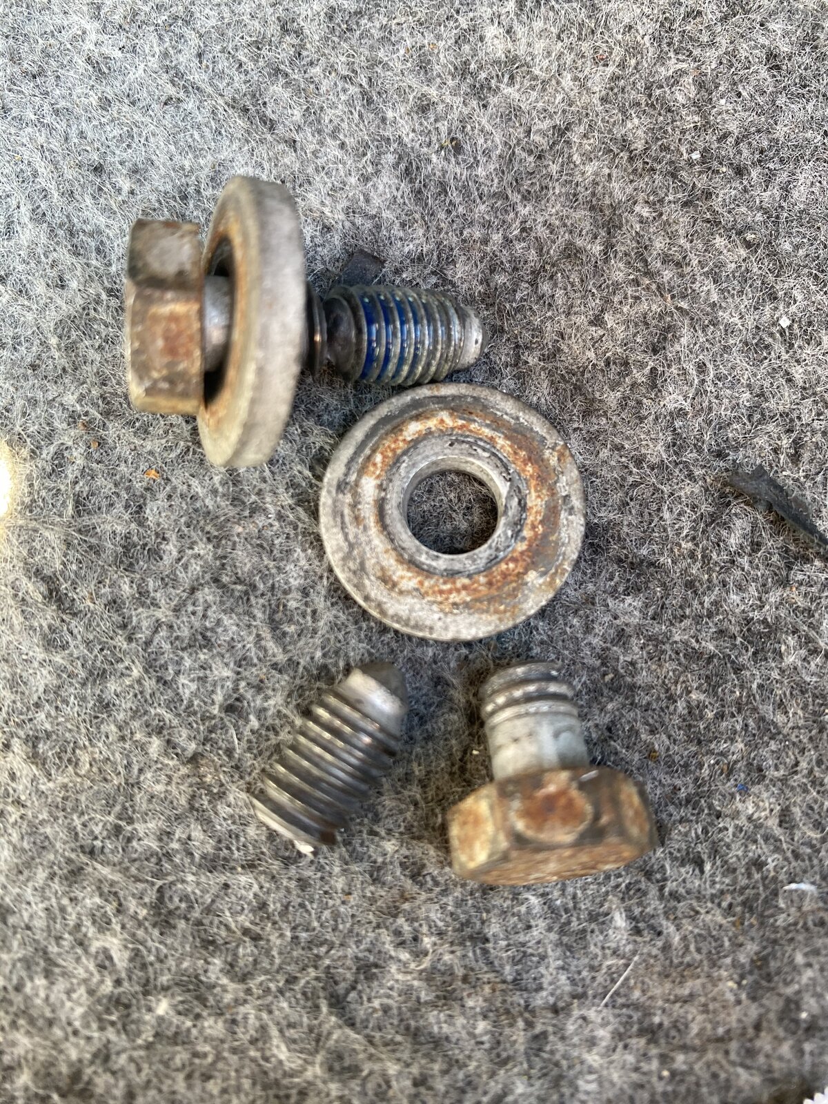

Jacked up the gearbox, put the mount on..snapped this bolt putting it in. Managed to drill through it and the drill on reverse removed the left over bolt in the chassis - which was very lucky!
Ordered and paid for new bolts from BMW that were missed by the garage on the lunchtime delivery by 10 minutes. Expecting them the middle of next week now as they weren’t sent out today so they’ll be processed on Monday now.
Made do temporarily with these I had laying around from another project. So I put them in, torqued them to spec and marked them in hopes they don’t cause me any problems until the new OE bolts arrive.

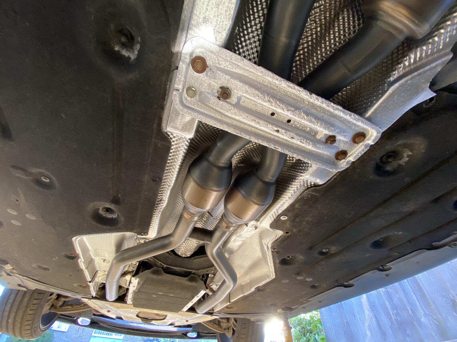

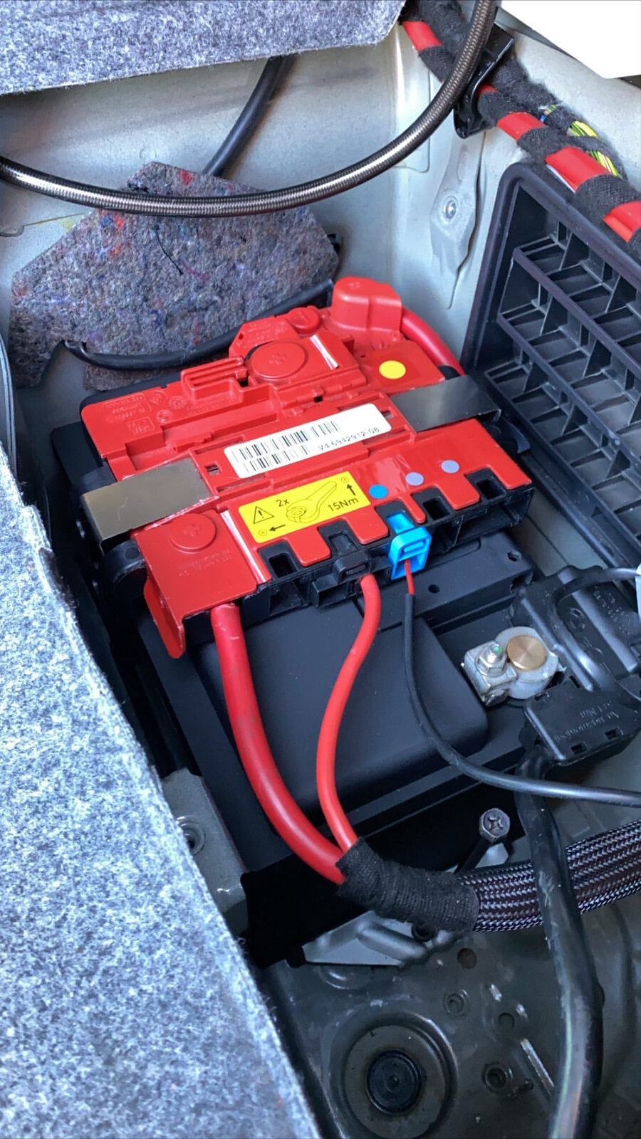

I managed to fit the new upgraded Deadweight Max battery today, fits substantially better than the previous one, no faffing - complete plug and play and at 950cca and 120ah it far outperforms the standard battery at 800cca and 80ah. Plus it only weighs 5kg instead of the 27kg original battery.

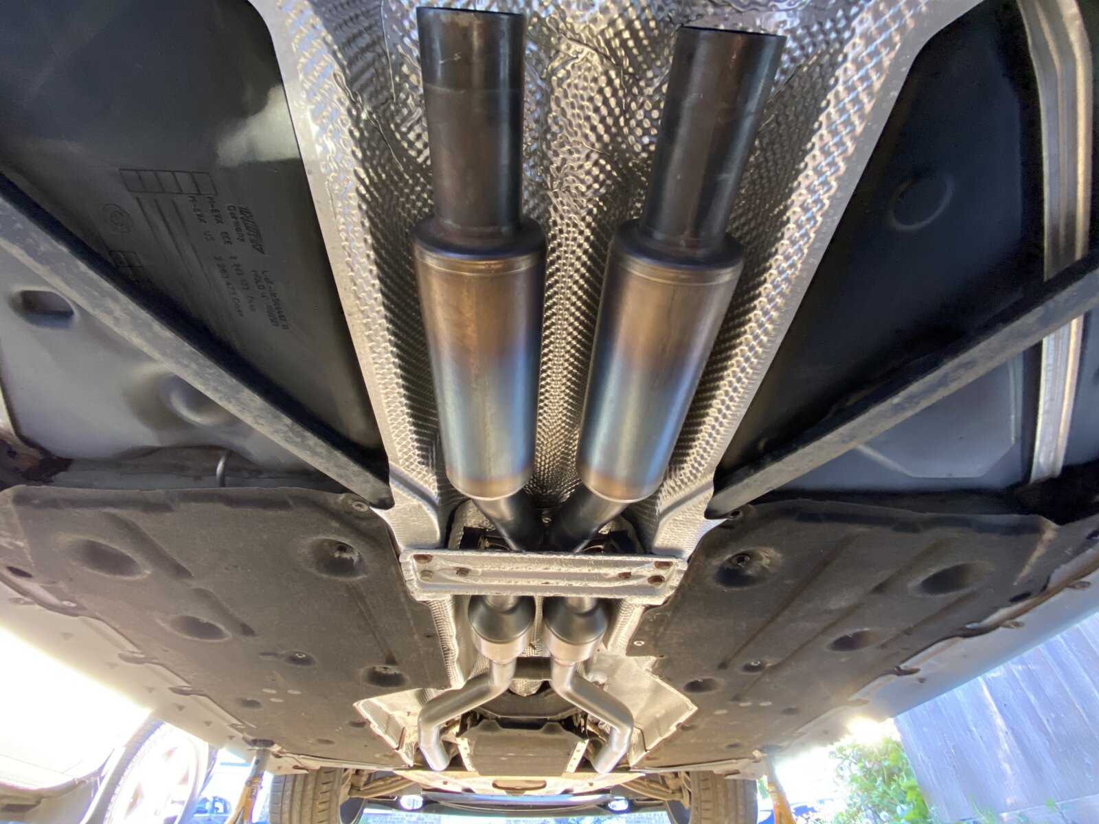

Everything seemed to be plain sailing from there on in, fitted the centre section back underneathI’ve realised it’s exceptionally easy fitting an exhaust by yourself when it’s made from titanium!
Back-boxes left to fit and then I can drop the car on the ground and use it for work again..

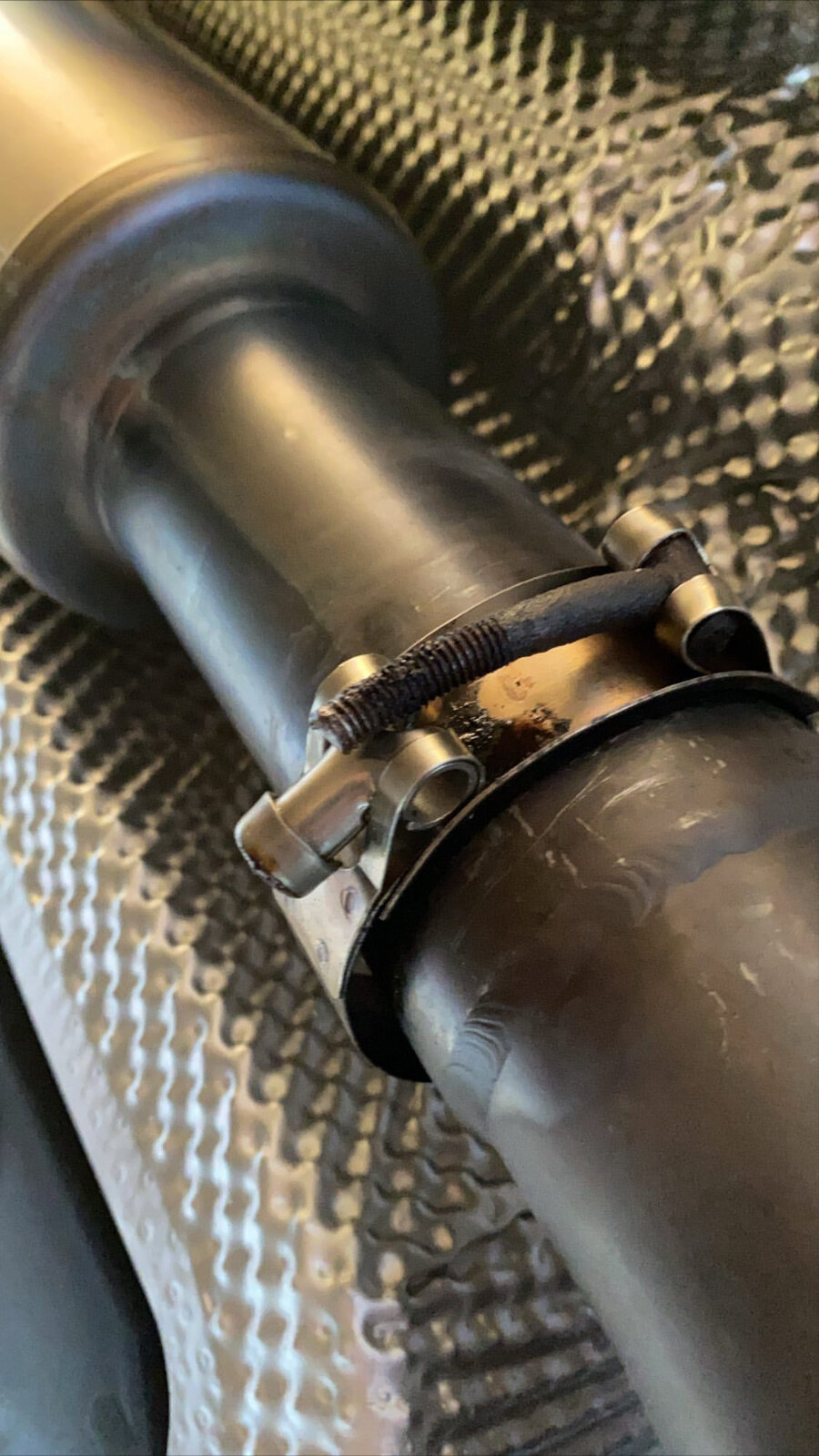

Then this happens;
Fatal. New exhaust clamp online earliest delivery is Tuesday next week so I’ve asked around local garages and a few specialists in the hopes of finding two new 60-68mm exhaust clamps.
One step forward and two steps back, at least once it’s all done I know it’s been done properly with no corners being cut.

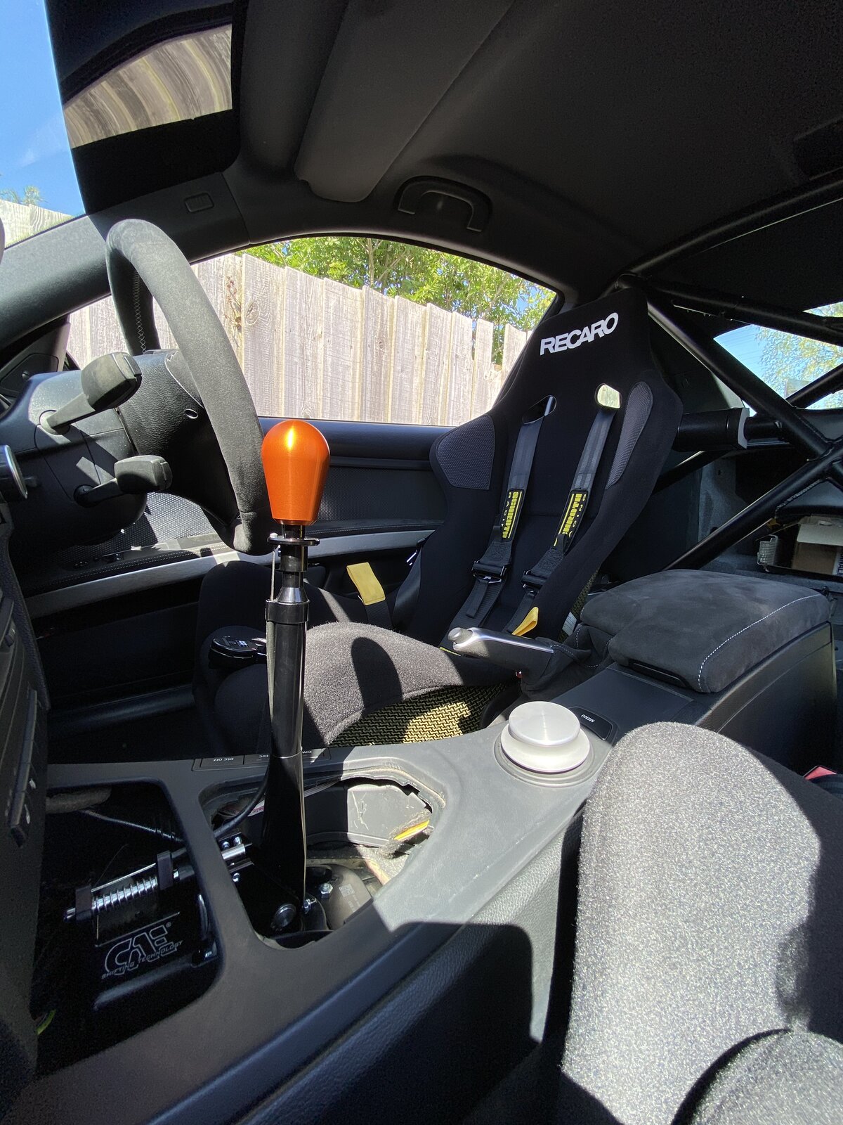

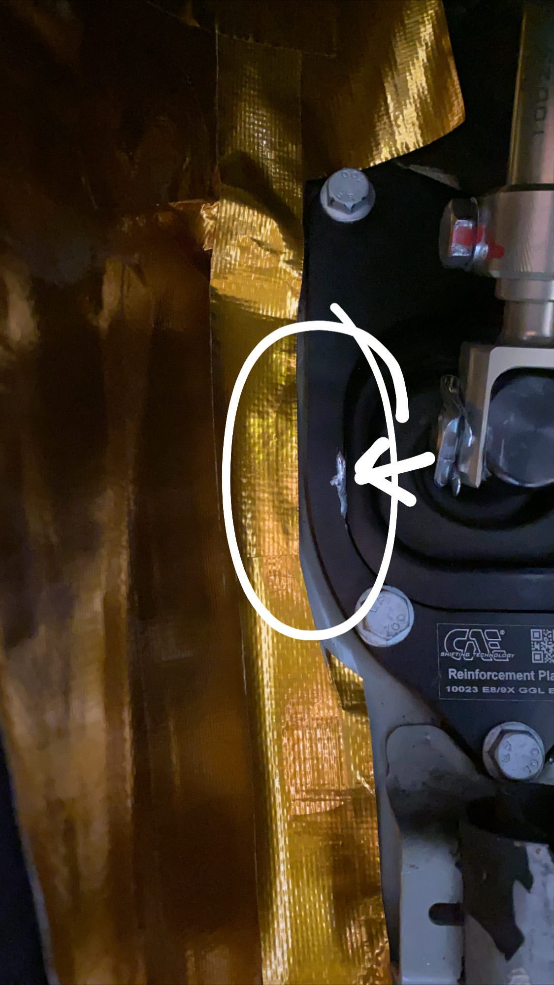

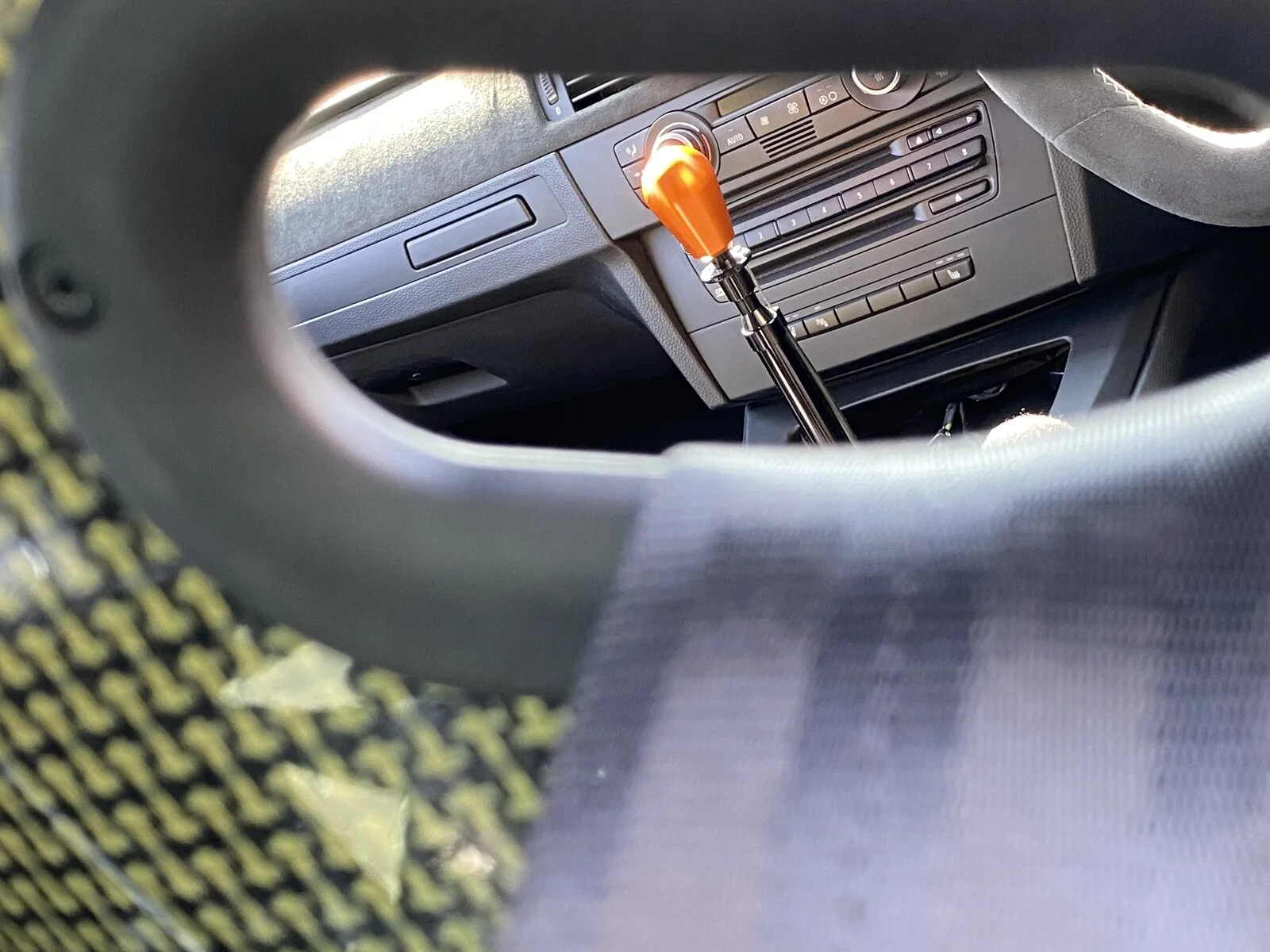

This could be the reason it wouldn’t select reverse..
Some idiot put the butterfly clips on the selector rod the wrong way around.. (me) so it was hitting the bracket below.
The CAE tolerances are minimal so I had to take the entire selector rod off - about 40 minutes of faffing later.. swapped the pins and butterfly clips around and it worked as it should.

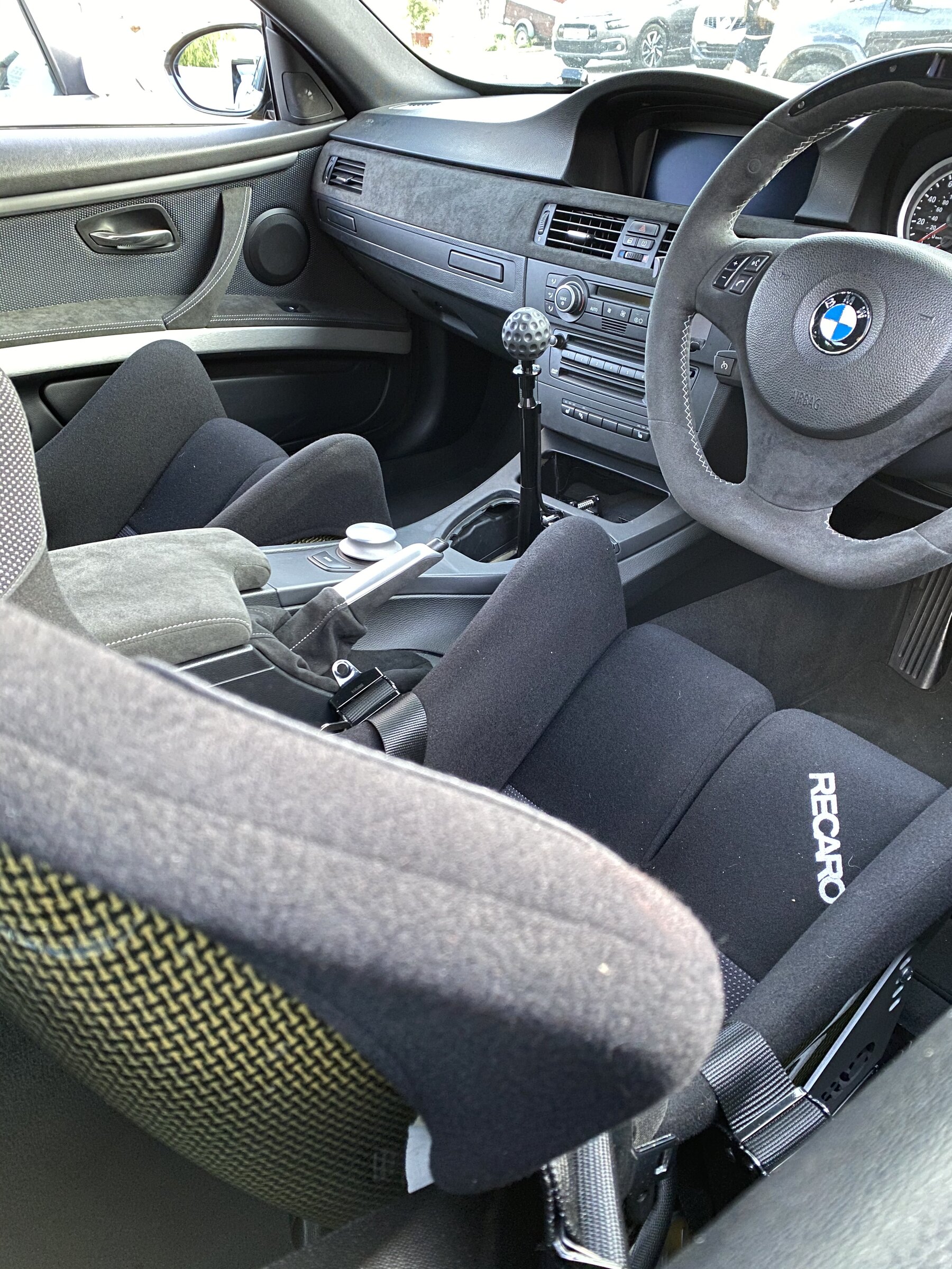

Put the BMW motorsport gearknob back on the shifter. Feels nicer than the CAE gearknob.. need to find some thread paste/glue/tape to thicken up the thread/stop movement.
Even managed to take it into town without getting stuck!

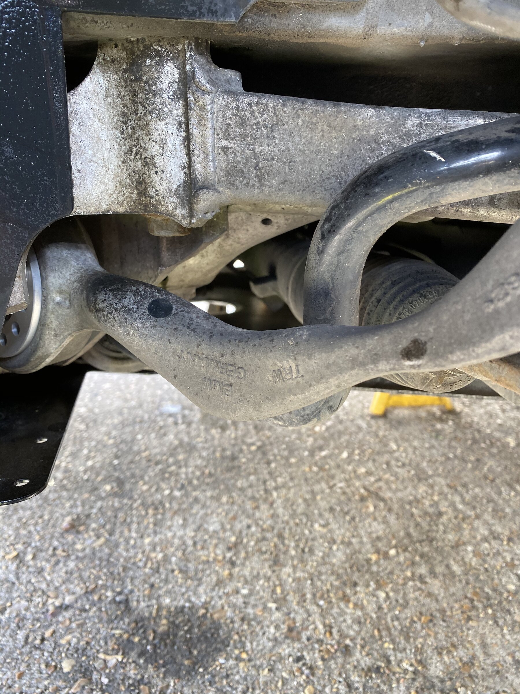

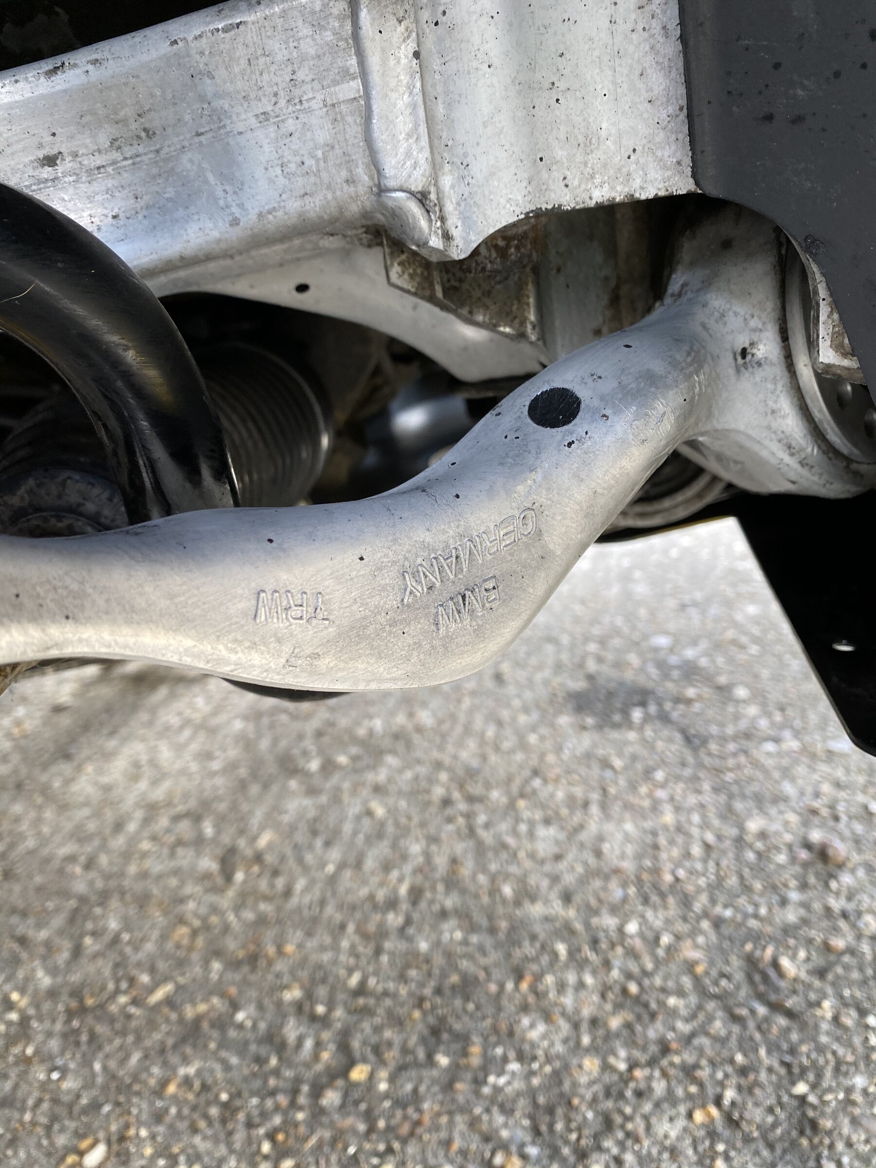

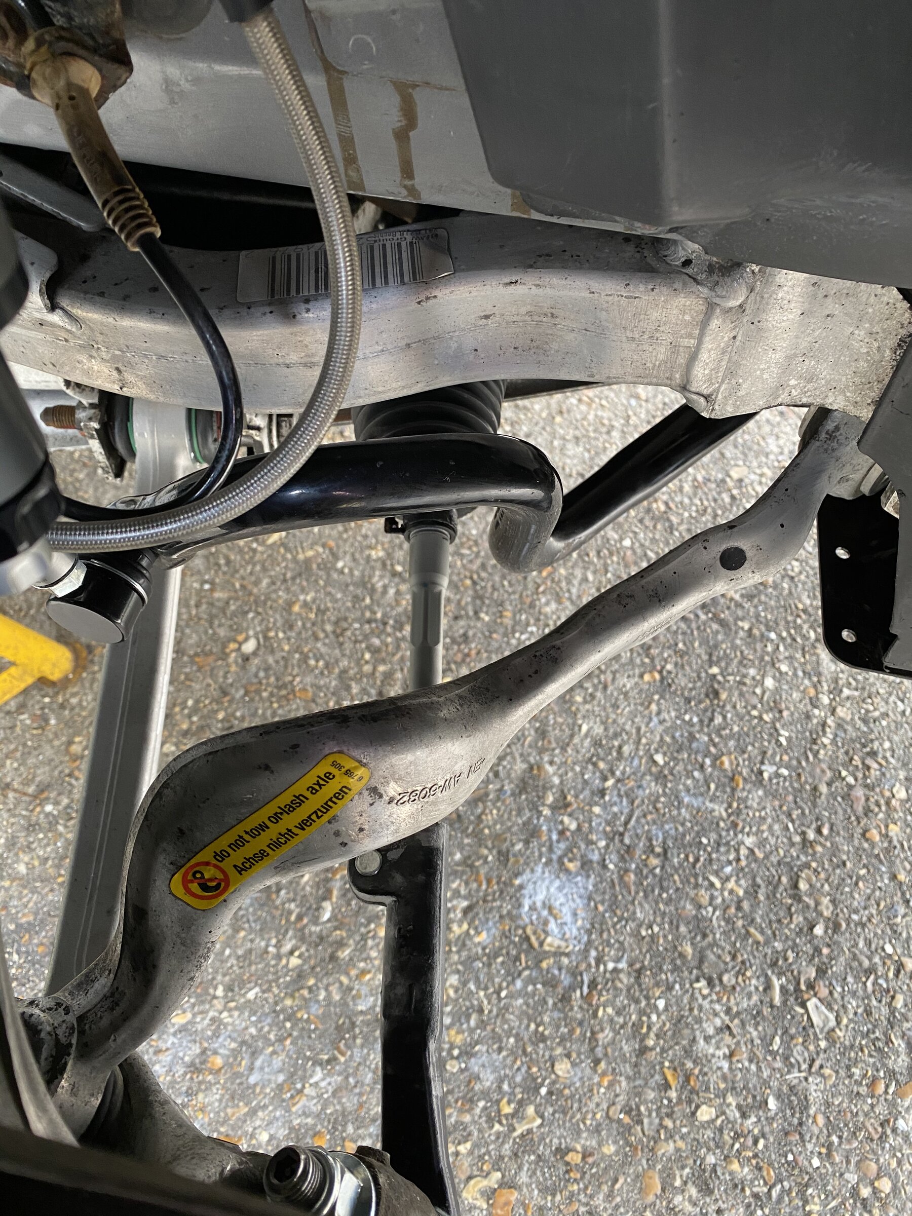

Also found this front lower arm, so I’ve ordered two new ones, track rod ends and tie rods so it can all be added for the fresh alignment.
Need to find some incredible aluminium cleaner as I hate the pitted look on the subframe.

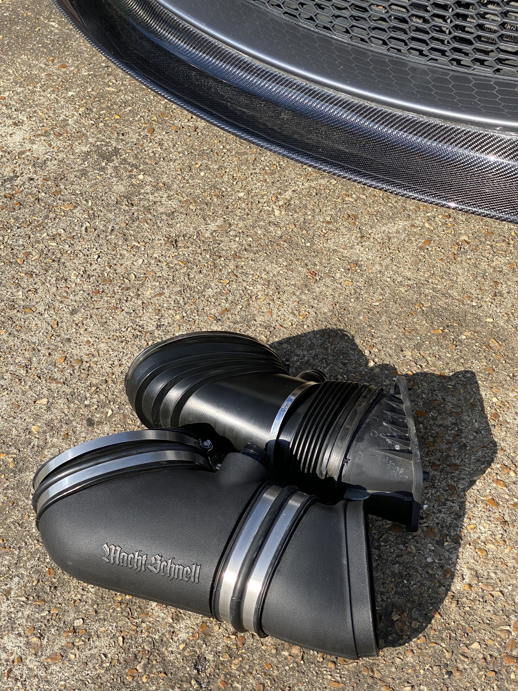

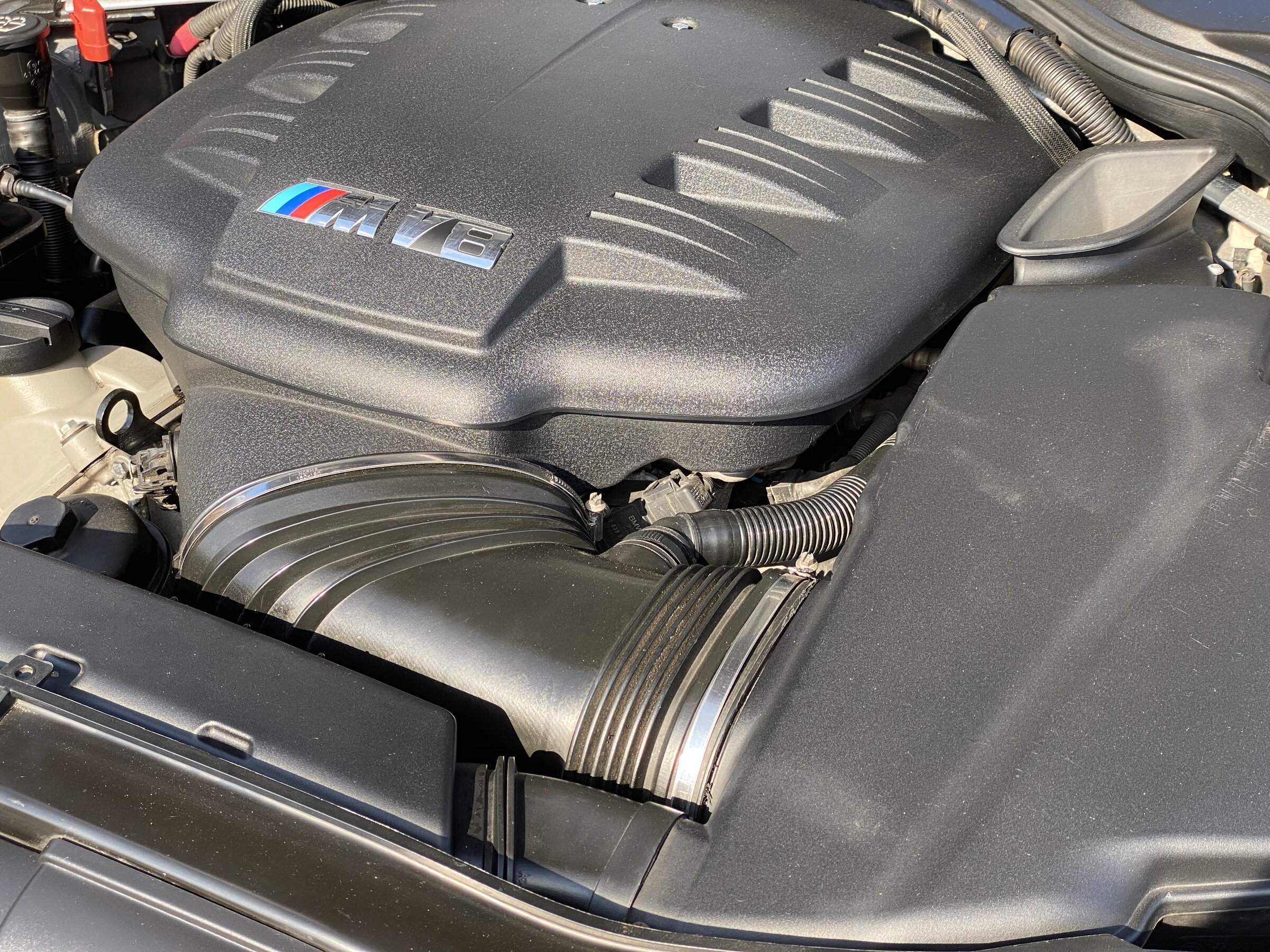

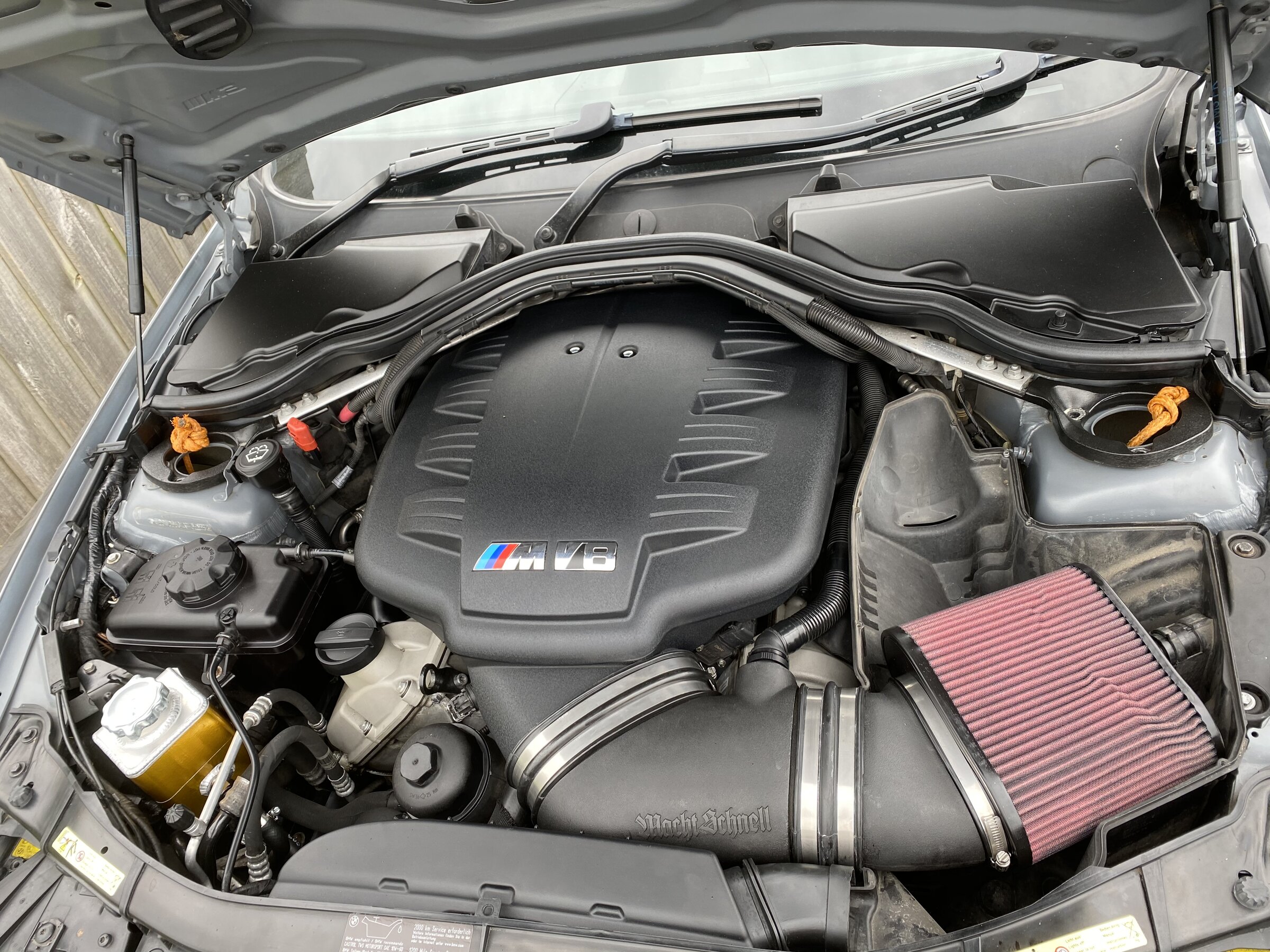

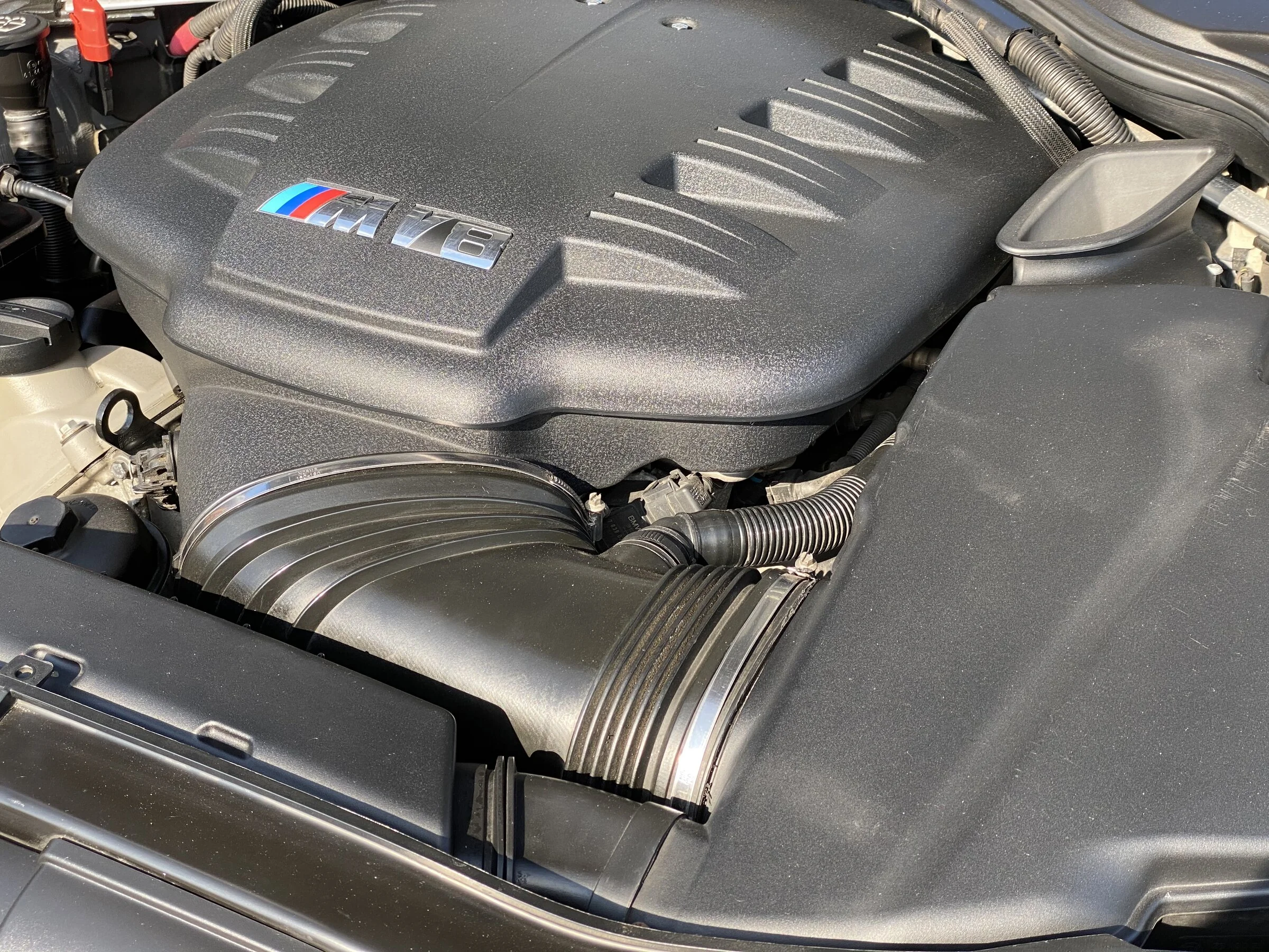

Intake kit arrived from America, that’ll do! Bit of a used bargain.
Cleaned up and re oiled the filter.
Before
Size difference
Air filters pretty huge..
Finished
Should give 8-12hp which I can’t argue with. Lovely fitment!

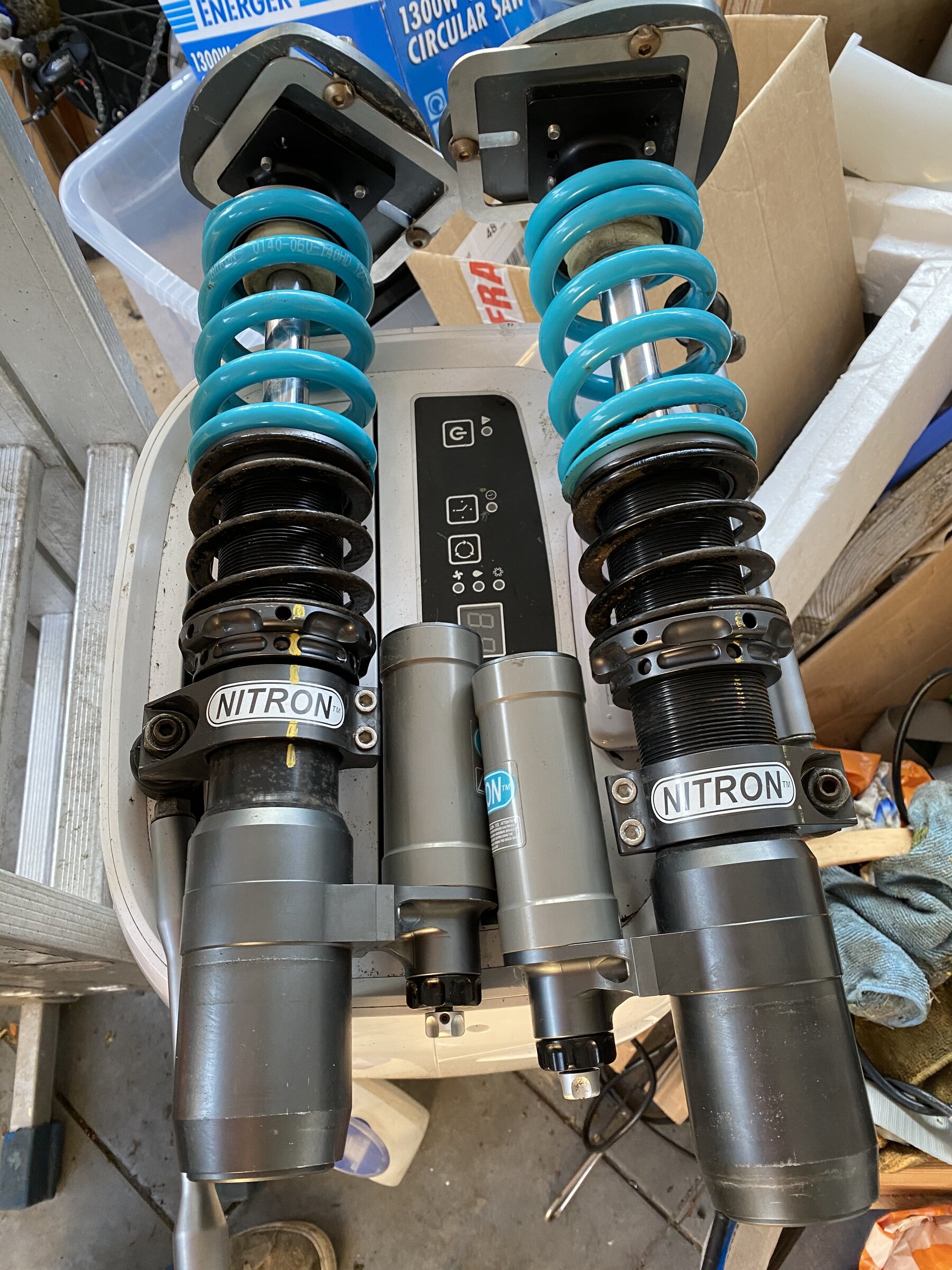

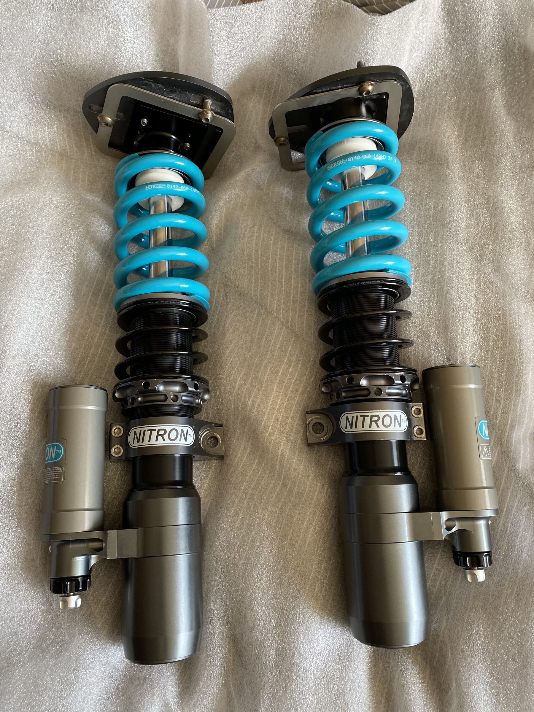

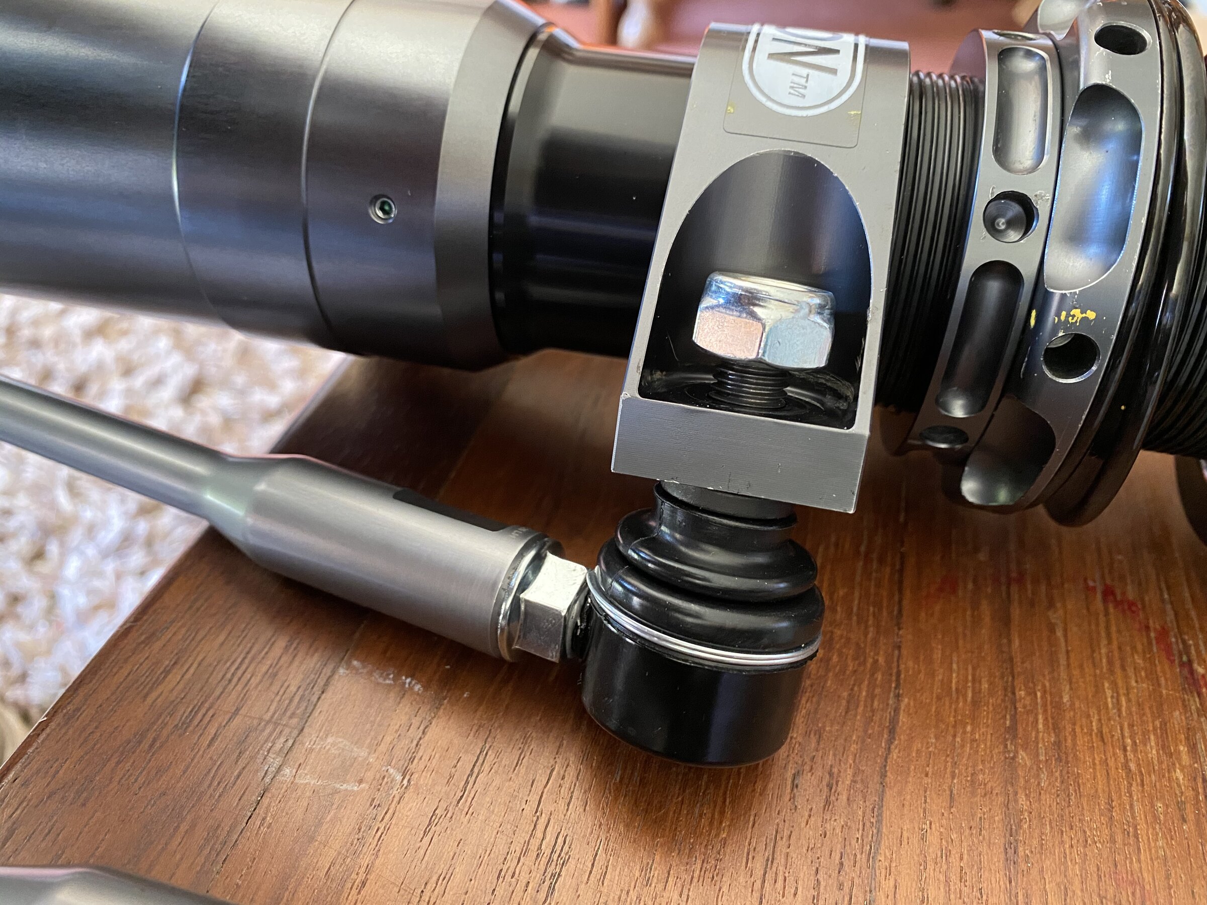

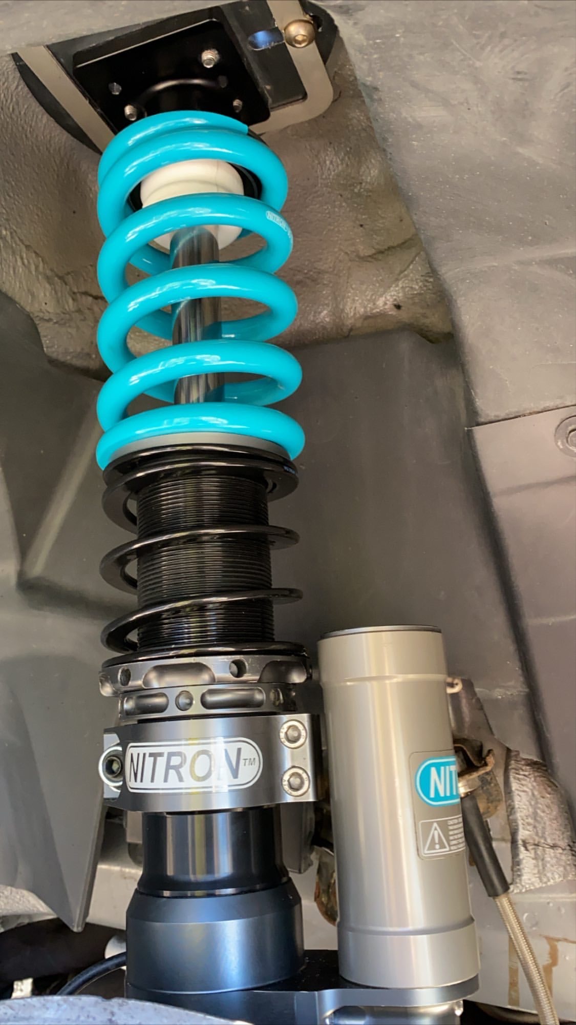

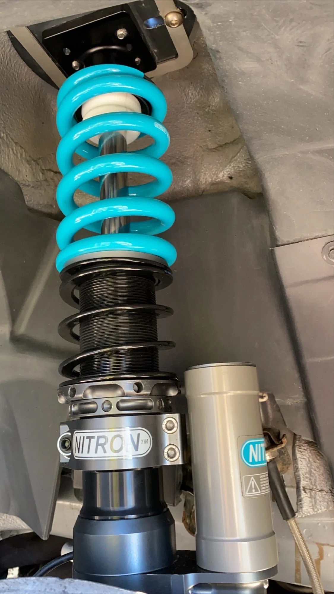

Dampers arrived back from Nitron, like new!
Decided my hubs and other arms could do with a bit of a clean so I bought some Frost Ali clean, this stuff is epic! One pass with it made a world of difference..
Before
After

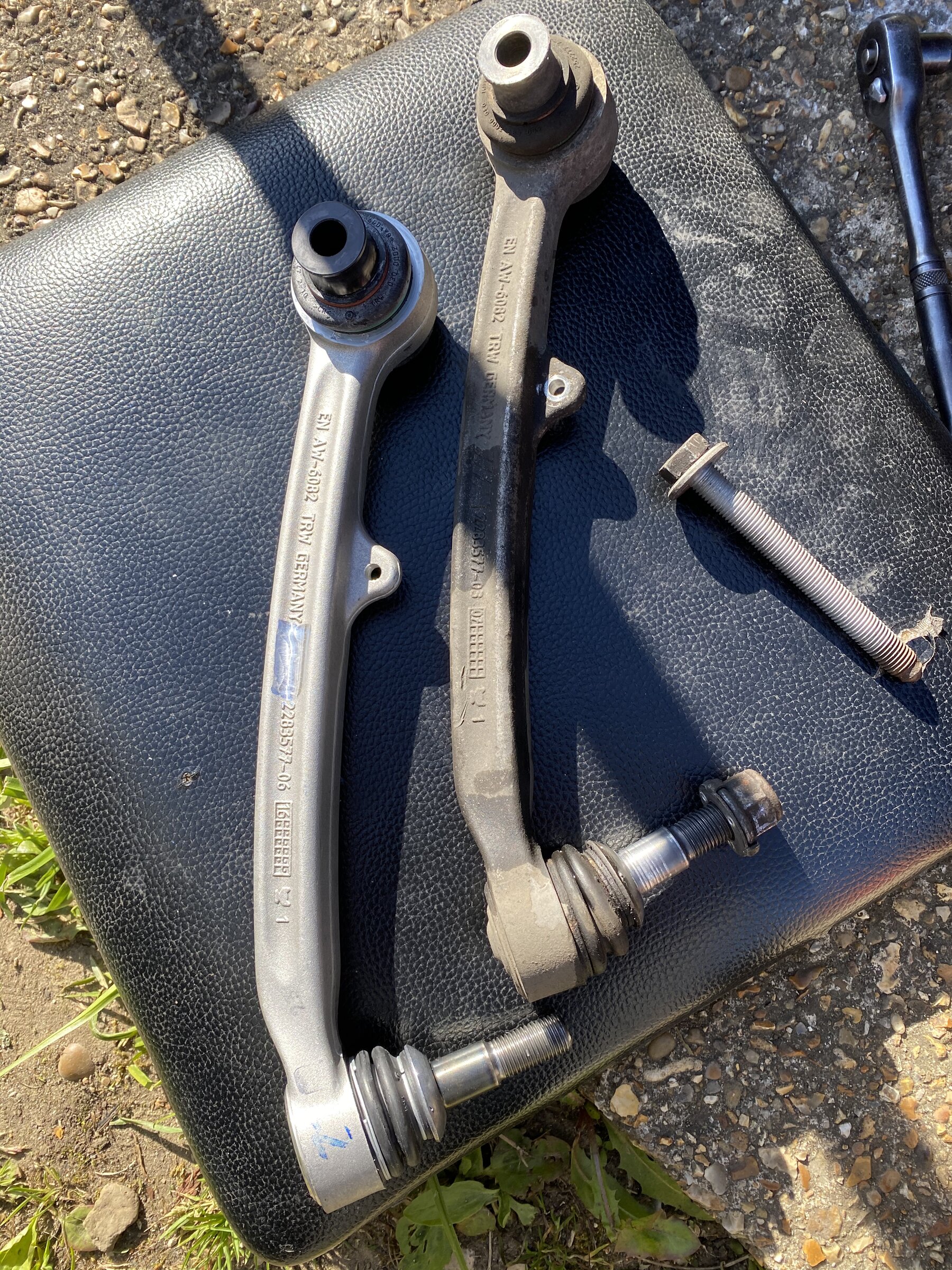

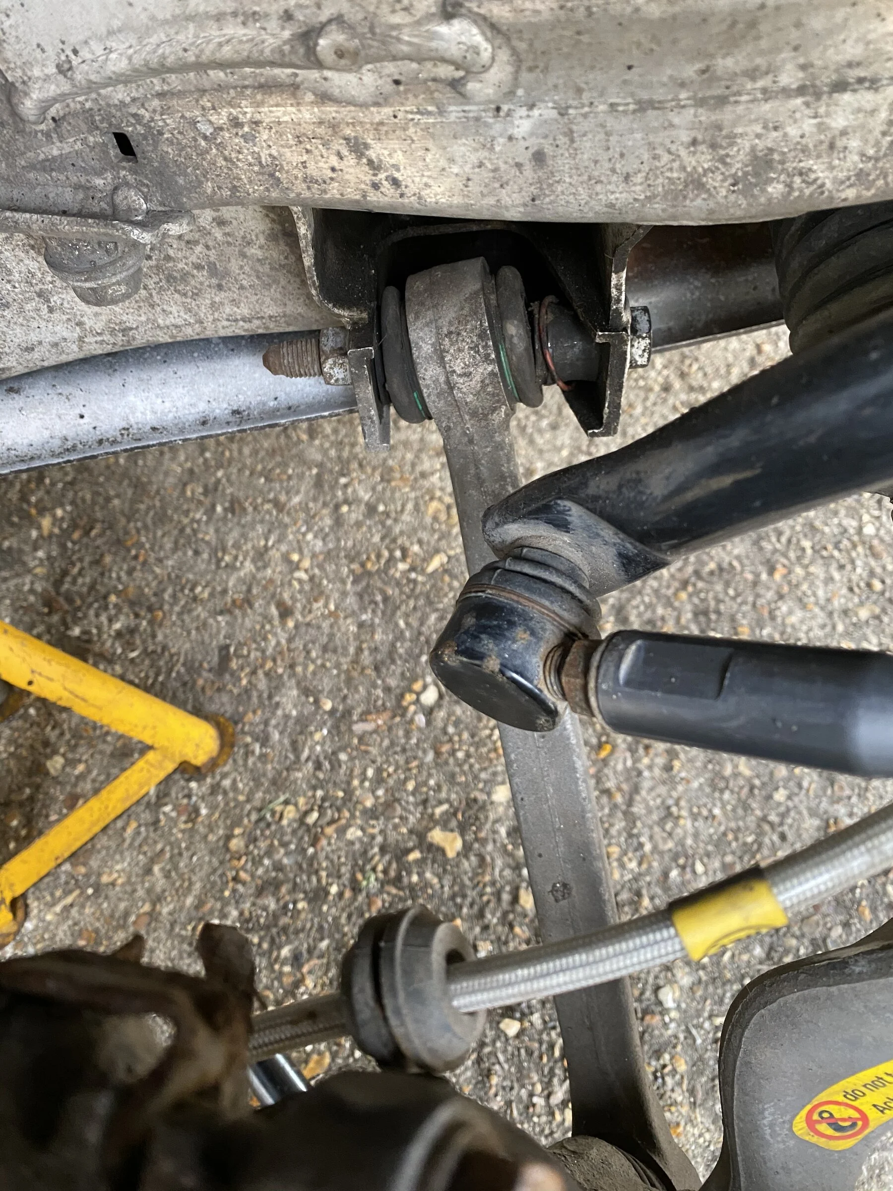

Also replaced my lower front arms as one inner bush emptied itself and they were beyond their best. I also bought inner tie rods and new track rod ends which will be fitted once I buy a 38mm
Nitrons fitted again.

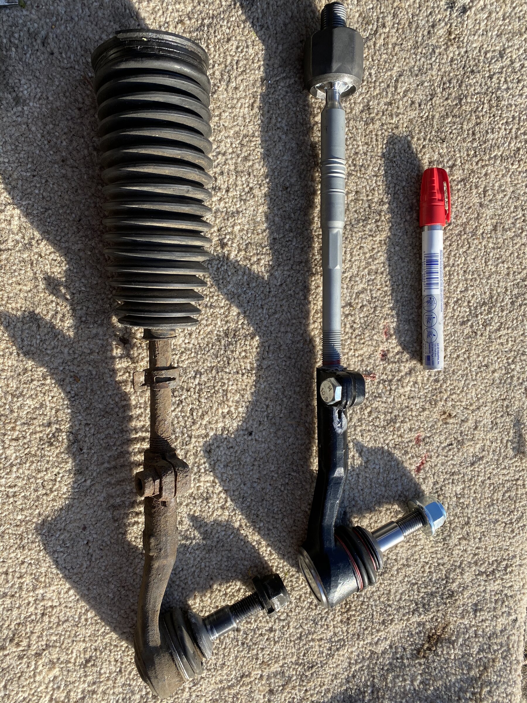

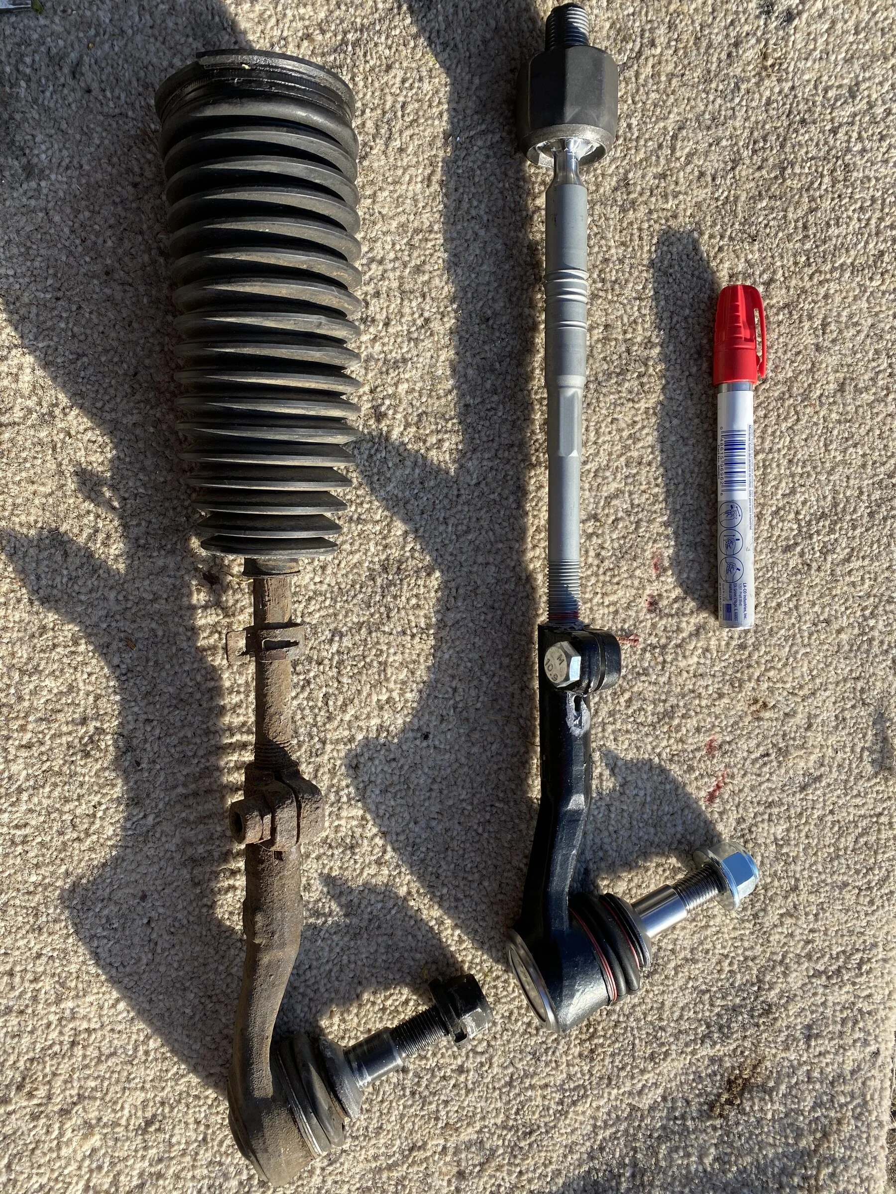

Before and After on the tie rods and track rod ends.
All fitted!

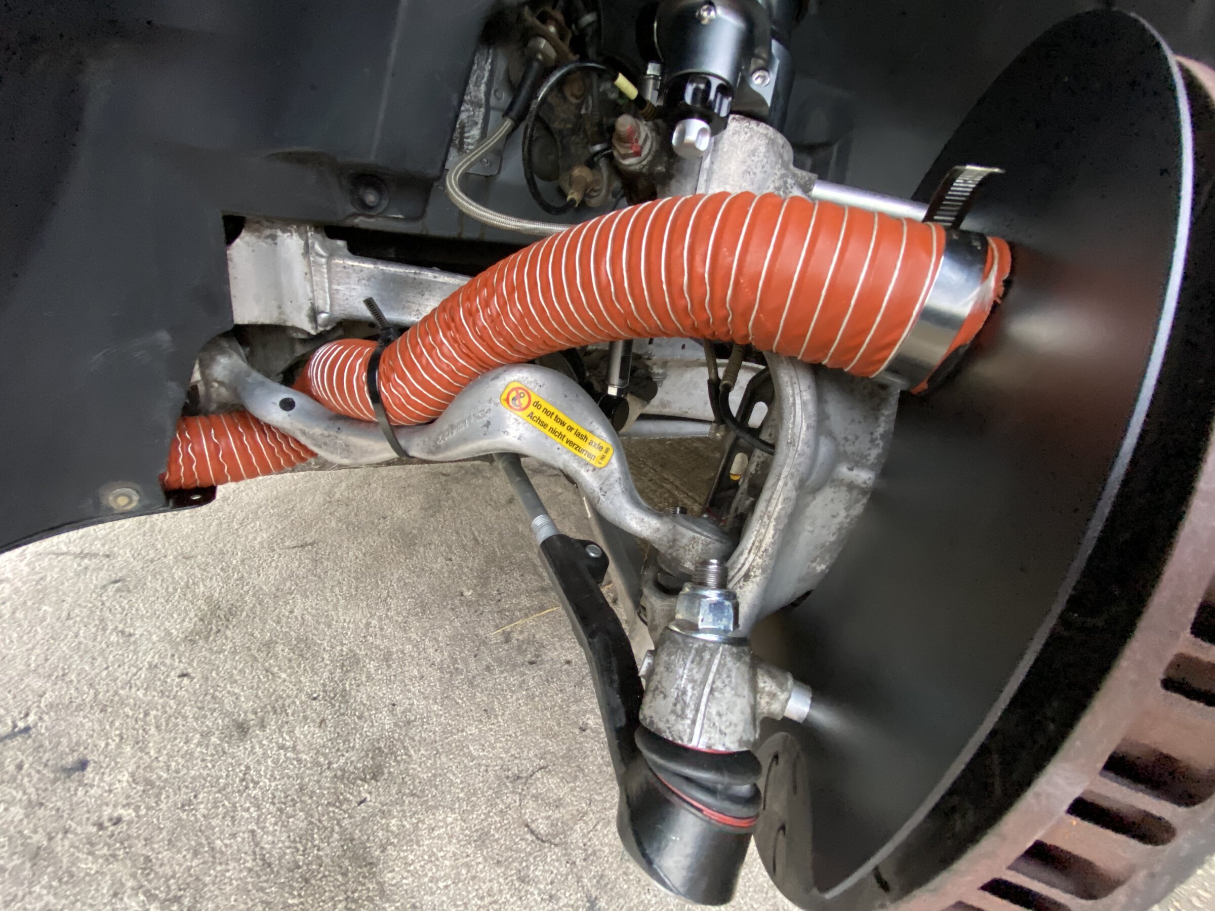

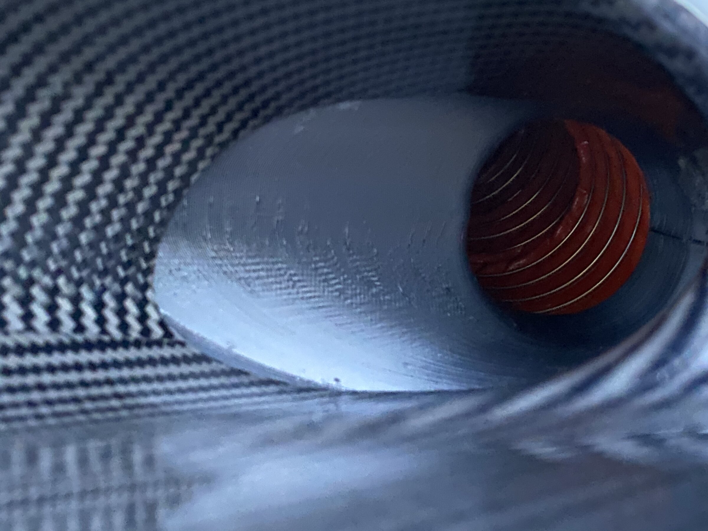

Then set about fitting the prototype brake duct kit with plastic printed duct adaptors.
Booked Snetterton 4th June for a shakedown, hopefully do my first ring trip early to mid July all going well.
