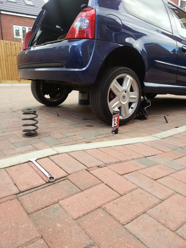

Just fitted a set of second hand eibach sportlines, purchased from icarus83 :cool:
fitted them this morning, was suprised how easy it was to do.
whilst i was fitting them i had the old and the new springs layed out and they looked the same size which shows how they differ in spring rate as once fitted, it is clearly a lot lower.

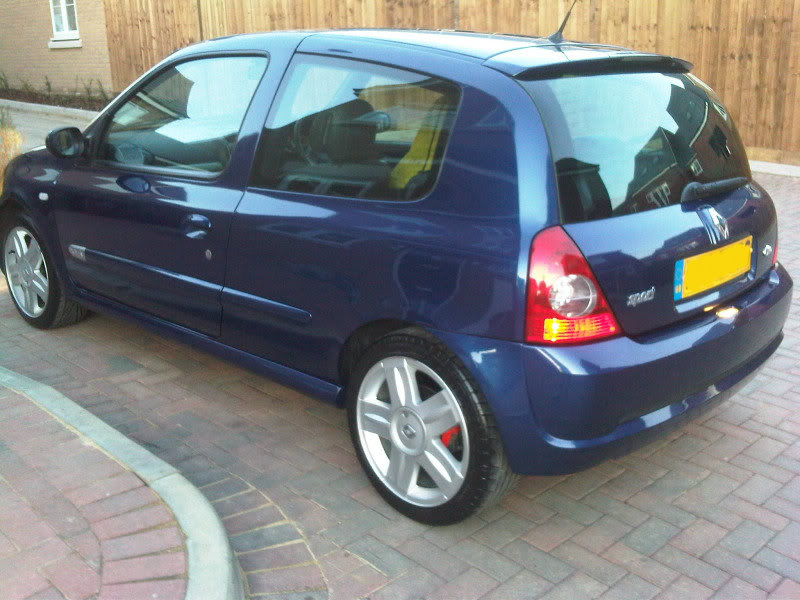

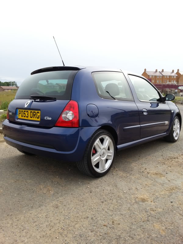

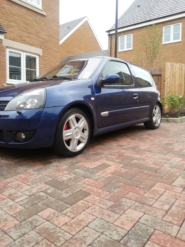

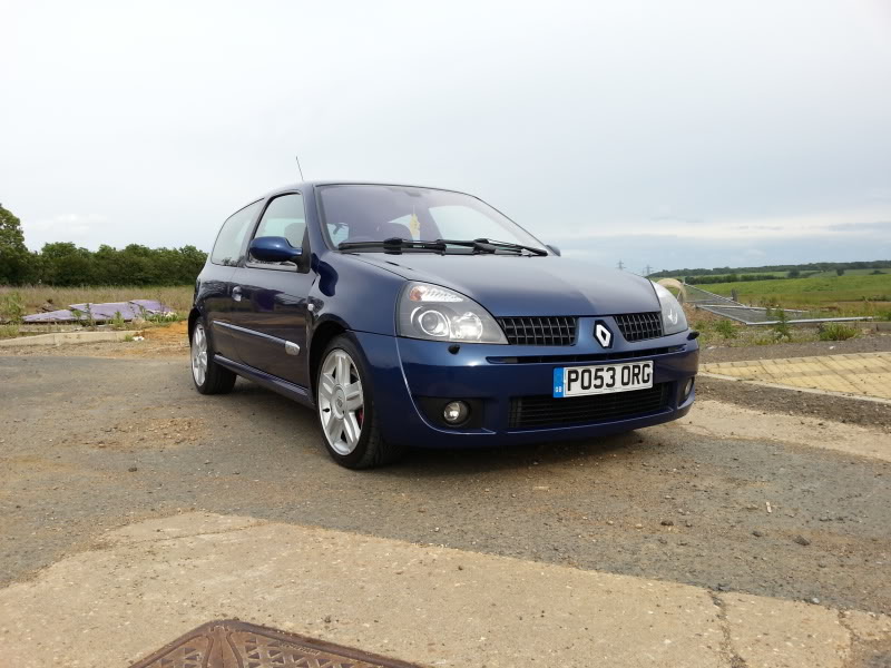

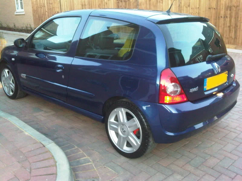

as requested here are some pictures.
Before
after

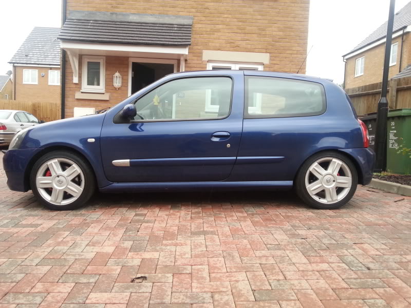

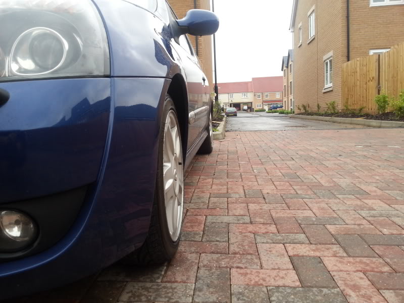

I think I need spacers

took me 3 hours on my own with one jack!
Thanks for the pics mate, much appreciated! Looks good, what spacers are you thinking of? Need to buy myself a set now dont i? :p
Brave lad getting under there with the scissor jack holding it up!

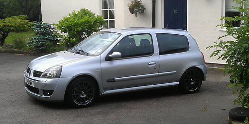

I found they didn't lower the back enough on mine (but yours seems to have lowered it more than mine - guess cos of your spare wheel?), looked standard so I got them sent off to a place in Sheffield and for £55 they dropped em another 30mm. Ride's still better than Apex.

Have a closer look at the pic and you will spot my trusty drum, full of expanding foam = unsquashable! lol that and a bit of wood to protect the sill and jobs a gooden.
mine got full interior, spare and a small sub.

I have no idea, I dont have a clue where to start really. was thinking just some off the shelf 5mm, any more than that and I think i will go for a bolt on set.

Thankyou sir, Just crying out for some spacers to get the stance I want now.

I needed spring clamps, don't know how the front springs on the Ph1's differ from the ph2's but just be careful is all I'm saying, will do some damage if there's tension on the springs when you take the top mount off.
