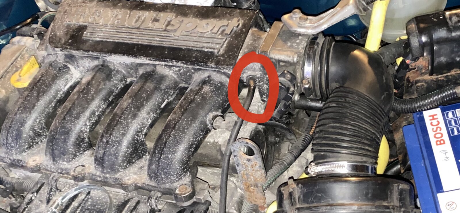

Pull the small pipe that normally goes to the acoustic valve on the front of the inlet for a small vacuum leak, it’ll raise the RPM a bit [emoji106]

Assuming the pipe is the one circled below @incy-spider ?
Is there anywhere it needs to be rerouted so is it ok just being disconnected and tucked?

I’d imagine the acoustic valve down behind the bumper has been bypassed with an after market filter anyway. So yeah just pull it and tuck it away. I took a blanking plug that I could just shove on for the mapping
