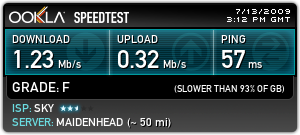

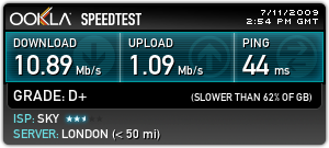

just tried mine on speedtest.net with the sky box unplugged:
not impressed! think i need to contact sky as my broadband is with them!
With the box plugged in (single filter):
