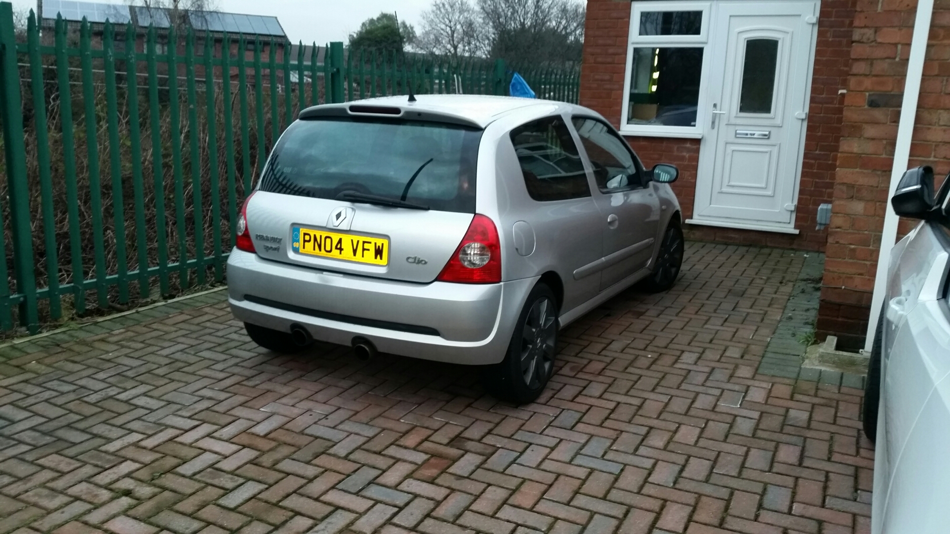

Quick pic before it went dark, will get a build/strip thread going...
