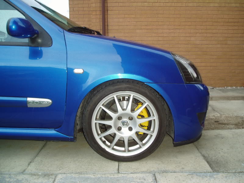

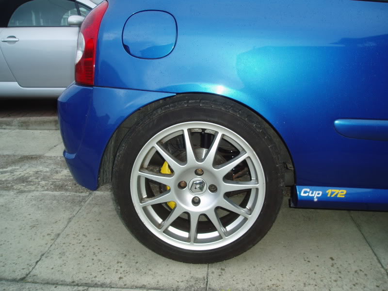

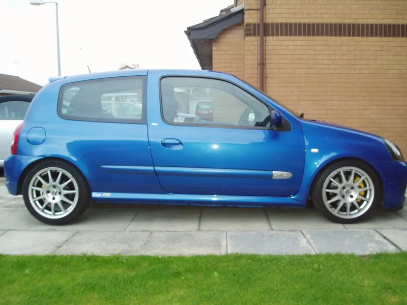

Don't know if this will help you but...
I just fit mine.
sit like this
The fronts are wound up very high, they go very very very low !!!

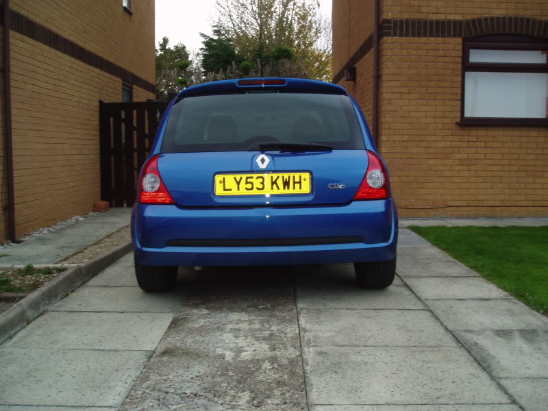

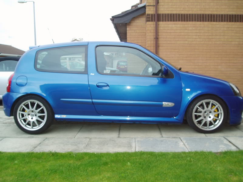

Aluco they have LOADS of room to go down and the car sits nicely as it is :)
