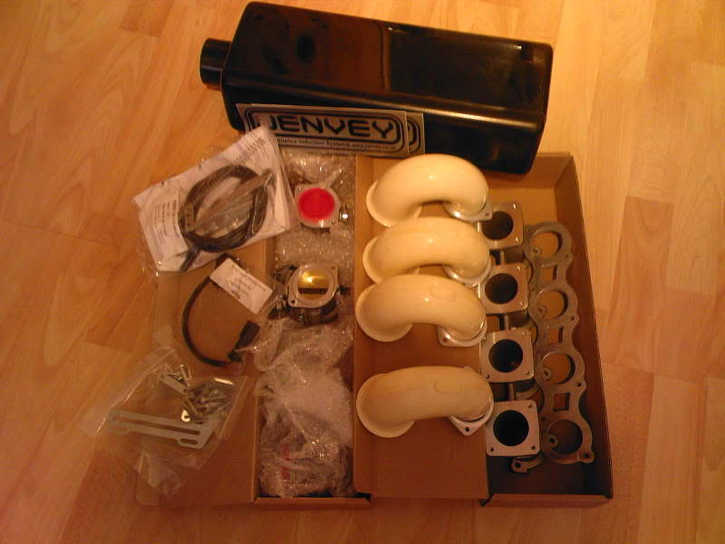

You can but they'd have to be custom as AFAIK and even then the airbox would be squashed by the bonnet, theres nothing on the market like that. I know Jenvey used to make plastic C trumpets for use on engines where the inlet manifold is on the back as it kept the inlet length for torque and you could use a plenum and air feed design as a pose to a foam filter.

I'll find a pic of the curved Jenvy trumpets for you.... Hang on....
