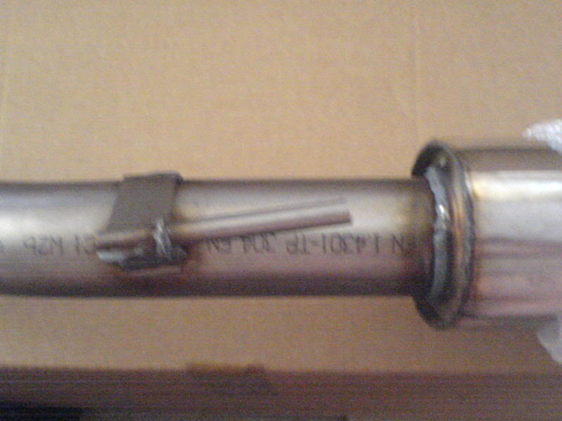

Issues with centre box rattling inside, brackets falling off, poor fit and lining up of brackets.

sums up the quality in my eyes!!
  Burgandy 174 sport t
3 including mine, I have had welds split too but this was only a batch of ten so dont let that put u off!!

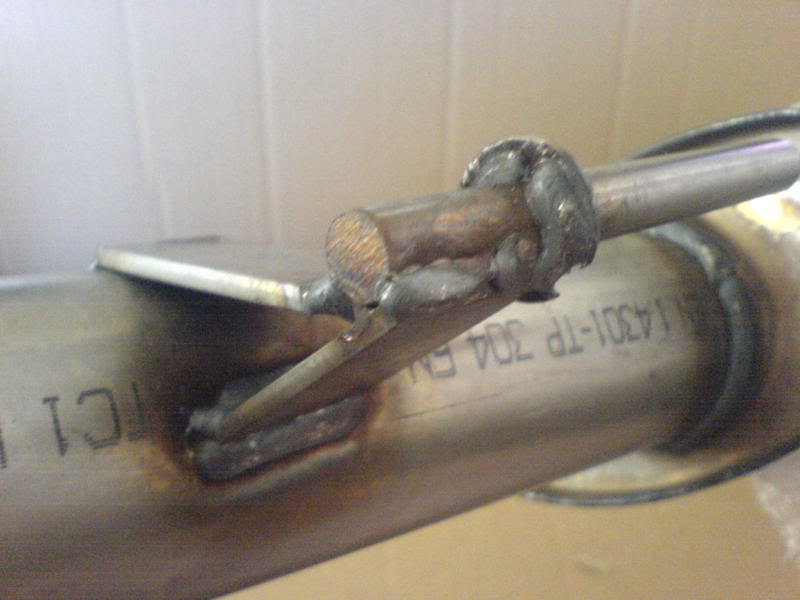

We had a batch of 20 made a few months ago which had a potential issue with the centre section. It turned out a guy welding the centre boxes was only tacking a pipe within in the centre silencer instead of fully welding around the complete outside of the pipe. This resulted in the weld braking and causing the rattle.
We have changed just about all of these under warranty and all the new ones have been fine since (apart from Deviltronics, that has the weld split on the side of the box which I or Janspeed have never seen before).

I have had more mk2 systems than mk1's, All the mk2's had the same fault so I must be pretty dam unlucky to get 2 out of a 20 batch!! (you told me it was10)
Yes I have moaned about the welds on that picture before, but when U look and that pic and realise it was a replacement system you would think u might send one that at least looks good after the first one FELL OFF!!
You forgot to mention the part where u put me onto the manufacturer to sort it out!!
