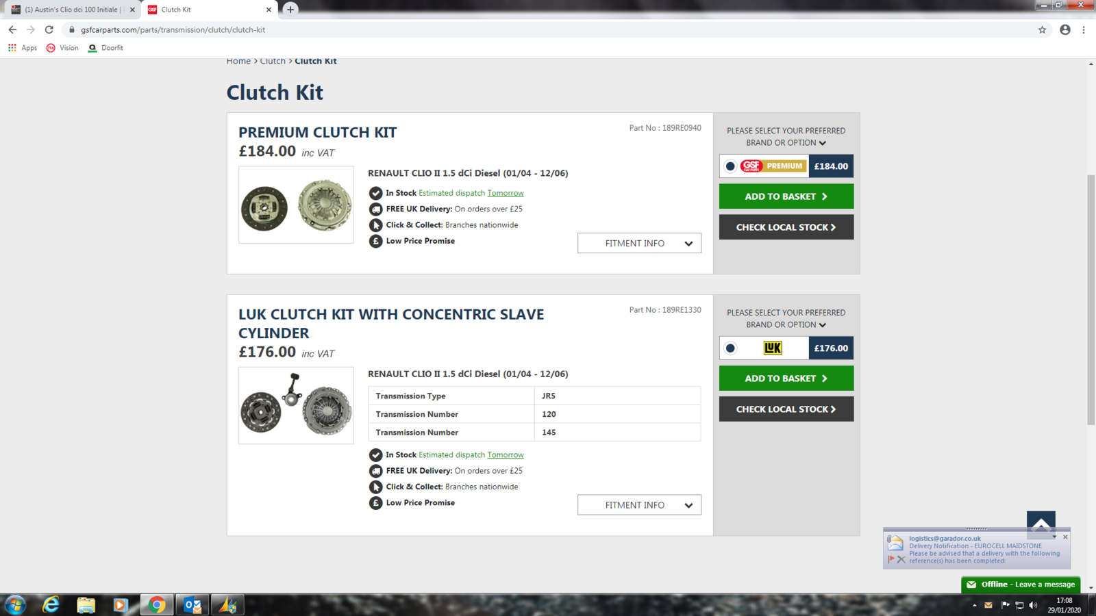

Was it a brand new clutch kit with release bearing?
Was the slave cylinder replaced aswell as i had an astra in that would just about drive and rattled it knackers off until clutch was pressed. The spring had snapped on the slave cylinder causing the rattle so replaced it all for good measure.

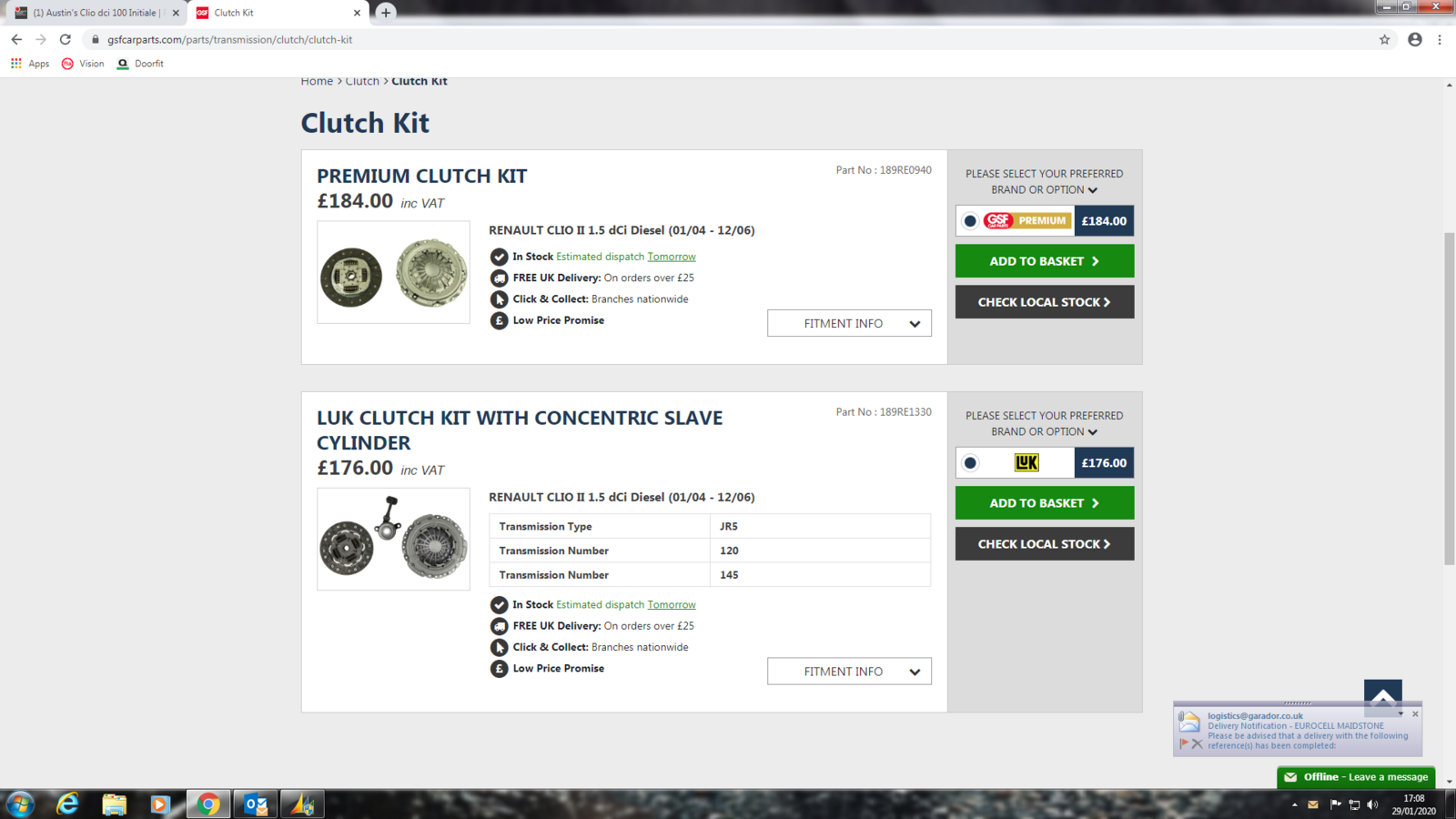

Yes mate it had a new LuK clutch and slave cylinder fitted, and the clutch line was replaced too.

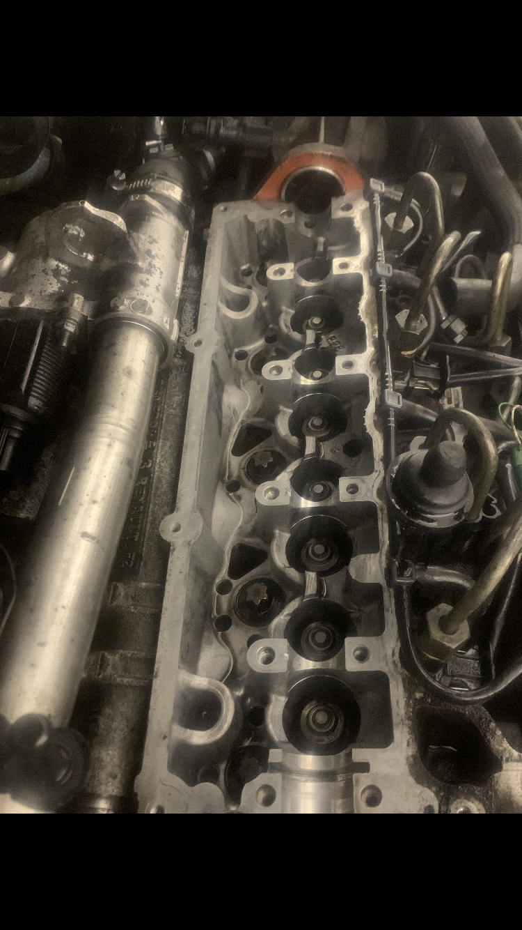

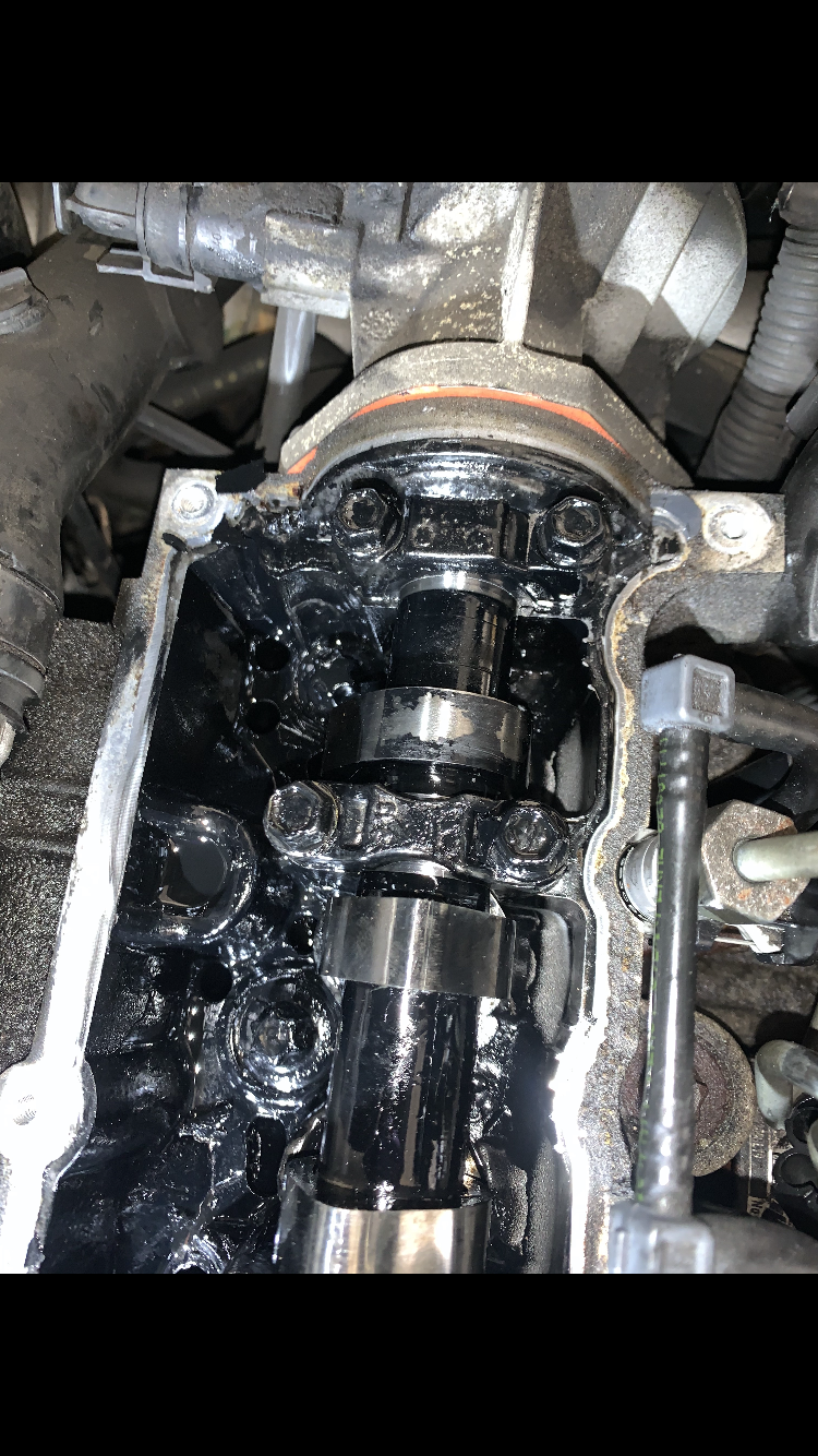

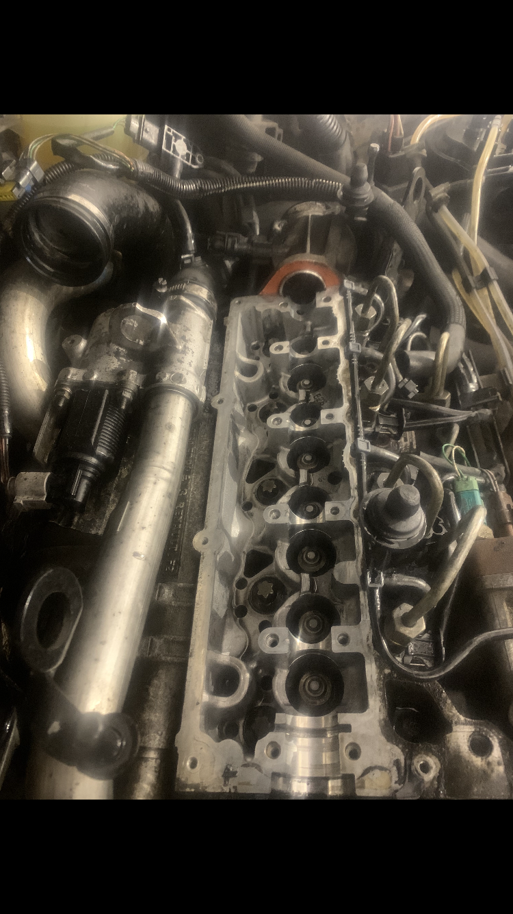

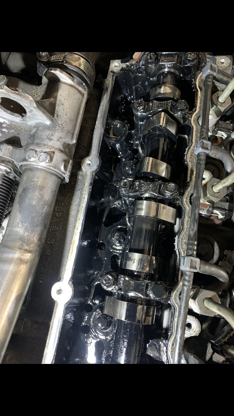

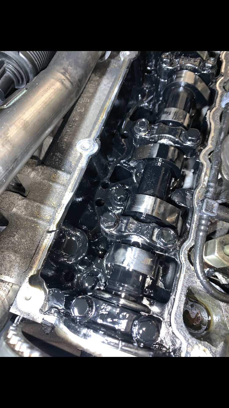

Replaced with a new genuine turbo and Kris took the rocker cover off to find gunky oil everywhere (see pics). Completely cleaned down (see pics also). Kris said lifters looked like they were not working as they should as there were black marks on the cam but this was not as bad as usual so hopefully a clean down and freeing everything off would fix. Tolerences were checked and all ok. Apologies here as my knowledge is not great on all of this.
This was done yesterday and when all back together and it was started there is still a horrific loud banging knocking sound. It sounds like top of engine but even Kris is now confused as to what it could be.

Theses don’t run lifters. They’re solid buckets ( set clearance buckets non shimmed )
that oil looks abit weird. If it still sounds s**t , it’s probably either finally spat a big end, or somethings adrift. if You was closer I would of had a look at it for you.
Actually tel a lie , I have seen oil like that before. A scenic I rebuilt an engine on last year , the lump i took out had bad service history( lack of oil changes ) that was all like that , including a very clogged intake port.
bet sump is full of it and it’s span a big end

Thanks mate. Strange thing is it sounds like its knockng from the top end and not bottom. I dont have great knowledge of that tbh, but even Kris said it didnt sound like bottom end. Plus there was another lad with him working on it and he said the same.
Got a front starter kangoo engine at the unit if needed. Ran fine until pump s**t itself and took injectors out. Pulled it out to fit a 1.9dci into the van
Its had 3 or 4 oil changes ovr the last year with me and has always ran amazingly, also it was only last serviced 2 days before it broke down again so the oil was fresh.
bottom end knocks on these sound like top end knocks.
if Chris pulled the sump and took the main caps off one of them will have span , or rod bearing.
injector knock will have it chucking smoke out the exhaust as it’ll be overfuelling. Cam rattle doesn’t sound anywhere near as bad. id also assume timing is correct Again.
Doesn’t matter how many oil changes you’ve done , that scenic had multiple oil changes by the owner over a two year period but the mejority of s**t had already done damage.
make sure Chris puts dust caps on EVERYTHING to do with the fuel system if he has to take it all apart , slightest bit of s**t will damage an injector. Fragile things lol.
Probably find dropping in the new lump will be fine. Injectors don’t need coding to get it to run. They’re only C2i codes for fine running/ emissions control.

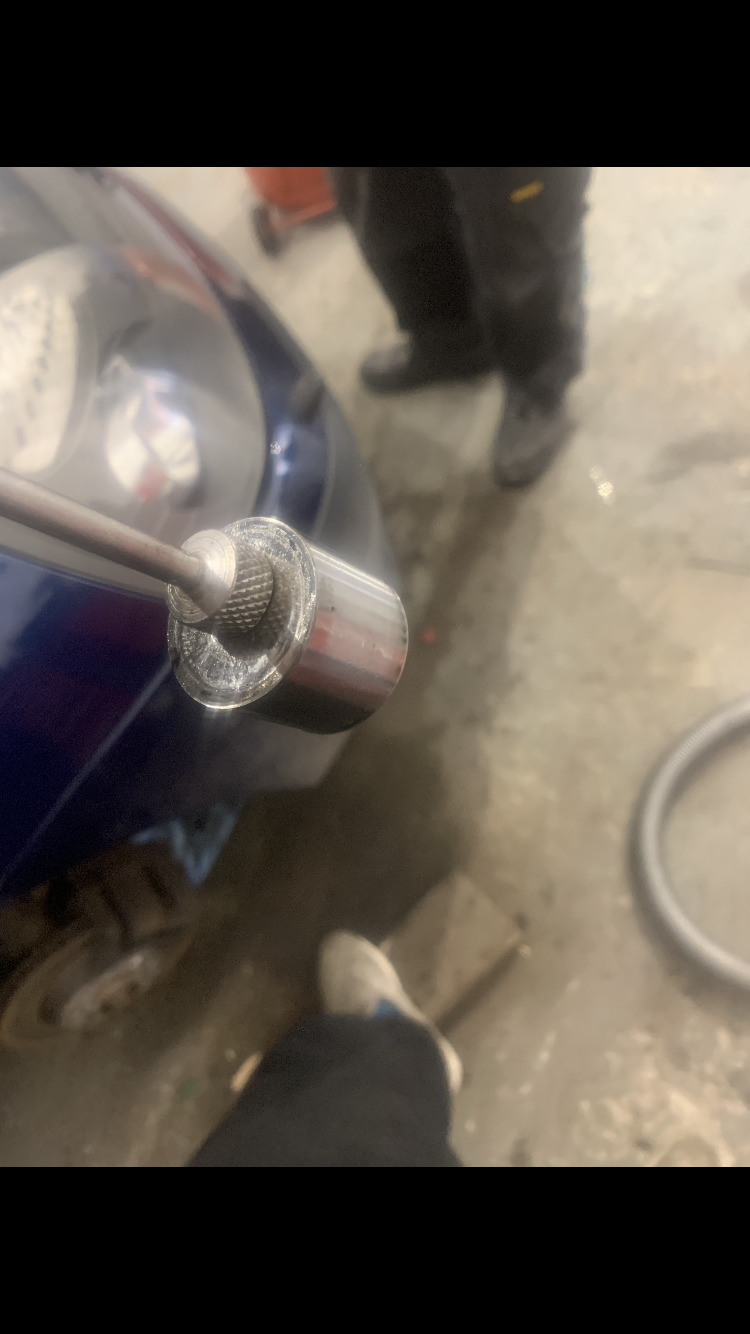

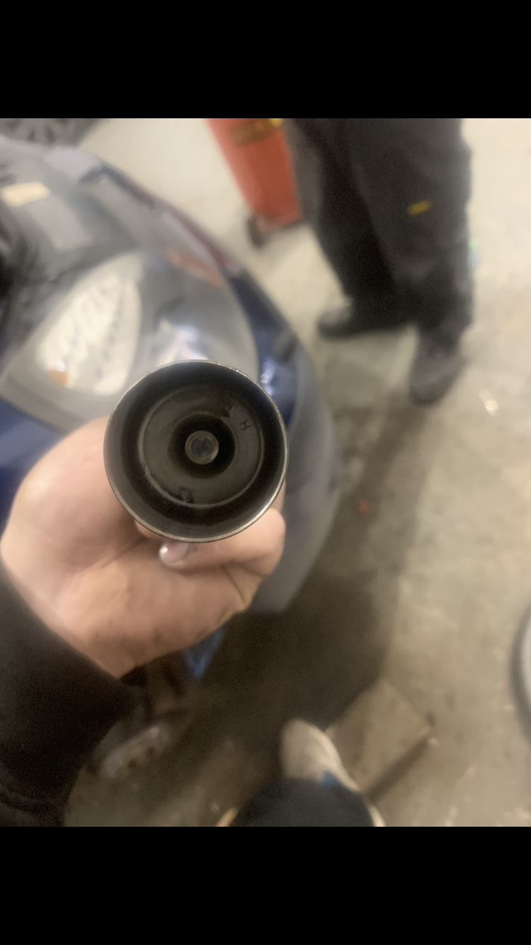

No just needs a new copper washer fitted, cheap as chips. Can even anneal the old one if your stuck and refit.

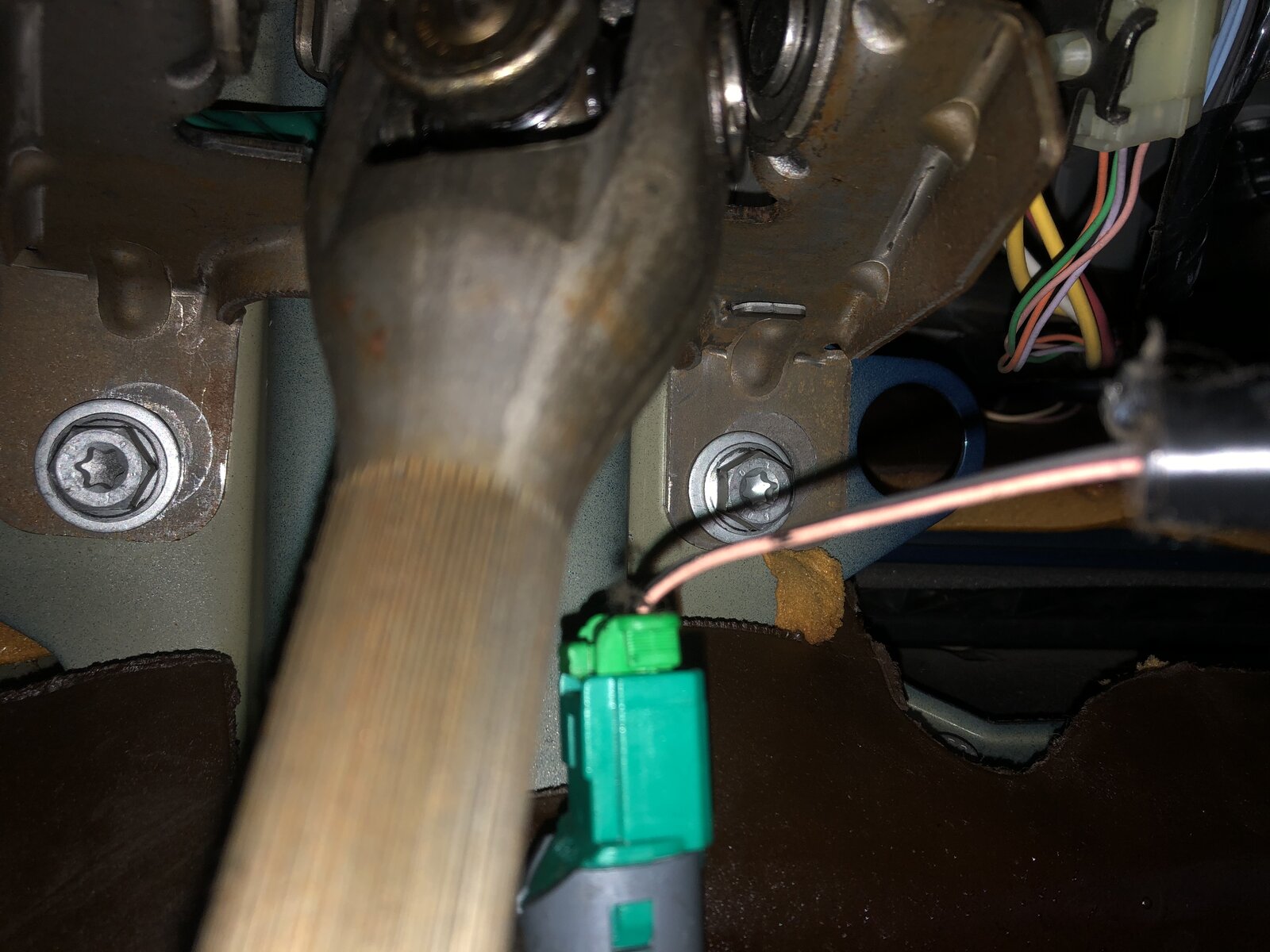

Also getting a grinding / vibration through accelerator pedal when pulling away and releasing the clutch if anyone can have a guess at what that would be?
Steering wheel is also wobbly as in movement up and down if anyone has any idea what would cause that?
Going back to Kris next week so I'm sure it will all be solved but appreciate the knowledge the help from you all on here too.

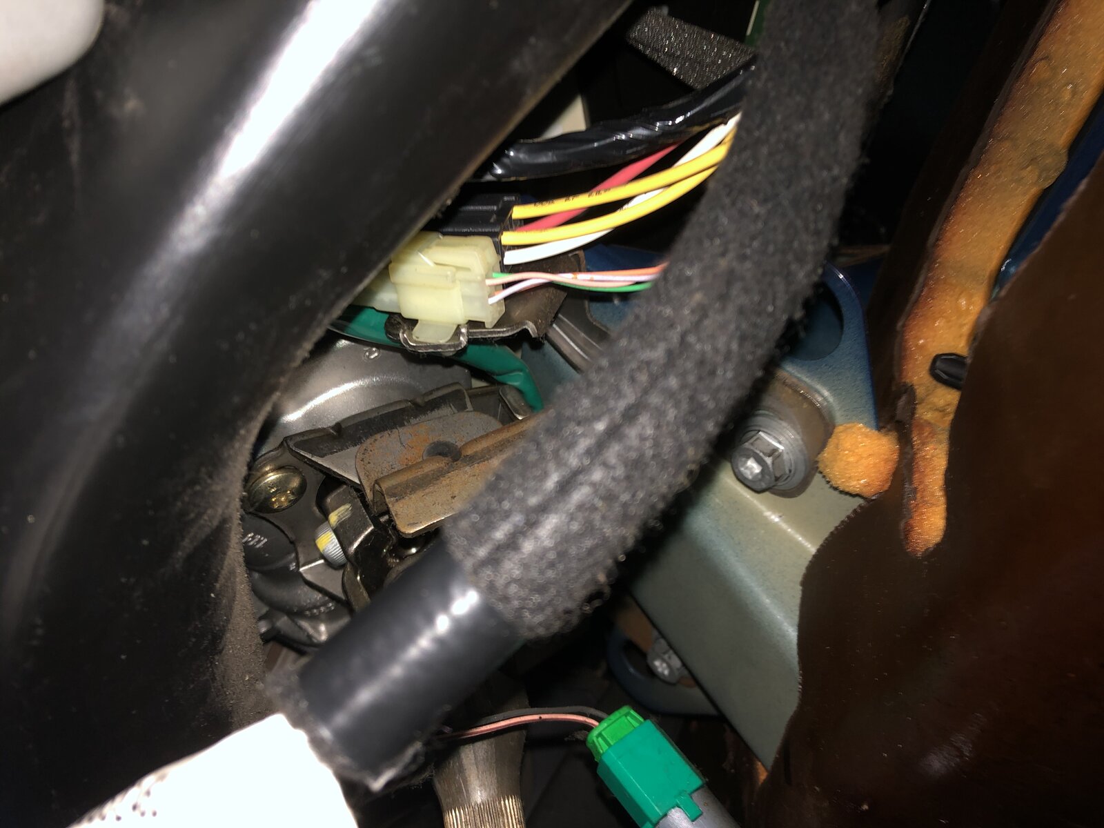

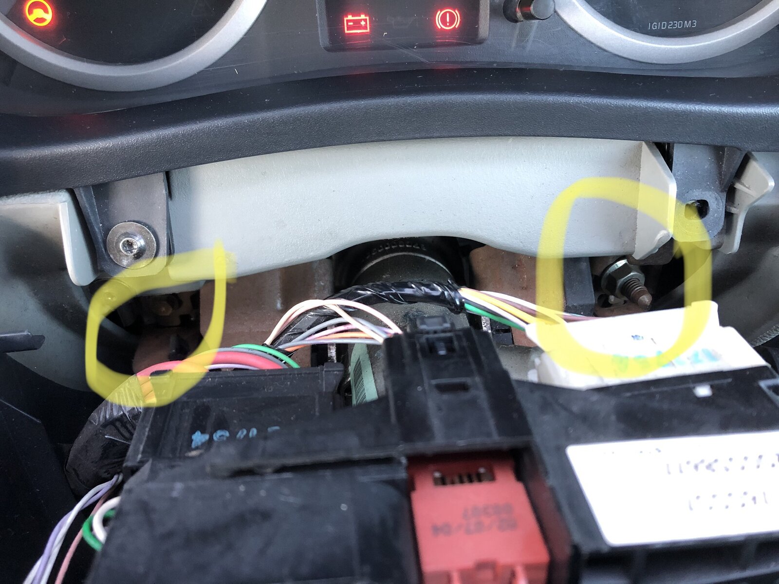

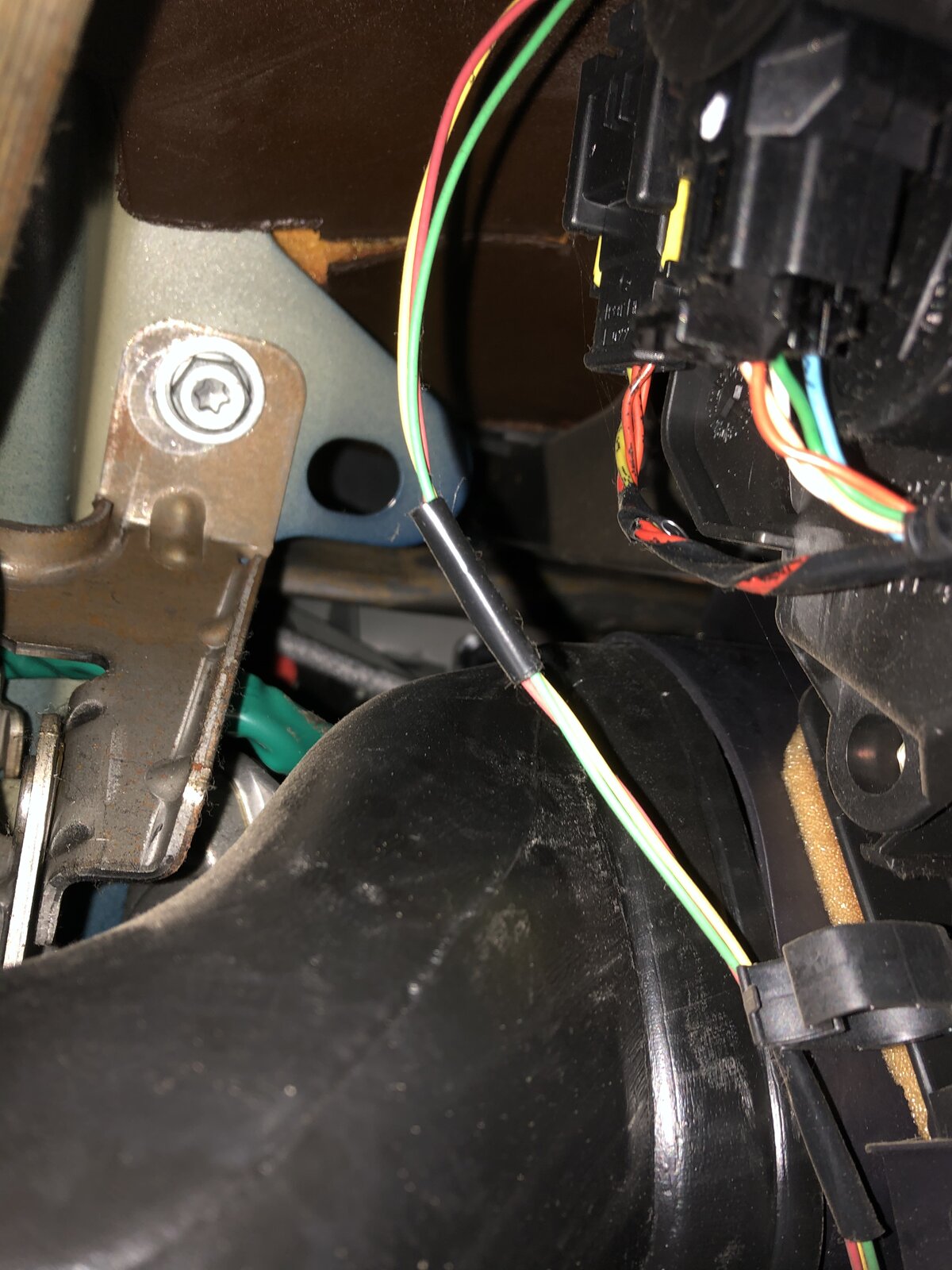

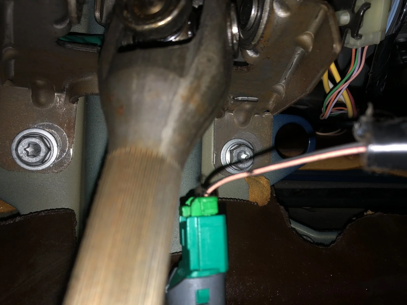

jeez looks like the 4 bolts that locate the column are loose !!
those should be done up in a specific sequence. Get down in there and look straight up, you'll see 4 13mm bolts that fix the column to the upper dash dupport.
have they had the steering column off ? if so, why ?

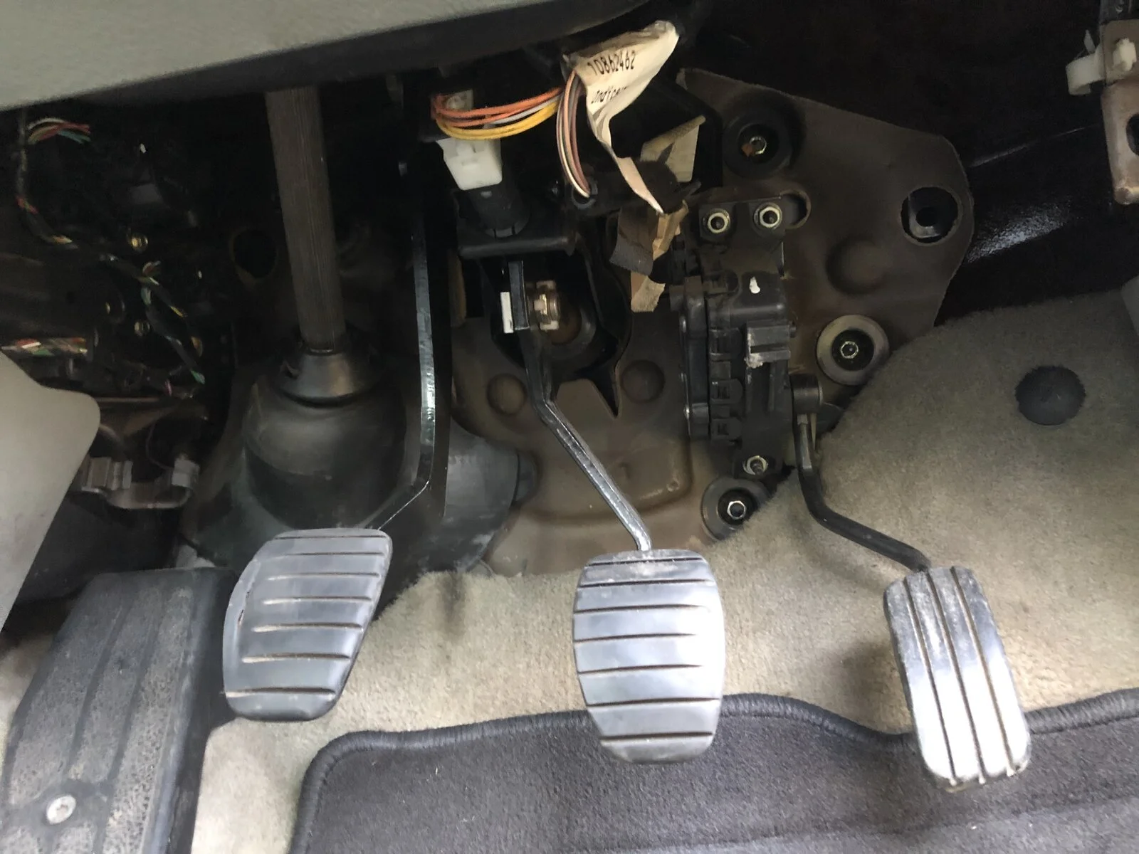

If that is the case I'd look into the 10mm nuts that fix the pedal box down as well, since you're complaining about the accelerator vibrating.
the actual operation of the pedal is fully electric so there is no physical connection between it and the engine, the only thing that can cause that would be some sort of movement around the firewall area, that's my guess.
what's going on with this car ??
I wish I knew mate I feel so gutted about it all!
No idea about steering column being off, i wouldn't have thought so unless i needed to come off for any of the work its had done?
I will go out shortly and have a look and then report back.

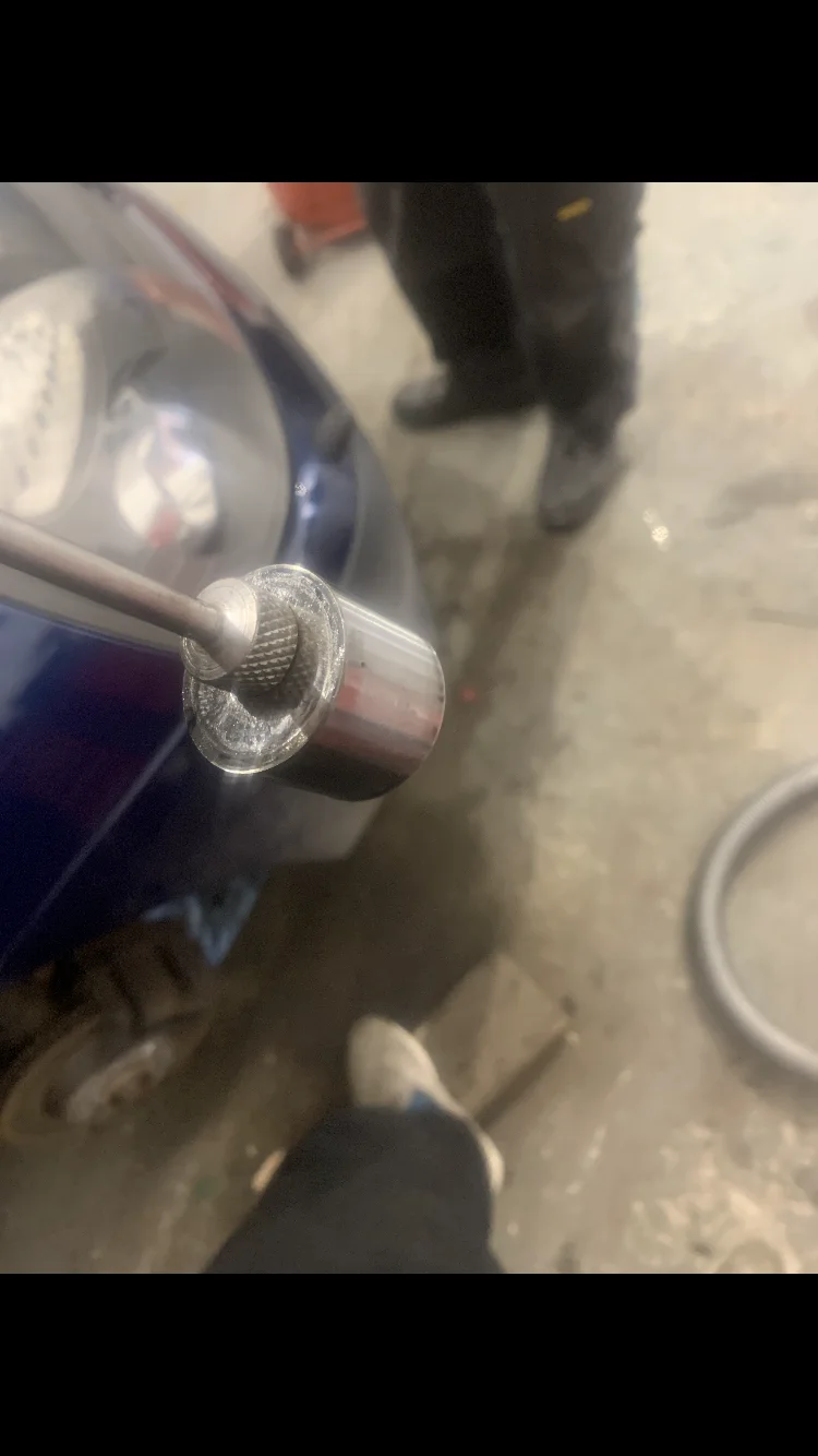

@Mazz
Is this what I'm looking for? Can only see 2 bolts. If so, it does look like they may have been removed as theres a small circle around as though thats where the bolts were previously fastened?
Are these bolts meant to be different to each other?
What am i looking for on the pedals?
Looking at pics 2,3 and 5 it seems like somethings moved/moving to where they have originally been bolted tight
