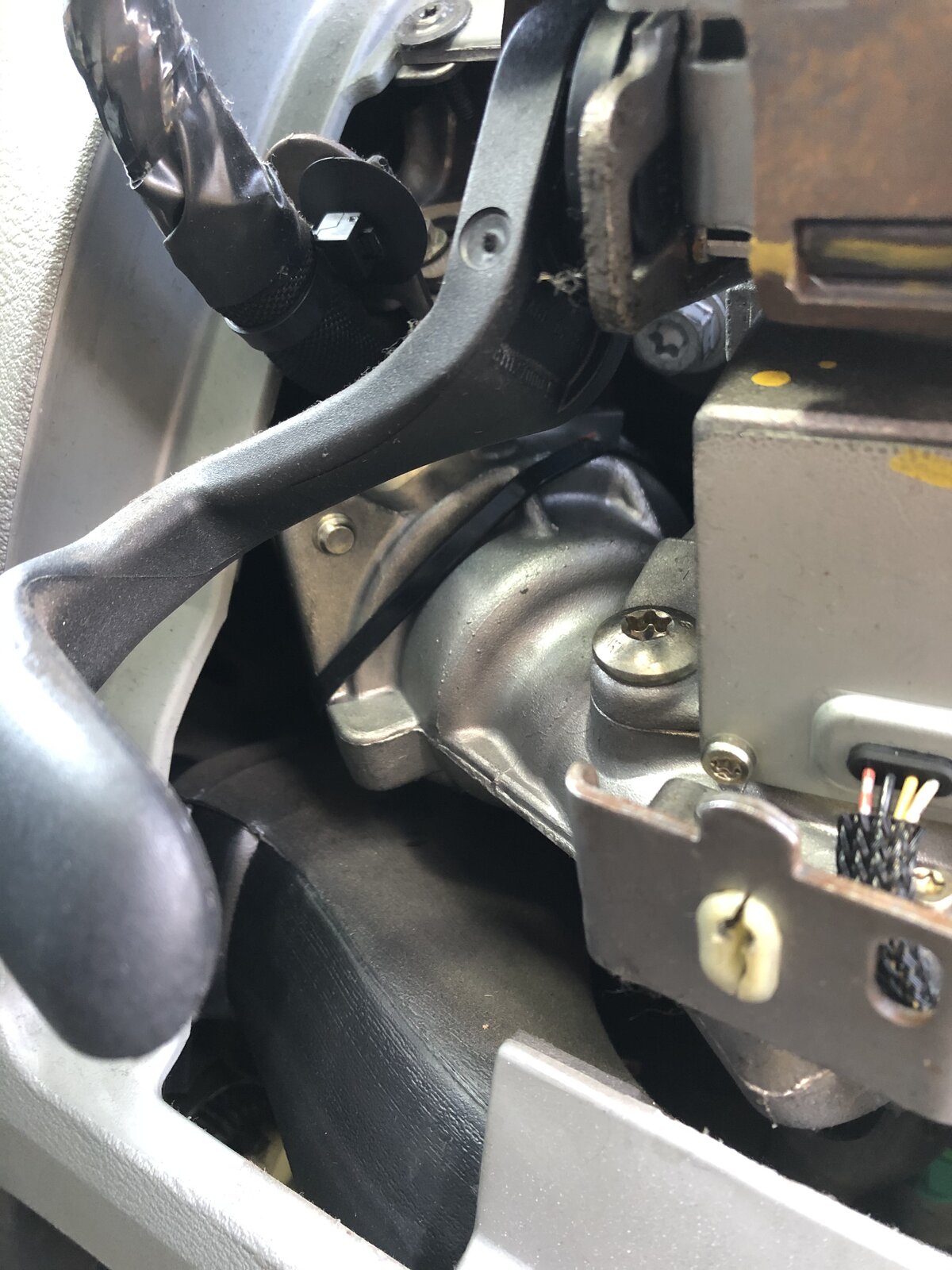

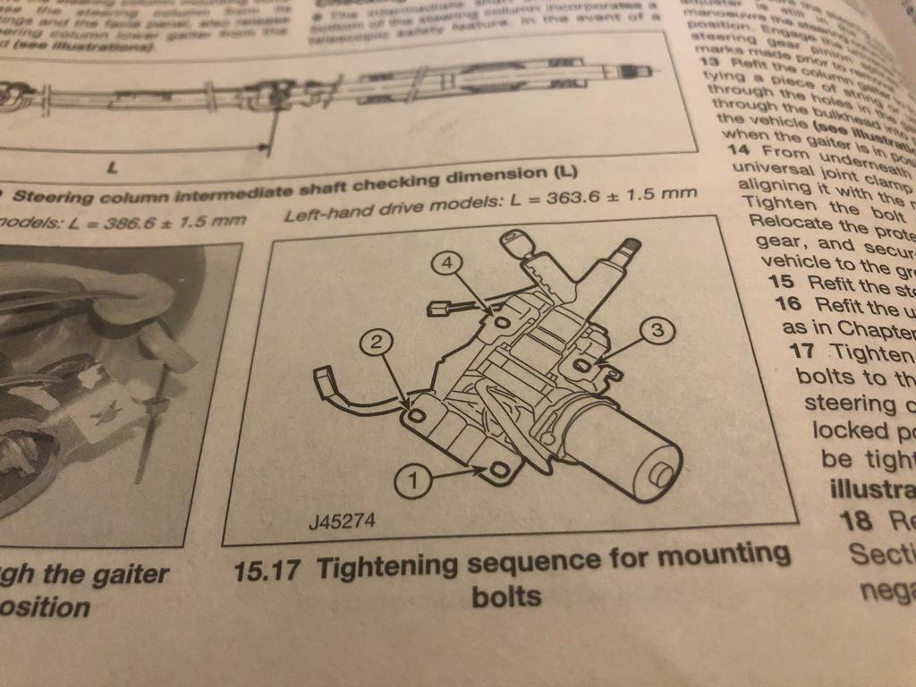

Yeah, those are the bolts.
Re centralize the column (ie, shake it around until you’re on those markings again), and torque everything up.
To do a nice job here’s the tightening sequence, 20nm on the bolts.

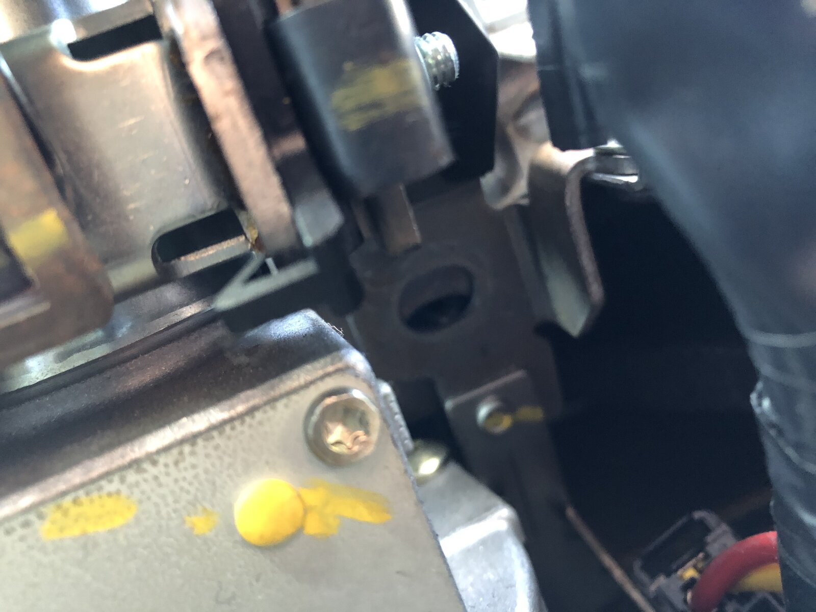

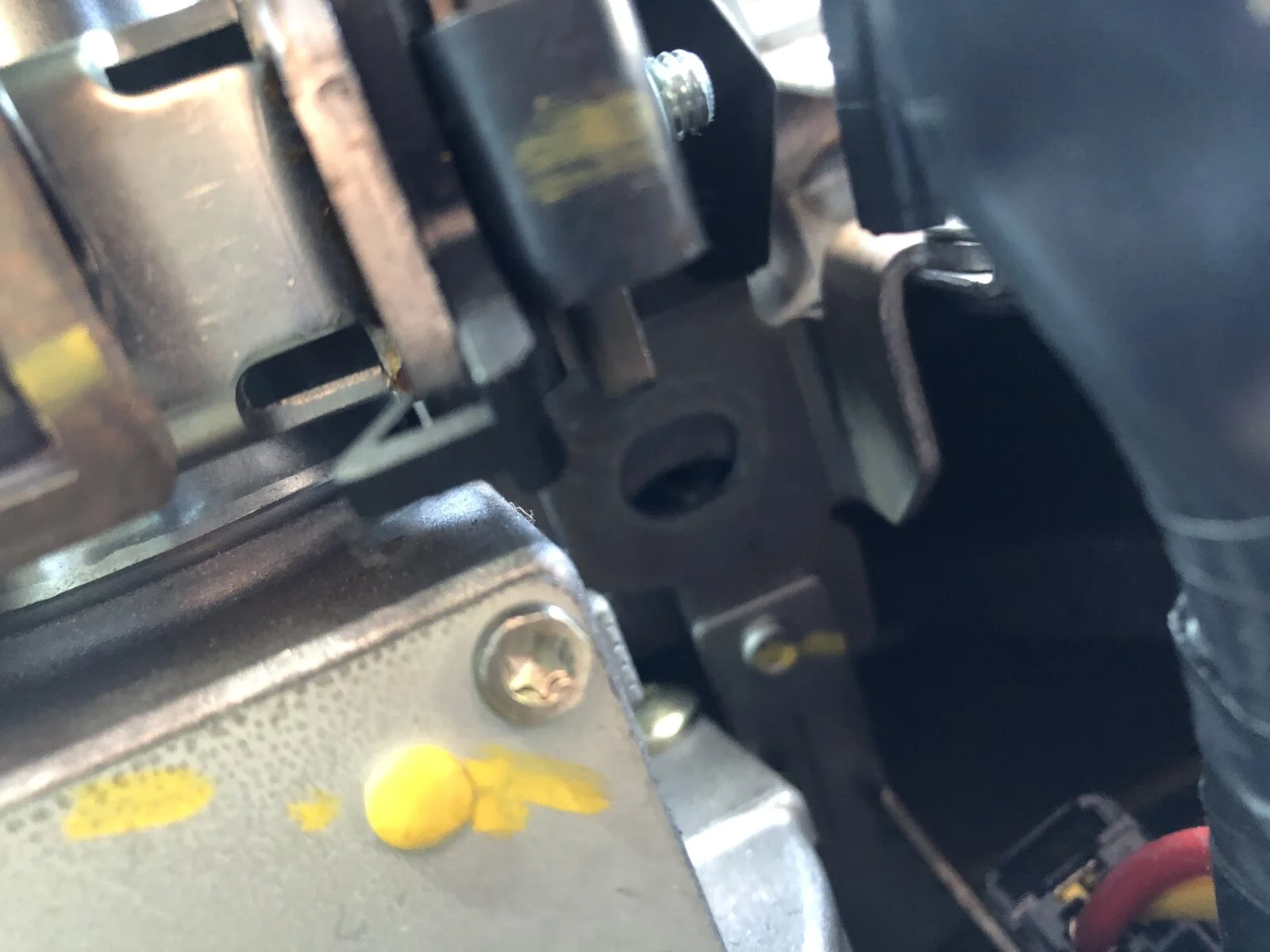

Thanks mate, I can only see 2 bolts though from looking underneath? The bolts pictured above are the same 2 from different angles.
Rip the steering surround off, flathead behind the audio control stalk to pop it off and 3 torx screws sandwich bottom and top together. With that off you should see all the bolts you need to access.
Better to not loosen the steering column adjuster (I did it with it loose but this is what the manual recommends)

Don't have a spare screw do you? Its missing one!!!!

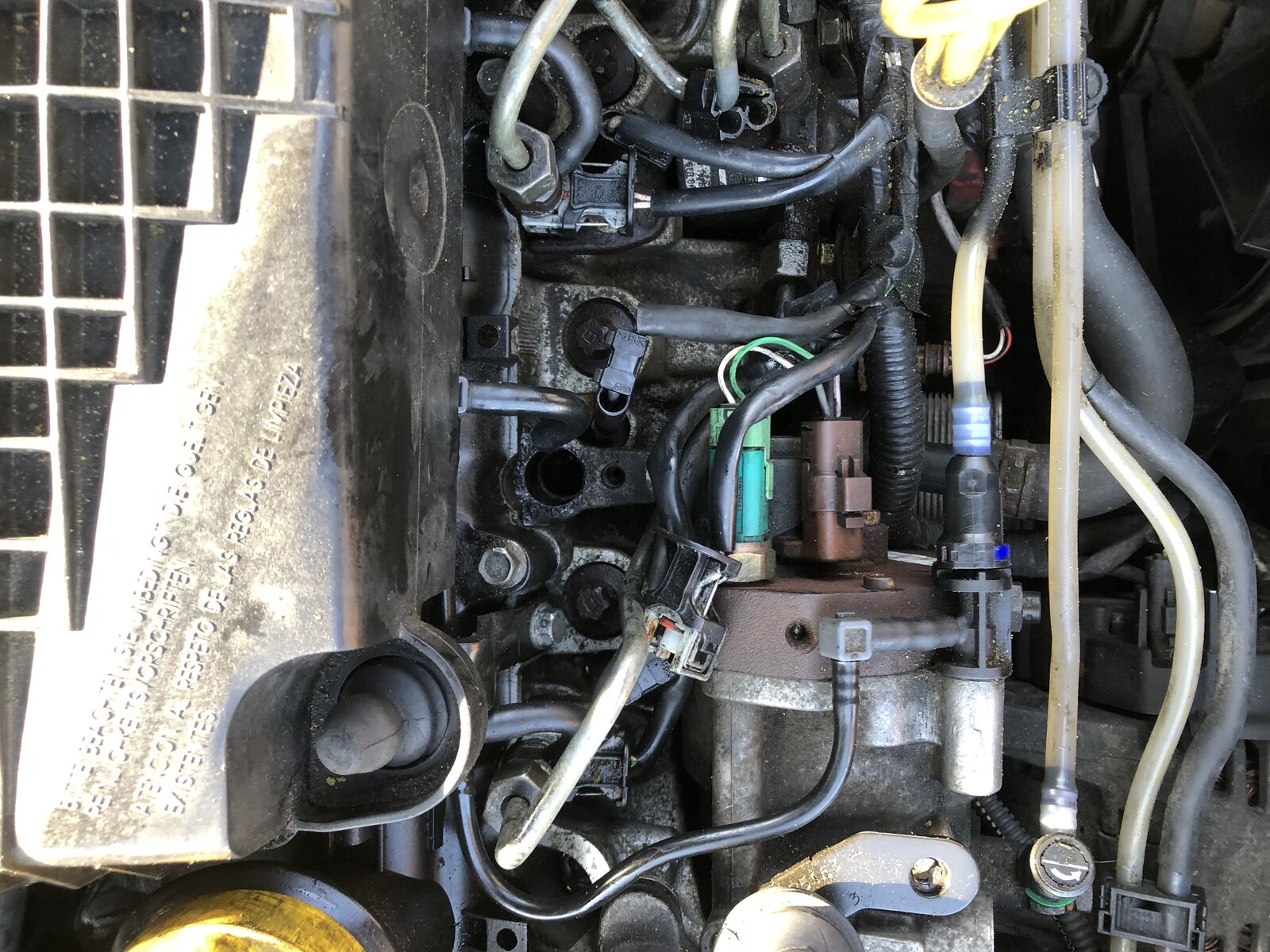

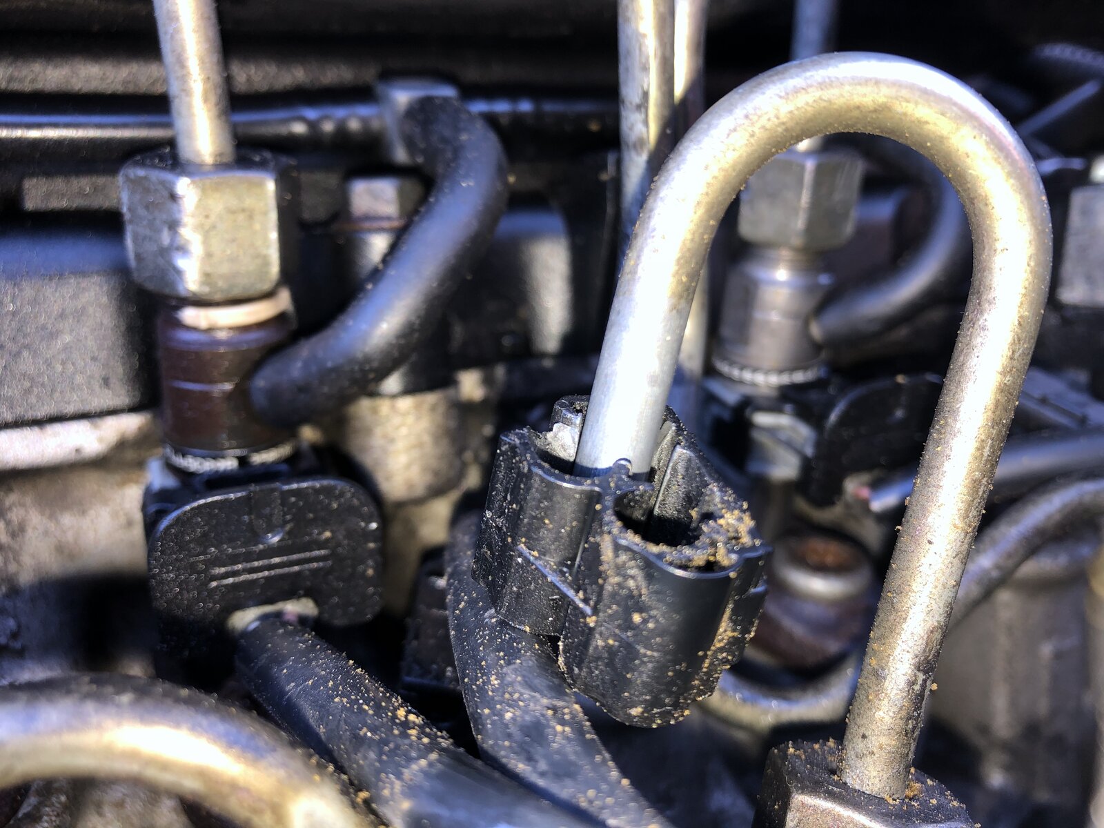

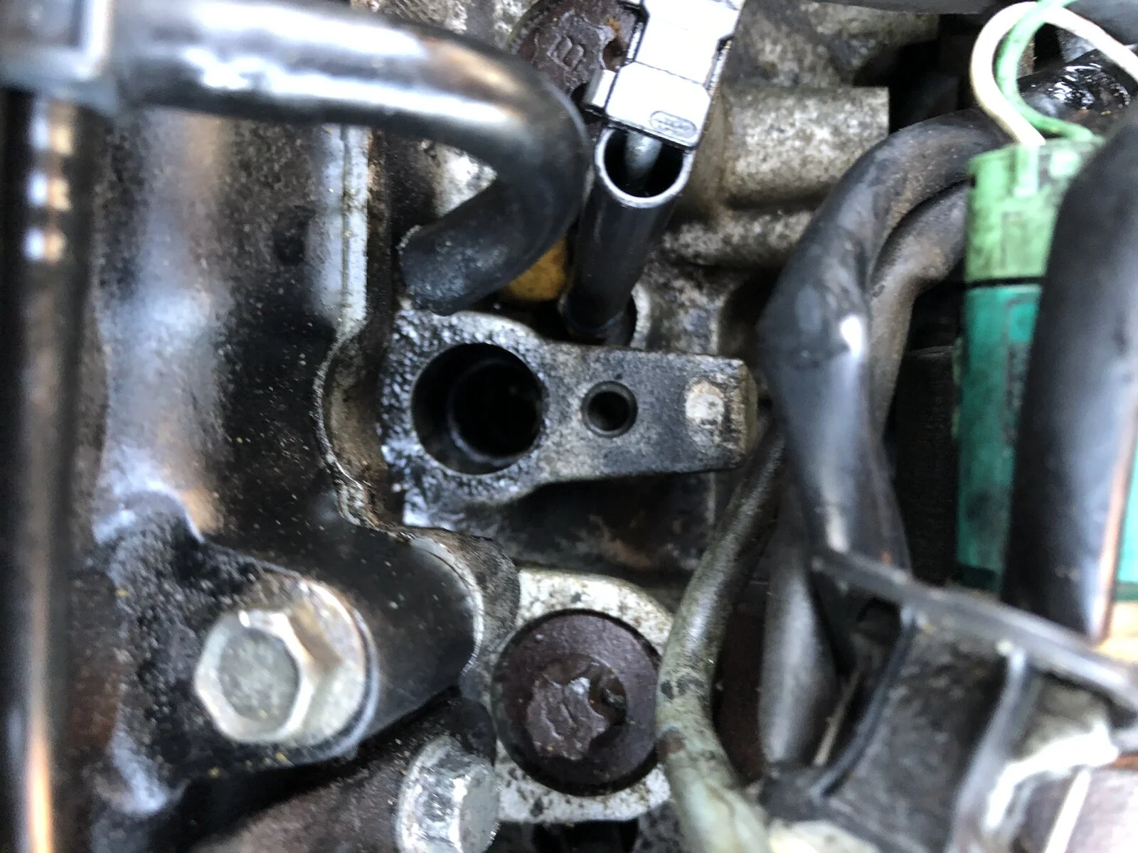

Car absolutely stinks of exhaust emissions if that might be any indicator as to what the loud ticking noise is?
Would the injector seals cause a strong smell of emissions? @Brigsy

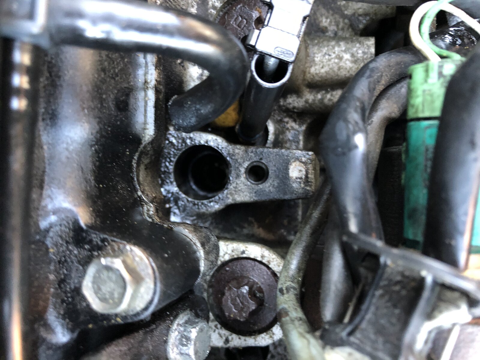

Shine a torch down the side of the injector and look for any black gunk
f**k knows why he didnt replace the fire seals anyway the spastic t**t. They're about £5 ffs

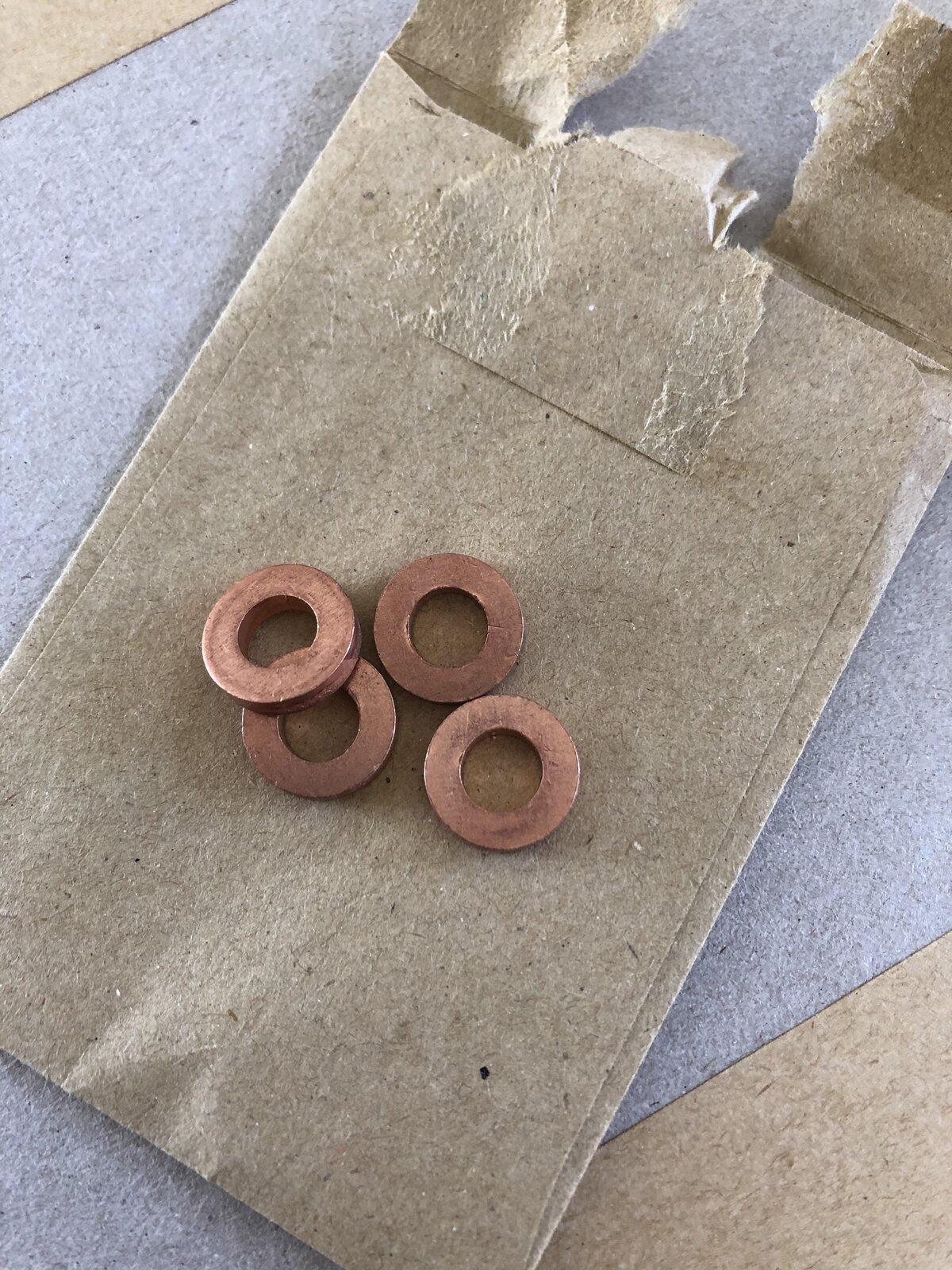

Yes it will stink of diesel fumes. Should be able to find out what cylinder is leaking when the engine is idling, or as @YorkshireKyle said the black gunk.
As above the injector seals are pennies, should be replaced and seats cleaned up in the head, and injector clamps torqued up properly, or they fail.
Im not sure mate maybe he has. I haven't asked him yet but iv asked about column and he didn't take that off. Its going back in next Monday so he can have a look.

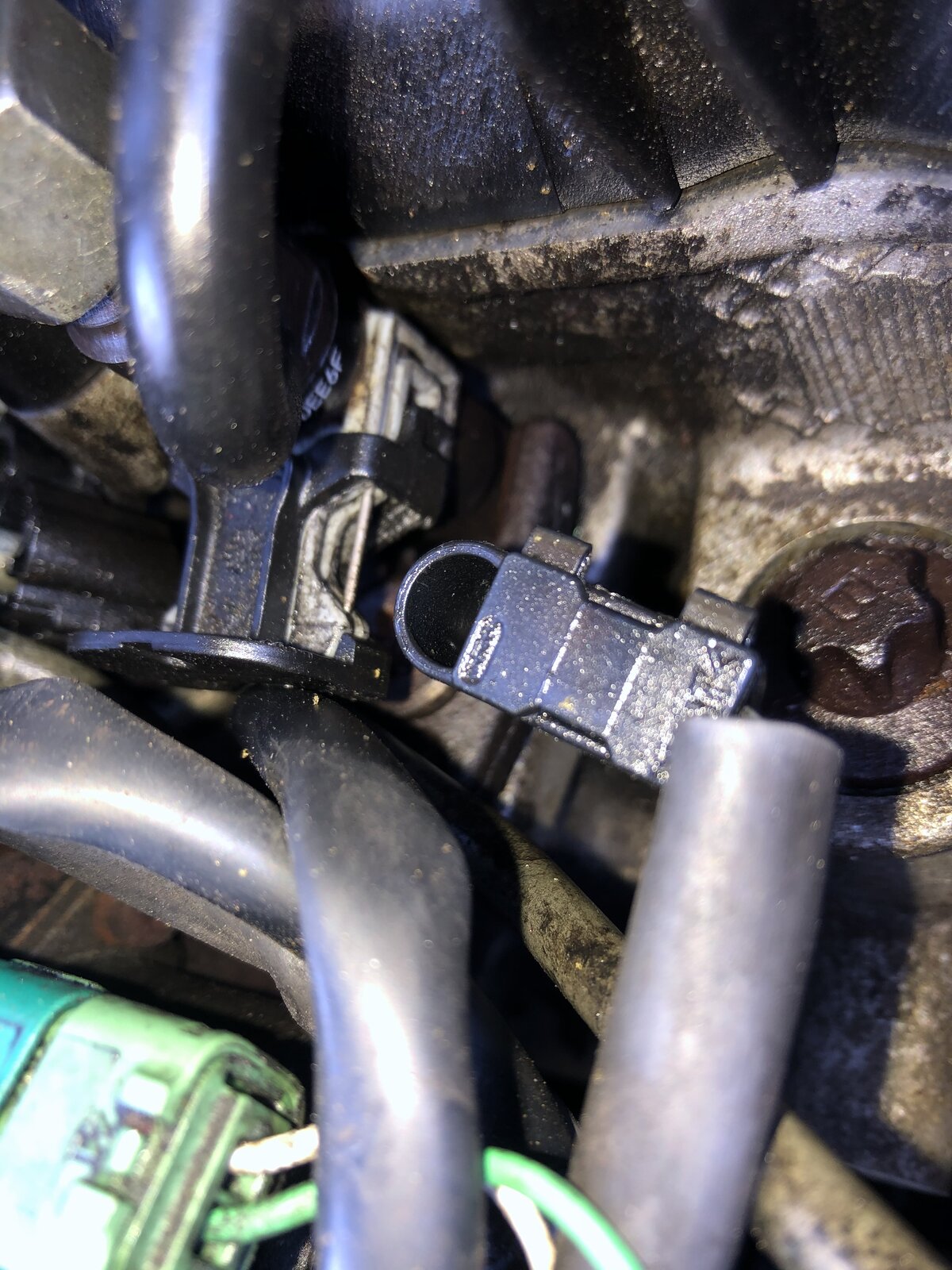

Just checked injectors with phone torch and hard to tell tbh. The new injector looks to be missing a little white clio although not sure it matters anyway and maybe don't all come with them?

The seals are way down under them rusty crows feet clamps mate
Another good way to test if they're leaking is to spray water into the hole around the injector and see if it turns black or bubbles up
Cheers Brigsy! Makes me a bit less worried now. Wont have caused an issue to the injector if it is that will it? And would you say I'm safe to drive back down boro from mine like that?
  182
Well looks like 100% injector seal. Just fired up and theres smoke coming out. Not sure if its injector 3 or 4 though, cant work it out. Maybe 4 due to the cylinder 4 misfire code, or maybe its both. f**king stinks!
Its not ideal but should be able to drive it steady, check the clamps are still on the injectors just incase

oh christ, they cable tied the motor to the column, the frontmost torx bolt is a pig to get in, and judging by the presence of a cable tie, it's probably not there at all.
Try and look for it, it's positioned 6 o clock compared to the other one that you can see the front of in the picture.
this is probably something that went down in the previous life of this car, i doubt these guys had the column off as there should be no reason for it at all.

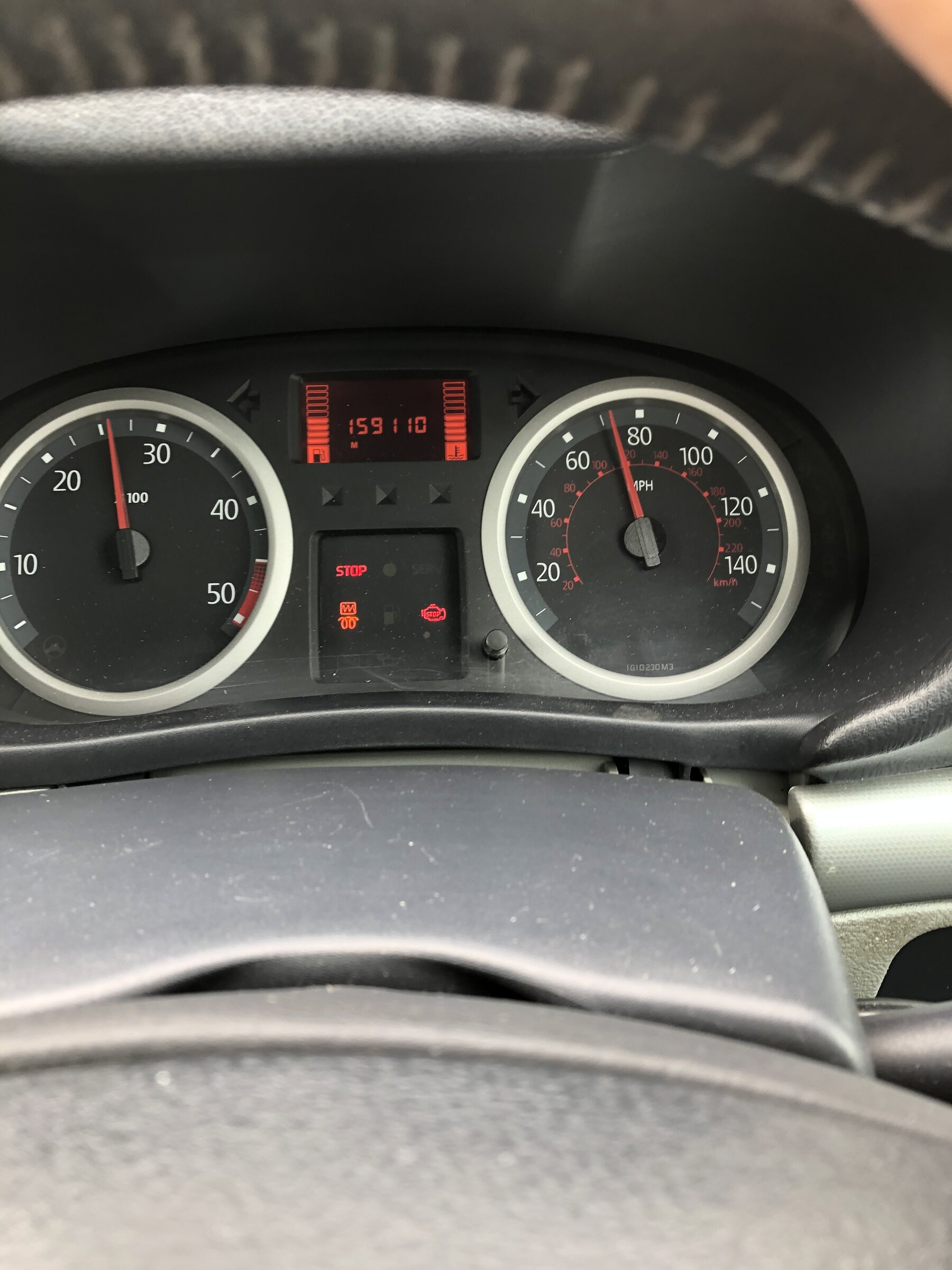

starts, drives well. Stop to go in a shop etc, get back in car and it wont start. Takes ages to finally start. Just keeps cranking and cranking and finally turns over.
Below lights coming on All the time. At first is was under heavy load 70-80mph. Now its all the time, but goes off after a few seconds. Like i say though, still driving really well.
Problem is I cant even sell it on now due to the above issues.if anyone can guess what it would be that would be great. Im considering listing is as “spares or repairs” or breaking it, although not sure it would even make much.

Oil leaks can be turbo oil feed, cam and crank seals and rocker cover.
Needs scanning with clip to see why the eml is on.
