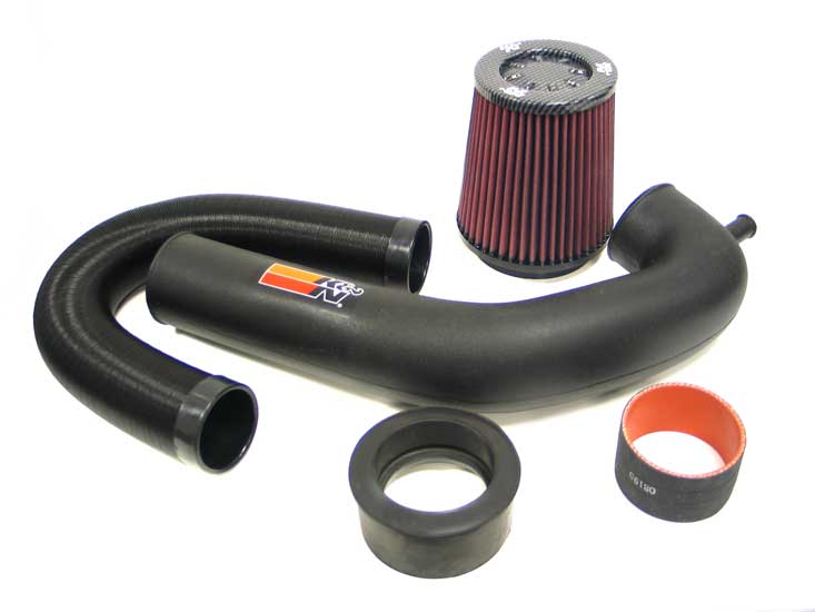

k&n do a already made kit.
http://images.esellerpro.com/2489/I/142/57-0488.jpg
you unbolt all the housing off the back of the engine. the sensor you see is the idle control valve that unscrews from the housing then you need to join it to your new pipe or put a small filter on it there is also a breather pipe that is behind the housing just below the throttle body that needs connecting to your new pipe or a filter added.
​Cheers Ben Lee, I've actually just bought the K&N 57i kit! It was reduced down to about £100 so i snapped one up.
​Looks like it'll do the trick nicely
