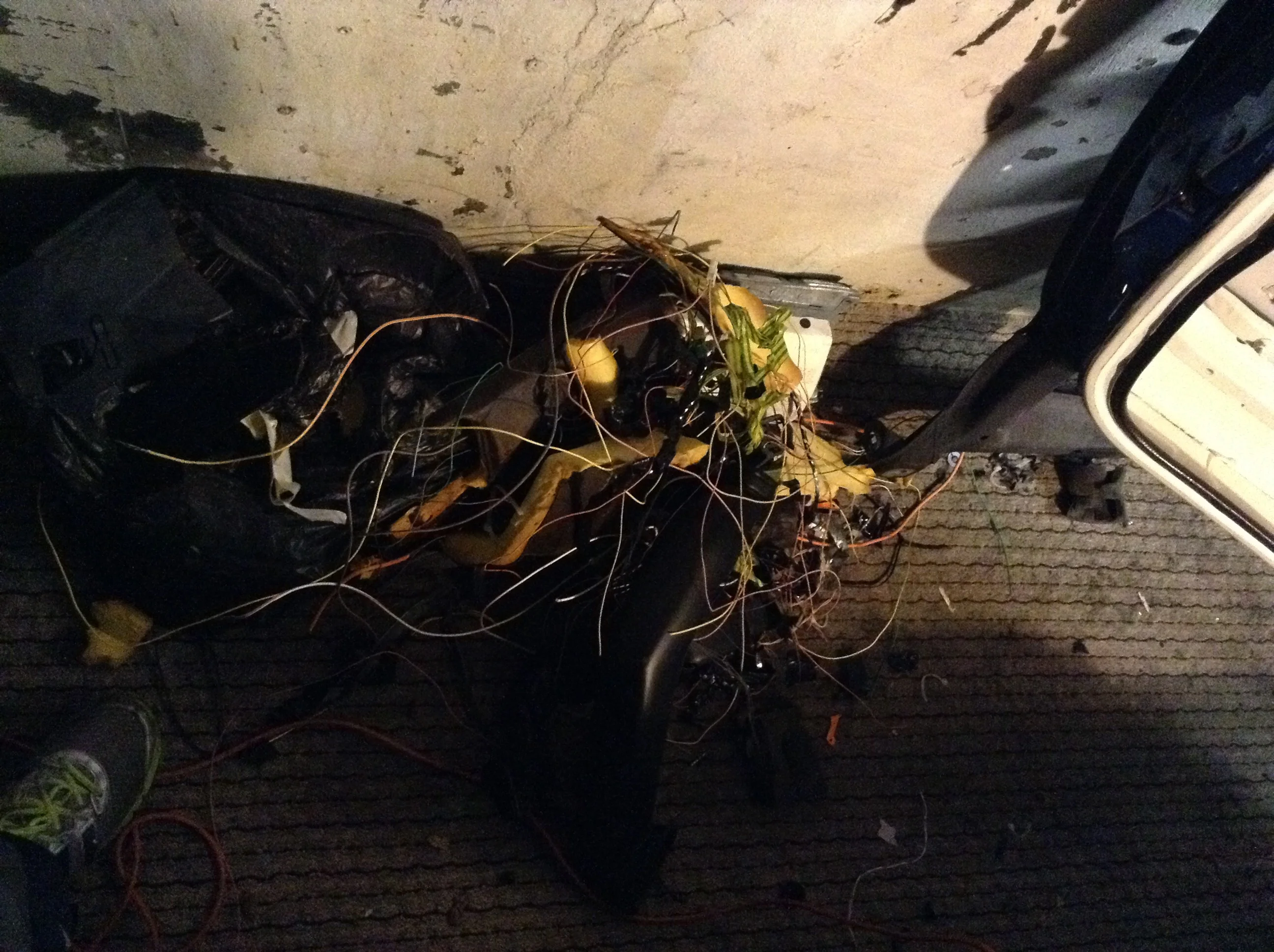

Cut out part of loom and interior that's not required

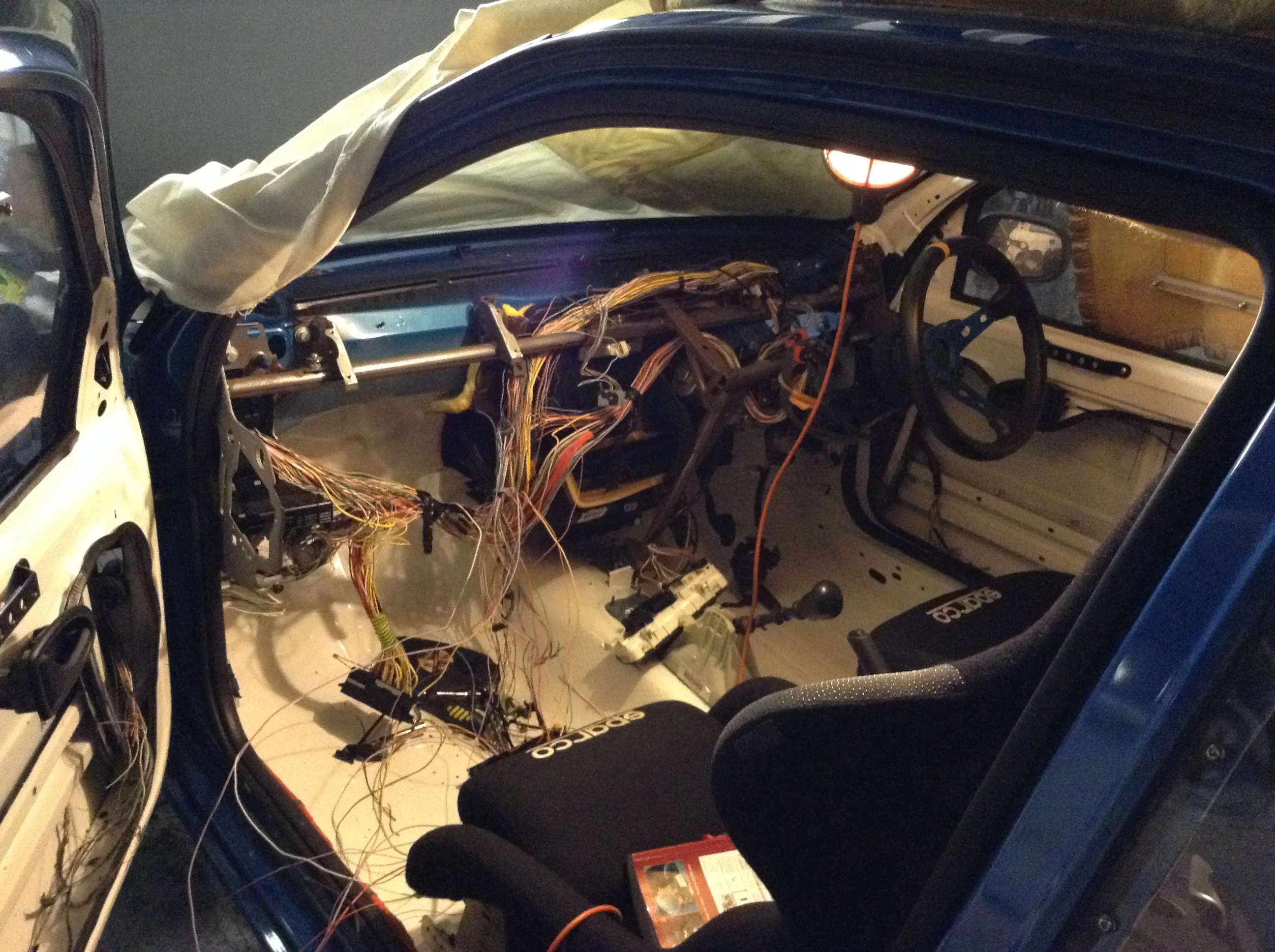

So yesterday I removed the wings, to inspect the arches, not too bad one the whole shell is really strong and no rust at all.
Just looking to remove the suspension, springs, ARB, subframe, and hubs to start with. Then will be treating these items and potentially powder coating them.
All of these items will be either getting rebuilt or replaced.
What suspension bush inserts do people use, need something stiff and reliable.
Also looking at potentially getting another K4m engine with low mileage and rebuilding it. Installing CAT CAMS, lightened flywheel, sorting the inlet, and having a head overhaul to include new valves and a bit of porting.
Something reliable with around the 140bhp will see me happy!

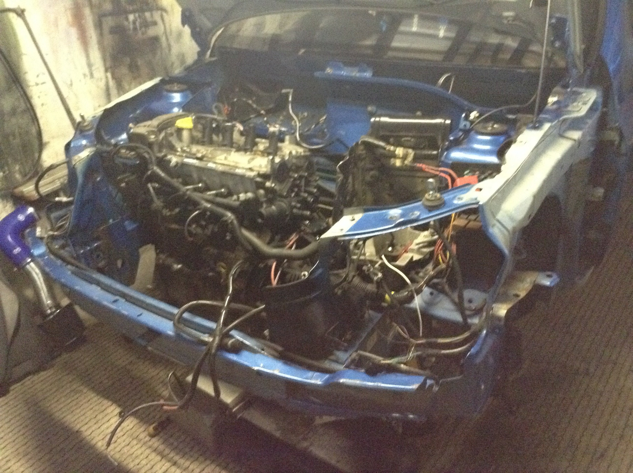

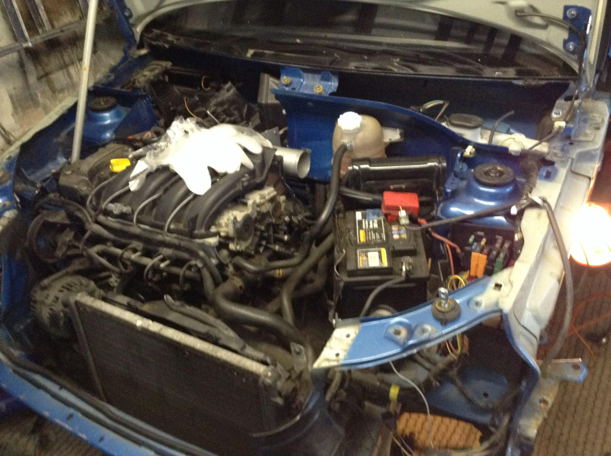

This was the state of play end of the weekend got a fair bit done however. Started to hit a few rusty nuts and bolts halting progress

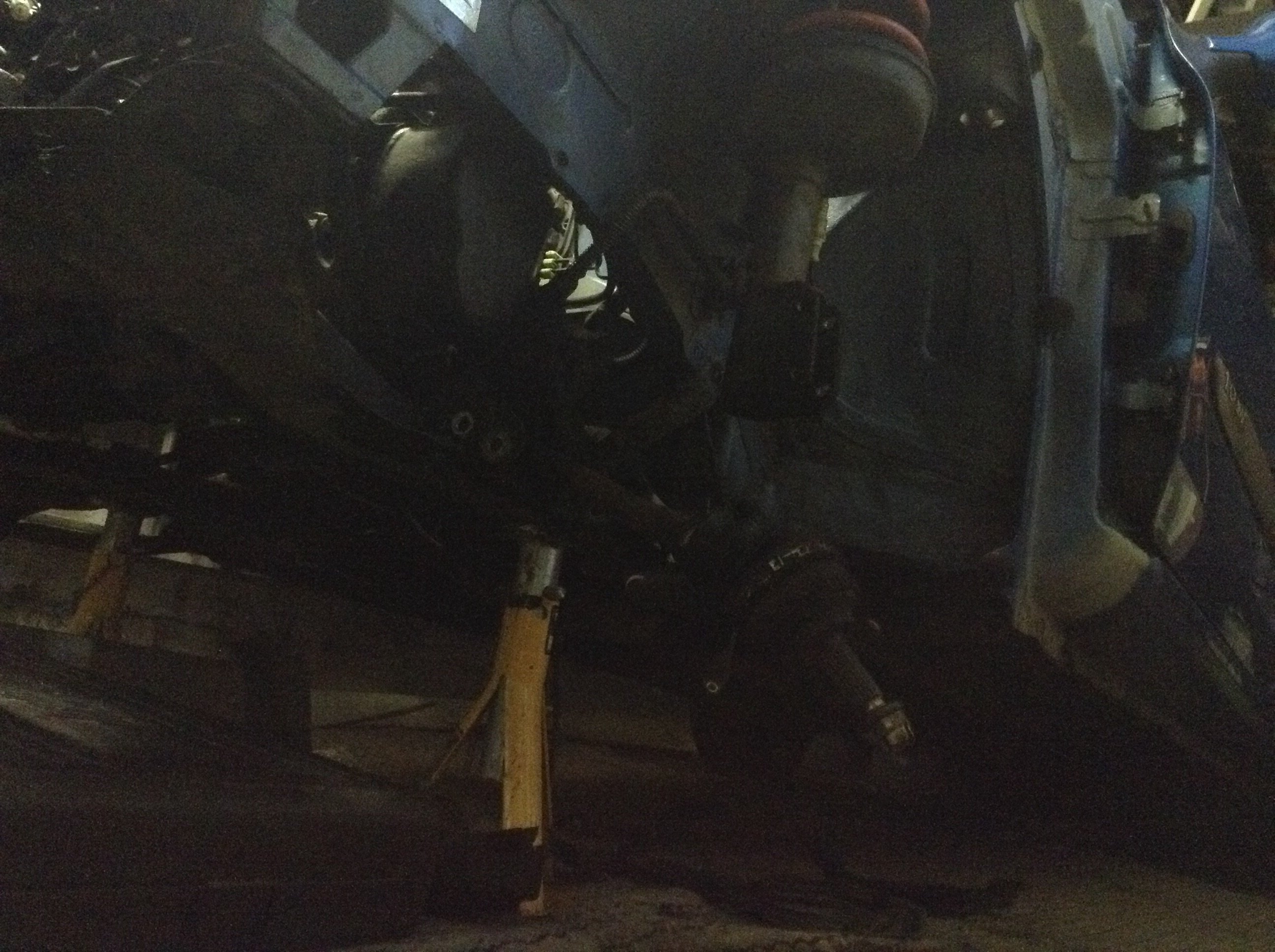

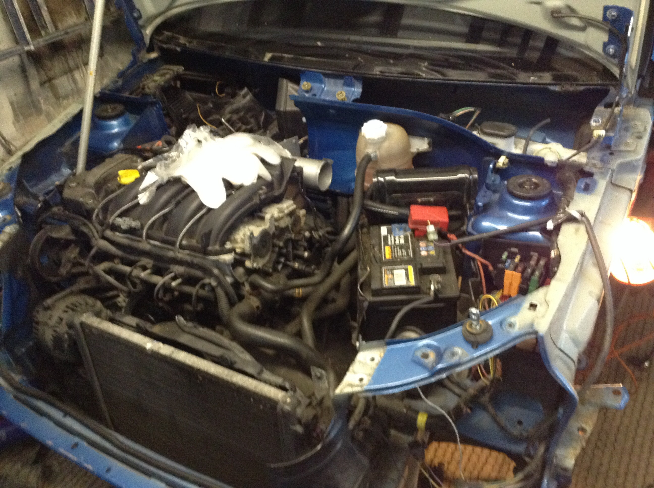

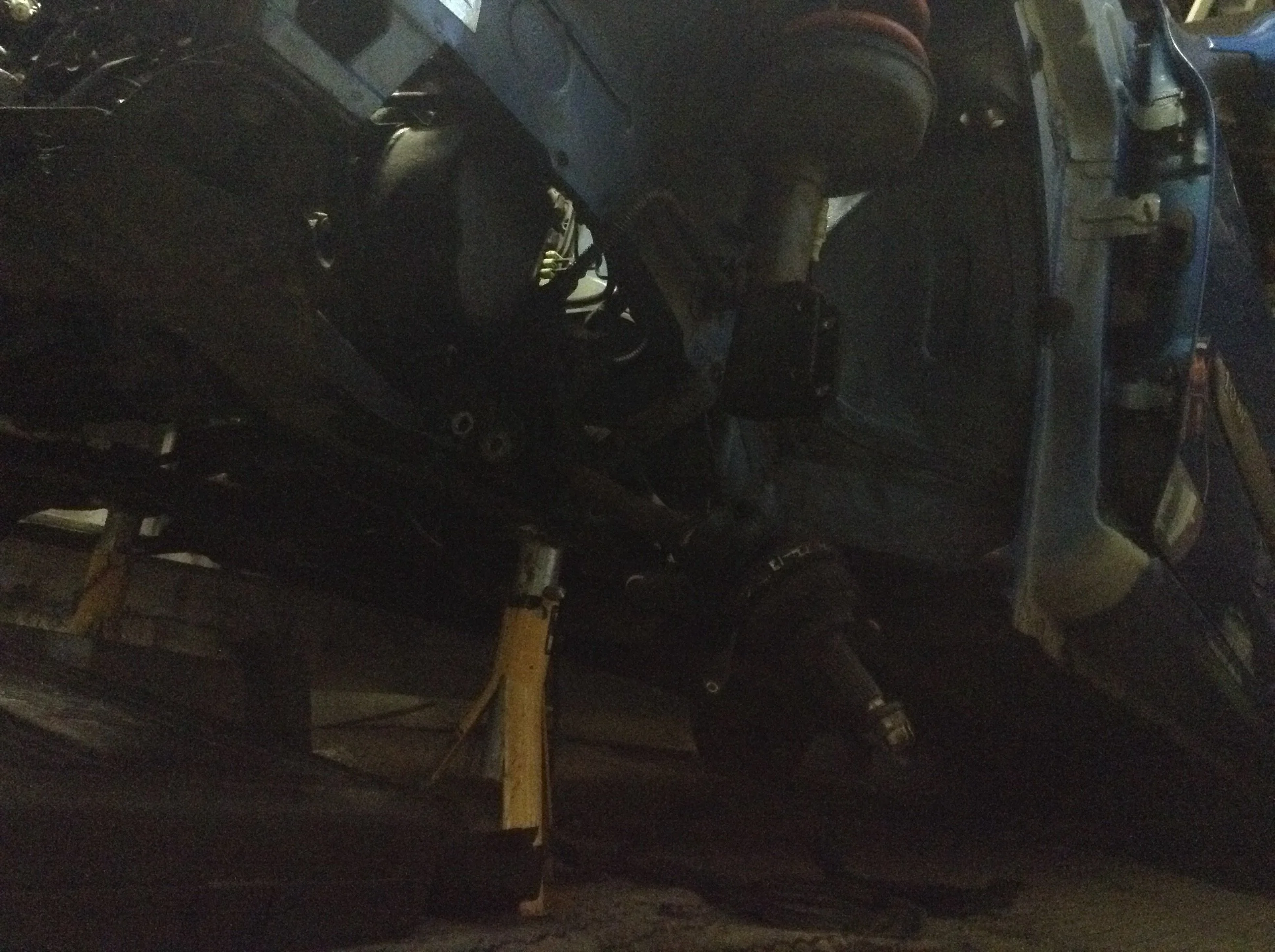

Bit more progress tonight on the old girl!
Air con completely removed.
Alternator removed
Radiator removed
Engine drained of fluids, so hopefully within the next week or two when my engine crane arrives I'll have it out for a rebuild!
Basically the whole front end will get inspected and mostly replaced!
I'm struggling to find the engine code came across a sticker tonight but that's about it, checked all the usual places!
I'm wondering if I can get a different shifter as there's a lot of play in this one, and will have to much throw.
Also looking for an Air con delete kit! Are these available for the clio mk2 k4m??

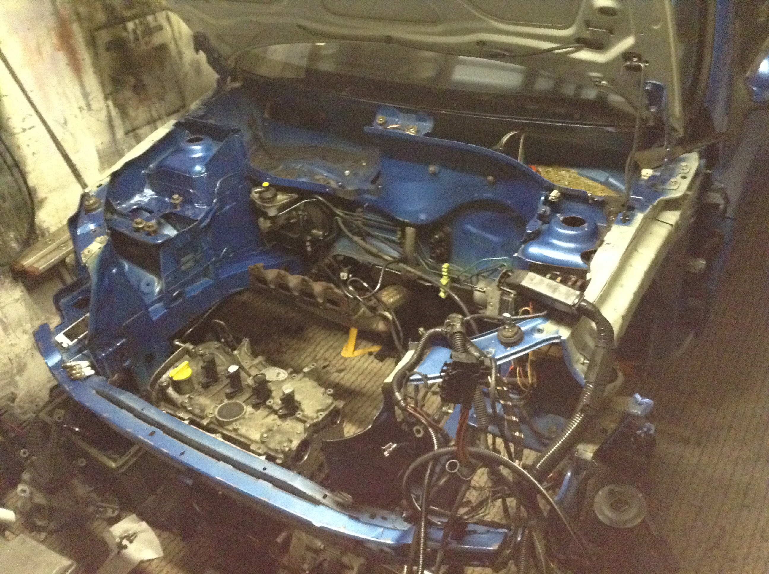

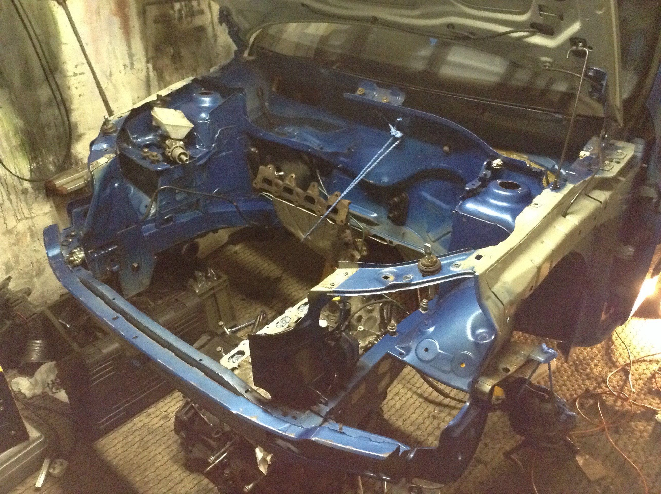

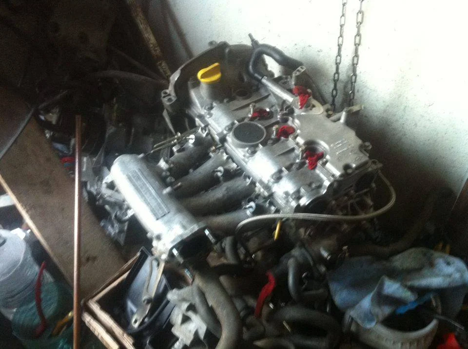

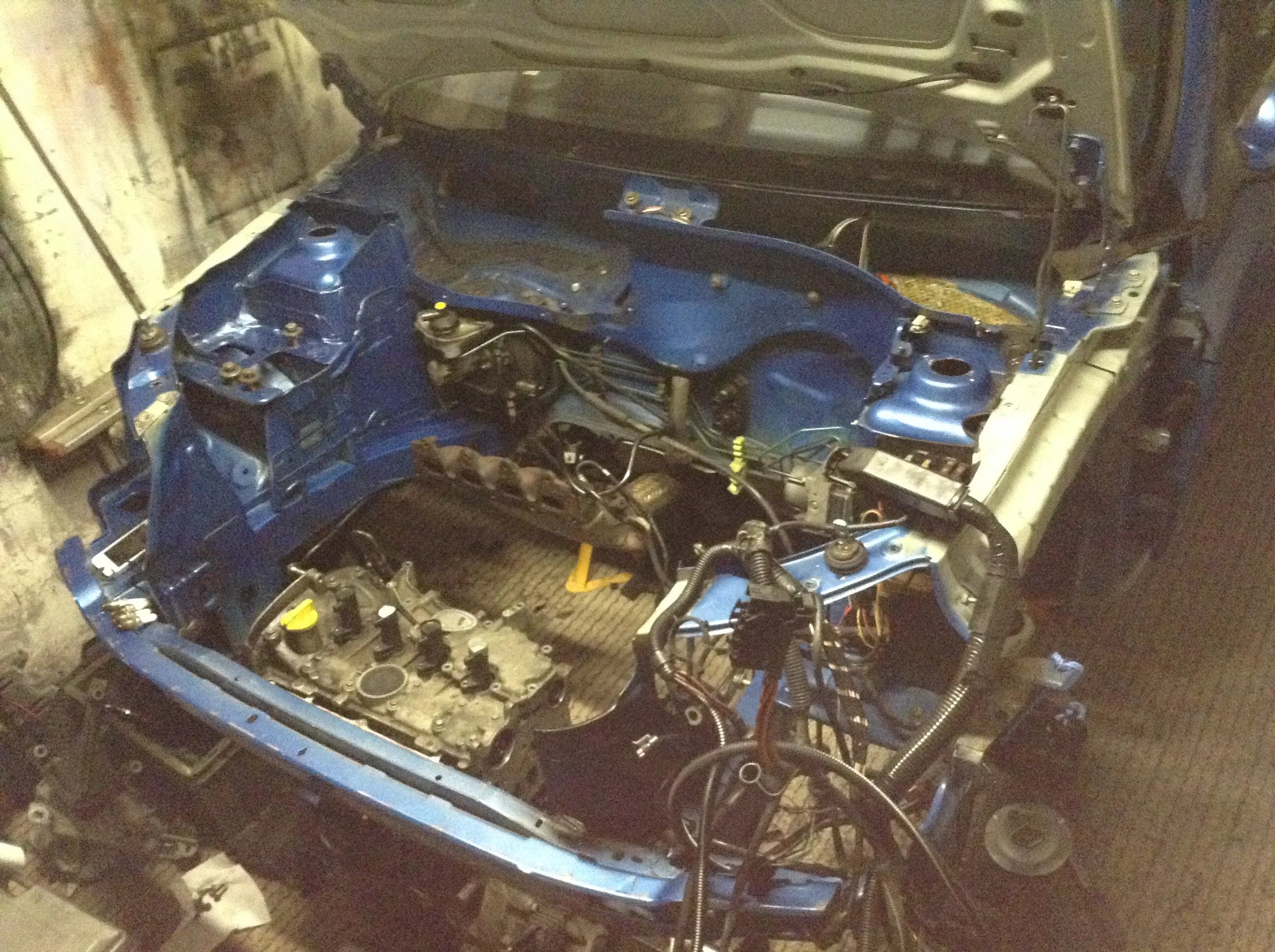

Finally got the engine dropped tonight.
After much hinting managed to find engine code K4M 774.
It felt really strong and pulled well, before I pulled it apart.
Looking and thinking of the best p, cheapest and most reliable route.
At the moment the plan is to sort the suspension out, get it all rebuilt with new parts, re paint the engine bay and sort electrics out a bit.
Learnt a lot in a short space of time.
The next phase will be hopefully to remove the ABS system, replace master cylinder and brake servo, and replace the brake lines inside the car.
I'm looking at running the front each independently from the master cylinder and the rear will be jointed from a single brake pipe like most other rally cars.
Hopefully will be ran through a hydraulic handbrake too!

Front end is pretty much where I want it to be. Looking at prepping the engine bay next for a lick of paint. Looking at doing the whole front end in white, which will include gravel paint under hearth the arches.
Removed all the ABS system and pipe work, which will be replaced by new brake lines and braided hoses from the master cylinder.
Quickly gave the engine bay a wash down as it seemed to accumulate years worth of oil and dirt.
Also managed to remove the engine Loom which will be getting looked at over the upcoming months.
Also managed to remove the whole sunroof which will be getting plated with a aluminium sheet and and waterproof rivets.
All in all a pretty successful evening. Still need to get in contact with @ Sam JFM to decide wether to stick with the K4M or go down the 172 route.
Hopefully by end of March, I'll have a new engine of some sort, coil overs, roll cage, new brakes, braided fuel and brake lines, hydraulic handbrake and a few other bits and pieces.

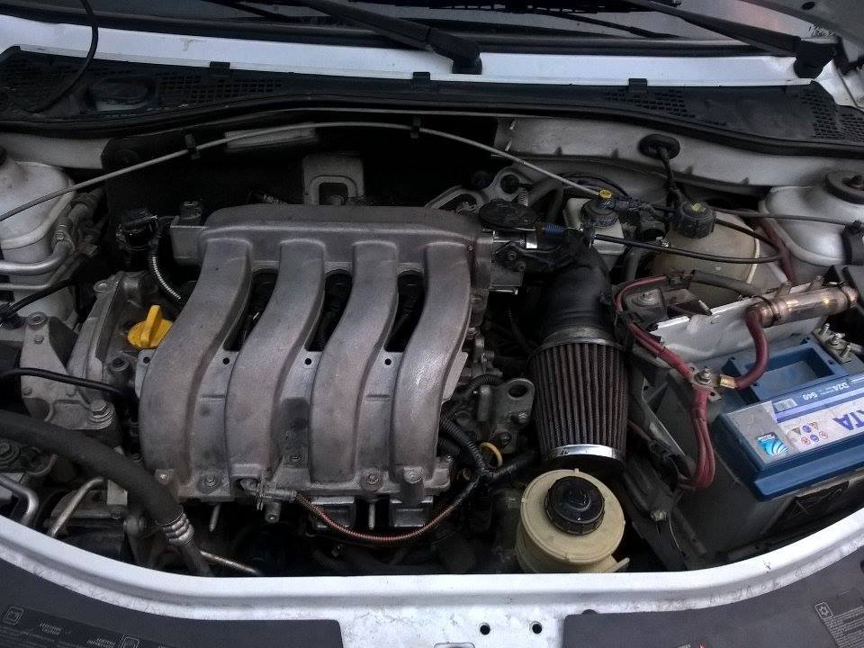

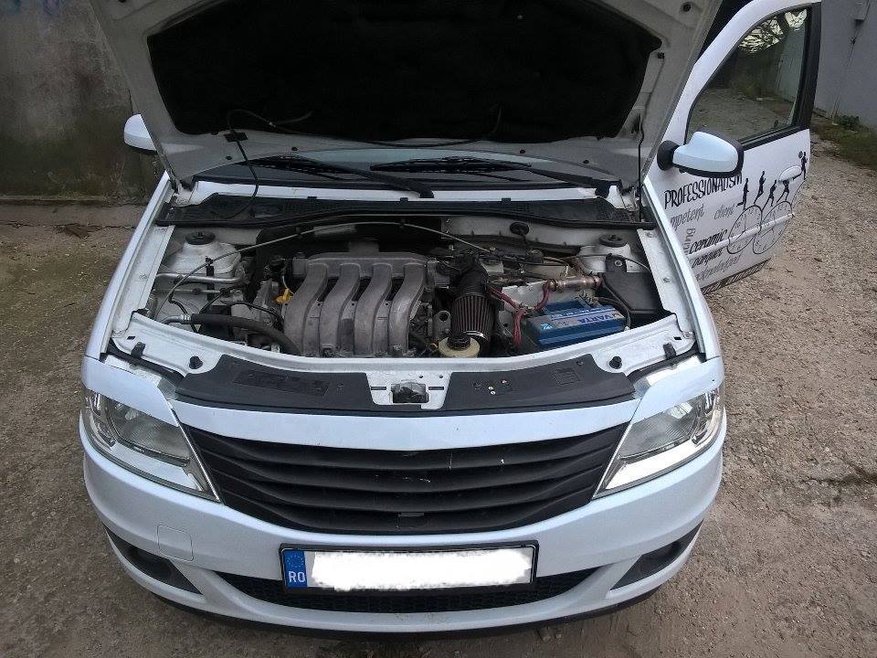

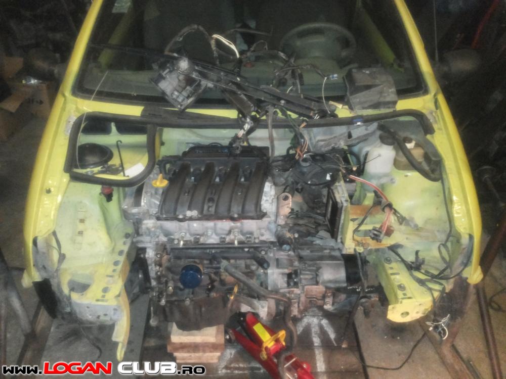

Hello from Romania, nice project I have a few projects under construction with K4M:
Renault Twingo 1.6 16v with :
-133 Twingo camshafts
- new itel manifold
-exhaust manifold SuperSprint 4-2-1
-new exhaust 50mm
- injectors f4r
-Aircon and pump sevo out
-light flywheel dacia logan 1.6 8v +update Sachs Clutch
-custom remap
-Custom gearbox jb3
Dacia Logan st 1.6 16V:
-Clio RS exhaust manifold PH1 4-1
-new exhaust 50 mm
-133 camshafts
- inlet manifold 133
-60 mm body throttel Clio RS PH1
-custom remap

Good evening mate nice to see what you have done there!
I like the look of the inlet plenum and f4r injectors.

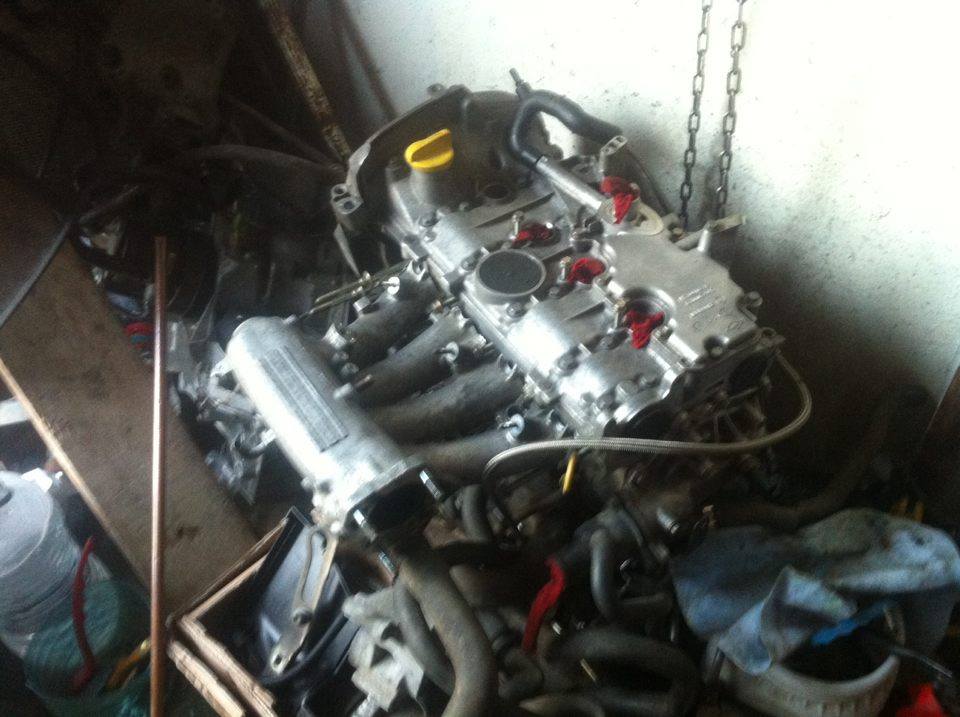

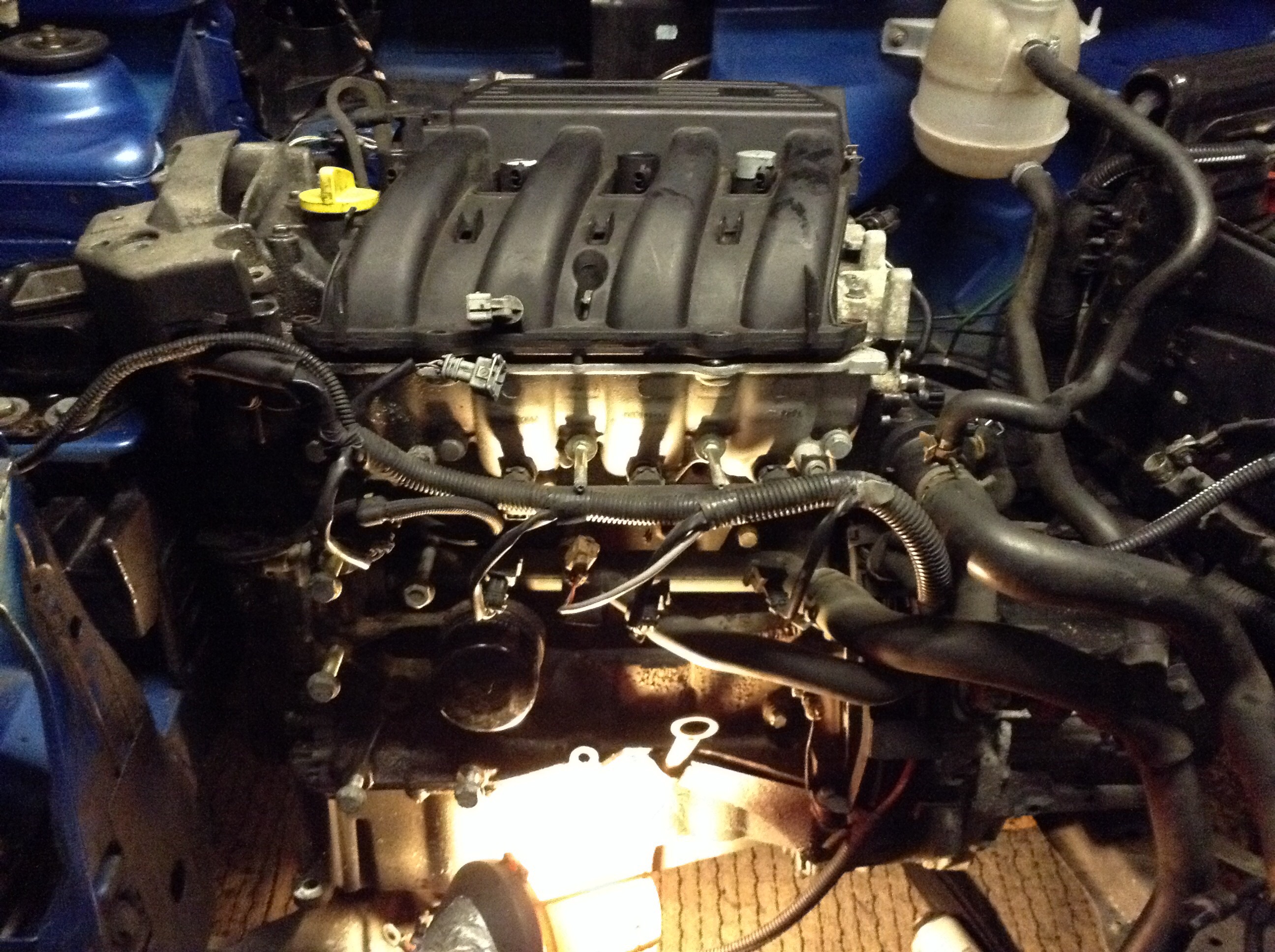

I think this is going to be similar as to what I want to achieve. At the moment my head is saying use the 133 twingo and modify it to include, new high profile camshafts, lightened flywheel, larger throttle body, new exhaust manifold and system plus a remap. Hoping to achieve 150-169bhp.
Then there's my heart on the other hand saying to use a 172 and develop it with throttle bodies. Maybe that's something for the futurre.
However no matter what route I go down be good to get reliability 1st, followed by driver ability and then power!
This for me has been the best way to learn, start off by stripping a base car you learn so much.
So this is the route I think I'm going to go down now!
Main reason being I feel pretty at home with the K4M engine and know very little about the F4R!
It's the Twingo 133 Engine and with some Cat Cams, Exhaust System and Remap I've seen proven results of 163bhp. That would be more than surface for me to be honest!
Granted it might take the best part of 2500 quid to achieve but it's still a project in itself I guess!
As to which gearbox to use I tink I will keep the K4M and maybe look at getting a LSD for it.

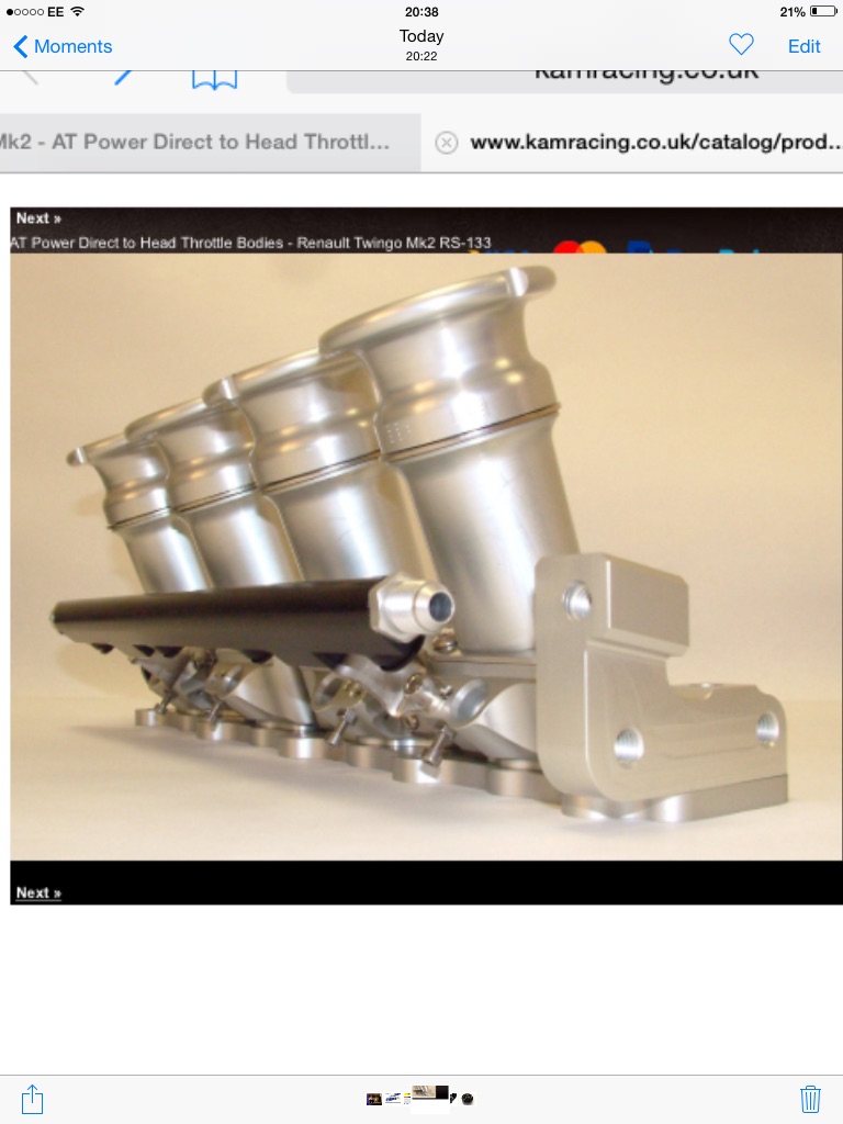

I've also seen this little beauty!
Not too sure how it would work with a FBW throttle body, however I'm sure there's a way around things!

Tonight was a good constructive session on the car!
All the dash removed and I beagn to strip the loom as much as I possibly could. Everything went including Airbags, all redundant wiring, electric wiring for the windows, wing mirrors, all the central locking loom.
Next up is to sort the engine loom and see what I can get rid of!
So far so good! Every thing tested and working nicely!
Below you can clearly see how much has been removed so far!
Also this forum has helped me a lot along with the haynes manual and wiring diagrams.
