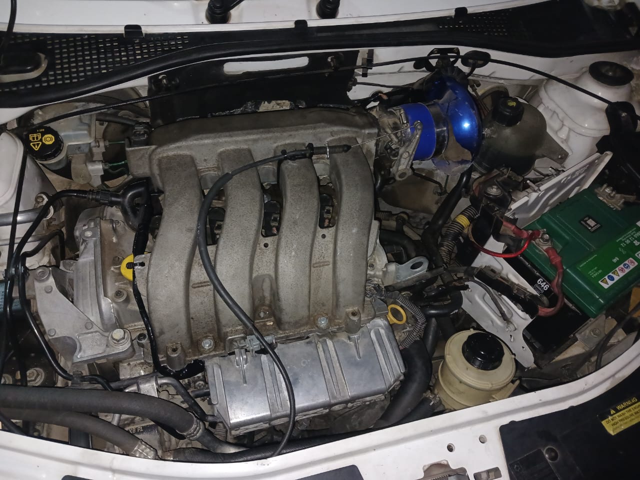

Thank you! Yes it fits, but I have idling problems now, dont know it is a leak but currently busy to find the problem. The car sounds much better, and pulls wayy better.

Since the video and foto, i build an induction nothing fancy. When it is sorted 100% I will be looking to build a nice one.
Ps. foto and video was the day when i got the Bakkie(small pick up) back.

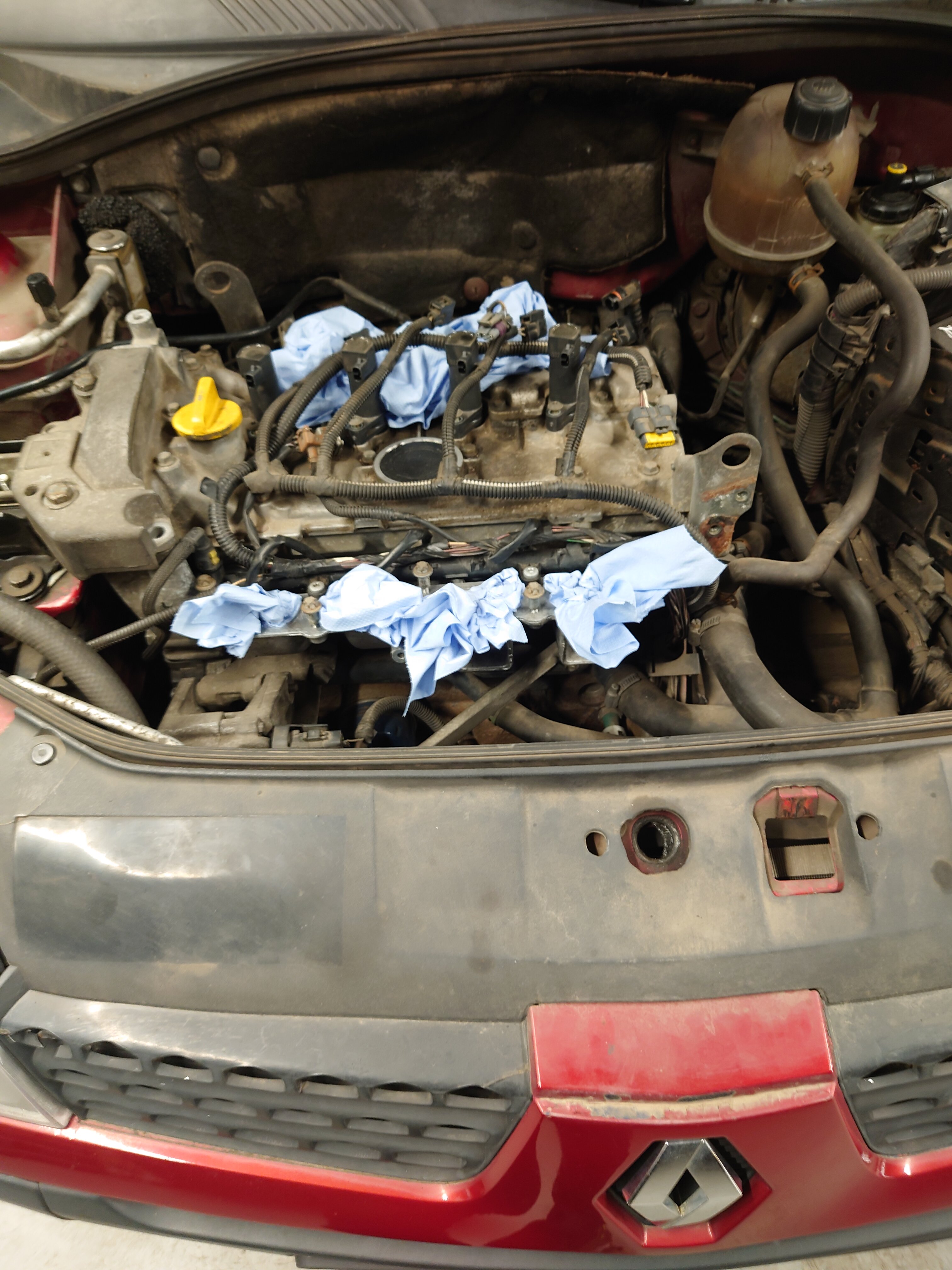

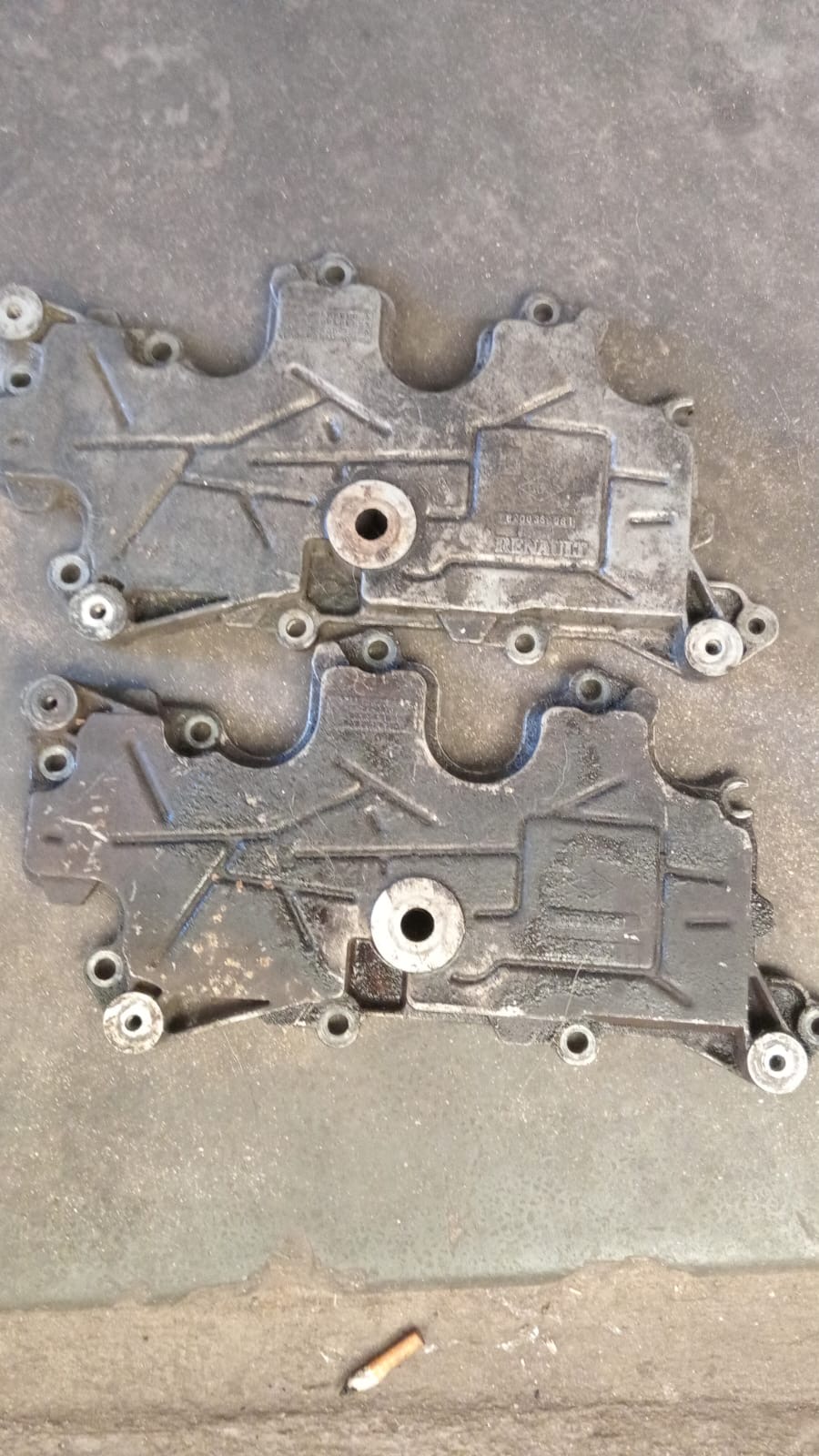

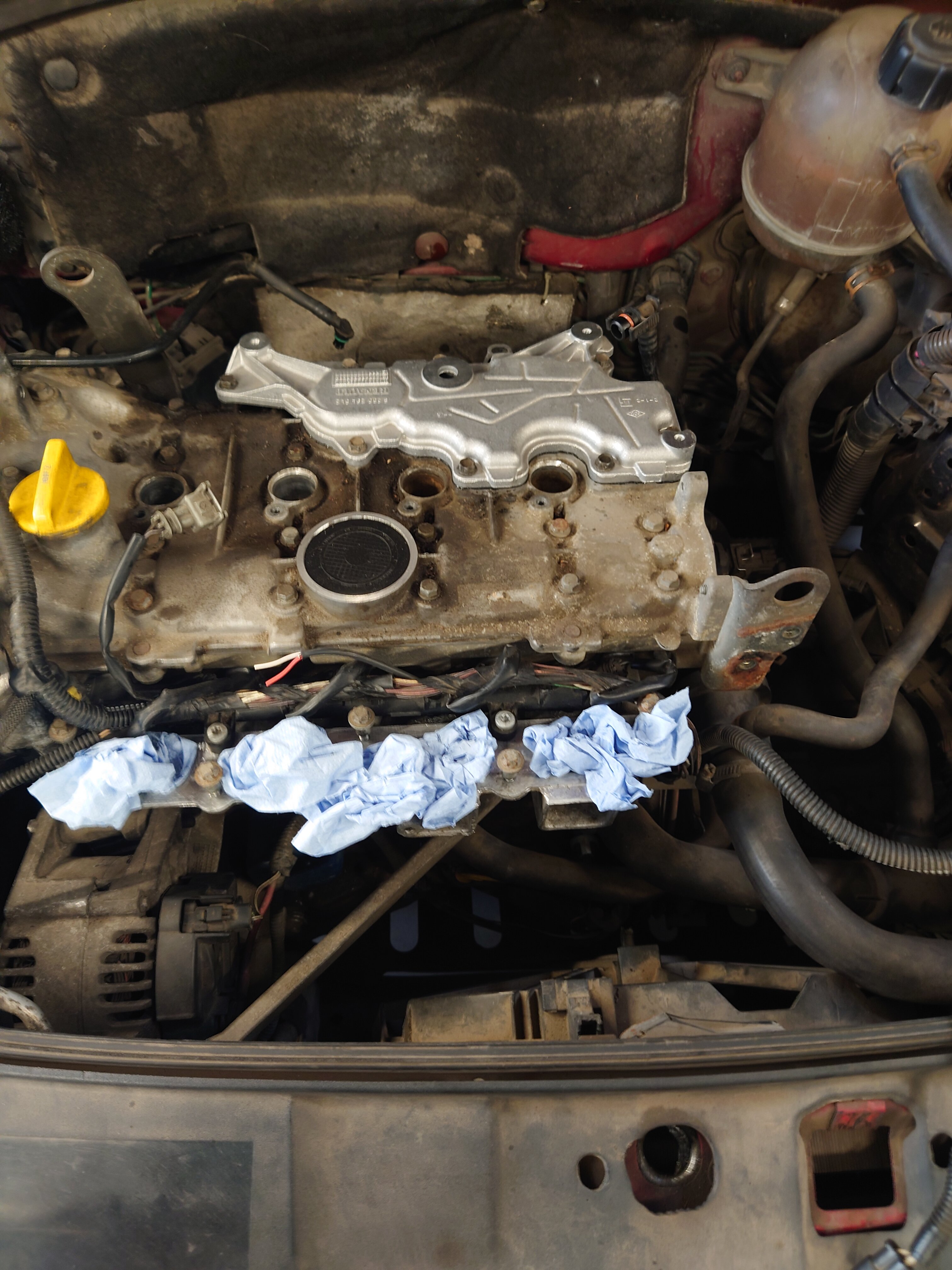

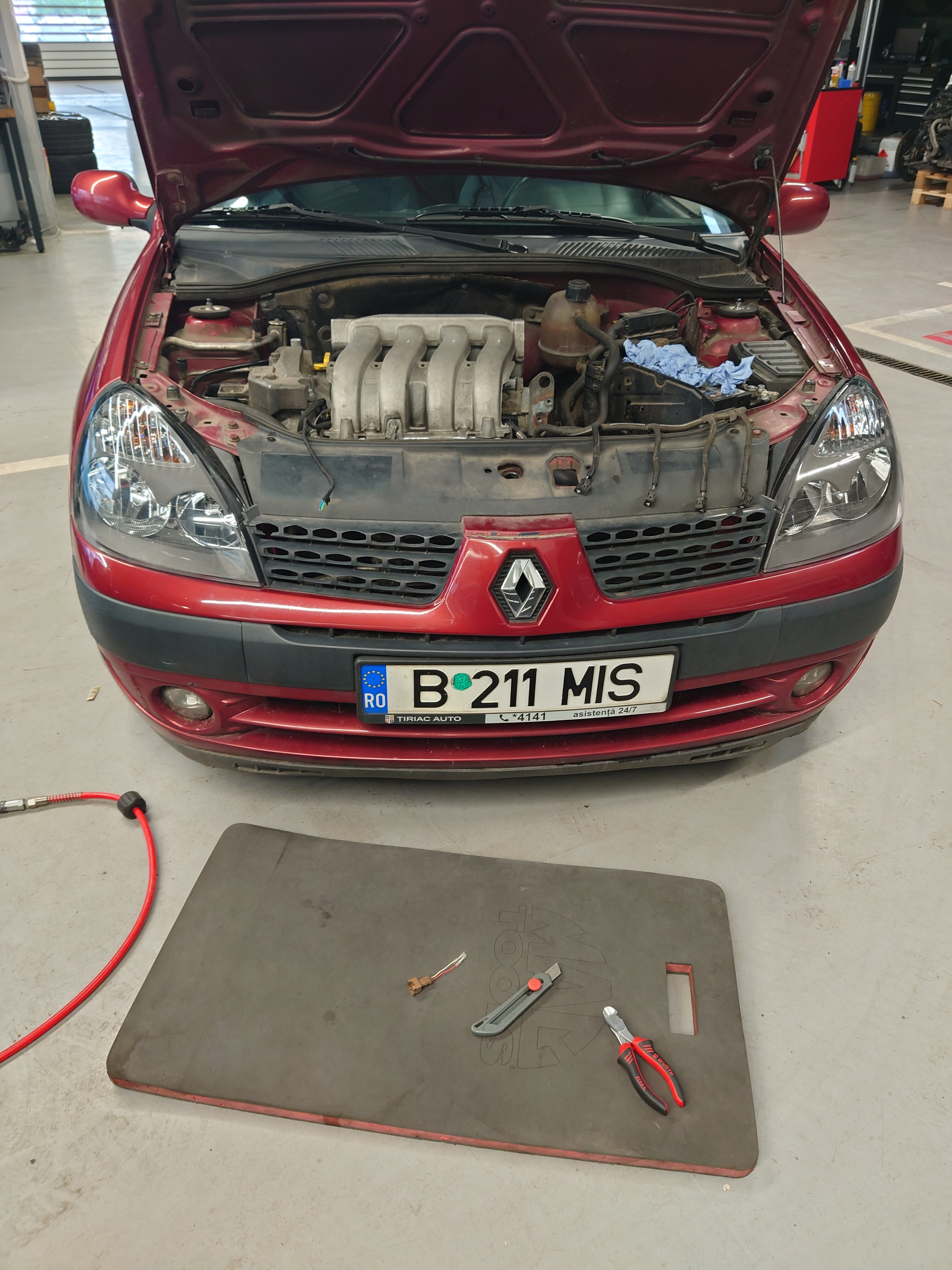

Hi guys , im about to do the same stuff to my clio mk2 1.4 16v , upper intake manifold and throttle body from an twingo rs , lower manifold from megane 2 1.6 16v also the injectors and the injector ramp (to get a complete manifold in my country is rare this days) also you need this rocker cover part from renault modus (8200294042) also the 90 degree rubber induction hose from the throttle body , if you want you can ut the twingo rs cams put the intake one yu need to plug the vvt holes ...for the exhaust part i nned to find an standard exhaus manifols from a twingo rs to see if i can fit it (abs pump is quite close) if yes k tec has a nice manifold on sale.

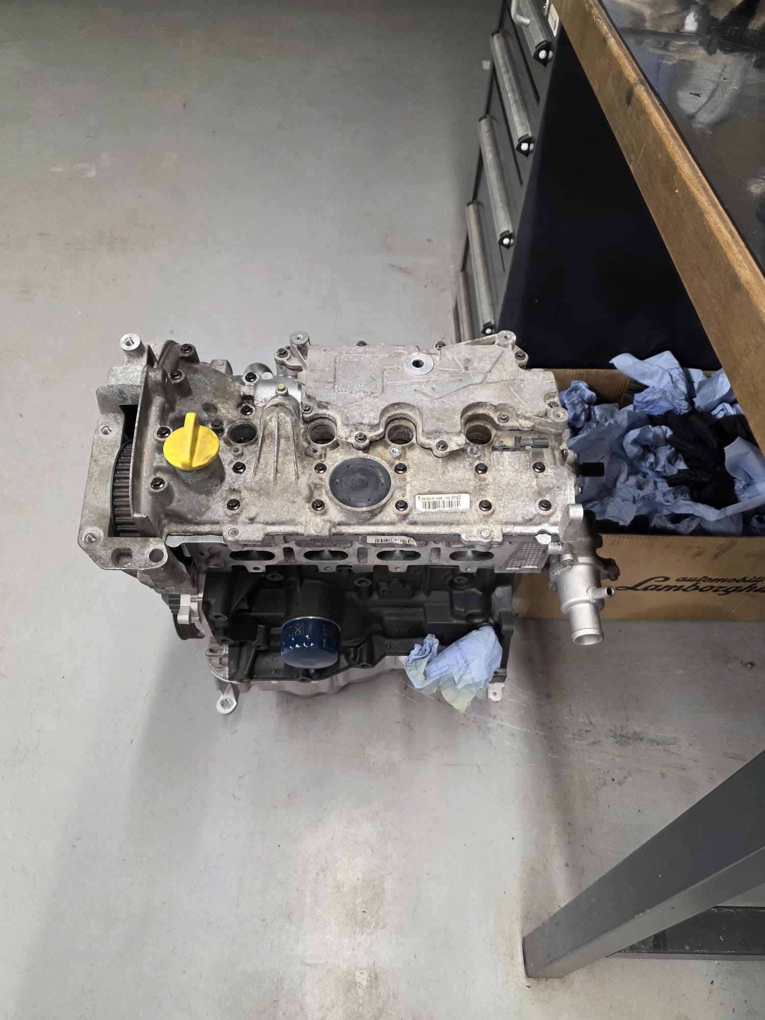

That is my frankestein Dacia - Twingo Rs engine as you can see it s exactly like yours but it fits only on twingo rs cylinder head , im doing a full conversion to twingo rs cylinder head on normal k4m engine block from dacia with all twingo rs internalls , mechanically blocked dephazor but still using the oil lines for both cams , from where you got that part just get the cylinder head too .
Did you use your standrd icv? Or did you get anither one from the clio rs? And if so did you use the standard location for the icv?
I don t have that on my car , my clio had electronic throttle body and a friend wired my clio rs throttle body to the original loom
