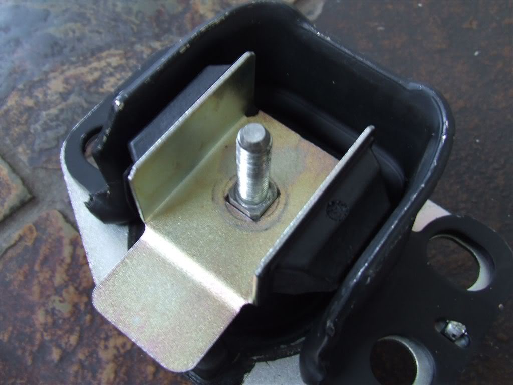

Yep apparently they are 'stiffer'. I'll let you know if they actualy are once I've got them on mine. However its not unusual for Diesel spec mounts to be stiffer than those spec'd for the Petrol version of the same car/van due to the differences in weight/torque the diesel engines produce.
Edited to add: The actual mount may be the same it may just be a difference in the 'buffers' on the top engine mount. The ones on the diesel mount I have are very much in contact with (and then some) the cage.

I'll let you know as soon as I've got mine into the workshop. I can test the stiffness pretty easily but then comparing it against an old mount is pretty useless.
The buffers on the mount I have here are under compression against the cage!

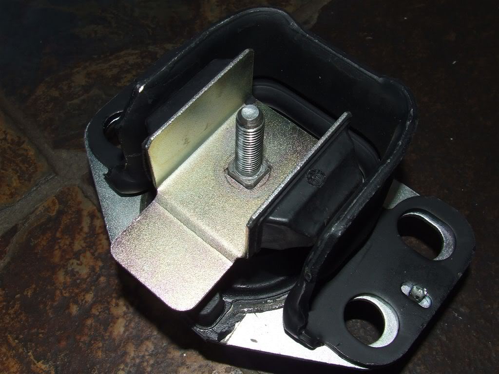

Went into GSF today and picked up this
I asked for a 172 mount and was given that, though it says its kangoo compatible

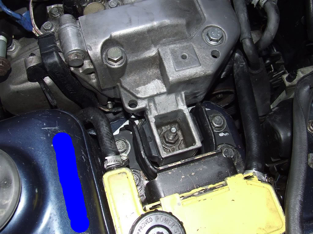

However, it *seems* reasonably stiff and the buffers fill the support thing so there is no movement!
quickly installed it too, much better than my completely snapped mount lol

Yep, same as mine. The buffer completely fills the right hand side of the mount as you look from the n/s.
The gearbox mount looks to be the same as the one that K-Tec sell as well.

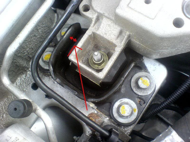

For comparison this is the gap and where it should be on the standard mounts. Can anyone confirm if the dogebone mount on the Kangoo is compatable with the 172ph1 or ph2??
Interesting.
