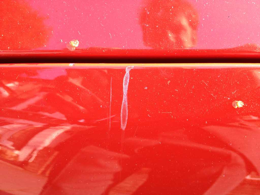

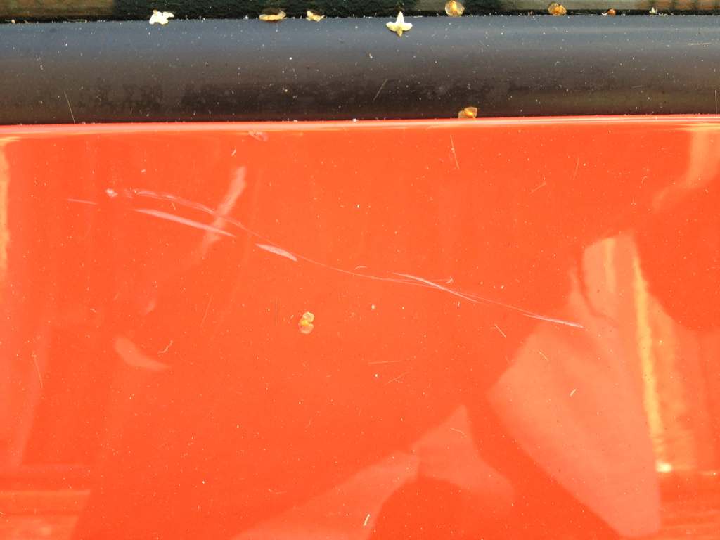

I have the following scratches from when some kind young chaps slid across my bonnet and stole my Alu wing mirrors on my S3;
Door;
Wing;
I have paint and some cellulose clear coat as suggested to mix together, I'm going to buy a tiny paint brush and use the "join the dots" technique.
After this, I'll wet sand with a backing block with 3000 and then polish up.
Does this sound about right? Can I use a hair dryer to speed up the drying process? Any other tips or advice?

It work so well on stone chips mate, my advise is don't use a brush, I used a MF applicator to do the Puma, you want to wipe over the scratch area, use a heat gun to lightly heat, then build up a few layers then wet sand back. Be careful though mate as that wing scratch won't have much clearcoat left, it's a high edge.
It's tricky to do but it's worth it, the Puma 1/4 panels looked so good even close up where they were white dots before.

Kevin do you really think the wing can be sorted? The door I can imagine but the wing looks fairly bad. I wouldn't like to try it tbh but then again I'm not good at it lol
Yeah I've priced up a "breaking spares and repairs" wing on eBay. £60 delivered, good condition (no scratches, swirls I can deal wid).
It's the door that royally f***s me off. So you'd advice MF applicator with paint? Wipe over a few times and then polish up, thus removing excess paint from around the scratch, leaving the build up in the scratch? I know that was the method for Russ' stone chips guide;

Wing is likely to be delivered soon via CS user hopefully! But interested in thoughts on the door as that's the one I know I can fix and hence pisses me off more!

Have you attacked the scratches with your rotary yet at all? I know a rotary won't ever get rid of it but it'd make a good start and less to fill via the paint/MF/sanding method.
Finger nail deep lad. No point round off the edges, it's not a UDS. These are broken lacqer and the the wing is down to plastic. I need to build layers, wet sand the round paint surface and then attack it with the rotary.
Gally
I wouldn't buy the new wing, they're a c**t to fit and probably full of hidden rust. If done right the guide works superb mate. You're description of what to do it bob on. I would practice first but fire in if you're confident.
It really does just level off. Don't go crazy with the paint, keep it very local to the scratch, about 1 CM either side of the mark if that makes sense. :)
The wing needs painted Scrooge, I don't think JD would deny that, all about making it looking a bit better. It'll never be perfect.
