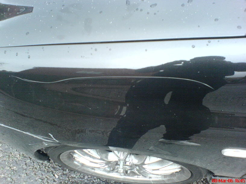

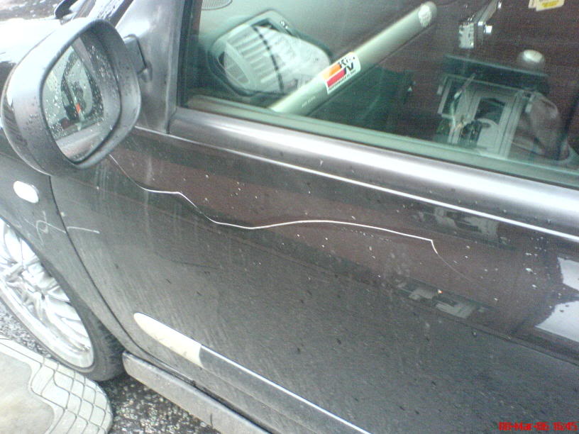

ok im sure weve all had it done or know some one who has had it done! last nite it wsa my turn! full length of the off side! WASTERS!
Anyone know of good companies to use?
shall i use a body shop or a company that repair scratches?
recomenadtion in the PORSTMOUTH AREA???
THANKS

Is there no where in your area that you can take it? couse you dont need the whole pannels sprayed just blown in aye.... should be pretty cheep to do it.

to be honest mate it should be pretty cheep
They might polish out with a machine depending on how deep they are but as you describe it probably not.

i wouldn't say repairing a scratch was piss easy in anyones book, to do it properly you need it taking down below the scratch so if the scratch is down to the primer there aint no way you are going to get t blown in, it will need taking back to metal!
a full panel paint is nessesery and it will need blending into the next panel too.
its one of the jobs any paint shop hates doing because its a pain in the arse to do if the scratches are deep.
