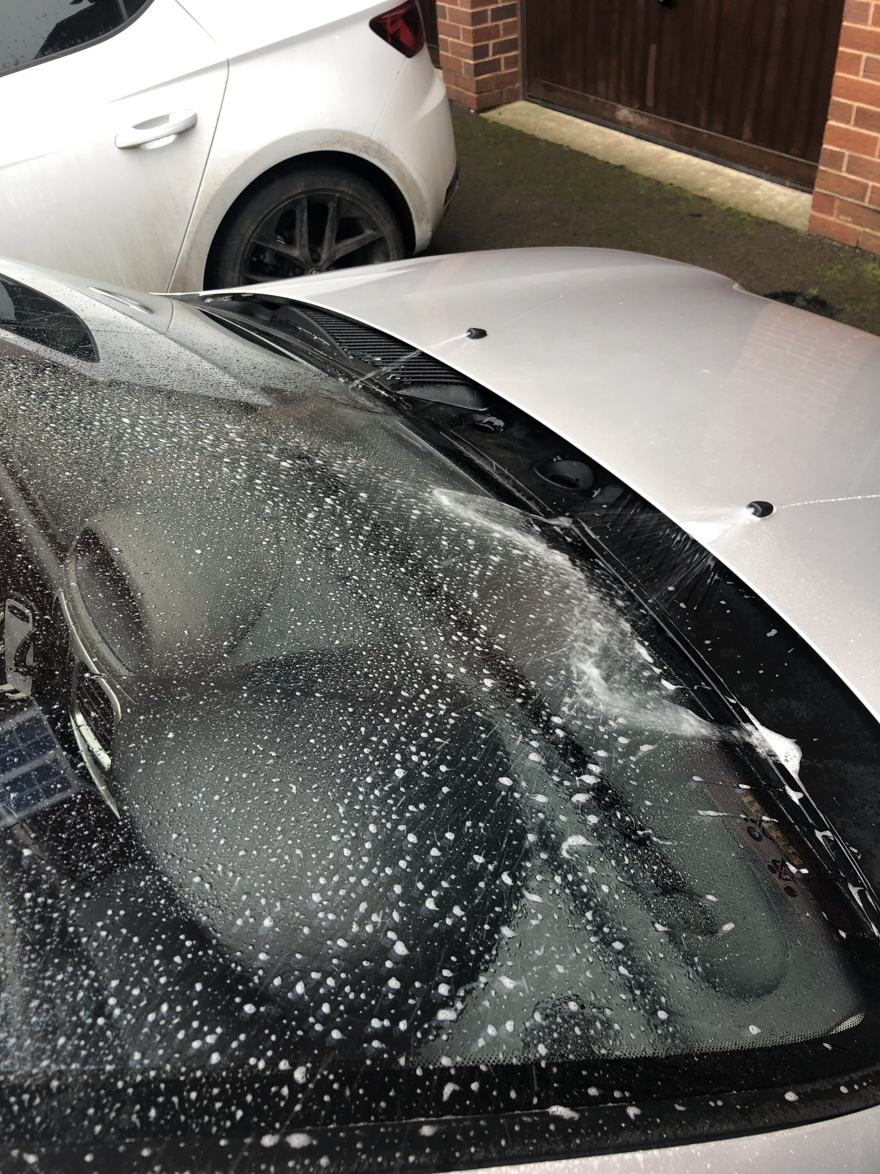

Washer jets weren't working that well when I bought the car, never really bothered me and I just replaced them with mist jets from a C3 as an upgrade. Had them on my old one and was impressed. But they weren't any good either. Now that I need to use the car more I decided to take a proper look. The one like squrts out at a jaunty angle and the other just bout hits where the wipers rest. I remember from my old one the water should hit at the driver's eye level - unless my old bucket seats were that low this is actually correct?
Swapped the nozzles over to see if it was something to do with the pipe work under the bonnet. Nope, they still perfrom the same. Thought there could be a blockage in the fluid bottle so took it out, emptied it and let it soak with some denture tablets in. Rinsed it through and still the same. The pump doesn't sound laboured either. Did look on eBay for replacment pumps and for tat price I might just swap it out and get some new mist nozzles (I can't find the original ones so must have thrown them out).

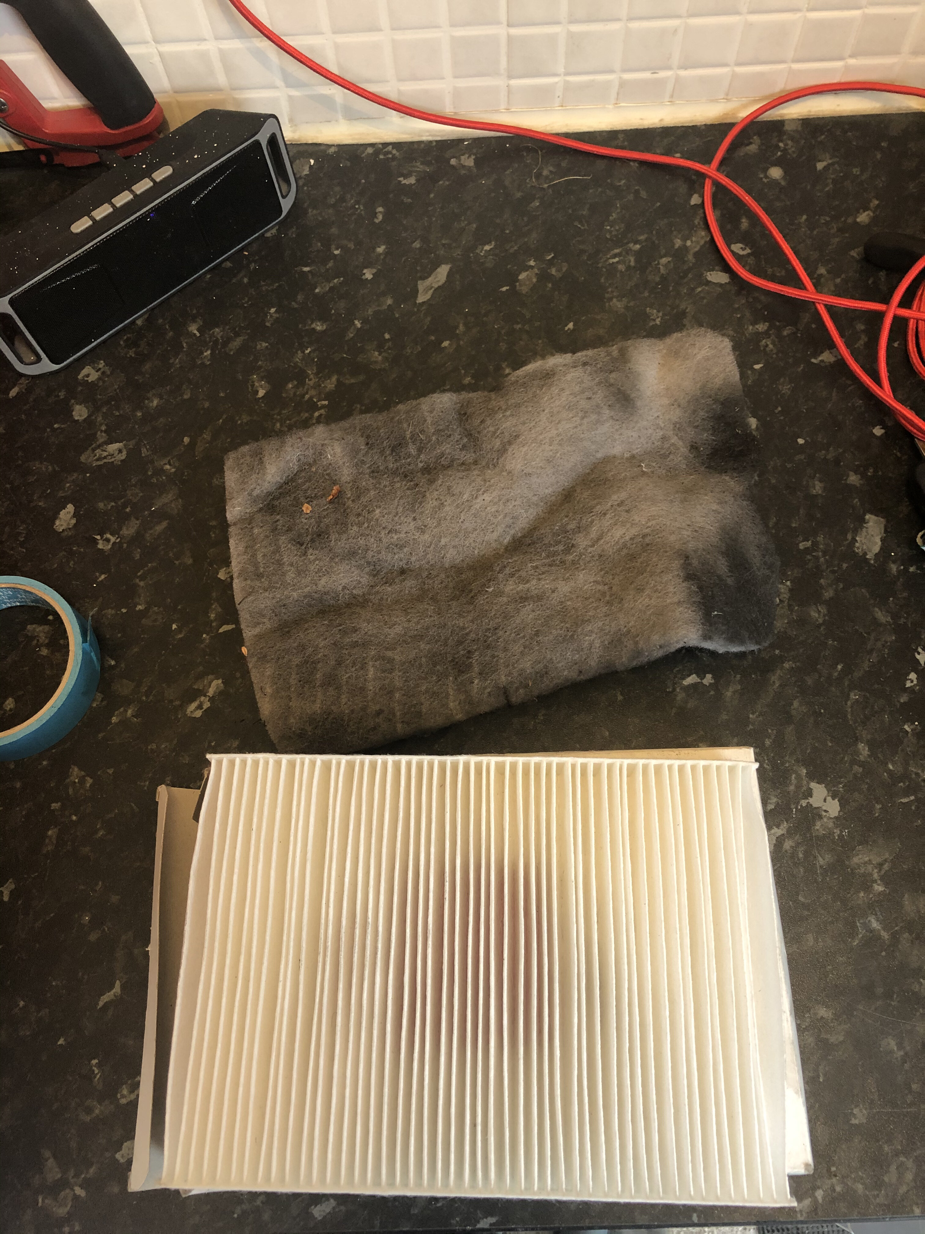

While the scuttle was off I decided to replace the pollen filter. There was one in the boot when I cought the car so thought would be rude not to change. Glad I did change it as I removed some really dirty foam mesh stuff that i don't think was doing much.

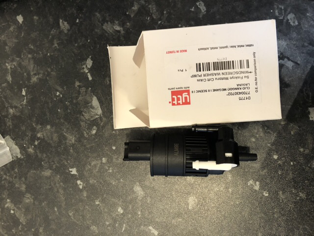

New washer jets turned up. I pushed the boat out and went for genuine Citroen ones, however they were in Alfa Romeo packaging
Worked a treat so turned out the previous washer jets were a dud. Did order a new washer fluid pump just in case and fitted that too

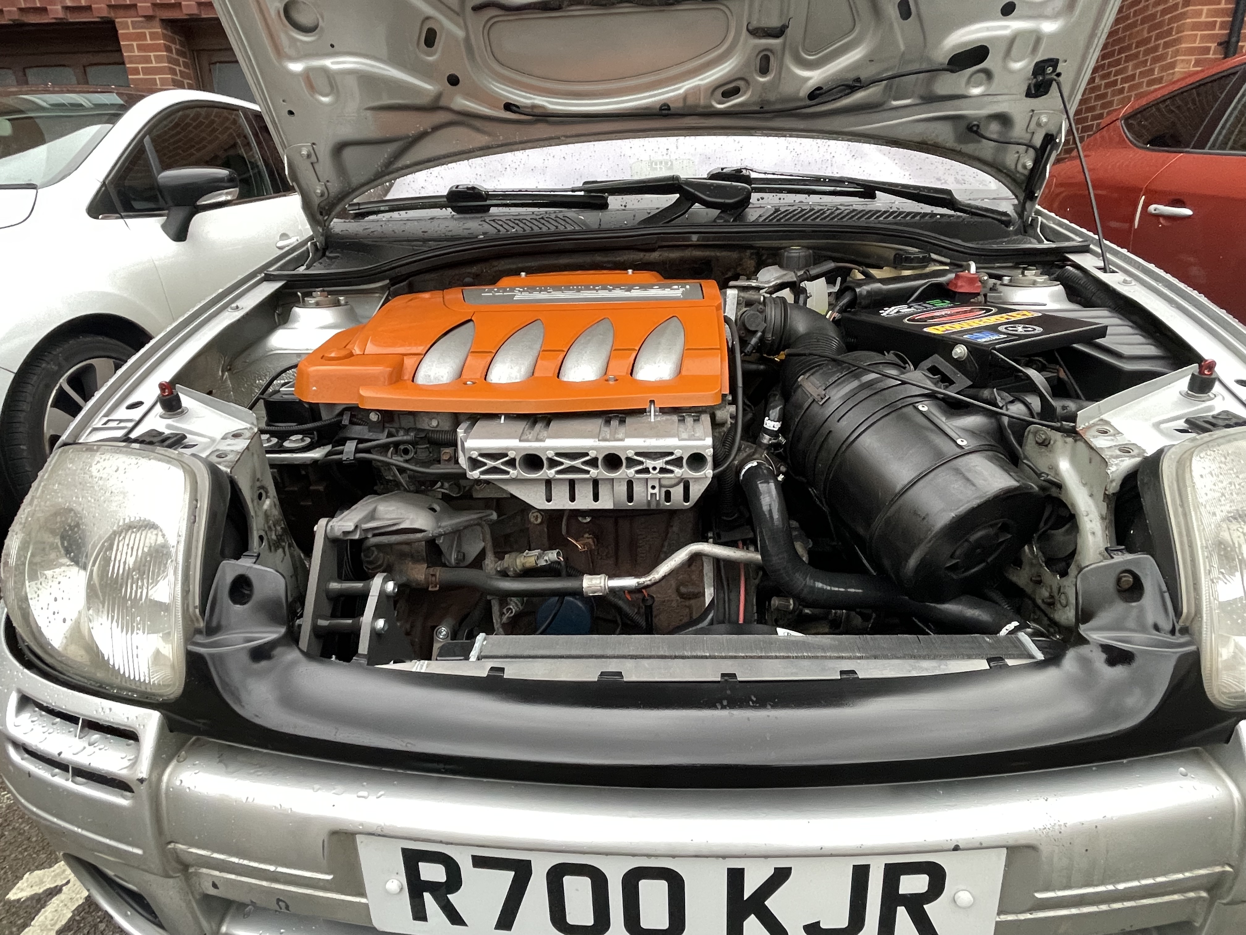

Need to source an oil filler flap for the engine cover then that’s the engine bay finished. How they are lost I have no idea and they are really hard to come across!

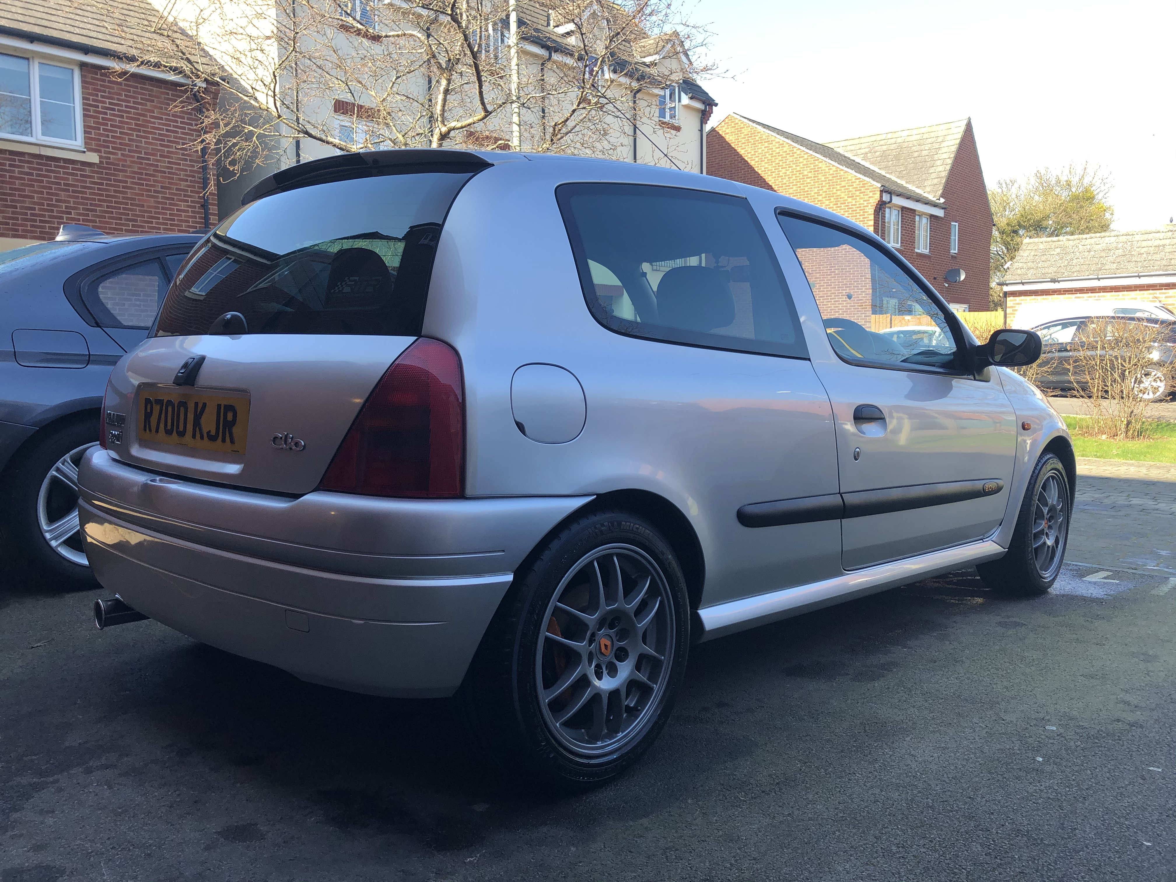

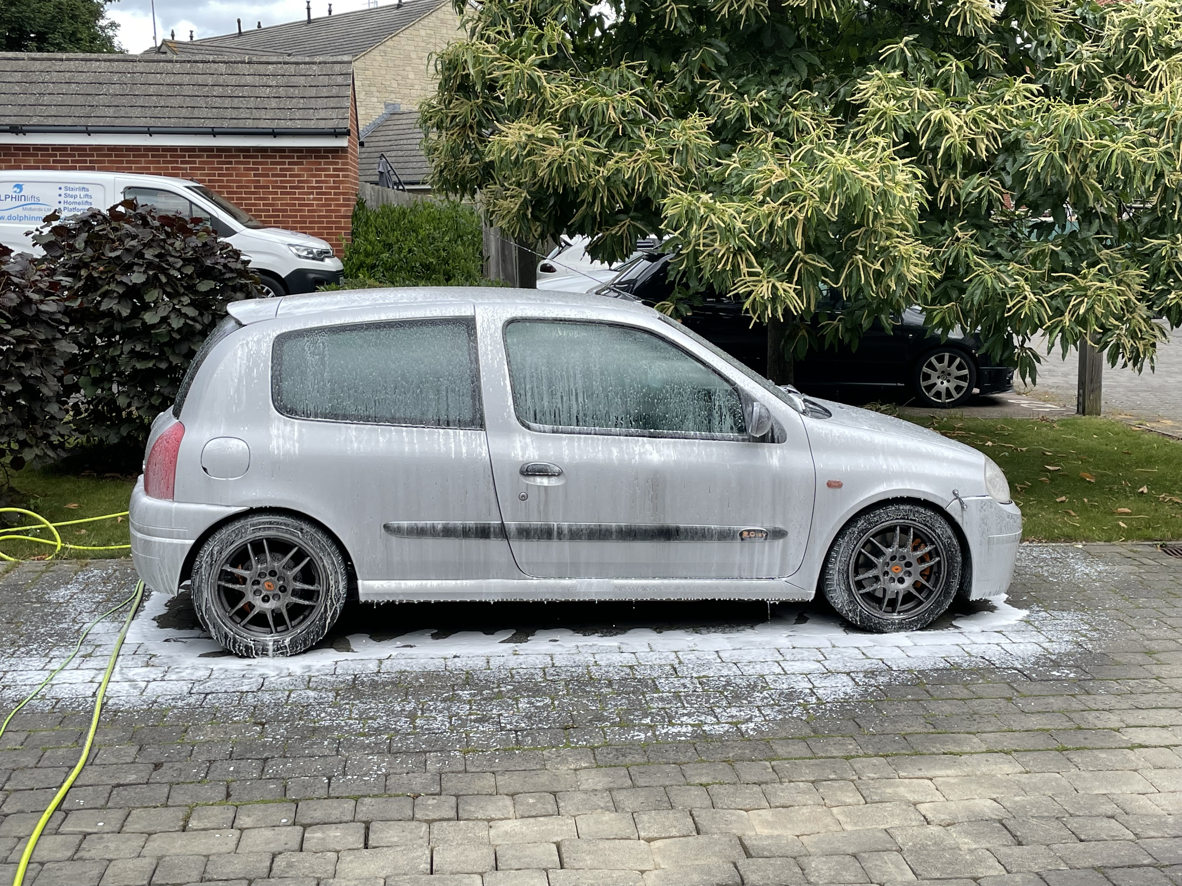

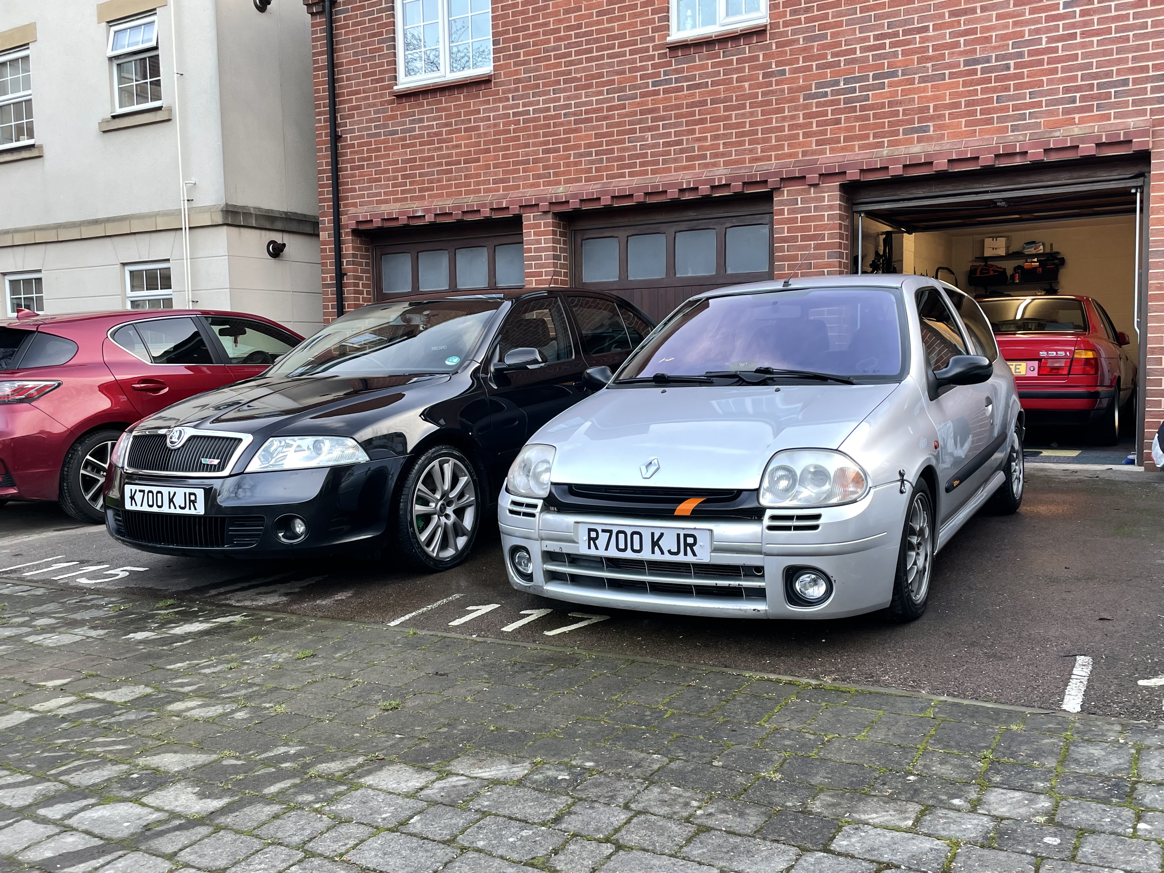

Finally got my hosepipe installed so took the opportunity in the good weather to clean it. Used the new AMDetails items I bought a few weeks back. Looks really good now. Do reccomend this items.
Polishing a turd comes to mind
Although it highlights the real need of a full respray. But the way it is makes me worry less about it. Just get the sills checked/sorted and take it from there.

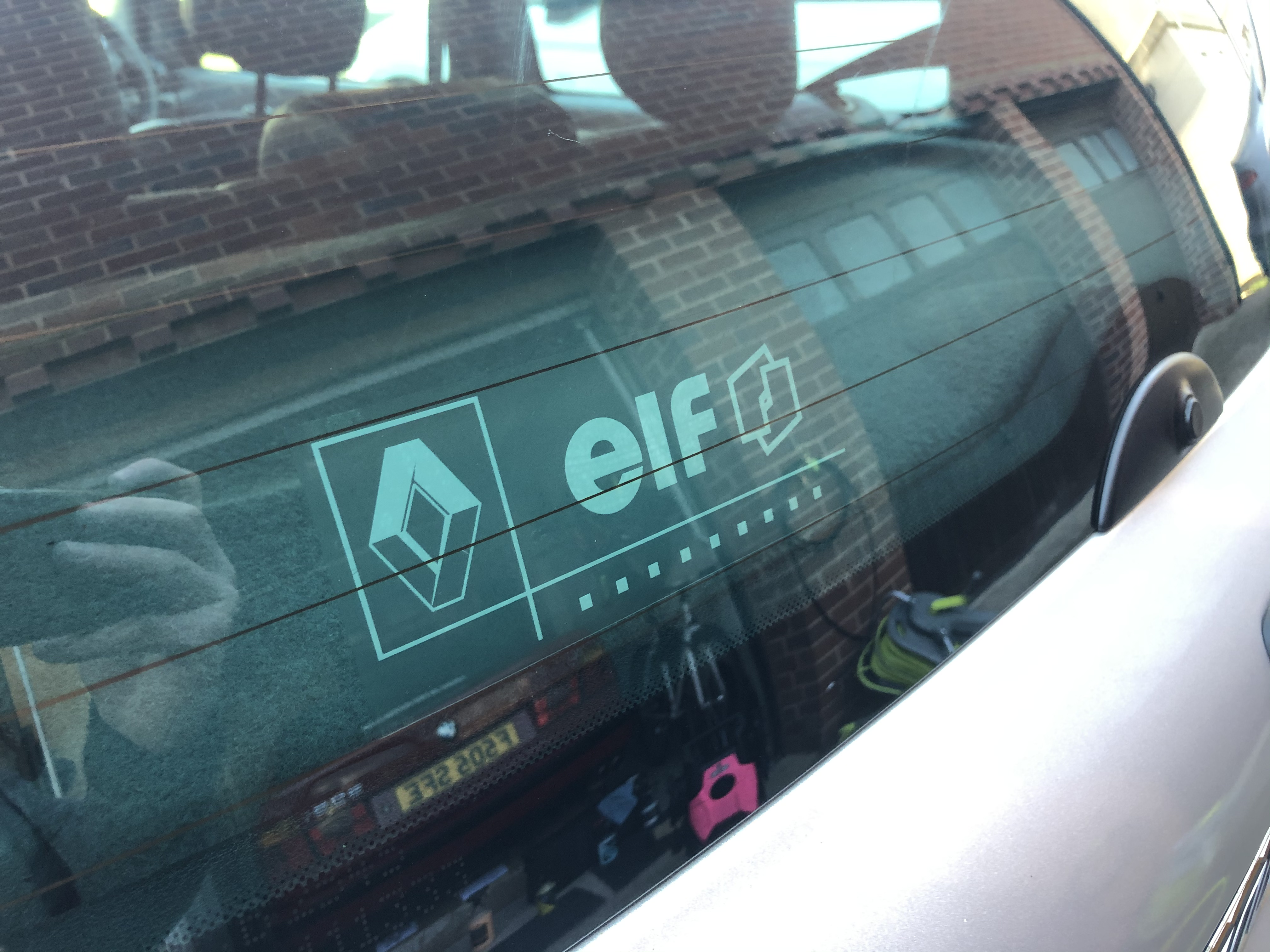

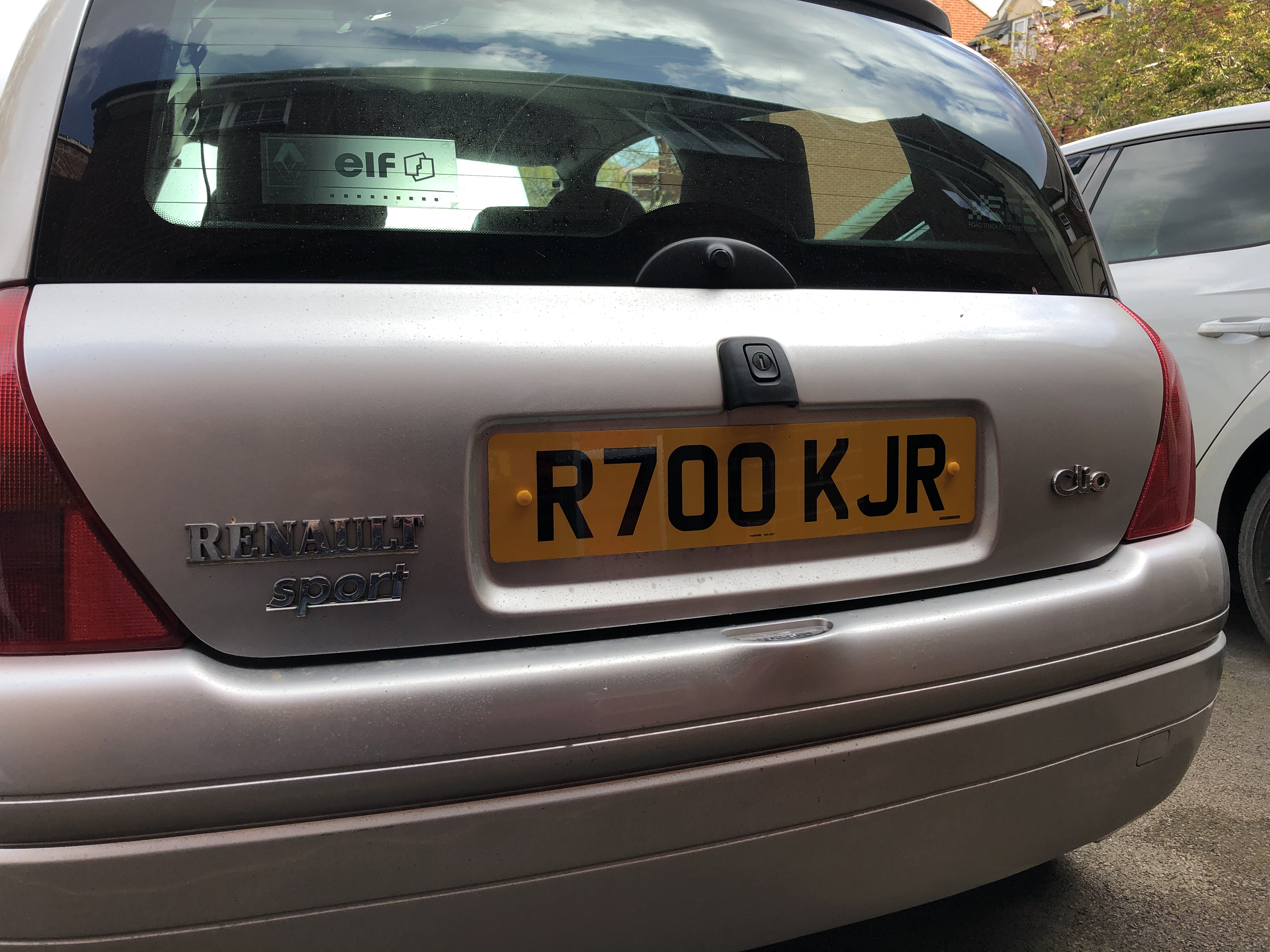

Got a new Elf sticker for the back window from @BenRS182

Your car is looking good 👌
Thanks for the picture of the sticker as well,makes it look that little bit tidier 👍

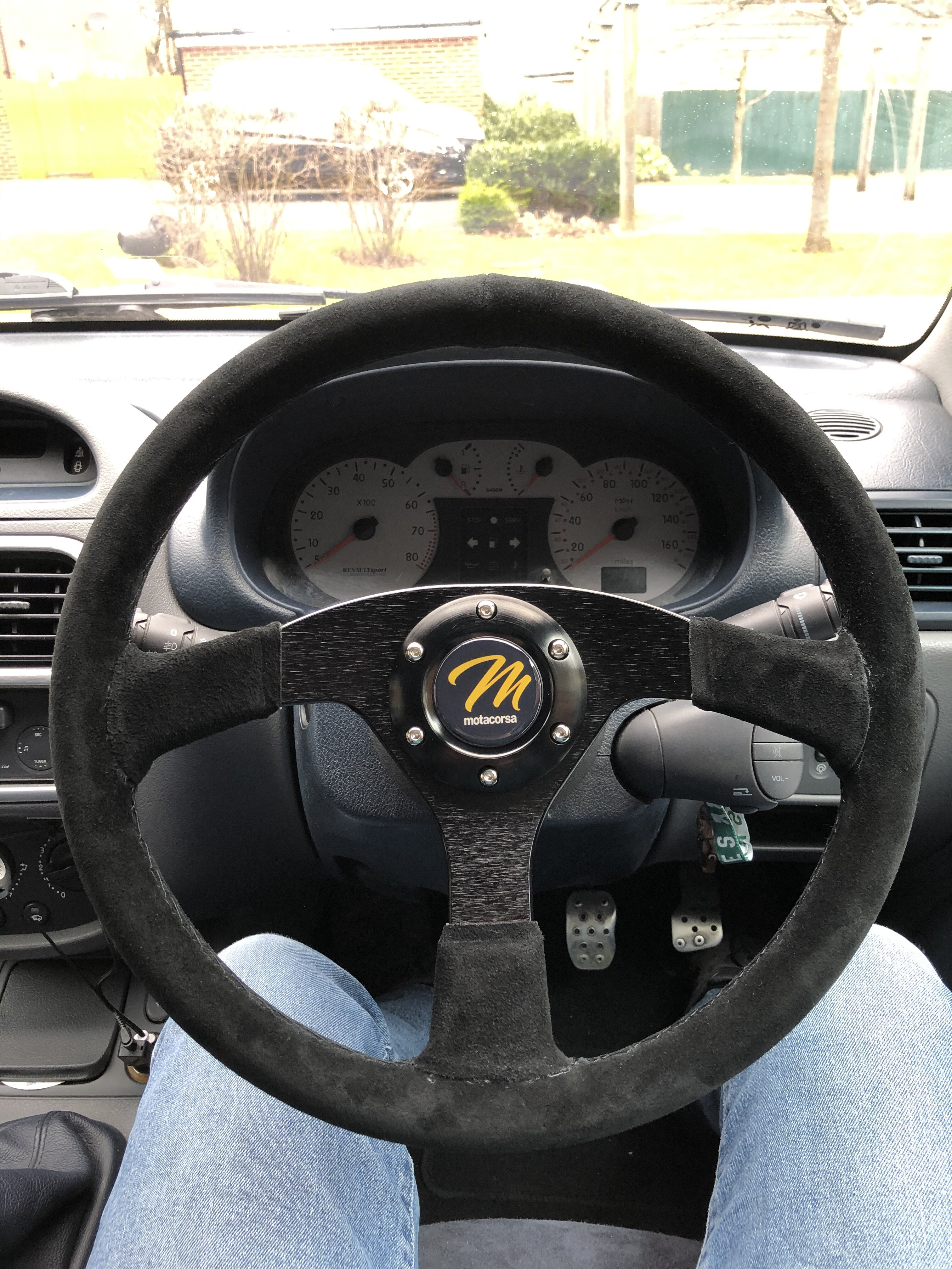

Fitted a new steering wheel. Forgot how much nicer it is without the standard wheel.
Brother has already offered to fit the new suspension, he was really keen to do it and I hadn't even asked him to help out. Will get that ordered next month and take it from there as to when we can get together to do that. Bilstein B14's and PMS top mounts and I might get a PMS strut brace.

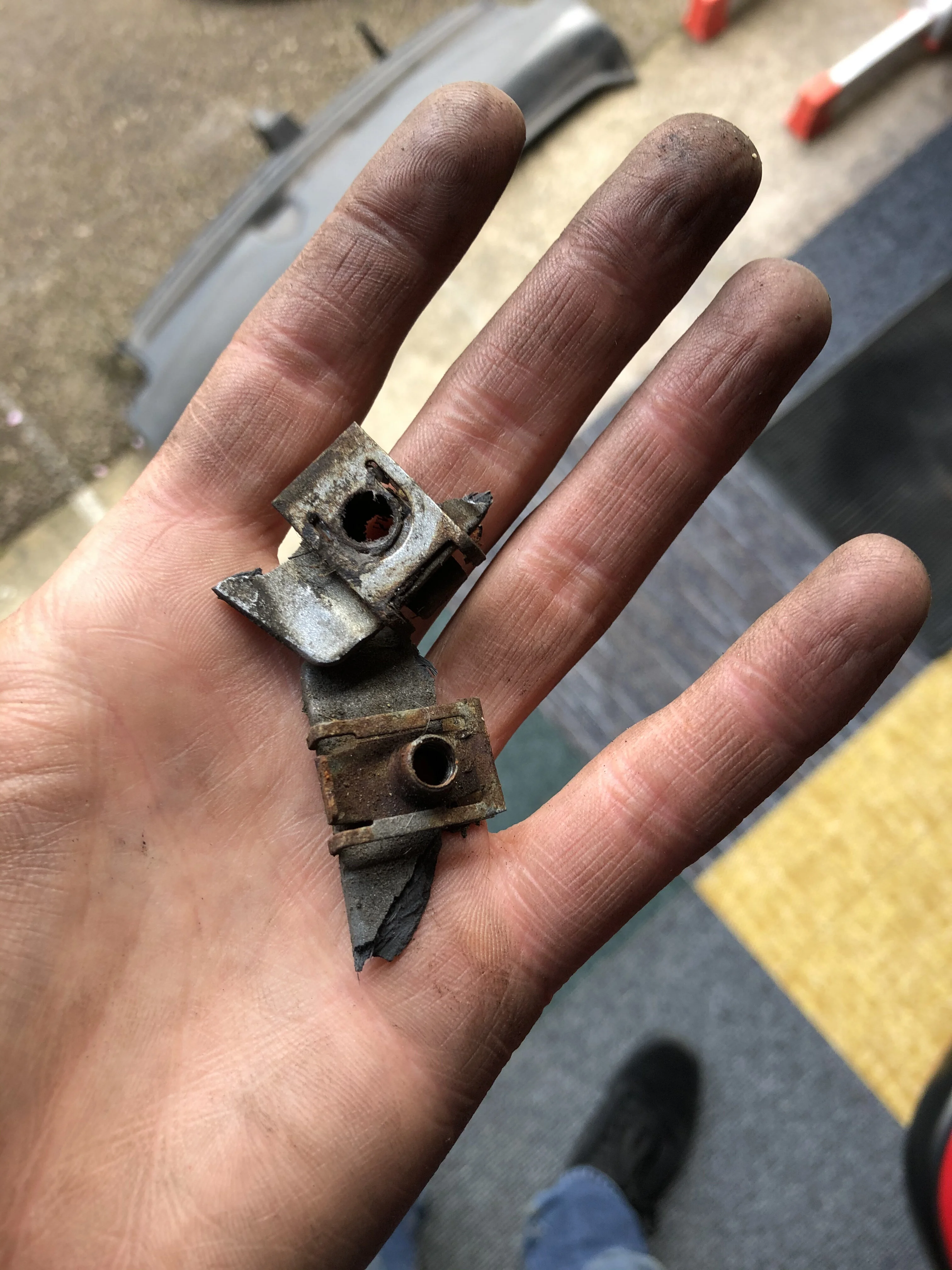

Made loads easier as I had the bumper off to fit a new grill thing as the original one was cracked. Looks better now.
However when putting the bumper back on I was struggling to get the bolts that go behind the wings in place. Had a look and couldn't find the clips...they had fallen off, along with the bits that attach them to the wings 🤦‍♂️
bumper is currently cable tied up JDM style while the quick release fittings are being ordered.

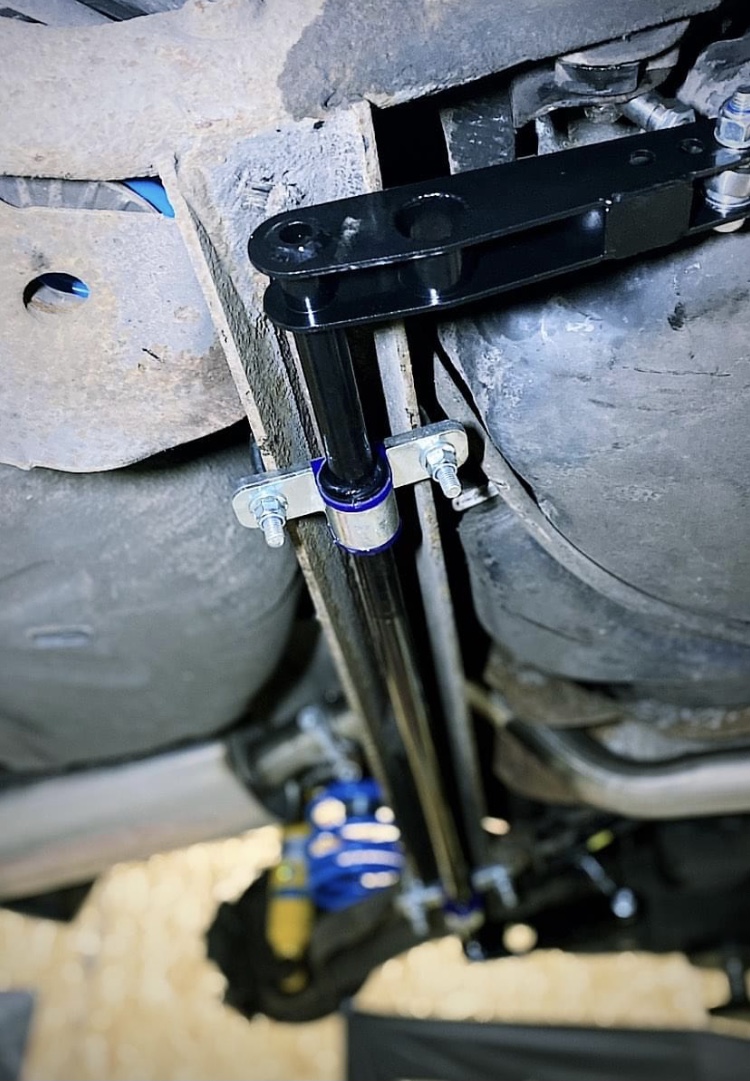

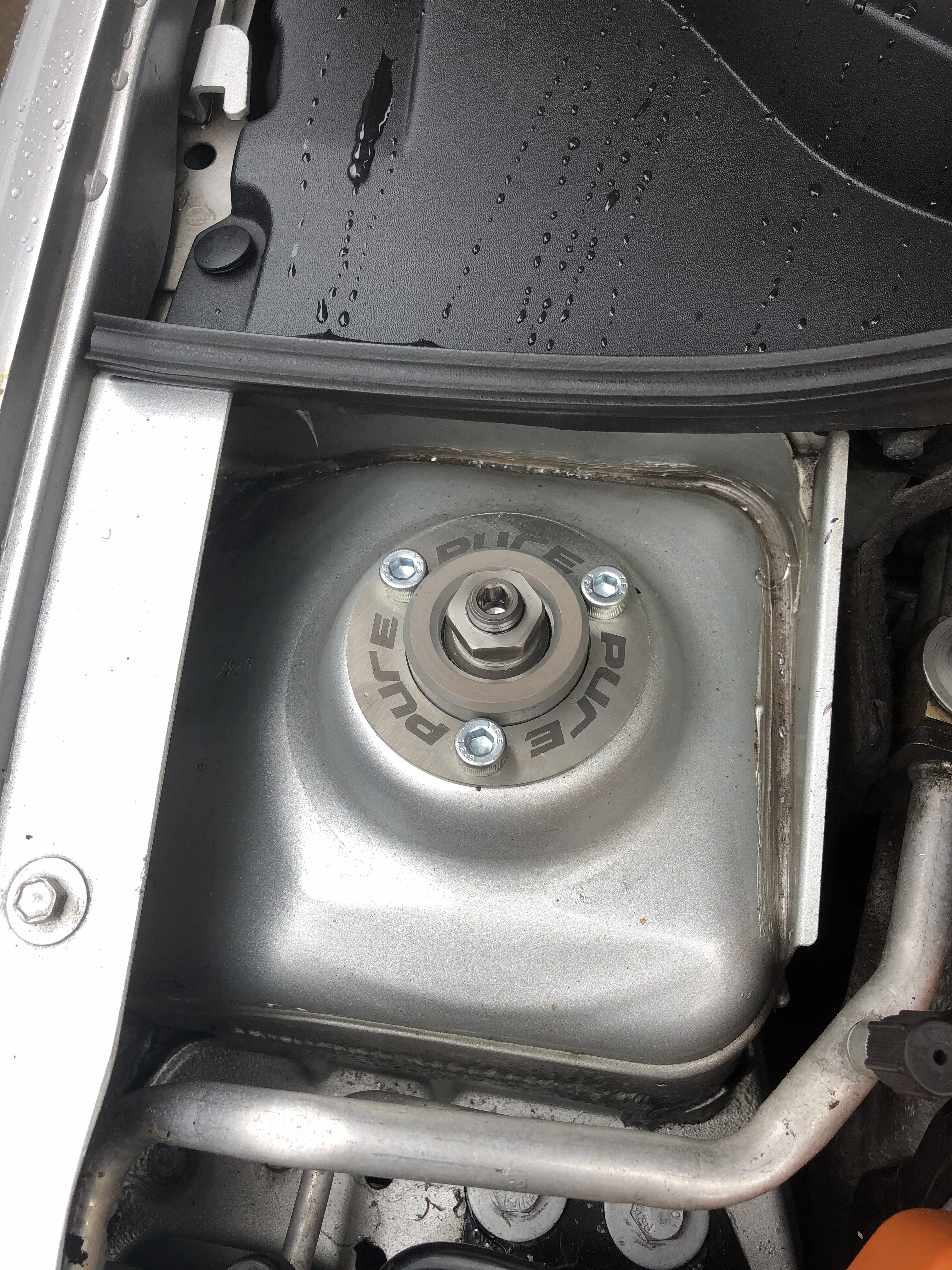

PMS top mounts and RARB have just been ordered (y) Can't wait to get the new suspension on. And as previosuly said it painted. I was thinking about that today and know that it will cost a bit of money but I am sure it will be worth it. Its pretty much suspension, front seats and body work and it is "done" (I know it will always be tinkered with so never quite done)

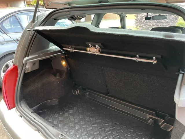

It's very over engineered for what it does, but I mainly did it as a showcase in case I need a new job. It's not perfect but will do. Like you can't make a mistake and delete an entry and I did have a model to see if mpg was going up/down but then I made the whole thing more efficient and it was expecting data before it could process and kept crashing. I just haven't found the time to fix it - mainly as I spend all day doing this for work I don't fancy sitting infront of my laptop correcting it in the evenings.

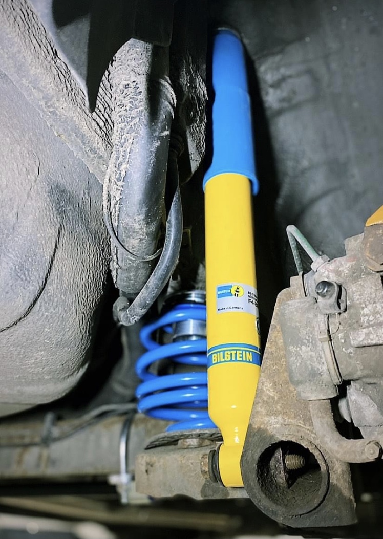

Nice little upgrade has happened.
Bilstein B14 suspension, PMS solid top mounts and rear ARB. Also had new front wish bones fitted. Then it was corner weighted and set up properly.
Now sits a lot better and less 4x4 spec ride height like it was before
Not driven it properly yet so will try and get out this weekend and see what it is like. But it is pretty much all new underneath now, will probably start swapping out the bushes for Powerflex ones.
Did sort of cheat and got it fitted at the garage. All done at Motorworks in Gloucester - they are very good and definately reccommend (they painted my E34 and some other work on that too). They were happy to fit the wishbones and PMS parts I supplied too.

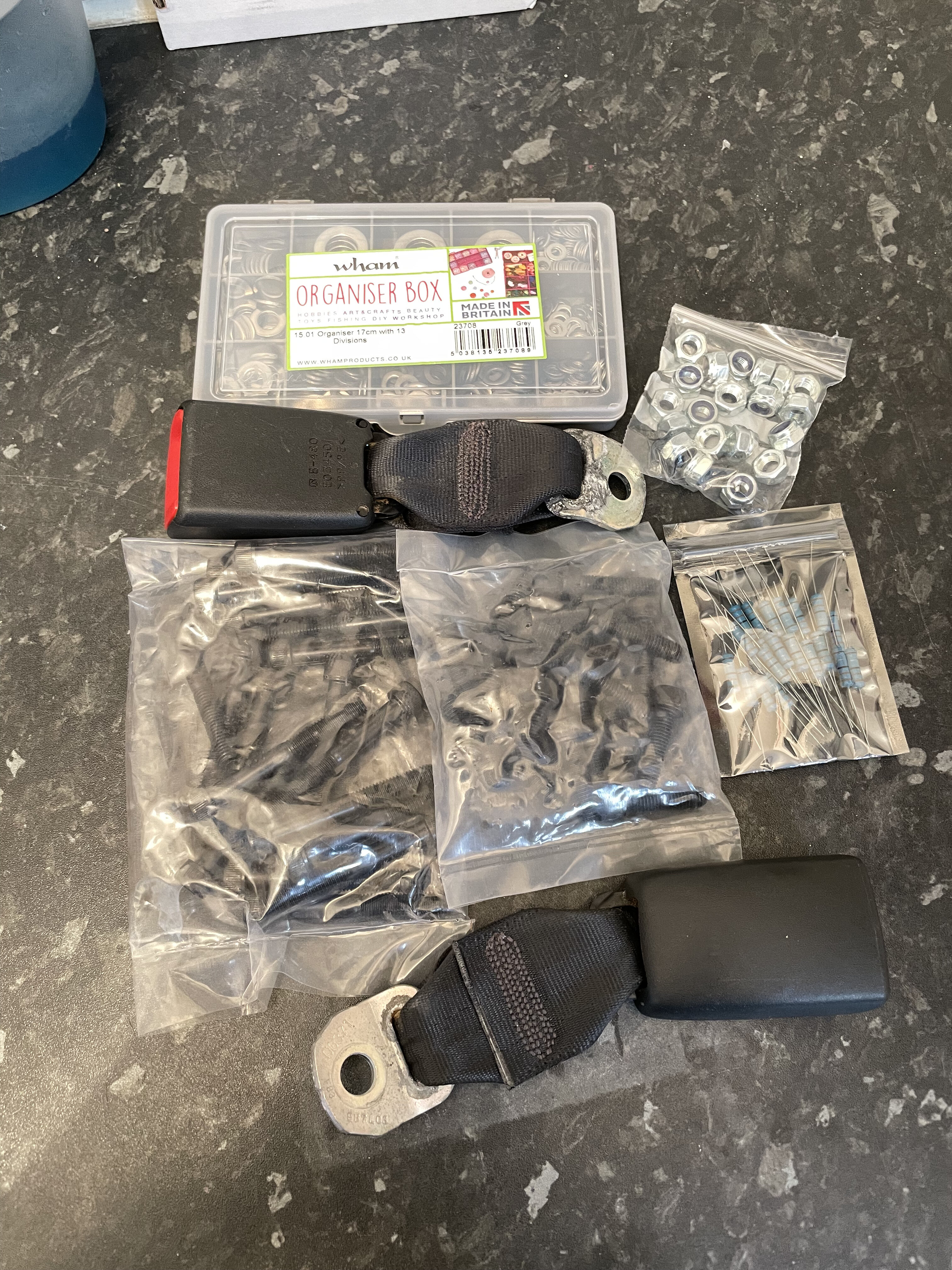

Stole the idea from my brother who has done the same in his car.
The tool kit that comes with the car I don’t think goes over the studs so need to use the deep socket and a big breaker bar is so much easier to undo wheel nuts. It’s a lot more secure than rattling about in the boot. Ideally wanted it on the side of the boot but there isn’t enough room. Have got another breaker bar and deep socket on order so I can do the same for my E34. Annoying as I have a set of the deep sockets and both cars use 17mm nuts!

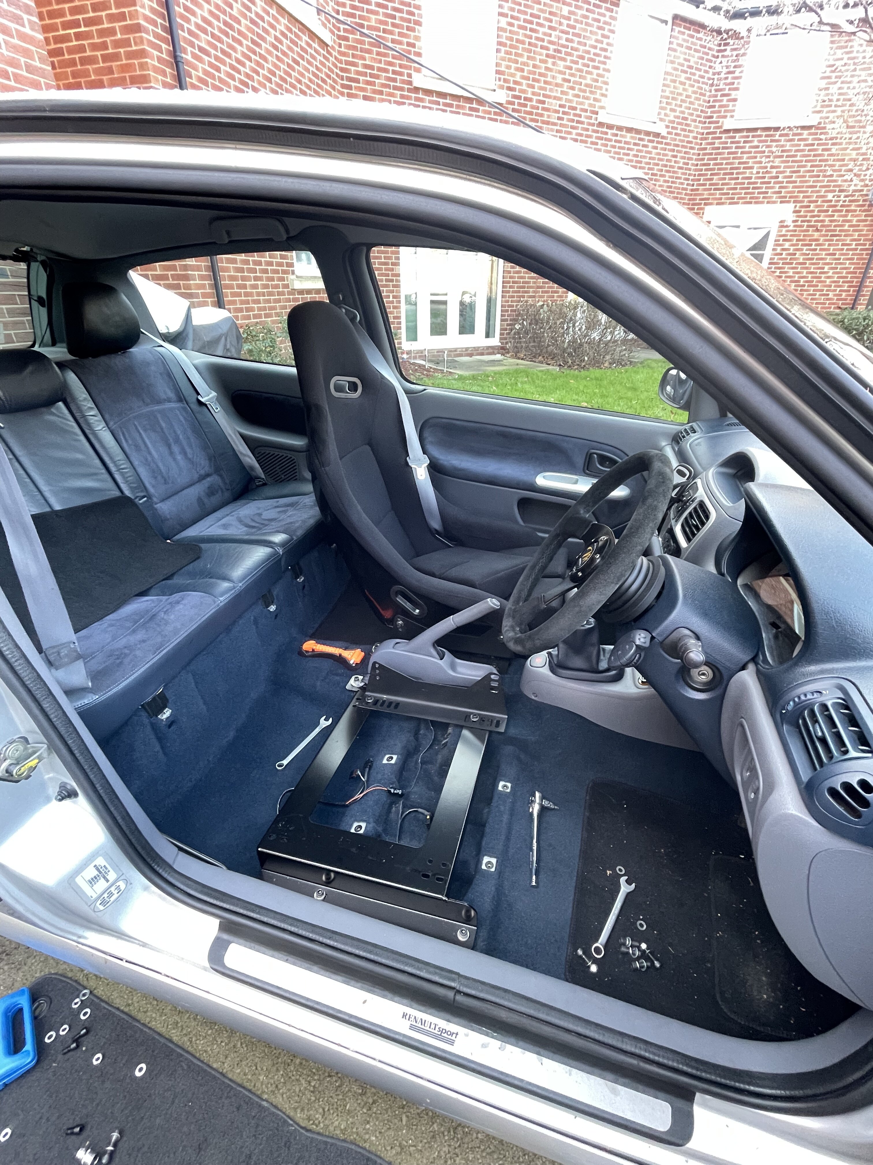

Ordered some bucket seats and sub frames yesterday. Will look at what fixings I need when they arrive, have seen on here that it’s M8x40 high tensile bolts but will double check. Just need to sort out how to run the seat belt clip as I am going to use the standard 3 point belts.
KitsonRis
Seat subframes have turned up and so have the seats
Thought I would be safe with the smaller seats being a slim 30" waste.....no, no I was not safe. I fit in them and its very cosy but it wont be comfortable for daily driving so have to get the next size up. Hope the seller doesn't mess around on eBay - I have opened up a return but want to see if they will do a swap when the replacement gets dropped off to take these back at the same time and it doesn't look like the return form will allow this so just waiting to hear back from them.
KitsonRis
Seats have been returned, just waiting for them to be delivered so a replacement larger set can be sent out.

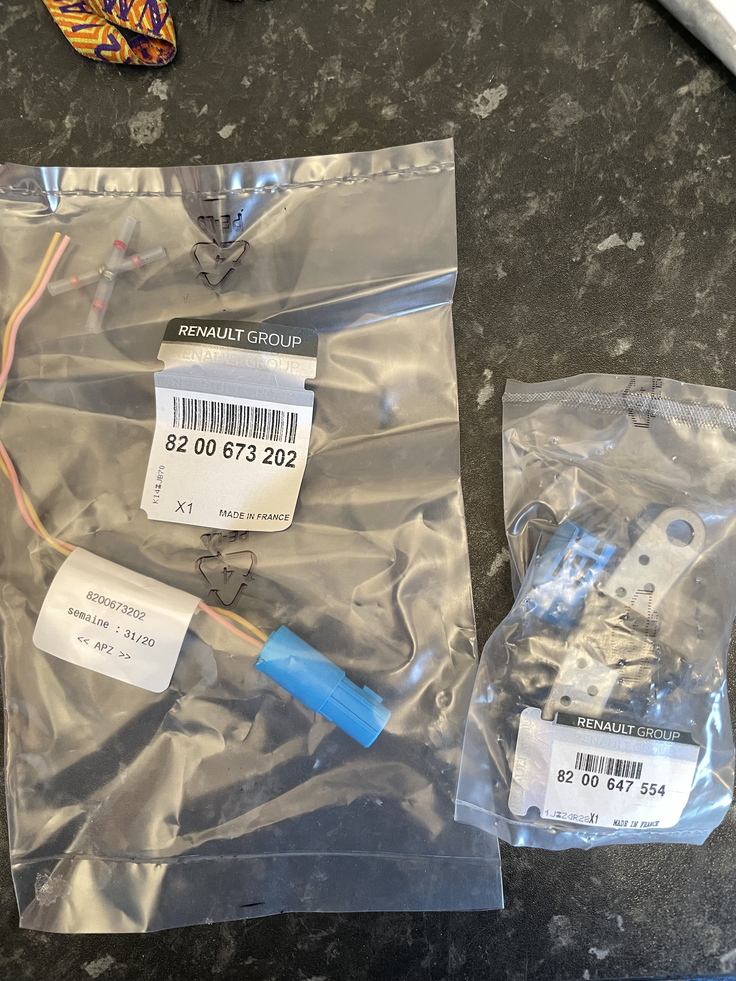

Did loads of searching on here about what was needed. Got the right resistors (good job I checked as the one type apparently don't work and I was about to buy them). Bought an assortment of washers as they will come in handy in the future. High tensile nuts and bolts.
Might wait until after the MoT test to fit them just in case. I did see on here to use Citroen C3 rear buckle clips, although they work but it is a bit fiddly to get them clipped in. This has made me think about getting harnesses now...for a daily car....which gets me onto the things I have been looking at on eBay - Volvo V70/S40/S60, MG ZT, Saab 95's, those kind of things to use every day.

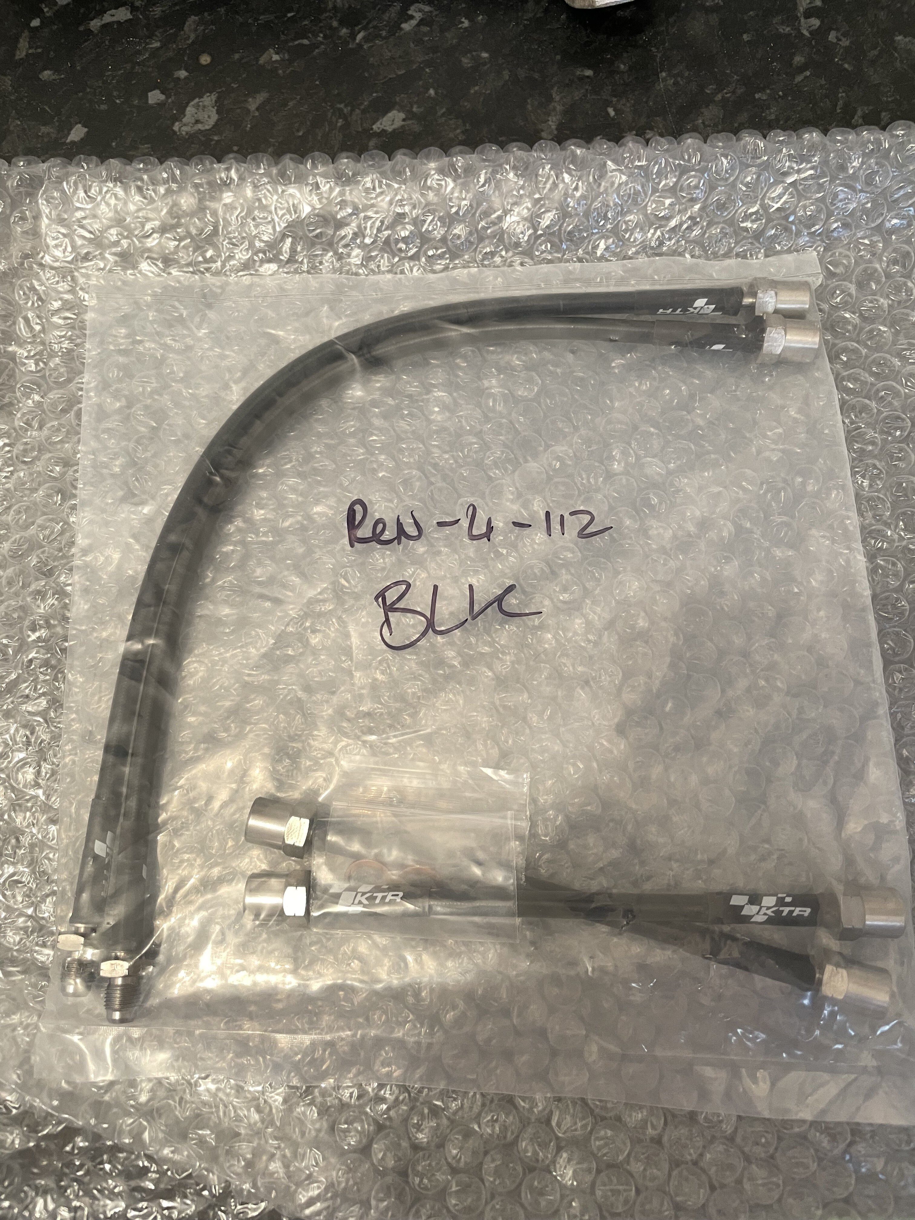

Braided brake lines are on order and the fluid turned up this week. That will be done this month. Also need to get the seats fitted this month too - my brother does know he is helping but need to gently remind him and get a day sorted with him.

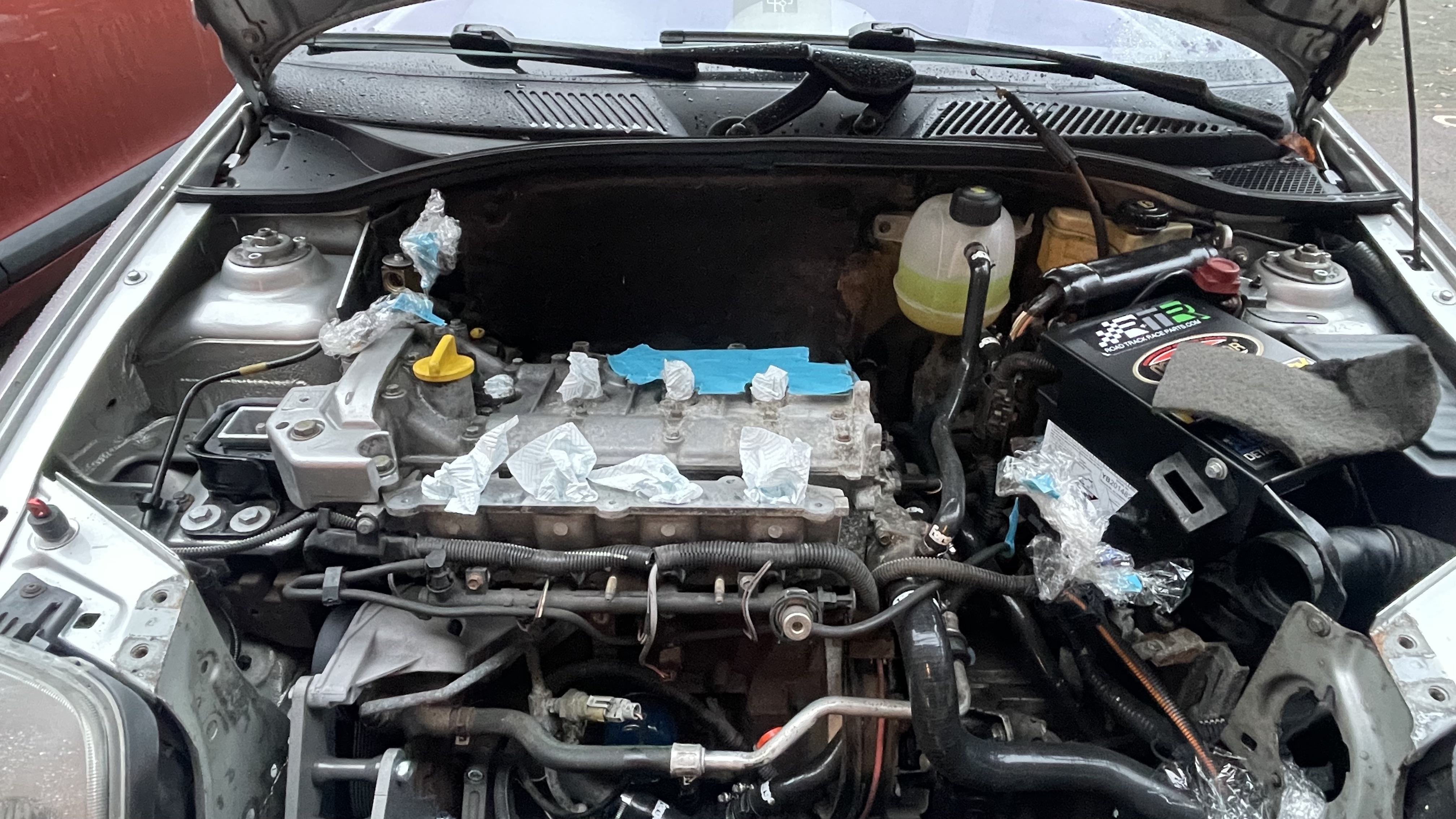

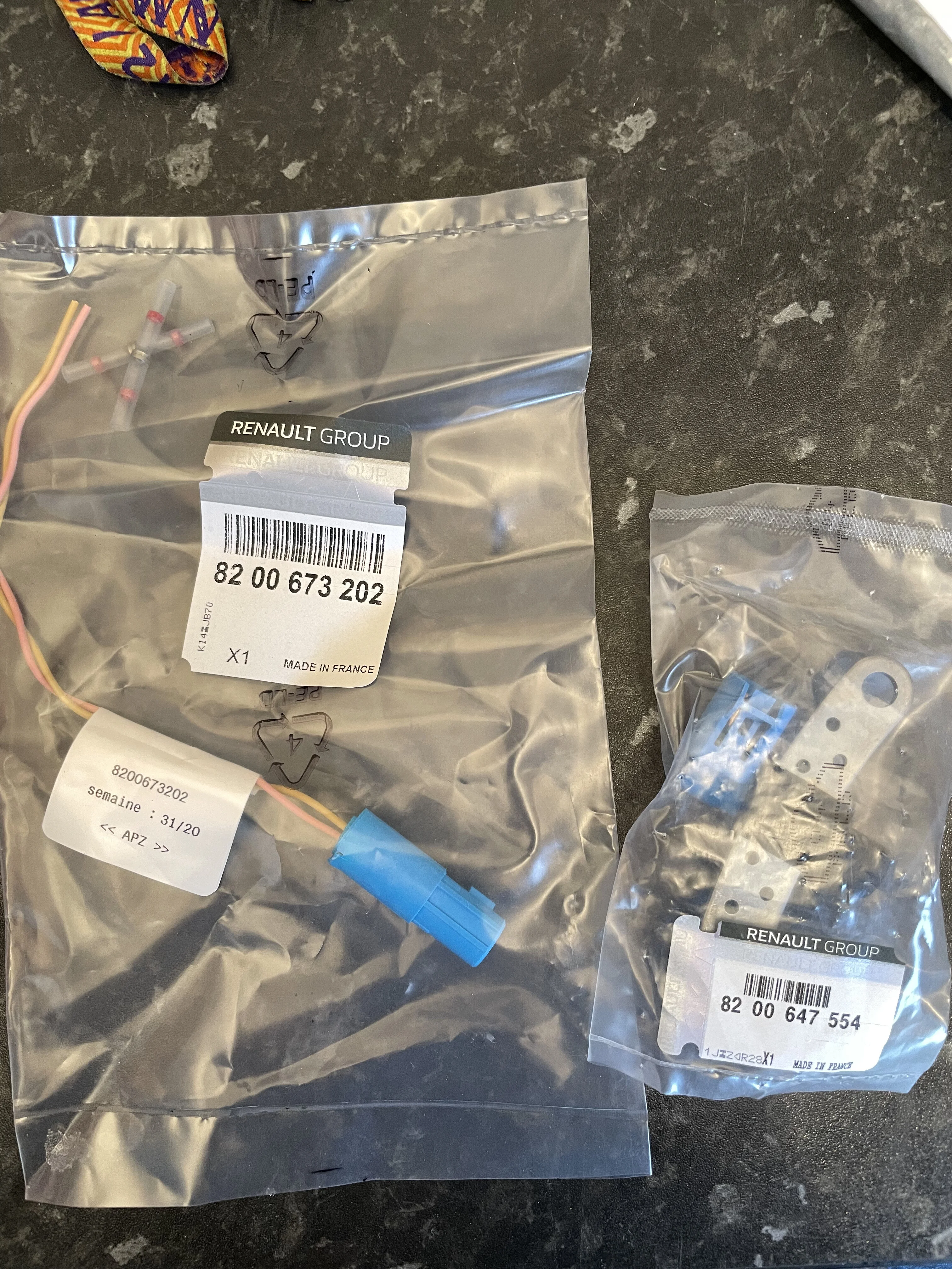

Also had the standard wont start but cranks fine issue. Pretty certain it was the crank sensor. Had to get the AA out (twice in a week) for it and when they turned up it started first time :rolleyes: although cannot fault their service and arrived within 30 mins. Got one and fitted a new one and fitted it. Works a charm
Cheated a bit and went to The Motorwoks to get some work done as I didn't have time or space to do it. Fantasic service as usual and hihgly reccomend. Braided brake lines and RBF600 fluid were also fitted

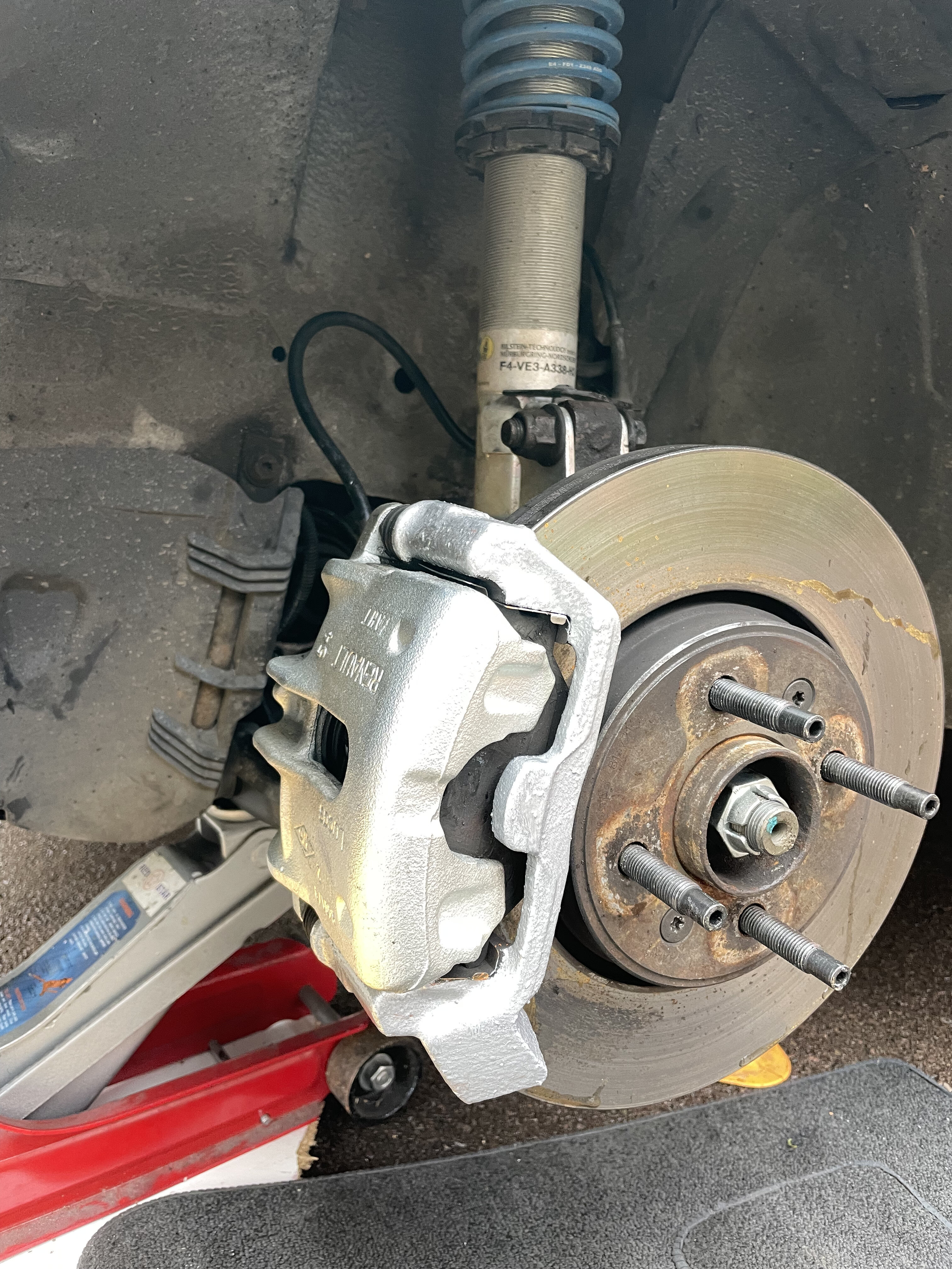

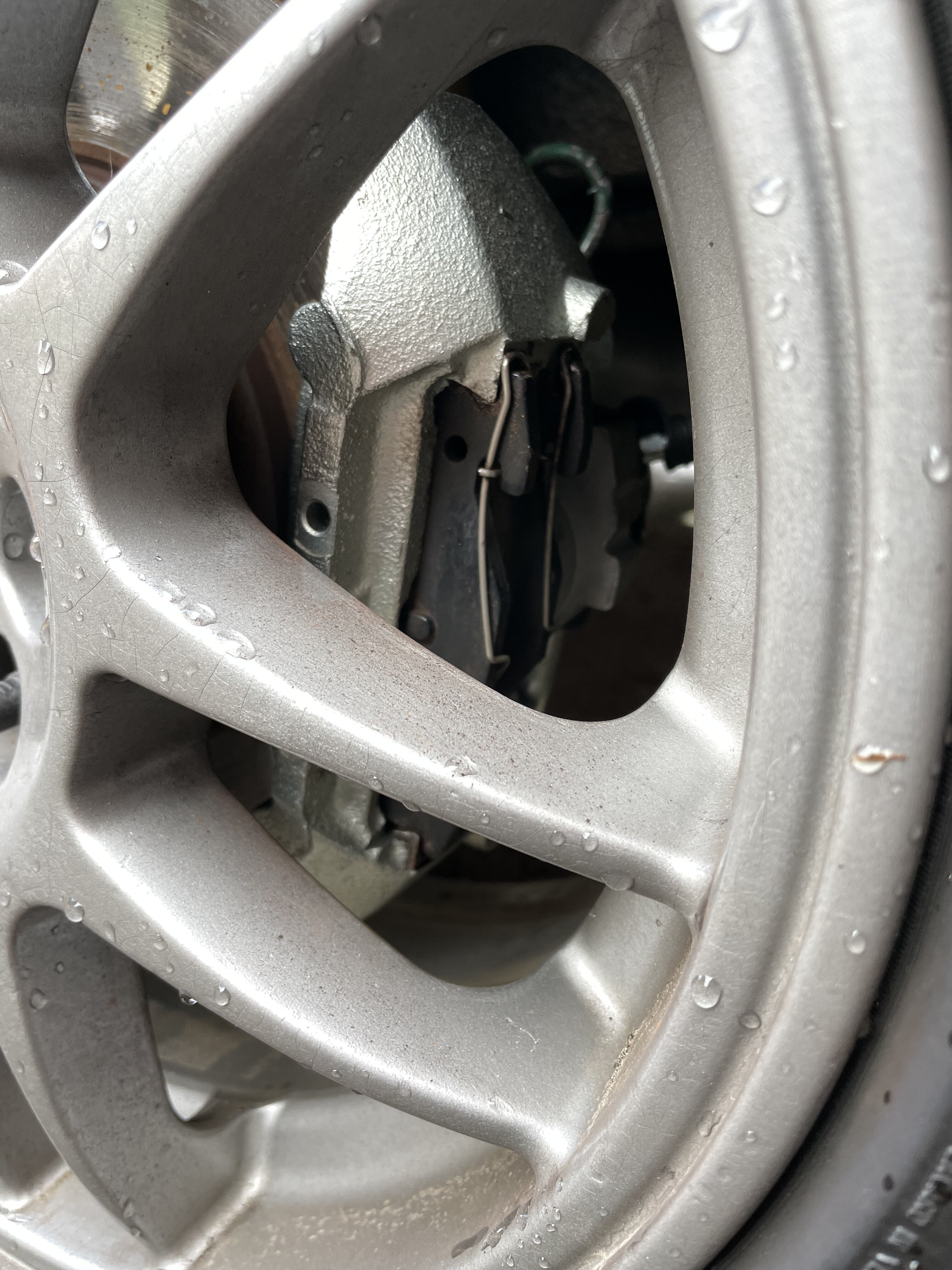

Had a nightmare fitting them and a bleed nipple in one front and rear calliper sheered off. Great. The option was to either try and get the broken nipples out and potentially mess it up and then have to pay for new callipers and the time taken to mess them up. Or basically a fixed fee for new callipers as they would fit first time. So.....
Man maths prevailed and I have four new callipers! Also de-oranged the brackets too and going back to a more OEM colour scheme.

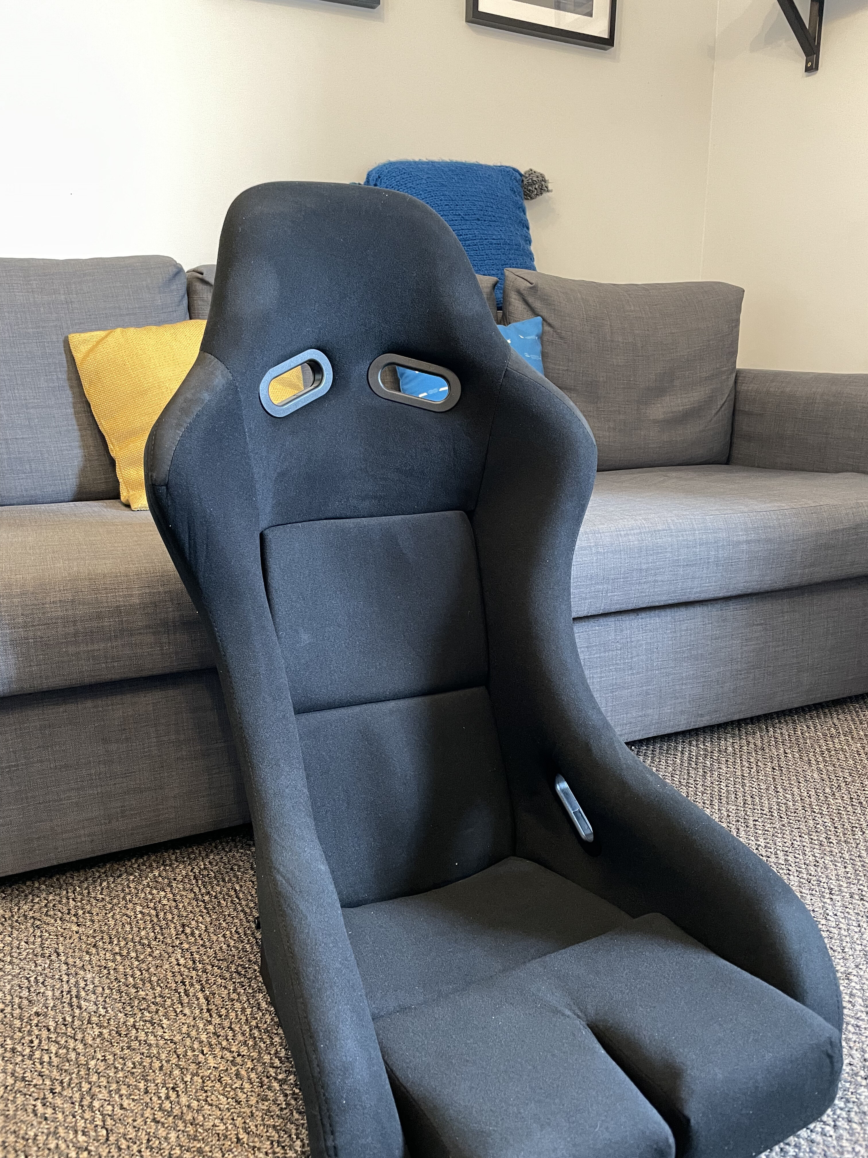

Bucket seats now fitted
Had to do a minor adjustment on positioning on them this morning and now so much better. Might sack off the rails though, not sure yet. One thing I need to sort out is the seat belt light on the dash in the centre console. My old Ph1 didn't have this issue but not sure if the bulb was removed of done properly with a resistor. All the connectors have got the correct resistors in and the air bag light is off and behaves as it should so not sure if the seat belt light is a different system?

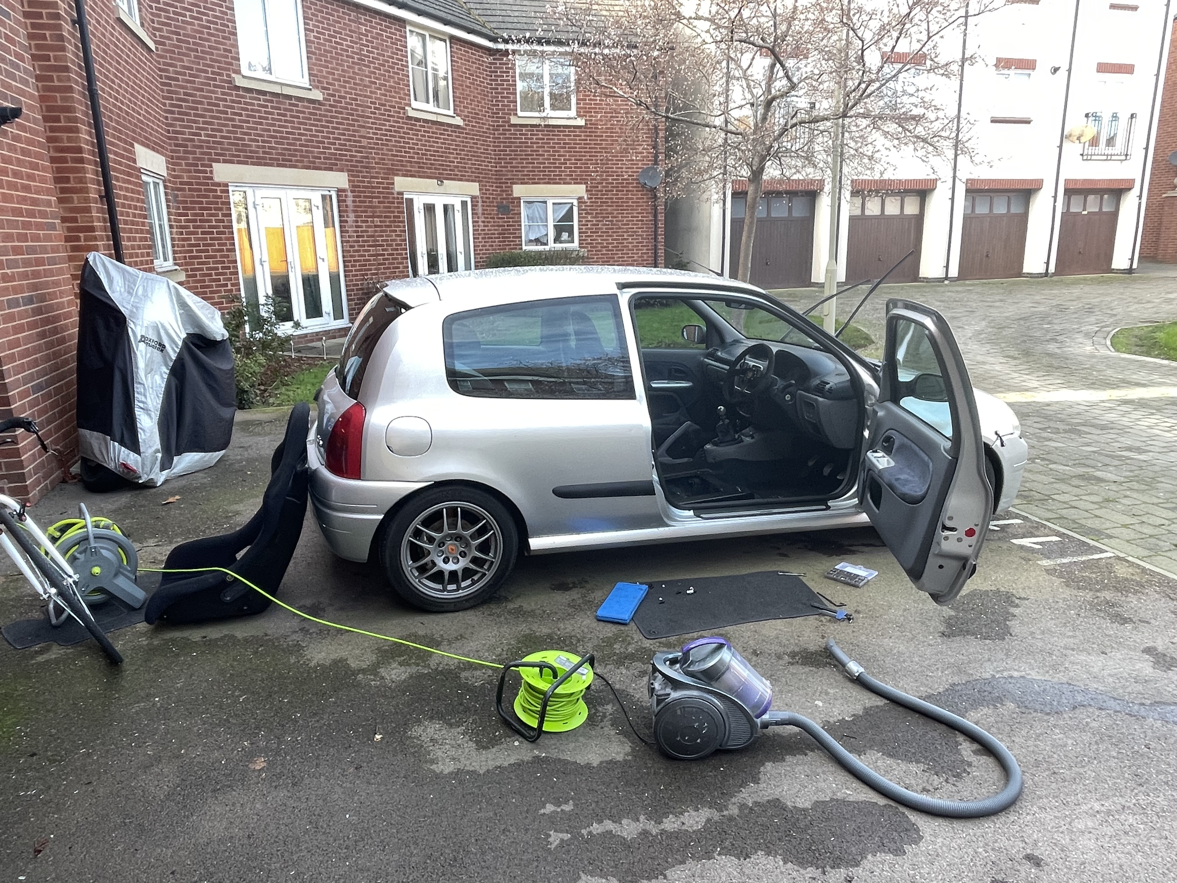

Been a while since I have had any time on this. After using it a bit I decided I wanted to drop the height of the seats more so took off the runners. Now they are fixed in one position. Now they are in a really nice position and a lot more comfortable. Also gave the interior a good vacuum while I had the opportunity as the seats were out.
Was very lucky today as I noone parked next to me so it made it really easy as could have the doors open.
And yes the rear seats are basically usless as you can't get in the back, but I kind of like it in a way. I don't want a sully stripped car.

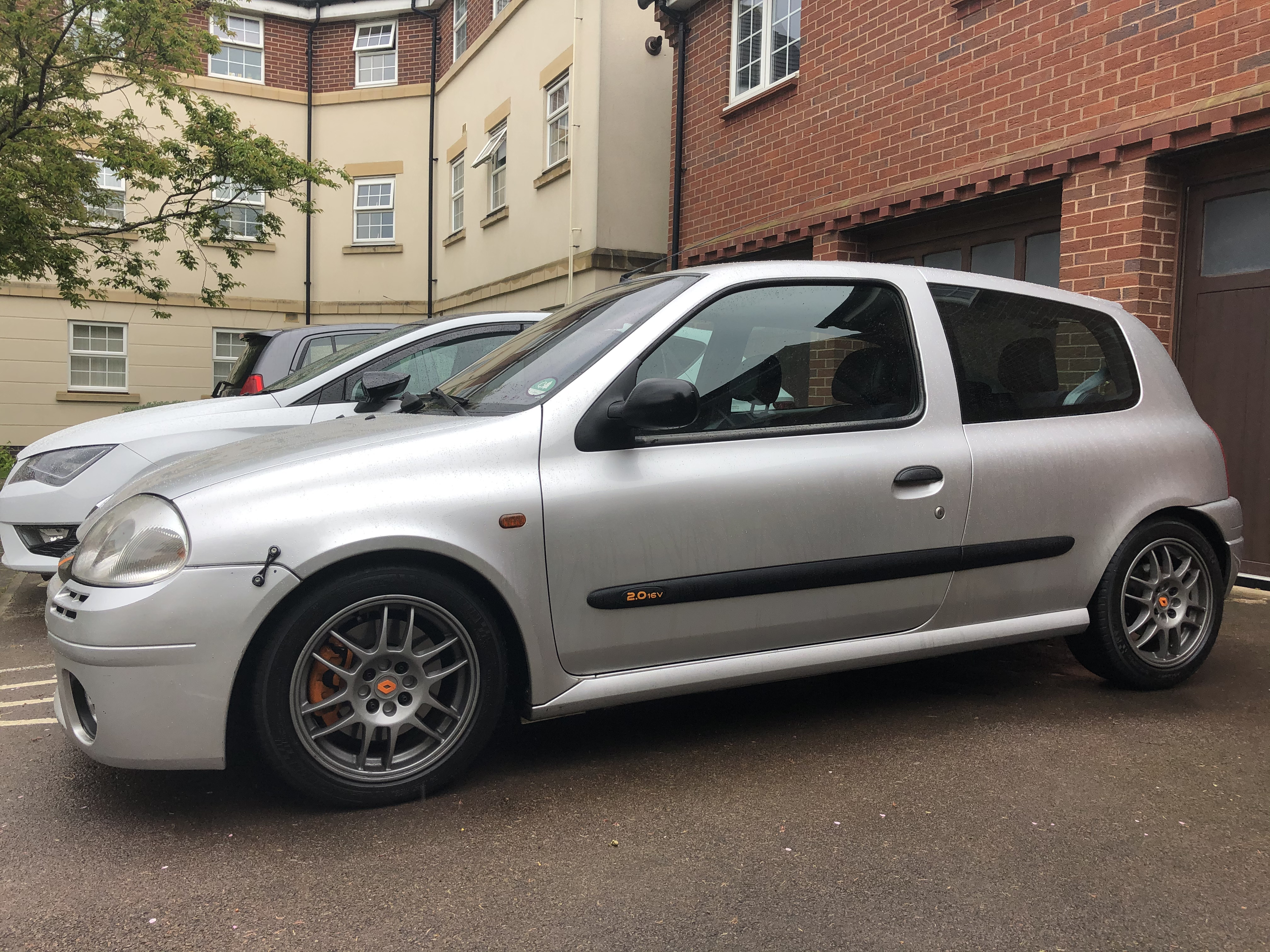

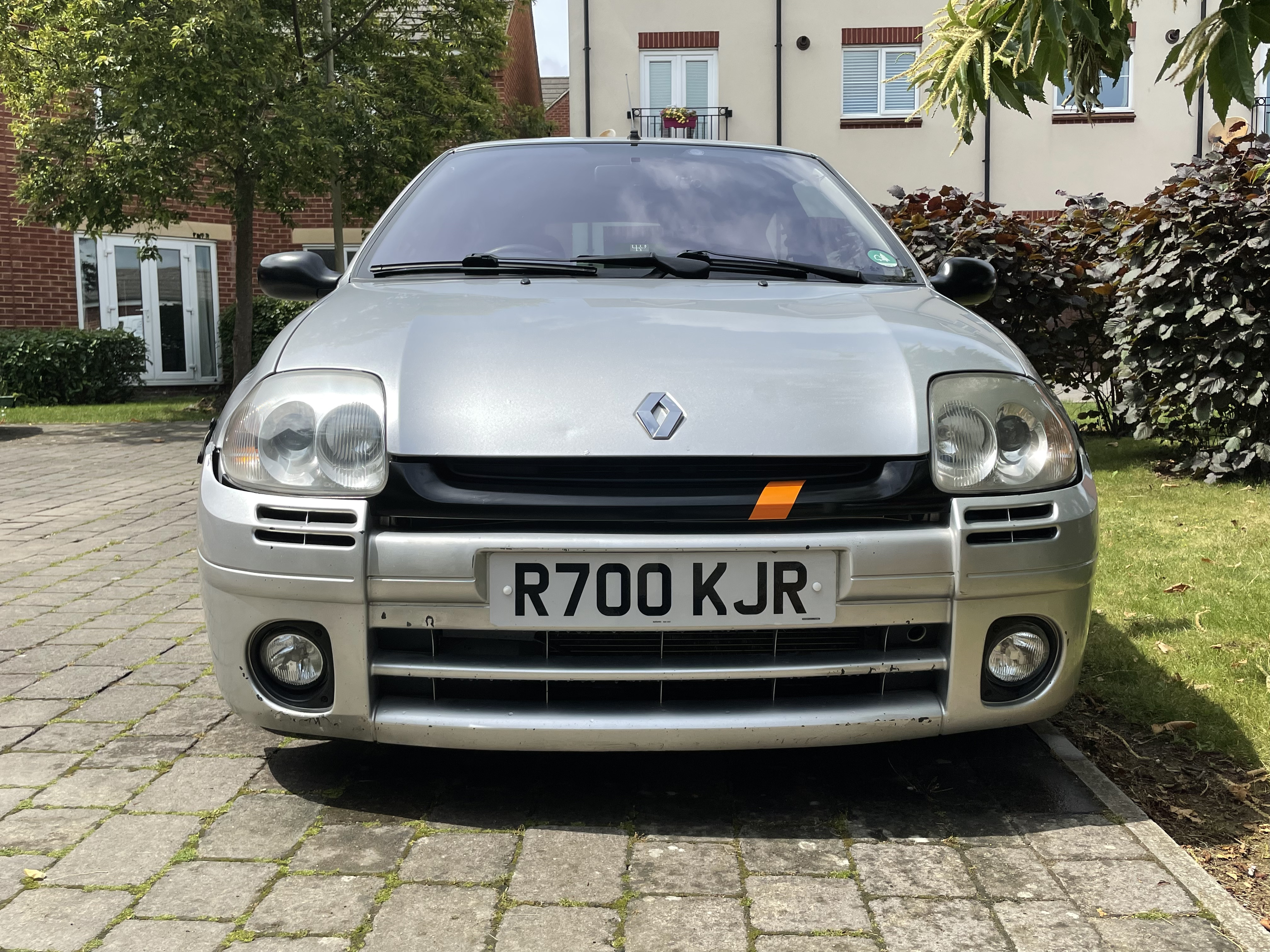

So a a bit has happened with my Ph1 over the past 11 months since the last update!

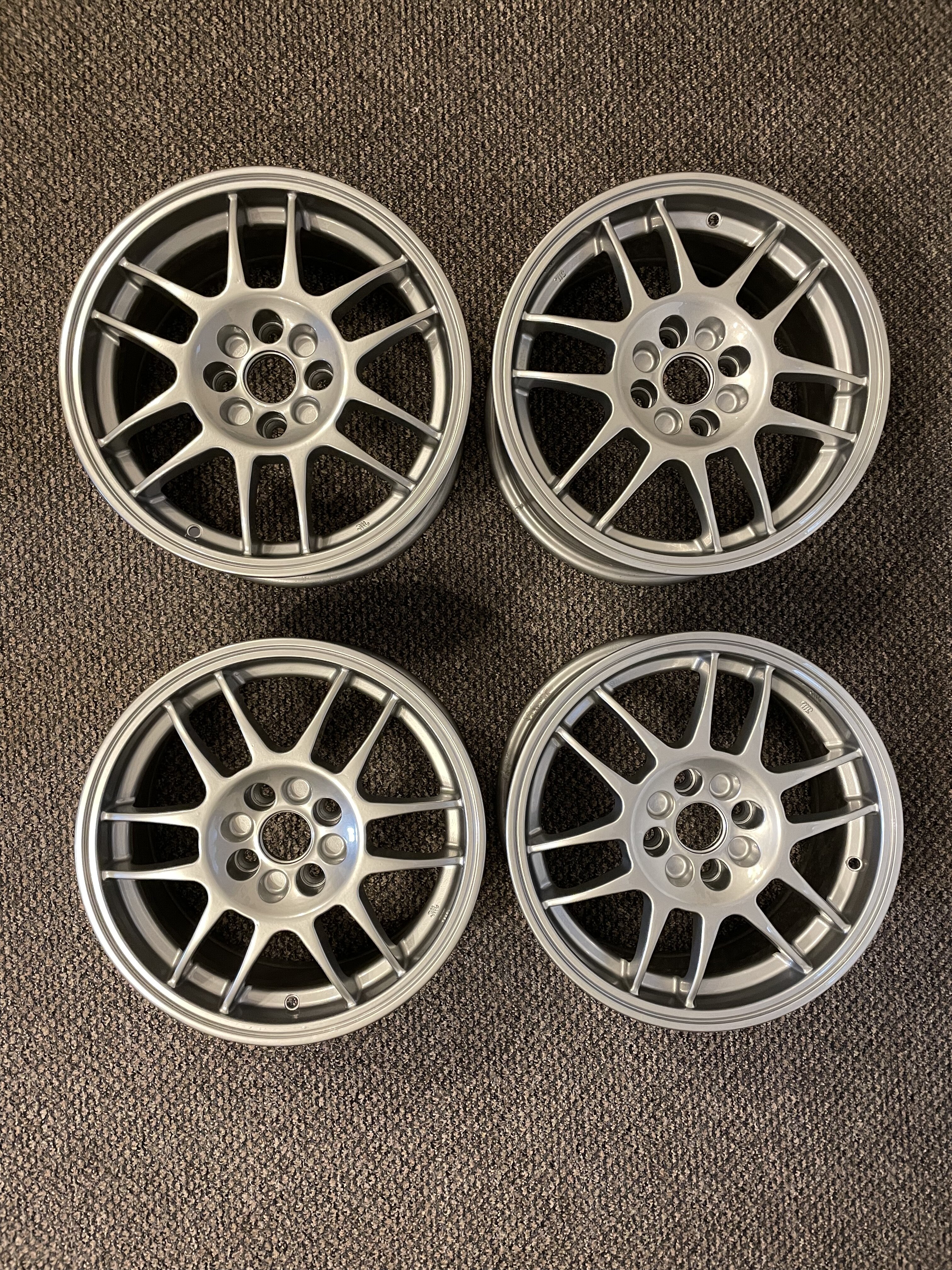

Got the OZ F1's refurbed and coated them in Gyeon Q2 Rim ceramic coating. Used this before and it is a really good coating and copes with brake dust and high temps well. Put some Nankang NS2R's on them, very good I thought ont he tracks days I have done with them. Couldn't justify the Nankang AR1's....yet.

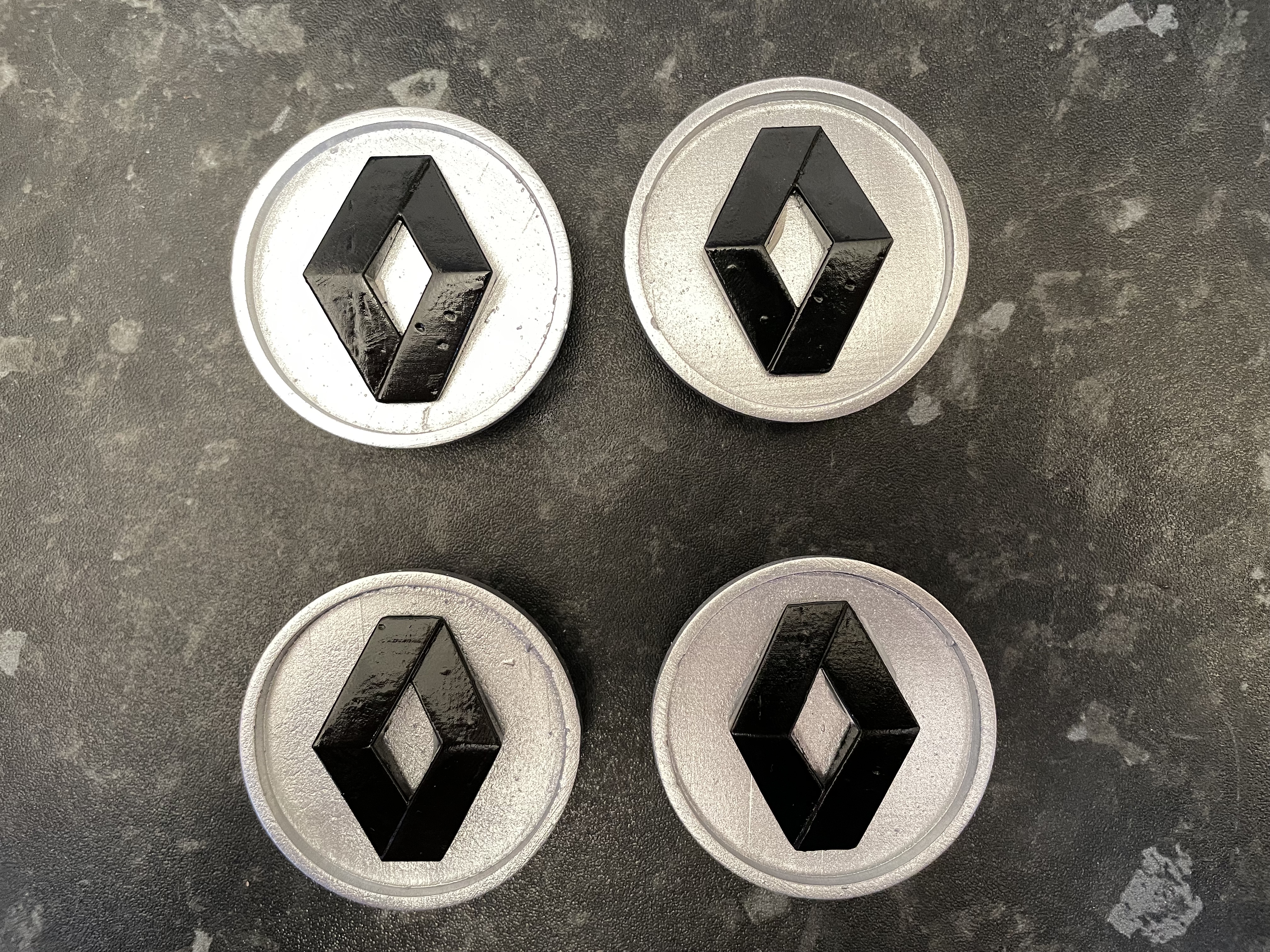

Bought some 3D printed centre caps and they were painted in the wheel colour with black diamonds
But I lost one and couldn't get a colour match so I ended up painting them black.

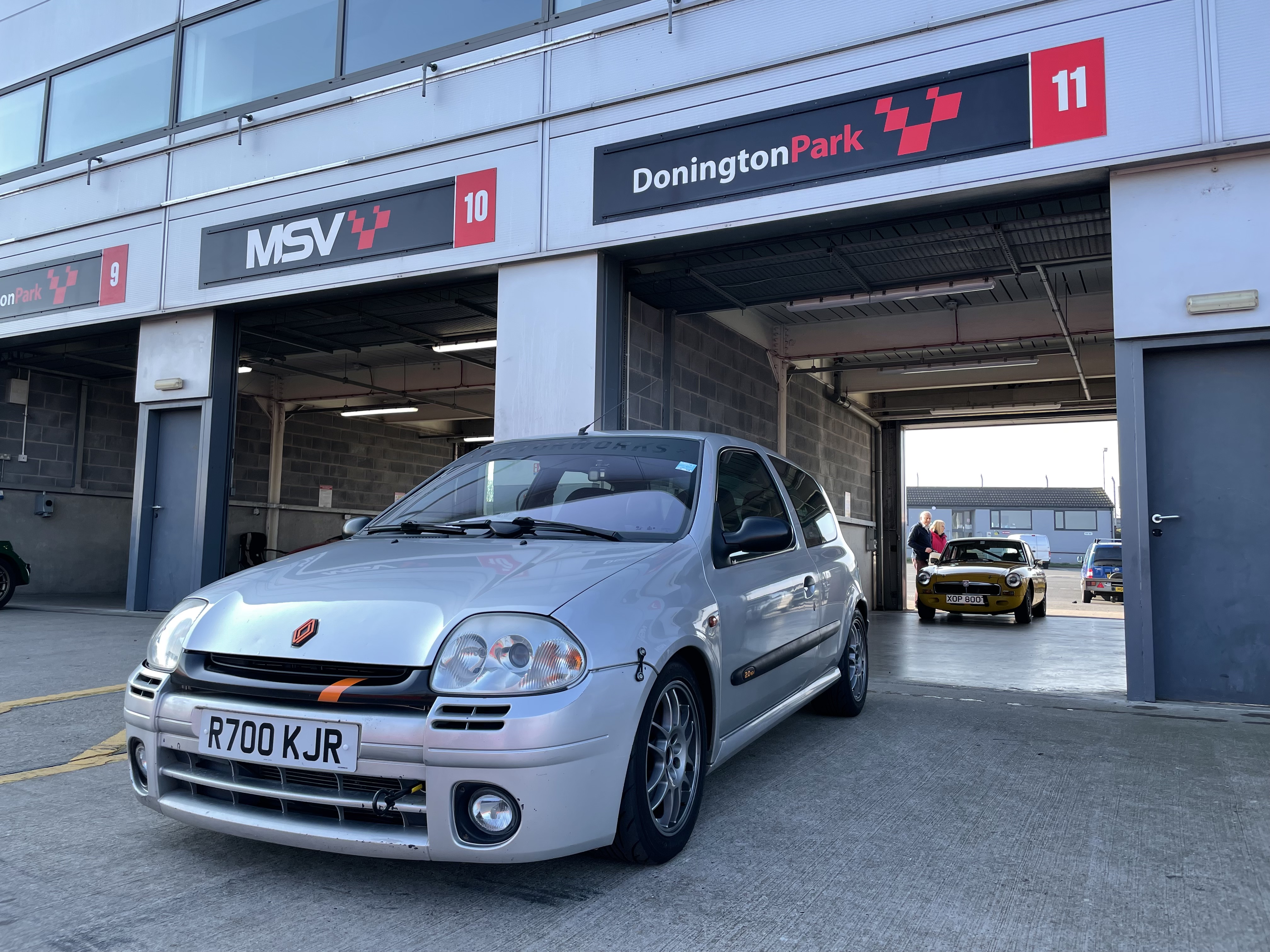

Did a track day at Donnington Park
This was great fun! First track day in about 5 years. Car was amazing, really enjoyed it. I thought it would be down on power and struggle at Donnington but held it's own really well, just my driving let me down!

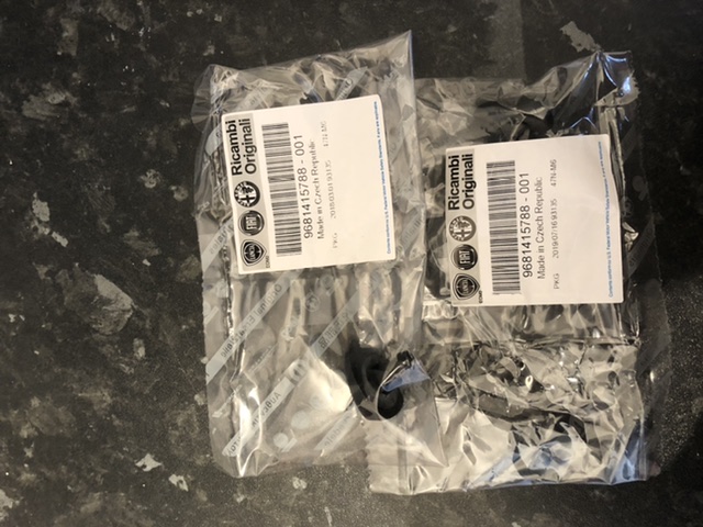

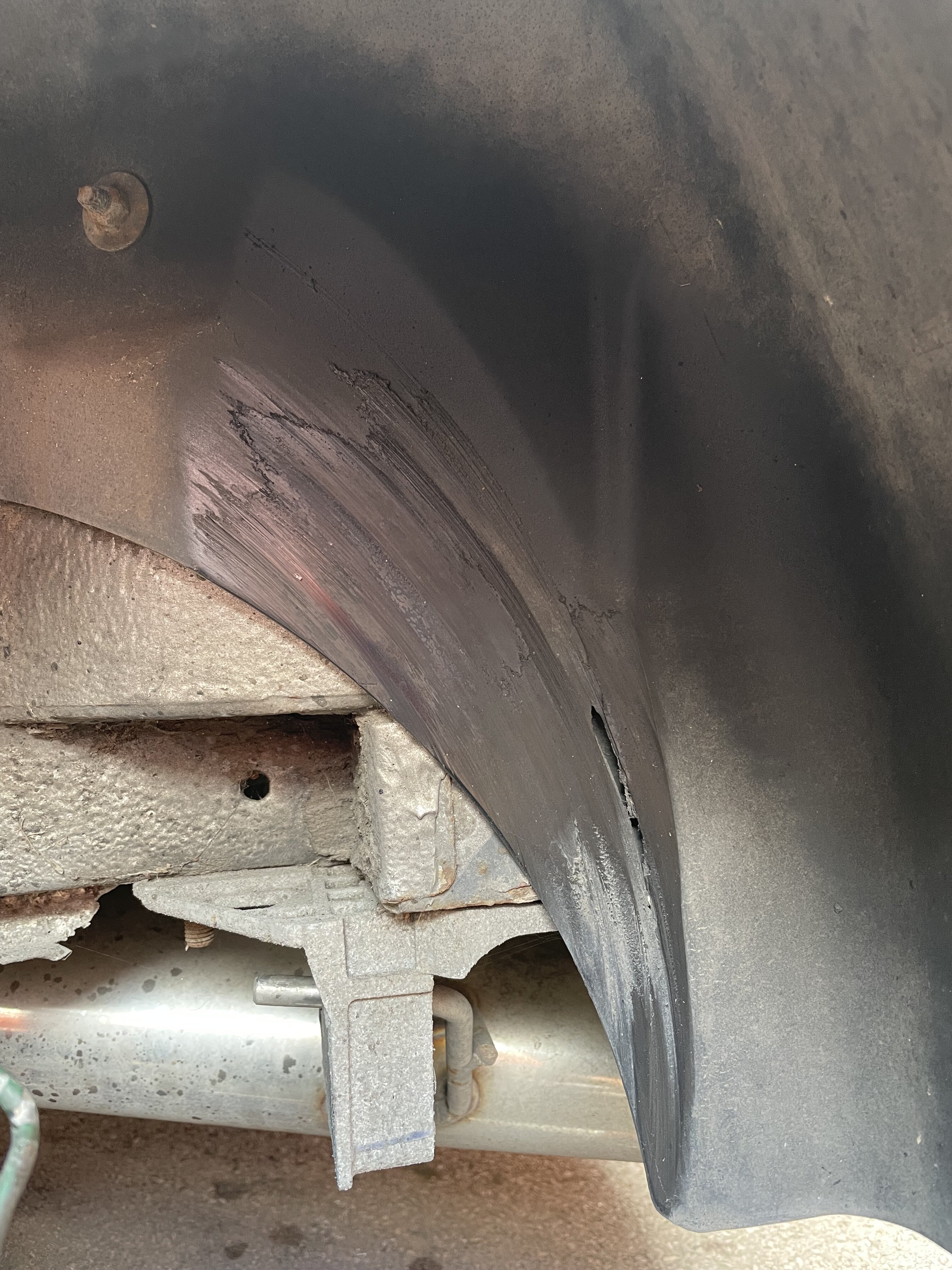

The only thing that has gone wrong on it was the near side rear ABS sensor has worn through which has been a mission to find!
When I was in the rear wheel arch I noticed the rear wheel had been rubbing the arch liner. My guess was from the track day, as Llandow is quite harsh on the left wheels being a tight right hand circuit. The tyre wall looks ok and not too damaged.

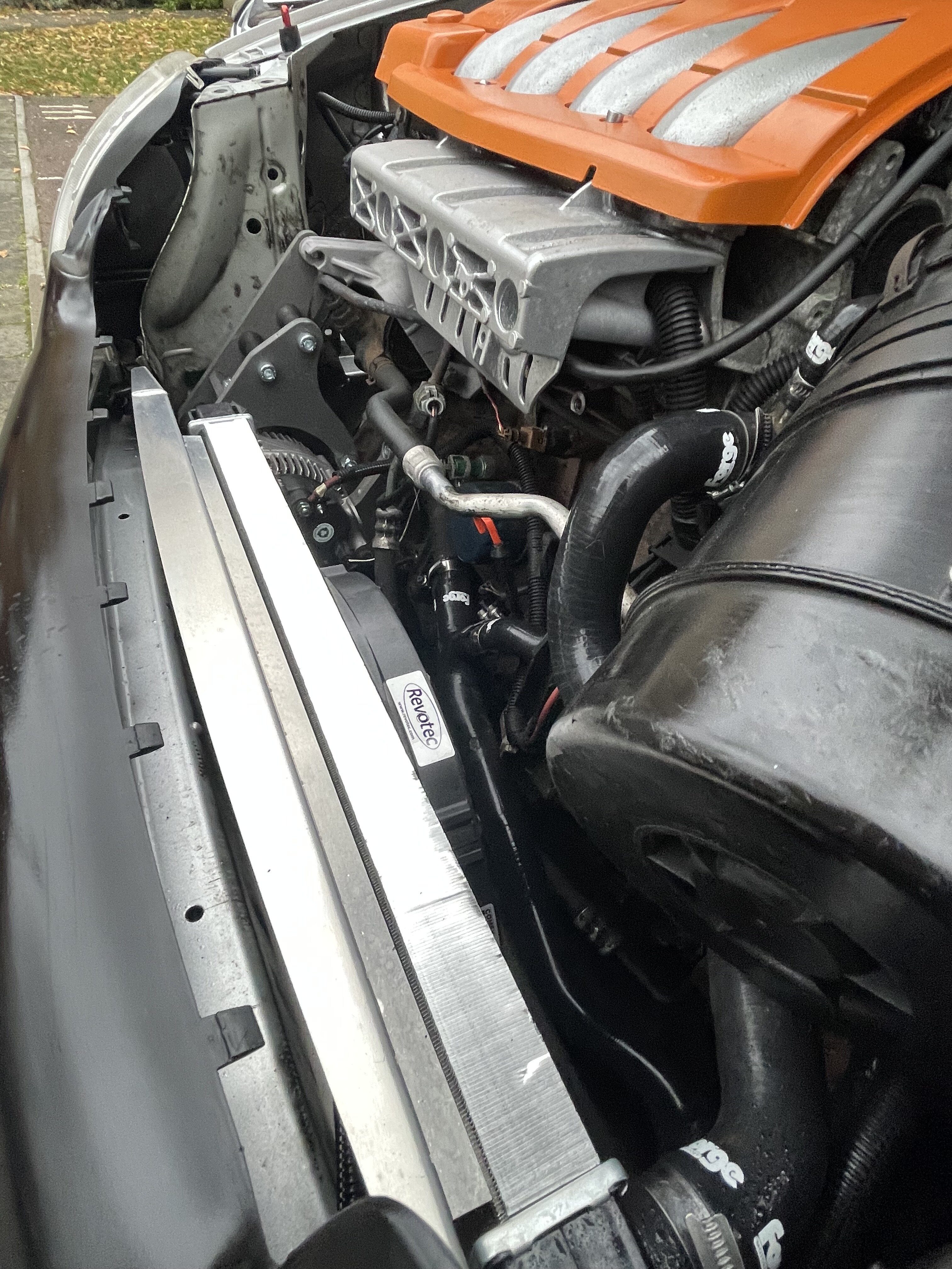

Had some recent work done to remove the air con, new radiator and silicone hoses

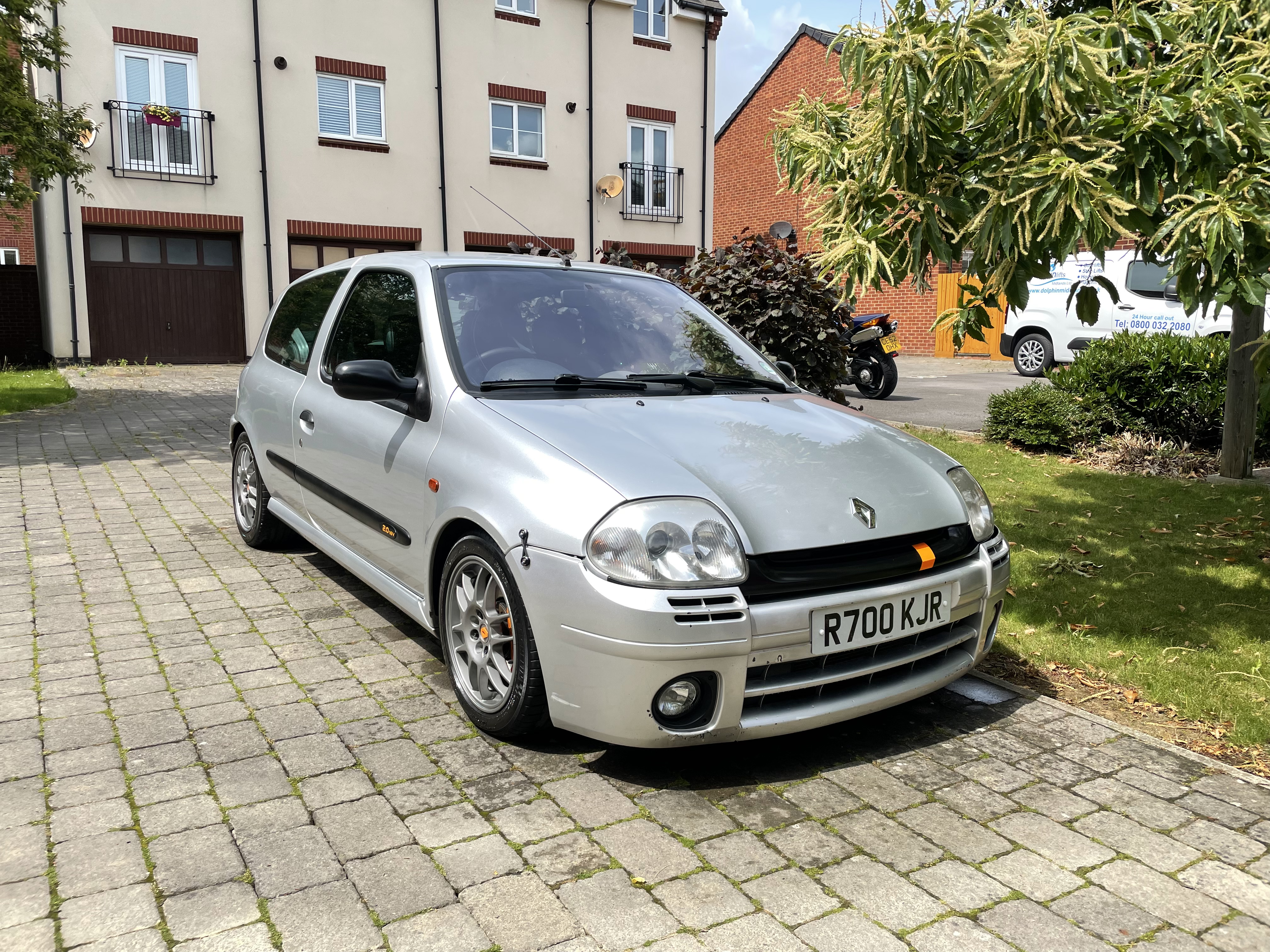

Current spec of the car is:
  • 2000 Ph1 172 with 130k miles
  • Has had belts and dephaser done in the past two years (less than 5k miles)
  • New spark plugs, coil pack and Magnecore HT leads
  • New brakes all around - discs, pads, callipers
  • Braided brake lines
  • New wishbones, ball joints and track rod ends
  • Powerflex steering rack bushes
  • Powerflex dog bone mount
  • Aluminium bonnet
  • Bilstein coil overs
  • PMS rear anti roll bar
  • PMS solid top mounts
  • Custom made exhaust
  • Bucket seats in the front, still got the rear seats in
  • PMS air con delete kit

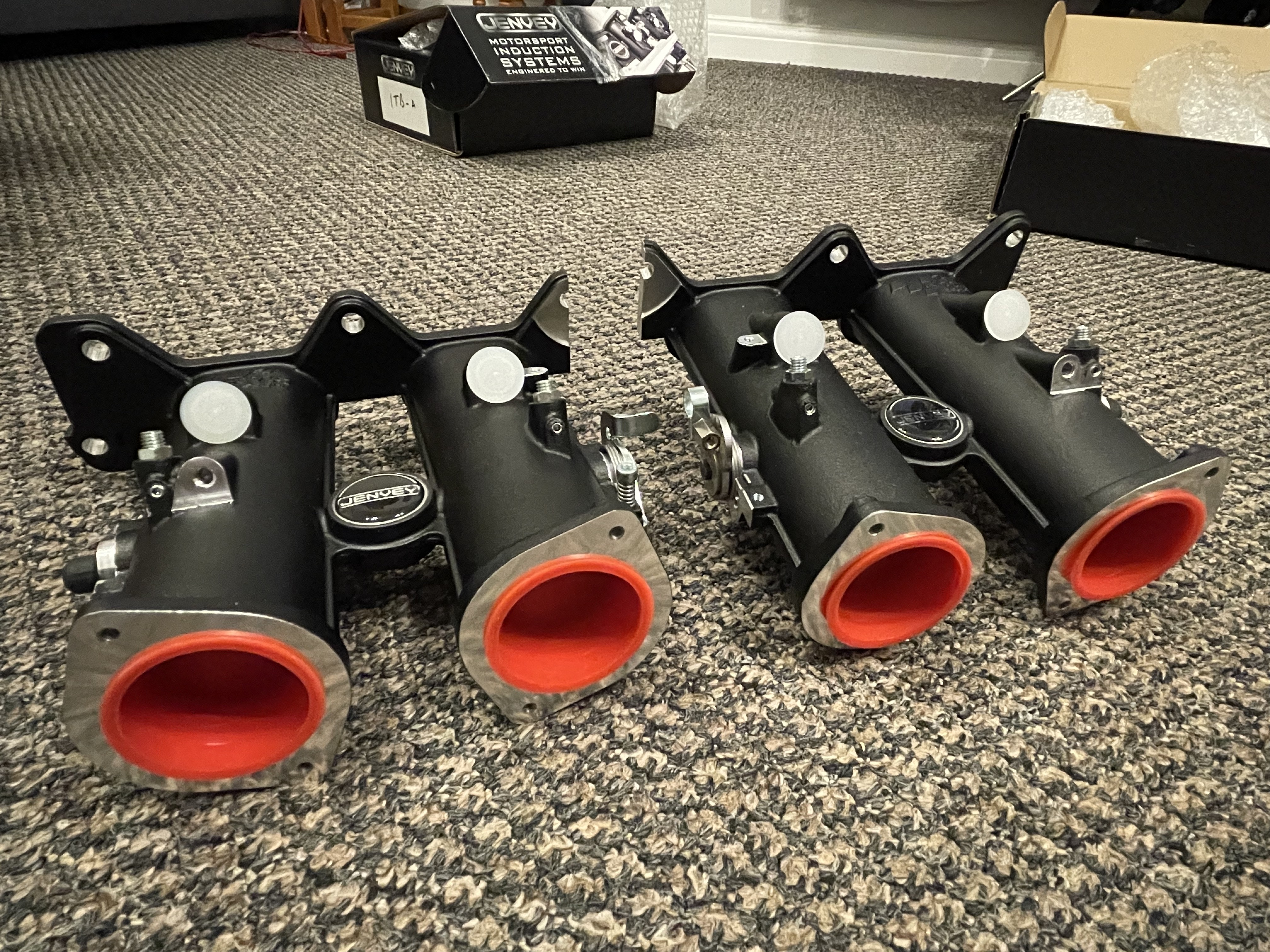

I bought the K-Tec ITB kit. Because noise. Just waiting for the ECU to turn up as they needed to get one in and prepare it with a base map but shipped the rest fo the kit. The plan is to do this myself over a few days (which is likely to be spread out over several weekends!) while doing a few other jobs:

Did an oil and oil filter change yesterday. Rn some engine fluxh though it too, couldn't see it doing any harm!
So much easier to get to the oil filter now the slam pannel isn't there! Although whoever thought putting the oil filter in that orientation on the side of the block obviously think fluid will just stay in place and not run down the side of the block 🤦‍♂️ like both of my 5 series have the oil filter housing so you take the lid off and remove the filter element and all the fluid stays in place, a much better design!
Removed the bonnet mechanism and cable seeing as it is now useless with the bonnet catches. Need to do a bit of a tidy up on the bonnet where the catch went
And finally removed the upper inlet and started to clean the rocker cover up. Need to get some brake cleaner to help shift the grime off as I have ordered some paint to tart it up a bit.
I put the breather plate back on to help keep thins from getting in there.
Labelled all the connectors up as well and wrapped them in cling film to help keep nay moisture out of them as it might be some time until I get around to plugging them back in.
Decided against taking the lower inlet off earlier as the E60 is in for an MoT test this week and as a precuation the Clio can be made to work again within an hour as it currently is. Fingers crossed it is fine and I don't need to use the Clio though!

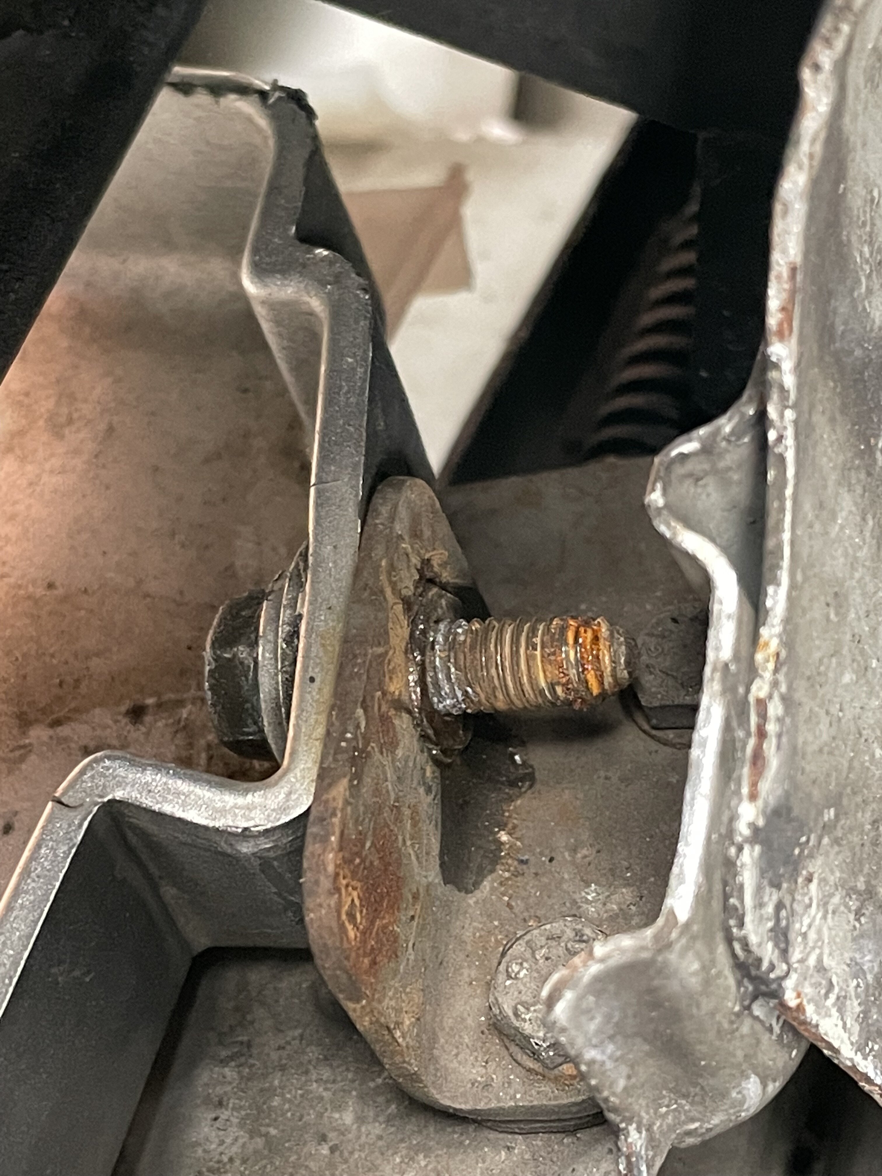

Oh and frst argument with a bolt trying to remove the bumper. I have no idea how to get this off as you can't get to the two bolts that hold the bracket to the car with a spanner either.
