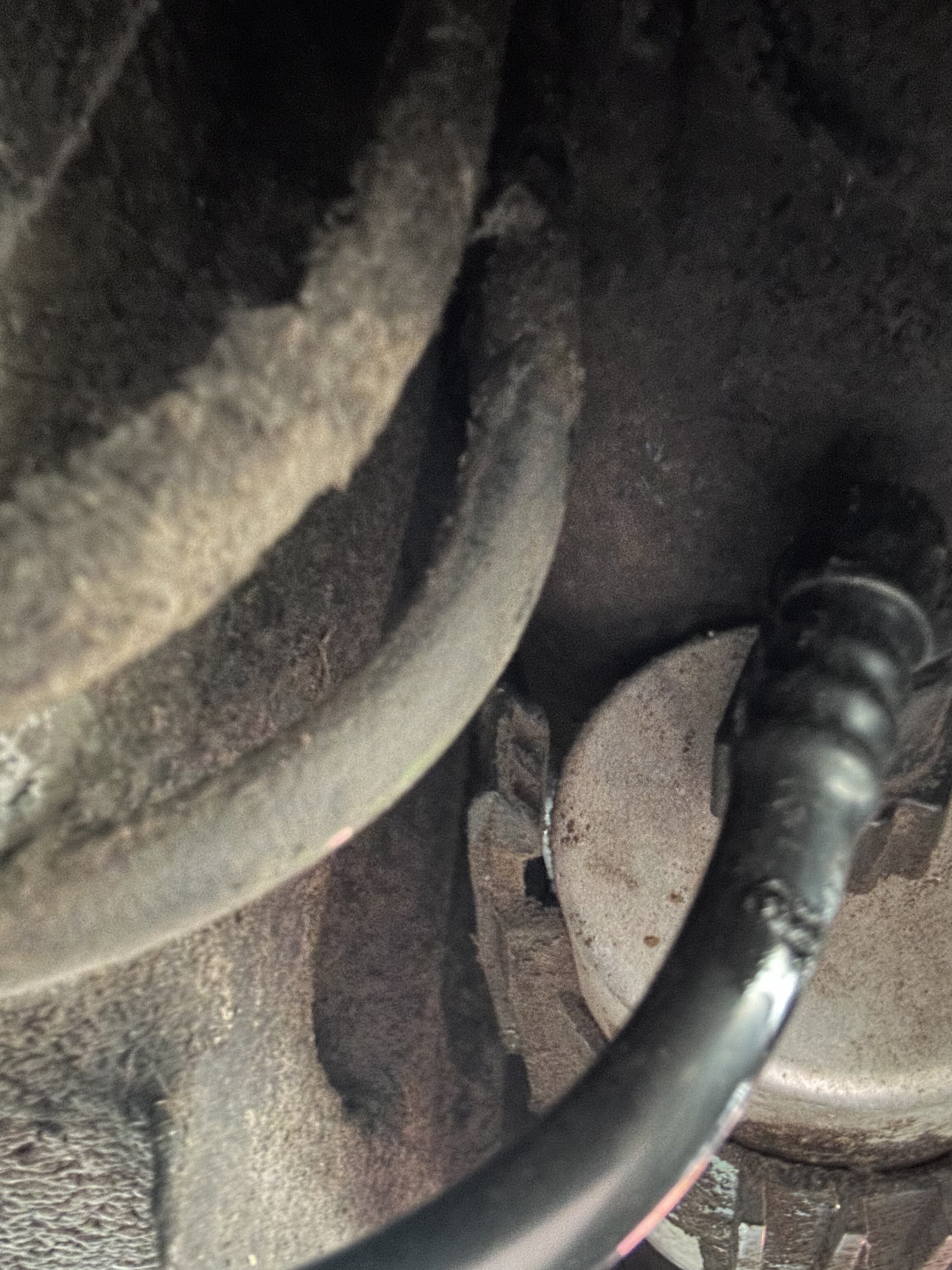

Next problem….massive fuel leak from this pipe
Not sure how as it was fine after Anglesey. I hope a mouse or anything hasn’t chewed it.

You can see it spraying out from that bend when the car is on so I’m confident it’s there it’s leaking from.
What is annoying the car had half a tank in it yesterday. I started it and walked off and left it running like I usually do every few weeks, could smell fumes but we had just a heating oil delivery and that smells a bit. Went to use it today and same smell and a trail of fluid and then no fuel 🤦‍♂️ What’s annoying is that I was off to look at the gear box as I can’t jack it up on my drive. So now I have this landed at the top of the drive which has given me some access so will see when I get home later.
KitsonRis
@mintno1 is the outside diameter pipe at the fuel filter the same as at the fuel rail?
I have found some left over fuel hose from my ITB conversion but the inside diameter is bigger than the inside diameter of standard hose. But standard hose does fit inside the hose I have and I’m thinking of splicing it in and just putting the old inside the new with a few jubilee clips. But I have to be 100% confident it is fine as soon as I cut this hose and it’s wrong I’m screwed as the AA won’t recover my incompetence.
Yes I could measure but I don’t have verniers and I have an off cut of the fuel rail end in my spares that I’ve trial fitted to the new hose.
KitsonRis
Actually this won’t work. Just checked exactly where the split is and it’s so close to the connector into the filter my hose won’t go over the old hose and barbs on the fitting
Need to source the right hose and fittings
KitsonRis
Fuel leak sorted 👍🏻 need to keep an eye on it just in case.

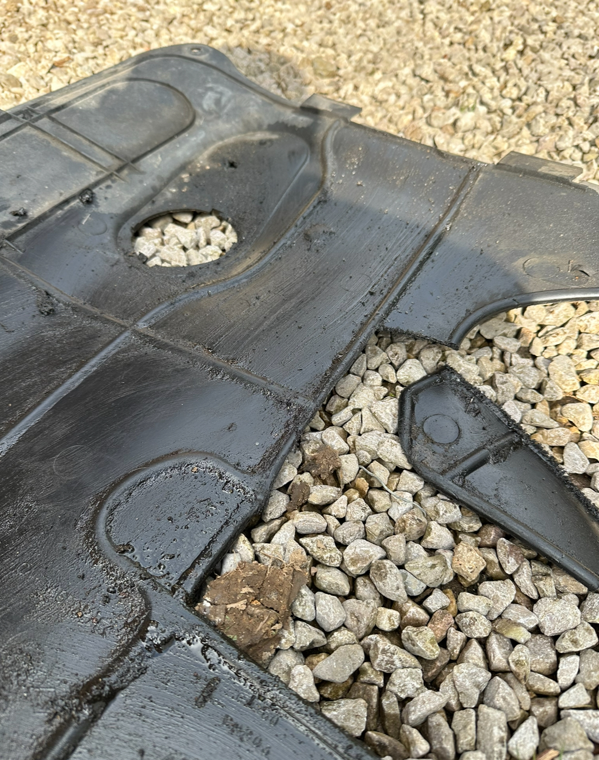

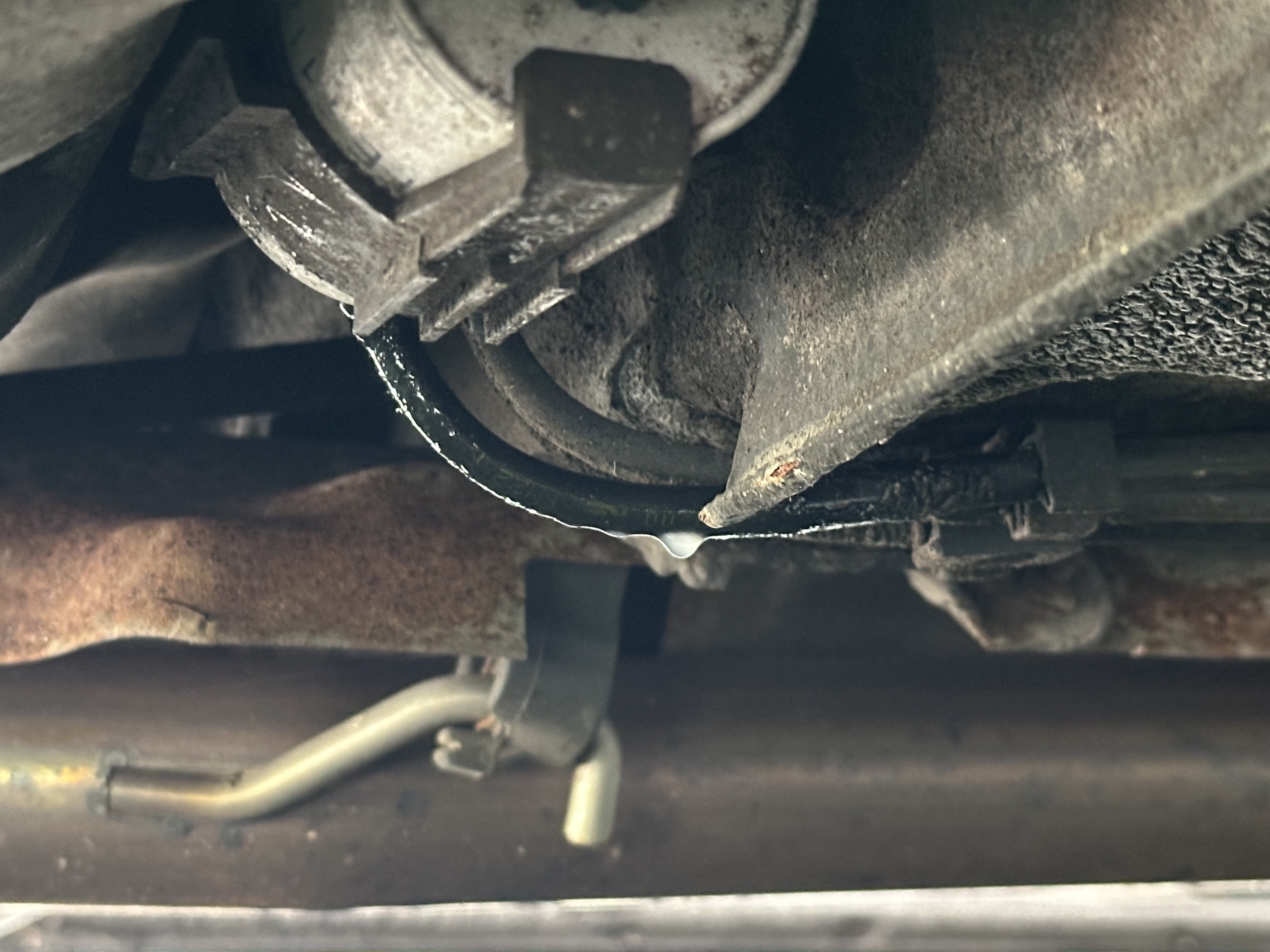

Gear box hasn’t exploded. I had time today to do some investigating. It’s not actually that bad once I took the under tray off. It’s coming from the selector seal as the drive shaft is bone dry. Can the selector seal be changed without taking the box out the car? So what I’ve done it dried it all up, chucked about 2ltr of oil in and see what happens in a week. Now I have a reference point it will be easier to see how bad it actually is.
My under tray was a bit damaged and the trailing edge was bent and it always scrapped on the road down the lane at home. So I took a saw to it and cut it off and now it doesn’t scrape!

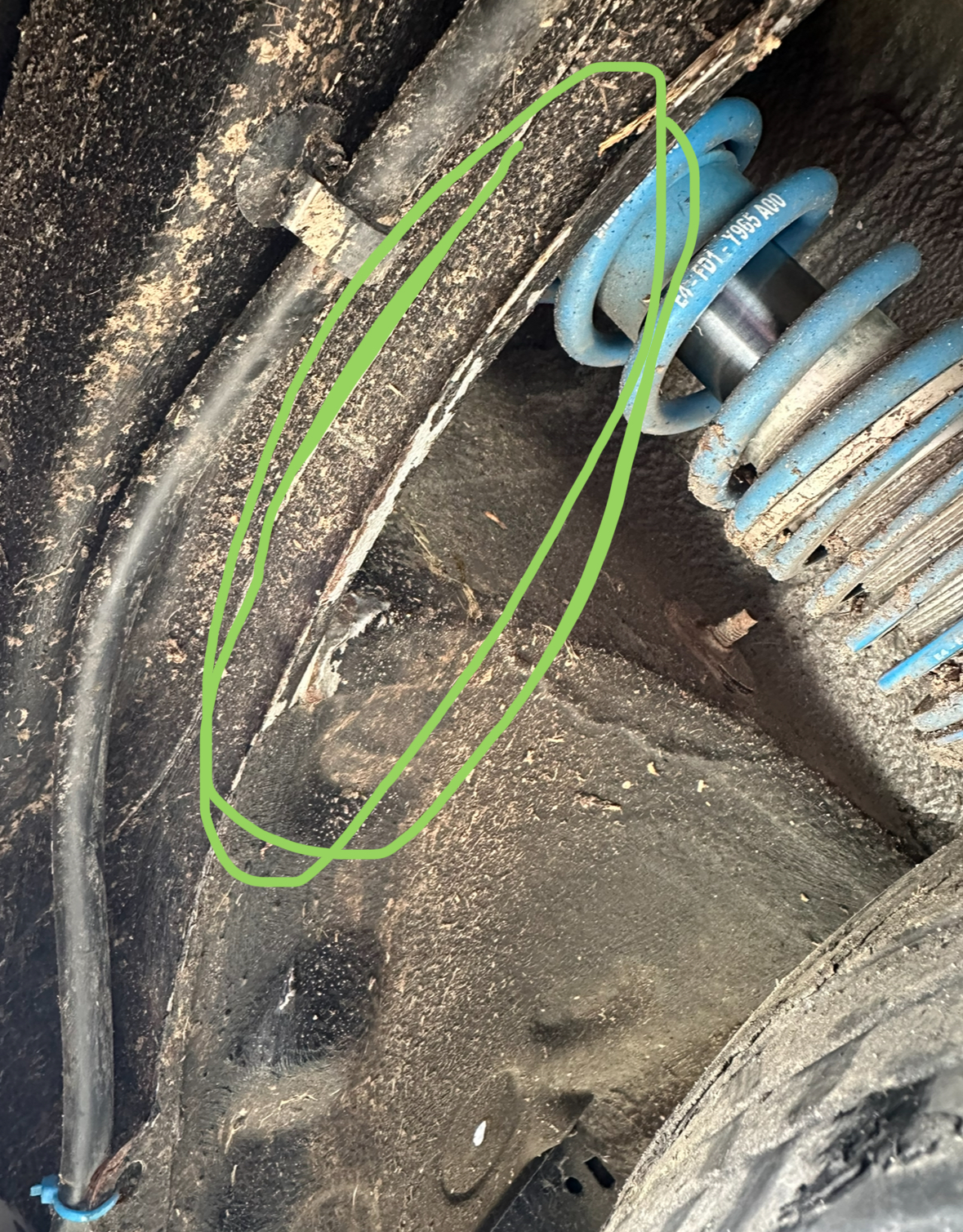

When I was at Anglesey there was a rubbing noise on right hand corners. My old Ph1 used to rub drive shafts so I thought it was that. Nope. Drive shafts looks clean and no rub marks on the chassis. Only thing I can see is this rub mark above the wheel
Tyre looks fine and doesn’t look or feel damaged. Can’t be that surely?

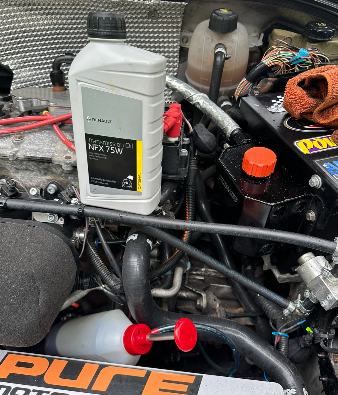

After writing the for sale advert I did I did a bit more gear box investigating and can confirm the oil comes out as quick as it goes in. Drive shafts all look dry so it has to be something else but it is really hard to see with using a trolly jack and not properly being able to get under it. When I drove 3hrs home from my parents the last time I used it you could smell how hot the gear box got and it is now whining (which stops when you fill it then it comes back). So yeah, highly likey its fubar. My step dad convinced me not to sell it with the prices only going one way on these, even for broken ones. And I know if I sell it, because owning a Clio is a disease you cannot shift, I will want another in the future and I couldn't bring myself to part with the money they are likely to get to (and it would have to be a Ph1, none of that Ph2 crap). At the moment I am in a lucky position I don't need the money so it can sit there until I am able to save up for the necessary things, which I think will include welding when I go to put it on the road. This is how it currently looks, little sad on the drive all covered up. Thankfully the drive has just been re-done so it is actually on hard standing and not some mix between what should be gravel and dirt and grass.

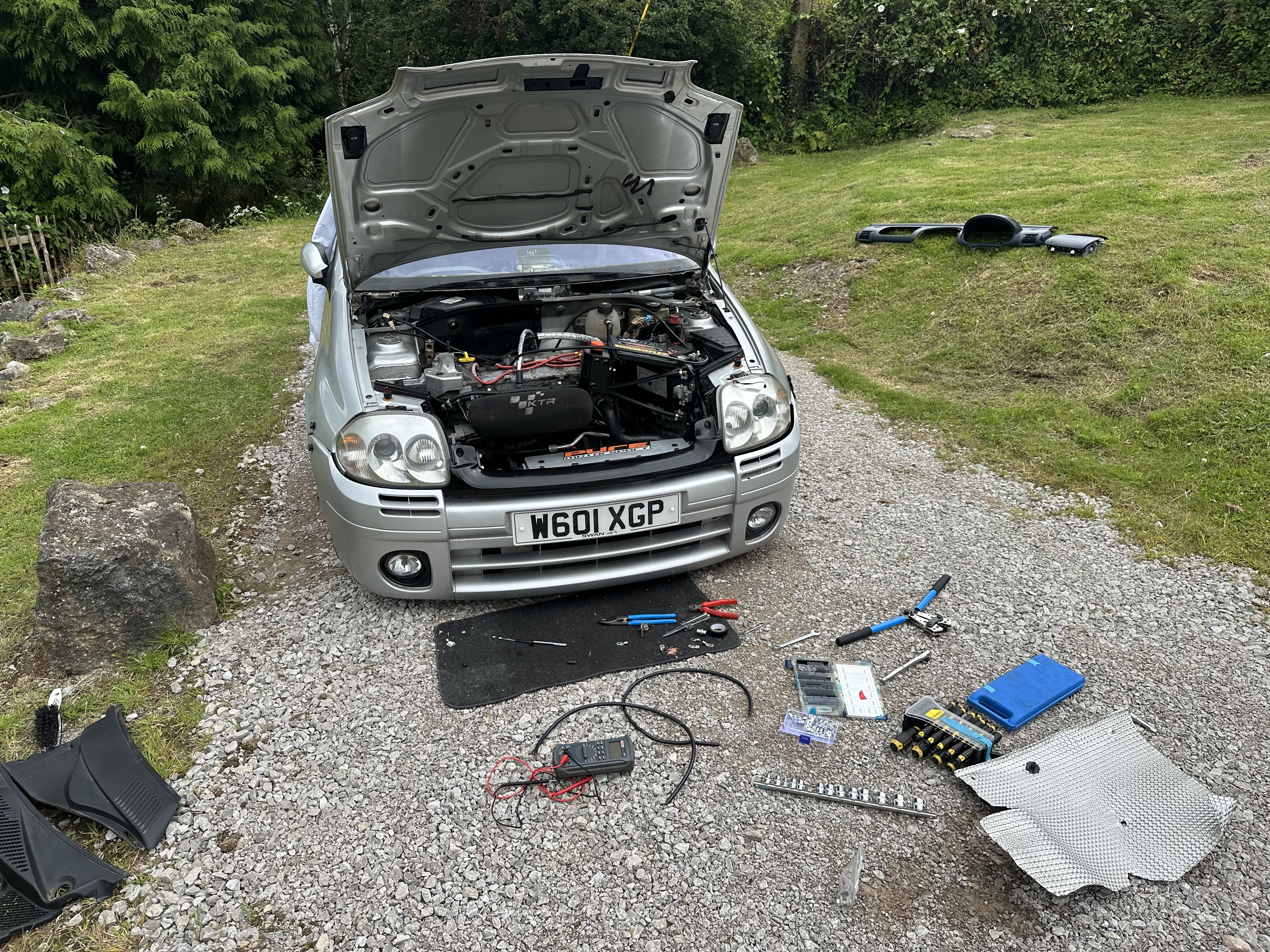

Small progress on this today.

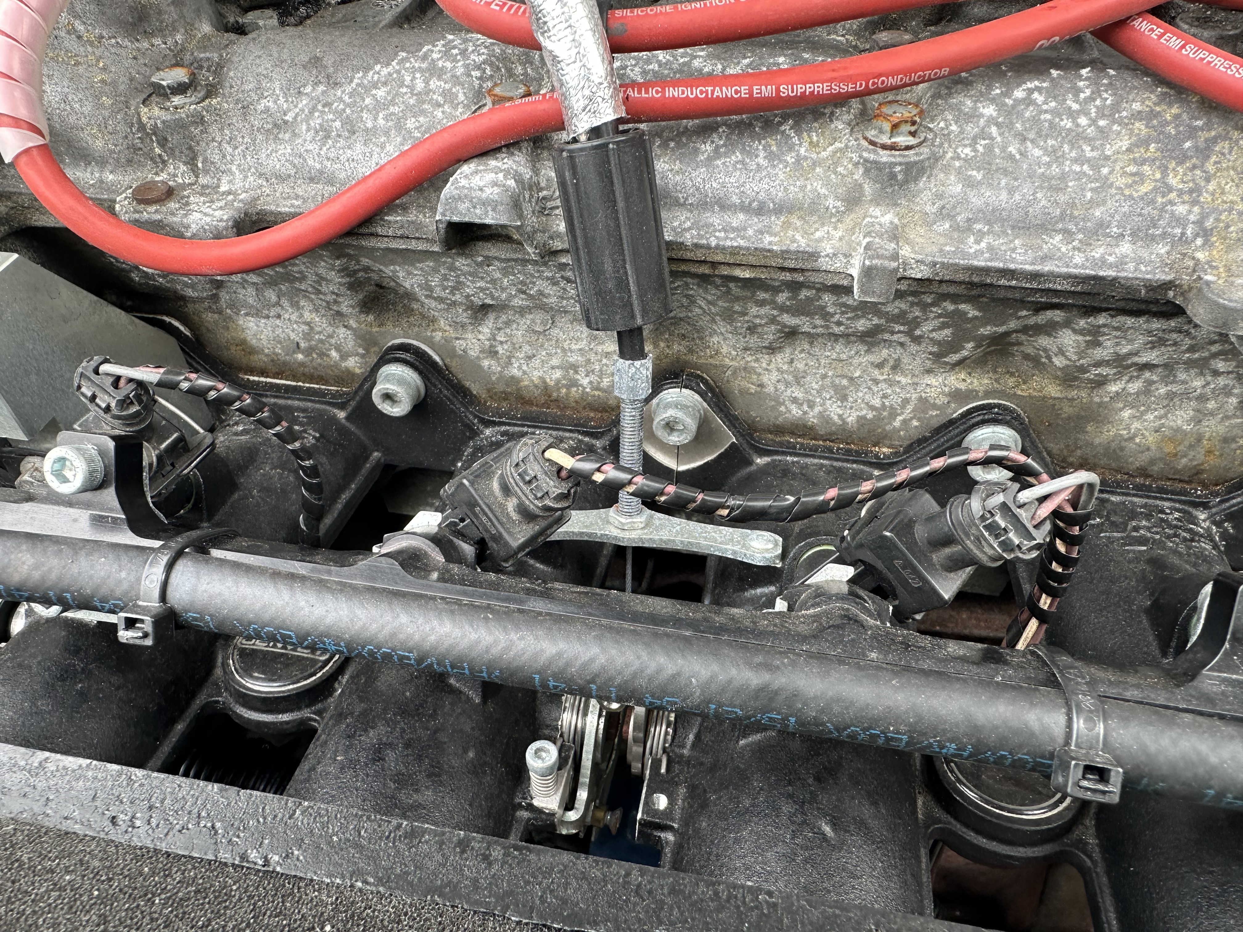

Wrapped some of the wires up for the injectors to tidy it up a bit. This was because I had to move them when fitting the ITBs so more of the wire was outside that little casing. Also wrapped the wires for my radiator fan switch too. Just neatens it up a bit

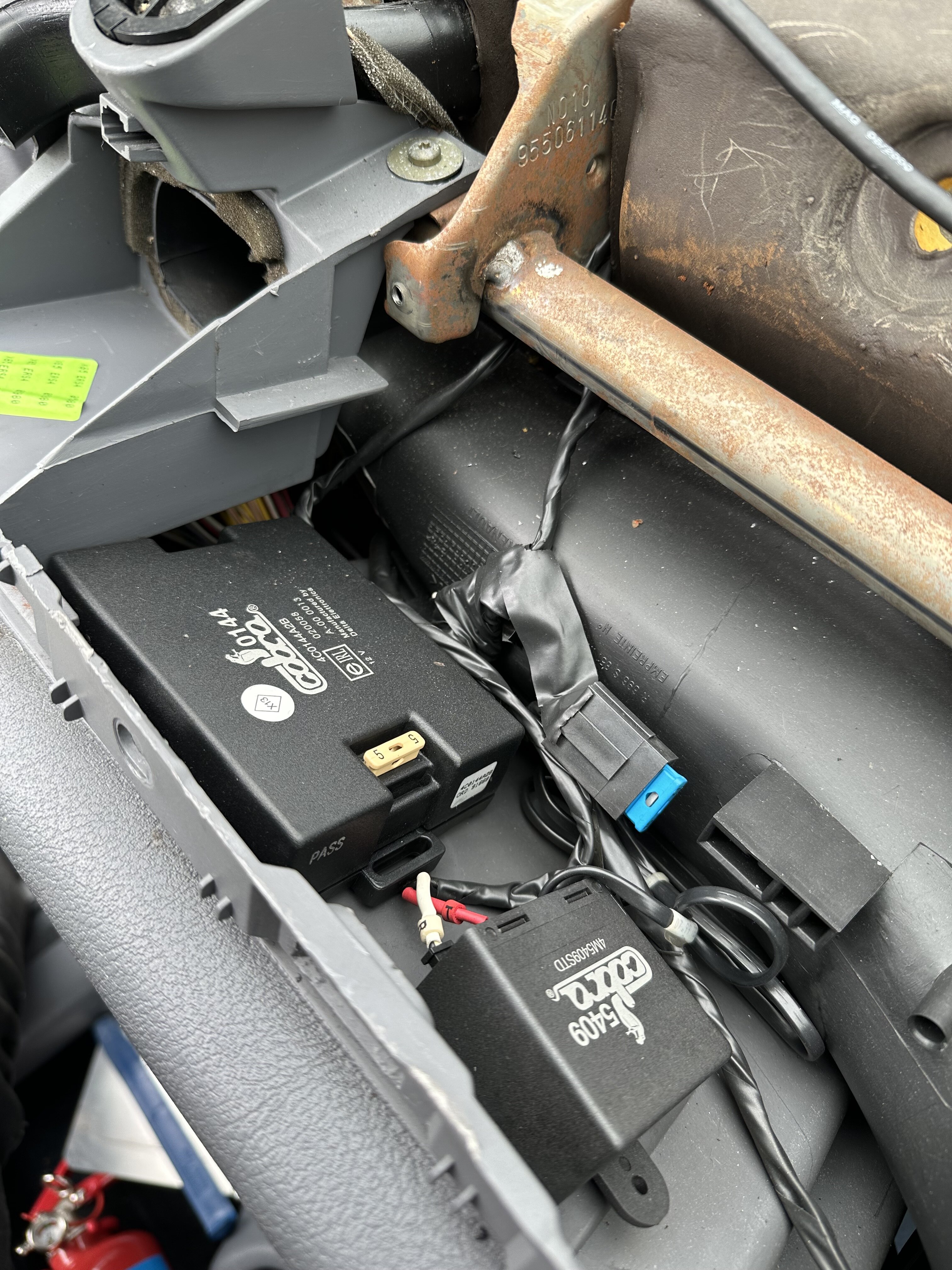

The idea is to have the key switch in the wiper scuttle on the driver’s side…. So I did a trial fit to make sure it was all wired up correctly. All fine and kills the battery as intended. Go to place it to mark up where I need to cut the scuttle and work out how to get the cables through the bulk head and fail - the switch won’t clear the bonnet. Oh and one of the bolts that hold the blanking plate thing on the bull head where the air con pipes goes just spins. I’ve already used the one hole in the bulk head for my radiator fan wiring. So I decided to remove the top dash to see if there was anything obvious there. Nope. Was greeted with an after market alarm under the passenger air bag
Not sure I should be worried about this as I always thought after market alarms from this era are a nightmare!

Spent some time on the Clio this morning while it was sunny.
Took the wheels off to work out what I am going to do with the arch liners. Have a plan now so just need to order some of the plug fixings. Going to run the curved part and the front sections I’ll cut off the bit that attaches to the bumper which are broken on mine (and nearly all Clios) as this will cover up the “holes” where the gear box and the aux belt are.

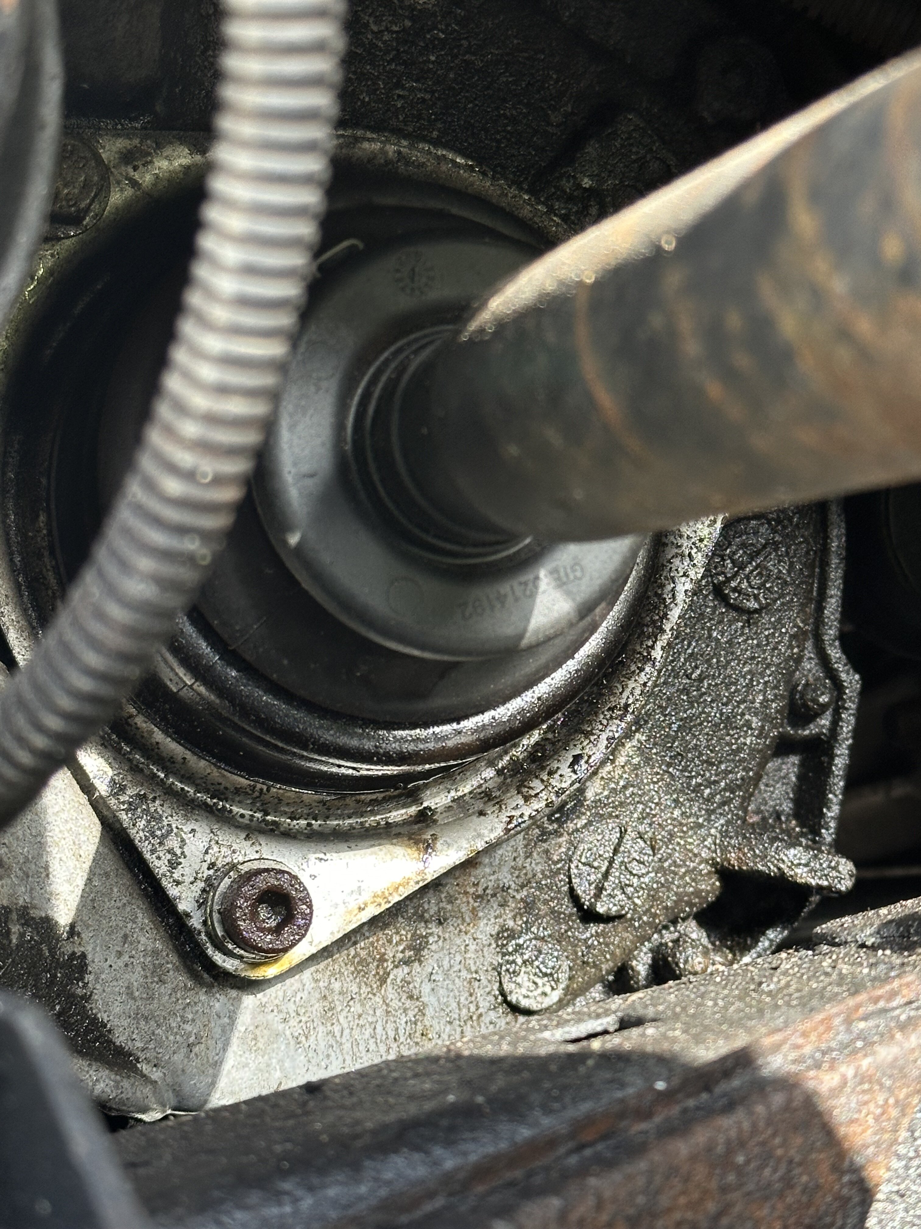

While the passenger wheel was off had a quick look at the gear box, still no obvious signs of a leak from the drive shaft so I’m going with the selector seal has well and truly left the building.
If the drive shaft seal was leaking I would expect this to be covered in oil and really dirty.

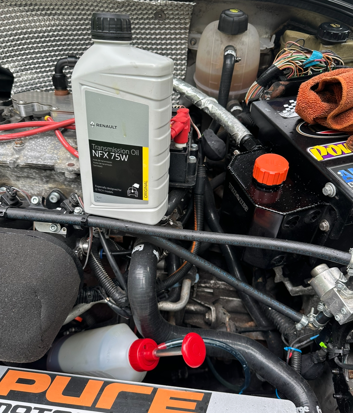

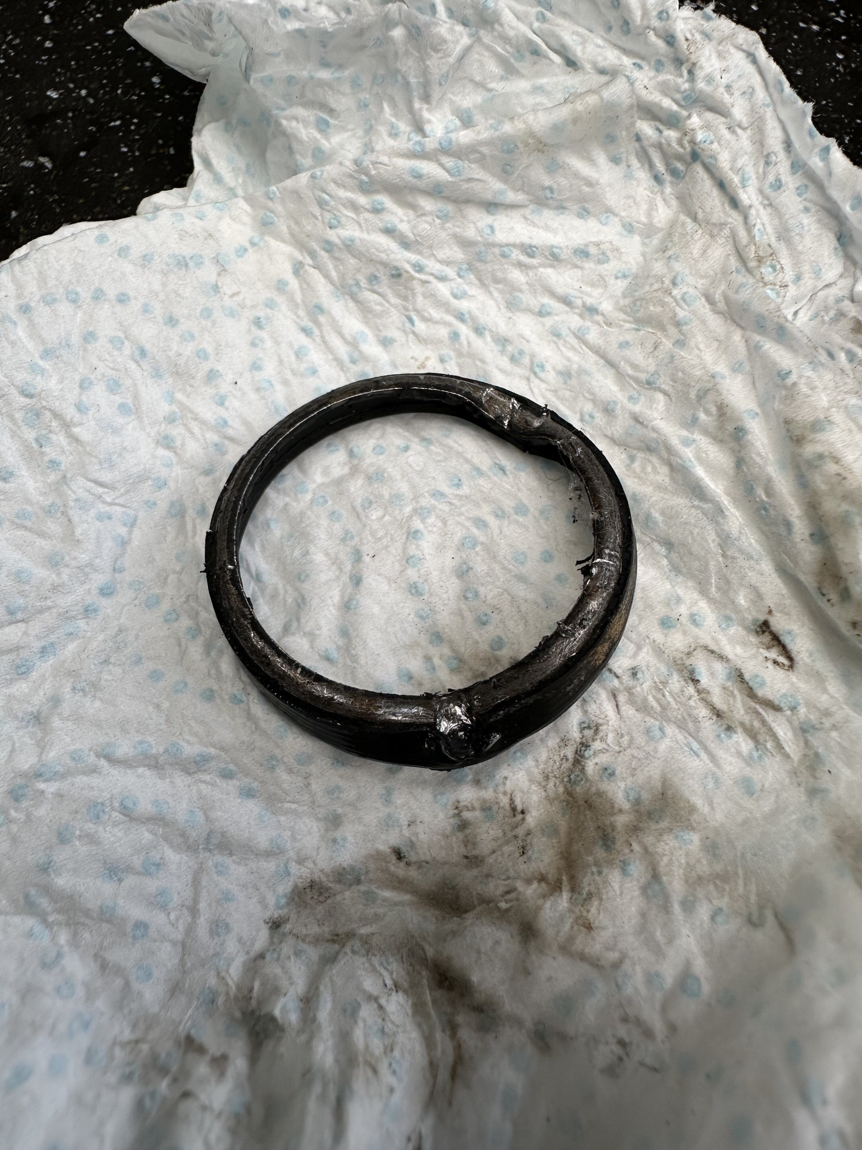

Finally changed the phaser solenoid seal. What a prick of a job
Ended up using a punch to bend it enough to come out. Quick clean and then used a socket to push the new one in. Feels a lot more snug. Had the car running for 10mins and no oil on the rocker cover so take that as a win.
Forgot how good it sounds.
