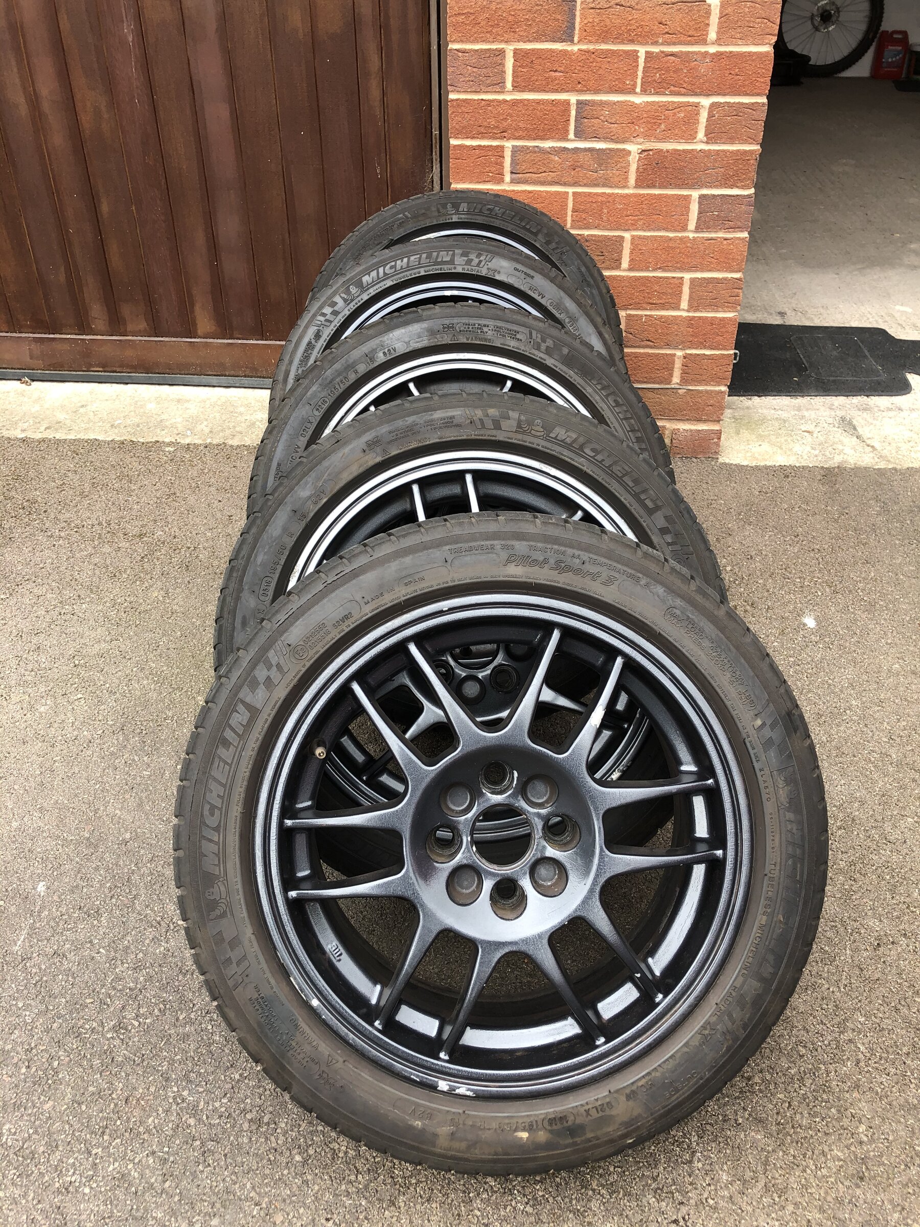

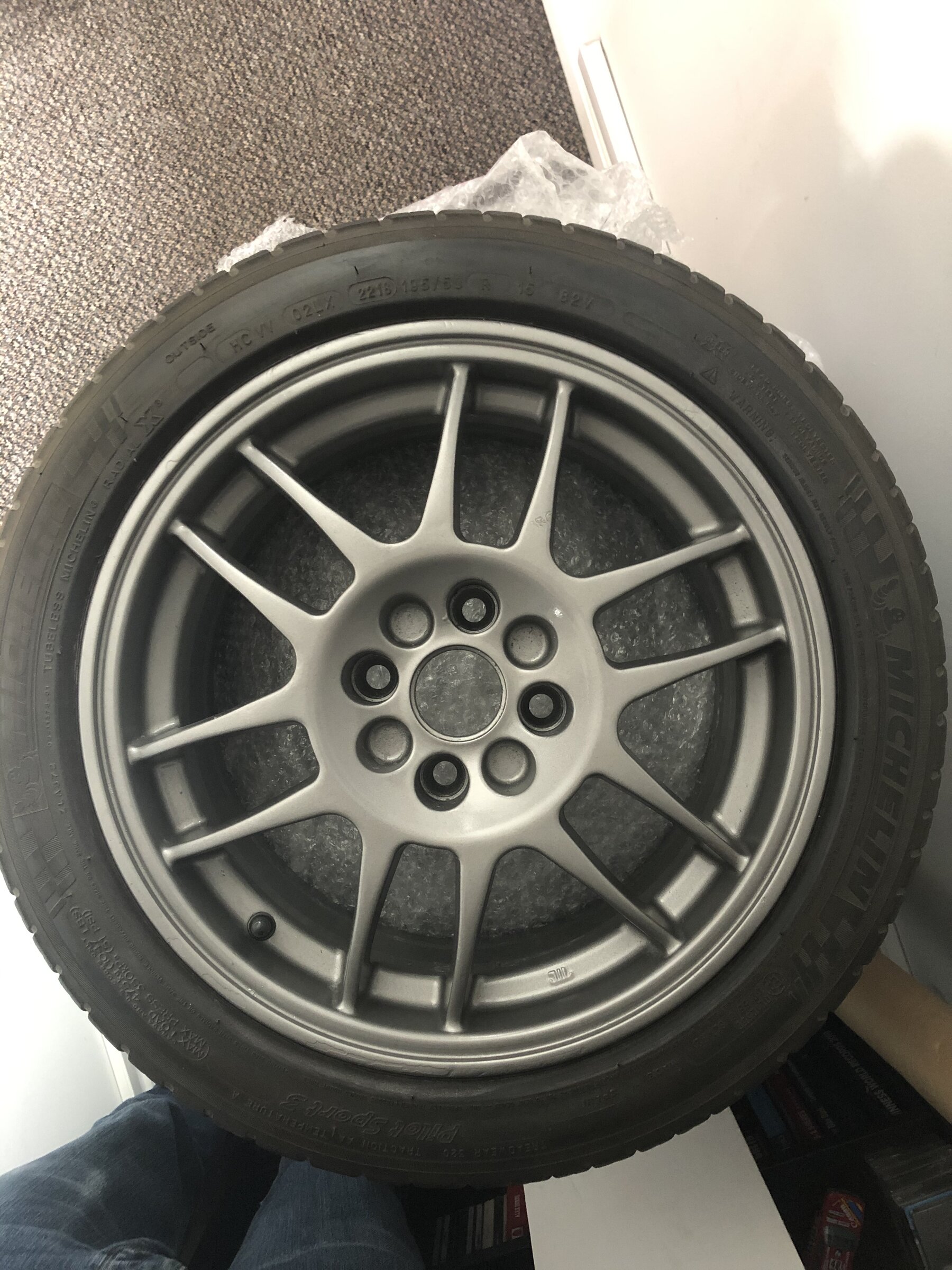

Managed to source a set of 5 original OZ F1's for it including all matching Michelin tyres. They need a refurb but I think I am just going to paint them silver for the time being as they will be acceptable then look at a full refurb at a later date. Just need to get some centre caps - eying up the 3D printed ones on eBay.

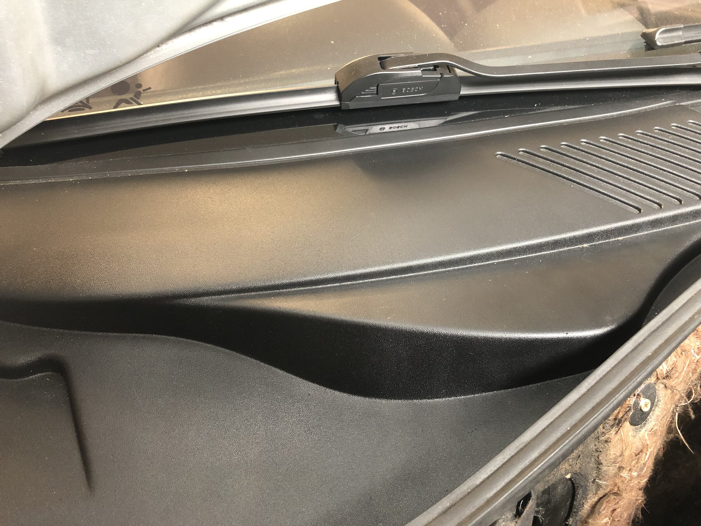

As with all cars I own I have refreshed all plastics too - side strips, wiper arms and wiper scuttle. They have all now been painted black. Always find these little jobs make such a big difference to the overal appearance, gives it that fresh look. Also put some new Bosch Aerotwin blades on. Fitted a pair of Citroen C3 mist washer jets as per my old Ph1. However I remember them getting to the driver's eye line, these don't. Not sure why that is.

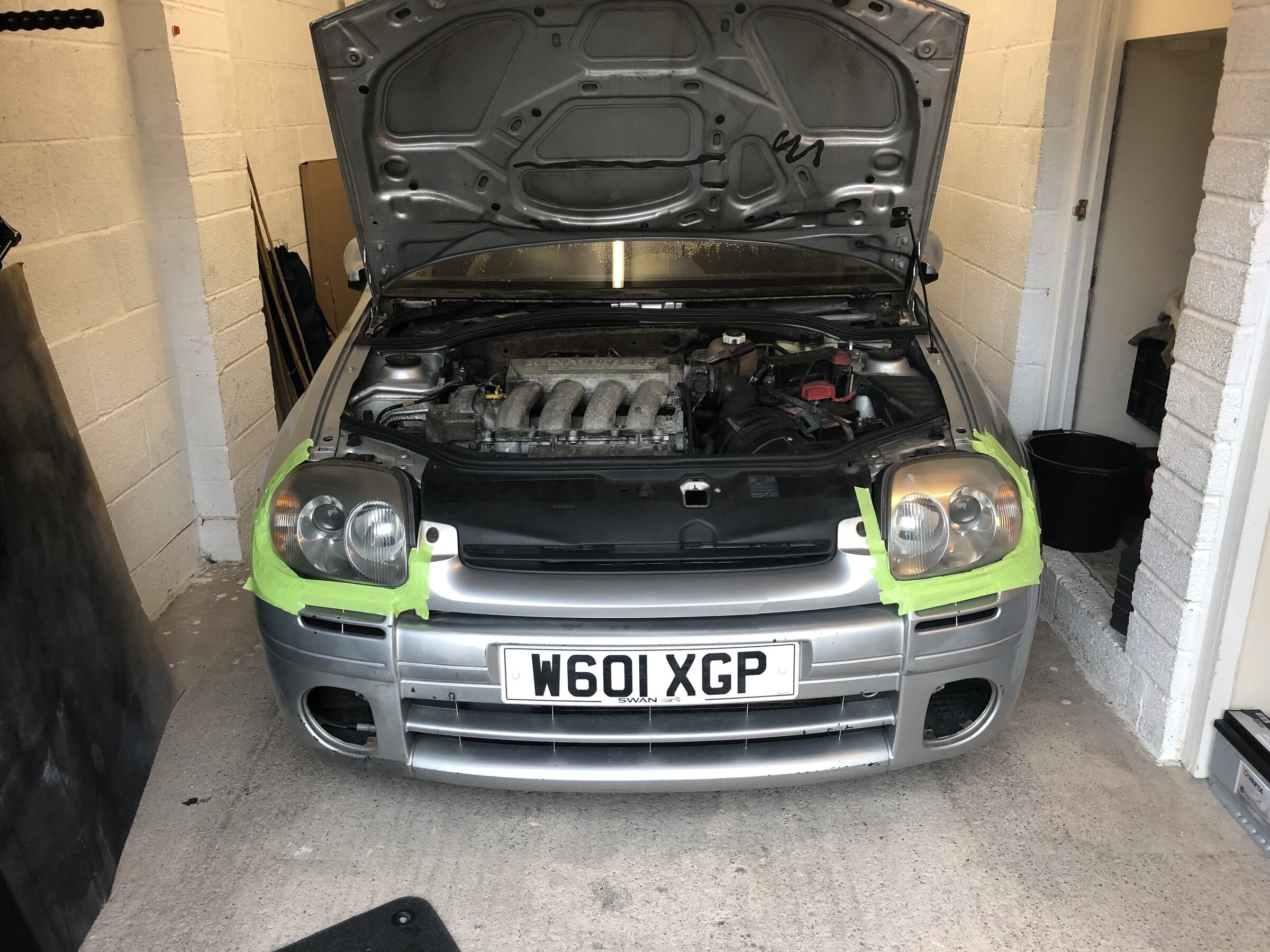

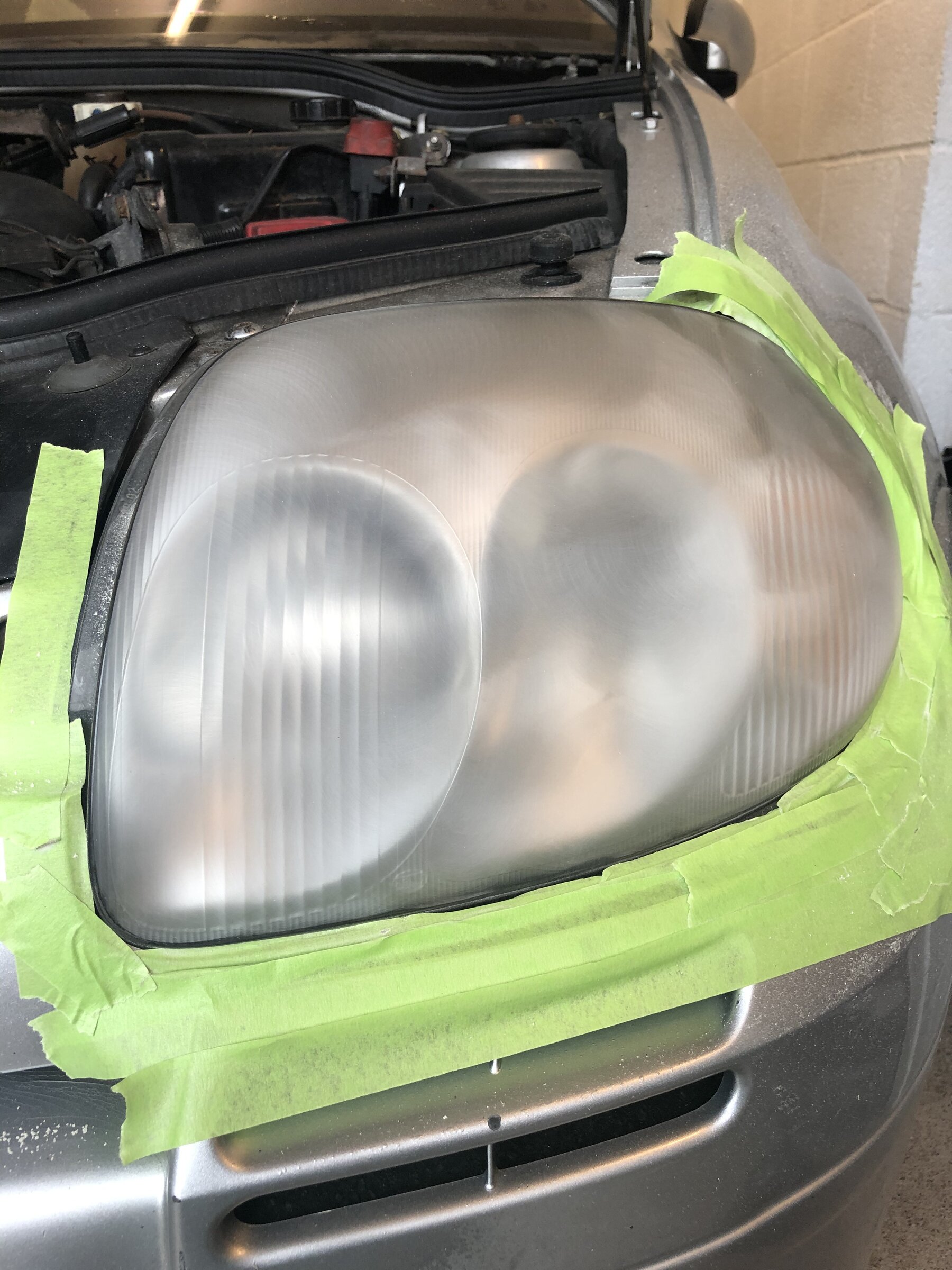

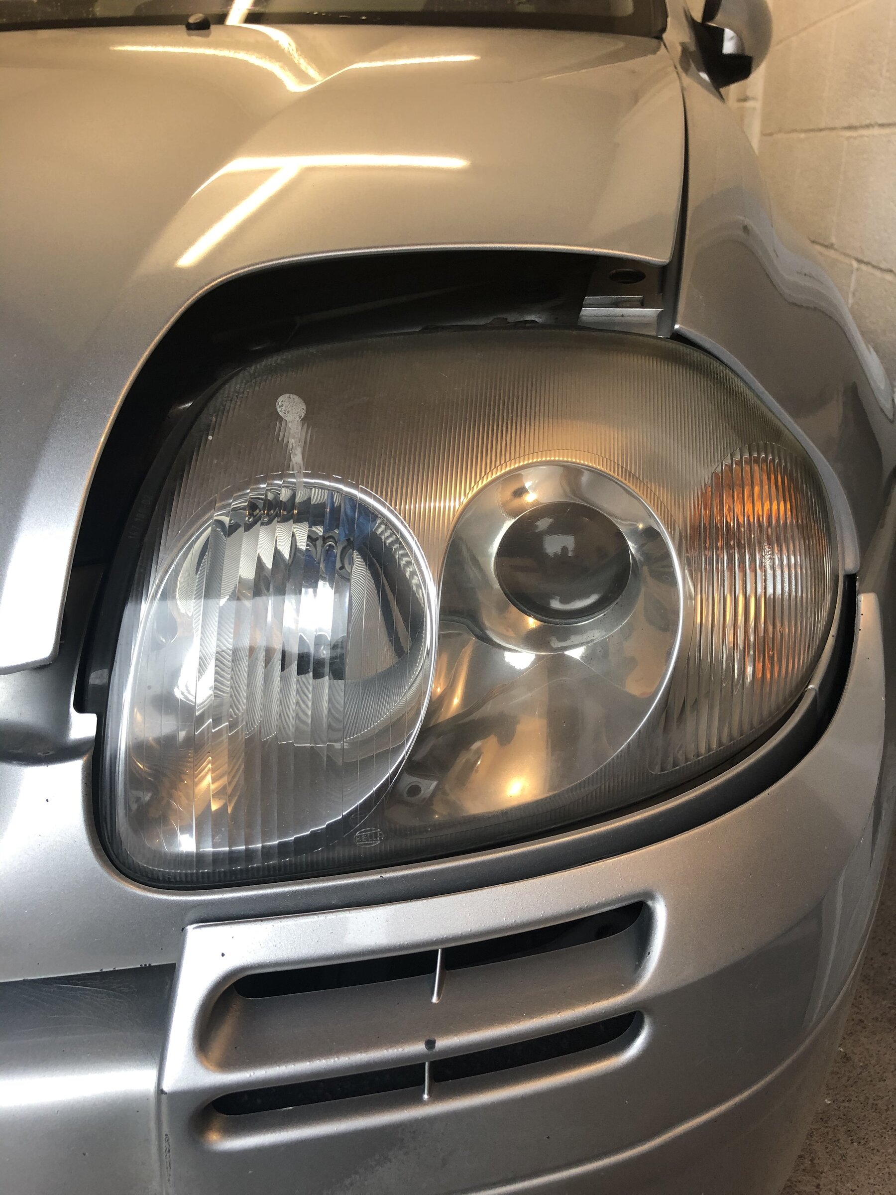

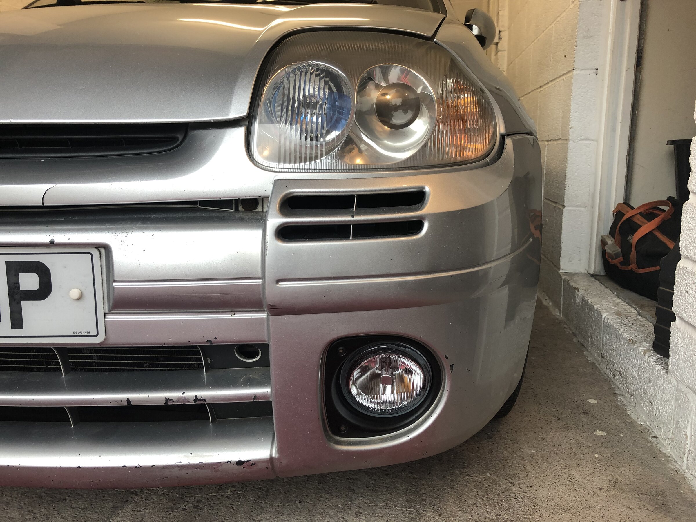

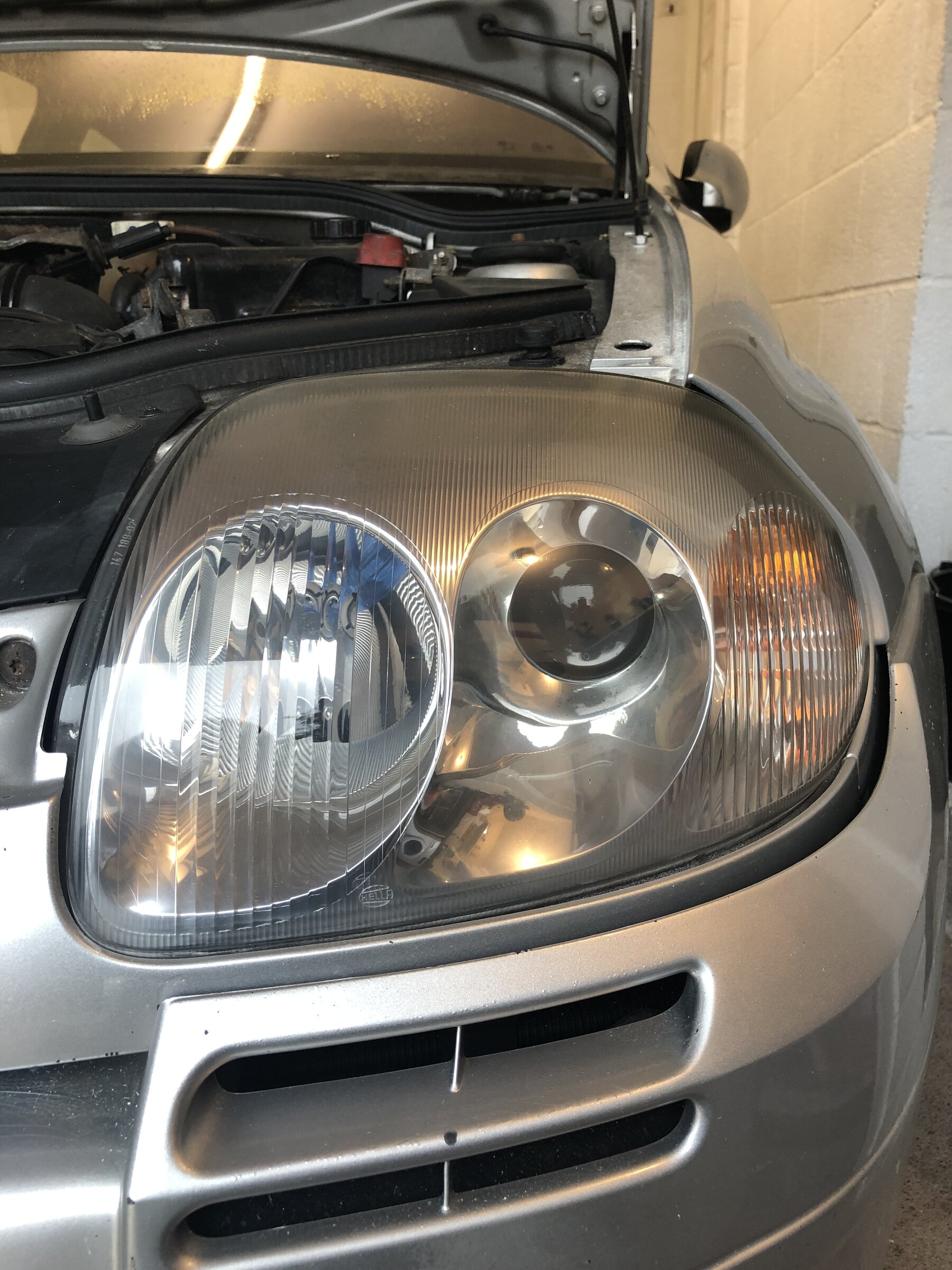

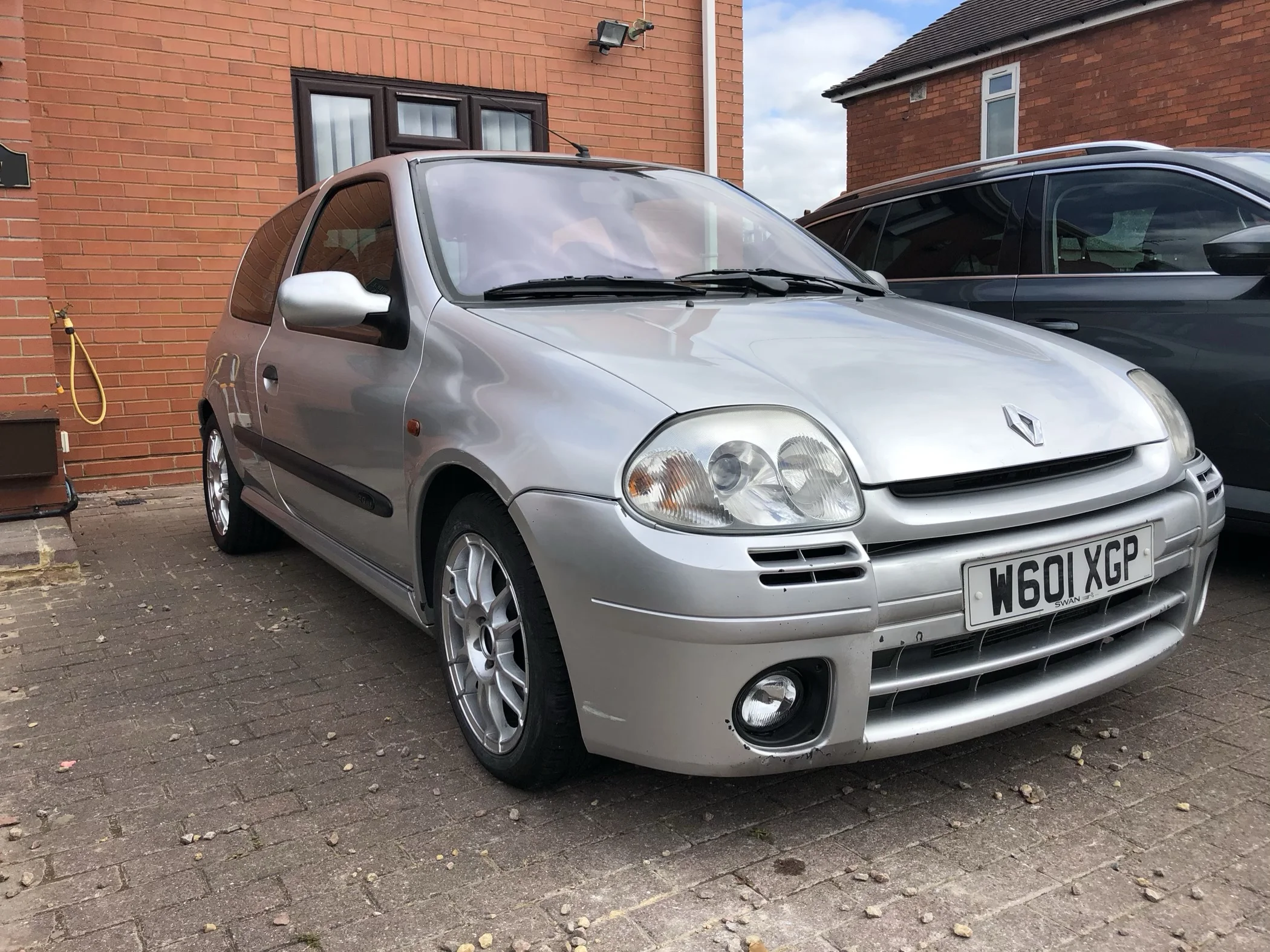

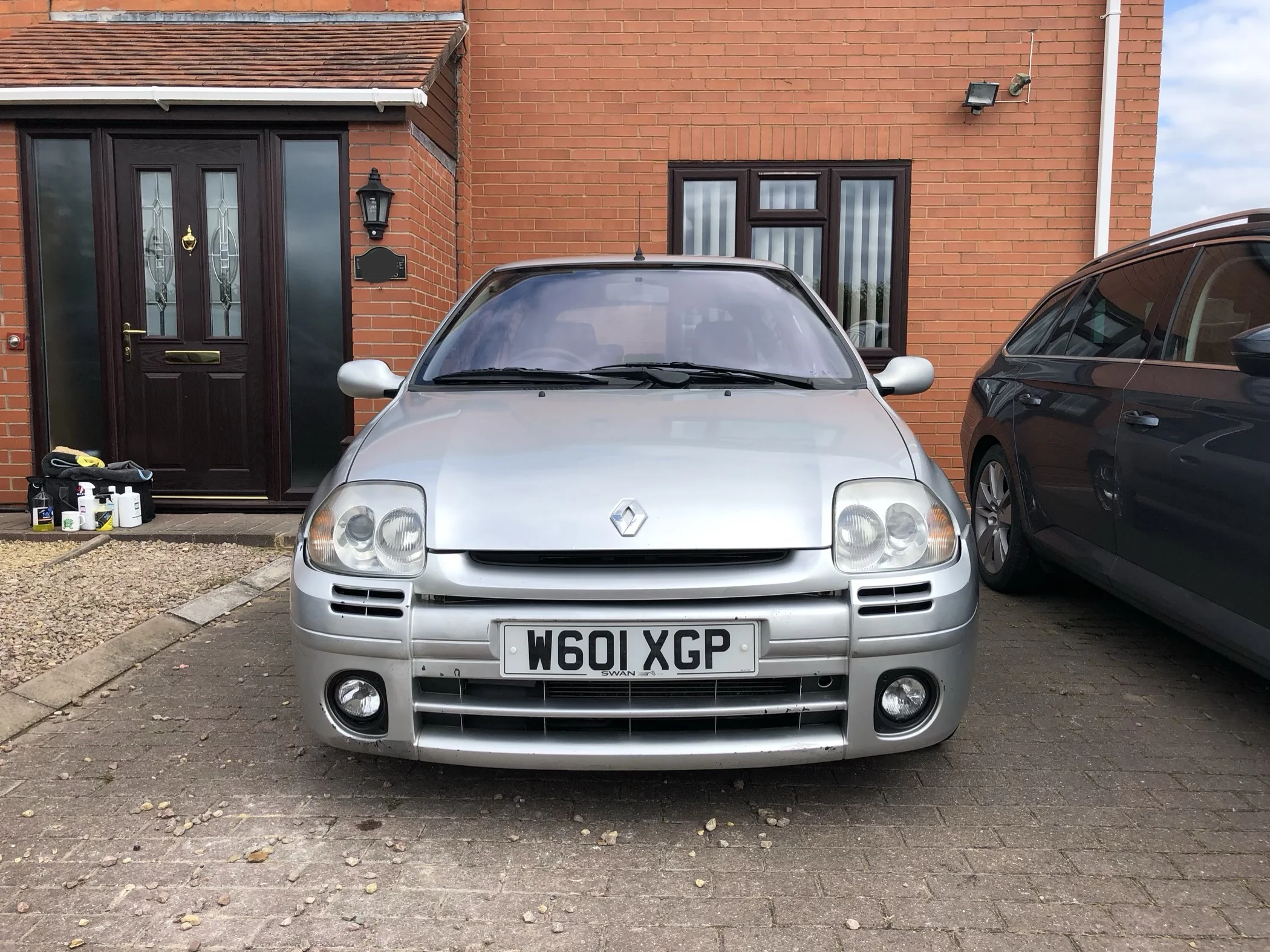

Gave the headlights a restore with the 3M kit. Came up a right treat.
Before:
During:
After, along with a new fog lamp unit:

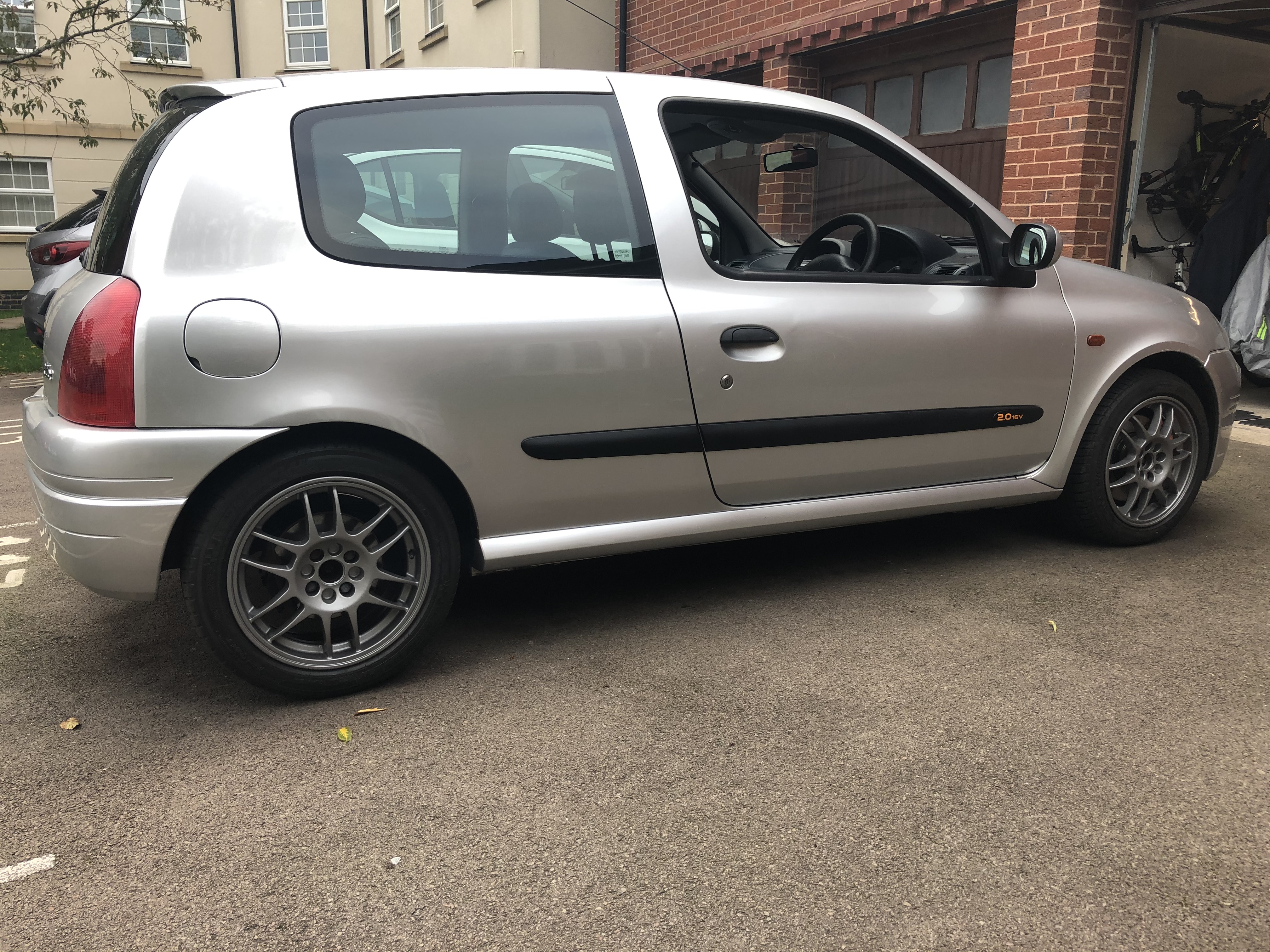

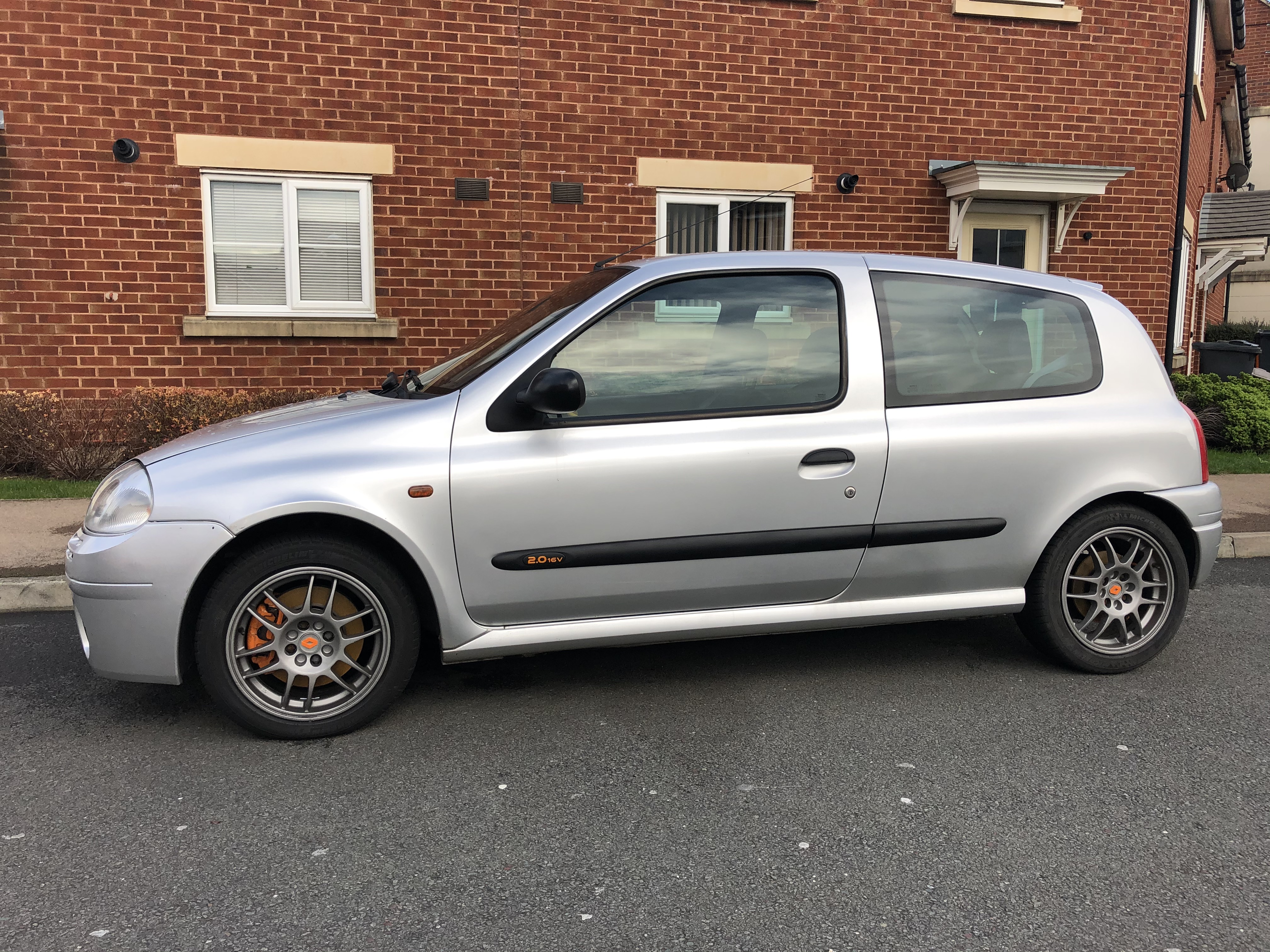

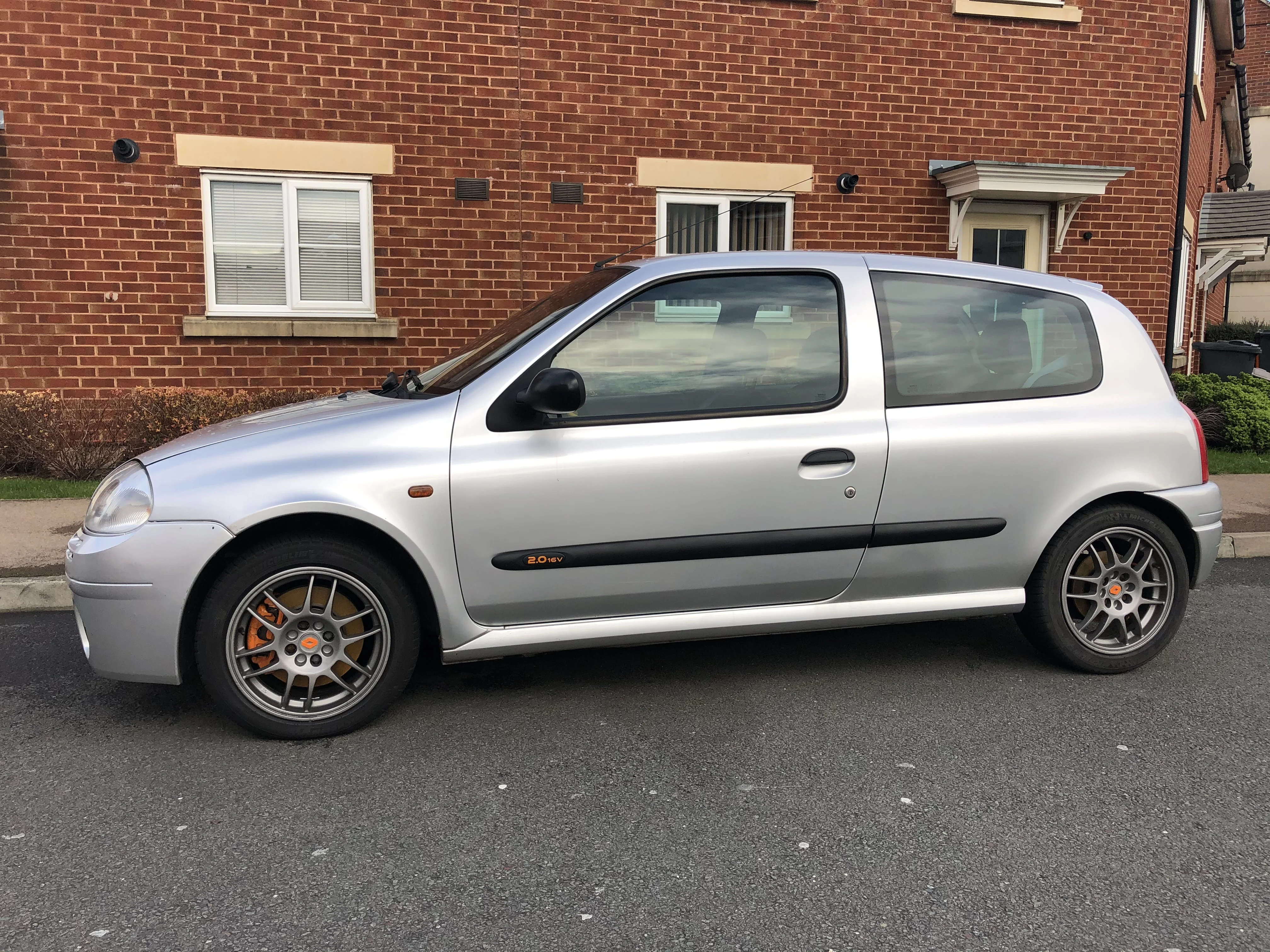

Panited the wheels. They easily pass the 10ft test. They will be properly refurbished at a later date, would rather spend the money on something else at the time being. Just need to get some centre caps and then the wheels ballanced up, fitted and tracking done. There is a lot of paint and lacquer on them, not making the same mistake as last time when I didn't get enough paint on them and brake dust eventually ruined it. Also coated in GTechniq C5.

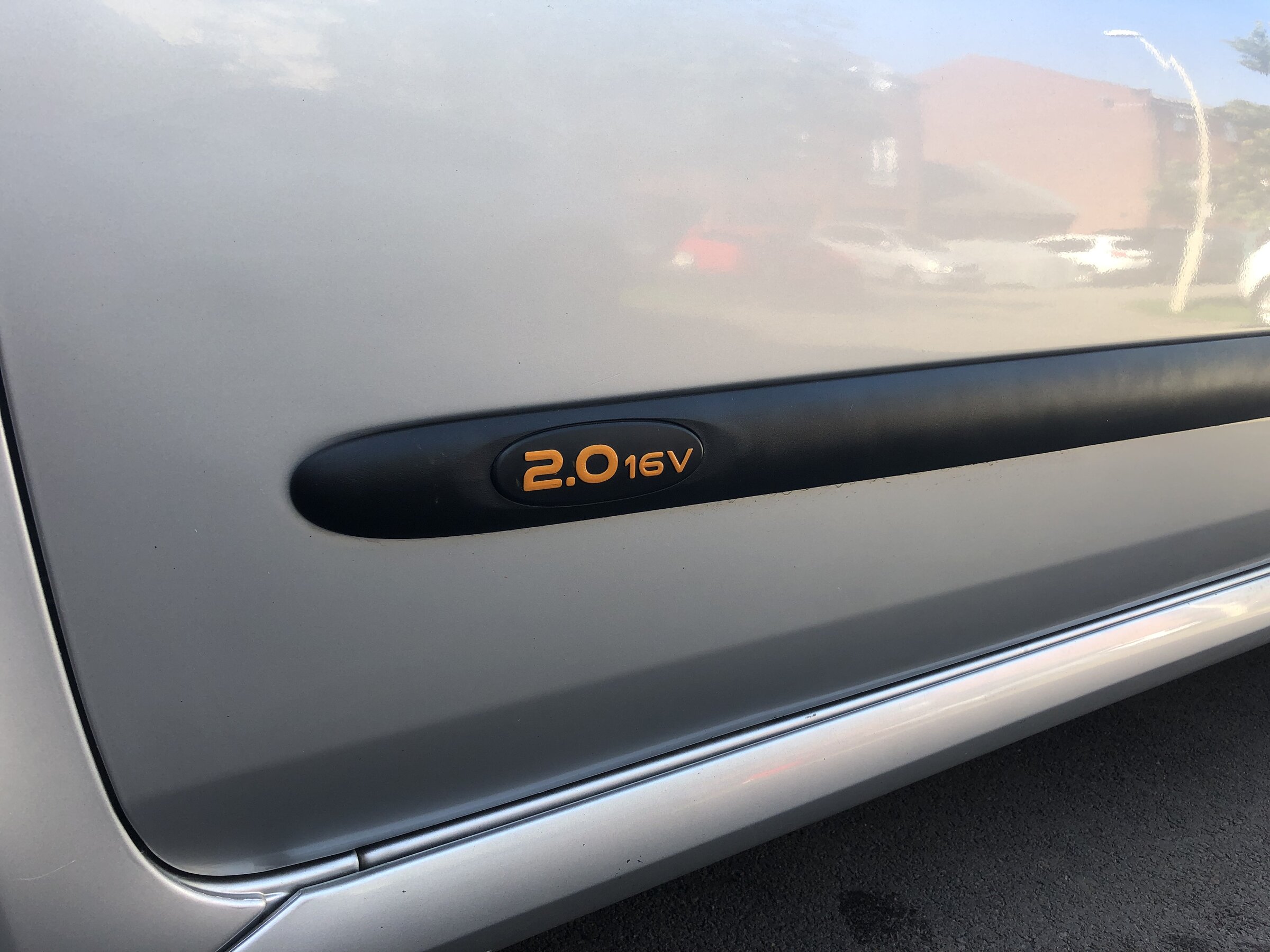

A little throw back to my old Ph1 and painted the "2.0 16v" on the door strips orange.

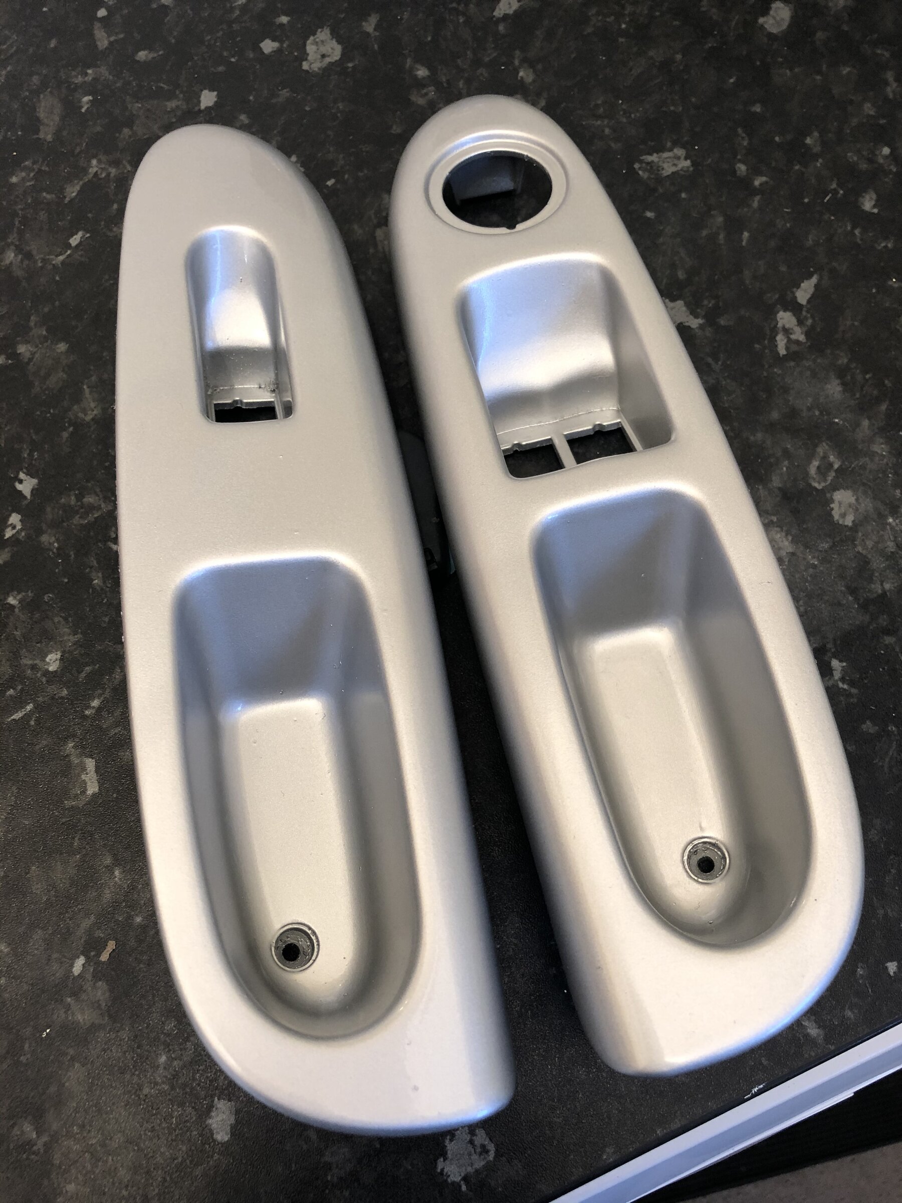

Interior door handles were painted silver. Managed to do the centre console too in the same colour.

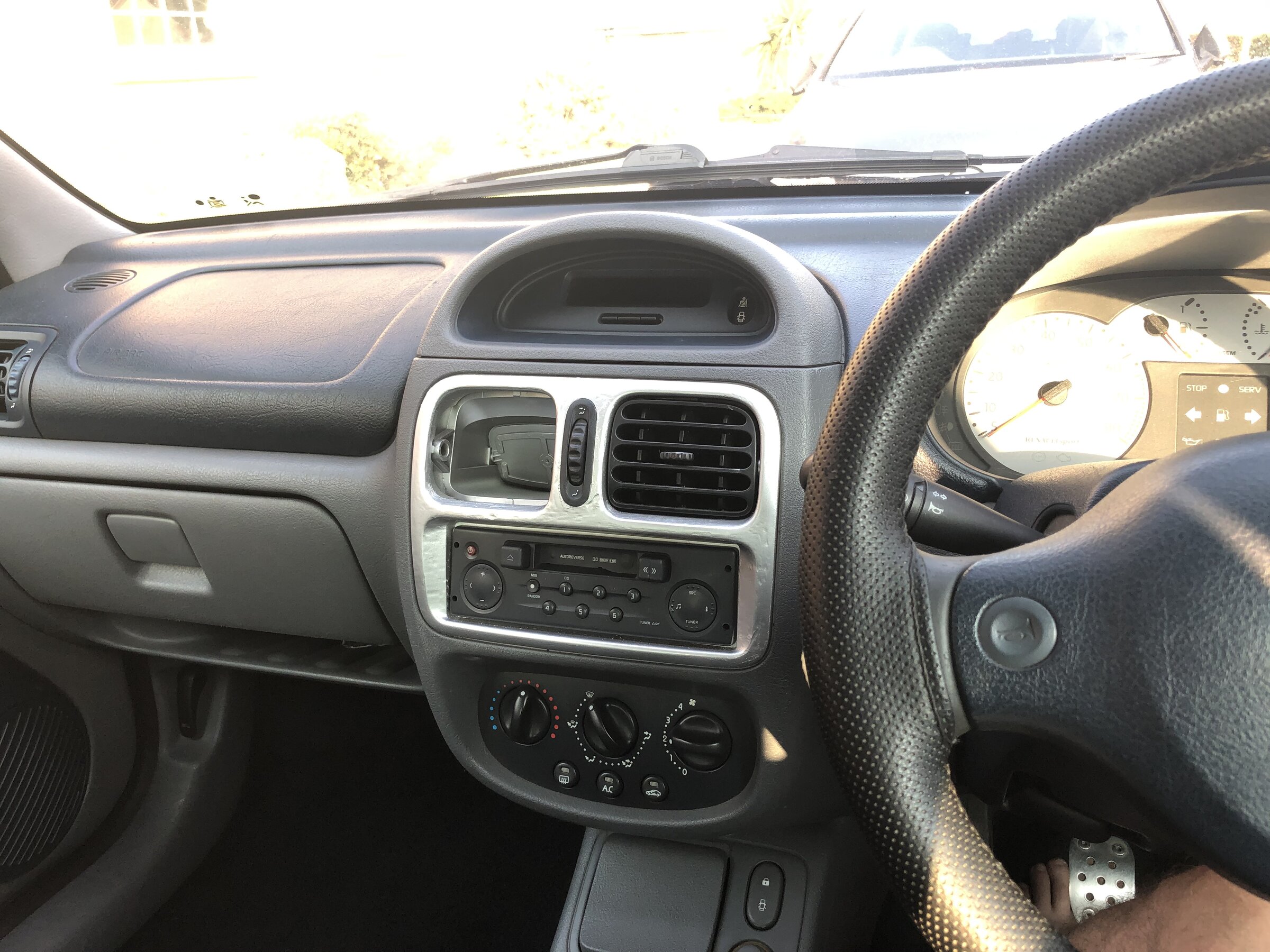

The passenger centre vent was broken and I took it out. Not going to replace it but going to blank it off and mount a phone holder on there.

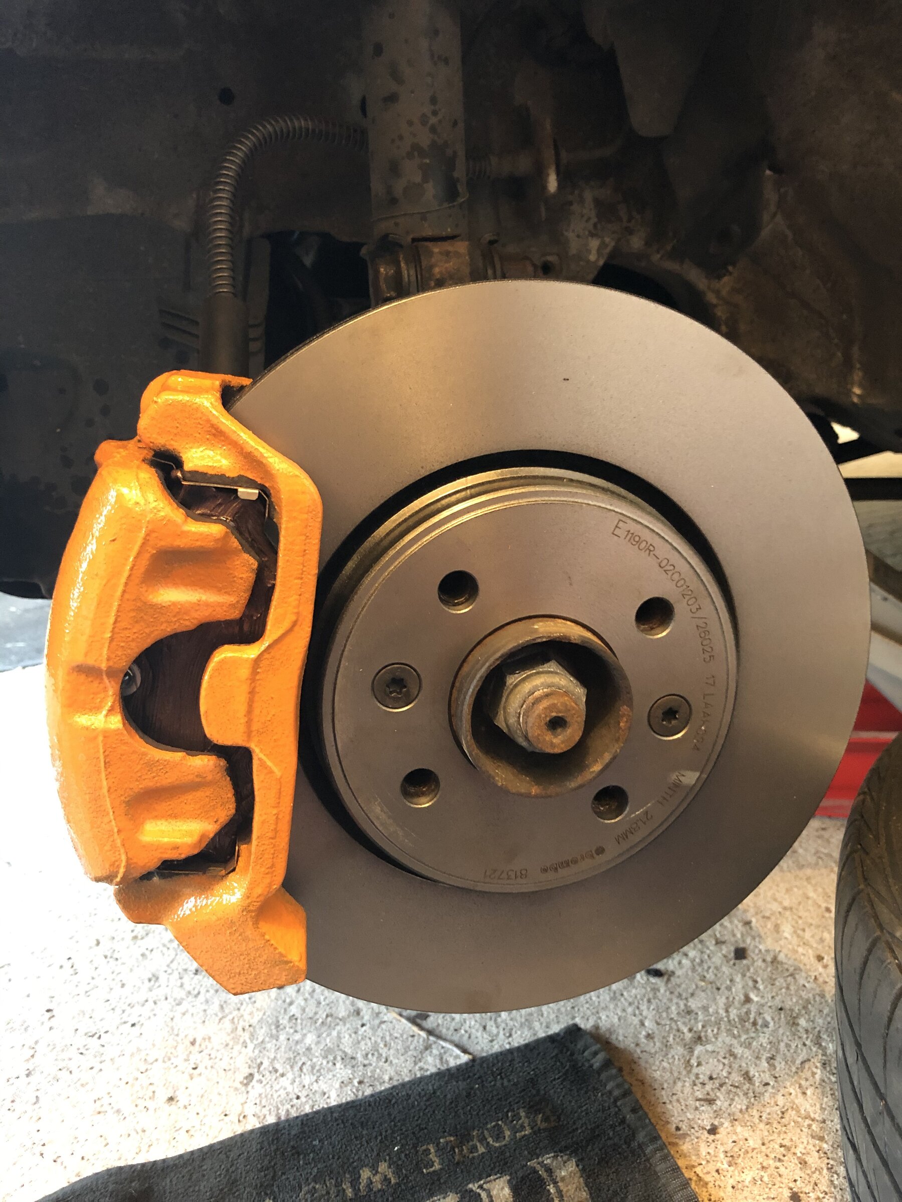

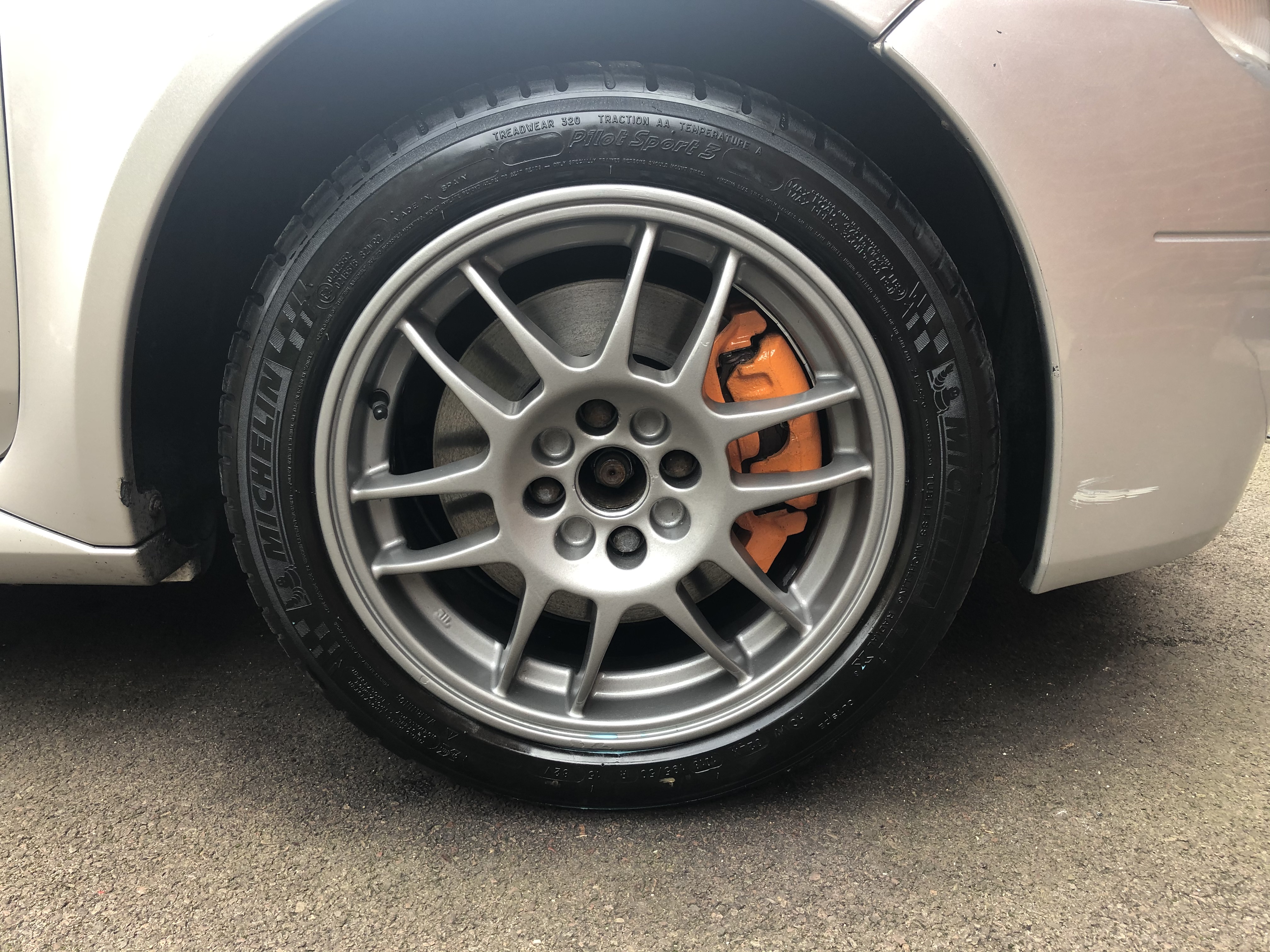

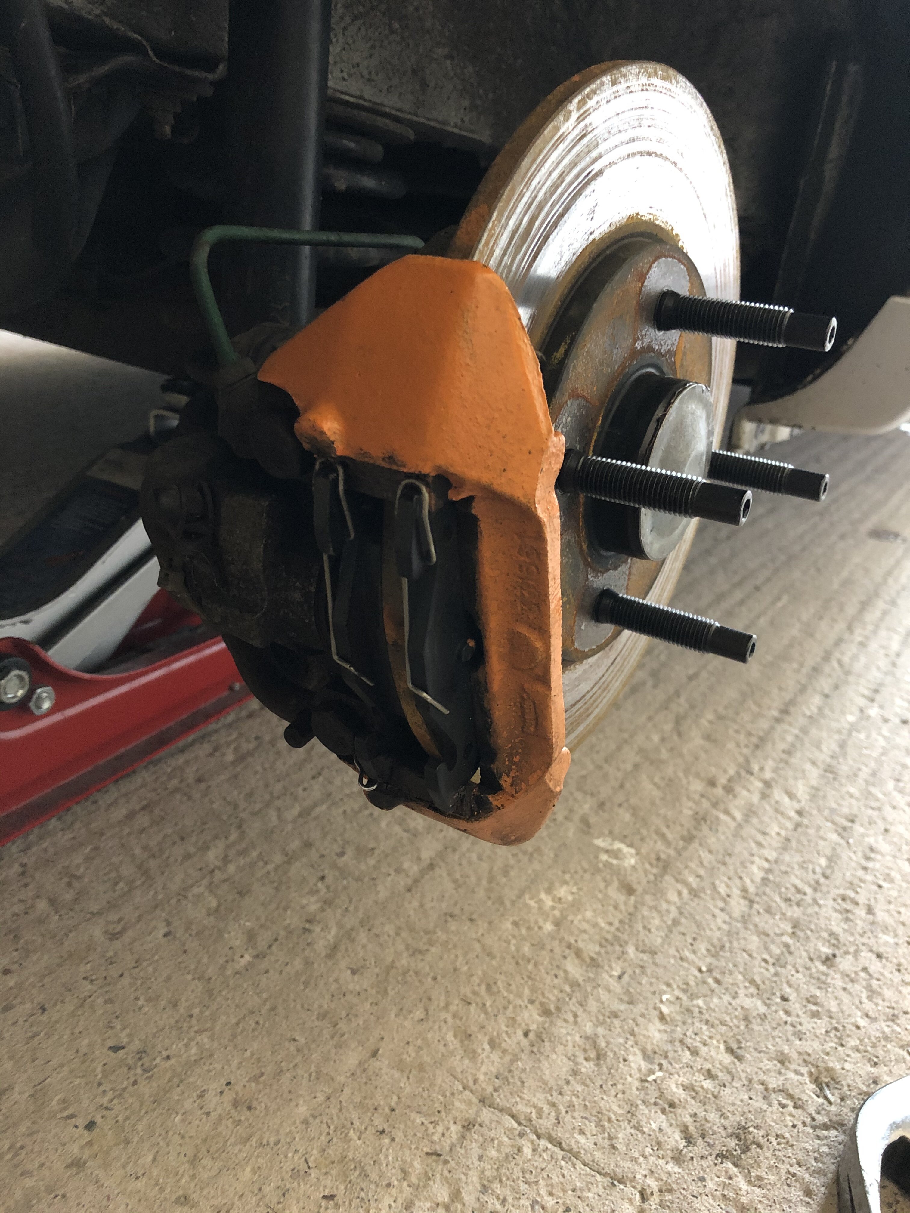

Changed the front discs and pads. What a faff that turned out to be. Got the car in my garage which turned out to be a good call as I needed to leave it for a few days. Driver's side was fine, no issues with that. Passenger was a bit tricker. Got it all apart, putting it back together couldn't get the calliper onto the carrier. Forgot to push the slider pins. Turns out one was seized. Took it all apart again. Hit it with a hammer, heated it up and nothing. None in stock from GSF or ECP. GSF gave me a part number. Found one on Amazon that I could use Prime delivery on to arrive quick. Even said it would fit the car. Turned up and totally wrong - wouldn't clear the disc and the mounting points were all wrong. Ended up getting a genuine one from the garage that changed the cam belt. So a job that was meant to take an hour or so ended up 5 days while I was waiting for parts. Oh well. A little bit annoying as if I had known this I would have been prepared to paint the engine parts while it was in my garage.
Went for Brembo HC Discs and Brembo pads bought from RTR sports. Another little throw back to my old ph1 and painted the callipers orange. Not to everyone's liking but it is a bit of fun. I will probably end up putting 4 pots on it at some point in the future.

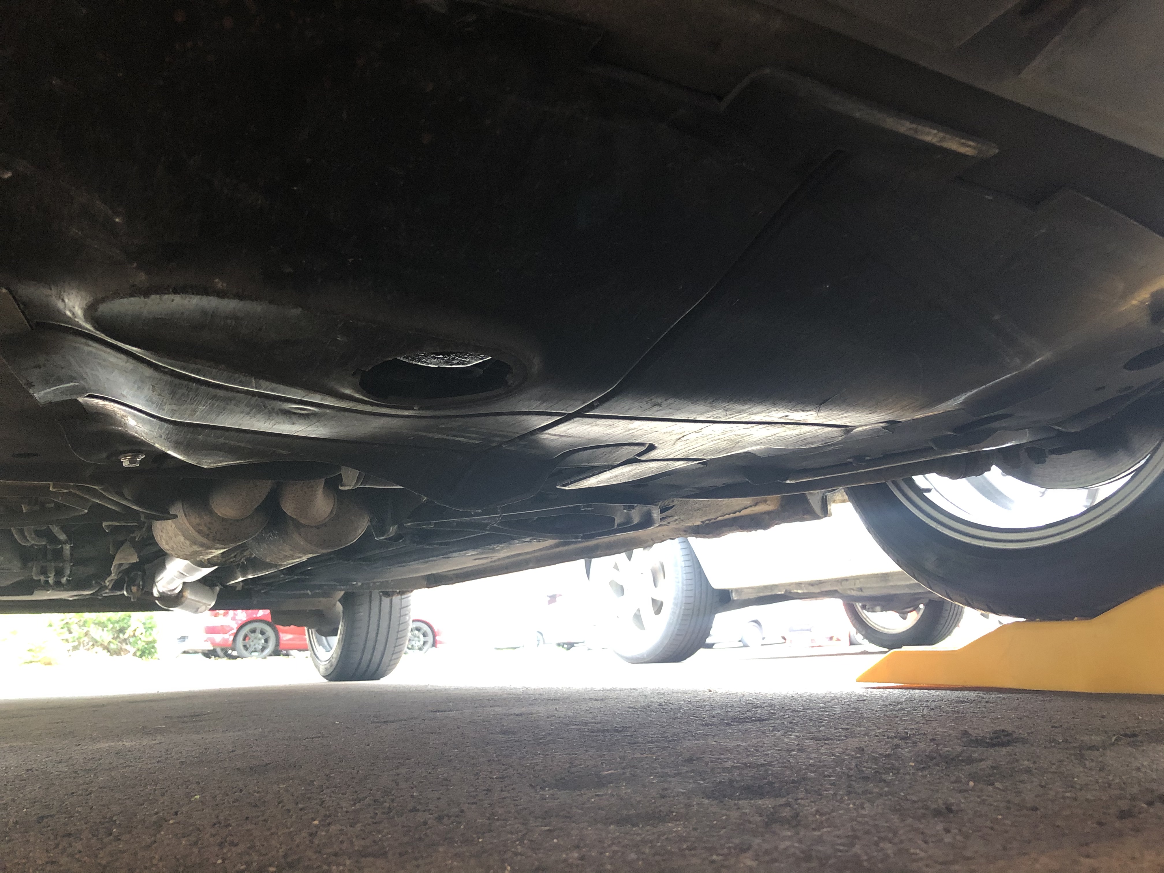

"Fixed" the oil leak that was an advisorary on the last MoT Test.....fitted an undertray.

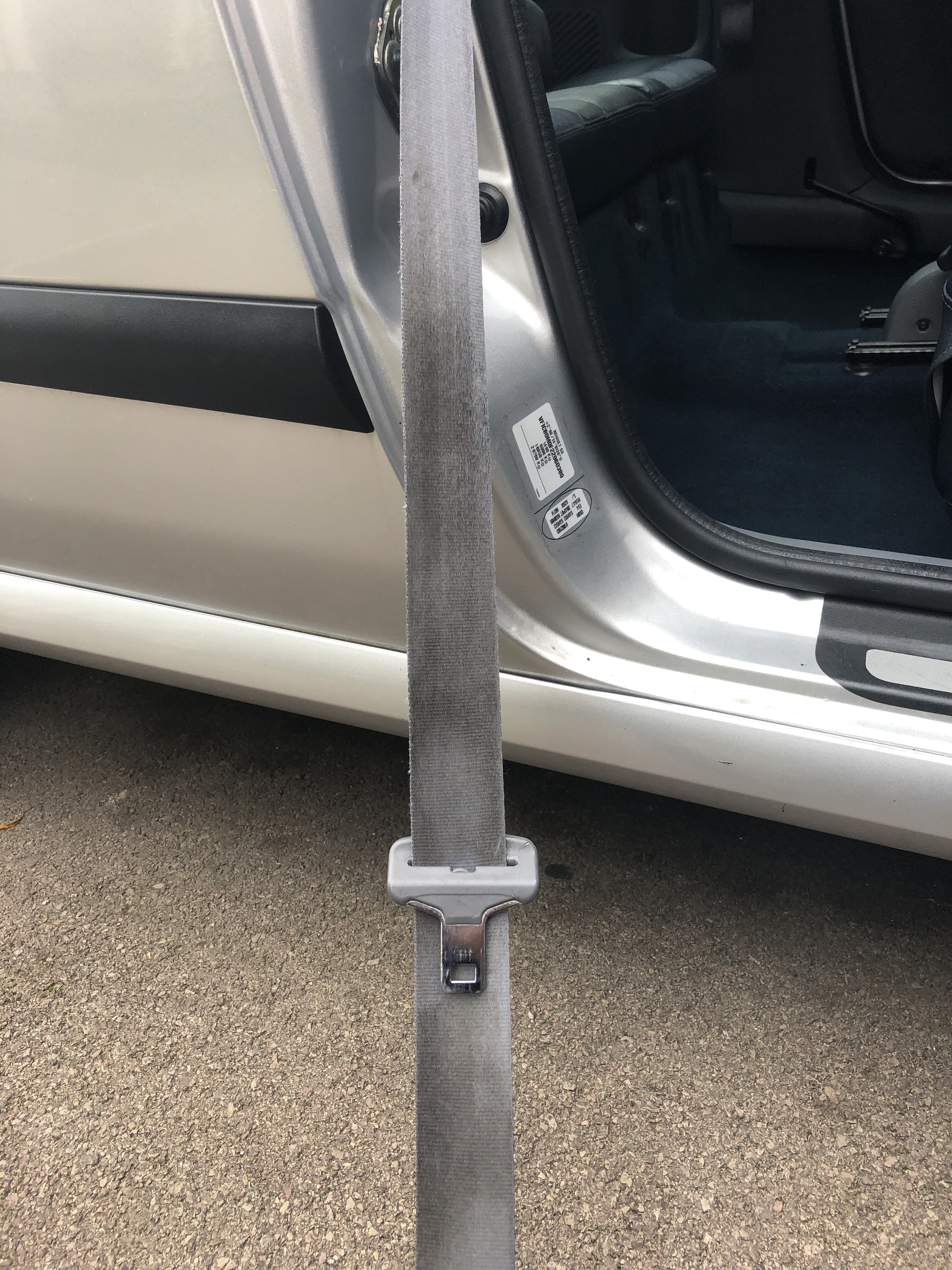

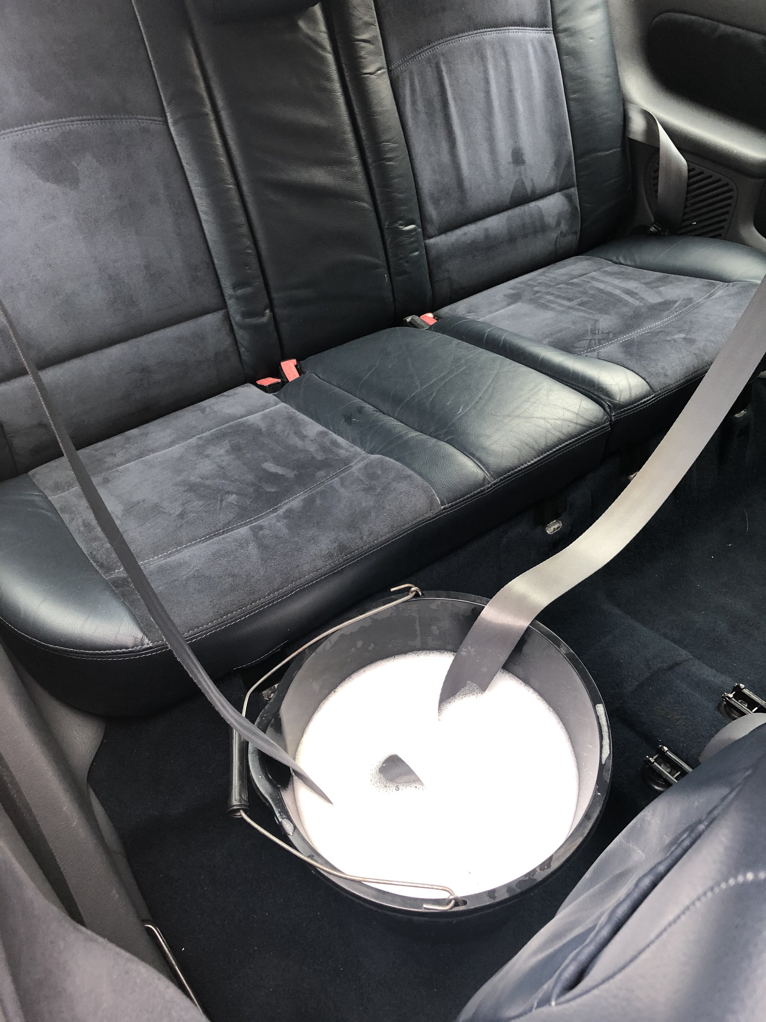

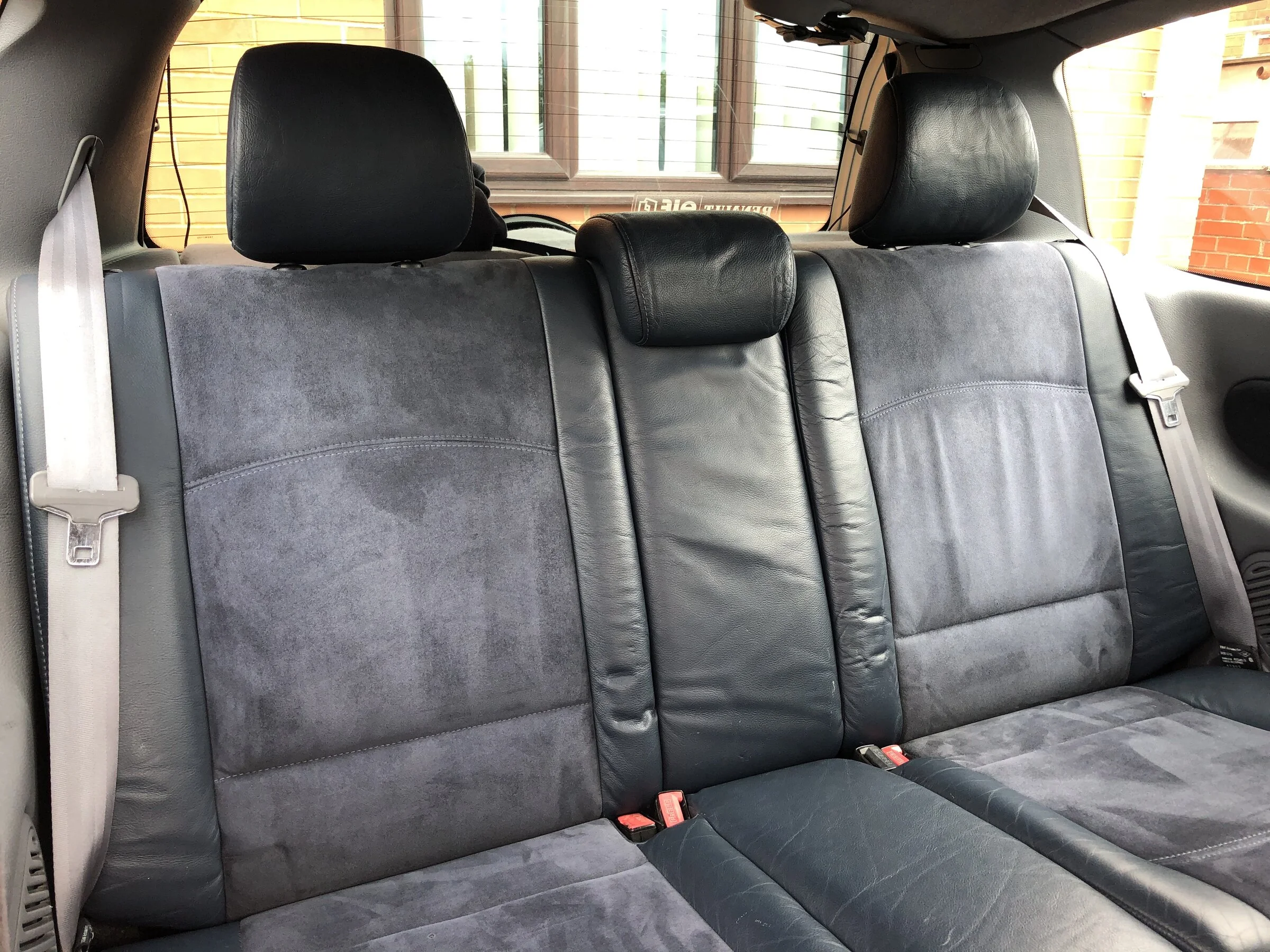

Cleaned my seat bets too. They came out really good. No pictures of after though, but they were pretty grim. Just need to do the rears.

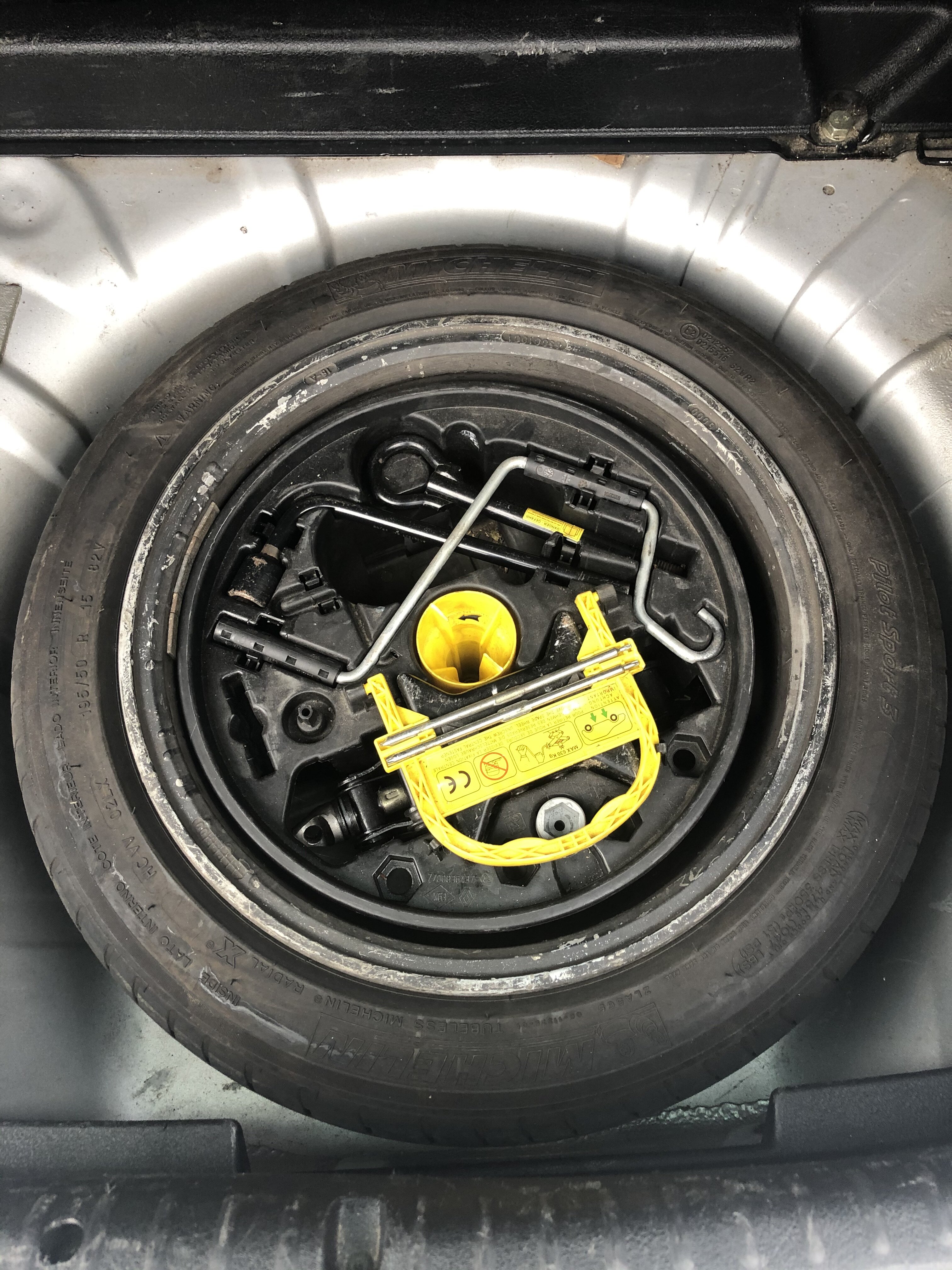

Sourced a spare wheel jack kit thing too.

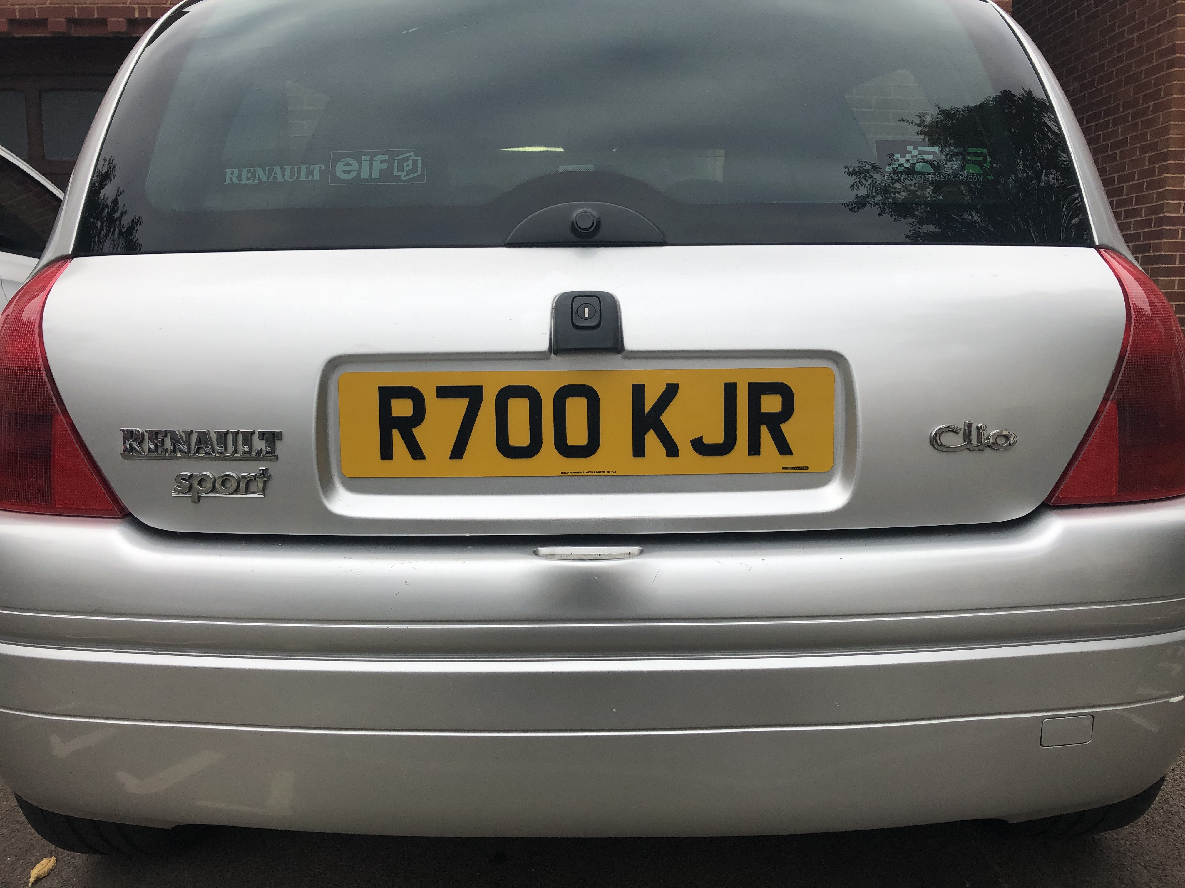

Put my other registration on too. Ever since having my E34 I have not been able to use both my number plates as it is too old. Dug out the old plates I removed from my old vRS and they were in good knick so transferred it over.

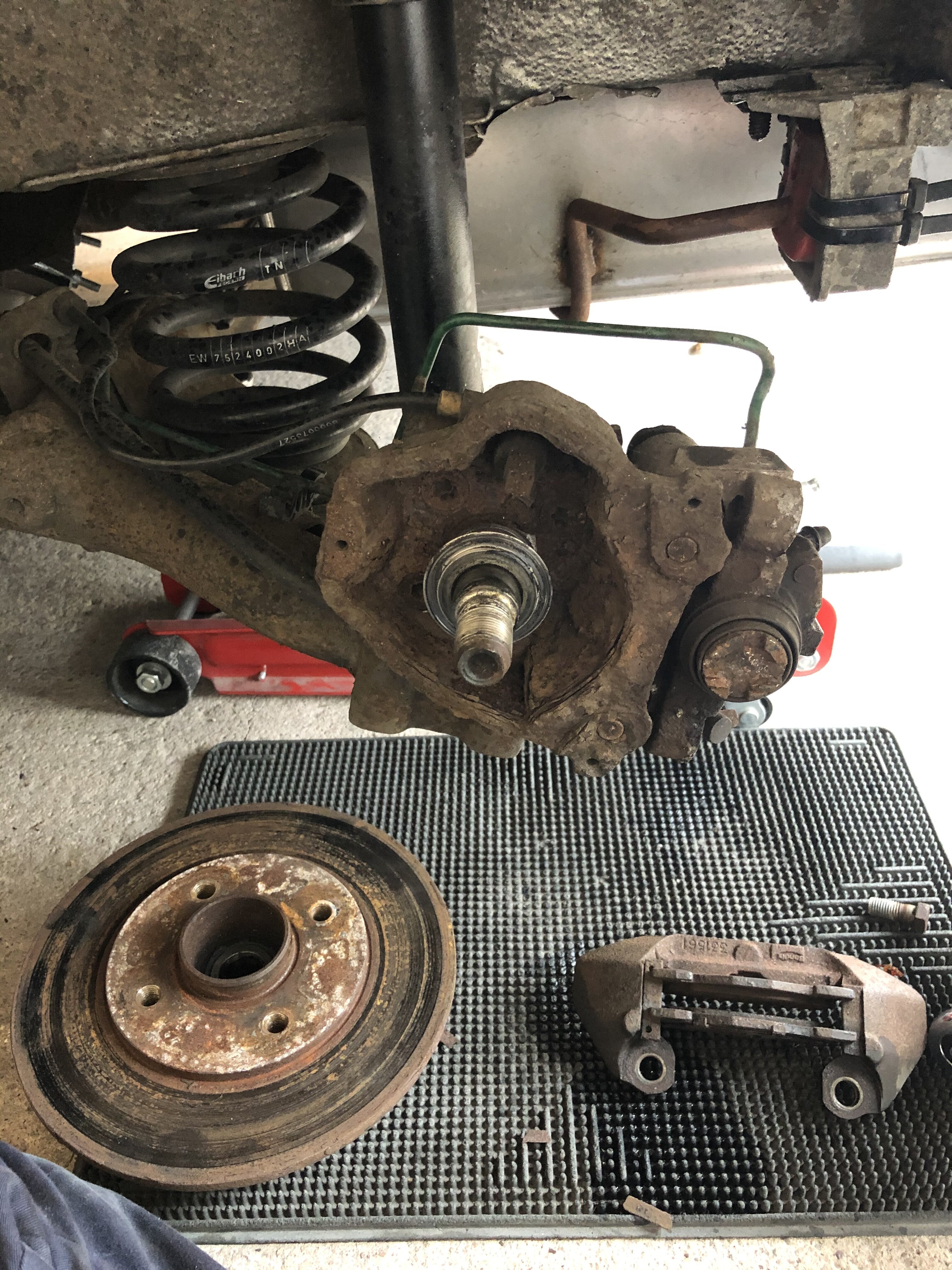

Few more jobs ticked off the list.

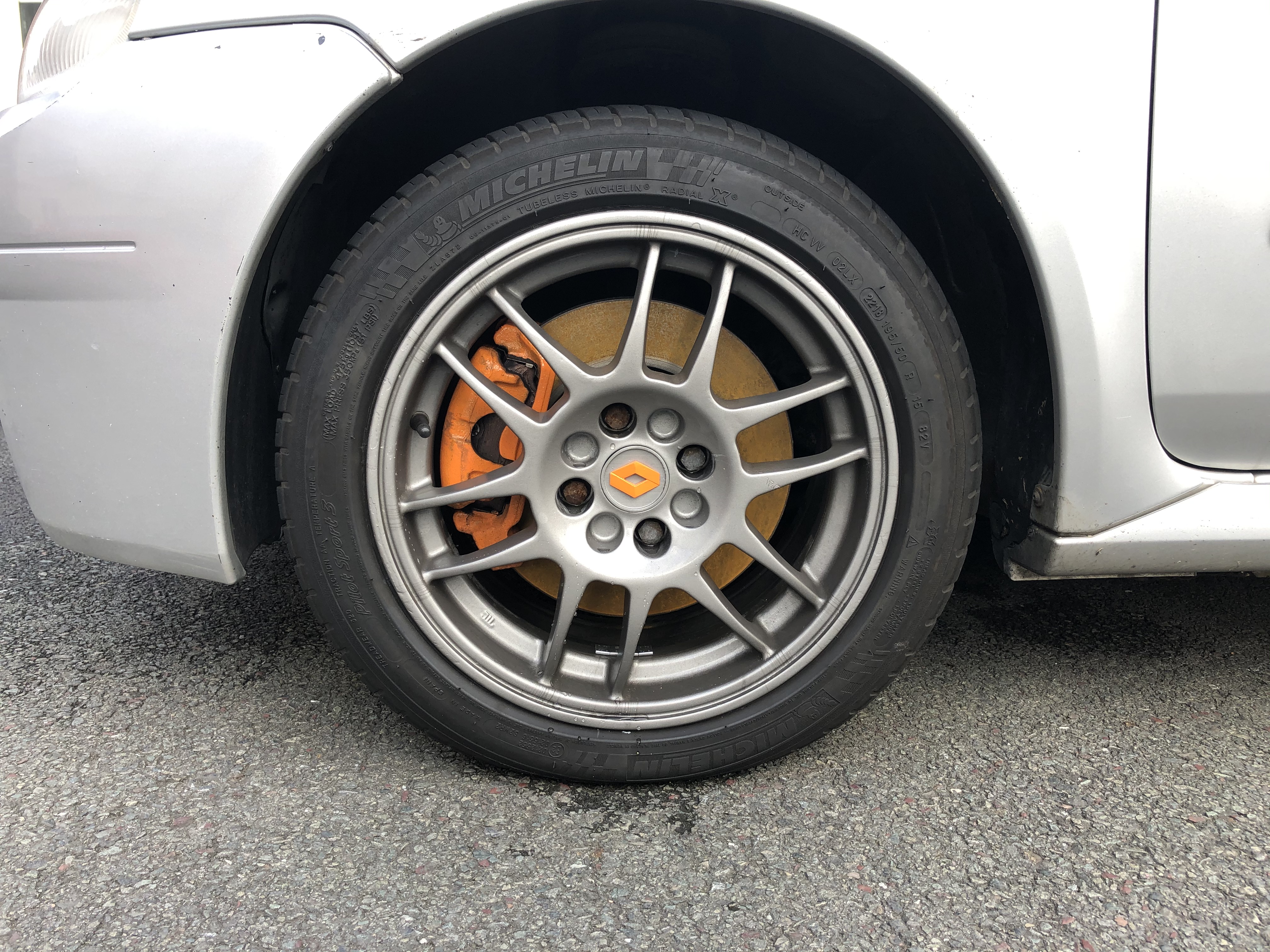

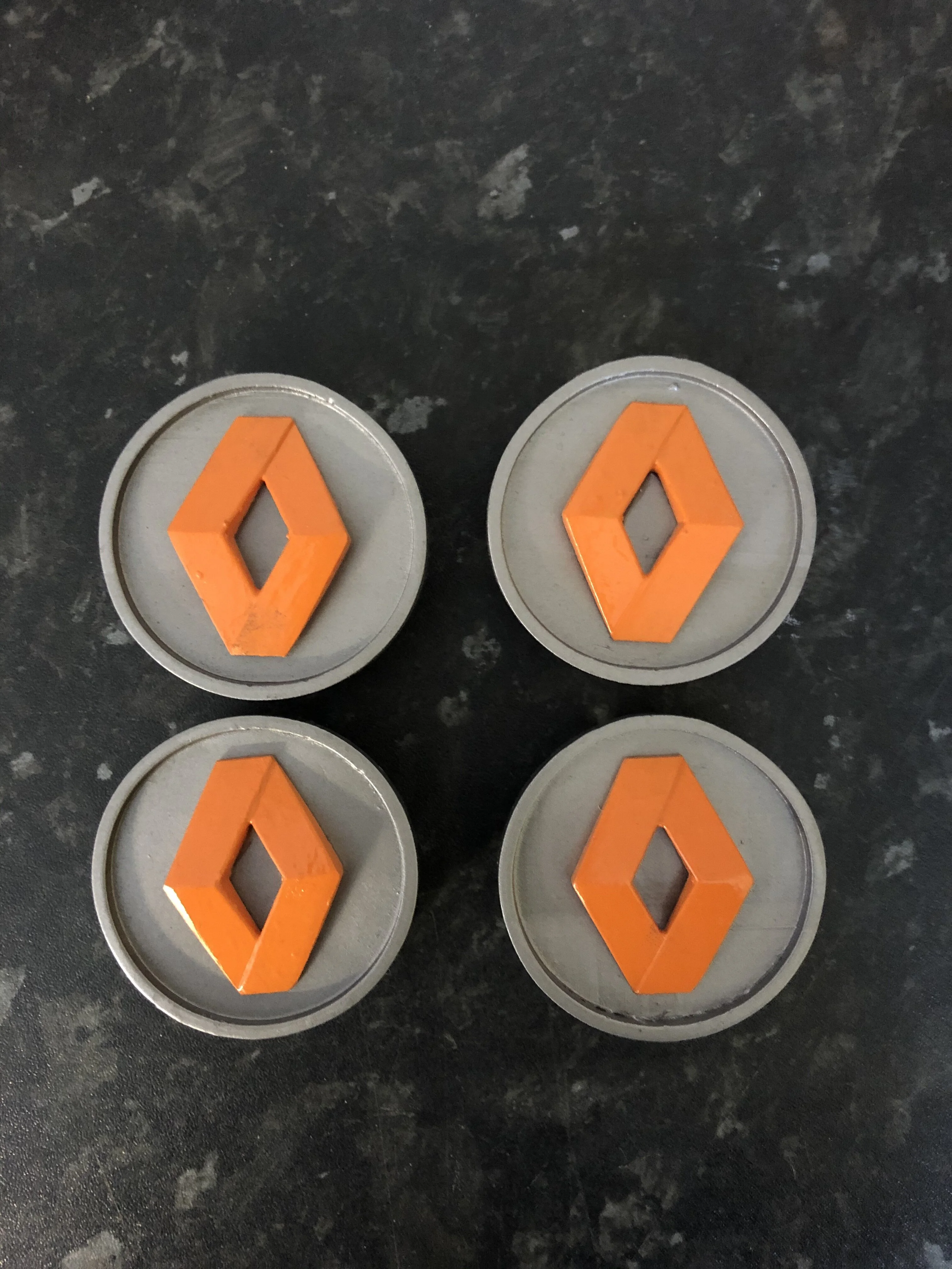

Rear brake discs and pads changed. Genuine discs and Brembo OEM pads along with new hub nuts and those little spacer things.
Haven't got an after picture but yeah they look good! Used it a bit before I fitted the new wheel centre caps to make sure the hub nuts were still tight. They are 3D printed ones from eBay. Painted the same colour as the wheels with orange Renault diamonds. Wonder how long they will last! Ignore the rusty looking dsics, it rained a lot last night and I haven't used the car today.

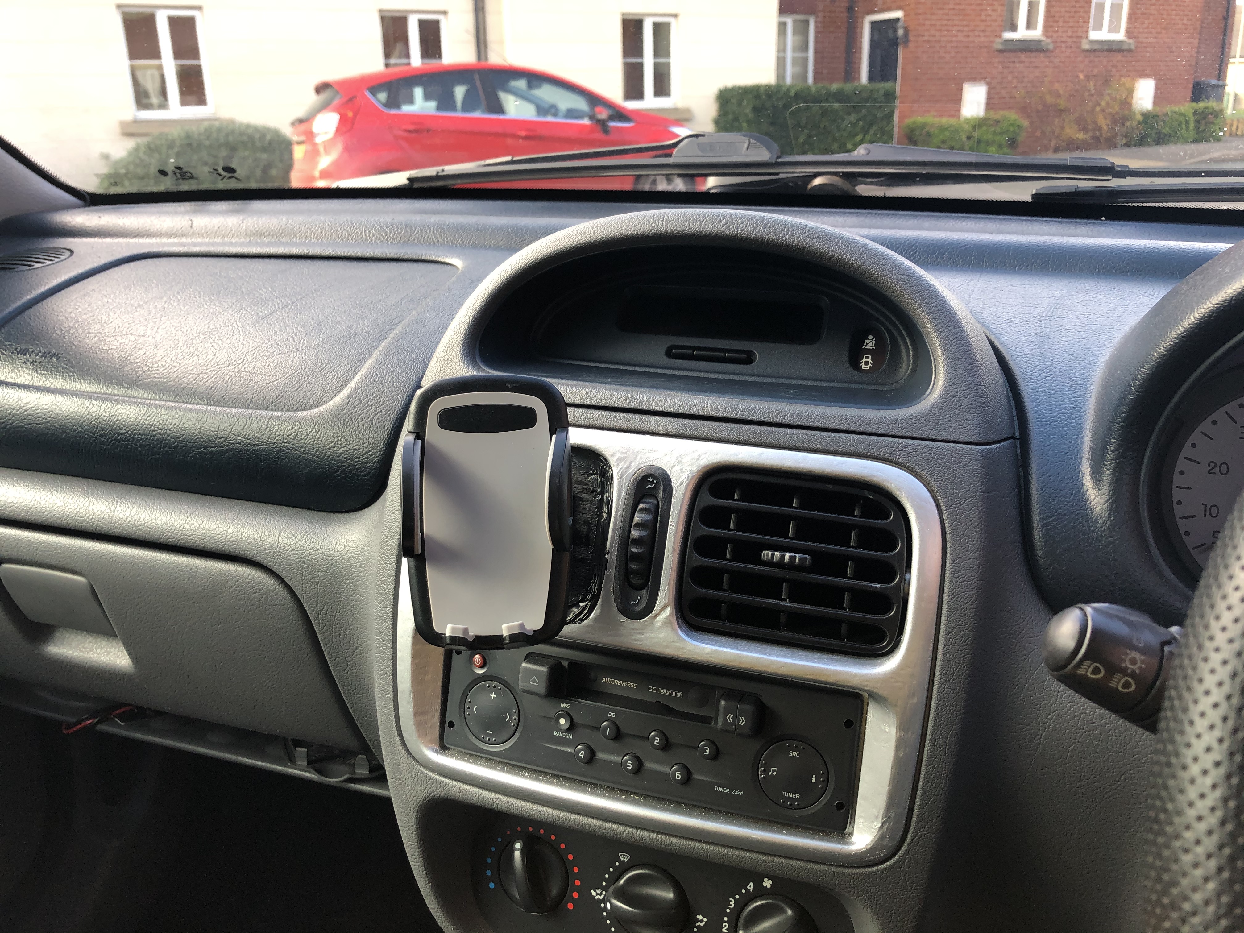

Was missing a centre vent as per most Ph1's. Got a bit creative and made a phone mount. Cut a piece of wood the correct size, painted it black and fitted it with some black grab adhesive. Screwed a phone holder onto it. Works a treat. Not a fan of the ones that stick to the window and this one does not move about like the ones that clip onto the vent. Will be a good addition when this becomes my daily car. One day I might swap the dash for a better one without a missing vent but that is future problems.

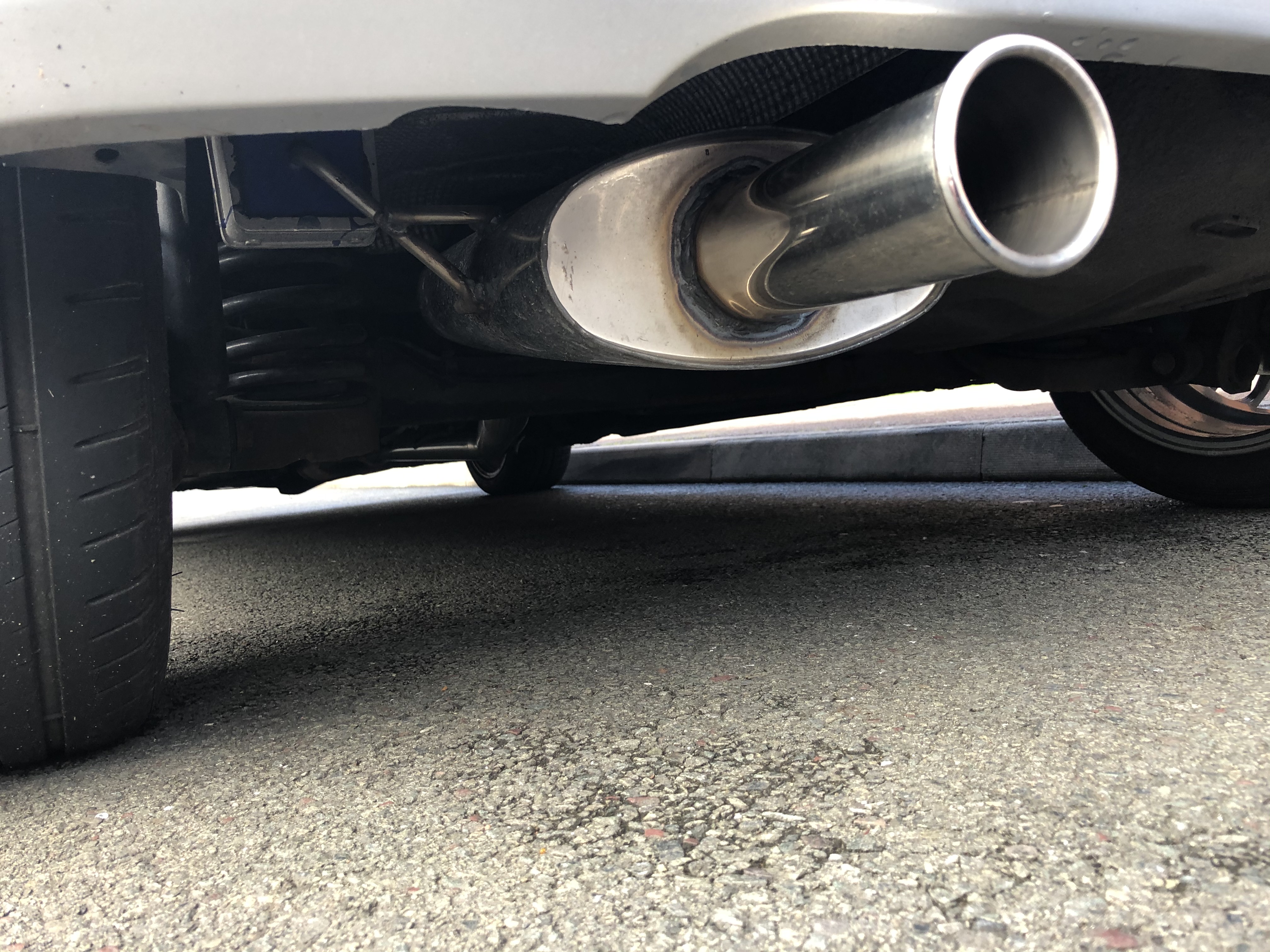

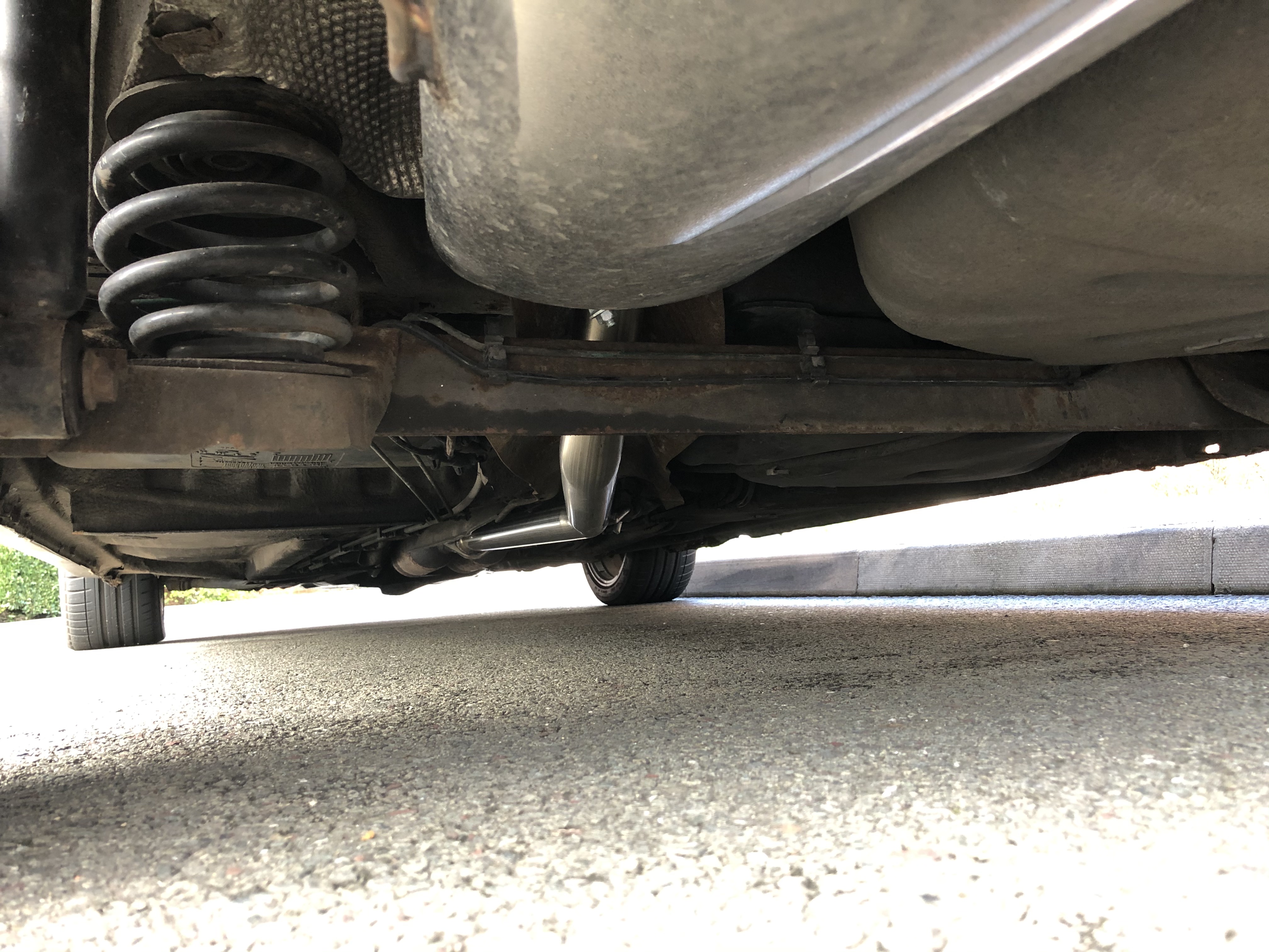

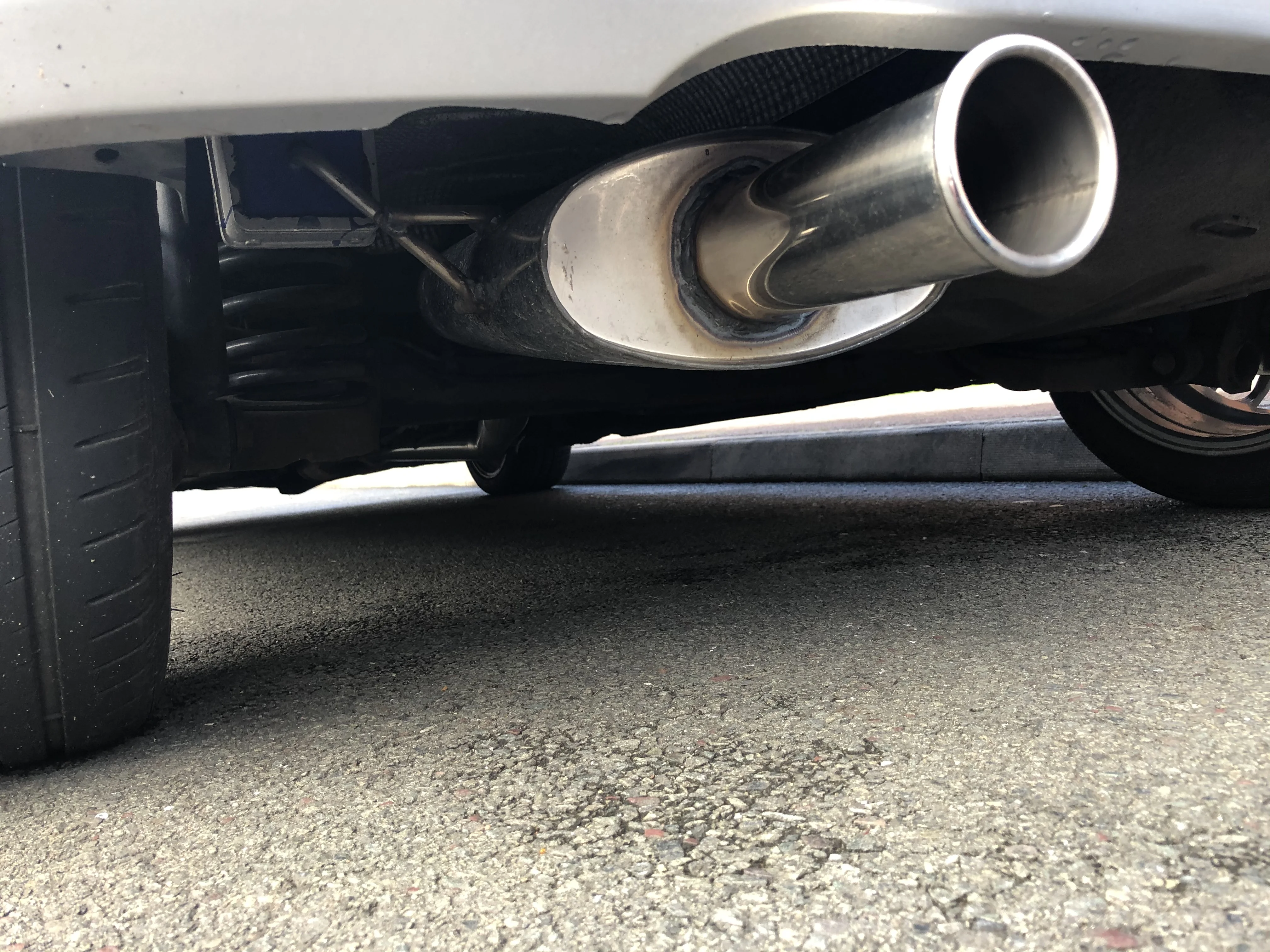

More exciting things happened. Got a new exhaust made for it. Went to the usual place at Infinity Exhausts (they made the one for my old Ph1, Octavia vRS and my E34). Also fitted a new rear exhaust mount. The sound is spot on. Really hard to get photos of it but these will do.

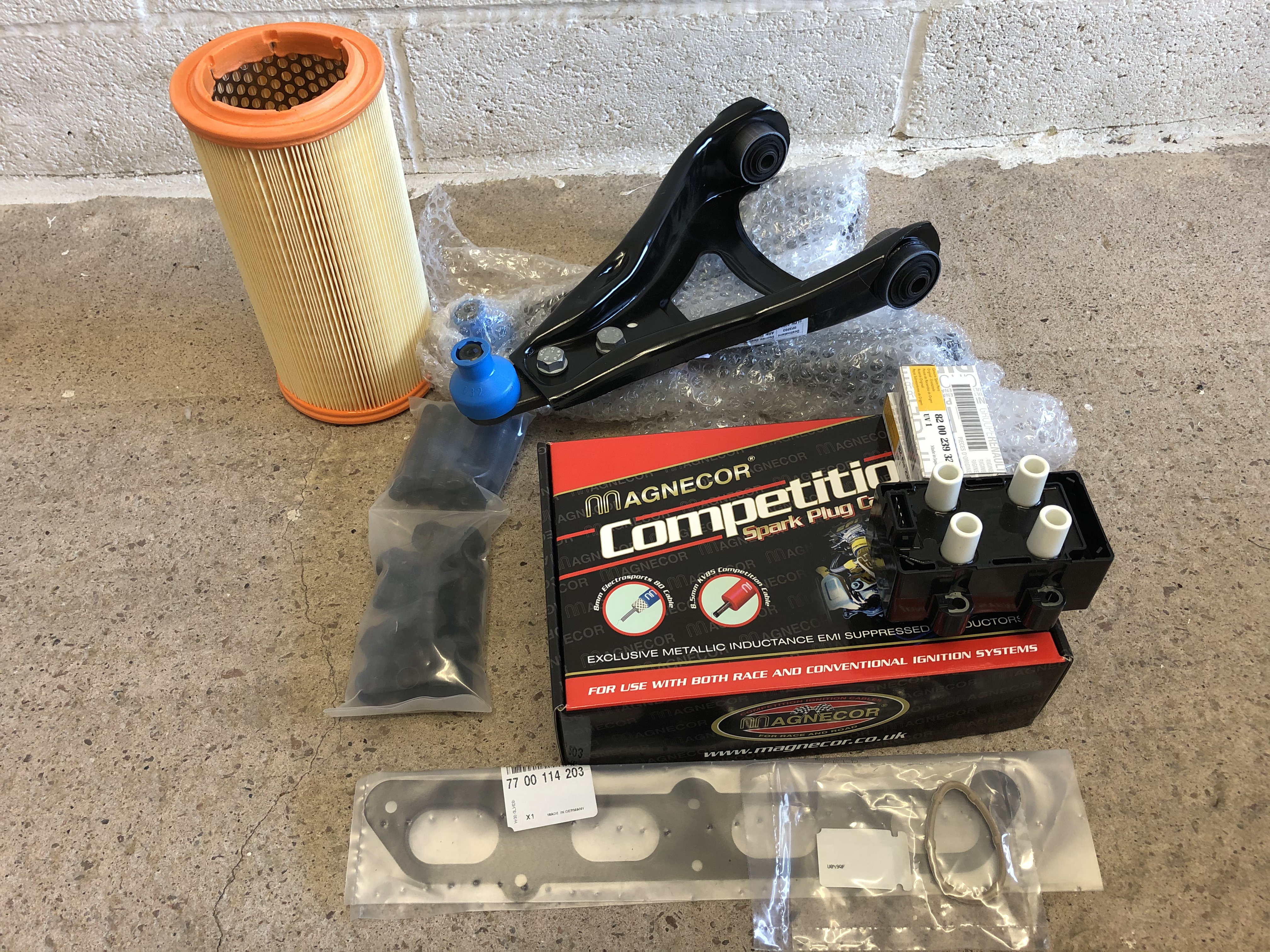

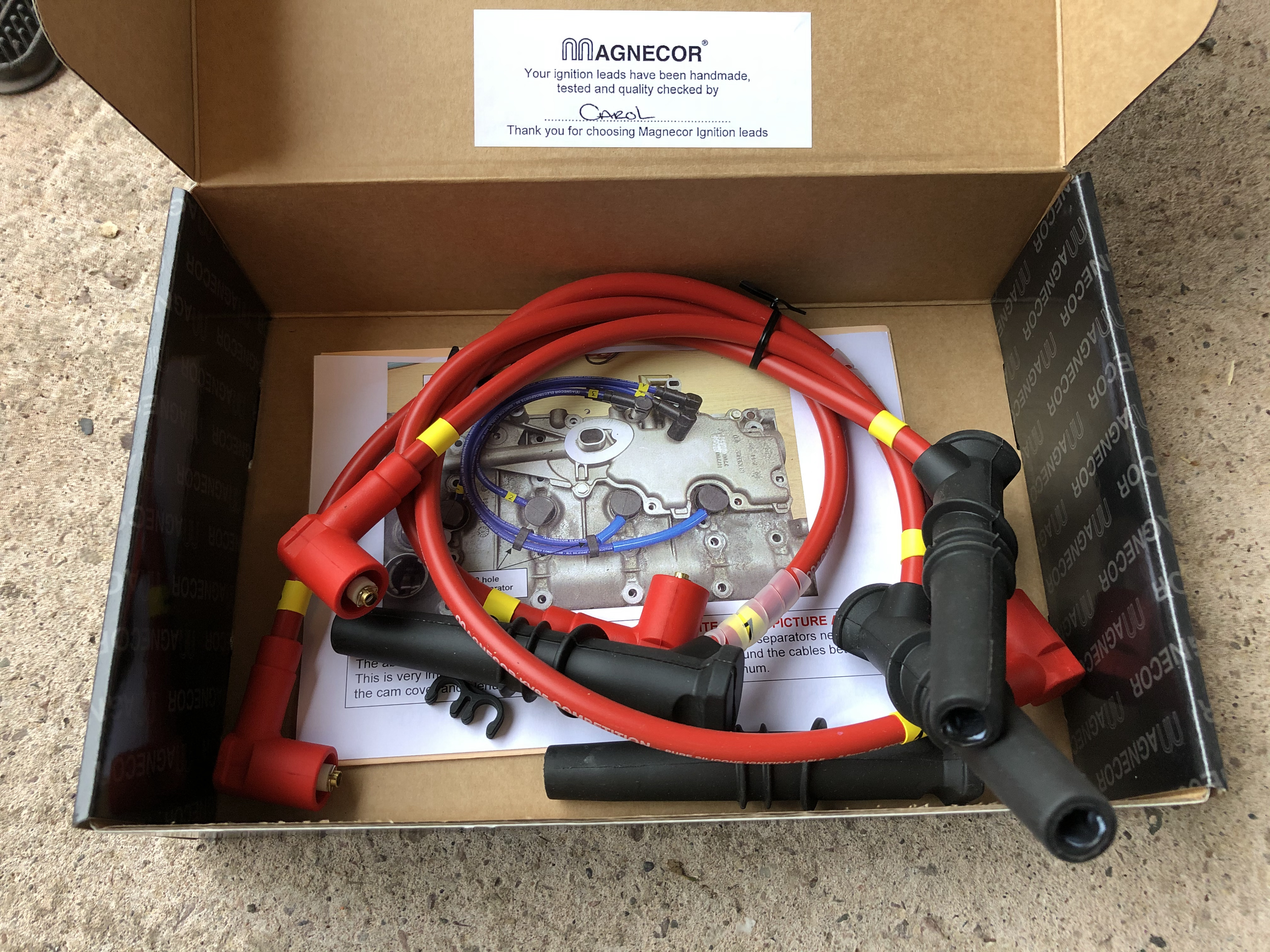

Going to order spark plugs, HT leads, coil pack, inlet gaskets, solid engine mount, heat shield and then get some paint to paint the engine parts up. Try and get this done over Christmas/before January as I will get it into my garage while I do this so need to move my E34 out then back in so then i can SORN it before I need to re-tax the Clio.

Hope the new plugs, HT leads and coil pack will give it a bit of zest again.

Now that the exhaust is sorted, as it was undrivable with how much it banged was unbarable, plus the tracking being done it's made me really pottering about in it. Once the kncoking noise is sorted then I will be more than happy to use it more often as I don't know what it is and want to get stuck if the driveshaft/steering rack fails. It has to be one of those two - receipt from 2015 mentions a knocking driveshaft and needs replacing but knocks without the car rolling which makes no sense if it is that. First job in the new year.

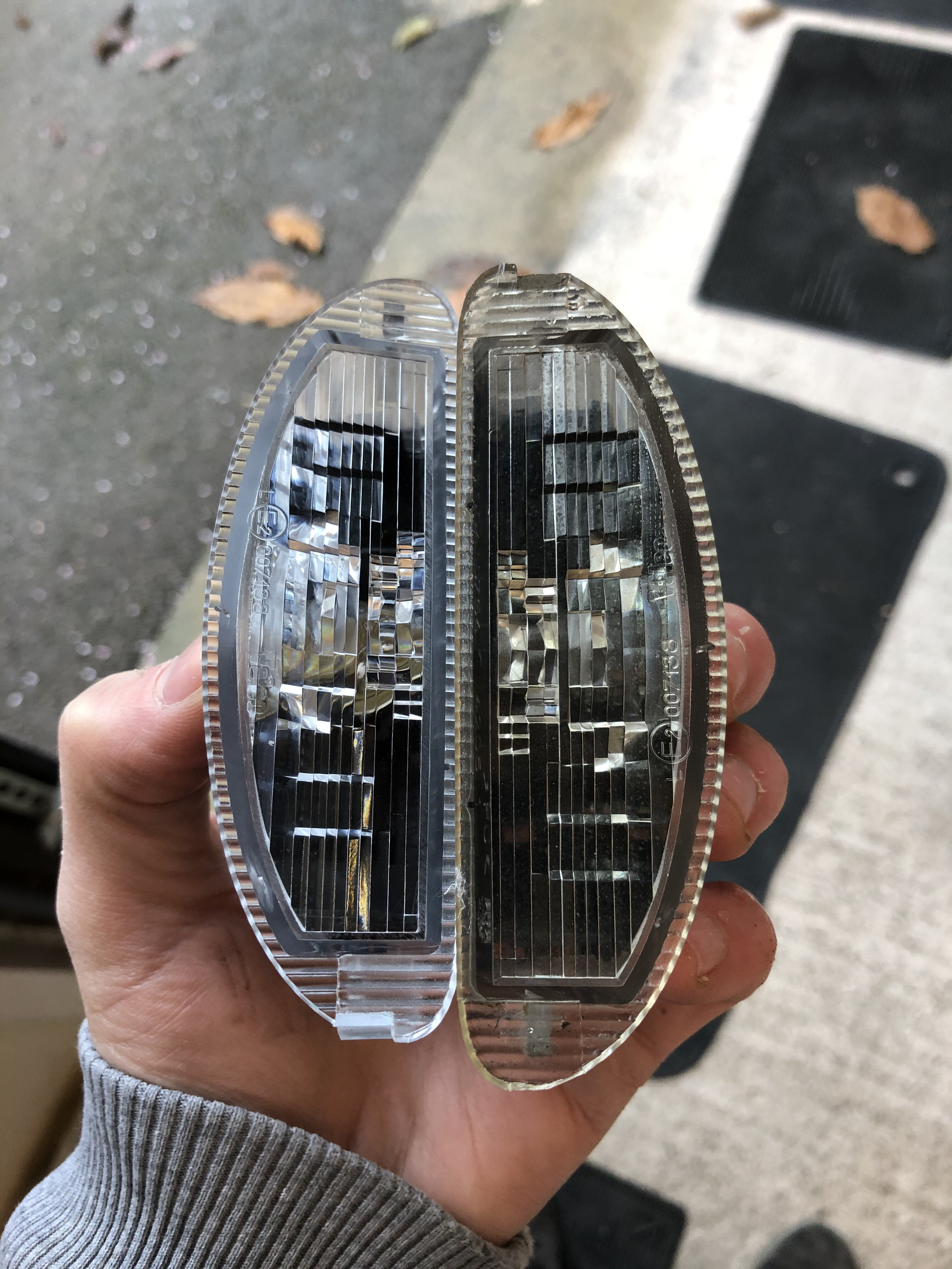

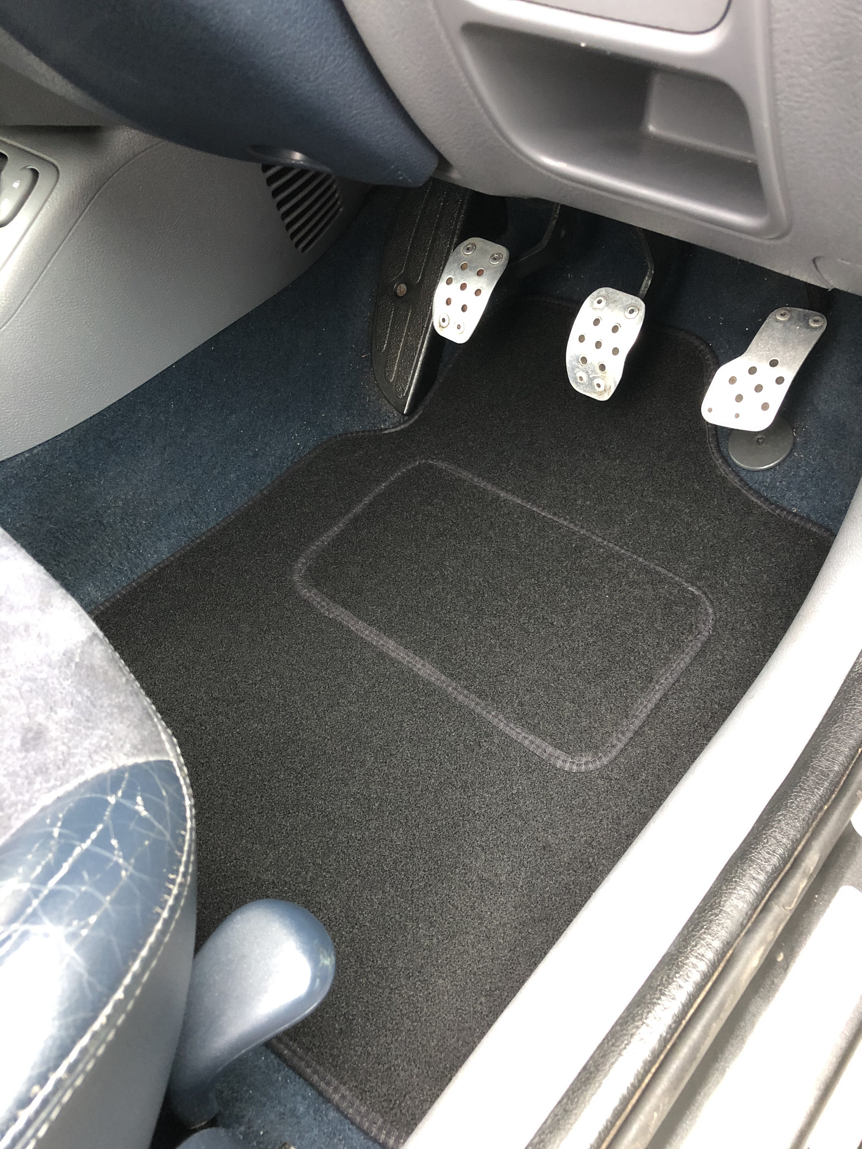

Oh and I got some mats for it and a new rear numberplate light

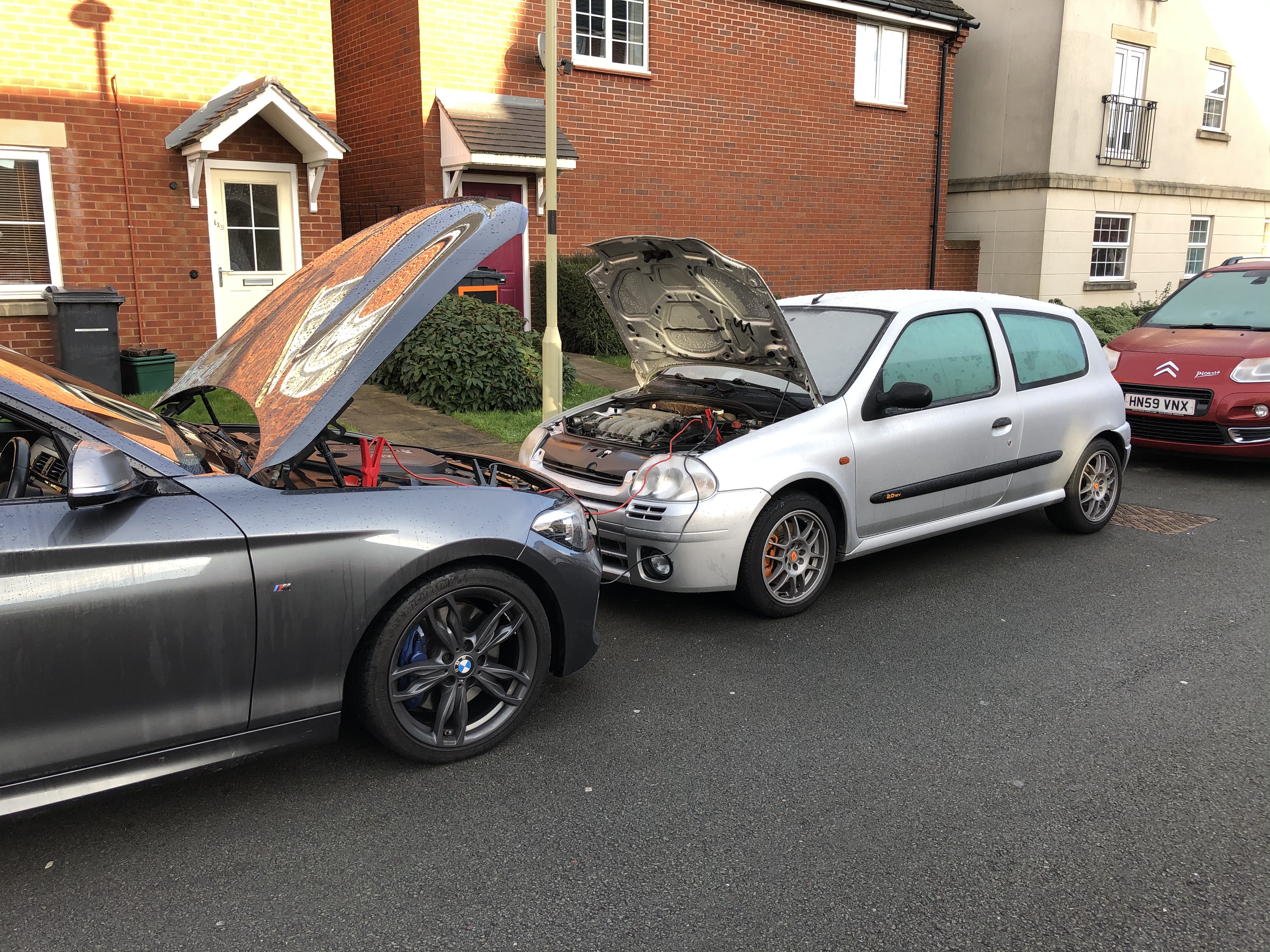

Car decided it wanted to be eco friendly today and fire on les cylinders than 4. Great. What was odd and not seen before is the immobiliser light was quickly flashing after I started it. Then it ran like a sack of crap. Hadn’t been used for two weeks and we had all that rain the other day. Left it running for about 20mins and it didn’t get any better. But today is not the day to rev it and try and clear it as I’m sure it’s just got a bit damp. Although I have new plugs, coil pack etc to go in.
Nice thread ! @KitsonRis Could you show a photo of your steering wheel with that cover on ? Wanna see how it looks because planning on doing same on mine.
Gone to start it now, key wouldn’t unlock the central alarm. Manually unlocked the door (probably shouldn’t have done) then the hazards came on and the little light by the gear stick is on. No alarm sound (thankfully!) car was very weak to start again and then the hazards/alarm(?) didn’t go off. Then I got out still running shut the door and then it went out. Back on and off again. Battery is reading 14V charging. Wonder if the flat battery is causing the immobiliser not to disarm? Keeping it running for the time being, although static reviving isn’t showing signs of less than 4 cylinders and it idles fine. Will test the battery again later to see if it has held charge.
Damn thing!!
Next lot of work is to finish the service stuff off and pint engine parts. Moved my E34 out of my garage and storing it elsewhere so I can get the Clio in so I can use the garage as a spray booth and also have it off the road. Greeted with a flat battery on in the E34
Then went to start the Clio and that was also dead, but was expected due to the battery being duff.
So one out of three cars started first time this morning. Clio also was still running like a bag of nails still, crap idle was also popping under the smallest of throttle input. I am guessing that that is due to firing on 2/3 cylinders. Hoping the new coil pack, spark plugs and HT leads will sort that out. It hasn’t been used for a while so it’s probably just a bit damp somewhere. Hasn’t thrown an EML error but might scan it and see if there is something that has been logged

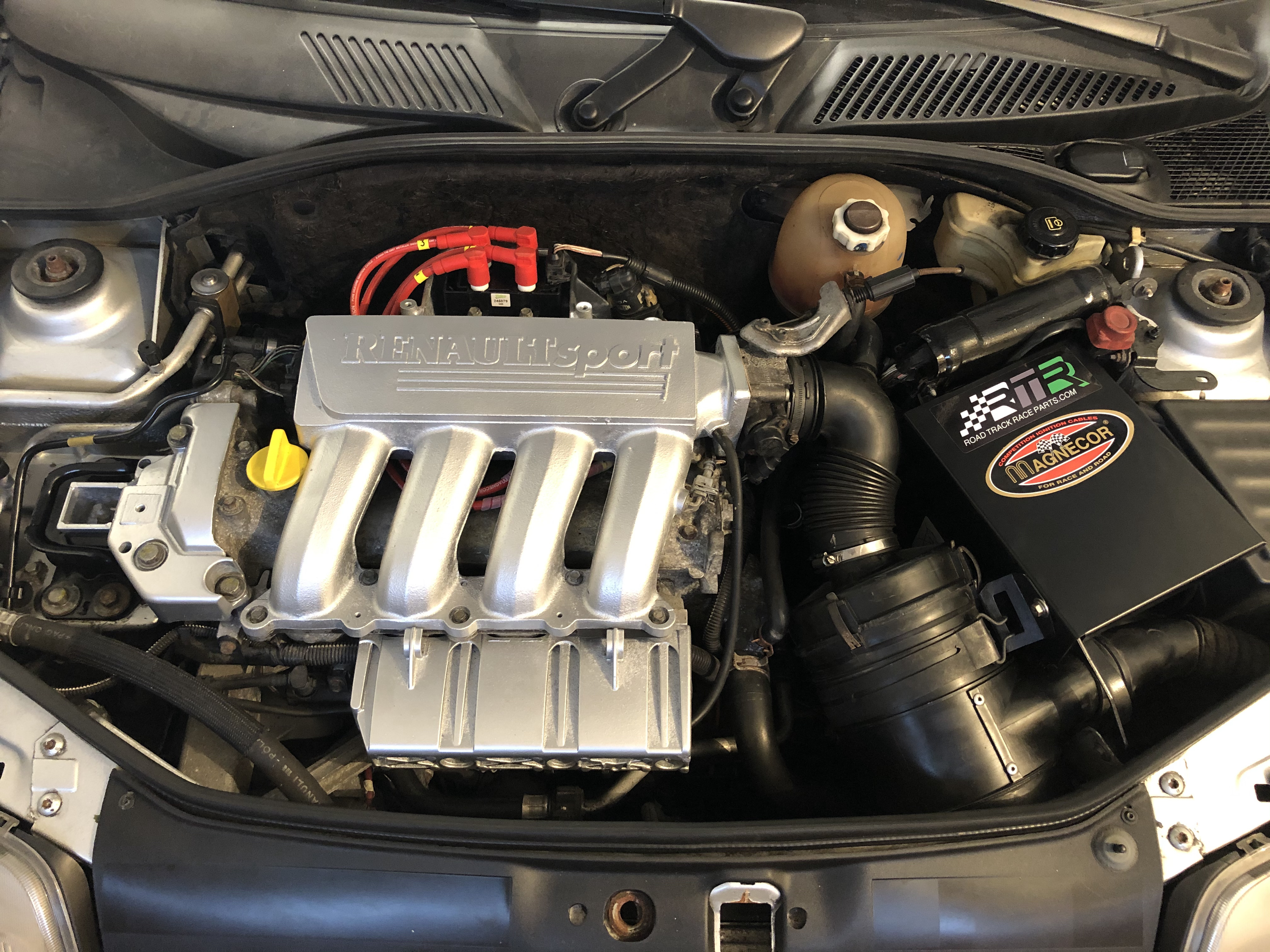

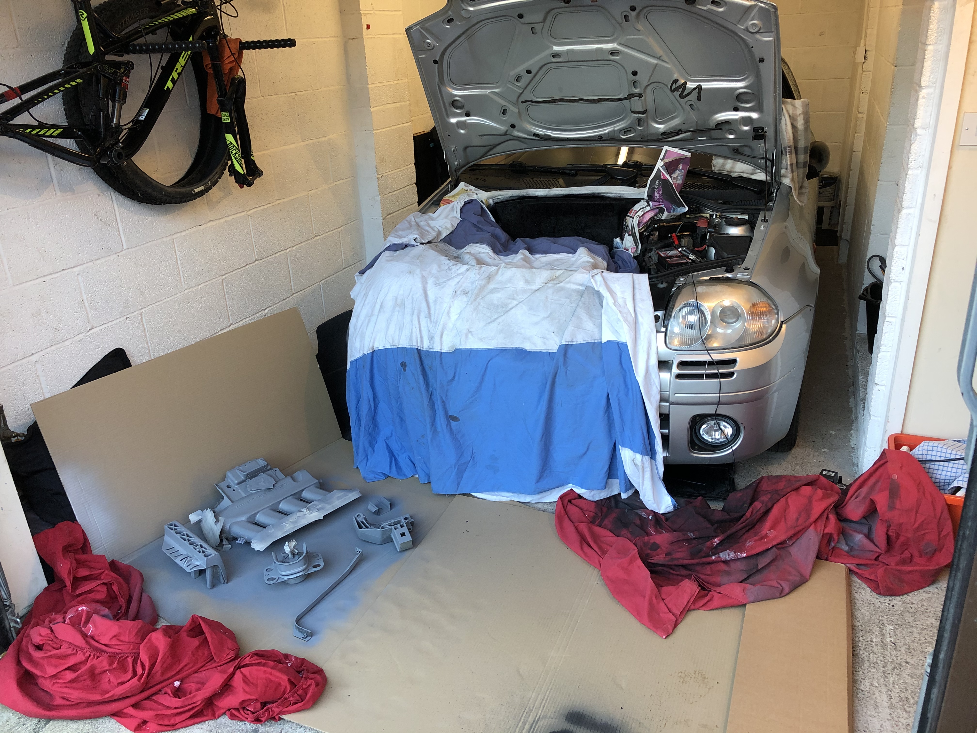

Then I stripped the engine parts out and have started to paint them. They are going silver and going to paint the engine cover orange. Took @Coops Mk1 tip and used the Autoglym die for the heat shield fabric. I am very surprised with it and looks really good. It will do until the engine is removed and I can swap it out for the metal stuff.
Just need to do a few more coats of paint throughout the week and can then put it all back together and see if I am running back to normal!
I'll start with the good progress....

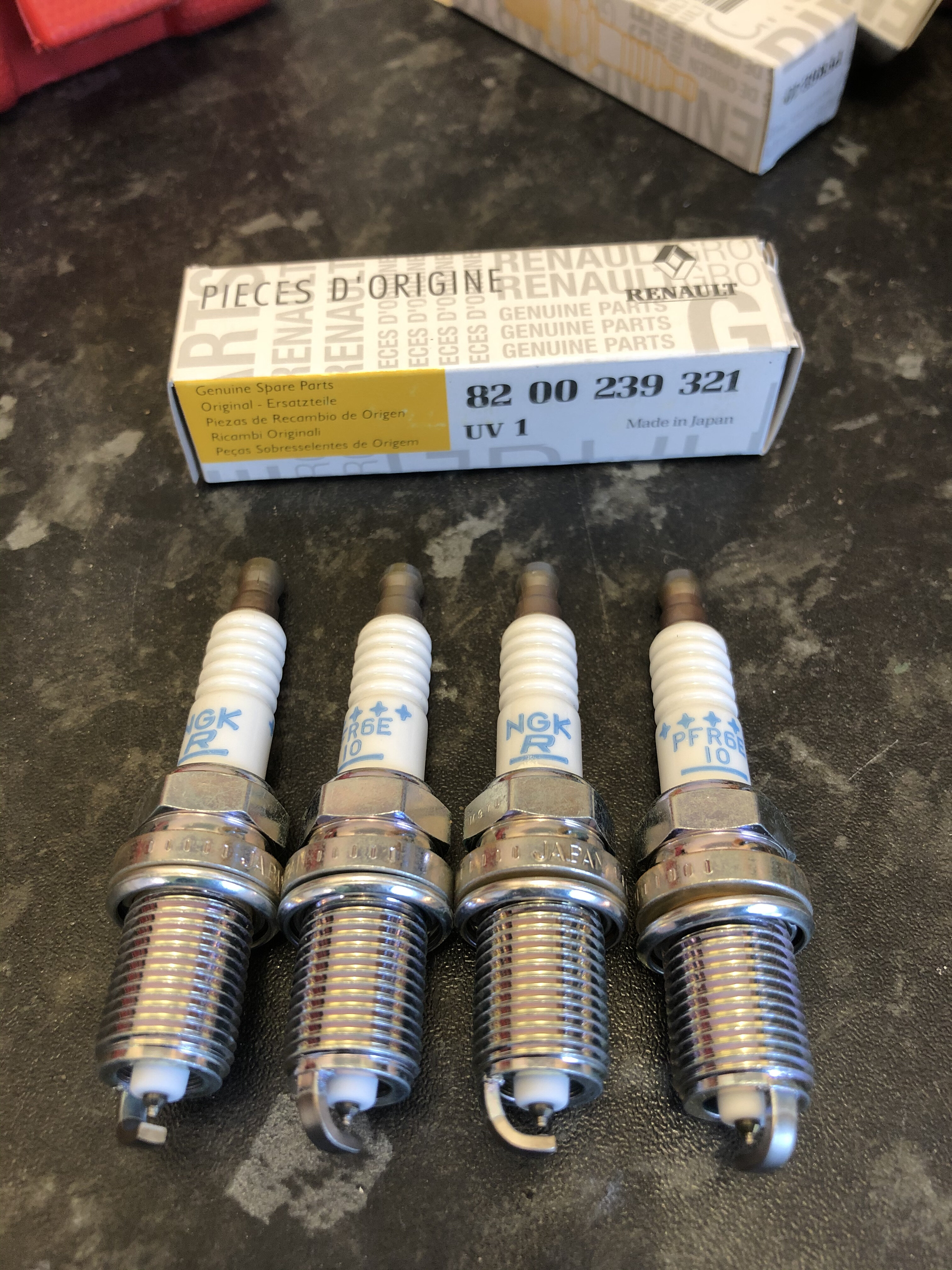

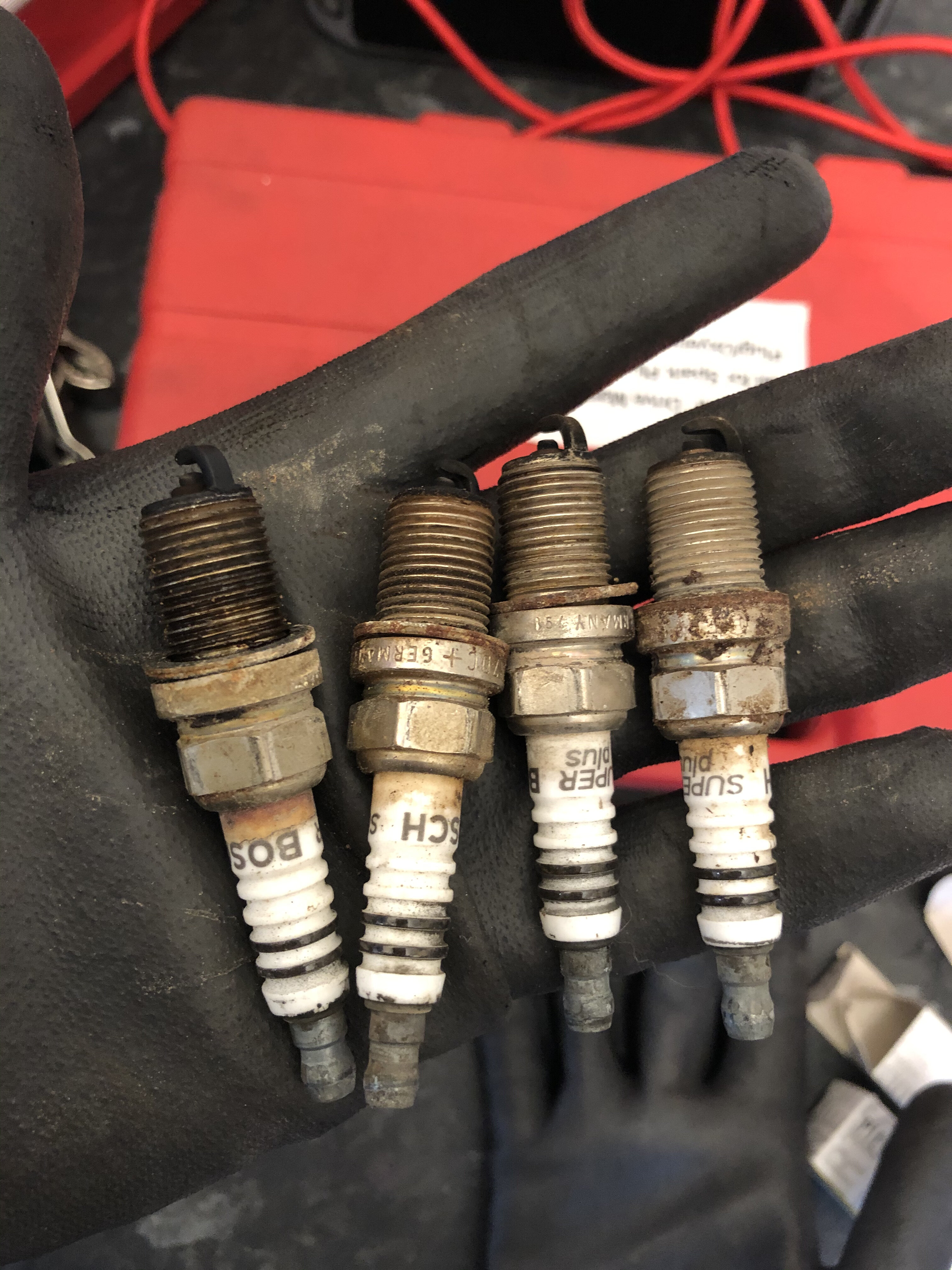

Managed to get what I wanted done regards to the rest of the service items. Now has new genuine Renault spark plugs, new coil pack and Magnecore HT leads. Did notice some of the retaining tabs on the MAP and inlet temp sensors have broken so have got some on order to go back on. Also had to get a new upper inlet as the one I took off had some sheared bolts in. I did order some genuine new bolts which haven't turned up yet but managed to salvage enough from the current and some that were supplied with the inlet. When they do arrive I will be swapping over for some shiney new ones. Gave the throttle a good clean too while that was off, but I know it is only time until it gets plagued by the typical Ph1 sticky throttle.
Old ones looked alright but now I know they have been done.

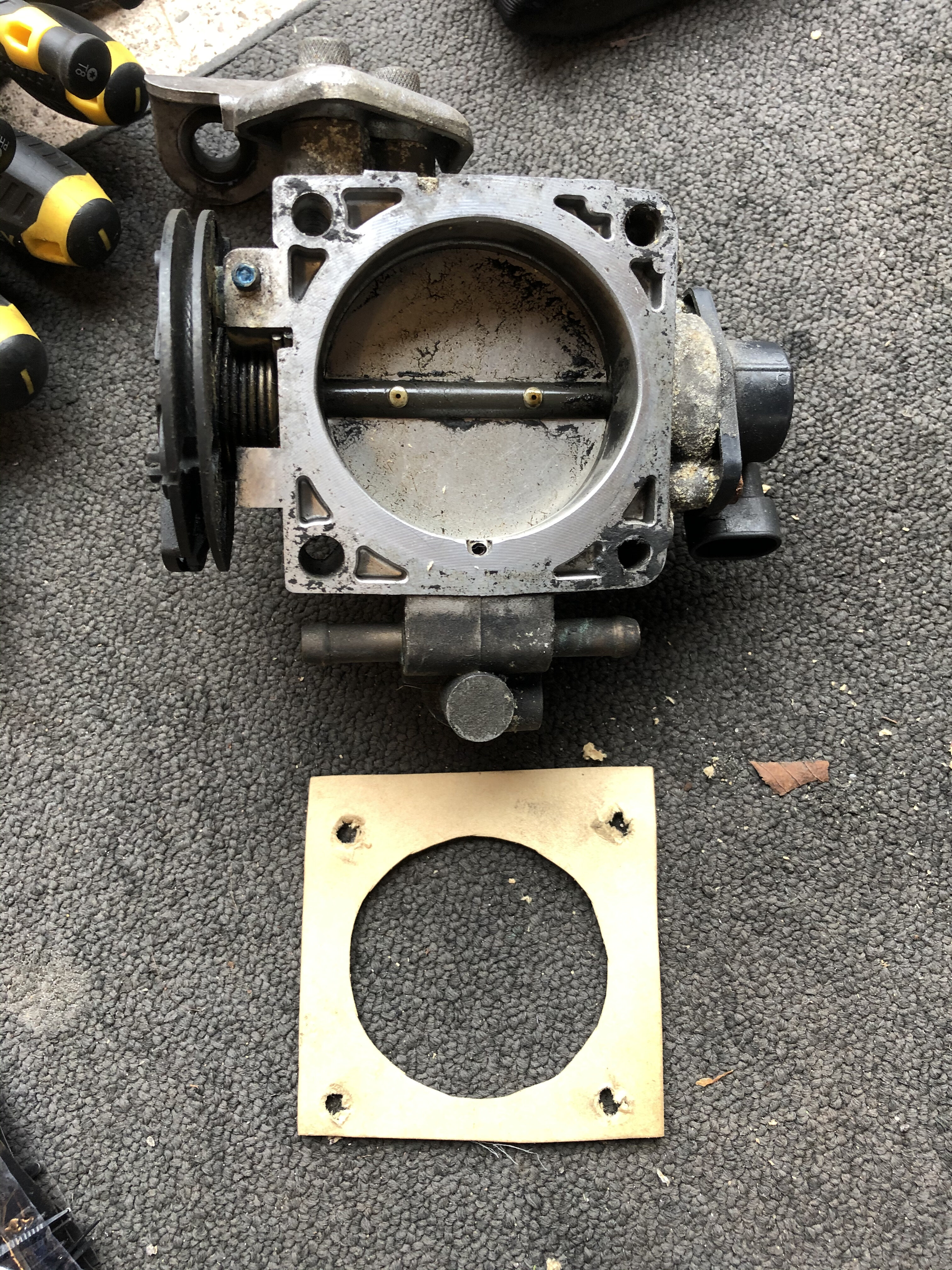

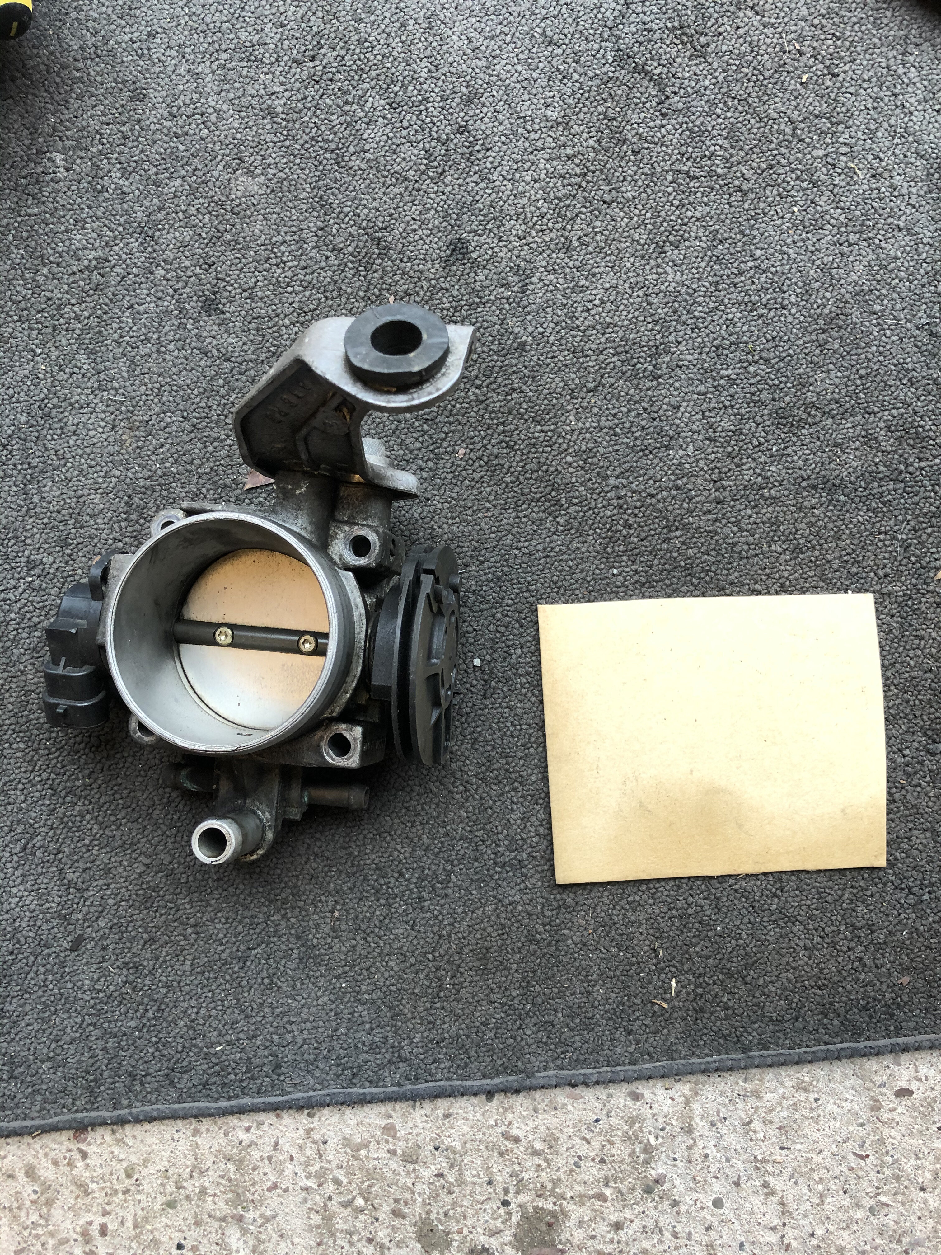

Had to get a bit old school with the throttle gasket and made my own as apparently they are not available anymore
Also fitted a Powerflex engine mount insert while I was at it. Now the engine bay is looking good. I need to get a new coolant bottle but will do that when I change the hoses and the coolant is all out. Have an engine cover I am going to put back on, just need to source the oil filler flap as mine was missing
