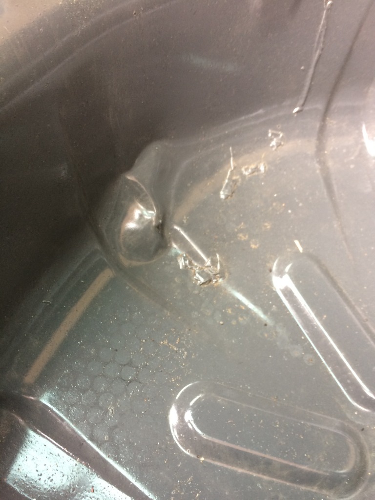

start off with some bad stuff.....had a phone call from my brother the other week (the last time he called me was when my dad was rushed to hospital a few weeks before so I was sort of worrying) as his girlfriend drove into the Clio. Great. The car is at the back of a driveway 4 car lengths long. So she drove onto the drive then continued for three car lengths before hitting mine. How we are not sure. If it wasn't my car she would have hit the house (rather my car than the house). My brother had a look when it happened but was at night so not good light, but said there was no vsible damage and that all the boot shut lines and bumper was all even. No cracked bumper or anything. Got a chance to look at it in the daylight yesterday (wasn't going to rush over when it happened as there was no damaged bumper or any visible damage). Turns out she moved the car quite far as you could see the tyre marks on the drive. Pretty sure it was where my index finger is and not my thumb

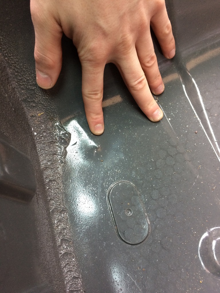

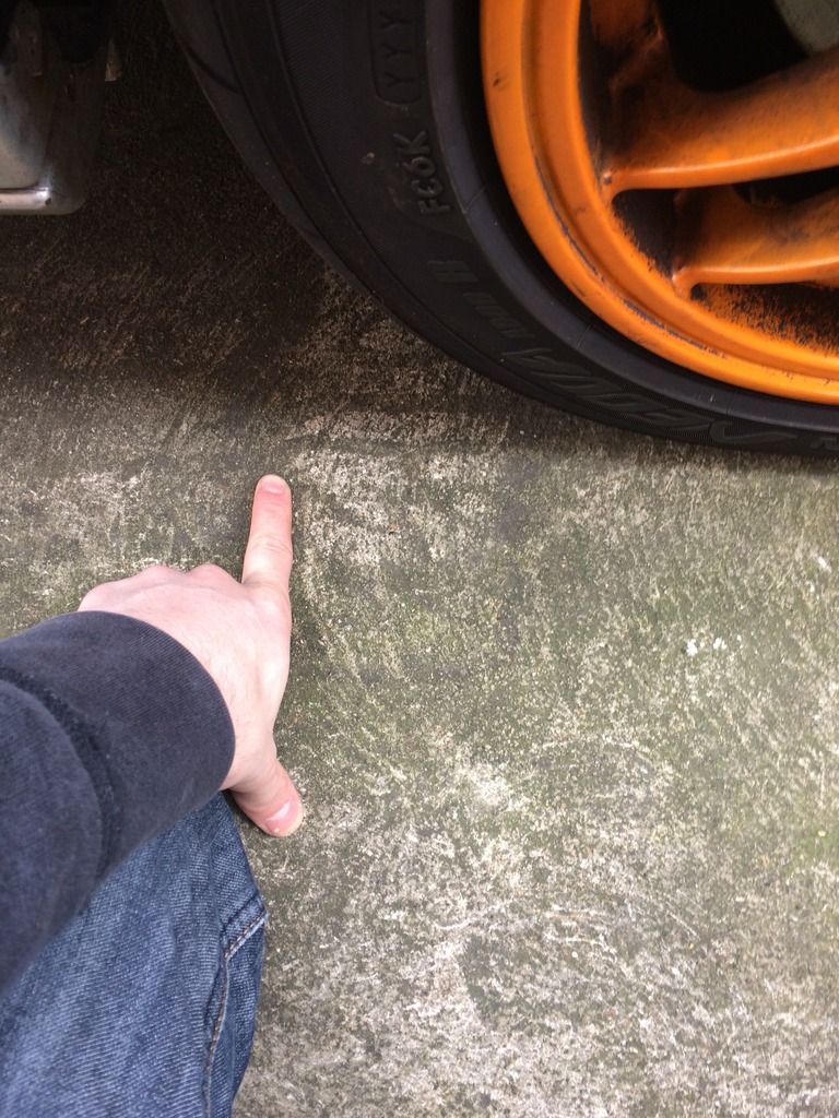

had a good look underneath and there is nothing I can see, shake loose or anything. The only thing is in the spare wheel well. This crease, but it is in the wrong place for a rear end impact and would think it would be a lot worse around it, seems very localised. I just can't remebe rit when I painted the insides last year. So 99.99% confident this wasn't her.
But this one is also in the spare wheel well below the boot lock, so in line where she hit it, but not 100% sure it was caused by the impact as there is a gap behind the bumper and the spare wheel well. It was worse but my brother pushed it out to what it is in the picture below.
All in I think I am very lucky. But rooting about in the car has made me realise how dirty the insides have got, need to give it a good wipe over when I put it back on the road.

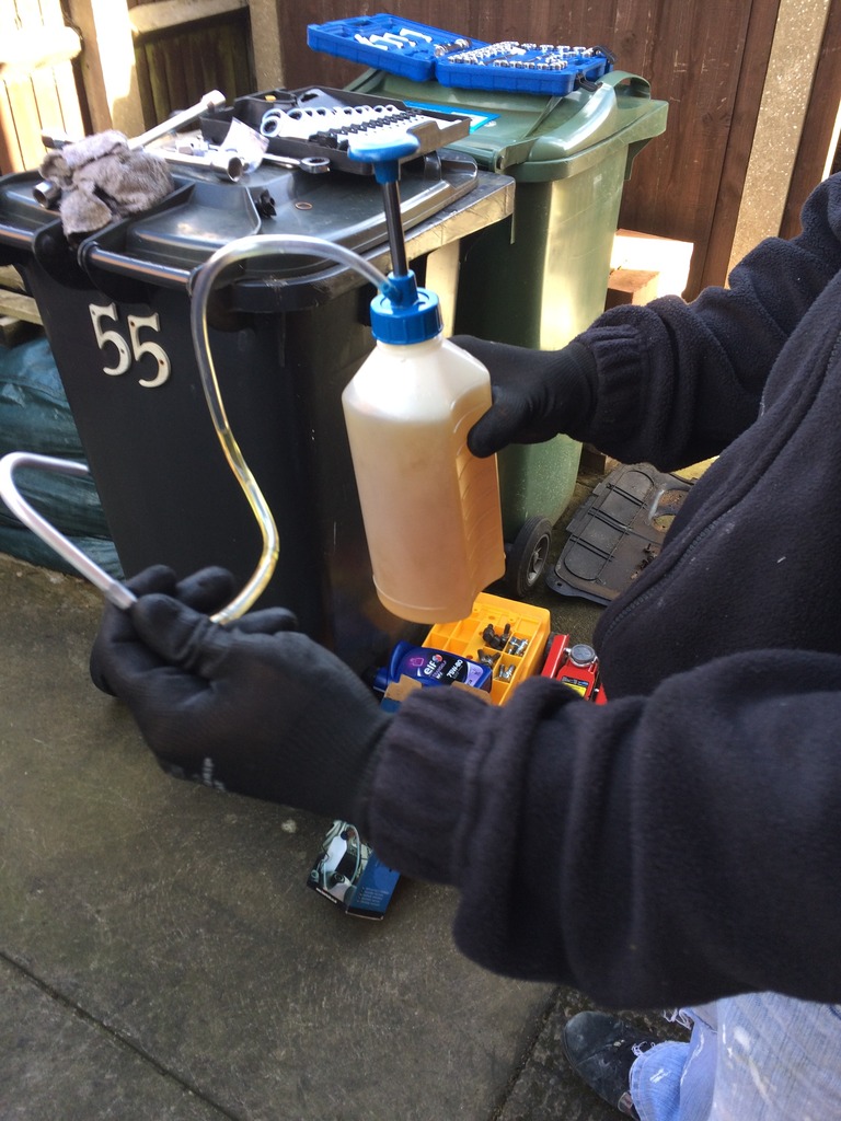

My brother very kindly helped me sort some things out, which included gear box oil change, bleed the brakes and fit new DS2500 pads to the front.
Had all the gear box oil change ready....new copper washer, new fill plug and oil.
Never seen a little pump thing before, I thought it was a cool tool. I knew he had it, but never seen one being used. Made filling he gear box up so much easier
So only ~2.5ltrs of awful looking oil came out. And only ~2.8ltrs of fresh oil went in. Just hoping that it was due to the car not being level on the stands when filling it and that it was actually under filled - it was overflowing the fill plug so no more could go in!

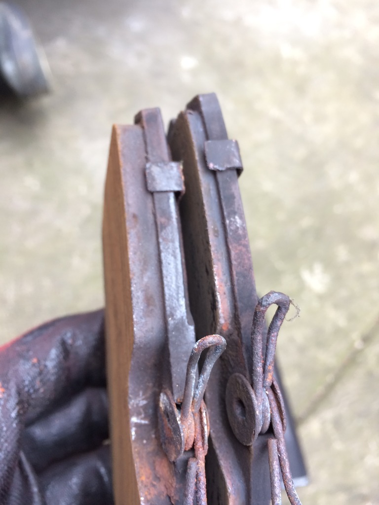

Brakes were bled as the last few times I drove it the pedal would travel to the floor and if pumped they would sor of work. Thought no harm in doing them again. Turns out the fluid that came out looked very clean, it was only changed in November 2015 and hadn't done that many miles on it.
These brake pads were 1 track day old
They are the Brembo OEM pads. I previously had the same pads; they did ~35k miles in three years and several track days. Put the same back on and this happens at one day at Cadwell Park, plus some other driving about. Now have Ferodo DS2500 pads on the front. By christ they are fat. ME and my broither agree they are too thick (~2mm per pad each side comapred to OEM) so they are a nightmare to get in. But they are in, just eed bedding in when the car is back on the road.

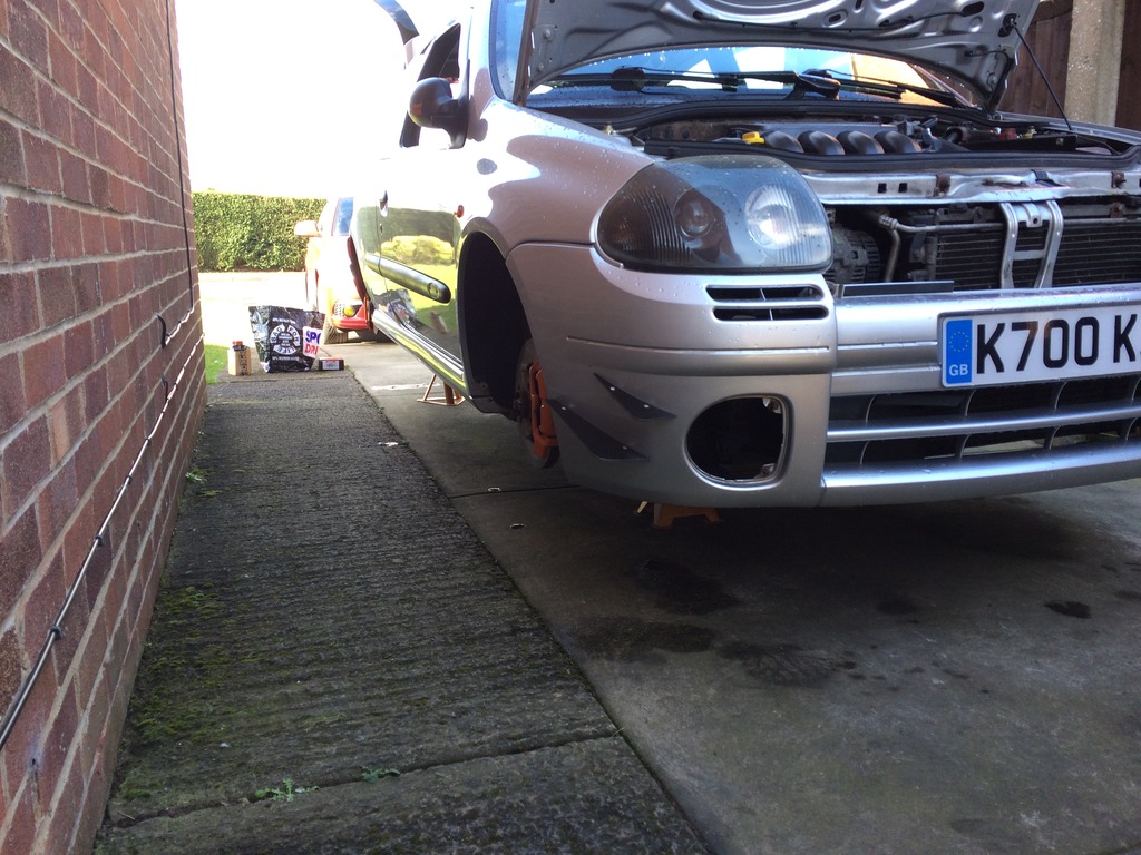

Car as spent a lot of time like this in the past few months!!
But now all back together - used new fixings to put the arch liners and bumper back on and was so much nicer than using the old ones.

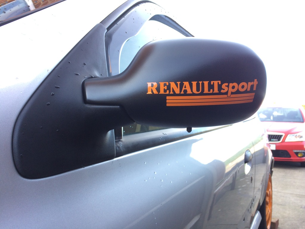

Thanks to @LeeRS for sorting out some stickers:

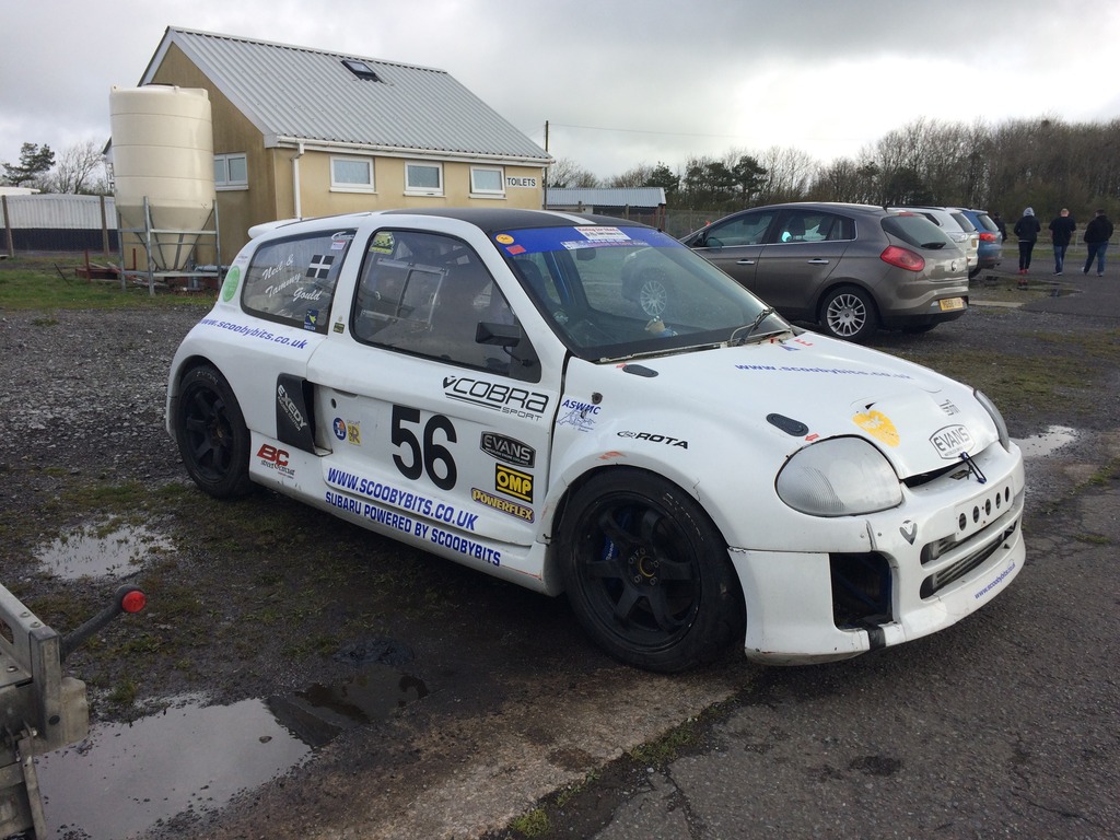

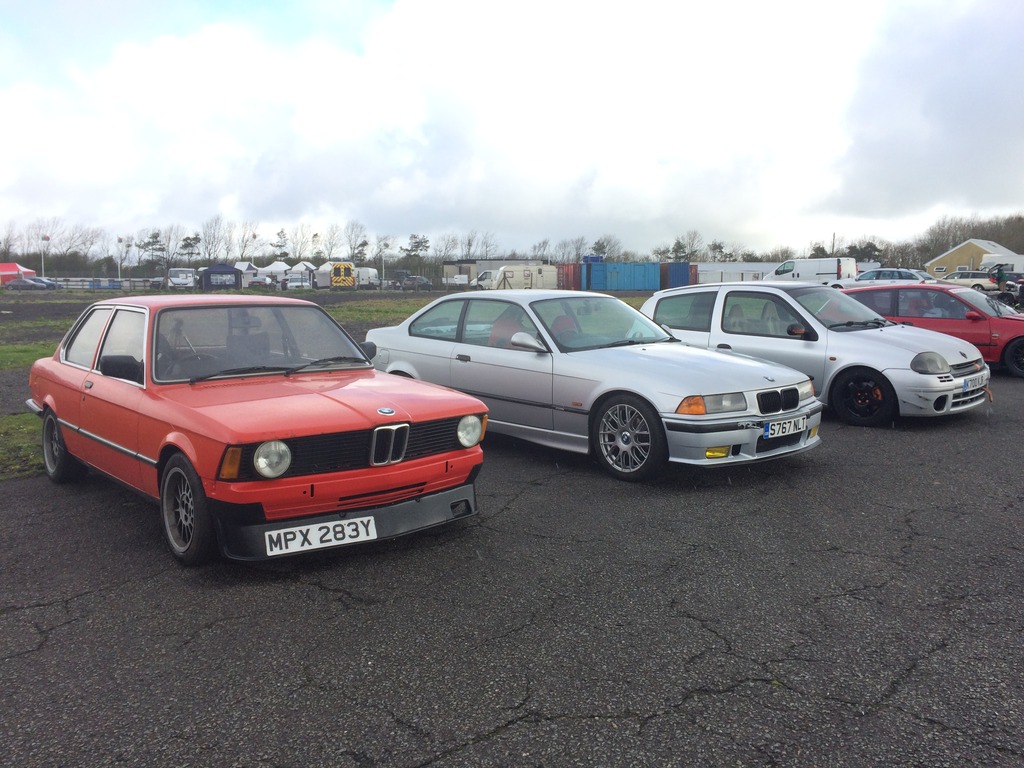

Went with my step dad in his E26 328 and my friend with his E21, which got a lot of attention! Was quicker then the E36, which is good as my step dad is a better driver than me and I was awful going though the chicane on the back straight. Didn't have a tussle with the E21. Was a good day tbh, a lot of high spec track cars there, including the Clio-prezza
This was seconds from a big sideways moment into the bus stop!

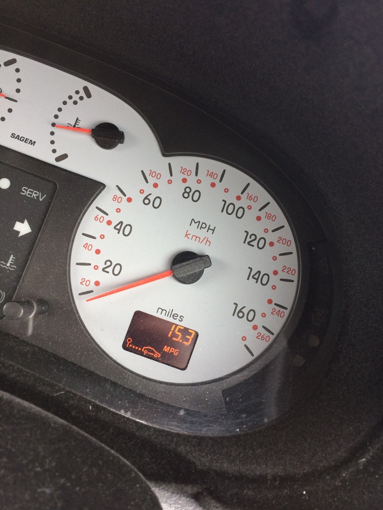

New record on the lowest MPG in the Clio too
Had a bit of a disaster when I got there - luckily my step dad was behind me on the two sighting laps and he was flashing at me all the way and pointing at me, so headed back the paddock before the green flag went. Turned out my rear left hand wheel was wobbling all over the place! Looked like the rear left nad wheel was buckled, was about to get annoyed as they are new wheels. But turns out they were not seated properly - the hub nut cap has got a small lip on which doesnt allow the wheel to sit flush, rather annoying. So just removed the cap and the wheel fitted fine. So need to sort this out really. Glad it wasn't a buckled wheel.

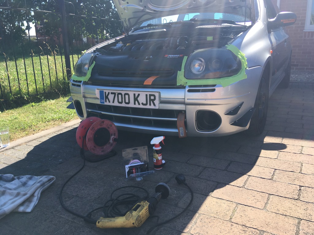

Slow progress on the induction feed light unit. Mainly as fixing my vRS was my top priority then I got busy. But need to source some bulbs, bulb holders (know the ones I want) and find a suitable LED flasher unit. Then its cut the light units to hold the new indicator side light bulb combo.

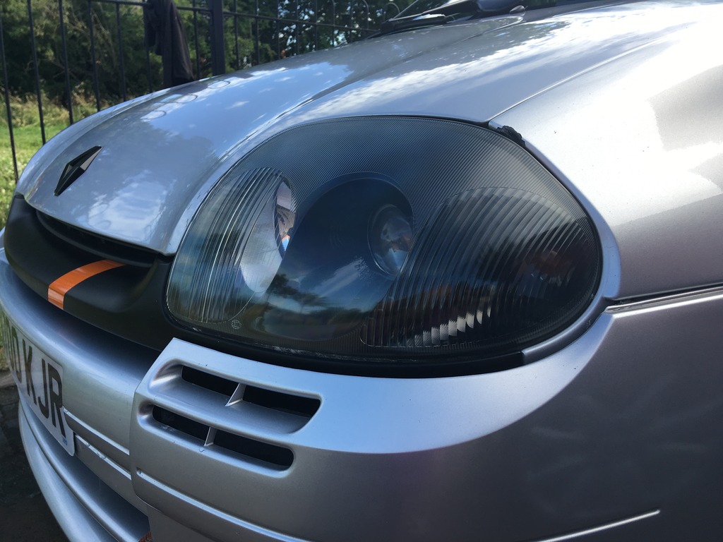

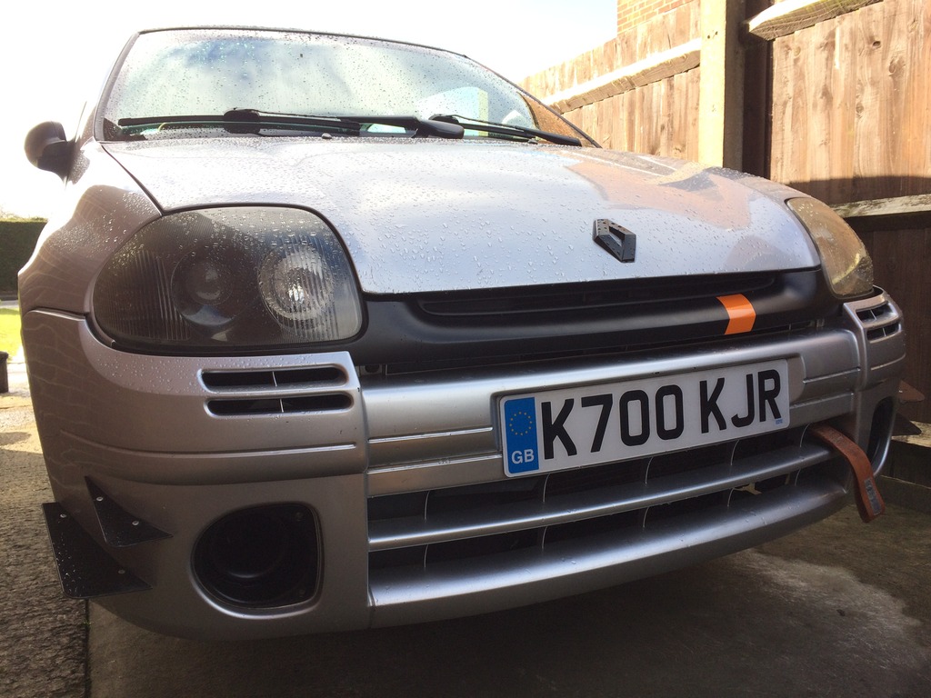

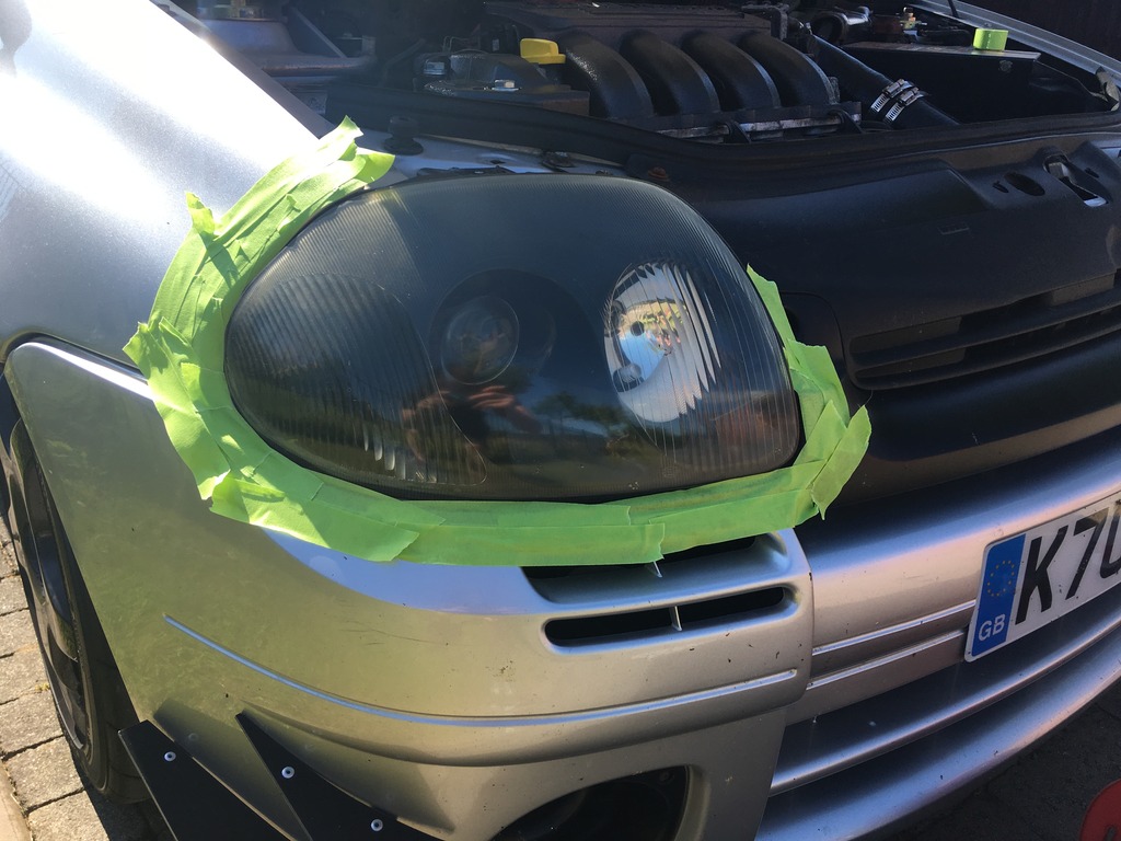

I also set about refurbing the lights again as they went a bit yellow, and the fact the one with the hole in for the air feed I wont be able to do easily anymore! Used the 3M kit again, was an hour well spent as it has made the front end come back to life. Pictures don't do it justice, and the fact it was too bright!
Before:
During:
Used Meguiars Headlight Protectant to stop them going yellow again, hope it does the trick.
After:

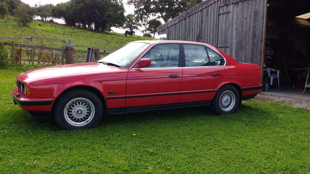

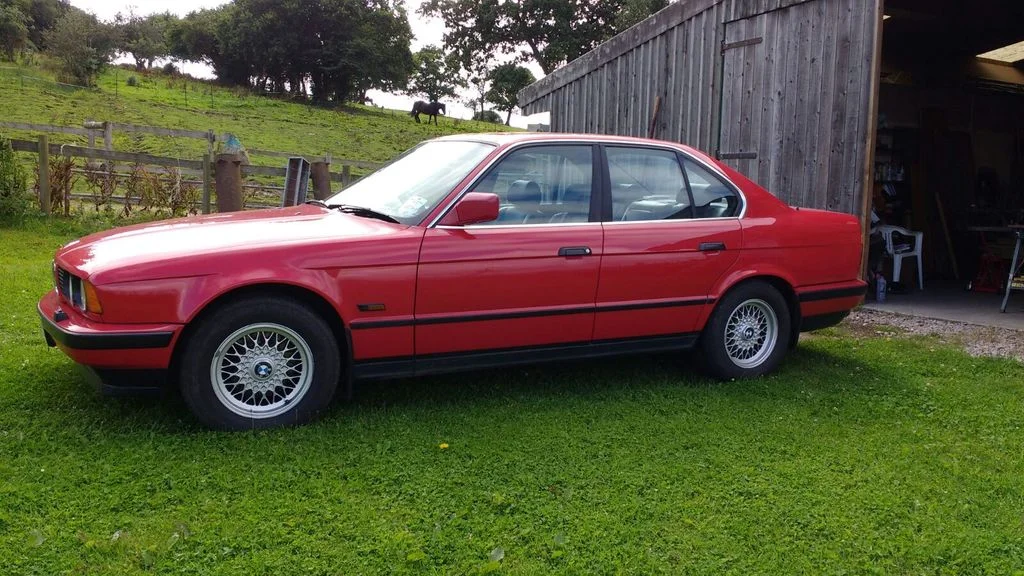

As promised a few pictures of the new car, BMW E34 535i
And just after I have washed it this morning. Would like to polish it and put some kind of hydrophobic coating on it, like my brother has on his car.
Mother thinks I am mad as I picked it up last night and off on holiday to Devon in it today.
No major plans apart from put some finishing touches to it, like there are a few frayed threads on the gear stick gaitor, needs some of the black trim re-painting, fix the headlight washers etc. Apart from that it is solid. Will be kept in clean and tidy and hopefully start to appreciate in value soon.
Who knows, if I find another Ph1 172 I may be tempted to sell the daily Octavia vRS for it........
