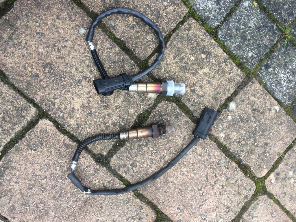

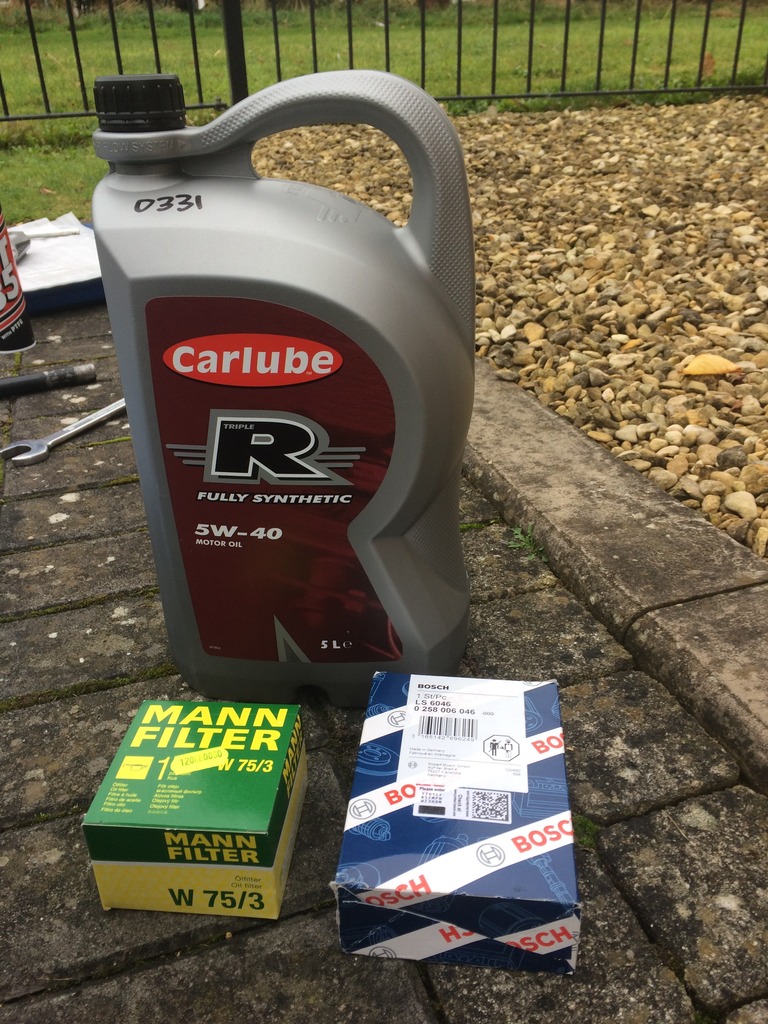

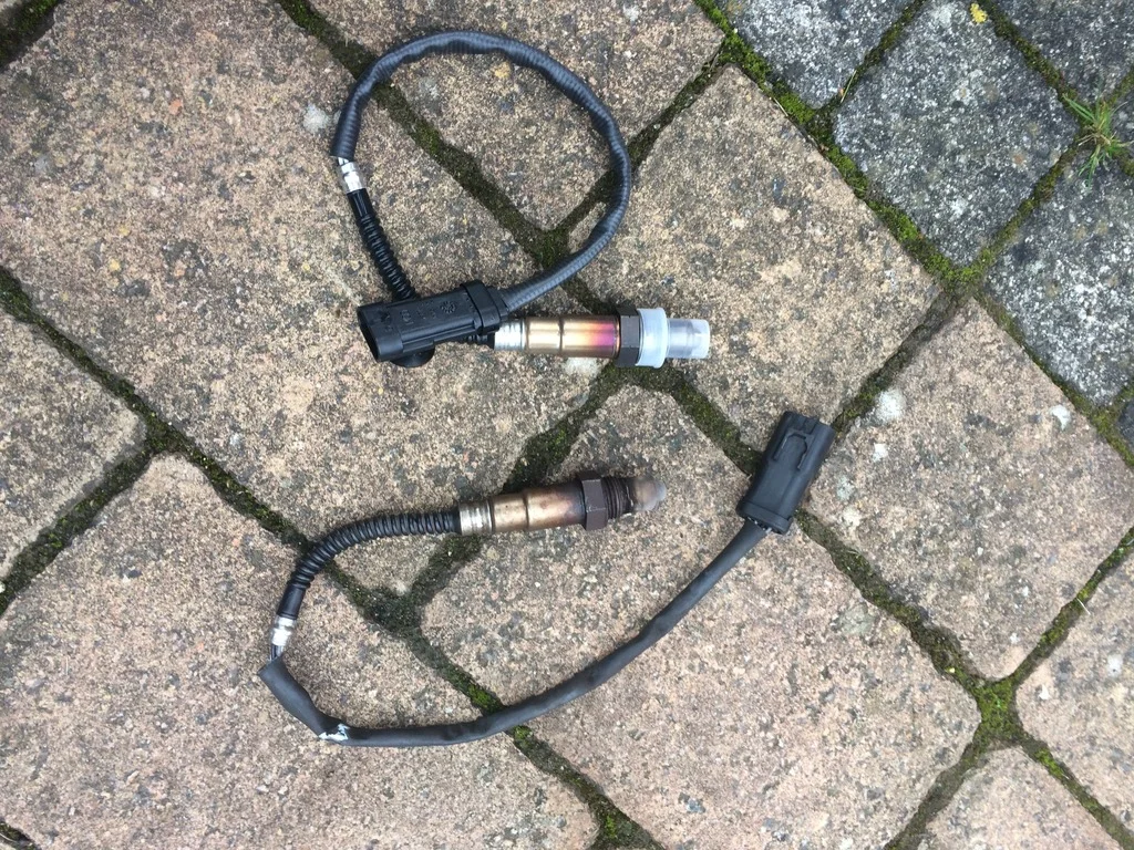

Car got a bit of love this weekend - oil and oil filter were swapped and I also changed the pre-cat lambda sensor
Had a missifre issue under acceleration and it was suggested that the lambda sensor is the issue; I would have not guessed that for ages! However after changing it the car has greatly improved, somehow it is a lot easier to drive and it feels like it pulls better. But not sure f this is some kind of placebo effect.
Changing it was easy, just a little fiddly pulgging it back in as the anti-roll bar is in the way! Also hated doing it as I had to get right under the car and I don't like it, the sooner me my brother and step dad sort out a two post lift the better! Was jacked up on one corner on an axel stand then the trolley jack and boot jack was also in place for that bit of extra security and comfort. Still hated getting underneath the damn thing!!

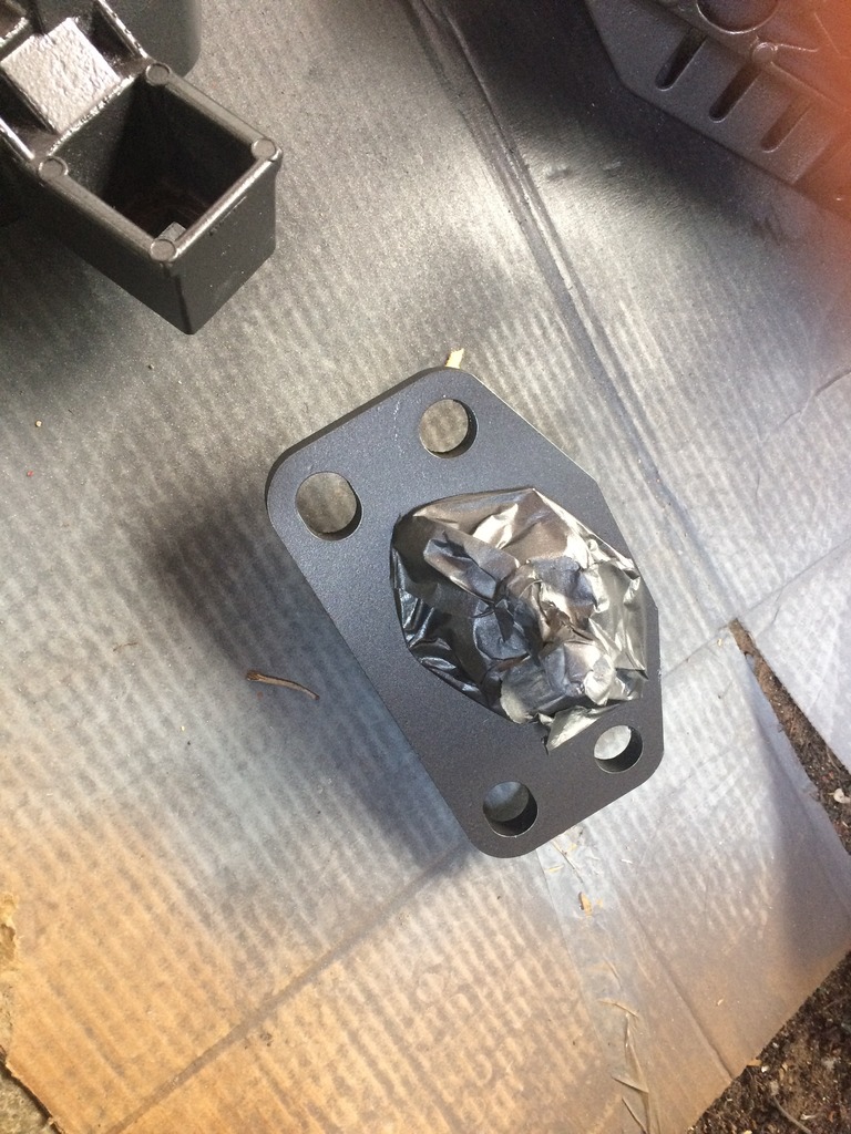

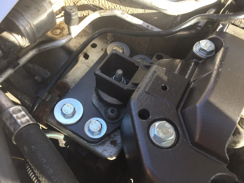

Solid engine mount turned up!

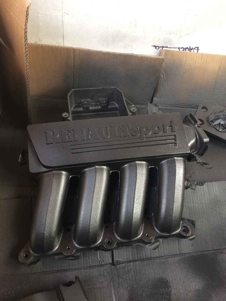

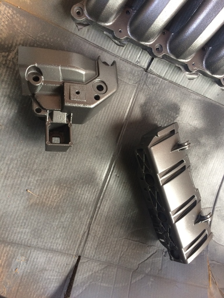

Also got the engine parts and started to paint them, along with the new engine mount to match. Colour is Ford Graphite Grey. They look loads better than the initial black paint job I did. Need to do the lacquer and they are ready! Will order gaskets, new coil pack and HT leads so I can swap them all and have nice and fresh everything. Not sure what I want to do with the "Renault Sport" lettering. I currently have it painted orange, but I don't want to risk messing this paint job up!
KitsonRis

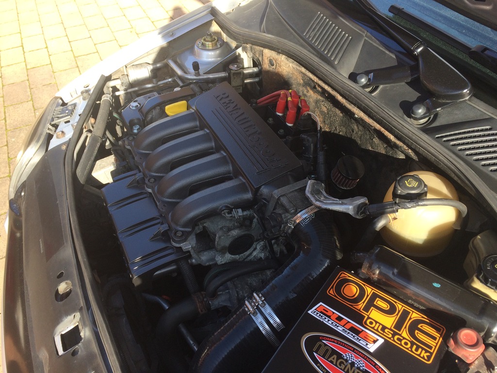

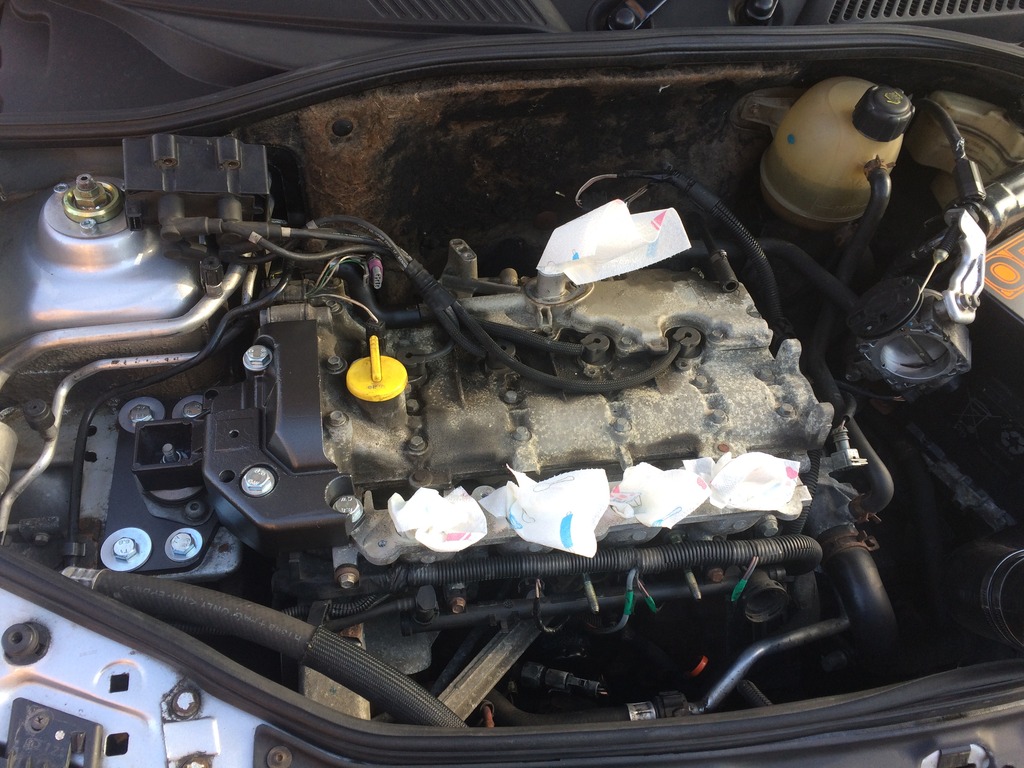

Had a bit of a tinker with the car today. Fitted the freshly painted inlet manifold, cam cover and solid top mount. Took the opportunity to change the coil pack and leads. Afte the failure of the last coil pack and leads I bought, this time I opted for a genuine Renault coil pack and Magnecore leads. They do look the part and the engine runs alot smoother

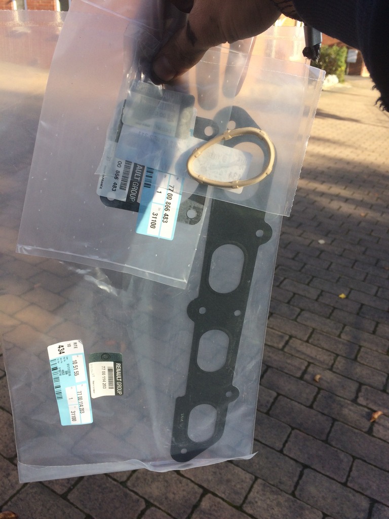

Bought new gaskets as I ddn't want to risk them being damaged and then being unable to drive the damn thing.
Also bought a new oil filler cap and gave the top of the engine a bit of a clean. Ideally wants painting but that can wait.

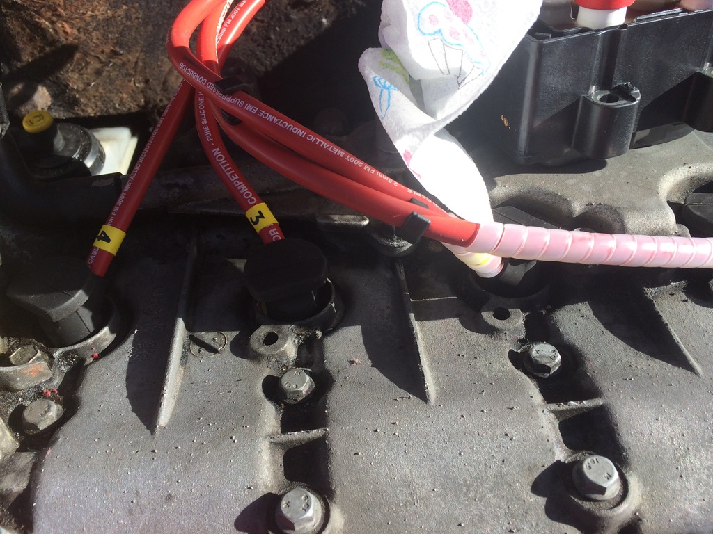

Not sure about the little protective covers on the HT leads for plugs 1 and 2. The other two leads don't have them.

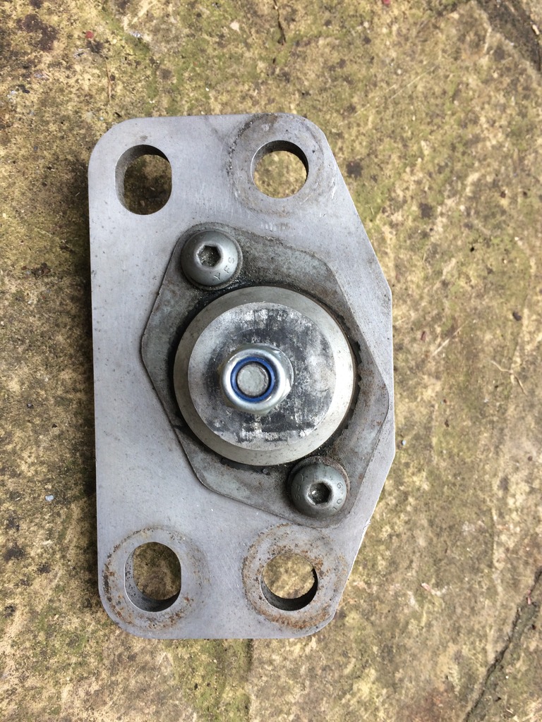

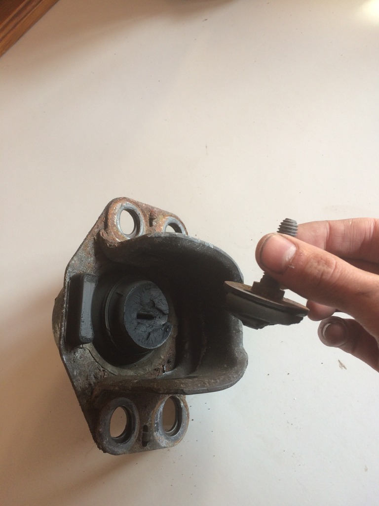

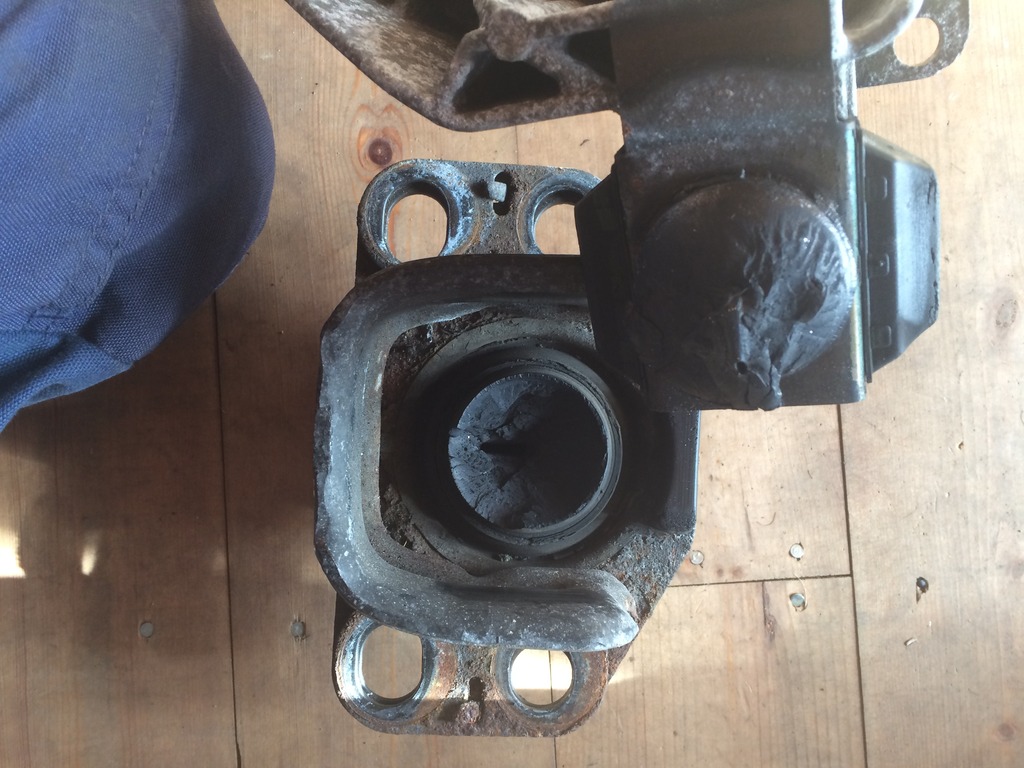

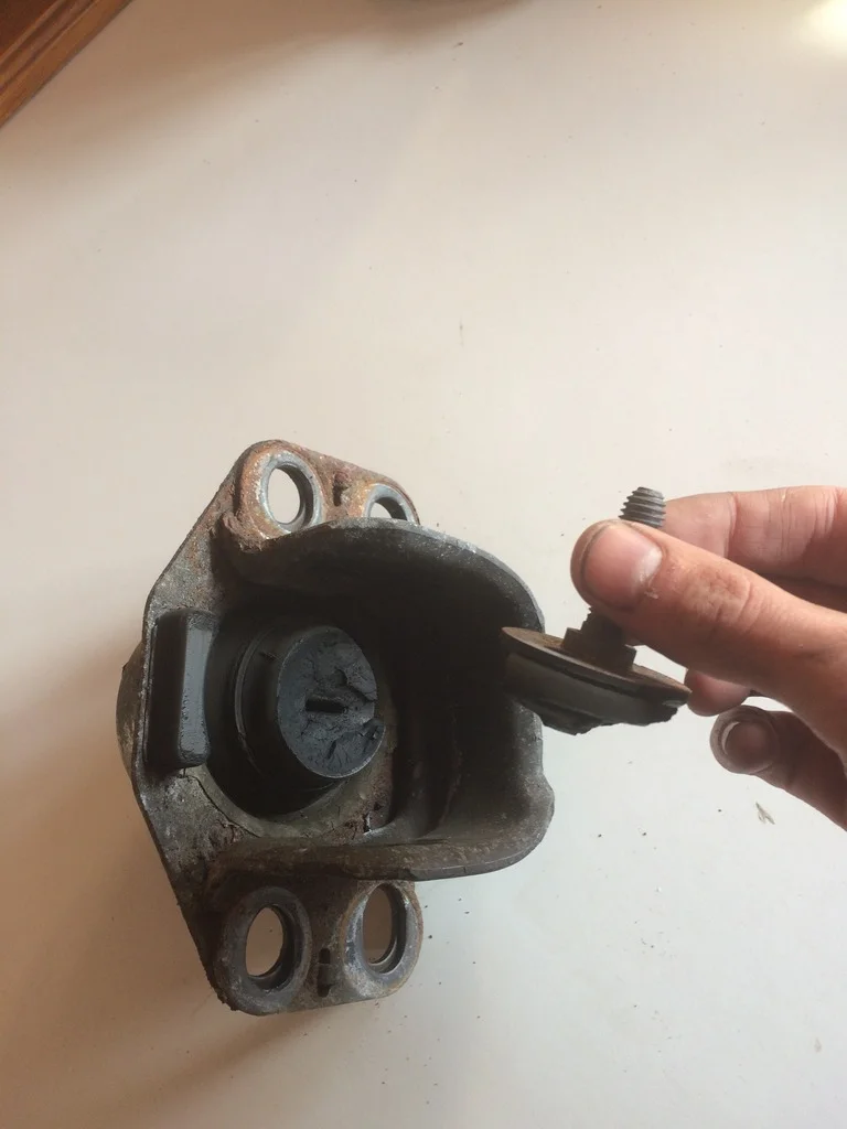

Glad I changed the engine mount as mine was in two pieces. Yes, two pieces. The rubber bit had failed so the engine wasn't bolted down. I have done track days like this! Hopefully the new Vibratronics one will also help.
Horn had stopped working so took the opportunity to fix this. Turns out the horn that plugs direct to the loom isn't working so for the time being I have put the second horn that piggy backs off the broken one into the loom. However this makes the horn sound pathetic! So need to sort the other horn out as I don't really fancy a rubbish horn as no one will take me seriously!
When the car went to get the power steering pipe changed at a local garage, it turned out they didn't do a good job of looking after the car, however I cannot prove it was them as I found all these things a while after. First was I am sure some bumper fixings are missing and also in the wrong place or not the same bolts that were in there. The passenger head lamp adjustment motor was not attached and left dangling. The bonnet close sensor isn't attached to anything and I cannot find the connector it goes into. And the worst one is the throttle cable housing is broken. I have bought a replacement and hope to get that fitted tomorrow. This was only replaced back in January which is so annoying. I wish I had it today as without the inlet manifold access is really good to get behind the heat proof/shield! So I am think I am going to remove it tomorrow to help out.

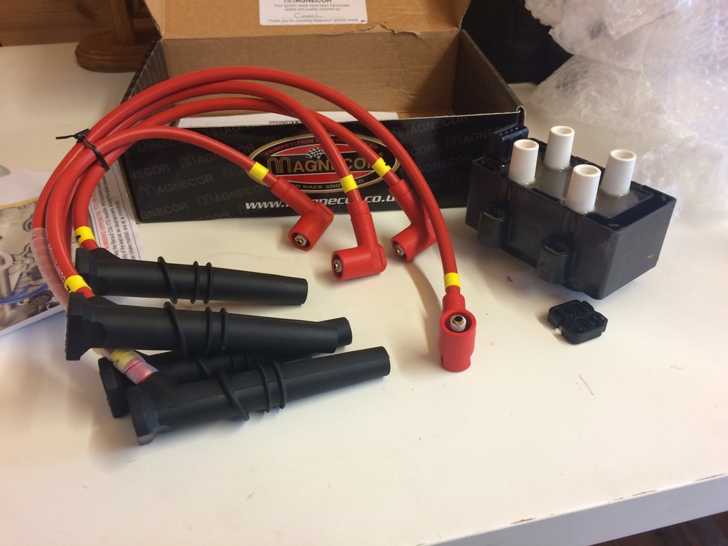

Throttle cable changed :up: Was really simple, mainly as I knew what OI was doing after only changing it in January and I had the brilliant idea of removing the inlet to give me loads more room!!! I t was done within 20mins, and that includes getting the tools out of the garage and taking the wheel off.
Drove the car to pick up the throttle cable and it feels a lot smoother with the new coil pack and HT leads on. I am very impressed. Or it could be sue to the fact the engine is actually secured to the chassis :grimacing:

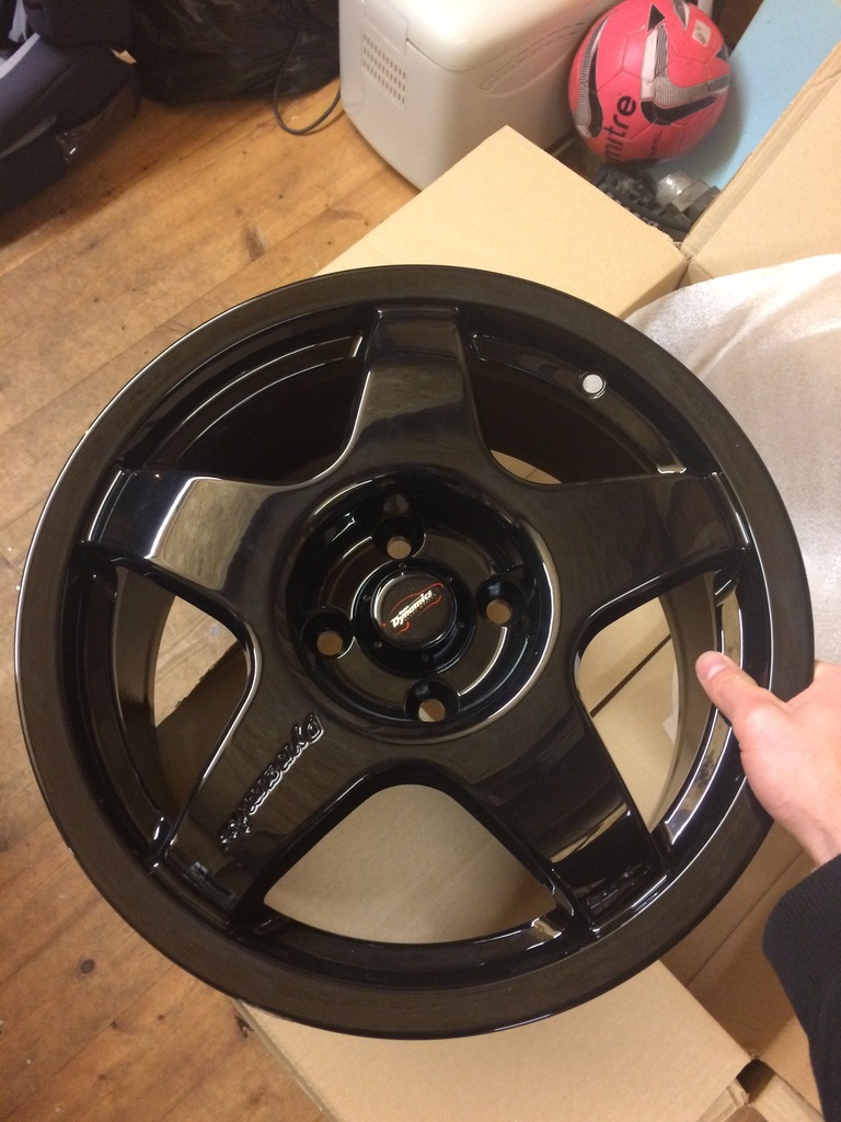

These wheels. Utter bargain at £307 from £624 and the are new!!!! I have only know two Clio's with these on, so hopefully will be a bit different
But black is boring...so they are going orange! I know it feel wrong to buy brand new wheels then to get them painted. But this time I am going to do it properly and sandblast and them powder coated. Would have prefered doing this to second hand ones but at that price I couldn't say no. This will be done in the new year as I want to get a cage and that powder coated orange at the same time so they match. Although coming to think of it my interior might look a little gash then as I have painted it dark grey (didn't want black or white or titanium) and I have brown seats, so not sure orage will match :confused: Seats are easily changed and one day I was going to replace them when they get worn out.

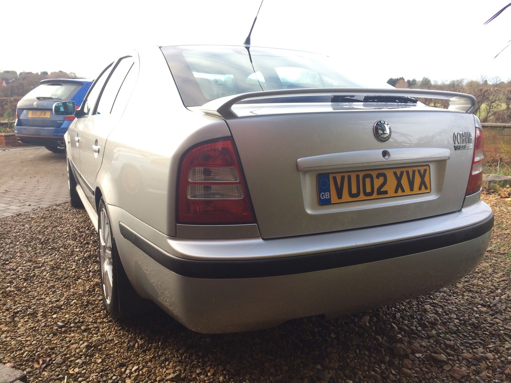

And I have bought myself a new daily drive! Another reason to not buy a cage this month. Its a Mk1 Octavia VRs, always liked them. And to not break tradition it is my step dad's old one (the Clio was his before mine!). Want to keep it as standard as possible as then it will hold its valu, bit of a gamble of a future classic. Will try and get some pictures soon.
KitsonRis

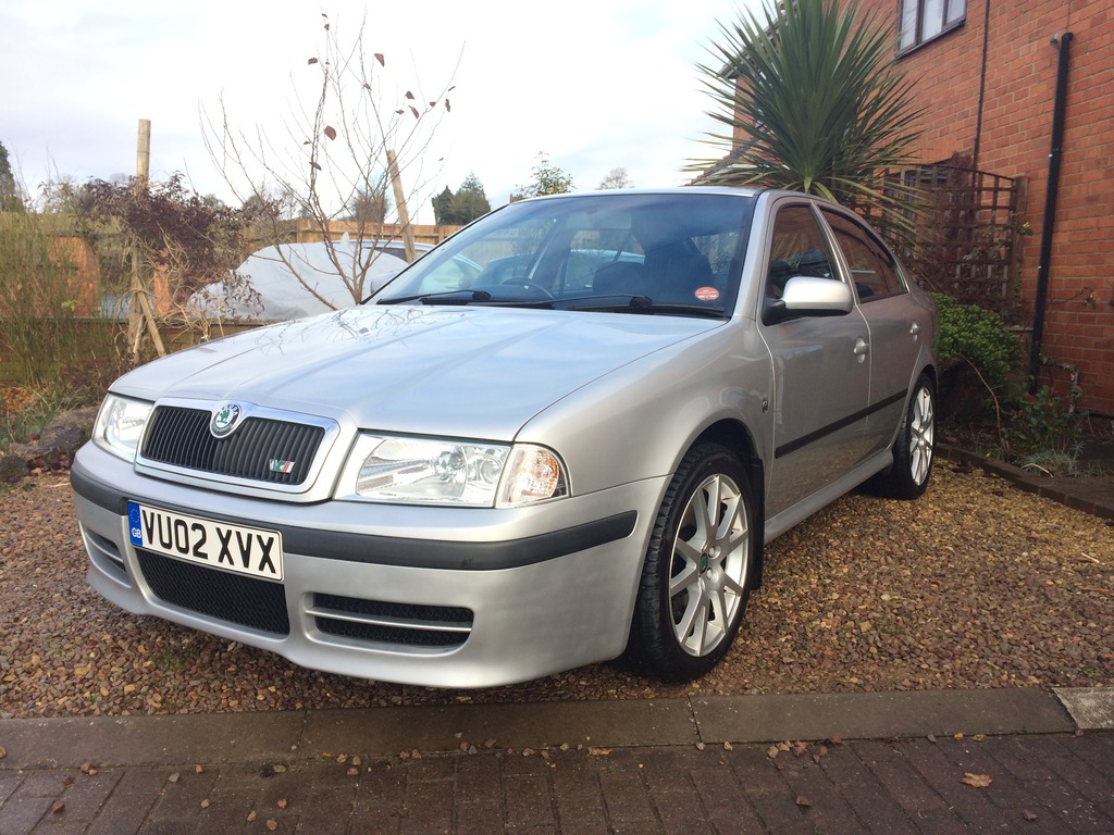

A few pictures of the new daily car just after a wash, hopefully will be a bit more shiney soon with a few more washes.
This was pre-vacuum!
Few jobs to do on it -
* Change front discs and pads (bought and ready to be fitted)
* Paint a caliper as it has been changed at some point and it's not green like the others
* Got a crack in the windscreen the other night so I am getting that changed Sunday
* Sort the exhause out as for some reason it doesn't have a VRs exhaust on so there is a cut out in the bumper for it but it has a "stealth" tip on. I do have a VRs exhaust tip / last foot of the exhause I could put on (cut the old exhaust off and sleeve this on) or....get a nice custom made stainless system made like I have on the Clio
* Get it re-mapped

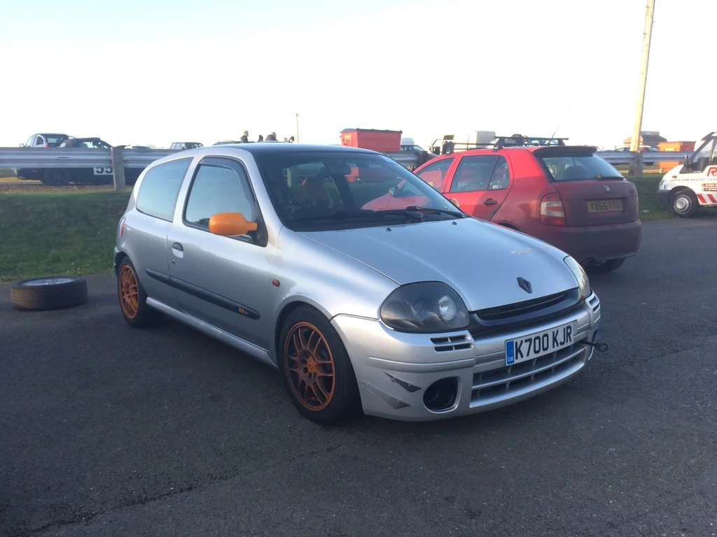

Clio time now......was at Cadwell Park on Sunday. Unfortuately my friend who I was going with was in hospital so was unable to attend, which I was sort of glad about as I didn't have anything to prove without him being there!
Car was really good. I enjoyed the track too, apart from the low sun which made it impossible to see going down the pit straight! Did about 60miles in total on track

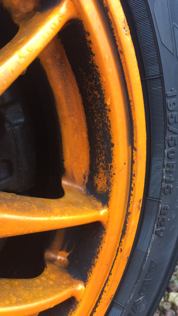

Turns out my basically new front brake pads are nearly gone :neutral::confused: They were only replace back in July after Llandow. They were the same pads as what they replaced but the ones I took out in July covered +30k miles and several track days! These only managed one track day and about 3k miles. The pads are the Bembo OEM ones so were not budget. I had epic problems getting a pair of DS2500 to fit as they were too thick so went for the OEM ones. But now hopefully with the discs a little thinner they will fit, plus my brother said he will get them to fit!
However, the brake material had to go somewhere though...onto the wheels, which subsequently baked on as the wheels got hot and it is now solid! GREAT :up: This now means the wheels are ruined as it doesn't shift.

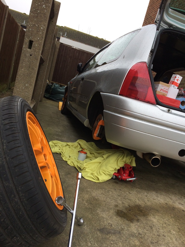

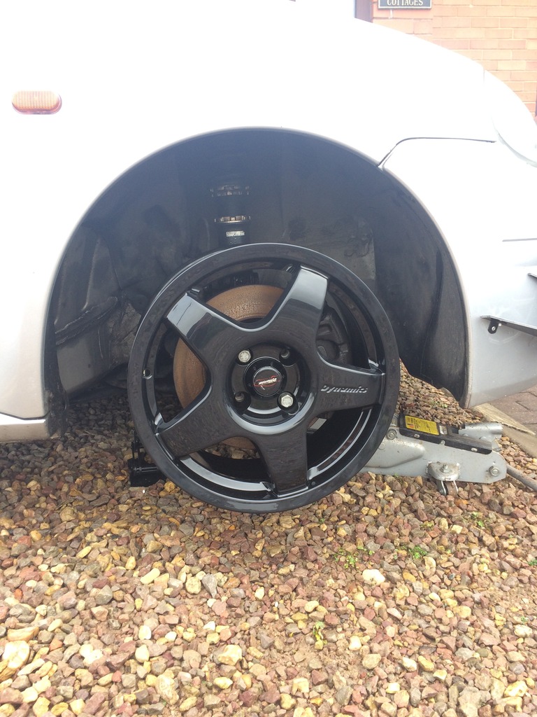

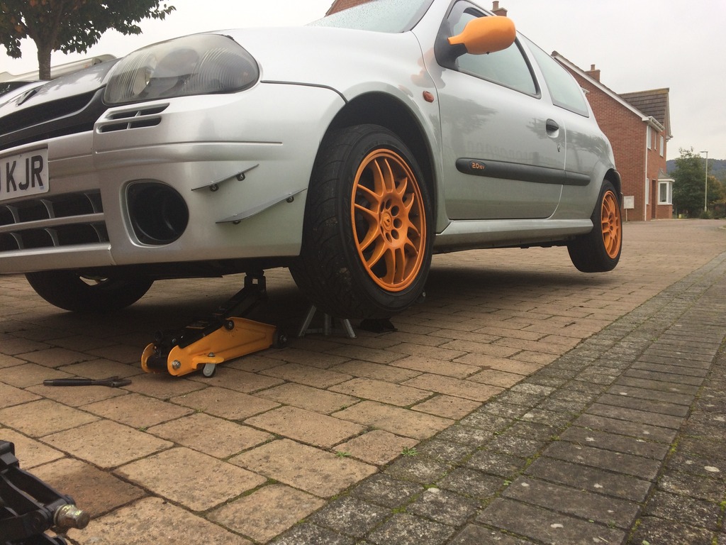

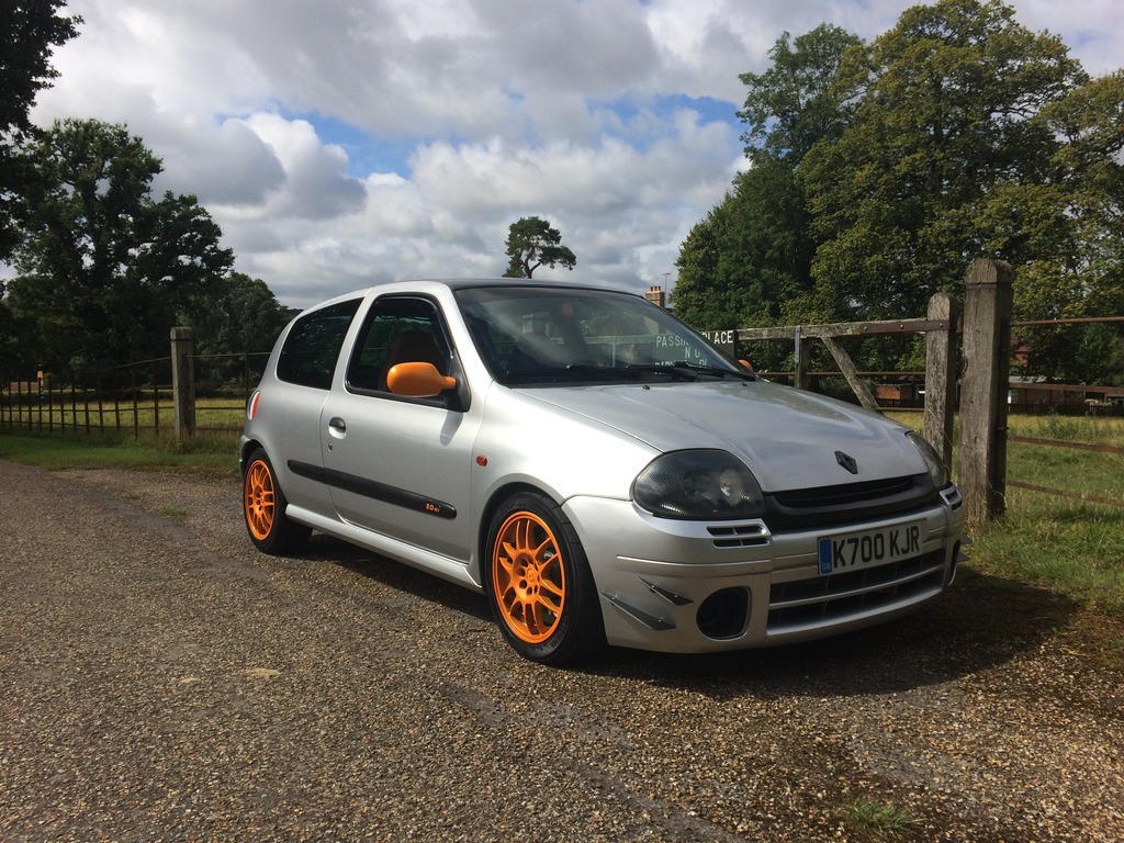

Trial fitted the new wheels, well one a least! Looks really smart. And I am tempted to keep them black. One as it looks smart and also it will be a lot easier to keep clean!!!! But this will mean getting rid of the orange colour scheme, will repaint the mirrors black I think, or could go back to titanium and then get some new door strips as I painted the lettering orange and I had to glue one in as it kept falling out of the strip.
I will probably re-furb the F1's and put some track tyres on I think

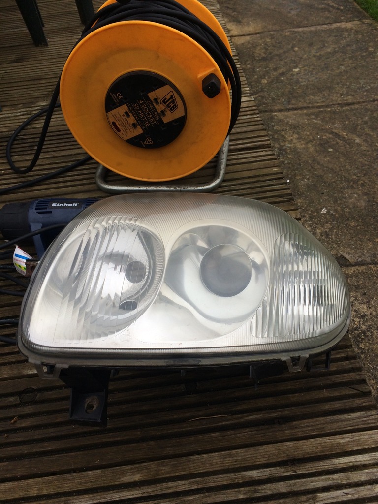

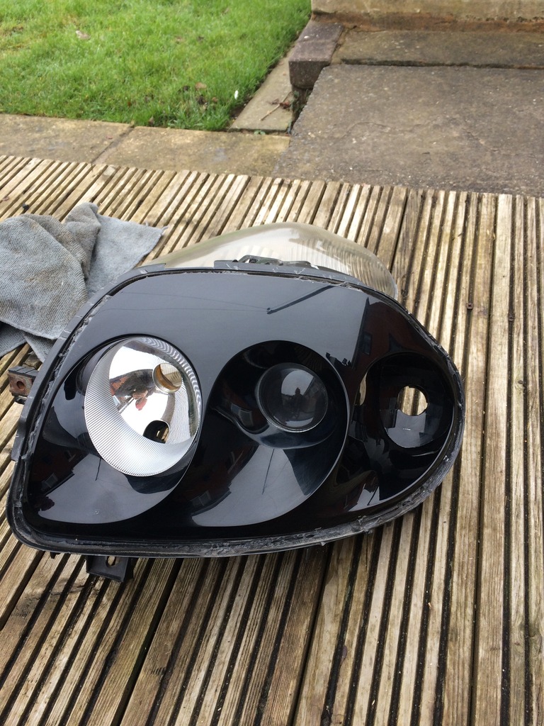

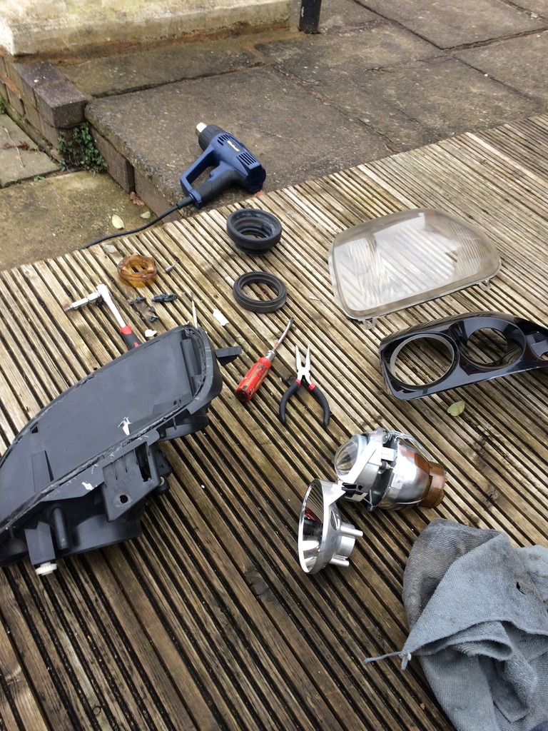

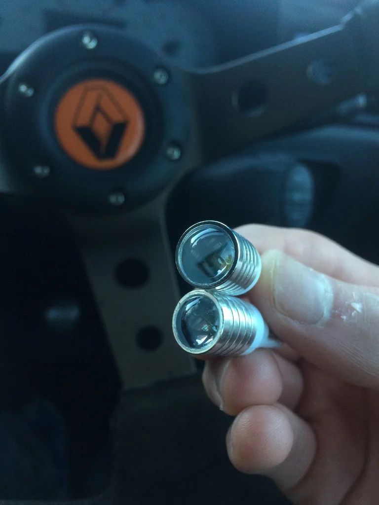

Then I did some tinkering - bought a another pasenger light to make a cold air feed, because I want to extract that tiny bit of power gain :tongueclosed:😂 haha
I have taken it all apart and cut the main beam light bit off which was great fun as I love my Dremmel, best tool ever.
But the bit which the lbulbs fit is broken (only found out after I took it apart) so I need to find a way of re-mounting it back into the unit. Another thing I need to think of is placing the side light bulb as the hole which it went through has been cut off so it will poke into the unit and be blocked by a piece of ducting. Need to get a trumpet cone thing and some ducting to help with this so I can trial fit it and then decide wthe best place to put it. Wanted to get to this stage before I bought anything as I didn't know what I will need, but have a better idea now. I know it wont give any gains but I think it looks ok, and I was a bit bored and fancied getting creative!

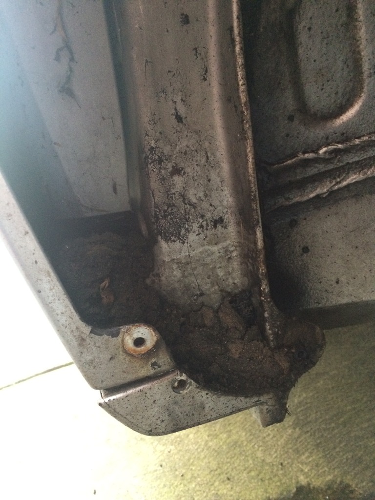

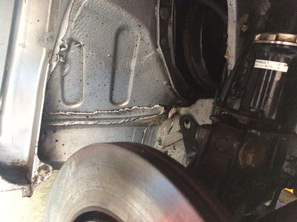

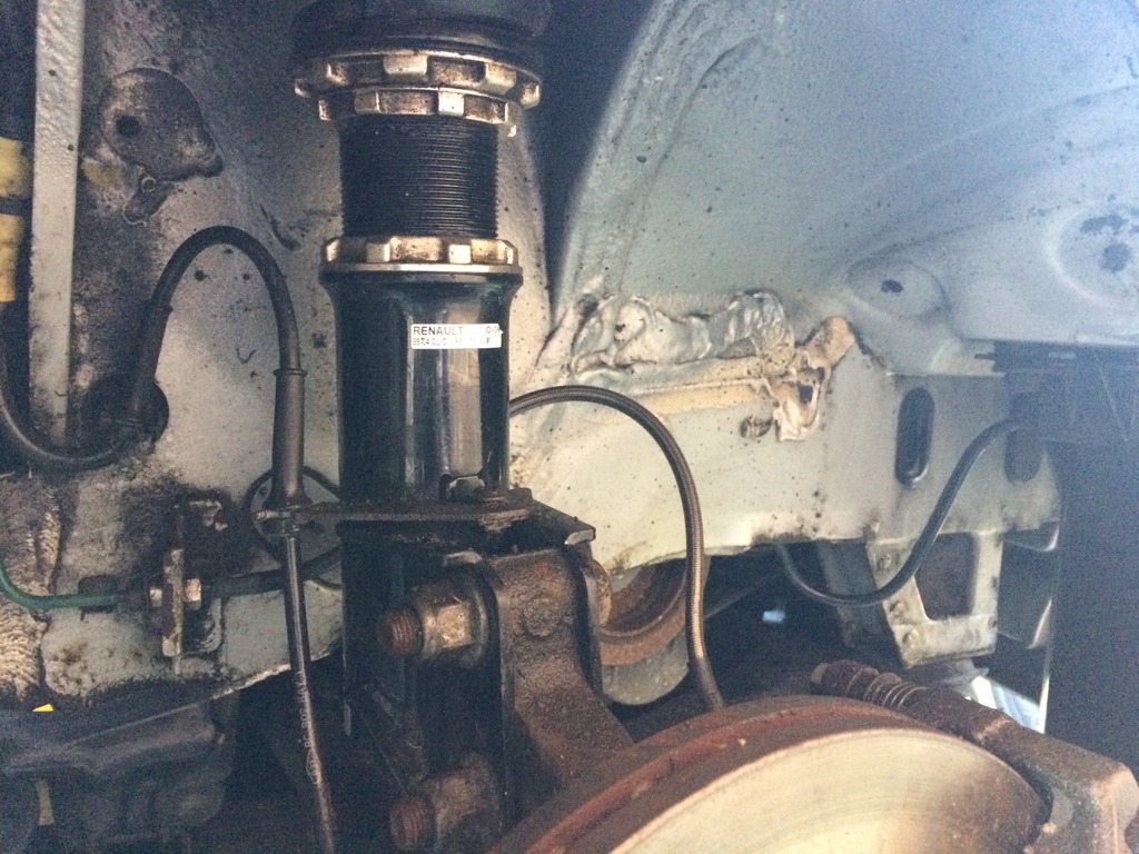

Took the arch liners off and was presented with this mess
ALl cleaned up now. One reason why I wanted to do this job was to remove the 16 years of grime and to have something that looks a little flash
Will be givn another once over before the arch liners go back in. I didn't want to use a scrubbing brush in case it scractehd it all and proveded a route for the rust to strat, so used a sponge and elbow grease. I think it looks better, but it is only going to be covere up by the arch liners again 😂 Just about to buy some ducting to make some brake cooling ducts, another job I have been putting off for ages!!

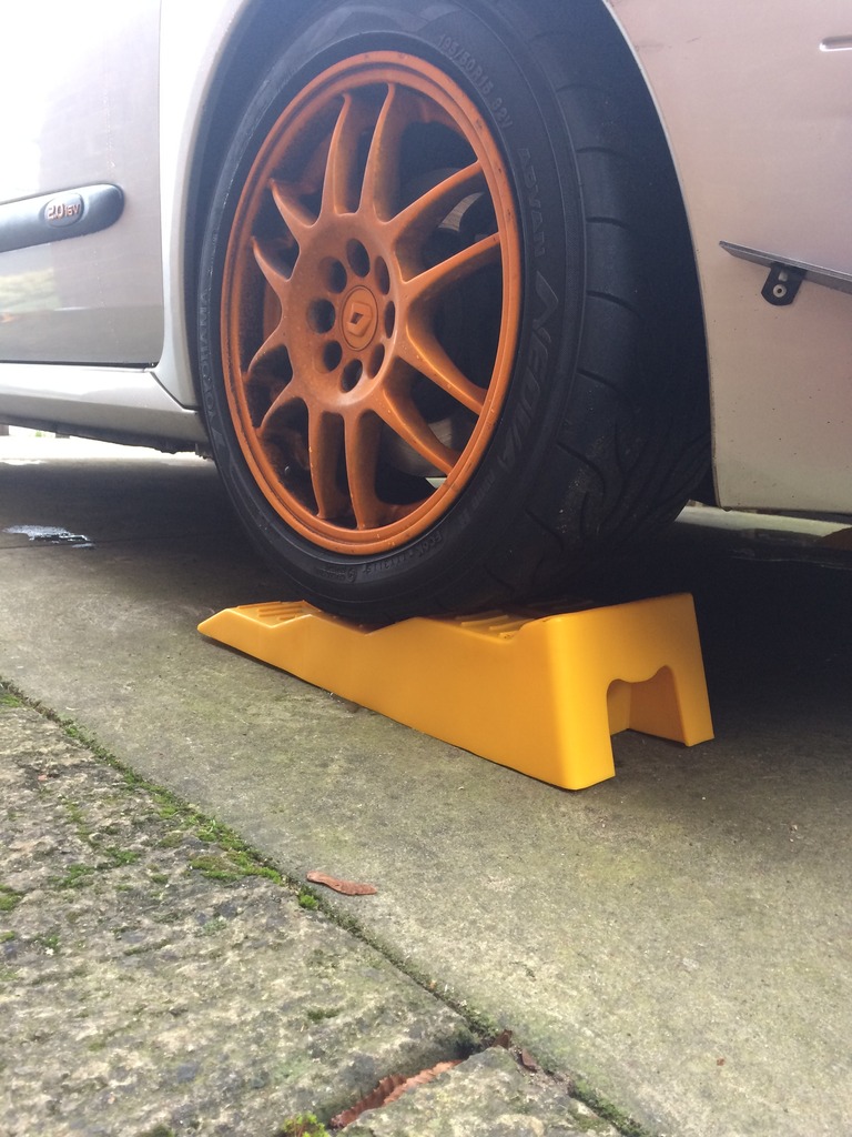

Got some caravan ramps for Christmas to help with acking of the car. My brother has some and I used his when at his as the trolley jack wont fit under the front of the Clio. I think they are really usefull! Makes getting the whole front end on axel stands easier IMO as you dont have to rock the car much when lifting onto the second stand, hich is the bit I hate and get nervous about when putting it on stands. They also came in handy yesterday when changing the front drop links on the Octavia.
Just need to bleed the brakes, change the front pads and get the new wheels sorted. Have a date for when I want the car back on the road - April 1st as its a track day at Llandow. Then it is Coombe Action Day the following weekend, then I am thinking after that get it booked into Engine Dynamics then, otherewise it will never get done!!

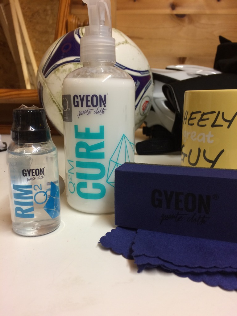

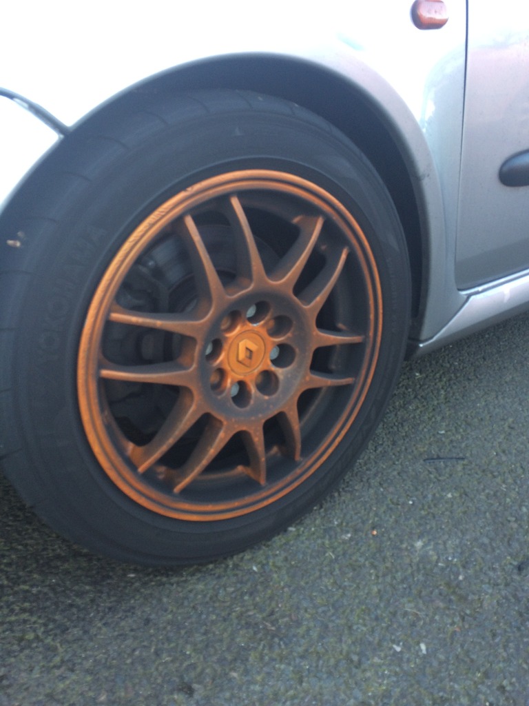

New wheels have been coated, used Gyeon Q2 Rim Sealant. From the reviews I ead about it I hope it does the job of keepiong the brake dust at bay or easier to clean!
Got some GTechniq C4 to restore the trim on the Skoda, but I thought it would be rude not to on the Clio 🙈:tongueout: I need to wait until the Clio is "finished" for the year, like the big expensive jobs, and I will waste the cash on the Skoda - new exhaust, re-map, coil overs.....

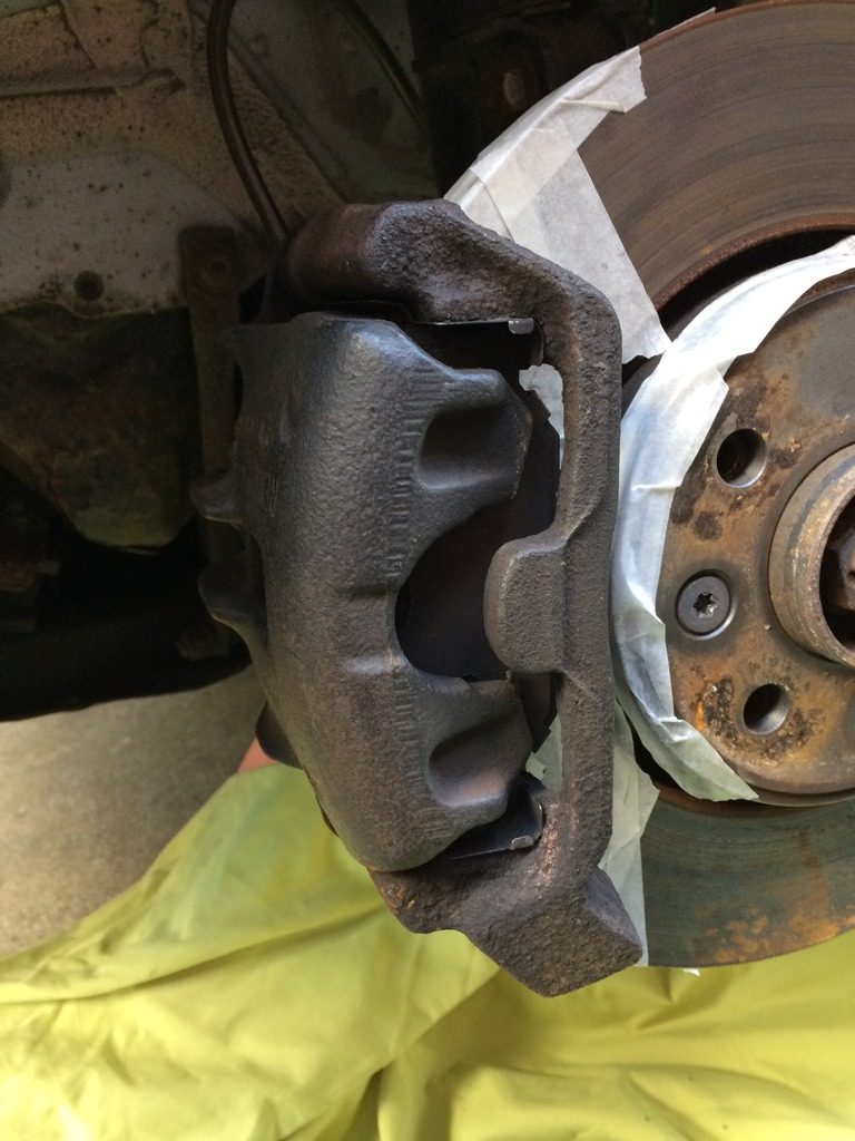

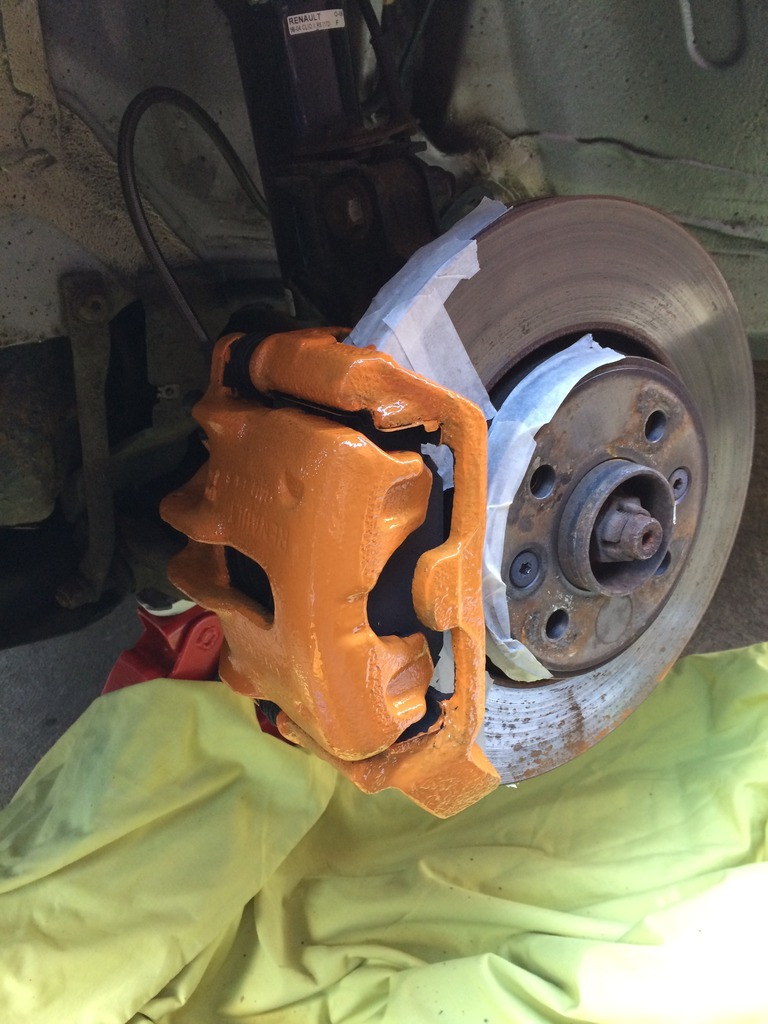

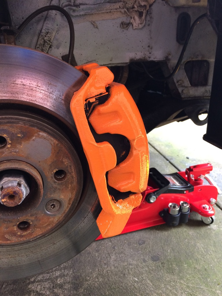

I know painted calipers are not the usual thing to do and people tend to hate them. When the wheels were black I did find the car looked like it had nothing in the arches, just black voids. So I want to still have a small bi of colour there so decided to paint the calipers orange. This was done on the car and I am sure the backs of the calipers are not orange, but I don't want to remove them as sods law says I will take them off and they wont work properly after! Plus I will only remove them to put 4 pots on.
Before:
After one coat:
And after a second coat, finished:
The look gash behind the orange wheels! But they arent staying for long. I am thinking a sinlge lap before the calipers are not as orange! Just need front pads (DS2500) and a bleed and the brakes will be done.

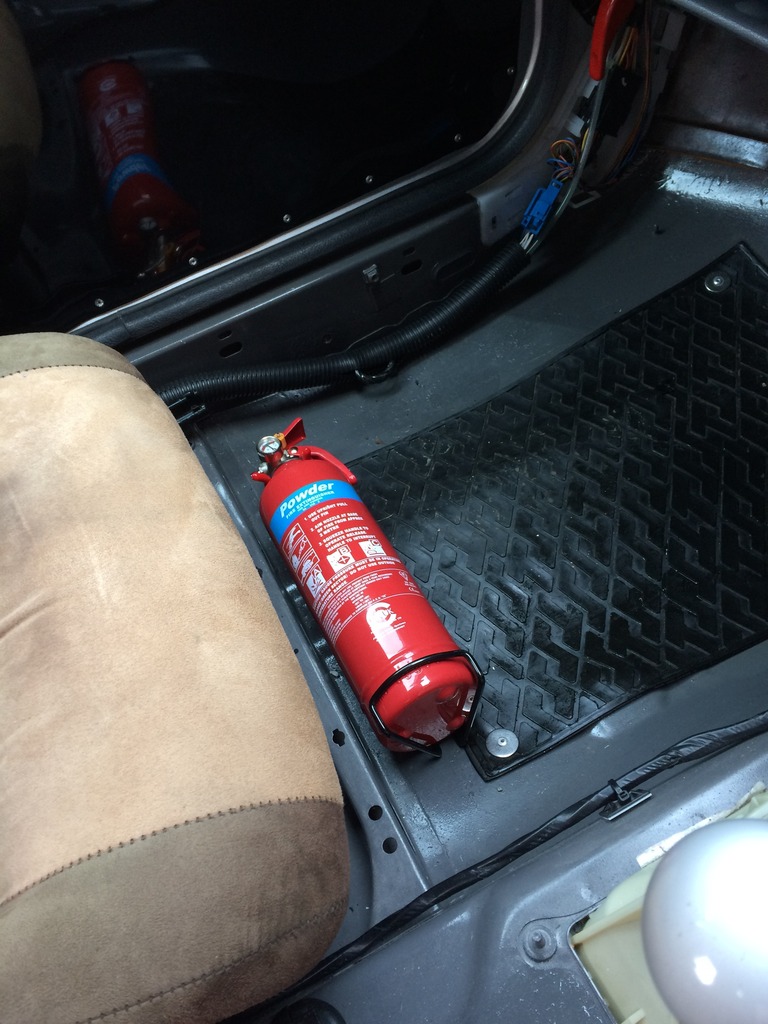

Fitted the fire extingusher I got for Christmas:
Hopefully I never have to use it.

KitsonRis
Where did you get the brake caliper paint from?
Looks like its covered really well :smile:
It's from eBay. I search for "calliper paint orange". Tbh I don't expect it to stay that orange for long! Just something to add a bit of colour behind the black wheels.
Glad I did the second coat as the first wasn't quite thick enough. Just need to use the car to clean the discs up as they are getting a slight rusting coating as has not moved in about a month.
