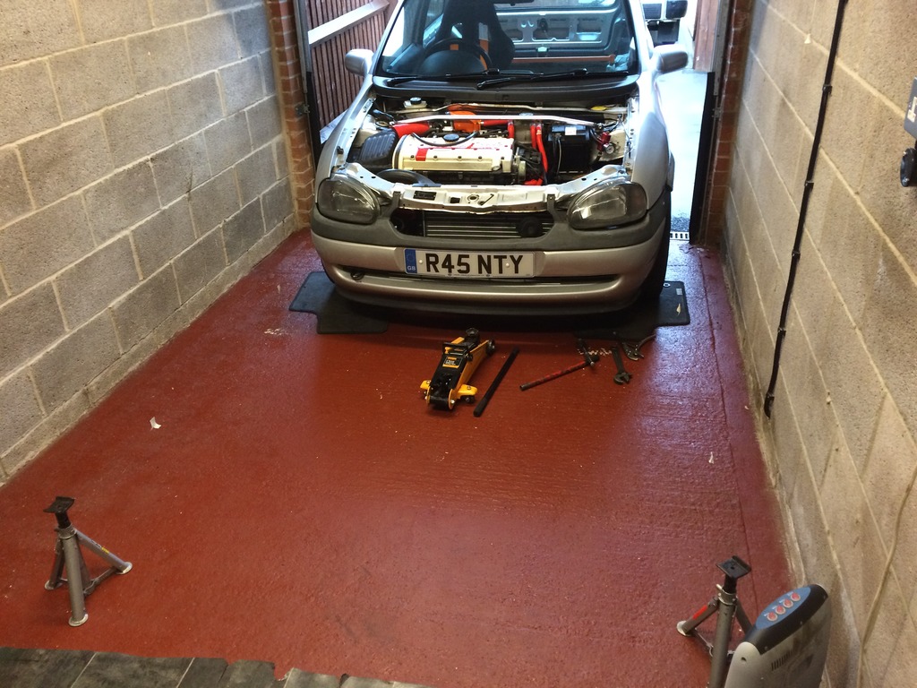

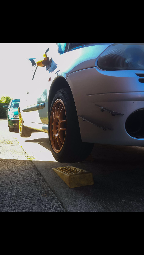

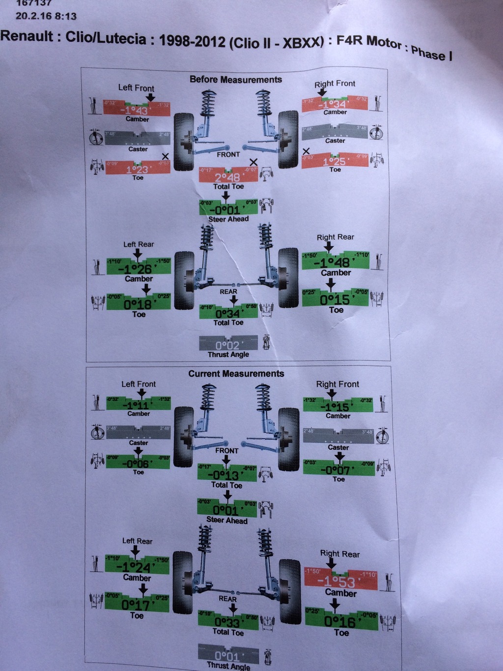

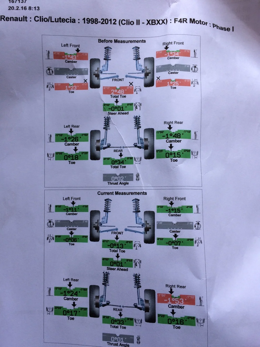

Oh and obligatory alignment print out when I got the new tyres fitted :tongueclosed: not sure how the right rear camber can go from OK to bad without it being touched! Unless it is some kind of live screen shot kind of thing and there is just some variations due to virbations and that in the garage.
I then got back home and my step dad says stop farting about with my car I have to align his Corsa's wheel! So this is how it was done:
Can't quite see the pieces of cotton thread from the wheels to th axel stands. It was measured several times to make sure. But it appears to have worked and got the toe set up how he wants. He did his old kit car in the same way and he never chanegd that once set up. Looking forward to getting the Clio out on track with this, should be evenly matched. The Clio is a better car (his words, not mine!) but he is a much better driver.

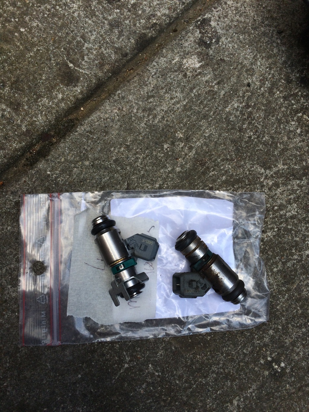

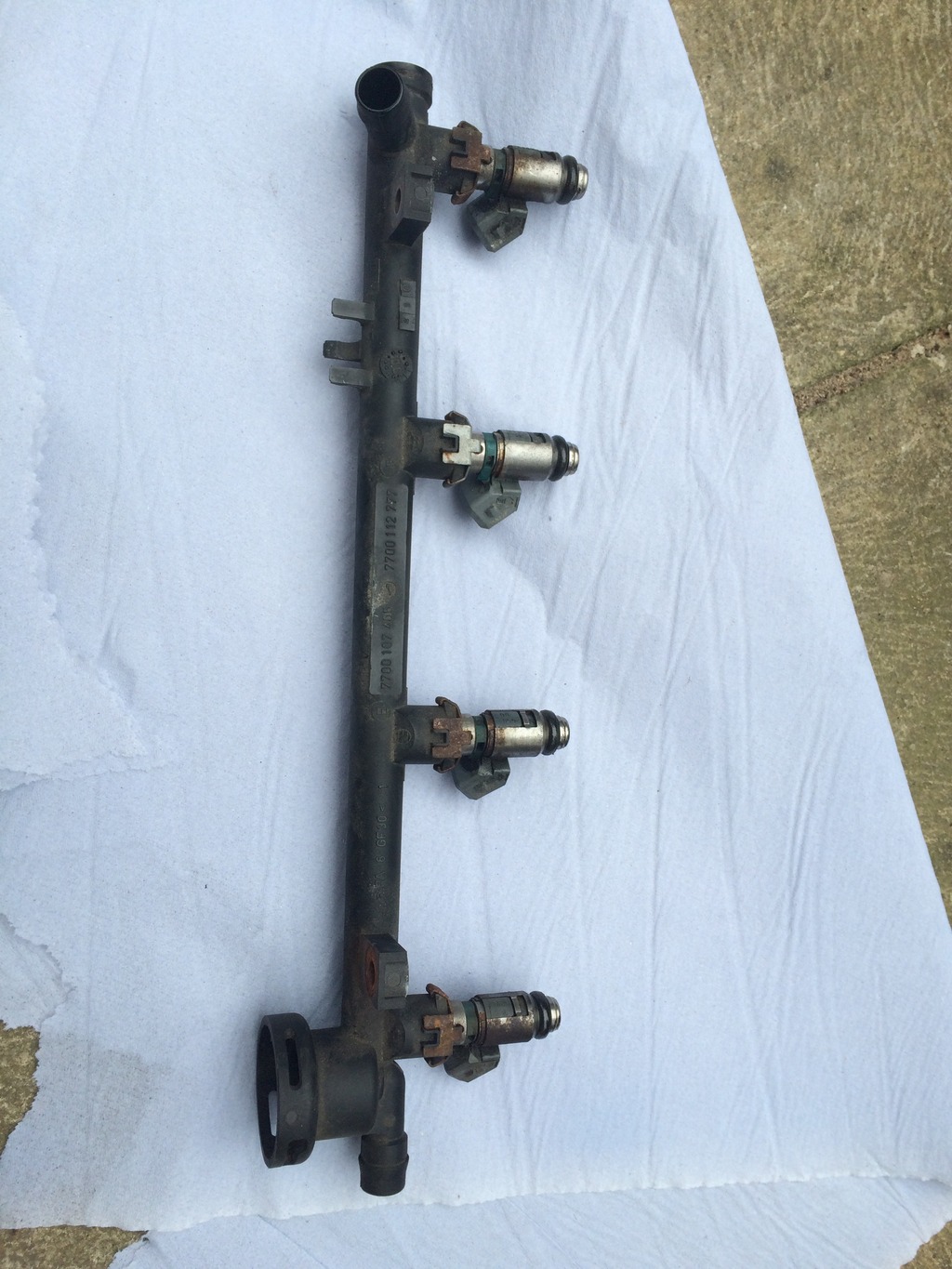

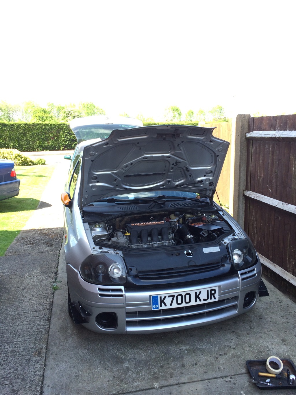

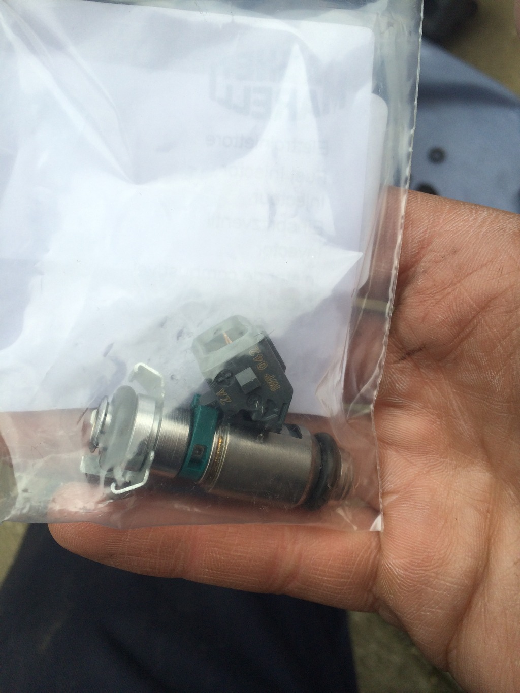

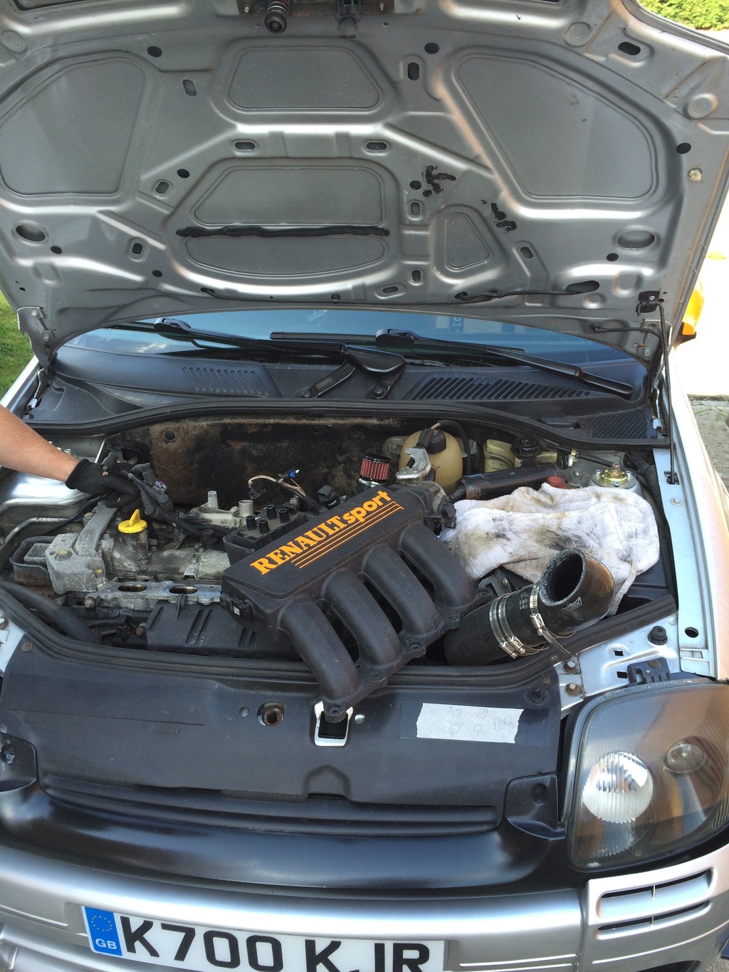

Back to 4 cylinder!!! Injector 1 was faulty, so I replaced that.
Fuel rail out....eventually!
Ready for a bit of a clean
New injector ready to go in.
I know I should have chanegd all 4 I think, mainly as a precuation kind of thing. Glad it is working now.

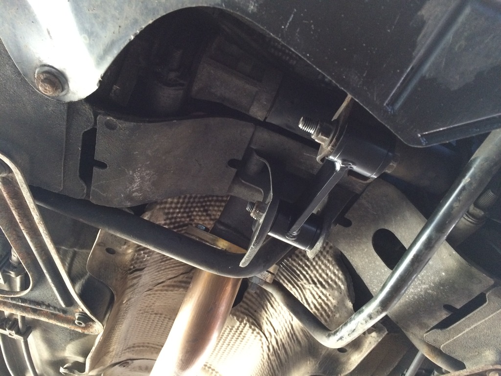

And about to start the process of getting a new exhaust made and fitted. Hopefully that will add some more noise! But more noise in a better way and not some chavvy badger catcher on the back
So.....4 cylinders are over rated, it's all about running 3. Yes, the car decided to be a 3 cylinder again today. I gave it a bit of a push joining the M5, got to about 6k and it hesitated and then decided to be a 3 cylinder. I thought it was the rev limiter, but I got confused as I was nowhere near the red line. The EML is flashing so I am assume injector fault again. Annoyingly I am about an hour from home to check anything. I have hardly used the car since fixing it, less than 50miles, so it's annoying.
But in other good news, currently sat at Infinity Exhausts getting a new system made up!!! Hopefully will sound a bit more race car like....when it's running properly again!!

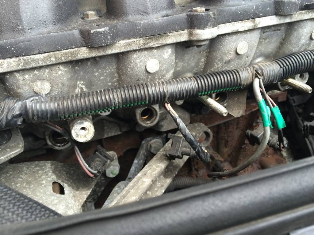

It's the same symptoms as before so I am pretty certain injector, and isn't flashing EML injector? But the EML doesn't stay on like it did. It flashes for a while and then stops for a bit before flashing again. Before it flashed for a while and then went constant on, then back to flashing. Although when it went before I had no power, struggled to get above 30mph. But I have just driven down the motorway at 70 like it and it pulls, just badly. It is as if it needs a boot full to clear a blockage. But I am scared to do that! And yes I know driving in the state it was in is bad, but I was seriously hacked off with it and I lost my ability to care for a while.
I also want the car Easter weekend so I need to get it sorted before then, but so busy at work to squeeze a day off. But car >> work!!
r****d moment.....injector wasn't actually connected. Not sure how it happened. Simple fix!!!

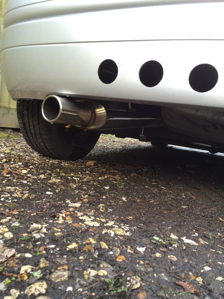

New exhaust is pretty damn fine. Custom made job. Centre silencer, decat and a single tip. Top notch! It's about 90dB at 4500rpm so will pass noise limits with ease. And the noise it makes is bang on. Really happy with it!!!
EXHAUST PHOTO! I am in love with it. Any one want an exhaust, go get one from Infinity.
The guy who fitted it was very complimentory over the home made exhaust mount, said it was the best he had seen. This made my brother happy as he made it. Tiger Seal ftw

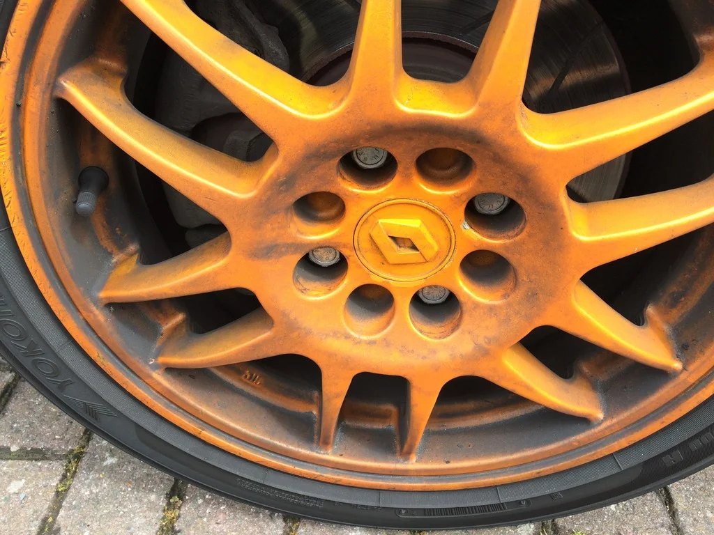

But washing it has made me want to re-orange the wheels and mirrors. They are looking tired. But if I do this I want to do something about the paint work. Roof needs doing, and will be done next month. But temtped to wrap the car, some kind of race livery/lairy colours, but would rather spend the money on actual performance parts.

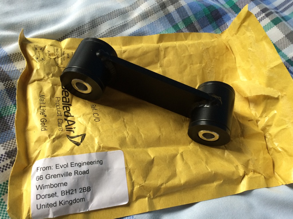

Coil Pack, HT leads, injectors, sun strip and an Evol Engineering dog bone mount. Only changing the leads and pack as precaution, my brother thought there was a slight missfire and I can't find any paper work to say it has been done. However.....the leads were totally wrong. Fine, I will just do that another day. Then came to fit the coil pack.....different plug on it! Great, first two jobs started and the car had to be put back together without anything being changed! I wasn't given any option when buying these but when I tookt hem back for a refund there were two they could have offered. Doesn't matter as I will just replace the coil pack with a proper genuine one and might invest in some Magnecore leads from K-Tec, but not sure if they are worth it.
Tripod car
My brother was a bit confused if the manifold on the car is standard or unpraged. I haven't had it changed so i just assumed it was standard. He says it is the nicest standard manifold he has seen!
Changed the injectors as I was sometimes still getting a flashing EML despite it throwing no fault codes or running badly. I changed one back in March and I knew I should have changed all 4 at the time, so I just swapped the remaining three. Not sure if it is a placebo effect but the car feels a bit more immediate. However the old ones were full of crud.
Dog bone mount was a straight swap over, really impressed with it. Makes everything feel a lot tighter with the gear changes. But there are a lot more vibrations in the car, can feel and hear them. The car makes a different noise when starting up, but that has to be the body work shaking!

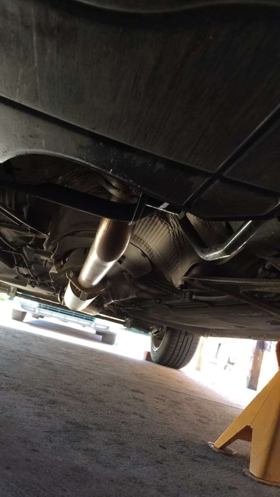

Undershot of the car showing the exhaust

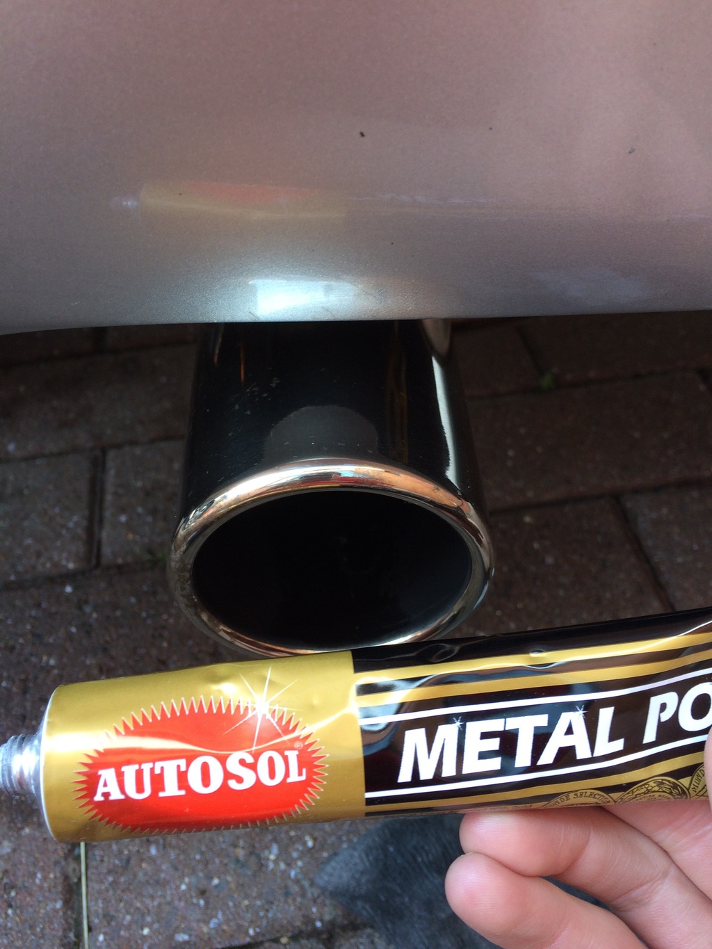

Gave the exhaust tip a quick polish

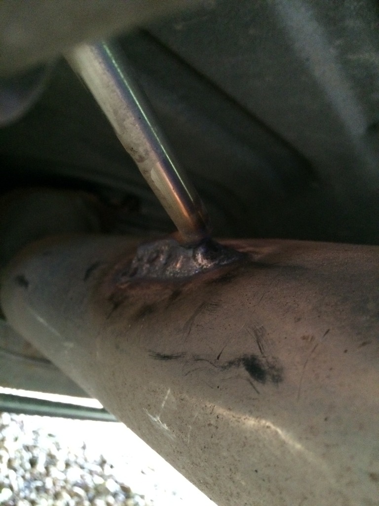

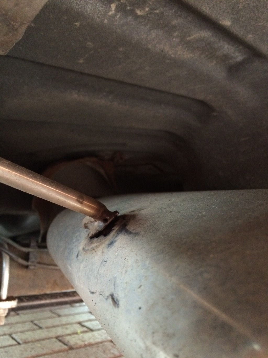

Then I notice this
The hanger mount has pulled the back silencer material away. Not happy about that. But I am about to drop Infinity an e-mail with picture to sort out getting it fixed. Has a life time warrenty so that is good, but I wouldn't pay for this repair anyway as it isn't that old and it hasn't been damaged. Just need to see what their customer service/after care is like, as they were really helpfull when I was enquiring and getting to sorted to start with.

Exhaust = SORTED!! Took it down to Infinity first thing this morning, was in there less than 30mins and it was mended. Got them to fit a Powerflex exhaust mount to replace the one that broke. Good service again, I cannot fault.

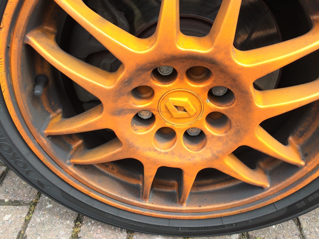

The heat has made the brake dust get into the paint and now it looks gash. The rears cleaned up well but the fronts need a refurb. ANNOYING!. Oh and a message to RTR George next month to purchase some new discs and pads as the N/S front is making an awful grinding noise unde braking, it is as if there is no pad. The outside pad is very thin but I havent taken the wheel off yet to see what the other pad is like. Apart from that the day was very sucessful! Need to get something sorted asap.
The car is booked in to get the roof wrapped black this Friday. So this will mke me do the wheels sooner as they will be the only thing letting the appearance down.

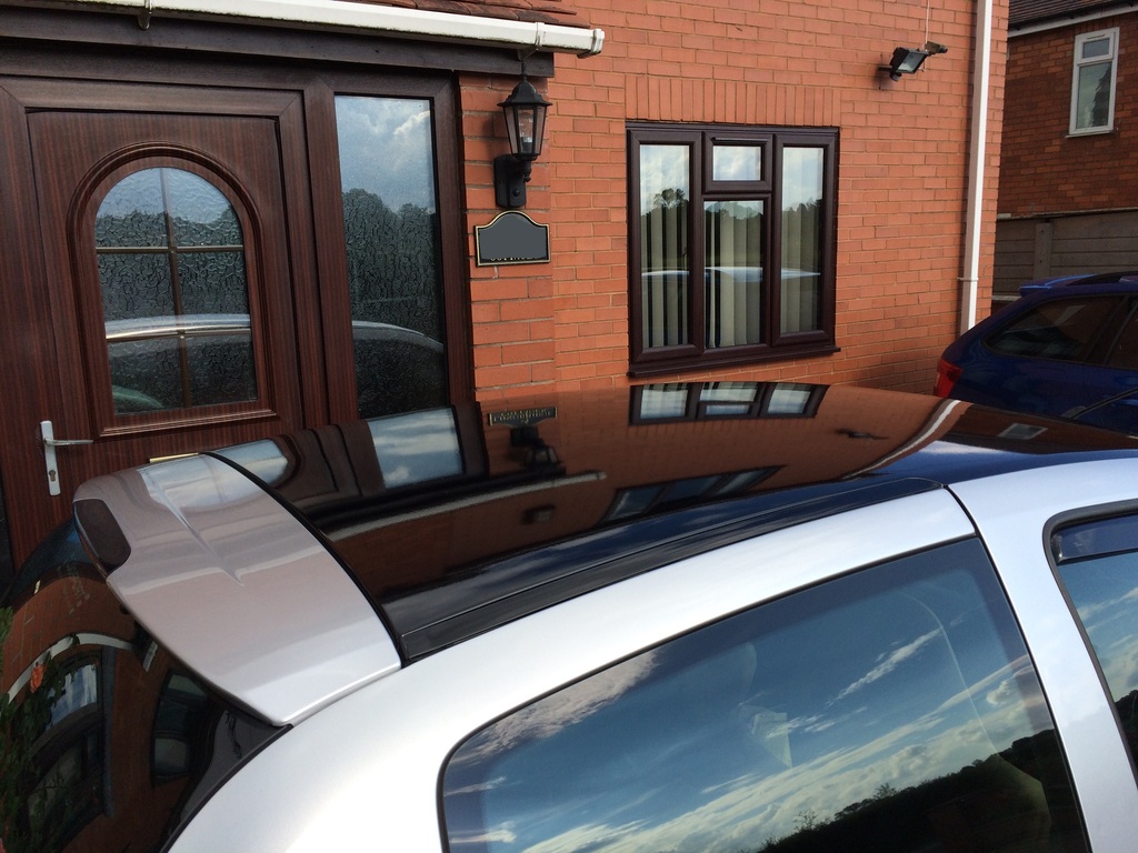

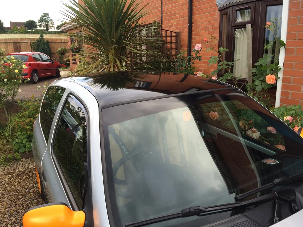

Not done much on the car last weekend. I did get the roof wrapped as I sort of ruined it - never use a heat gun on the inside of the roof if the outside is wet, I burnt water marks into the lacquer. I couldn't get a picture of it, but no one had seen anything like it. But now it is black. It does the job and looks smart. Also got a sun strip put on at the same time, it was getting really annoying not having any sun visors! Not sure if my camera will be blocked by the sun strip now, may have to make an extension for it.
It was quite hard to get a picture of the roof, the sun was in the totally wrong place and there was too much glare. Looks a lot better in the pictures.

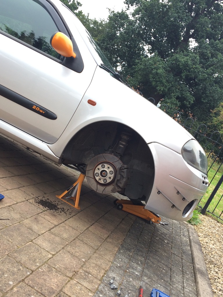

Did a but of work on the car this weekend...changed the front discs and pads. Wanted to remove the arch linings at the same time to clean the crud from behind, but ran out of time. Plus one of the lining bolts was about to round off and I didn't have a replacement.

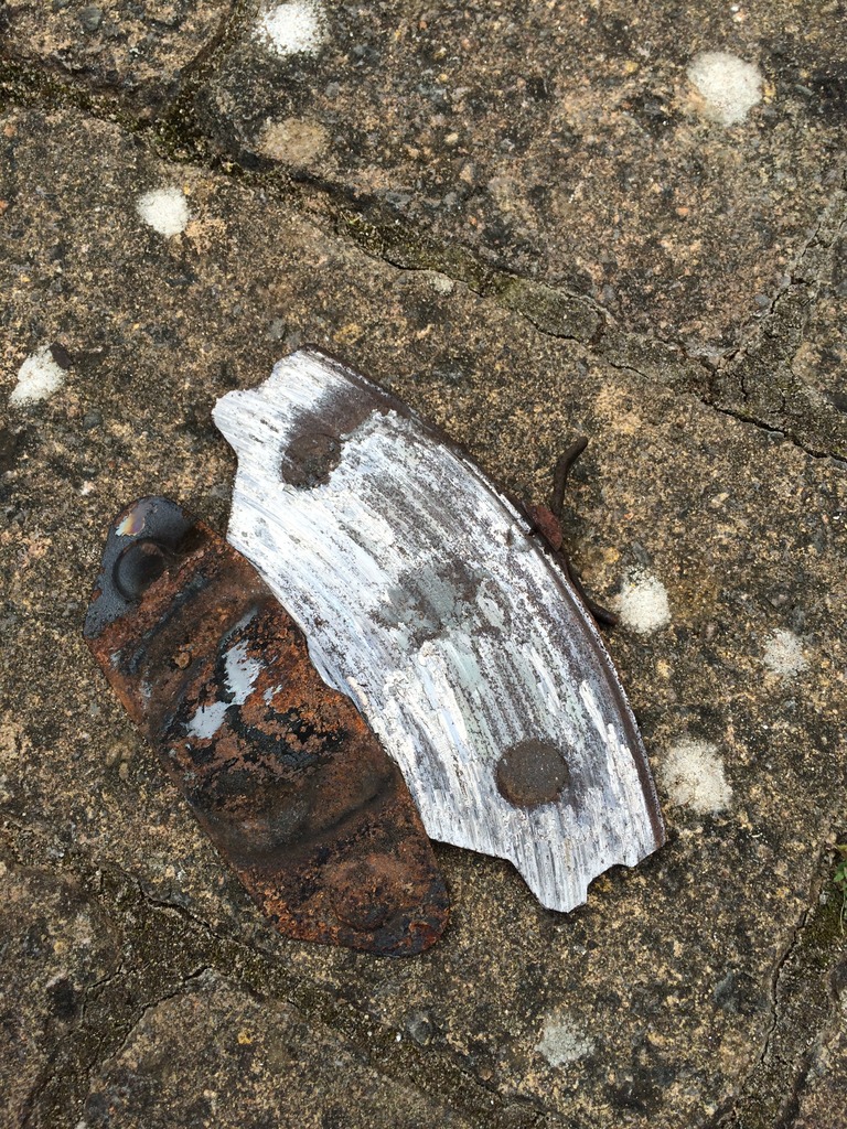

No wonder I had an awful grinding noise when braking, I think there is meant to be a break pad here:
The other three had quite a bit of life left in them, this one - N/S on the inside of the caliper - there was nothing.

However I struggled like mad to get them to fit. Did the standard file the bit off the ends/tabs to get them the right length. Managed to get them to fit inside the caliper but they wouldn't slide. Nothing was working, so I got angry as I needed the car working so went up GSF and bought a set of cheap budget pads to get the car to at least work as the MoT test is next week and this was the only time I have at fixing it. Turns out the Ferodo pads are a slightly different shape to the Brembo ones that came off and the cheap ones I bought, The Brembo / cheap ones are flatter along the bottom, the Ferodo ones are rounded, like they have more material.
However.....the instructions I got from RTR George when I bought them says you can run them without the carrier shims. Told my step dad this later that day and he called me an idiot and why didn't I say this before as this would have worked! Messaged George to confirm, so will sort them out next weekend. The cheap ones were never going to stary, just to get the car working. I hope they fit my 1.4 Ph2 daily Clio as they can on there!!
I needed a second person to apply the brake to clamp the disc to undo the disc bolts and spacers, but I was home alone. But I had a box full of discs brakes! Worked very well.
Few more plans....need to source two wheels to get them painted up orange as mine need a refurb. I can't have the car standing on axle stands for long periods of time so I have to get two wheels and paint two at a time, swap the tyres over and then do the other two. Not an issue as I will have two spare wheels.
