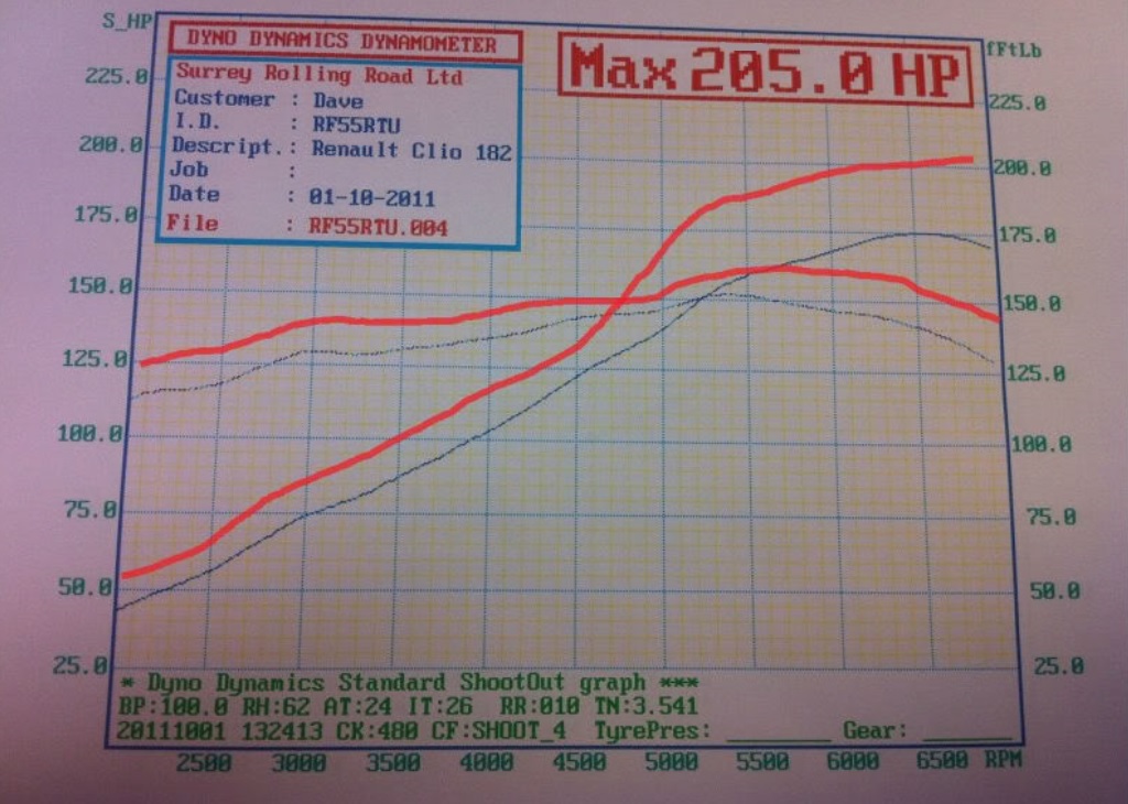

I had my Ktec map checked by Mike Woodford a couple of weeks back, and he actually said it was one of the best he'd seen from them. Maybe he'll pop along to post an image of the log.

Here's a graph of the power it made with it on, gained 30bhp iirc.
Indeed. Your generic map from K-Tec was absolutely spot on! Couldn't fault it if I tried.
Sadly. Your car is the only one I can say that about though.
