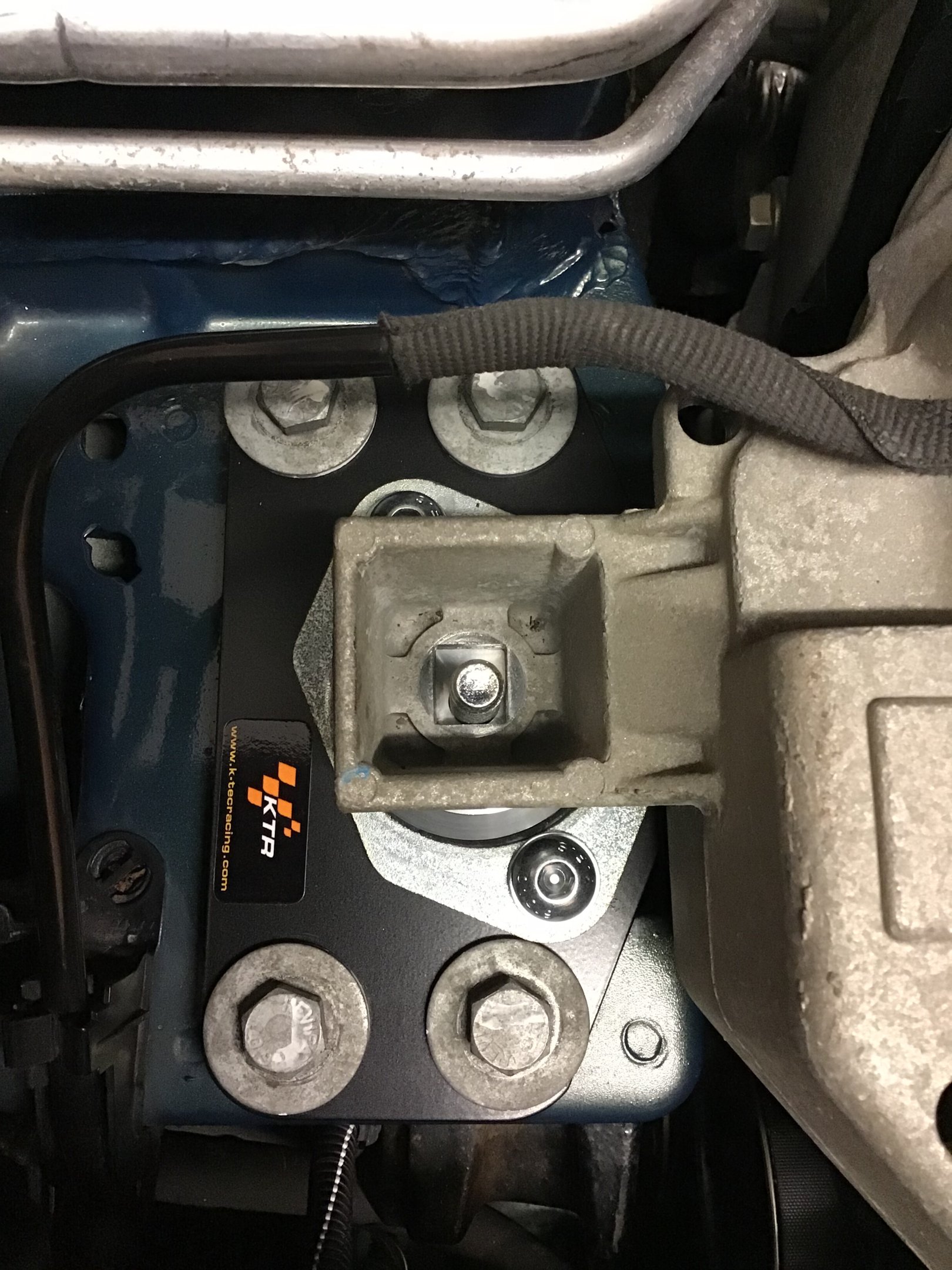

I have fitted the uprated Ktec engine mounts and I have a question on the right hand side one.
As the picture shows, the engine timing cover has a square hole which sits over the bolt to the new mount. The engine can rattle around the bolt within the square hole except for obviously when the nut is fitted it holds it all in place.
I kind of expected a square washer or something that would stop the potential movement?
It might be fine but I just wanted to check what other people have done.

I got a thick washer that perfectly centralised the stud into the middle.
Just measure it, can't find the ones I bought tbh
