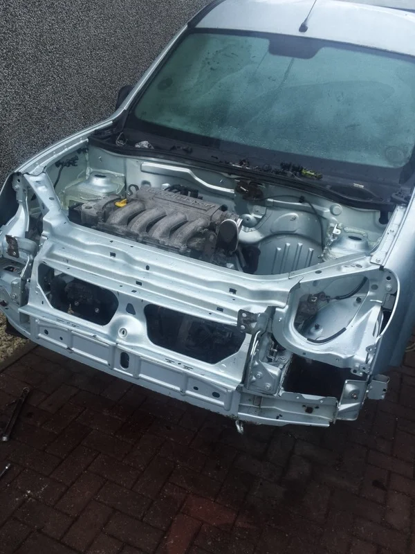

Car  van low and 1.6 16v

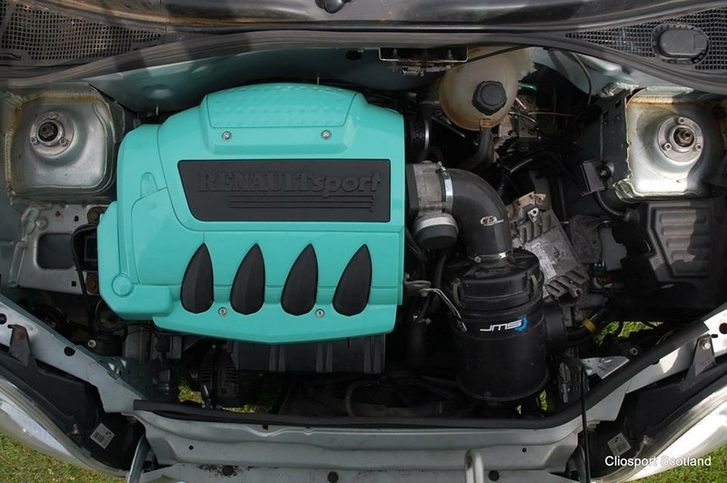

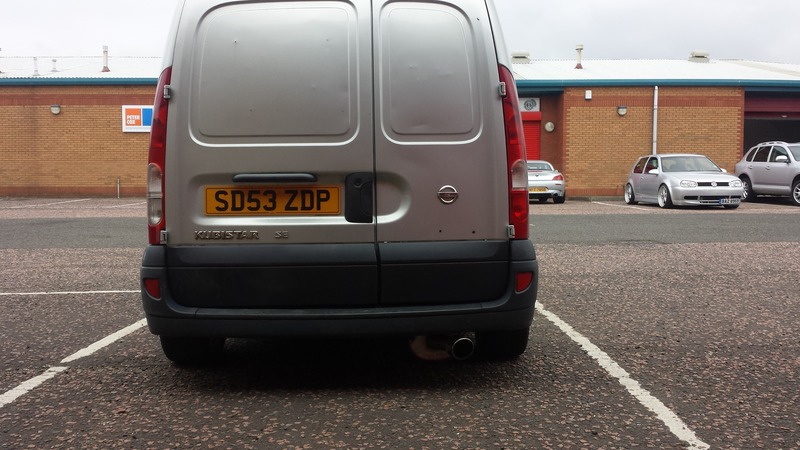

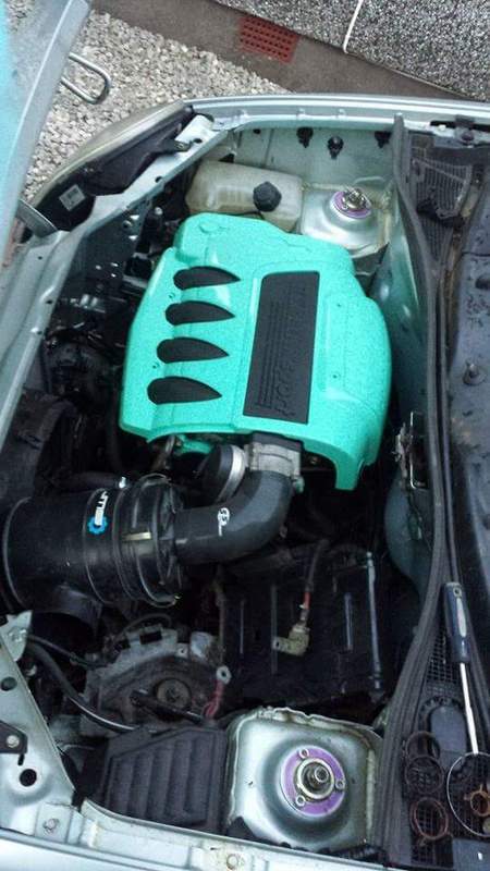

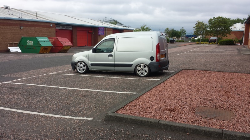

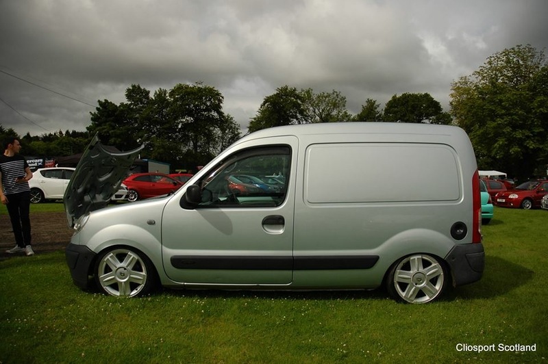

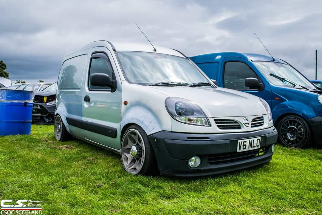

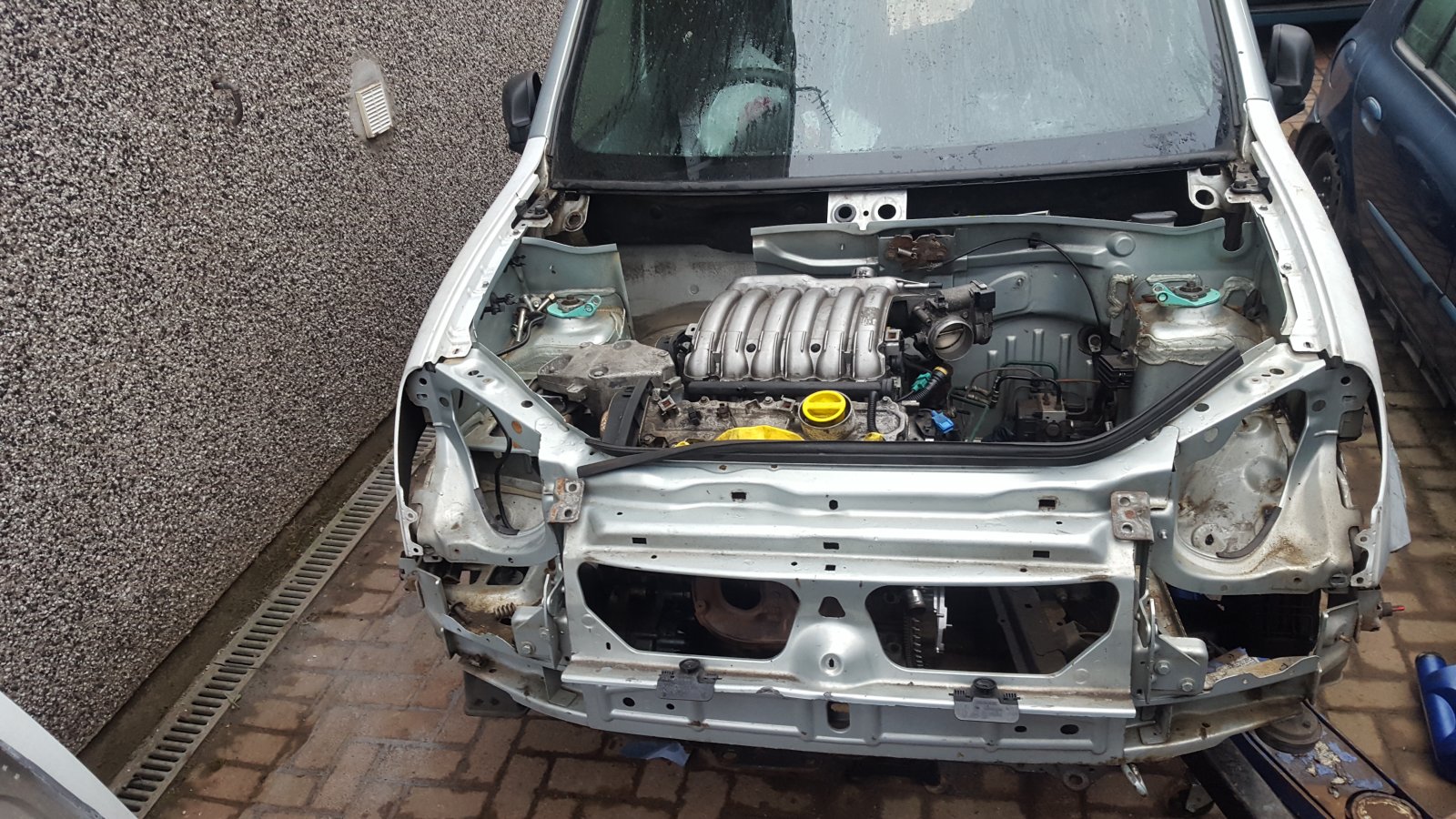

Here's my latest build. Orginally started as a £400 van which I was buying as a new daily which was only supposed to need injectors. Turned out it was far more than that. So worked out cheaper doing the sport conversion. So i fitted the f4r in. Got it going and had a weak spark on 1 + 4. Traced it to the injection comp fitted my spare on in and now runs perfectly. Still few things to sort out. It nothing major.

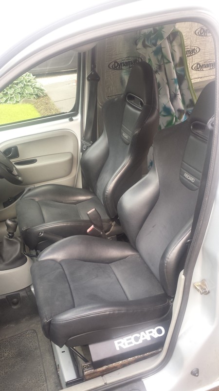

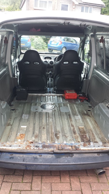

currently has jms induction kit, pms exhaust with decat. 16mm rear spacers. raceland coilovers with pms top mounts, planned to fit the strut brace but means loosing the engine cover. lowered torsion bar. recaro trendlines. waiting to fit my 197 wheel once its retrimed.
plan to refurb the wheels as the donar ones are fairly covered in kerb damage but they do the job, and sort out the body work and replace the windscreen. replace clutch and refurb the box due to the selector seal leaking.
That's pretty damn cool. Nice job. Love the fact you've put Recaro's in it.
Genuinely one of my favourite things at the min.

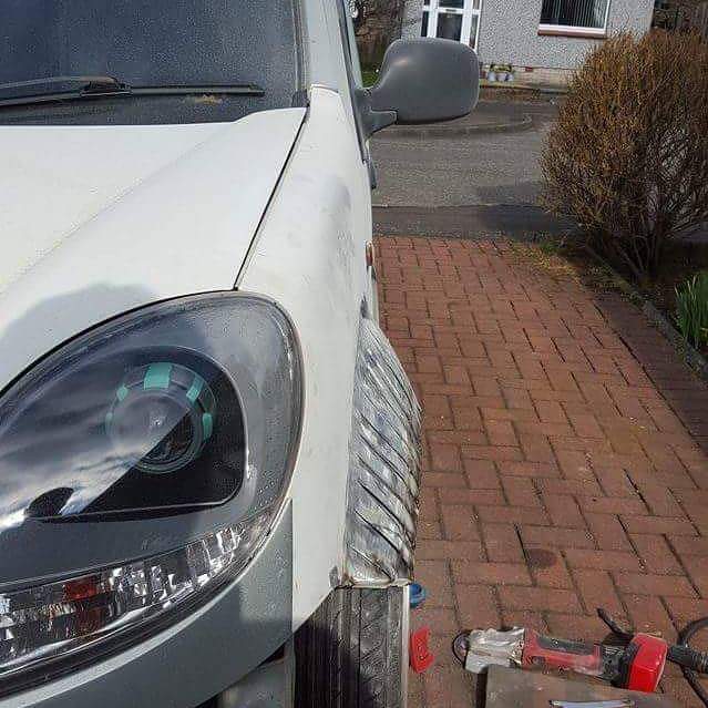

Ive went and done what i do best and ruined it.

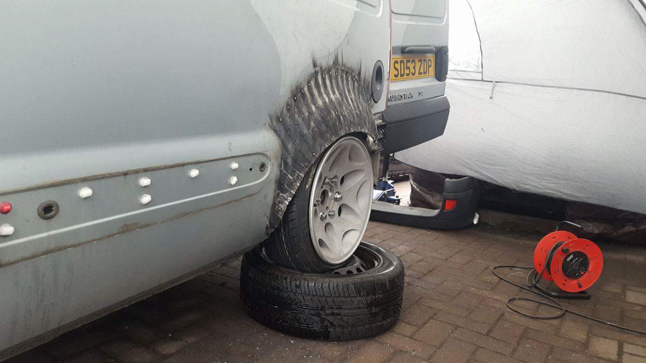

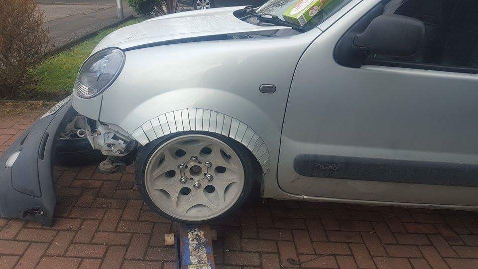

Now has l200 alloys, wider arches that just need filled/shaped

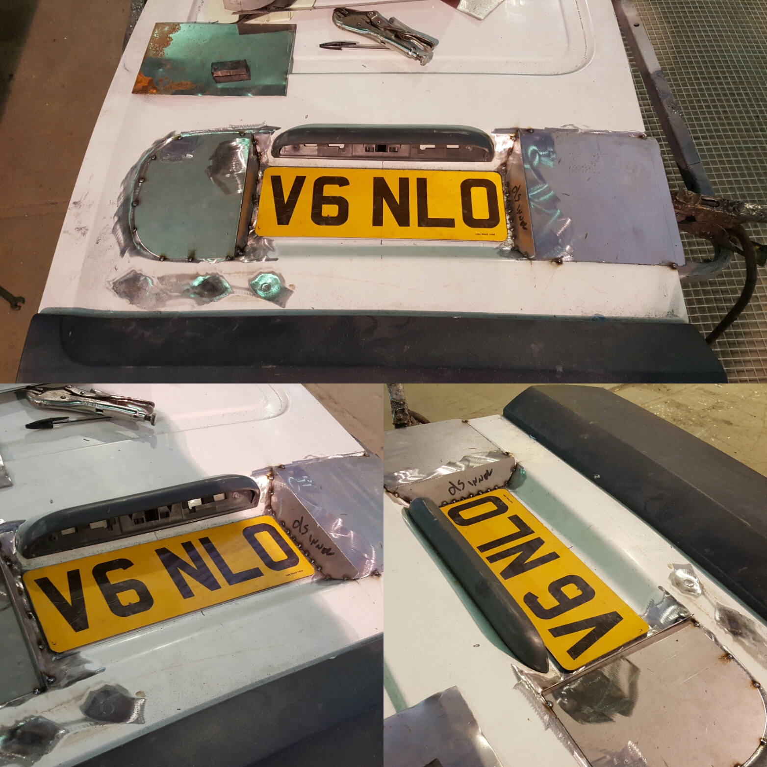

Private reg is on

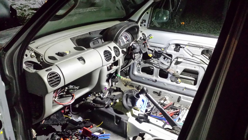

Middle of shortening the rear doors and removing handle.

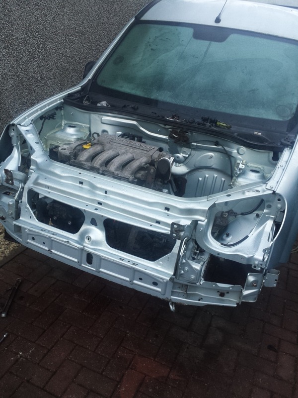

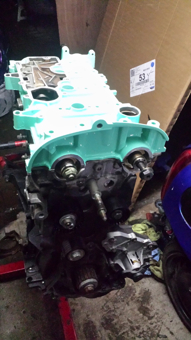

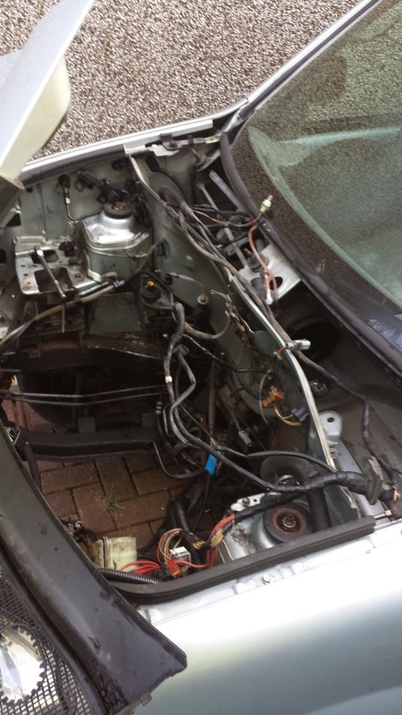

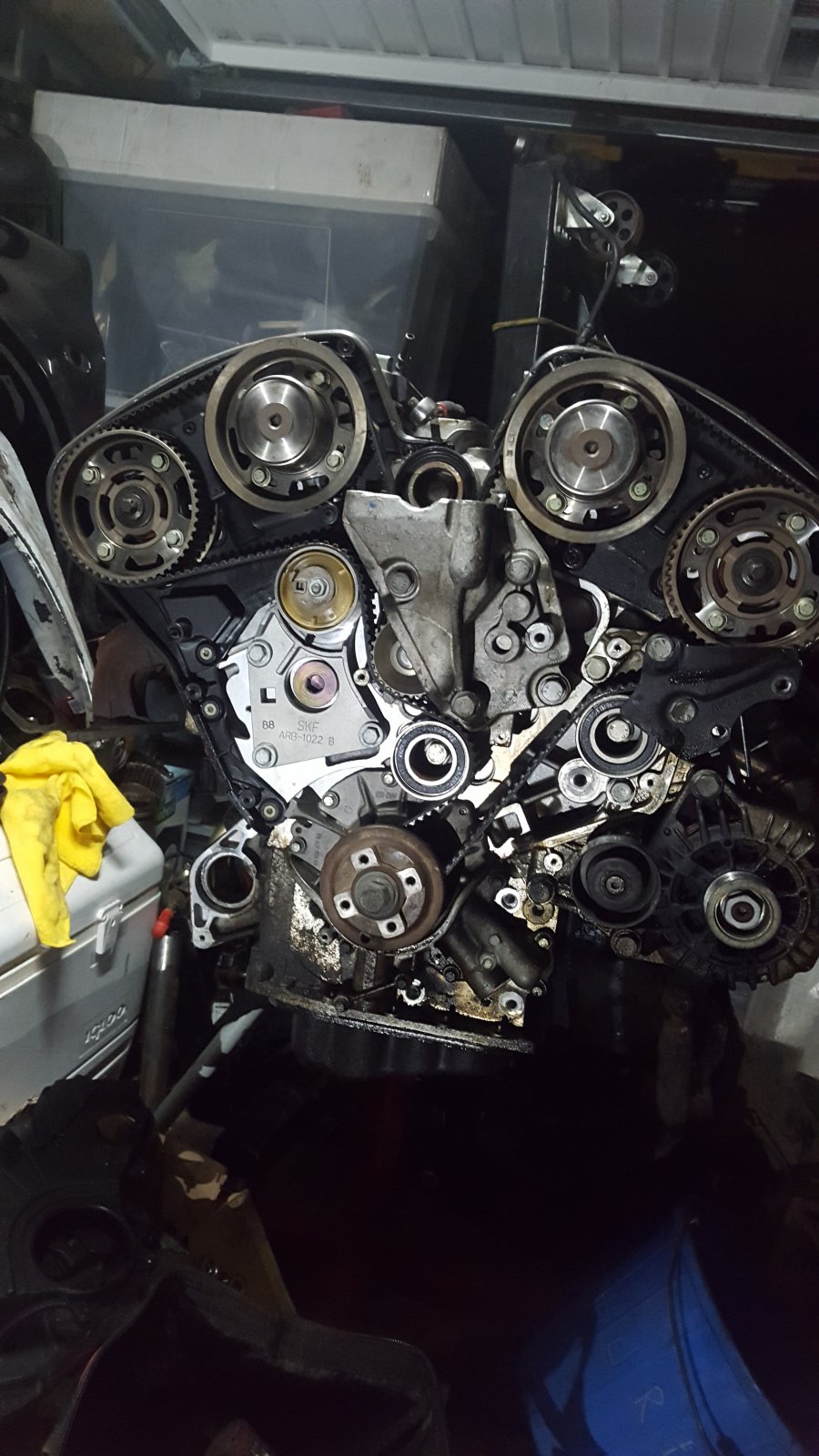

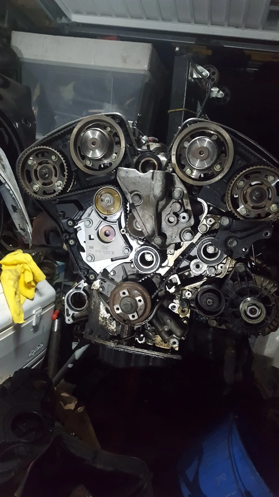

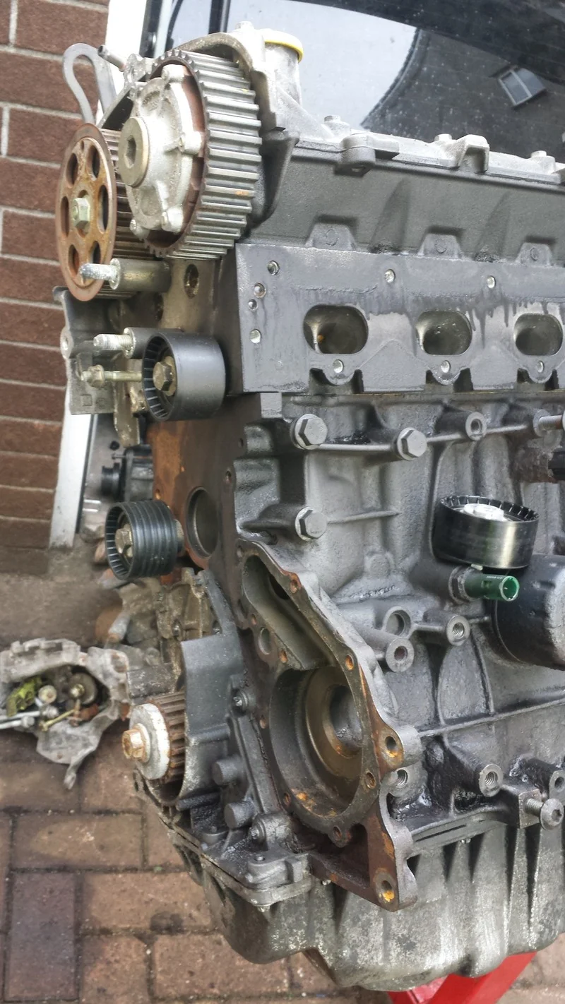

And just sorting out the new engine for it. L7x.

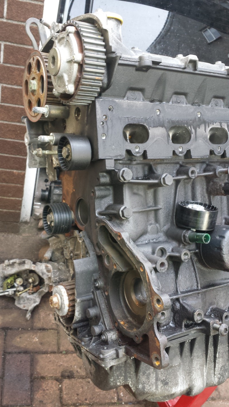

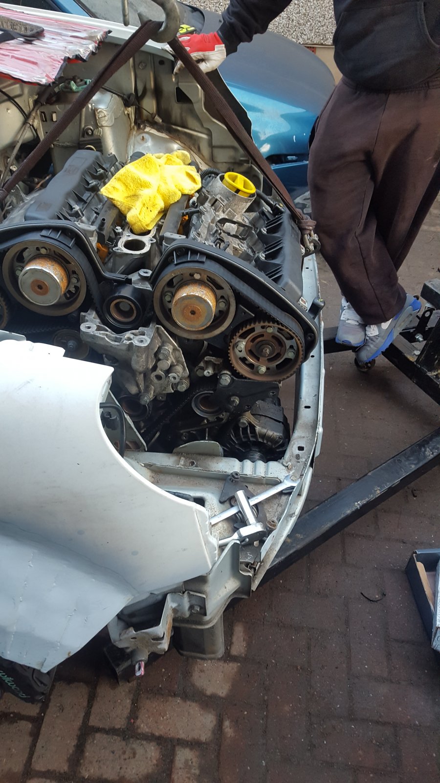

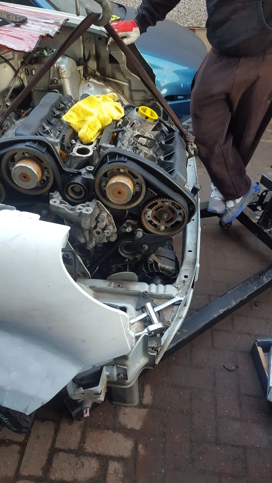

Started new engine conversion

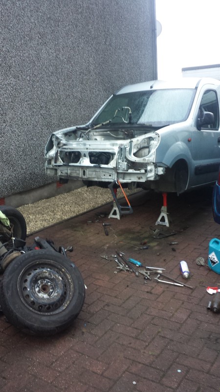

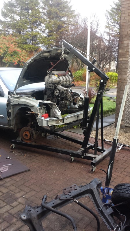

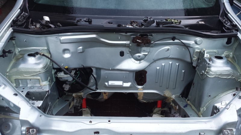

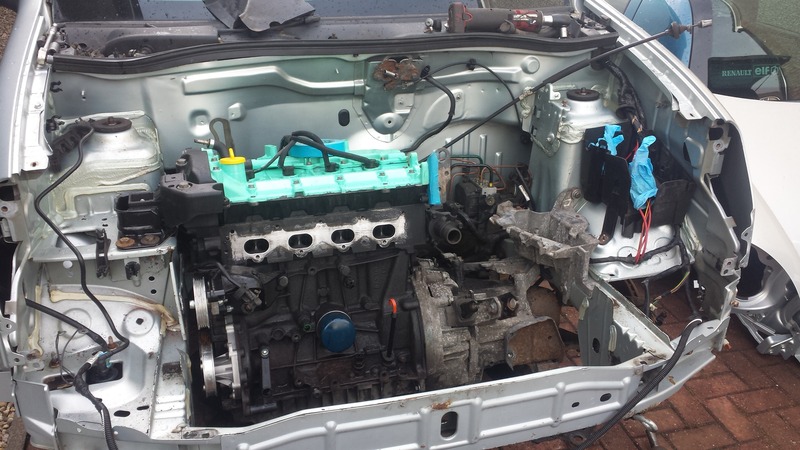

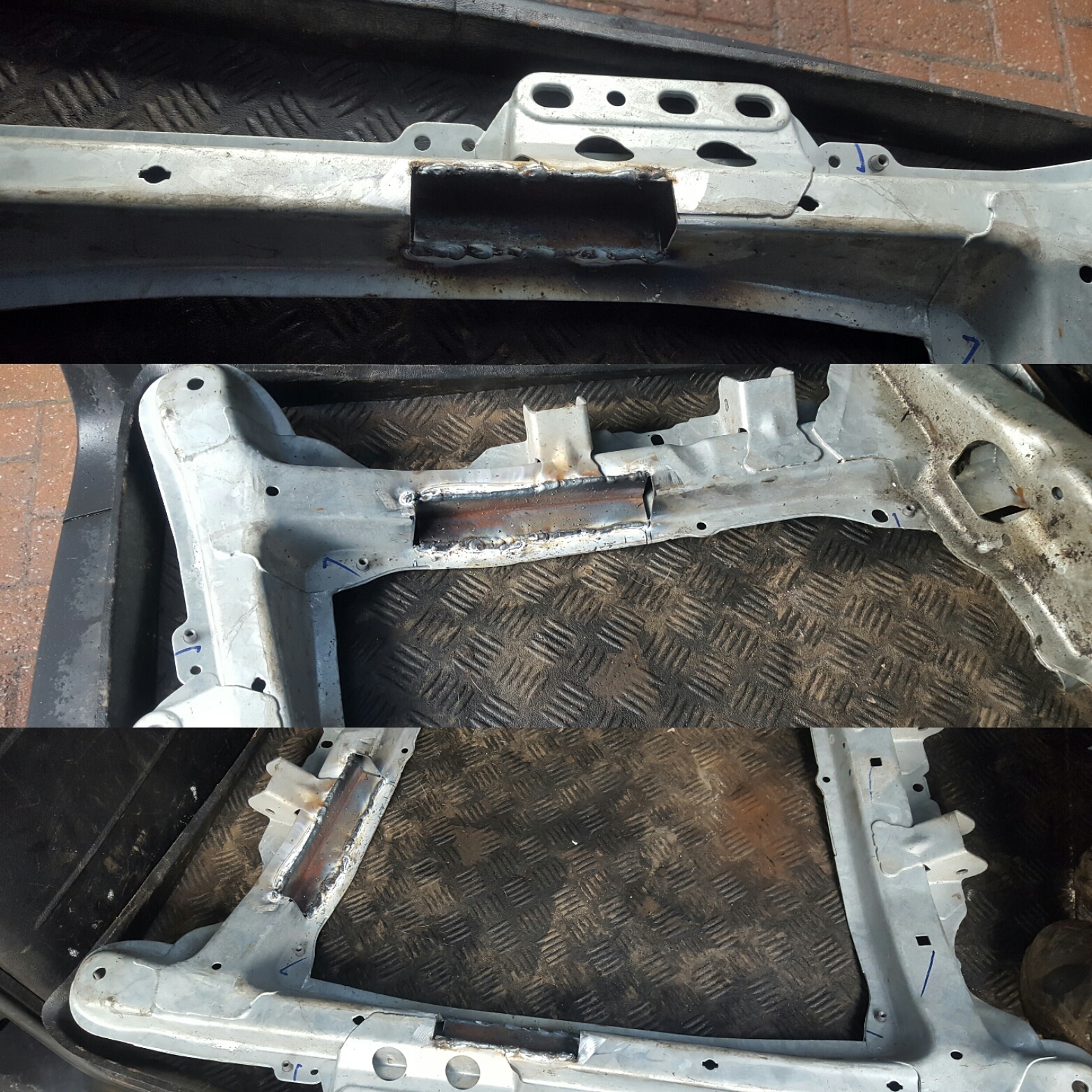

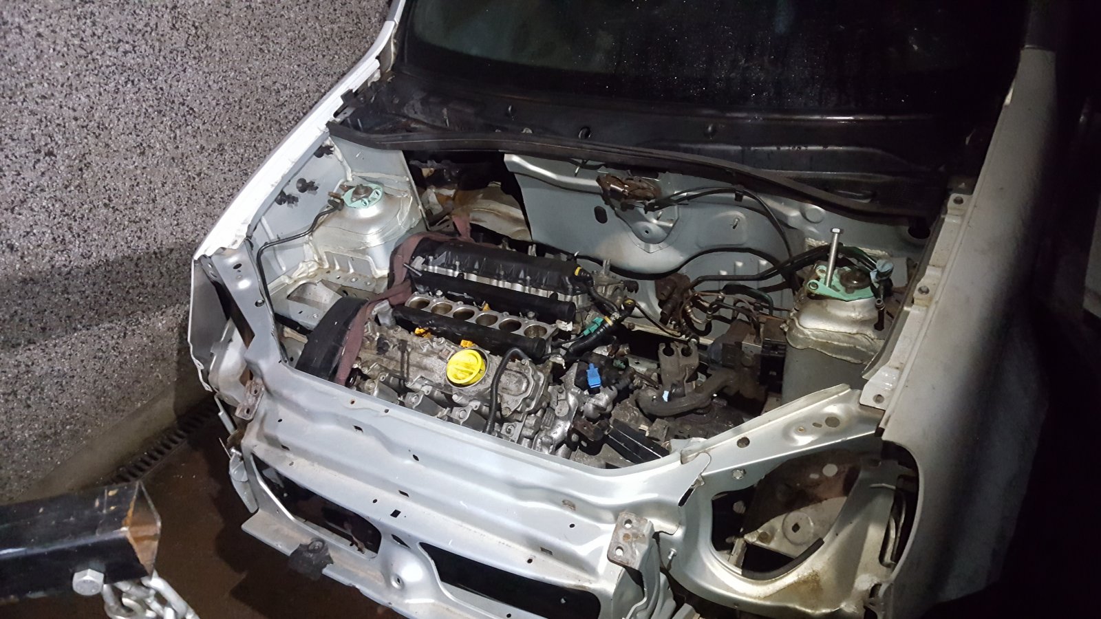

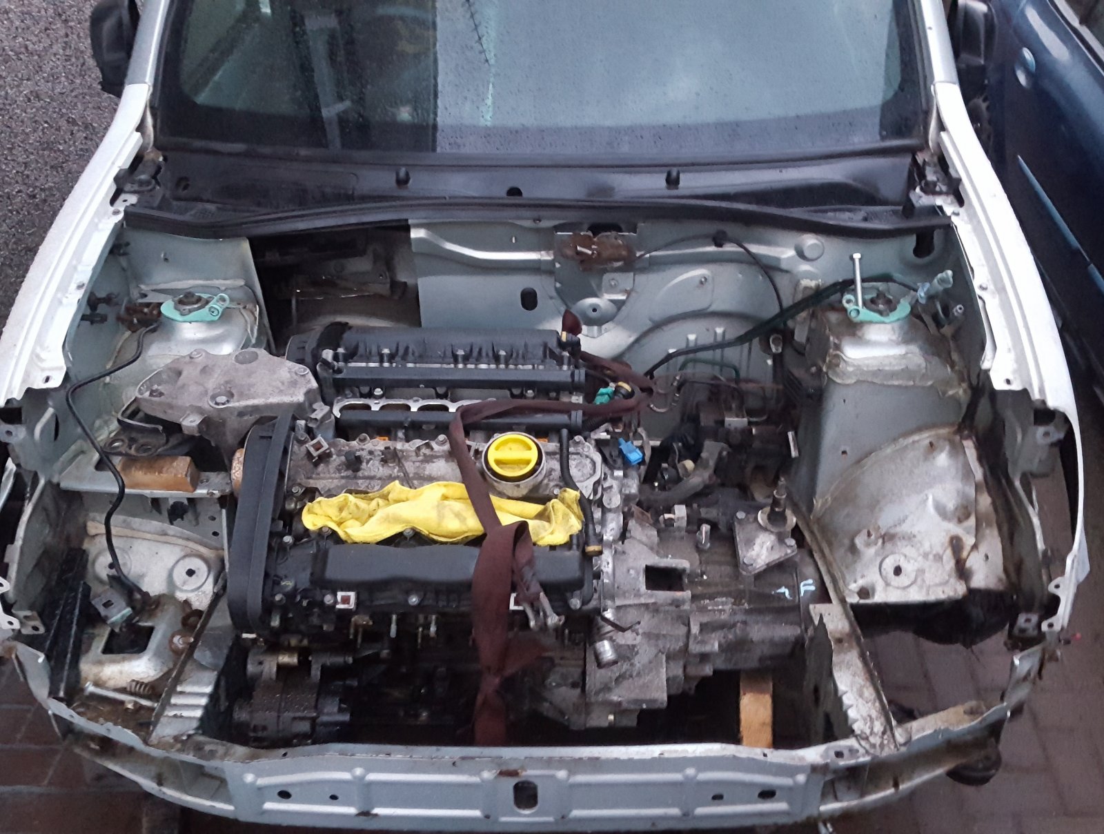

Got the engine sitting where i want roughly with out the box. Seen what i need to do to top mounting and how much i need to trim bulk head. Just need to remake that section i cut out. Unfortantly i need to relocate the servo/master cylinder so might mod a megane 2 pedal box or just get a universal on with its own resivoirs another option would be to use a remote servo.
Also collect the gearbox tomorrow so will get that on and hopefully see weather or not it will be 100% going in this way.
This is how it is sitting just now. Till i make up my new engine and box mounts.

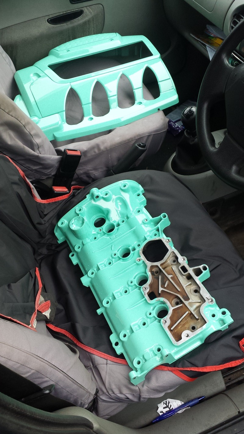

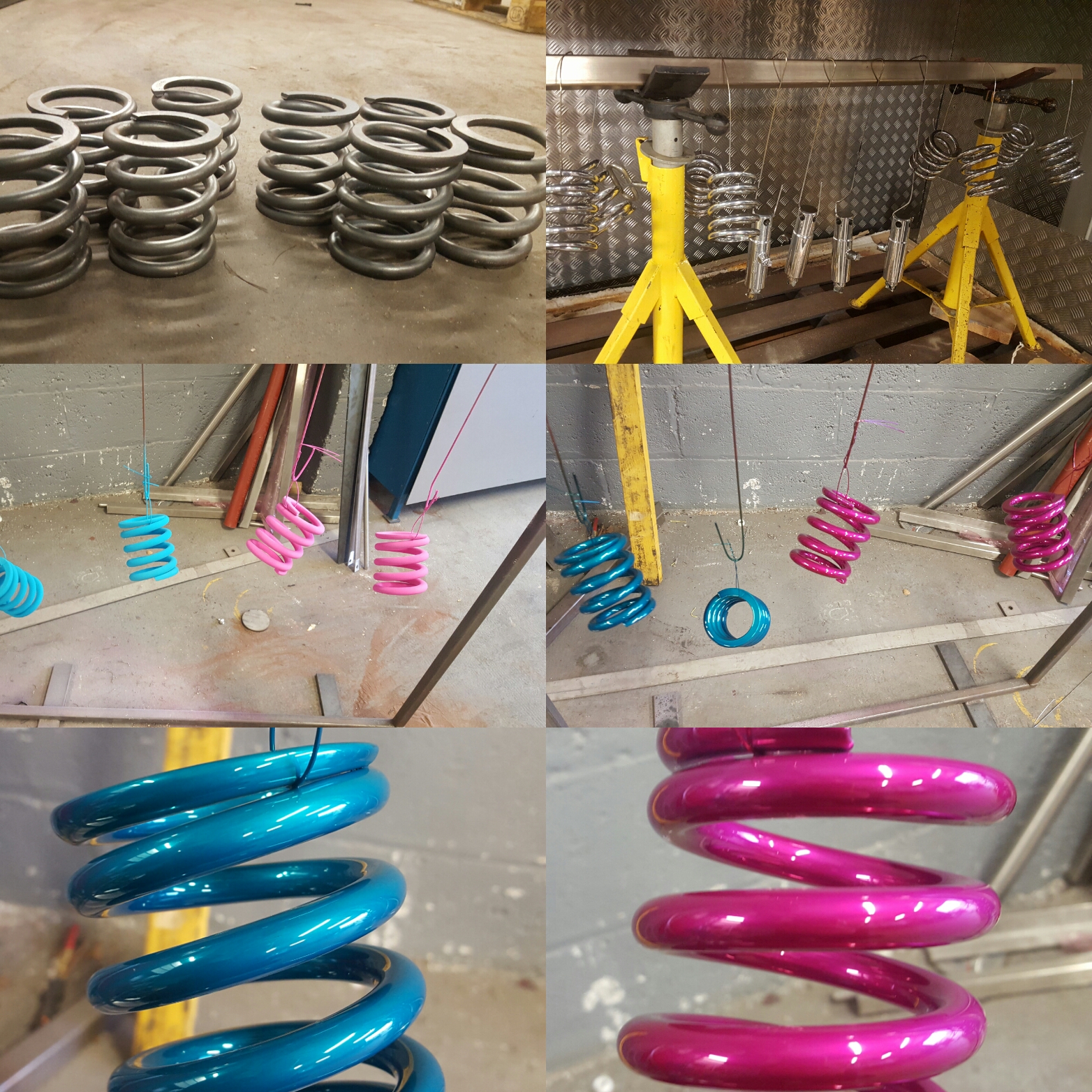

Used some candy powder coat on my hydraulic springs. Nearly finished powder coating all of that. Only got my craddles to coat then get 4 hoses made up and its ready to get fitted all being well.
