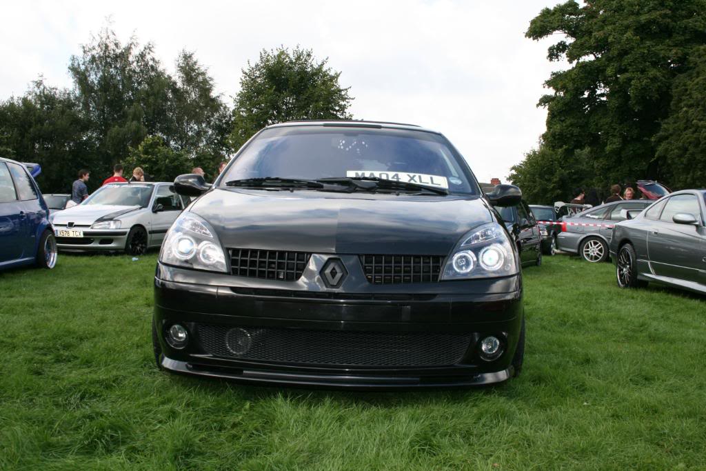

what are peoples opinions on this?
personally i think it could look pretty good and smarten the car up a bit.
has anybody done this?
its just that ive found 2 cans of lacquer and i am considering it
i was thinking that myself. but it may look decent. i dont want to try incase it goes wrong.... unless somebody says "it will look good. here is a pic of mine" lol
not much difference really, i was going to go for gloss black but i thought the front end would be too shiny black.. just kept it matt/satin looking without the hassel of it fading/turning grey..
if you want to laquer it just give it a good clean then get the laquer out, what so hard about that? just spray a few coats until its shiny... but it'd look crap. stick to matt black aerosol, or if you stil persist on the shiny look get the gloss black
Sprayed my saxo grill. It was faded quite badly and ag bumper care wouldnt get it back to life so i just gave it a quick rub down with 800 then 1200. Primer. 1200 again then satin black paint from halfords.
